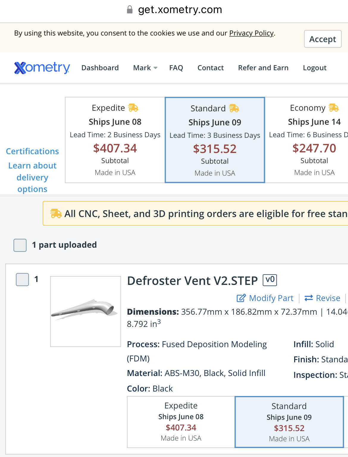

I never finished my model, but I just ran the prototype through a quoting engine to illustrate why I abandoned the effort.
This is one side:
Well Markos, thank you for the kind comment. Also, your comments about 3D production validates Don's comments.
Either too expensive or not feasible, not to mention ours will last forever, specially without rivets ;)
At times, 3rd world antics and a bit of imagination trumps new world tech.

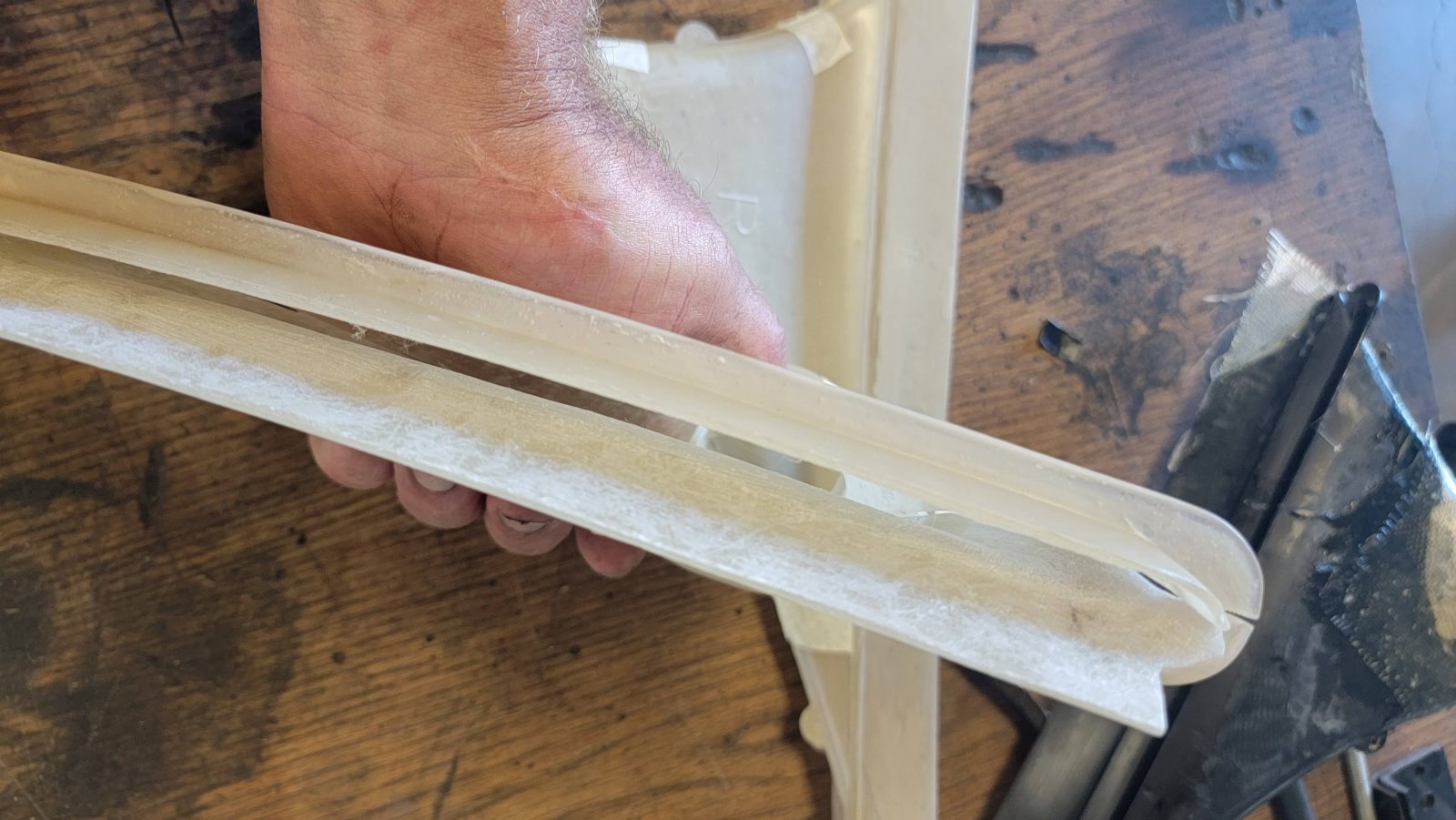

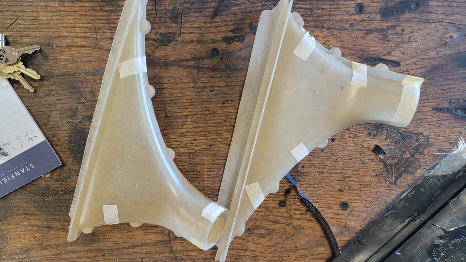

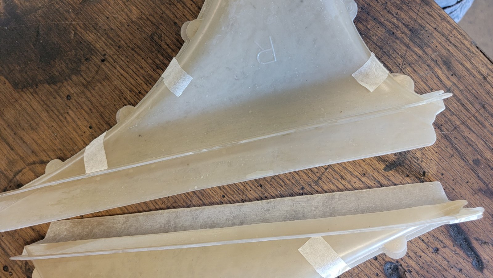

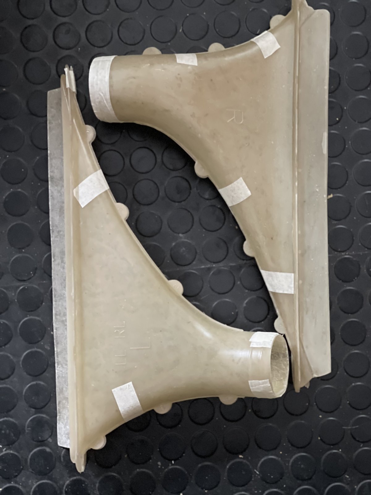

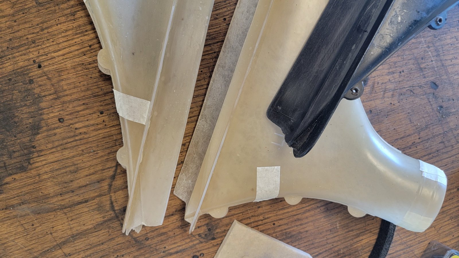

Just an update for everyone who has waited 40 years for these unobtainable parts... I am the first recipient of @aguirola 's fine workmanship and am very pleased.
Thanks so much to Alberto for rushing out the first set to me -- I am in the midst of finishing @JetDexter 's CSE and the old vents were close to beyond repair so these have enabled the project to continue moving forward. As mentioned, I asked for a set non-bonded together or painted because we'll need to make some modifications to the hose end to adapt them to the modern Vapir 2 HVAC unit we're installing in this previously non-AC car.
Overall, the pieces are very nice. Far from looking a gift horse in the mouth, if I'm being a perfectionist there are a few areas where these differ slightly from the originals. Namely, the riveting tabs are very thin, and, in fact, break off easily. The corners of the deflector blades are a bit square, and the new units lack the internal dividers of the originals. But none of these are show stoppers. The new units are designed to be expoxed together, not riveted at the tabs so the tabs are really just for alignment. Recipients of the fully assembled units will no doubt never care about the tabs. The corners of the blades can easily be sanded down a touch to match the original profile if desired. Again, something Albert may do when he assembles and paints non-prototype units. And the lack of dividers has no material affect on the performance or strength of these reproduction vents -- being fiberglass reenforced, the new vents are much stronger than the original brittle plastic so internal supports aren't necessary.
There are a lot of complex curves and finely detailed areas that came out perfectly in these units. Any other small differences will be below the dash pad. They will look great from up top once installed in a dash.
Thanks again to Alberto for fine work, and for even using US-visiting friends to save on shipping costs. We talked on the phone a couple times and he's a great asset to the old car hobby.
