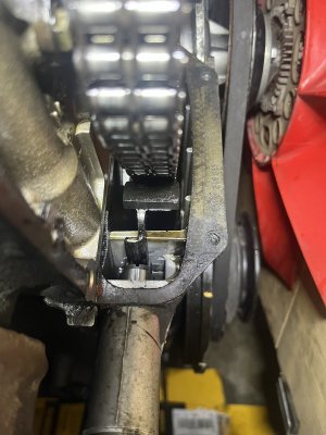

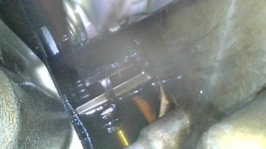

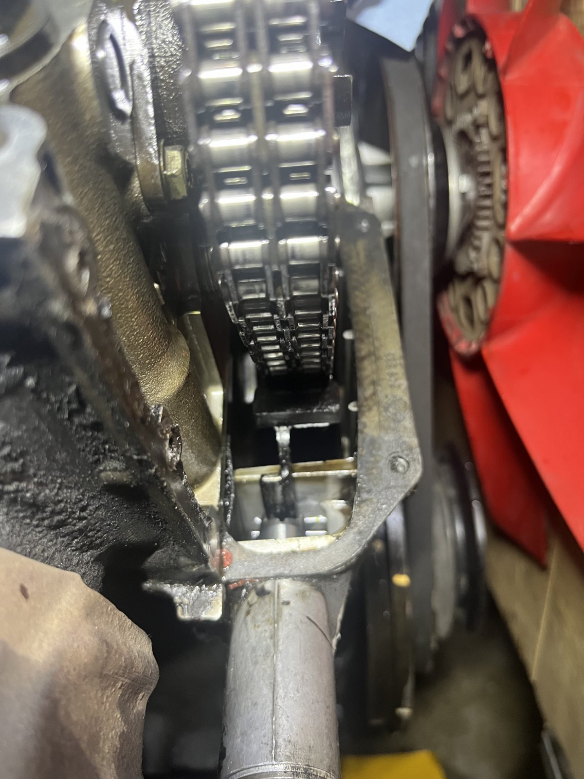

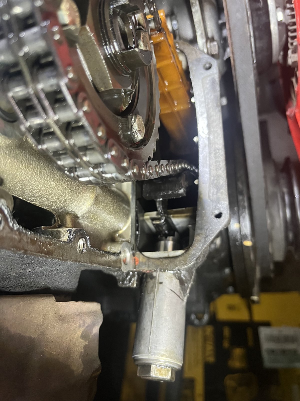

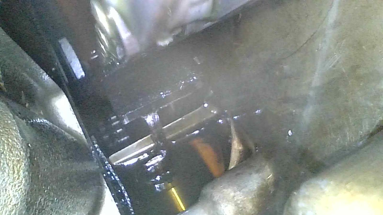

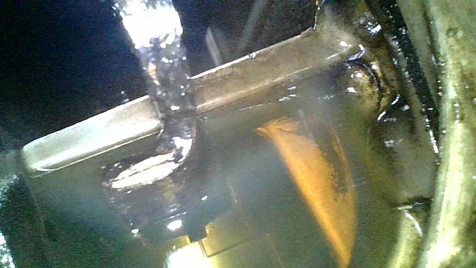

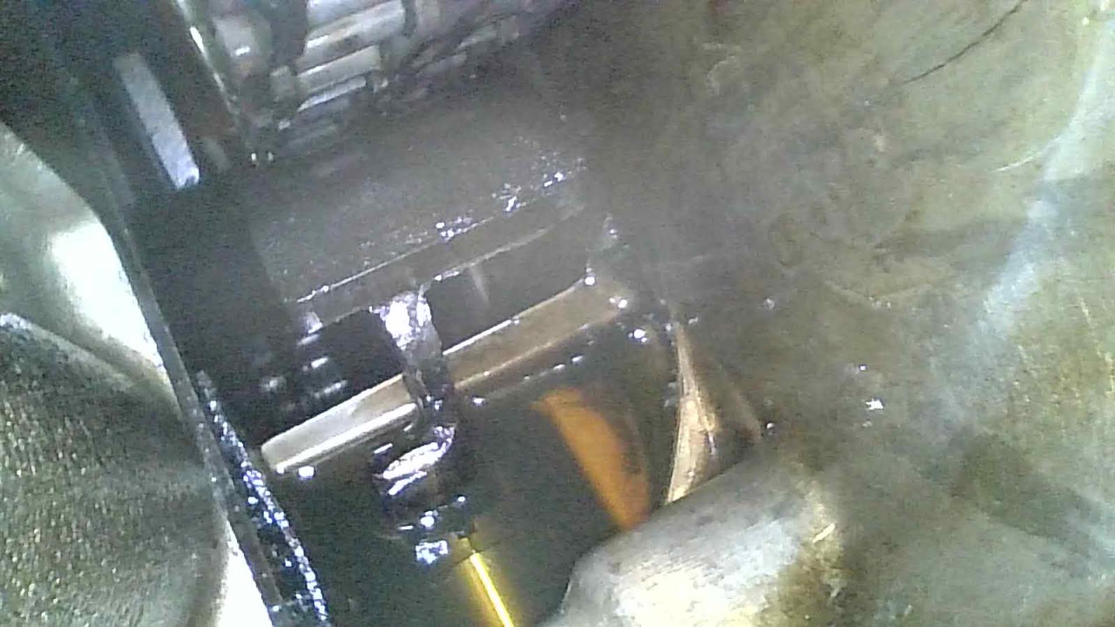

Hi Don - took some photos, not great resolution as bore scope maxed out here
I think my rail is different to yours?

Is the piece of rail that fits into the tensioner piston hitting or touching the aluminum wall of the timing cover? There should be at least 1-2mm there Is the chain stretched and what you are hearing is the tensioner rail hitting that wall? Had that happen on a 2002, same difference had other issues but ended up putting in a new chain and a much better cam gear
Thanks, Rick

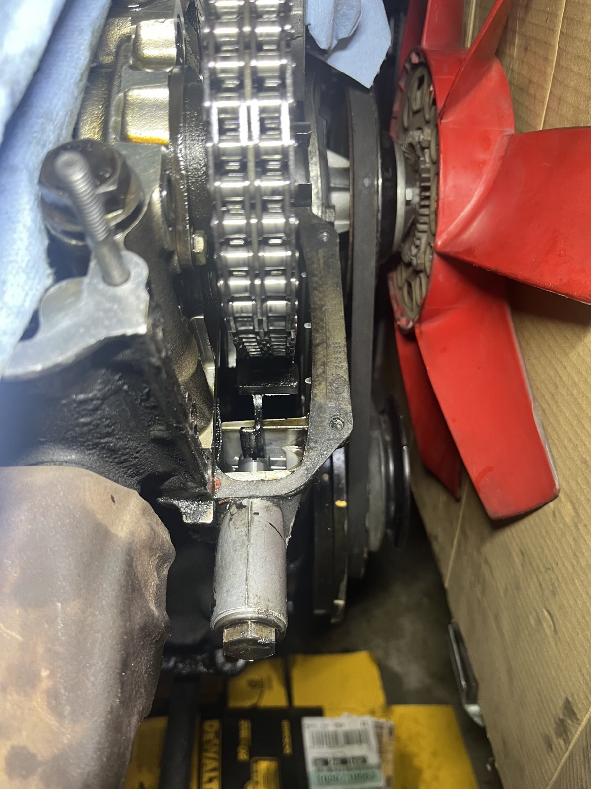

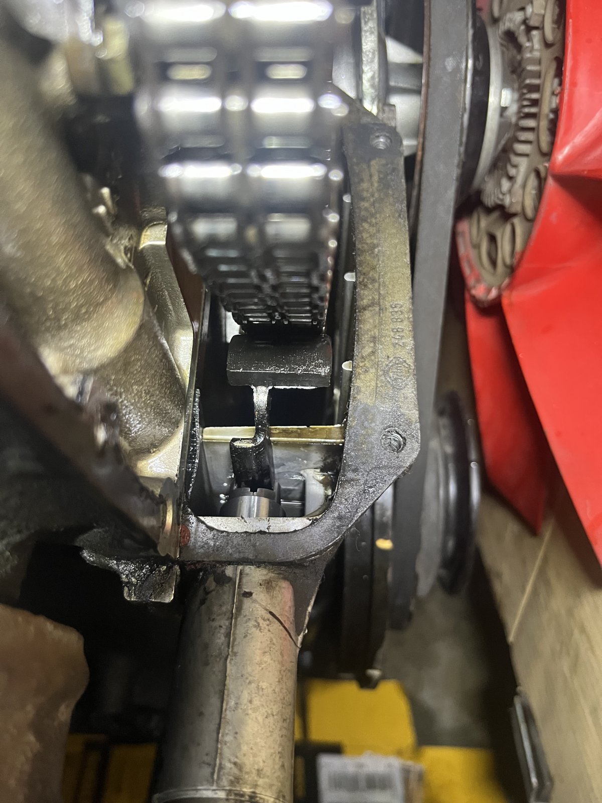

I don’t know what to say- do you have a cell phone you can use? I’m simply using an iPhone 11- nothing special. Your pictures are completely out of focus?
Is this an m30 engine? Can you take an in focus pic from a foot away or maybe 2 feet away? Your chain is a complete blur. please don’t take boroscope or close up pics- it’s defeating the purpose. Take an exact copy of the picture I posted from the same distance with a clean lens. Copy the 1st picture I posted exactly. Use a cell phone.

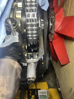

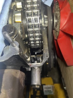

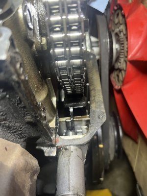

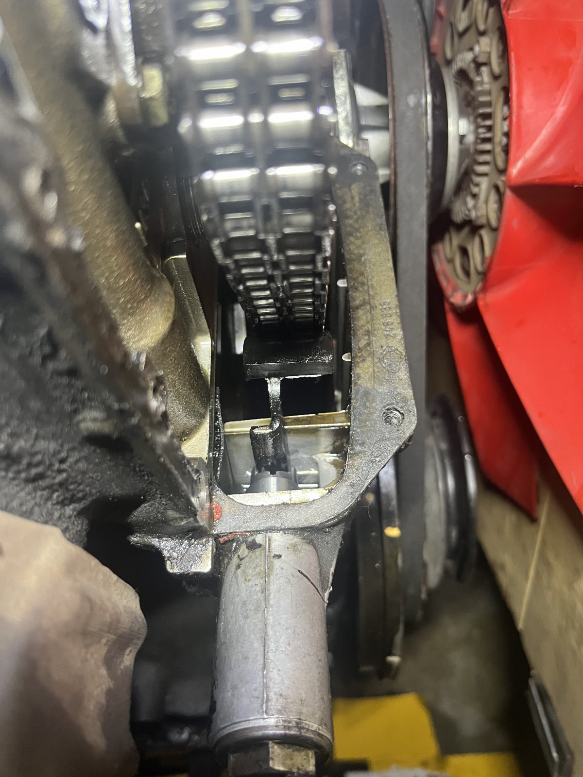

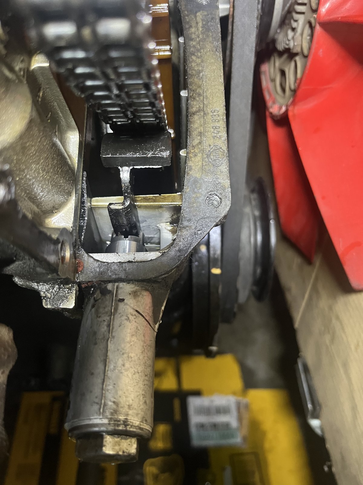

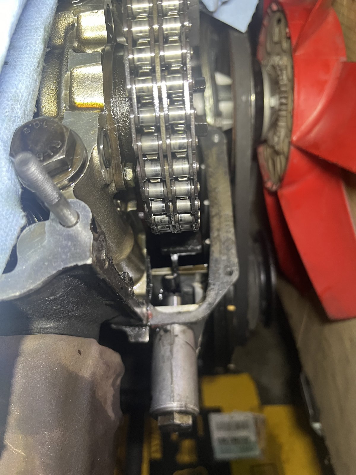

Are these better?

It appears to me that the tensioner may be touching the wall on the lower timing cover? Can you check this by using a large screwdriver in the spot I have marked?
The tensioner and tensioner piston should be very stiff and barely move.
Mine isn’t very stiff at all. But the small arm that slots into the tensioner piston does not touch the wall however hard I try to move away from the piston. from the video the “long side” of the tensioner does hit against the wall when you pull it towards the piston far enough.

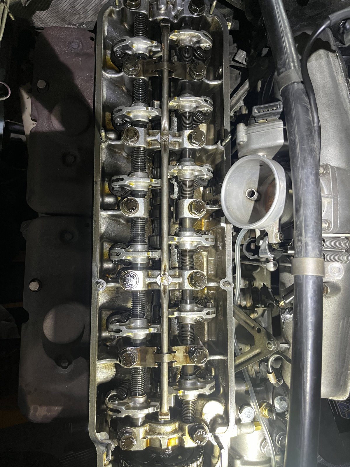

can you post a pic of top of head showing full position of oiler bar?
Grap the yellow plastic guide and verify it does not move.
