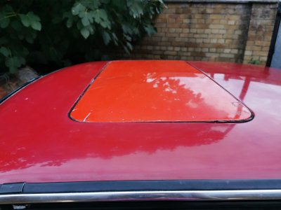

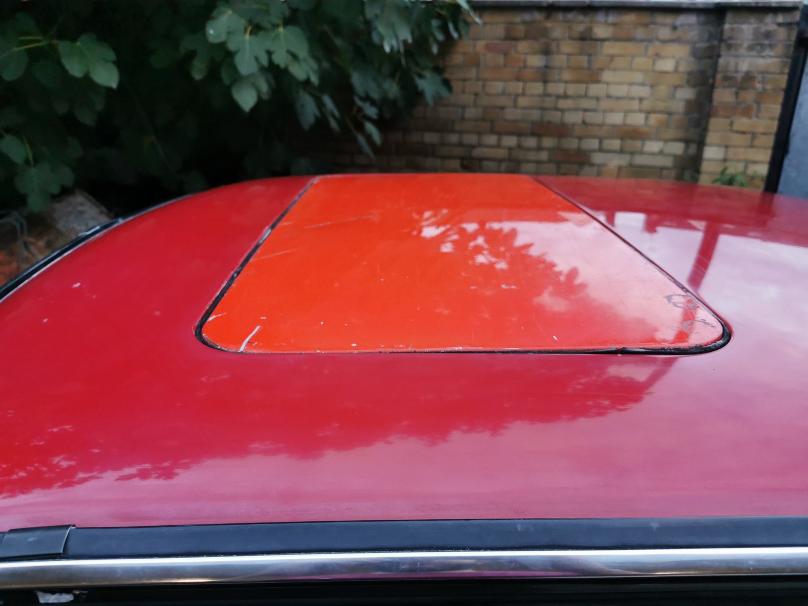

Some rust in the bottoms of both rear arches/sills as well as the tops, a few bubbles here and there elsewhere but nothing major. The usual rust under the rear lights too. The sunroof was completely toast. I presume that it was stored in a leaky garage, thankfully no damage was done to the interior. The zinnobar paint was very faded and generally, it just needed some love. Overall, a very solid base that, most importantly, hadn't seen a welder or any bodging.

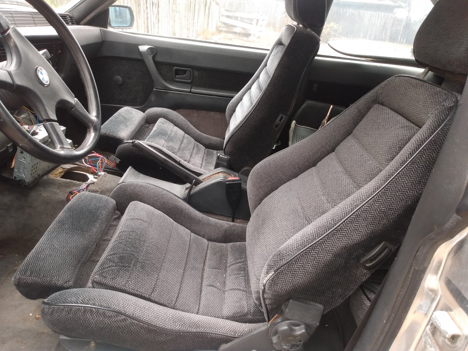

Nice seats, not torn but the leather was drier than Gandhis flip flop.

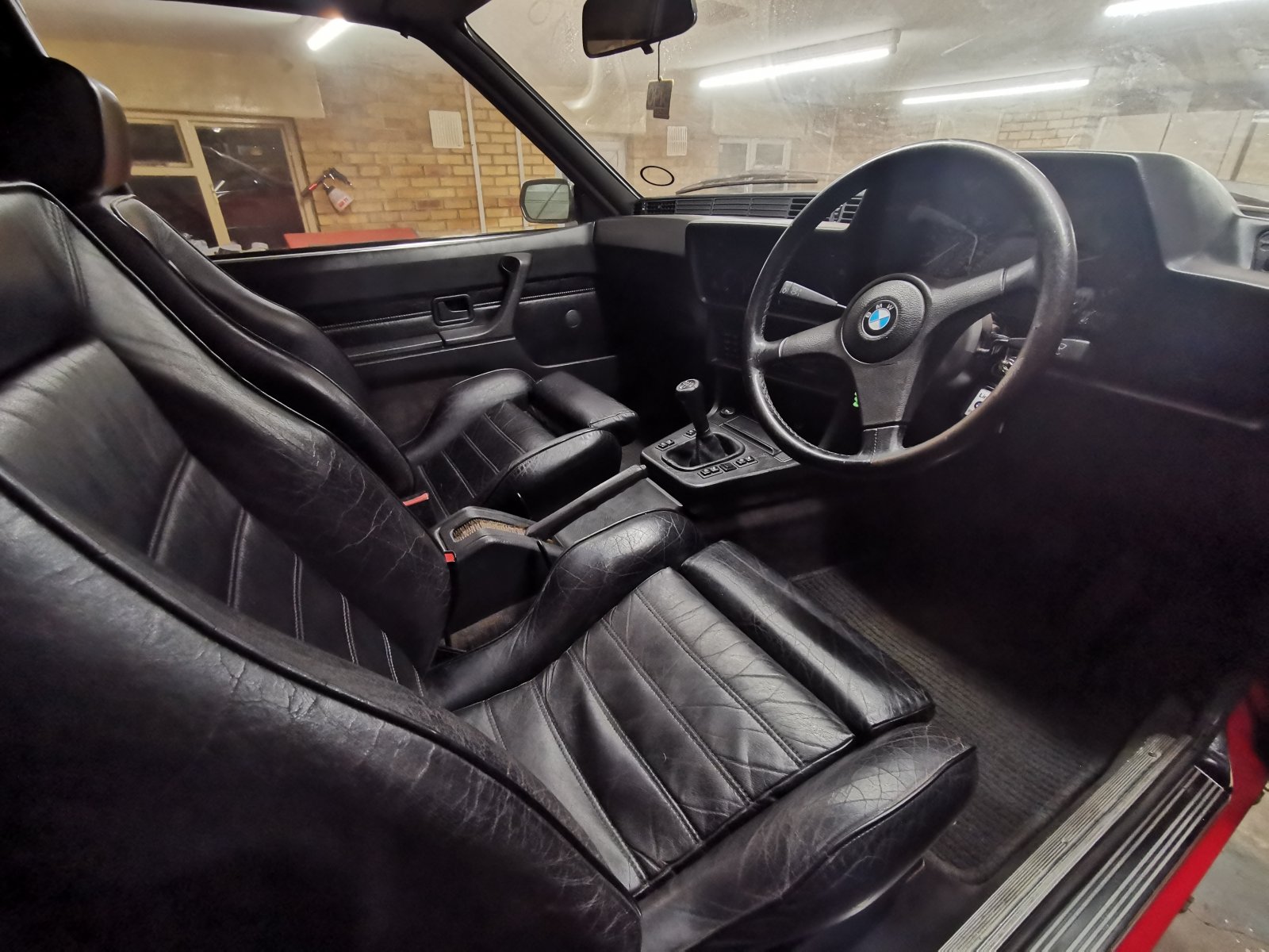

A few interior pieces were not fitted or loose, so got repaired what needed fixing (mostly damaged/broken mounting tabs) and fitted everything back into place. A new mirror switch and multiple coats of leather balm to try and get some suppleness and life back into the seats really made a difference. Also found the original floor mats in the back so fitted them back in after a good scrub

Correct me if I am wrong, but the Recaros or should I say, the seats from the OP, are standard and present in both my U.S. 88 M6 and 86 635.

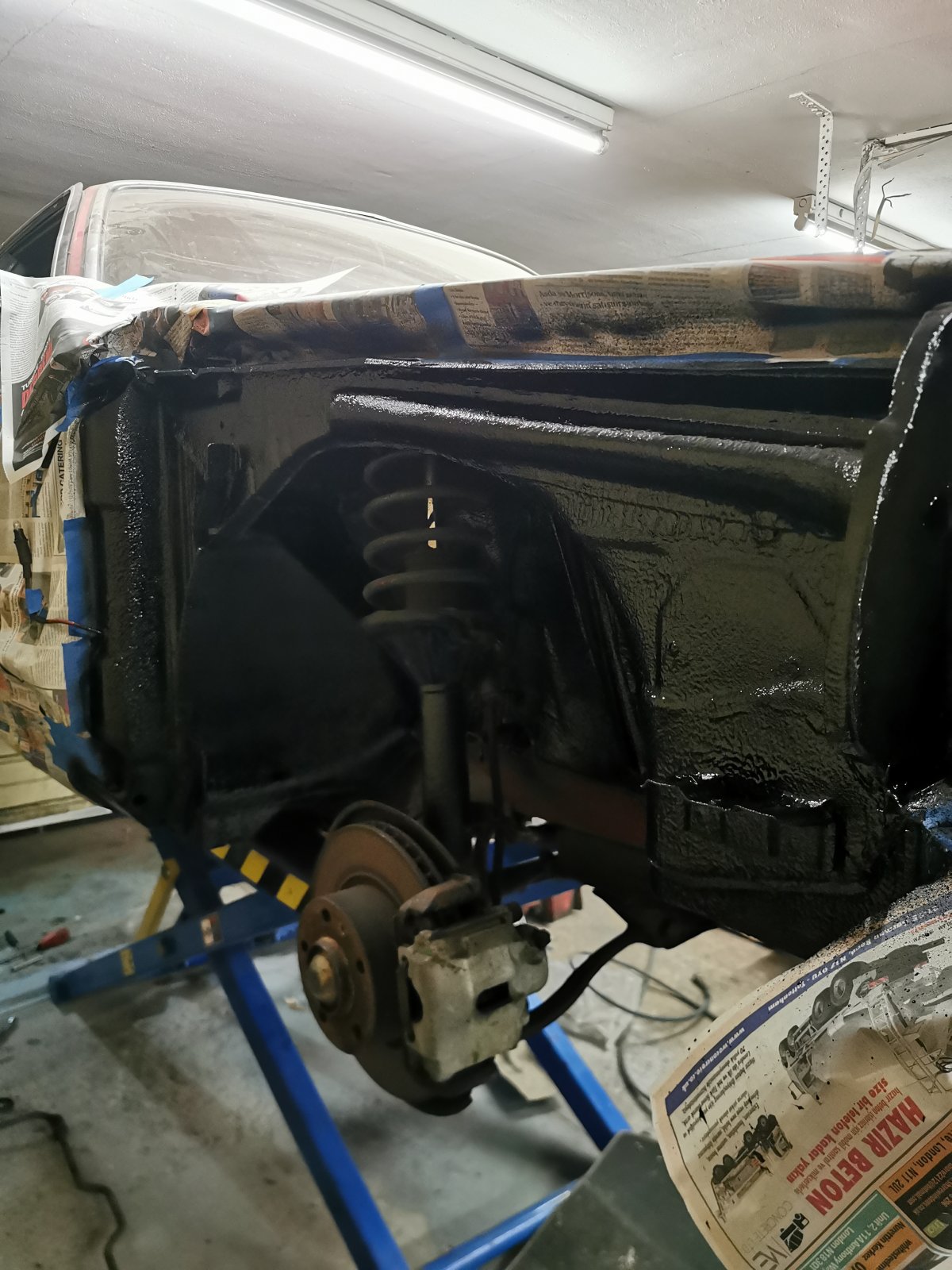

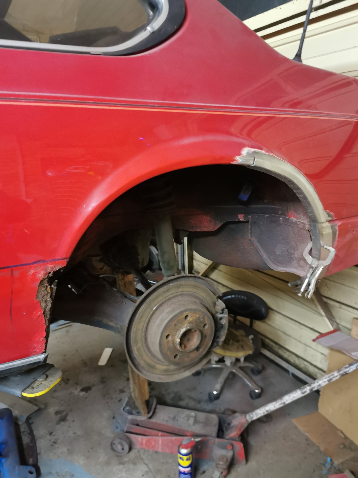

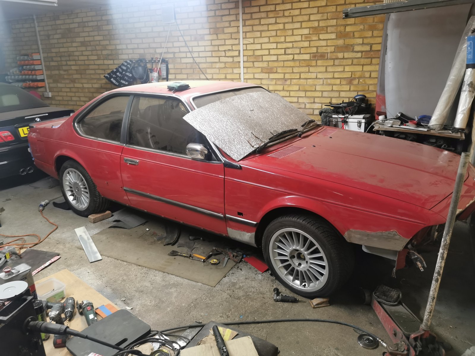

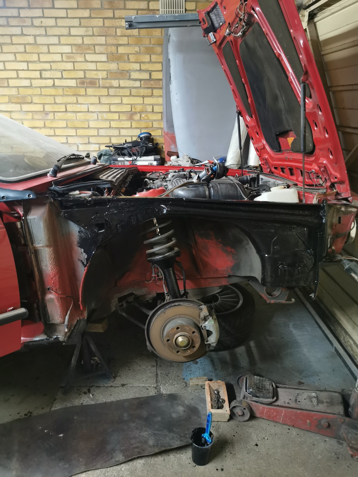

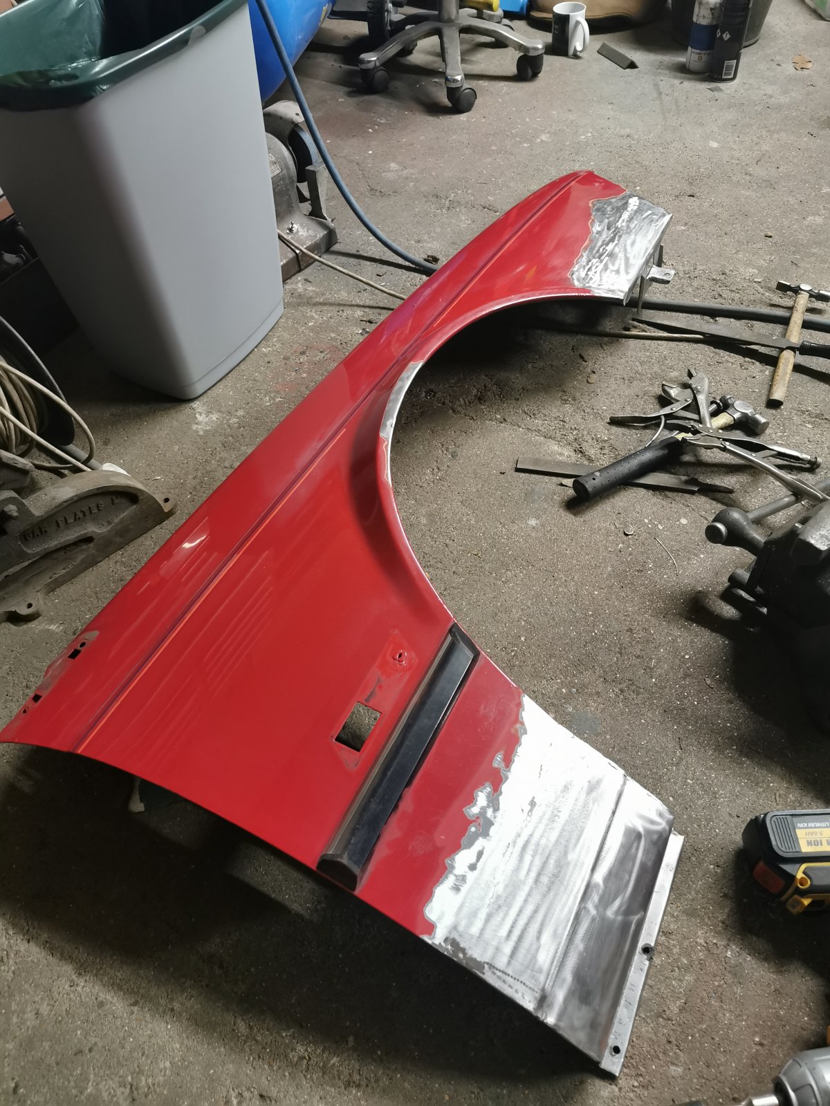

Fiddling about with the RH wing uncovered some crustiness. Wing had to come off for the usual E24 rot. This wasn't expected, and took some more time than expected due to it being a more complicated beast than the e9s inner wings and coupled with the unavailability of repair panels. Followed the same process as the E9 with healthy doeses of epoxy and seam sealer, followed by 3M undercoat

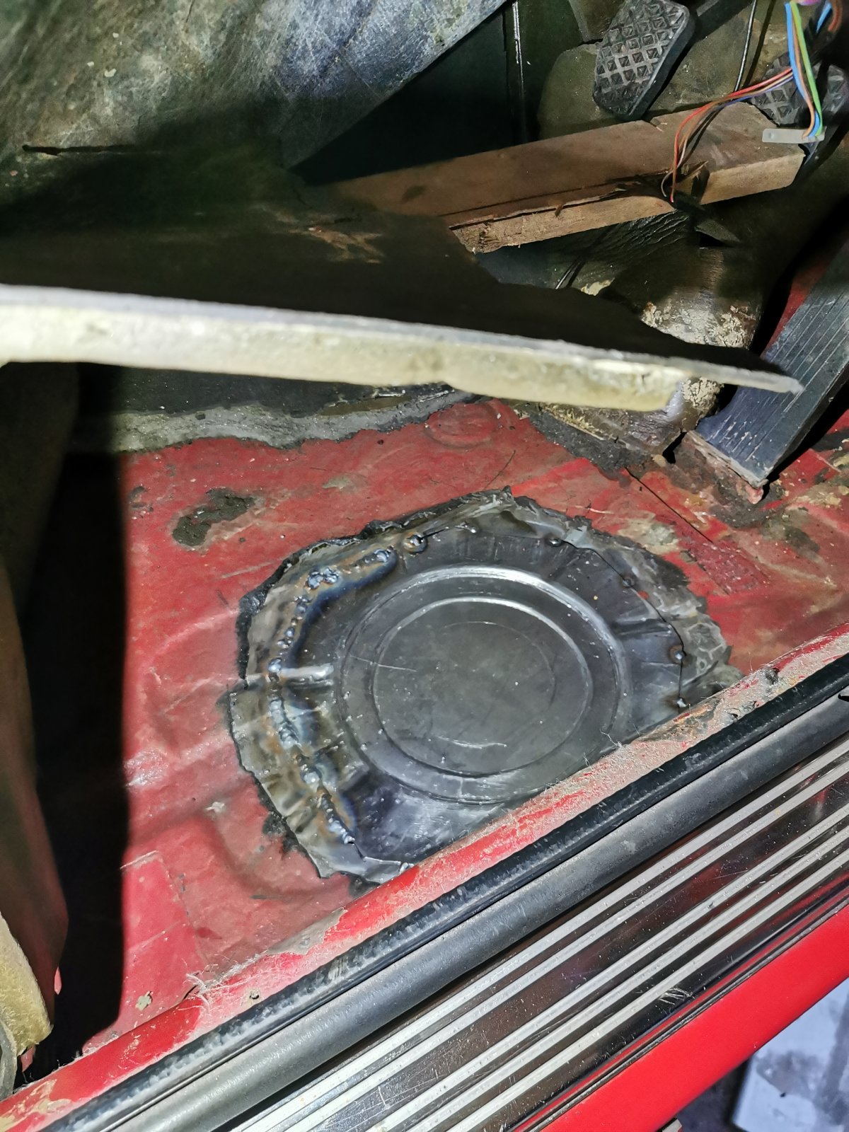

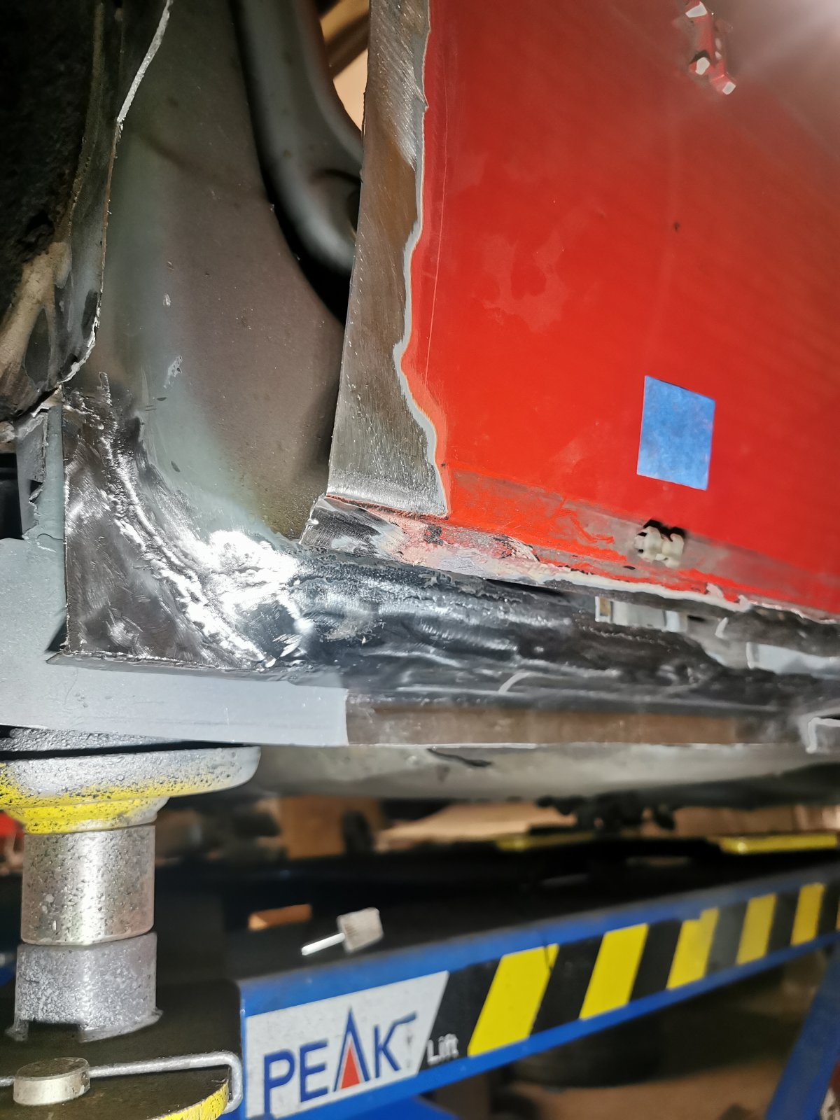

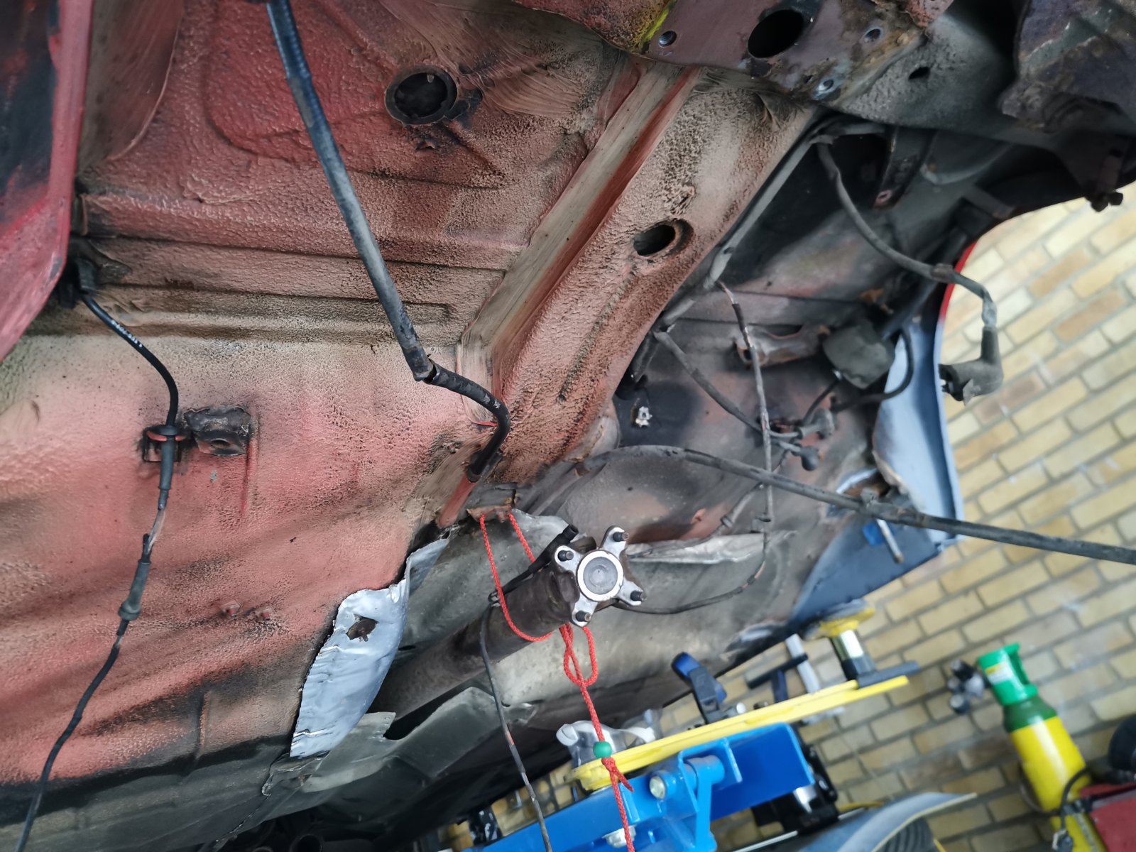

Rear sill sections needed work. Axle out and new fuel and brake lines will be getting installed

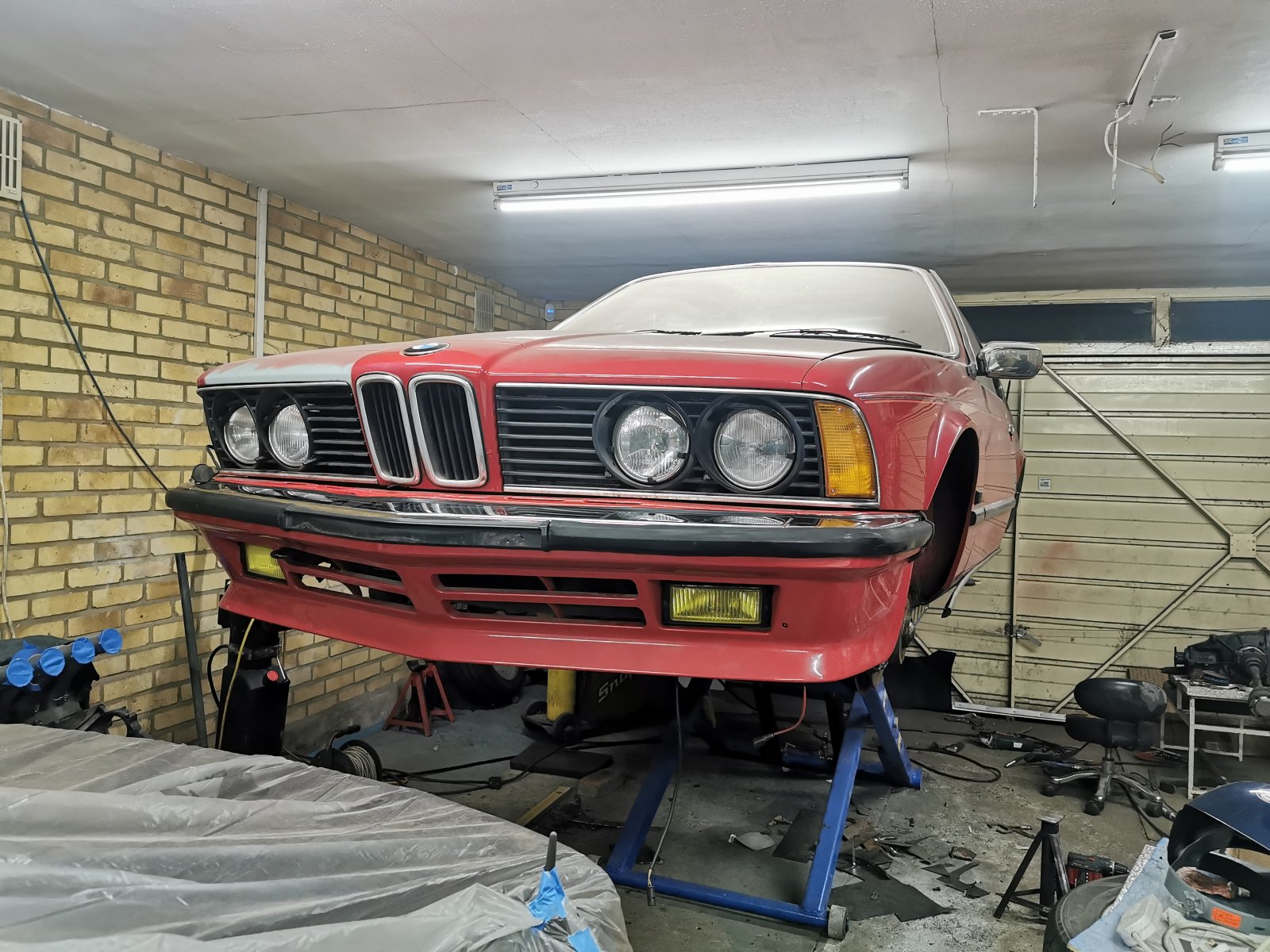

Front bumper centre section is rather badly repaired and fillered, in future I will get a new centre section (both corners are new) but want to try and kerb the project creep as much as possible for now. New centre and corner chromes as well as a new foglight to replace the damaged one.
Did you swap out the fog lights for rare amber ones or is that just the photo? Original photo seems to show clear fog lights.
Good eye. 1 of the fog lights was brand new so I got another new one, as they are so susceptible to stone chips and cracking I covered them with yellow laminX to help prevent it.

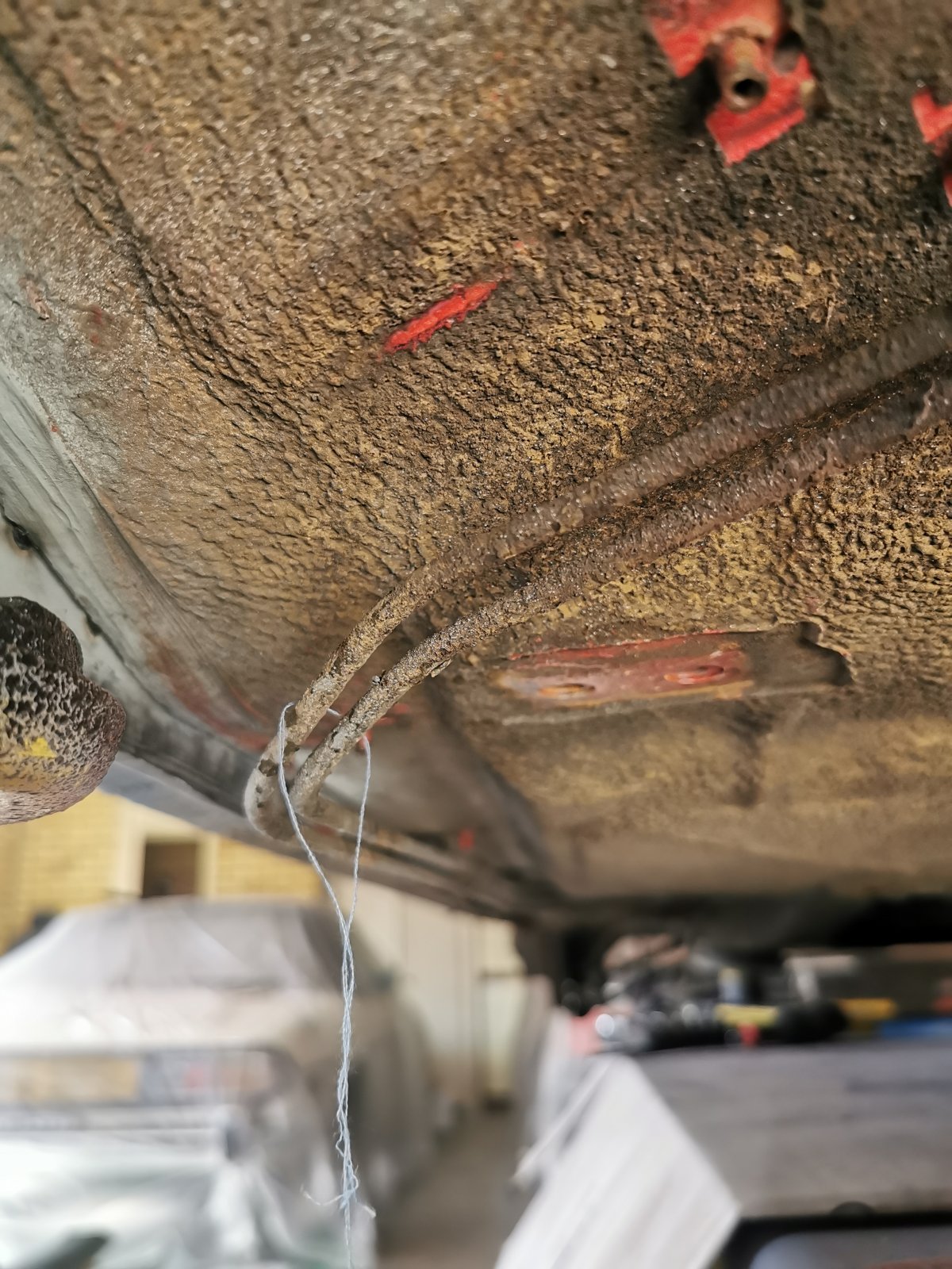

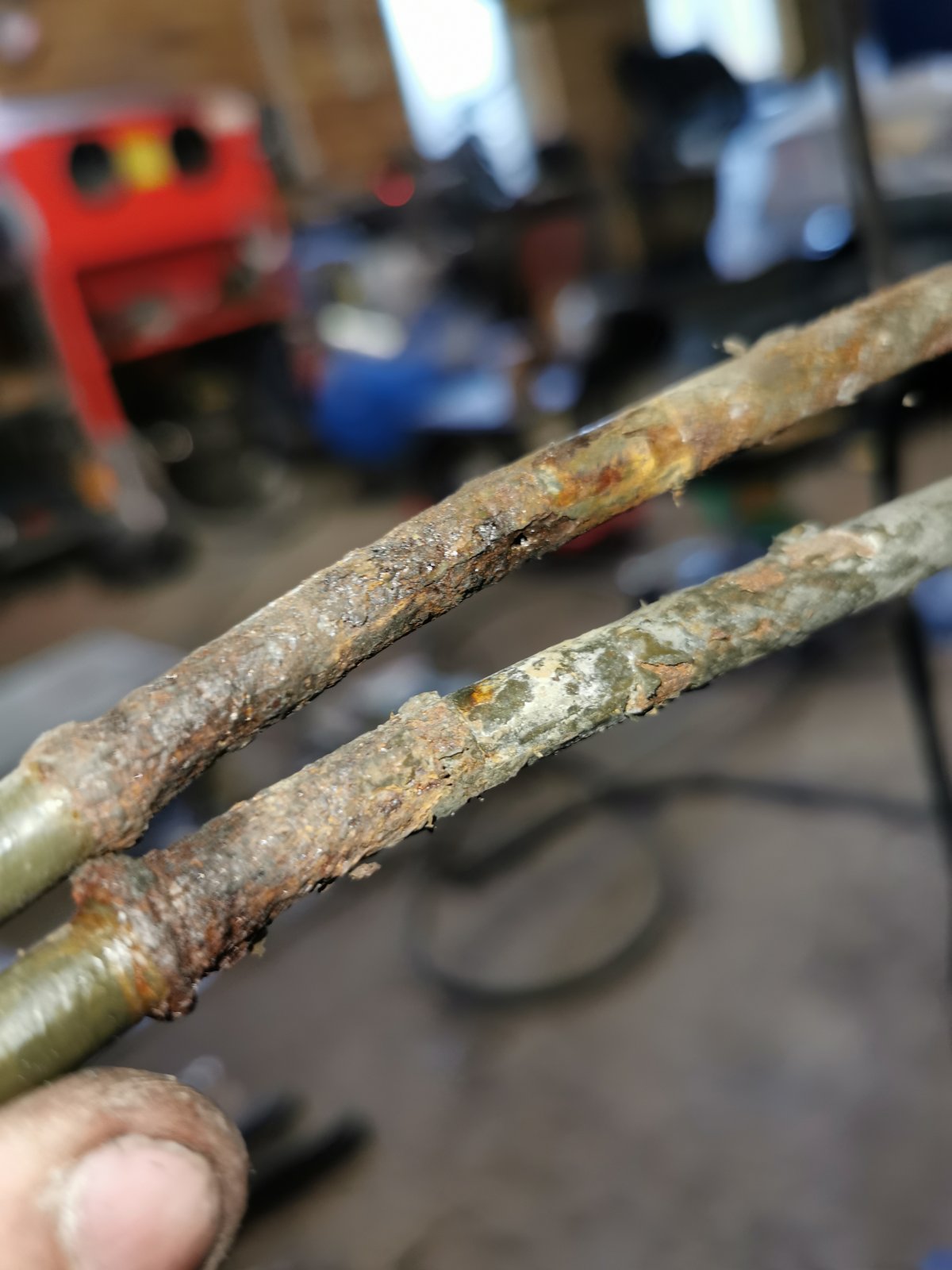

A reminder for everyone to check their fuel lines. These weren't leaking but after brushing some of the crust of I could see pin holes. As the rear beam is out all the brake and fuel lines are being renewed.
Spent a rather considerable amount of time so far underneath cleaning the dirt and mud off and getting to the original finish. It only needs a few touch ups in places.

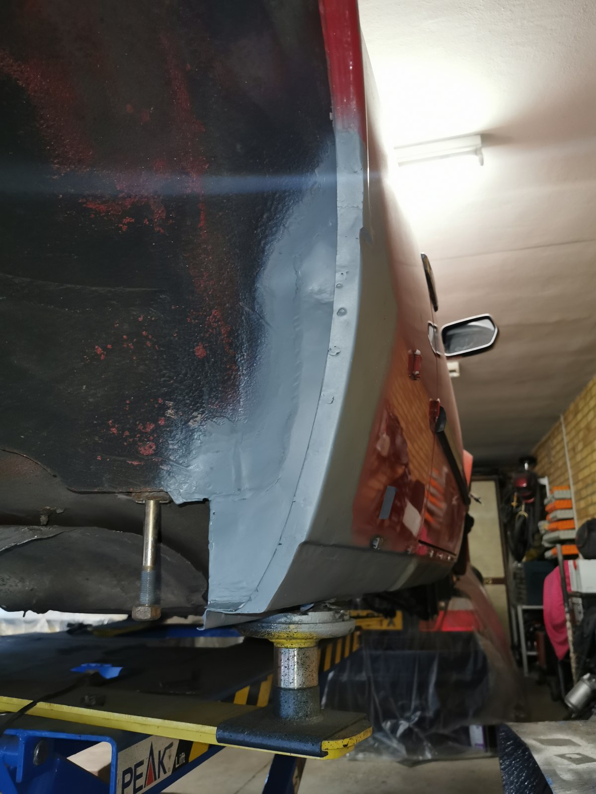

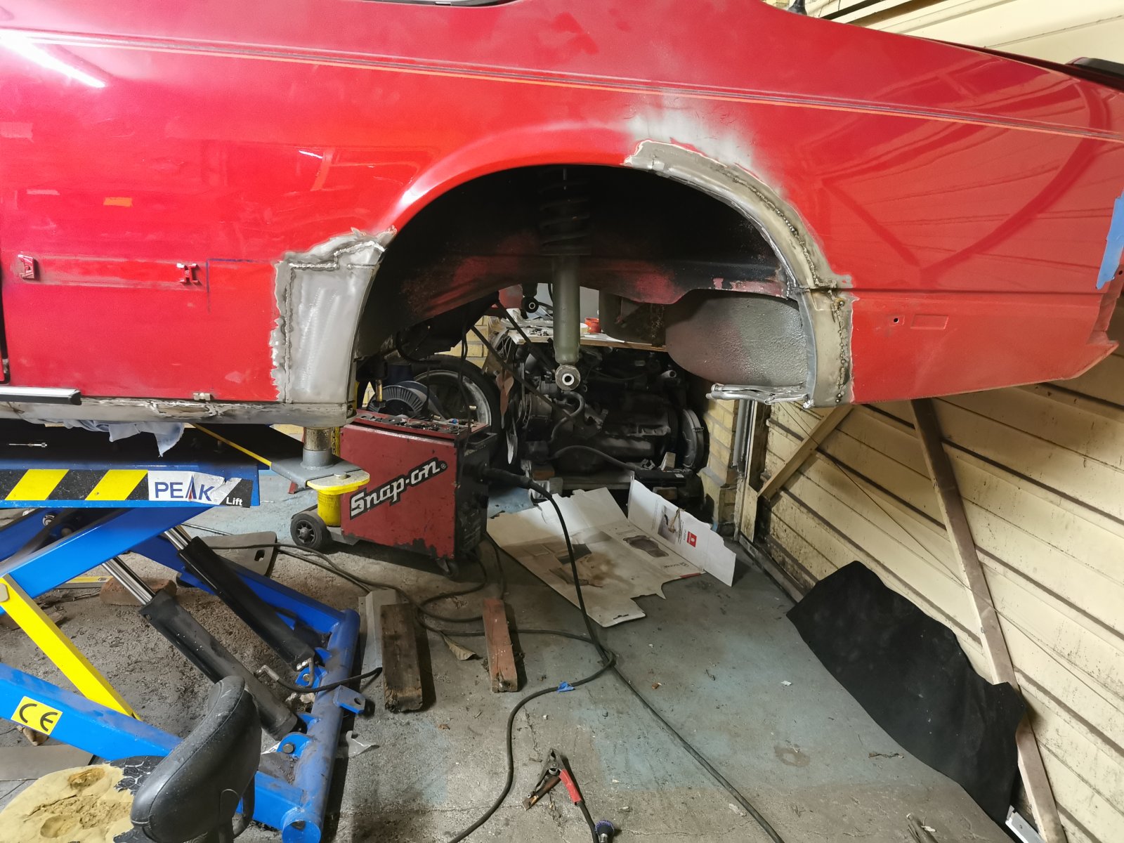

Welding finished up on the drivers sill and arch

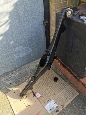

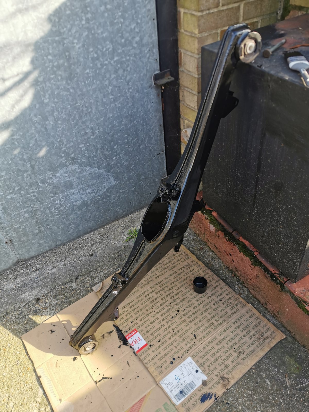

Let us know how the bushes come out of the trailing arms, suppose to be near impossible even with a press.
There are videos of people torching them out, black smoke, crazy. I had strange tire wear and went to a Turner Motorsport cars and coffee, they pointed out my subframe bushings were shot, I think these are often overlooked.
Honestly? Had them out in about a minute flat per side with the hydraulic press at work. New ones went straight in. Sand blasted the beam best I could and have slapped on a healthy coat of POR15. I love this stuff but be warned, it'll stay on your skin for at least 1 or 2 weeks!

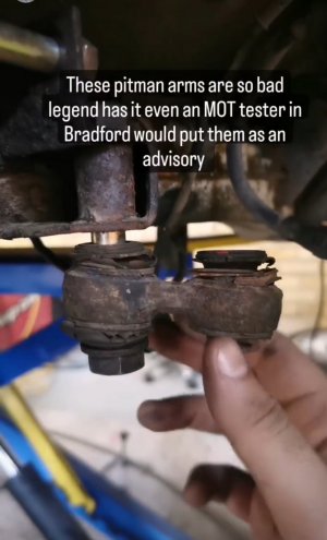

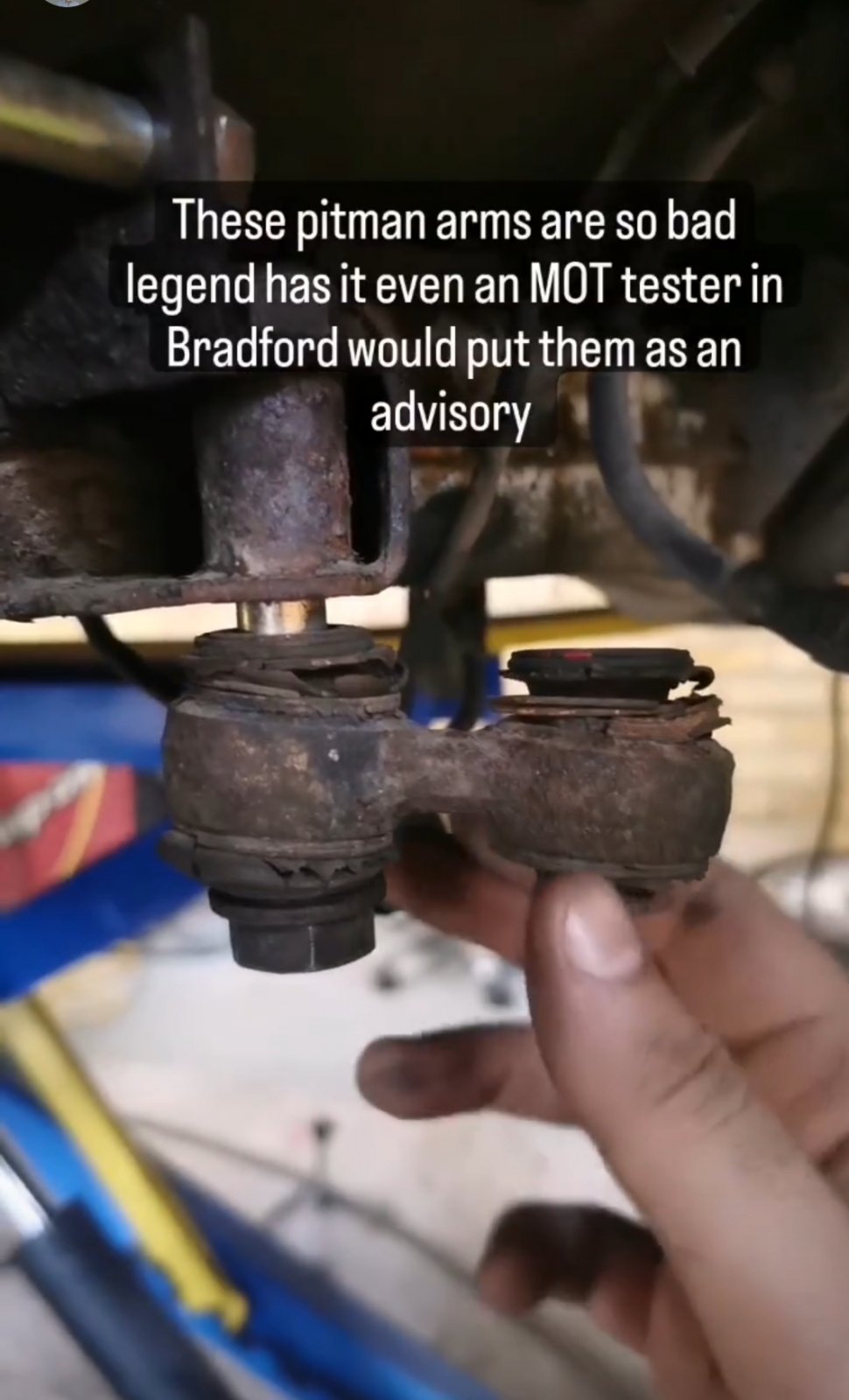

And as for the pitman arms, fairly certain driving on the road with these would have resulted in some "interesting" handling characteristics
