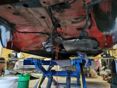

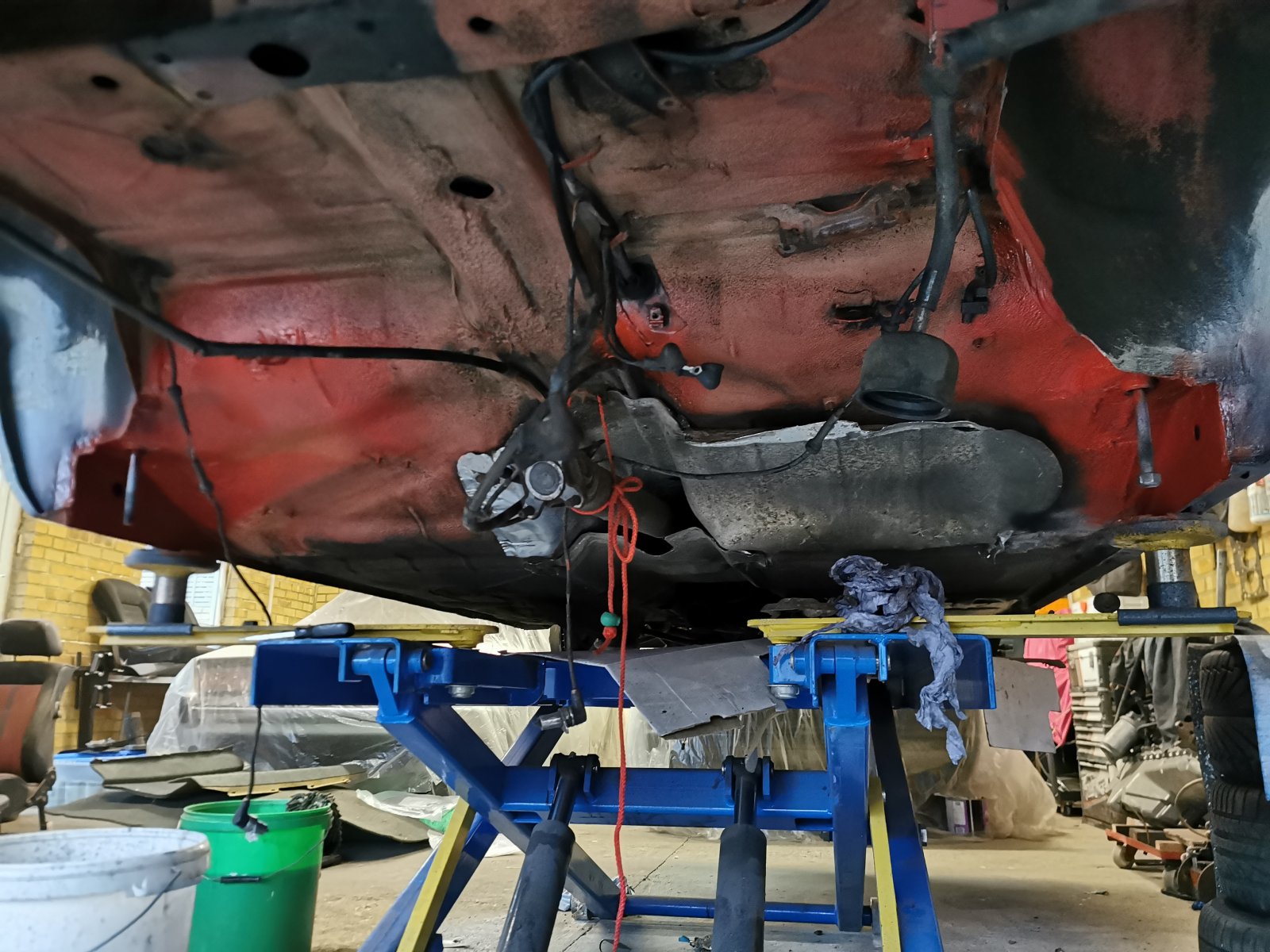

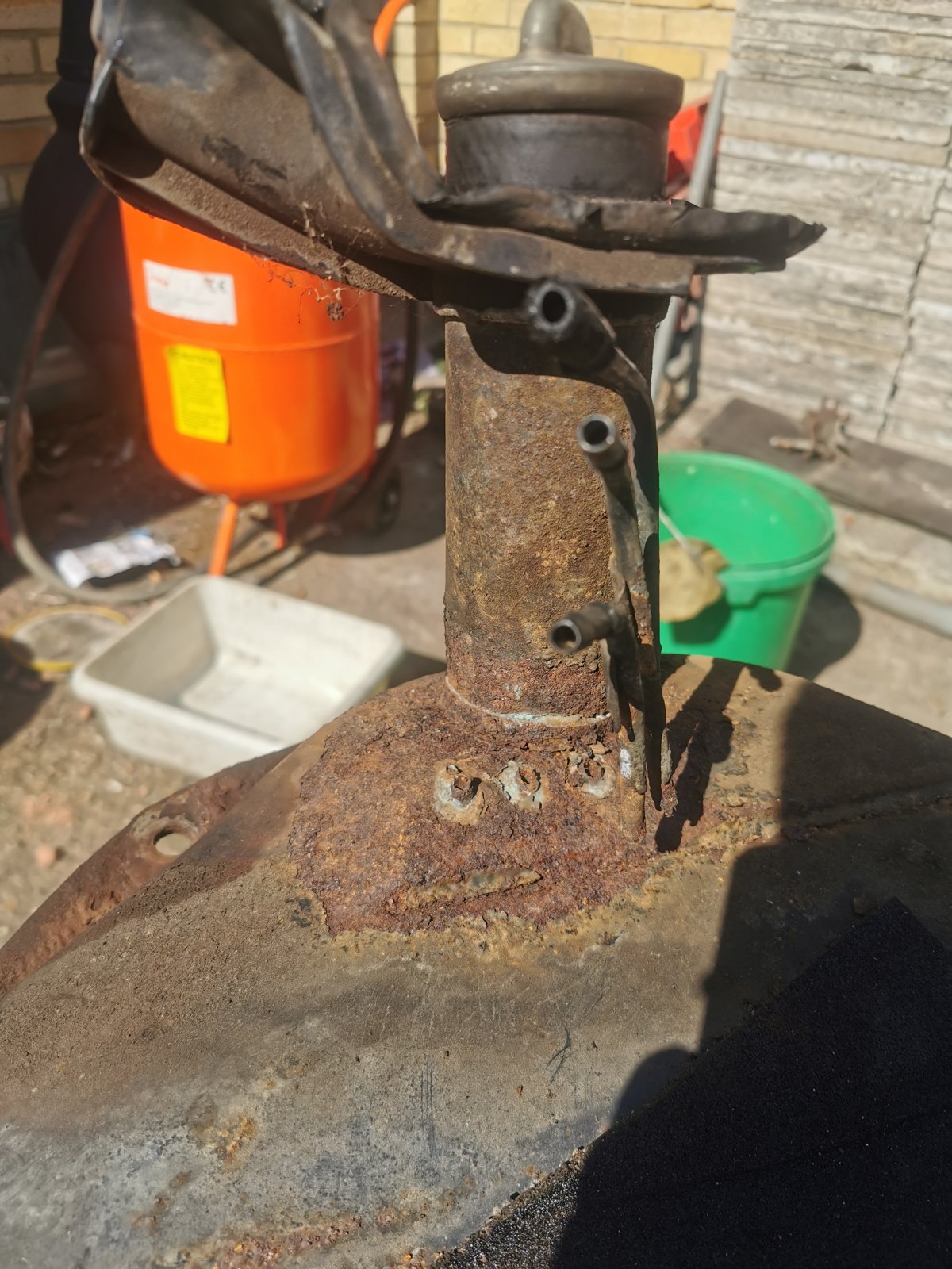

Dropped the fuel tank out as it is definitely past it's sell by date... Cleaned the underside up a touch more. In the process of making new fuel and brake lines but sods law my flaring tool has given up the ghost on the last fuel line. Need to sort that before everything else can go in but in the mean time a touch more welding left to go to keep busy. Hopefully this time next week car is back on the ground

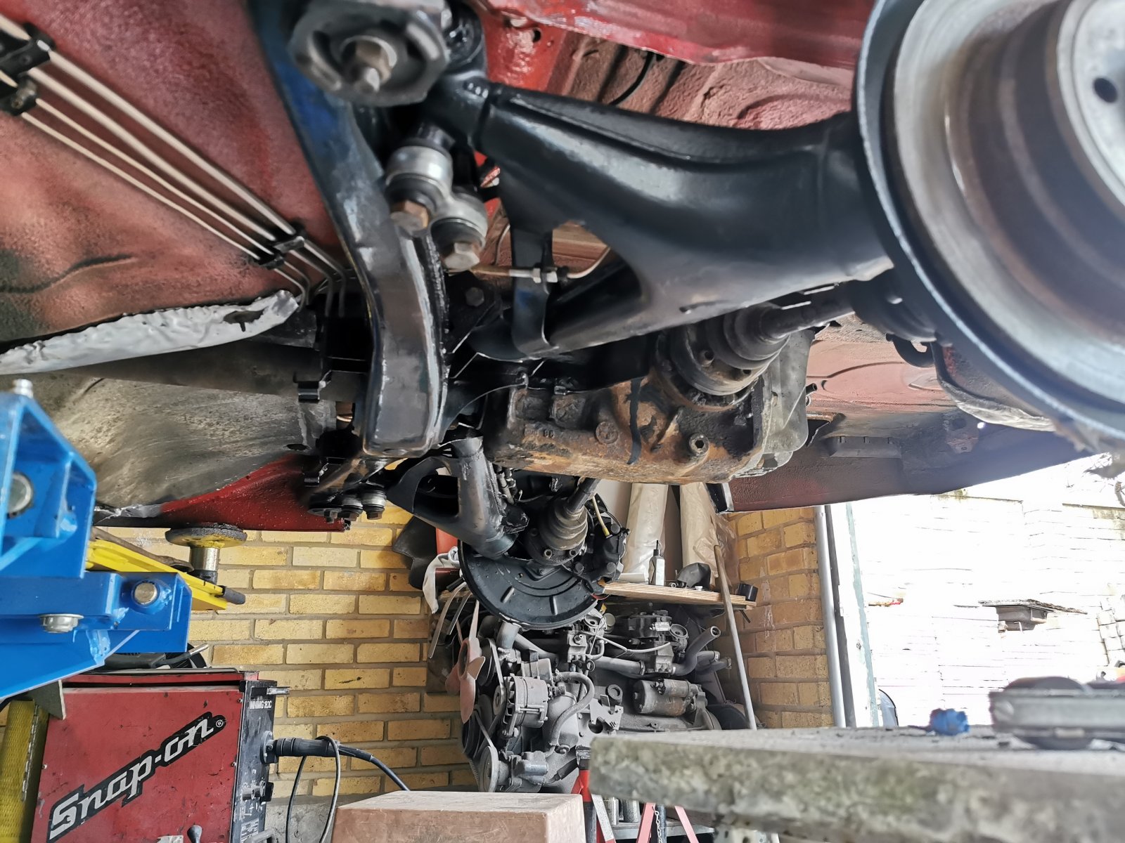

Kunifer brake and fuel lines all in. Braided brake hoses and gave the subframe and arms a tart up with some POR 15. New pitman arms,diff mount, trailing arm and subframe bushes. Few bits of paint to touch up under the diff and also clean up round the arb mounts on the body before that gets bolted back on.

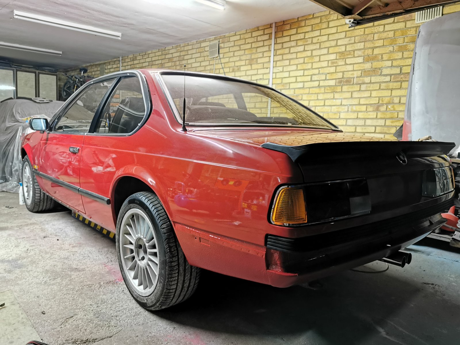

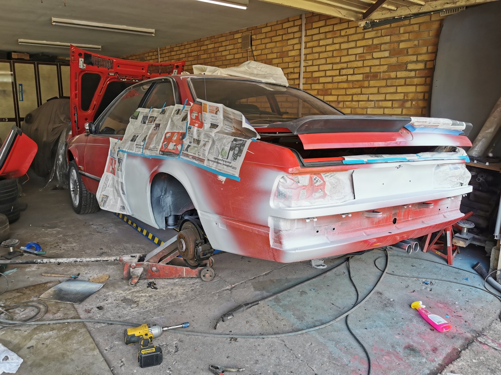

Exhaust repaired and a new tank back on and car running. Most filler work done, hopefully can throw some paint down over the next few days. Won't be mint but usable enough to enjoy for the summer and come next year can have a proper glass out respray

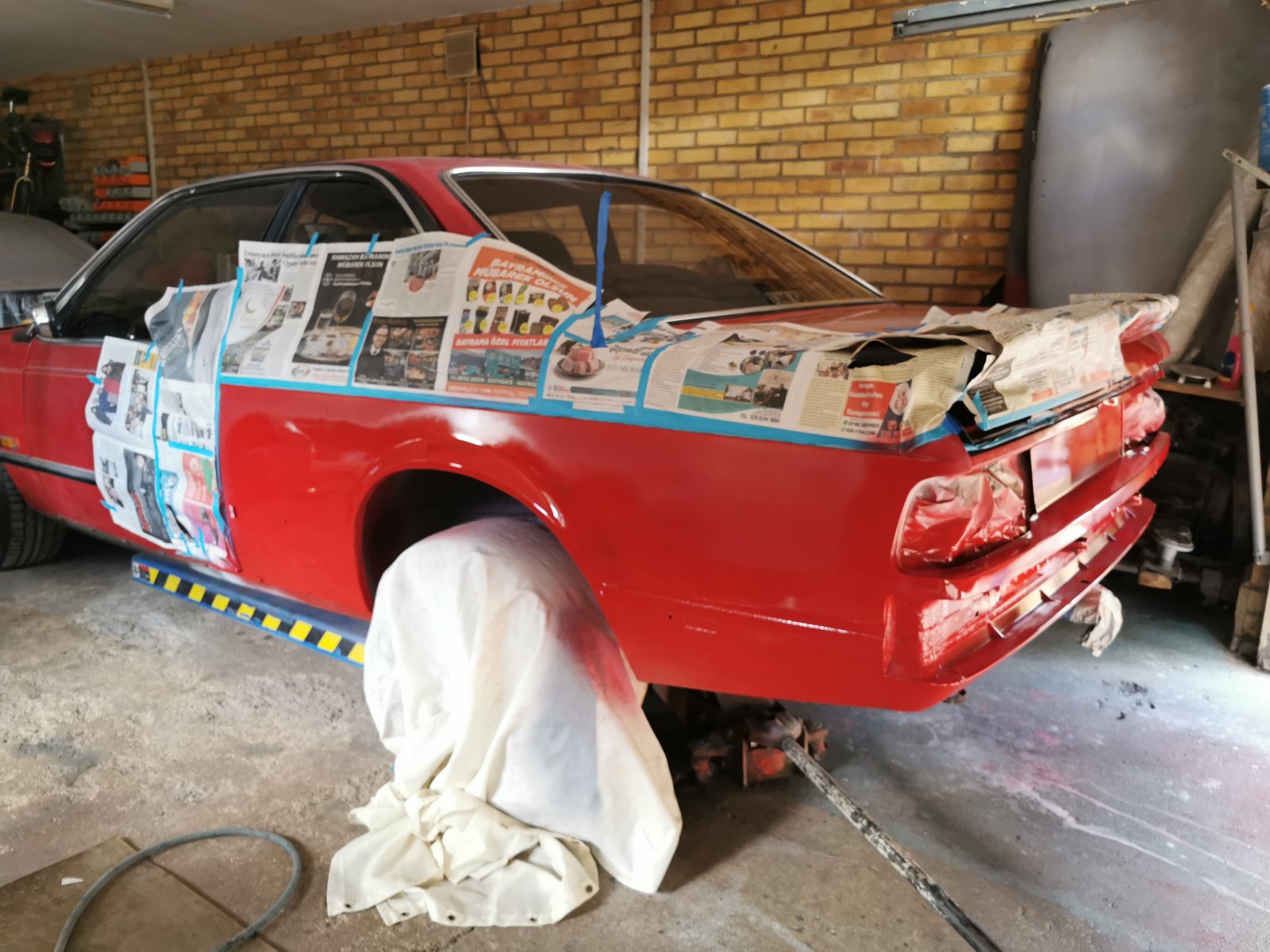

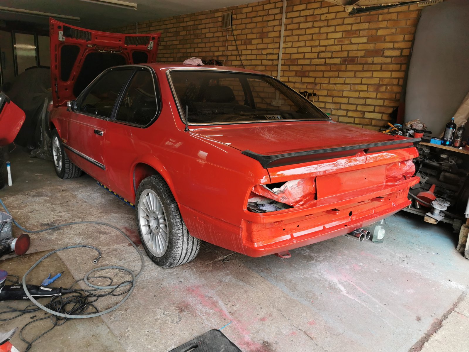

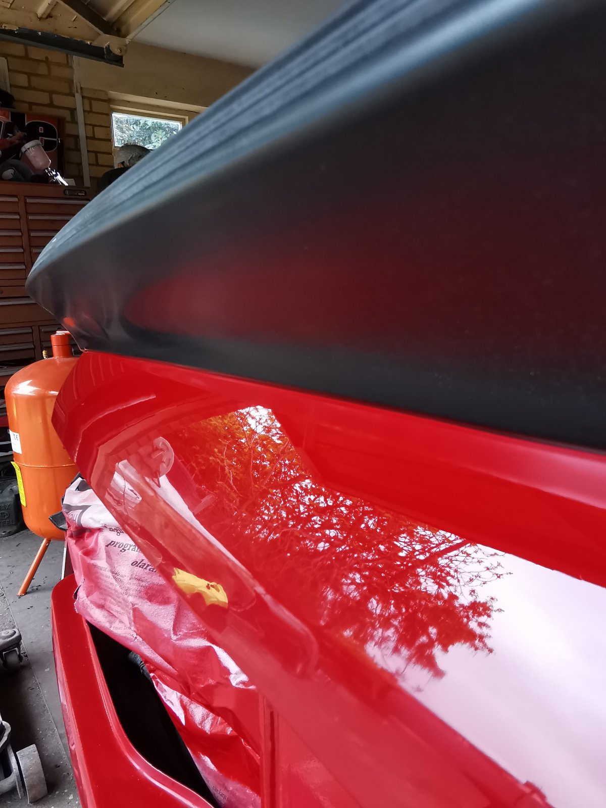

Paint went down last night, for a quick tart up (just to keep me going until time/funds allow for a full respray) this has actually come out lovely
Flatted it down a touch, considering how faded the paint was on there it's really not matched too badly, although I did hit it with some 2000 grit to help remove some of that old oxidised paint.
Fuelled by some plenty of Turkish pizzas made some decent progress this afternoon and finally this is starting to look once again like a car

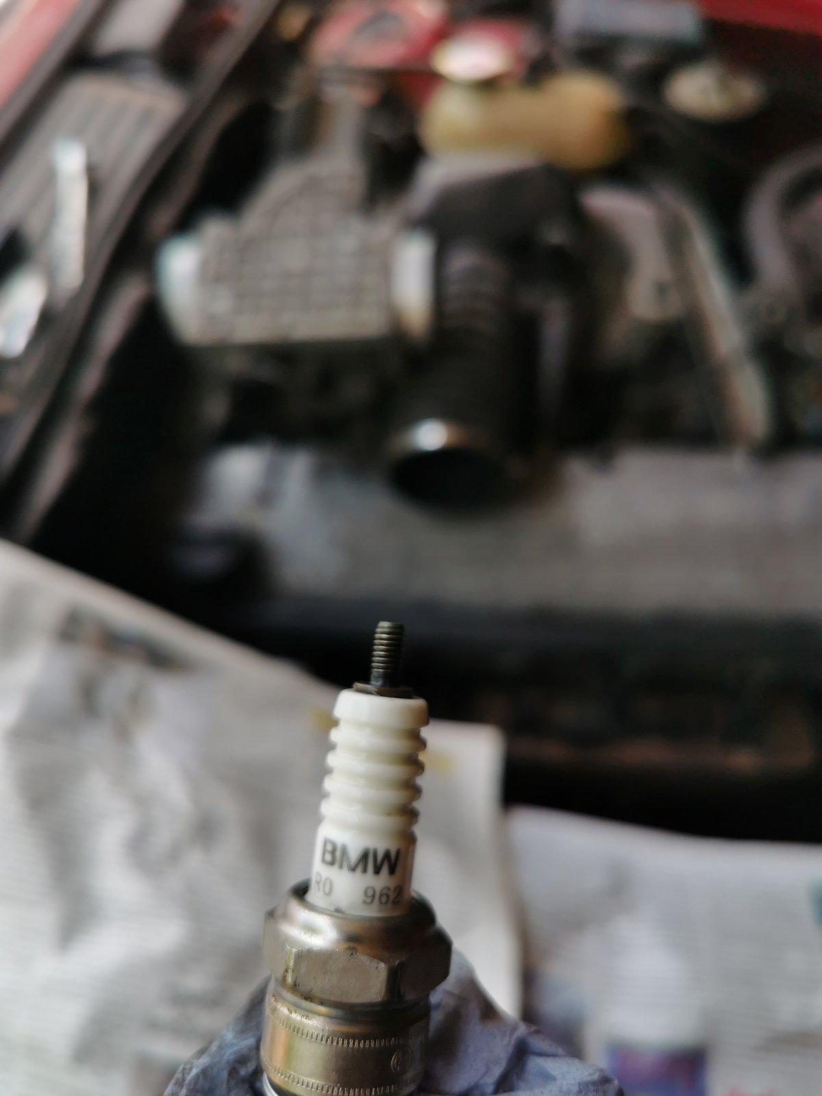

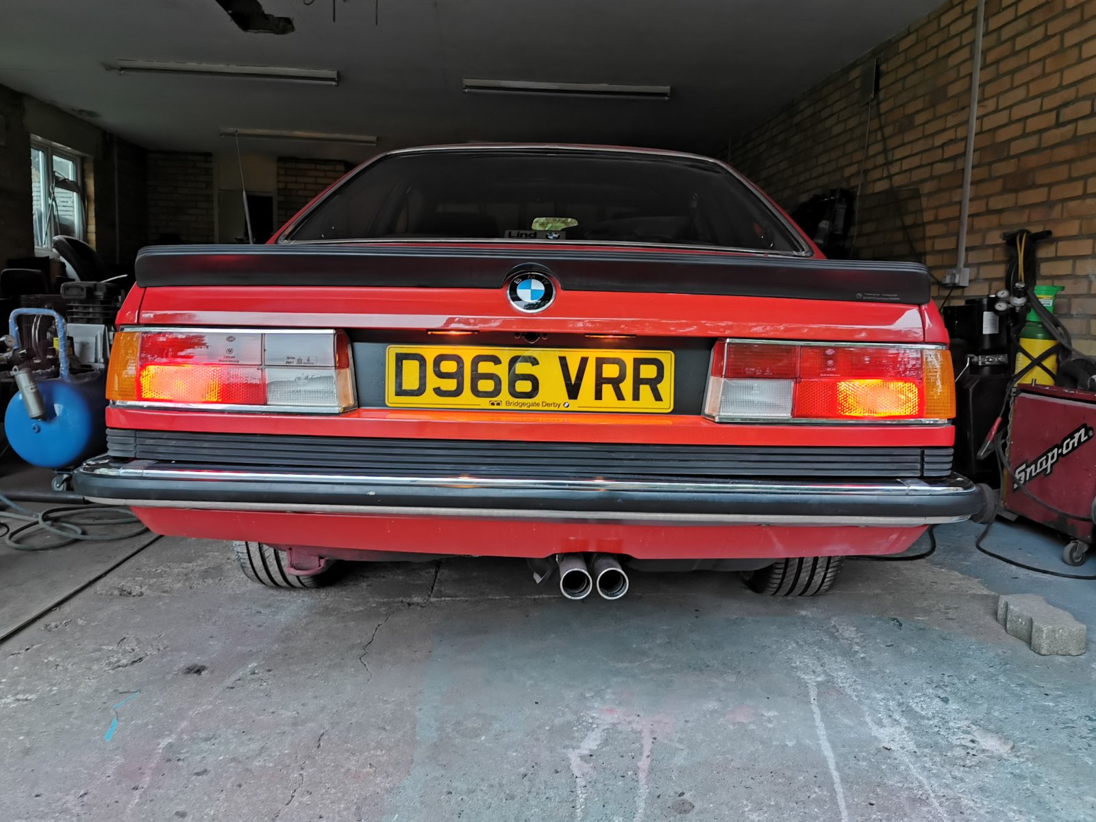

New WR8DCs, these plugs were installed during it's last major service way back in 1999.

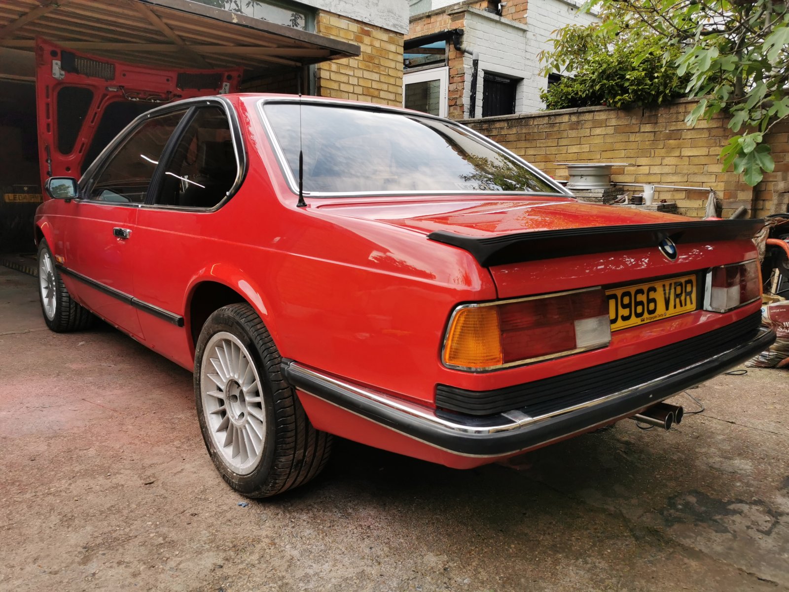

Rear bumper on, also painted up the license plate surround and original dealer plates (lind sticker as it was serviced there from 88-2000, it was originally supplied by Bridgegate, now Stratstone BMW)
Interestingly the bumper, rubbers and all clips etc seem to have been fitted just before it was parked up as it is almost like new with stickers still on, so cleaned up and liberal coatings of bilt hamber UC inside to help with corrosion.
