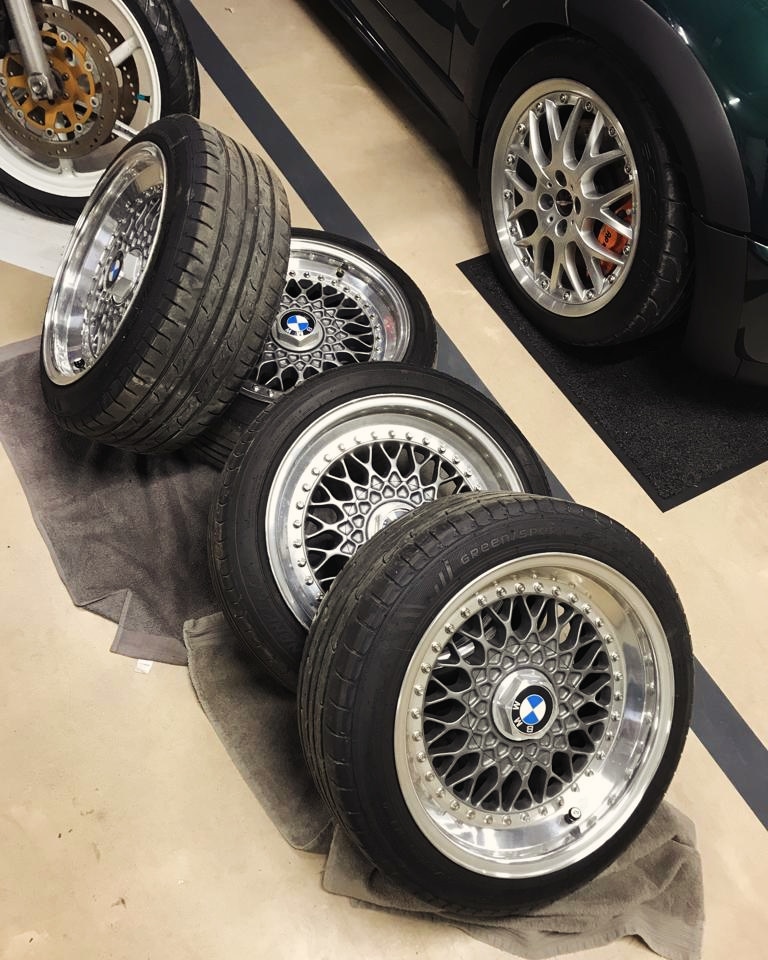

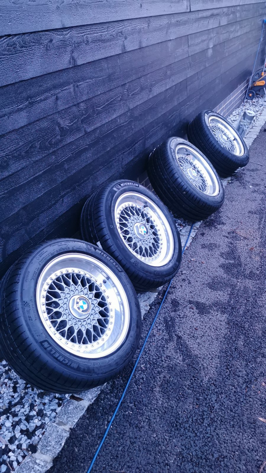

To help get some love back, a good friend decided to sort me out with this RS005/RS021s, which would have been original fitment for the car back in the 80s. Will get some decent rubber on the and next on the list is to replace the master cylinder which binds when hot, also need to stick an exhaust on there and should I get time, replace the currently bypassed heater core
205 55 and 225 50 16 Michelin pilot sport 4s. Wheels are 1986 date stamped and really look the part on the car

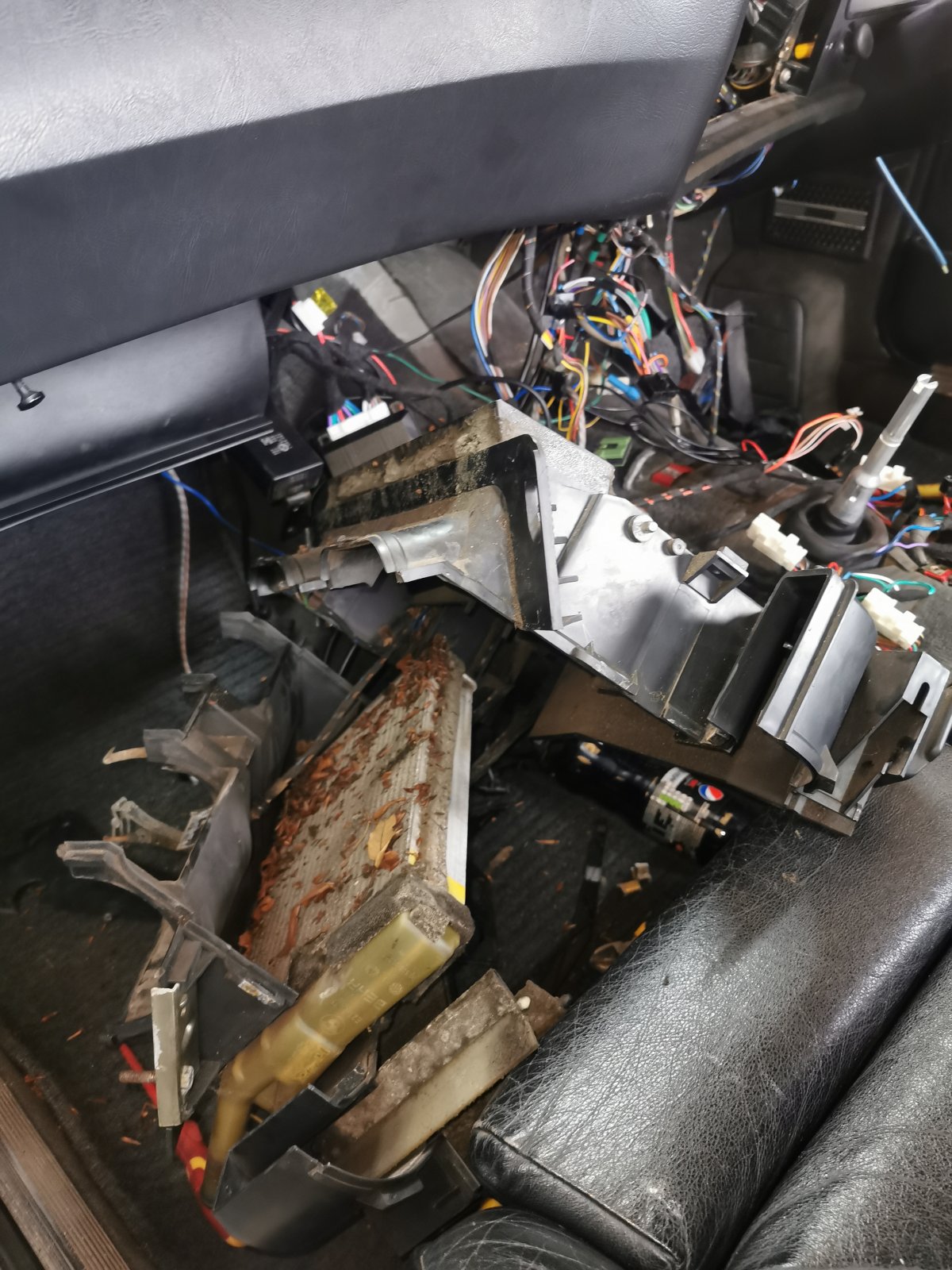

I really, really hate doing heater matrices
Now have a functioning heater and master cylinder. Will redye the leather and give the interior some love then fit a new fritz Bits exhaust but she is ready again for the spring!

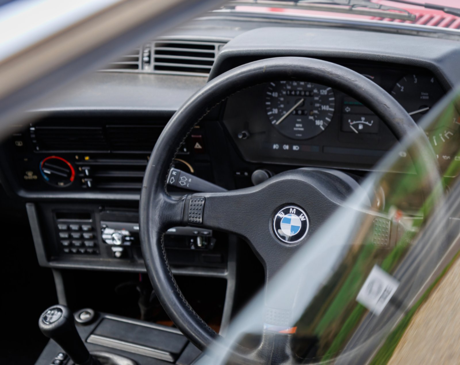

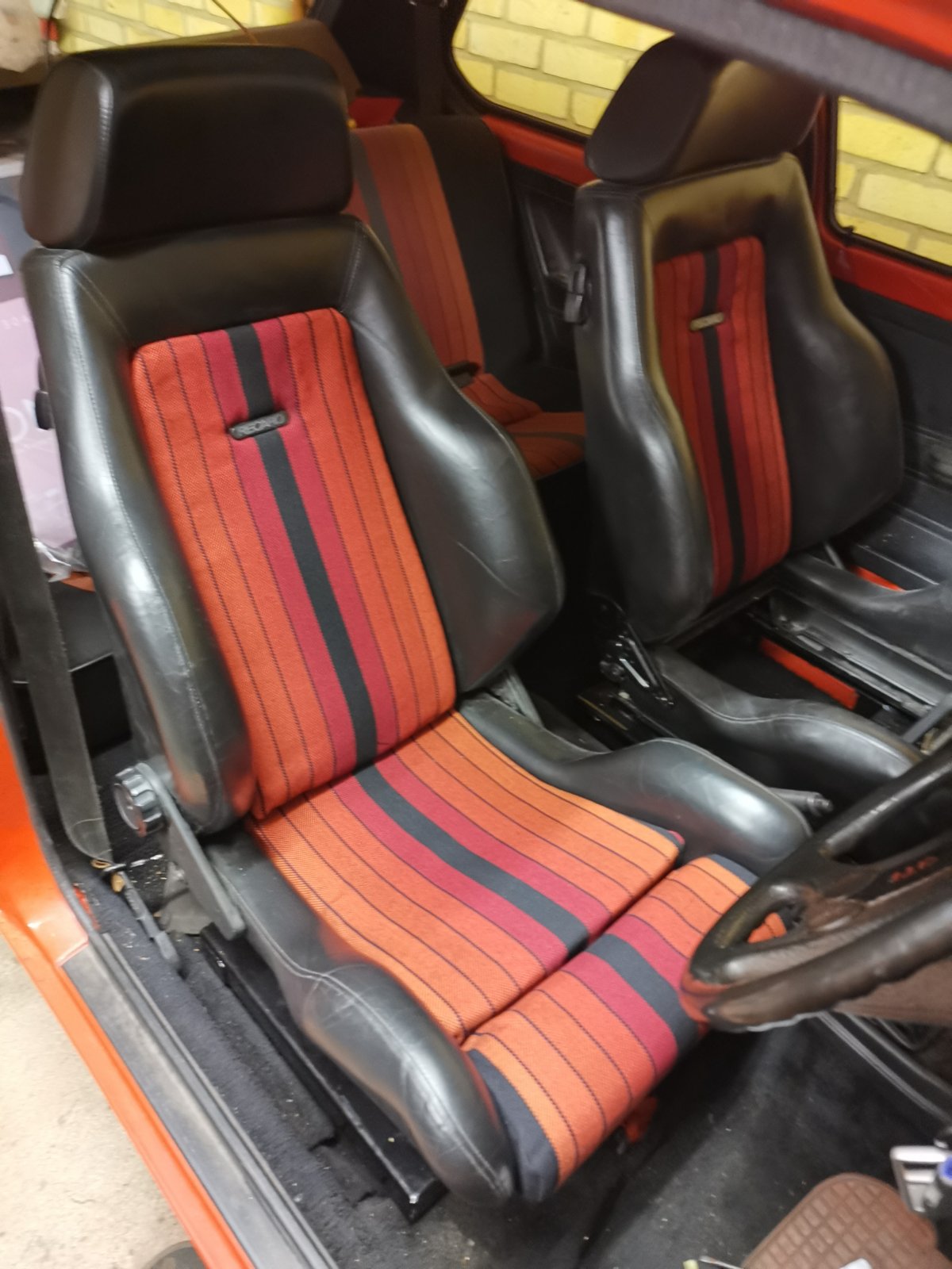

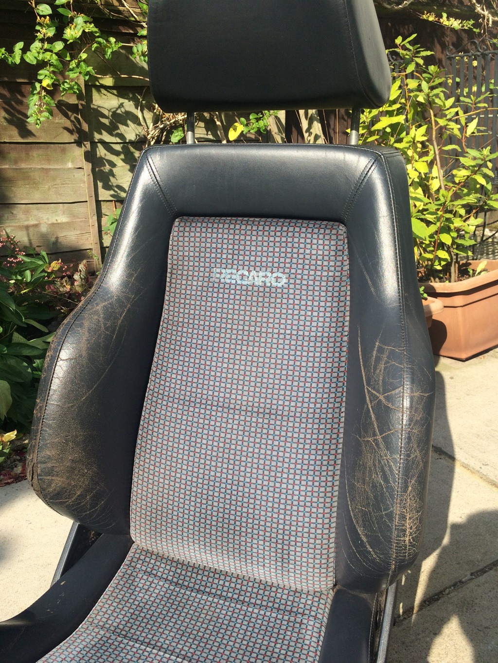

Great job. Any ideas on how to restore the steering wheel leather? I have the same one and would like to do that.

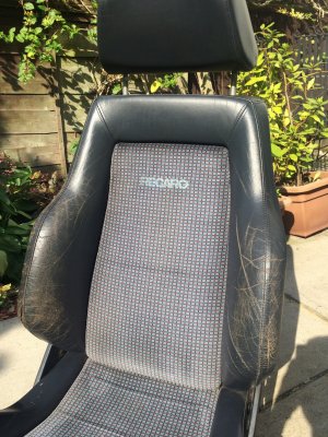

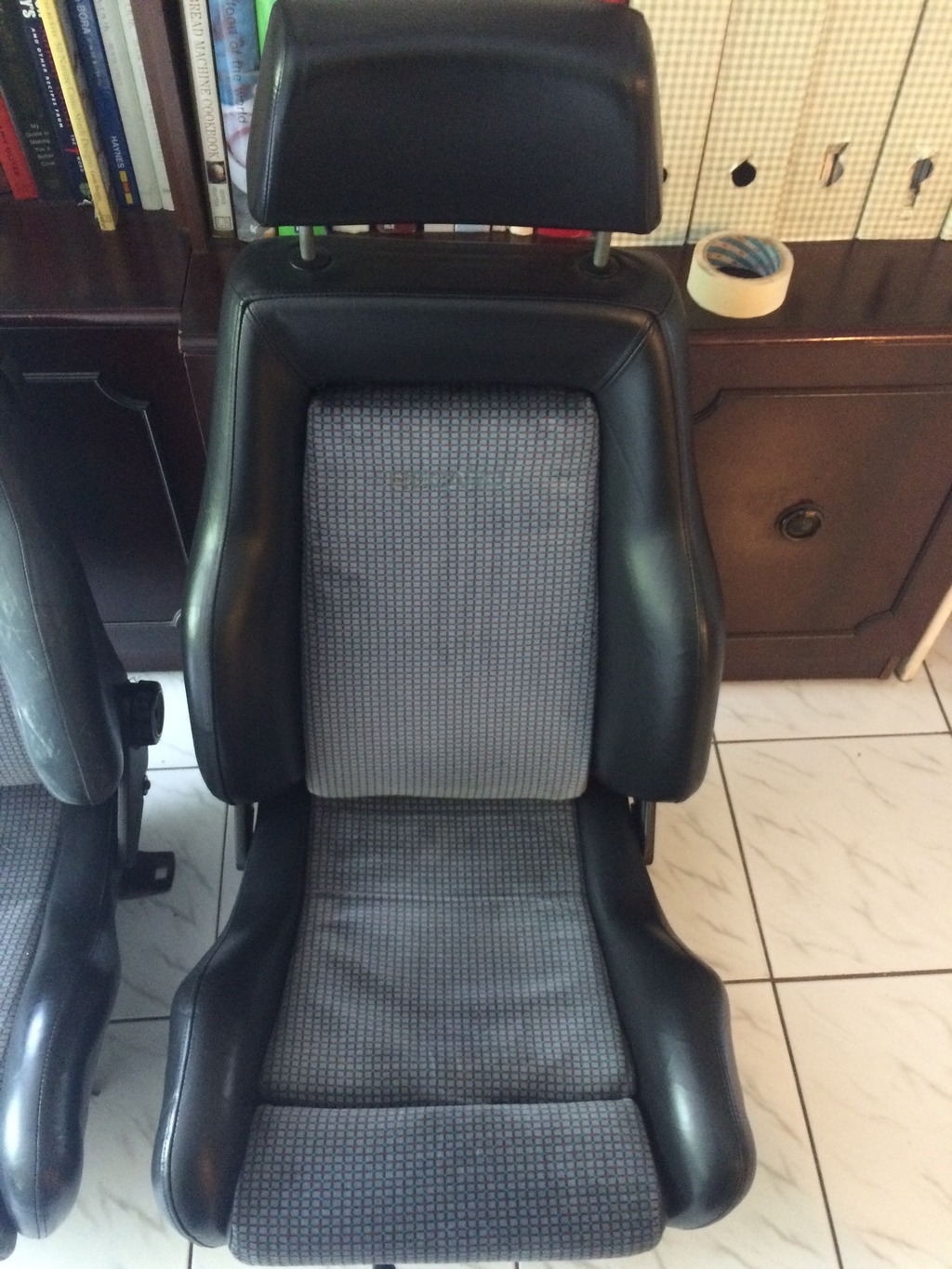

I use a kit from a company called furniture clinic in the UK. Thoroughly clean the leather with isopropyl alcohol and if needs be for any cracks, use a flexible leather filler which is then sanded down. I then apply leather dye with a sponge or cheap airbrush, then multiple coats of sealant
@Arde this is a set of Recaros I done with the kit which are now installed in my Mk1 golf. They have lasted about 6 years and have held up fantastic, the kit cost about £50 from memory. Won't be showroom fresh but it still has the character and patina of the seat without looking tatty
