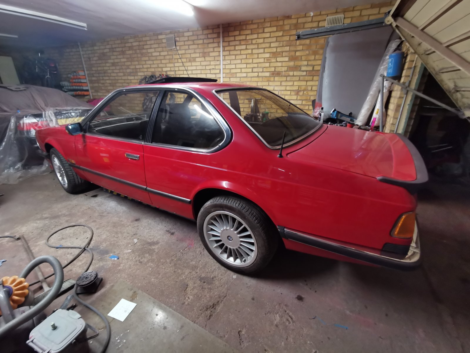

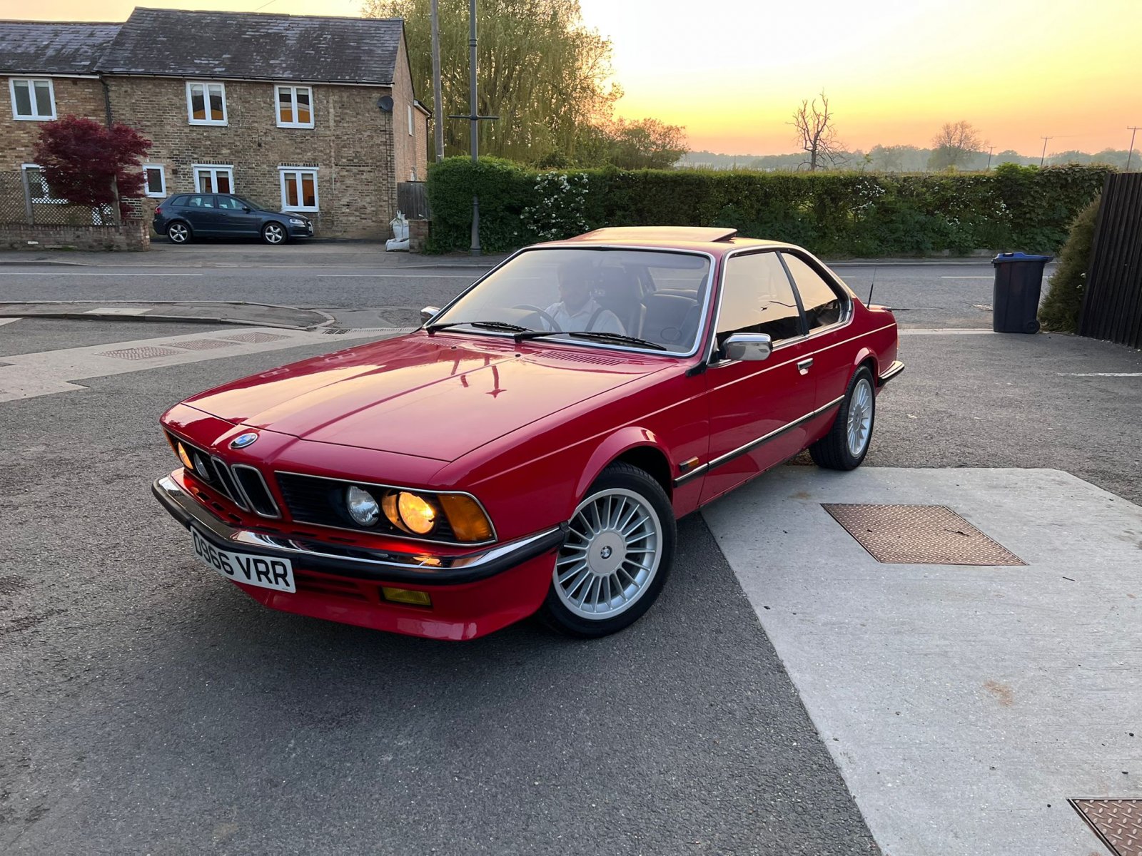

It's currently just past 1am over here. The car is in enough of 1 piece to get it through an mot in 7 hours time. I'll get it on the ramp at work on Saturday for an oil and filter change, fit radio and button up some pieces. Sunroof panel was a bitch to fit and took about 2 hours alone tonight!

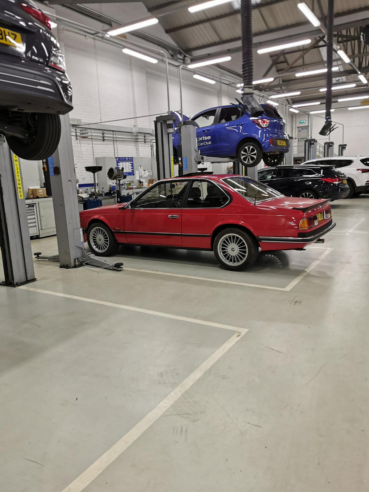

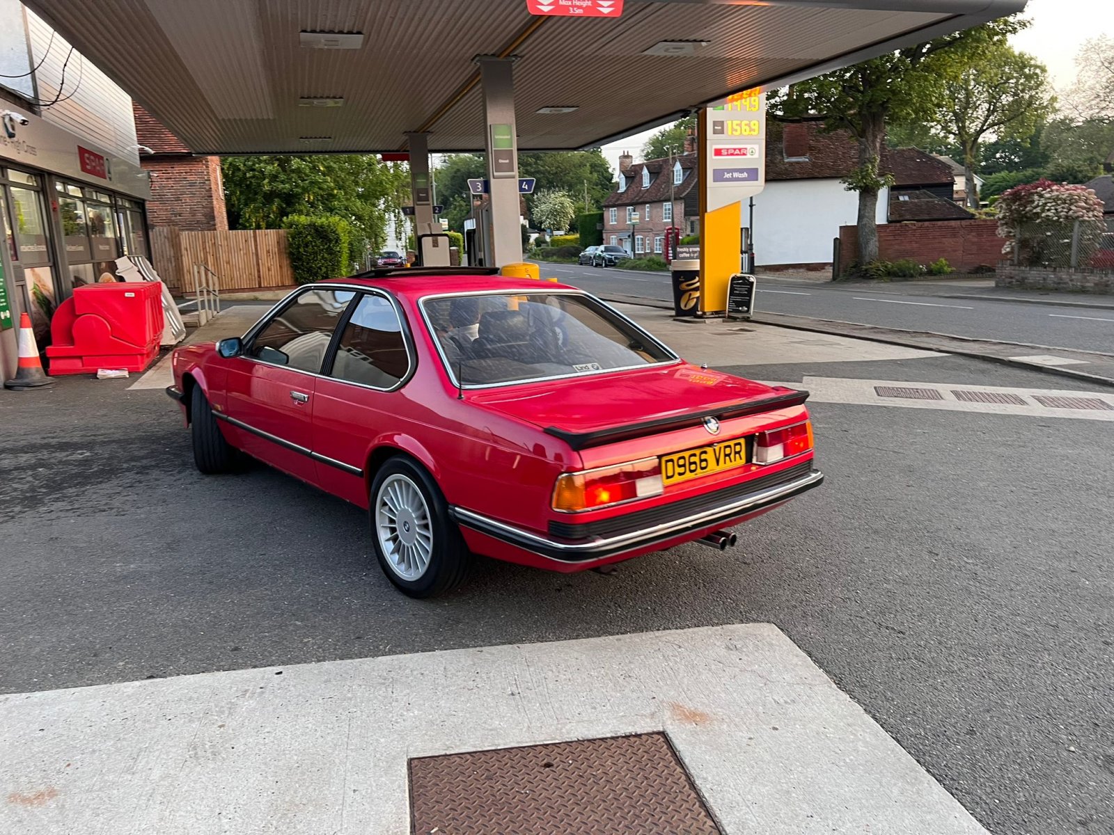

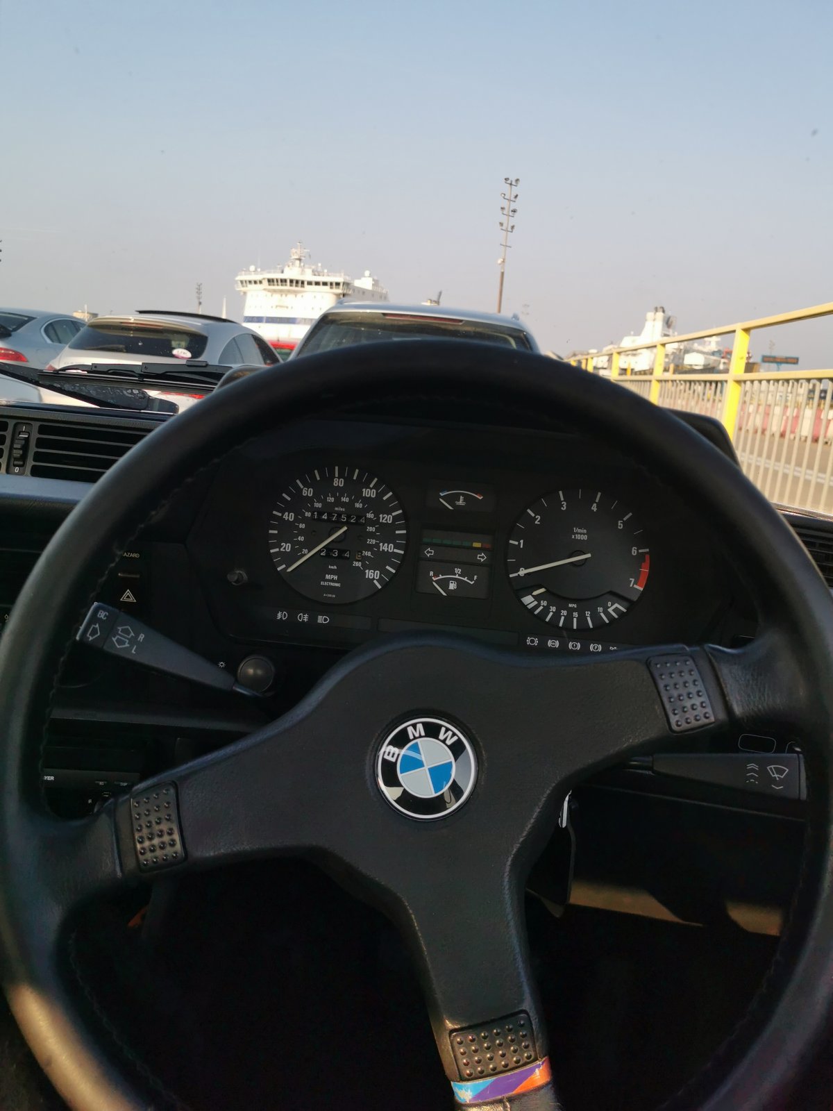

Made it into work with no issues other than the lack of radio being a bit boring. OSF brake binding a bit but hoping a good drive will help to take care of that!

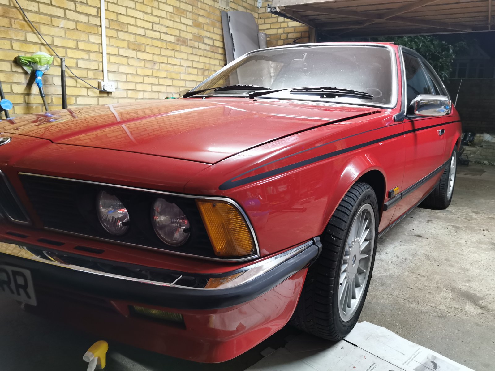

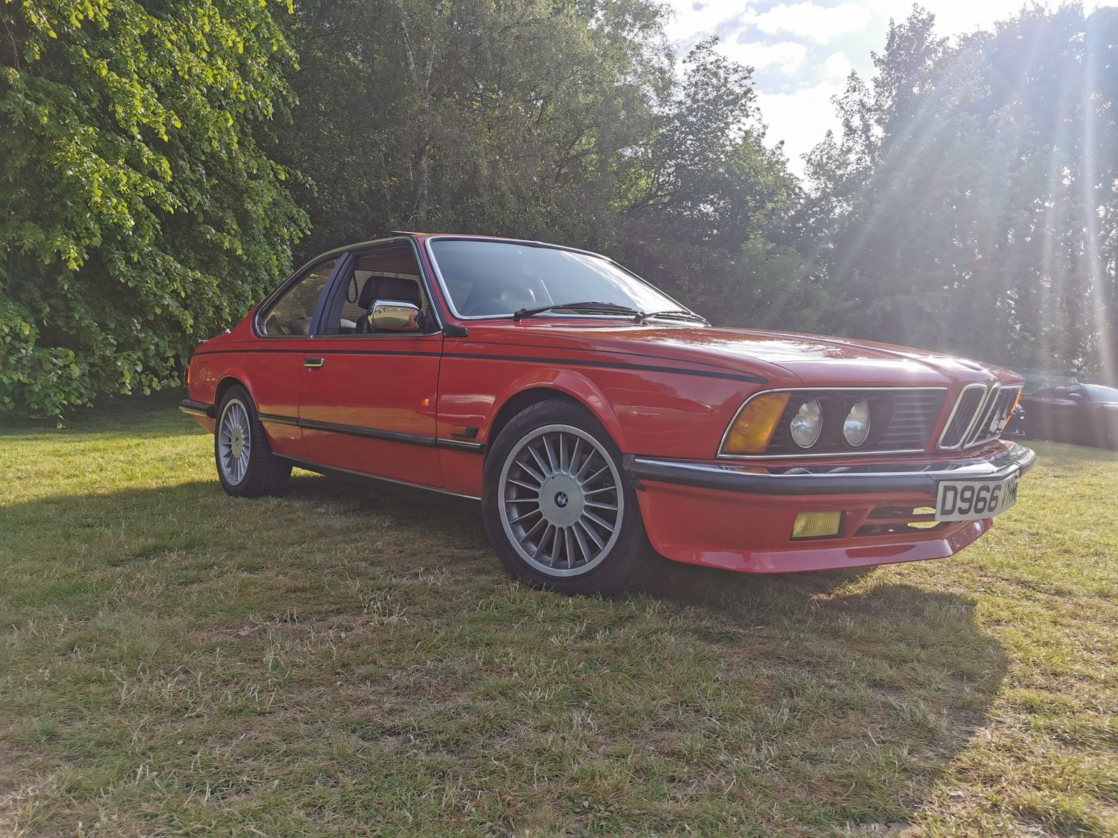

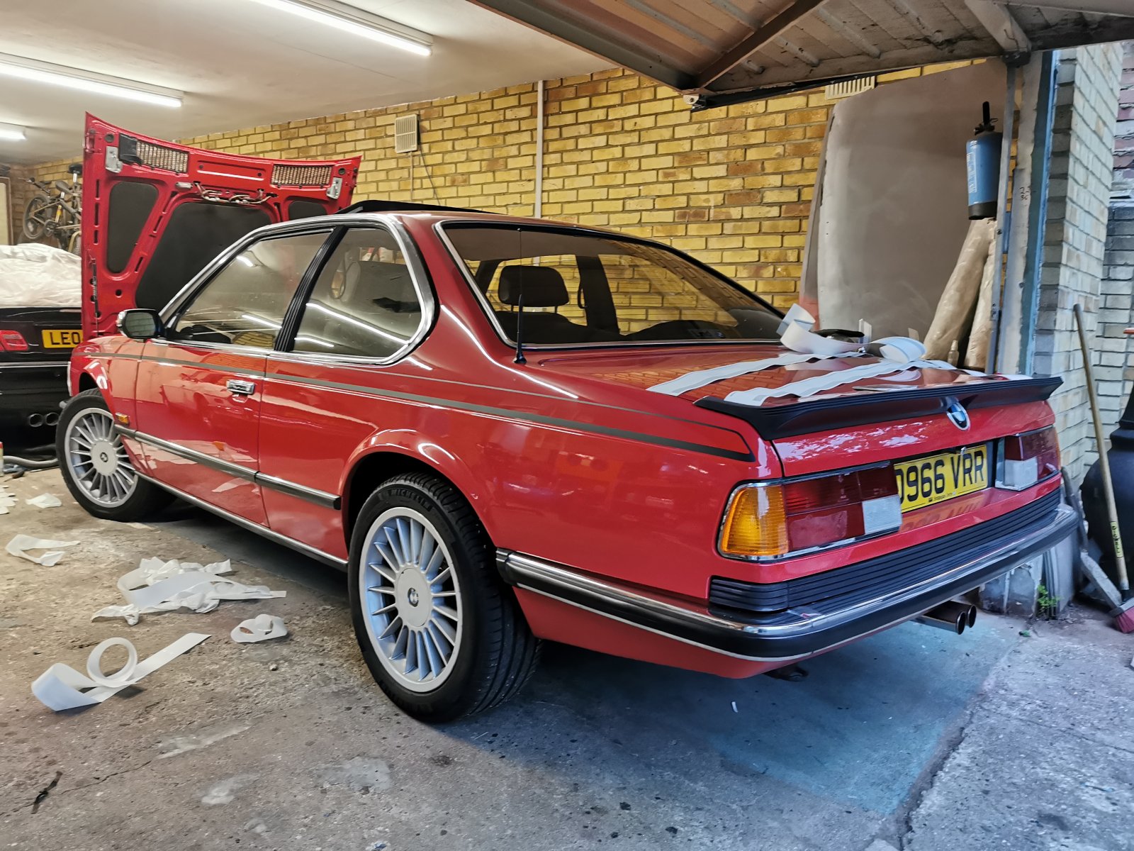

Side stripes on, also picked up a tech 1 wheel, got the glovebox light working again (contact cleaner works wonders) and adjusted the headlights.
Will try and get the washers water tight as the system is like a sieve, only a week left till Le Mans!
