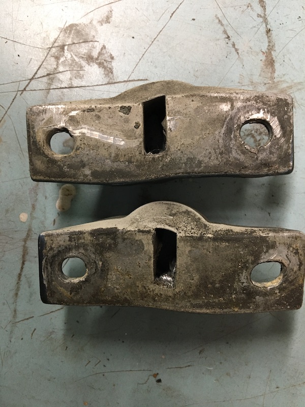

Can you post a picture of what you actually got from BMW for those 9 usd? I'm curious!
They don't have the E9 version anymore, so I modeled something and had it milled for 100 euro per side... gulp...
I think the original material is lead based, being the reason of the parts being soo heavy, plus that they seem to deform over time, as they are constantly loaded with a closed hood.

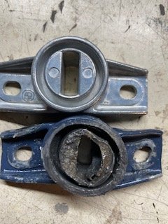

Hmmm, not so sure I needed new ones............................................
I have paint drying on the new ones. I will check the weight differences after they dry. I think they may be made of different material...........or I hope so.

I don’t know whether it’s pot metal or aluminum or what. Nowadays we’d say it was made in China. But we look at it with a jaundiced eye, and forget that these things are 50+ years old. Mine weren't that bad, but I replaced them, and unbelievably they’re cheap.(that may be a double entendre) Putting them on wasn’t very difficult. Probably helps to have two people.

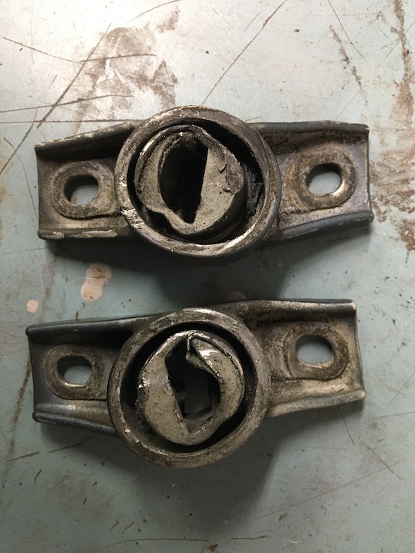

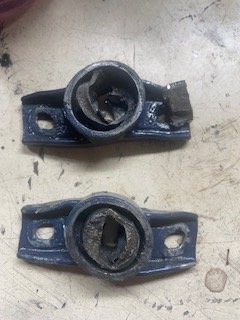

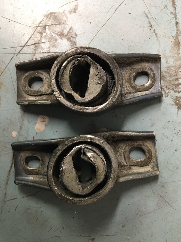

Pot metal, new ones are the same as the old, no upgrade. On the flip side, it is hard to do when you are working alone.
You nailed it. Both ends are pretty well chewed up allowing the springs to rotate some before they start doing any good...
The springs seem to be intact.
I'm not sure what would cause this other than 47 years of opening and closing the hood?
Mine looked exactly the same after 50 years of opening and closing. Just turned into mush. Replaced both hood torsion anchors two years ago and fixed! Just be carful of the mouse trap effect from the torsions bars when disconnecting the linkages.
