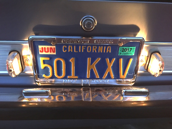

p.s. I trust Mike shared with you my blue plate success story on the e9. Thank you for your help and advice on that. I hope you have similar success.
