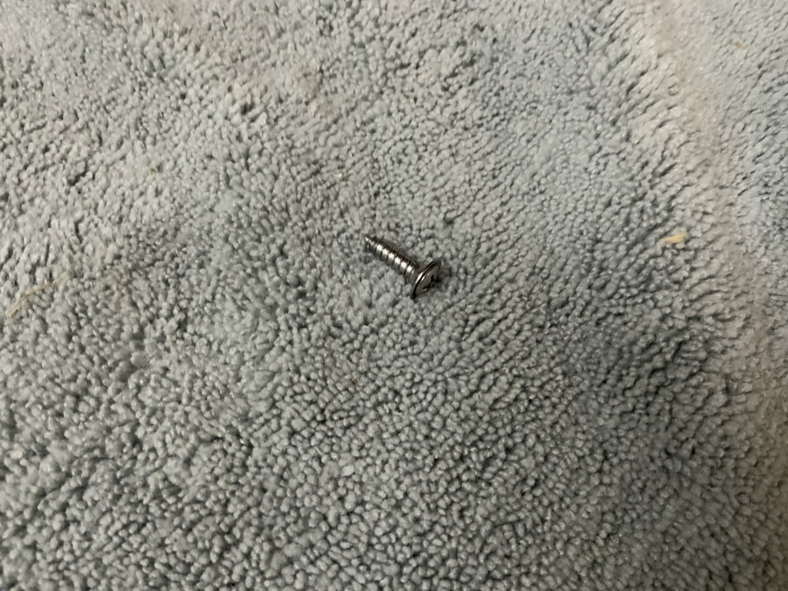

Early e3 trunk caddies mounted to passenger side panel with two snaps. Easier to use two chrome screws with integral cupped washers into the trunk board. Just don’t drill into to your gas tank, ask me how I know this! And the small side piece holds your wheel chock.
What Chris said, I've seen them secured both ways. Where snaps were used the cars also had a cutout in the trunk carpet for the "bag", earlier cars used screws into the bottom panel through the carpet :-(
Our 70 2800 has snaps on the vertical panel, I’ve never seen a snap on the floor but e9 caddies were fastened with two screws in the floor.

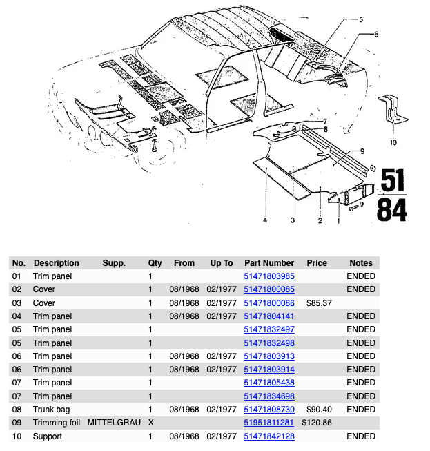

RealOEM does not show any fasteners in addition to the bag or the vertical trunk panel, but maybe the snaps were a part of both the panel and the bag?

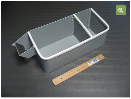

I just noticed that the one I got from CS Werk is different than the one pictured in that Bavaria on BaT. Mine has the wheel chock holder on the big part of the bag and the one on BaT has the chock holder on the small side of the bag. The one pictured on CS Werk's web site is the same as the one I received from them.

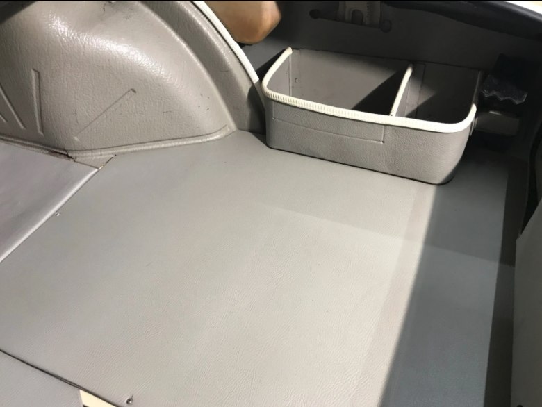

@bavbob and @HB Chris (and anyone else with one in an E3), can you post a picture of yours and where it sits against the right vertical trunk panel? Thanks!
Here is a BaT pic:
