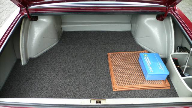

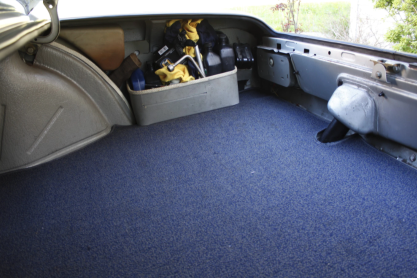

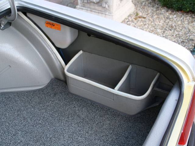

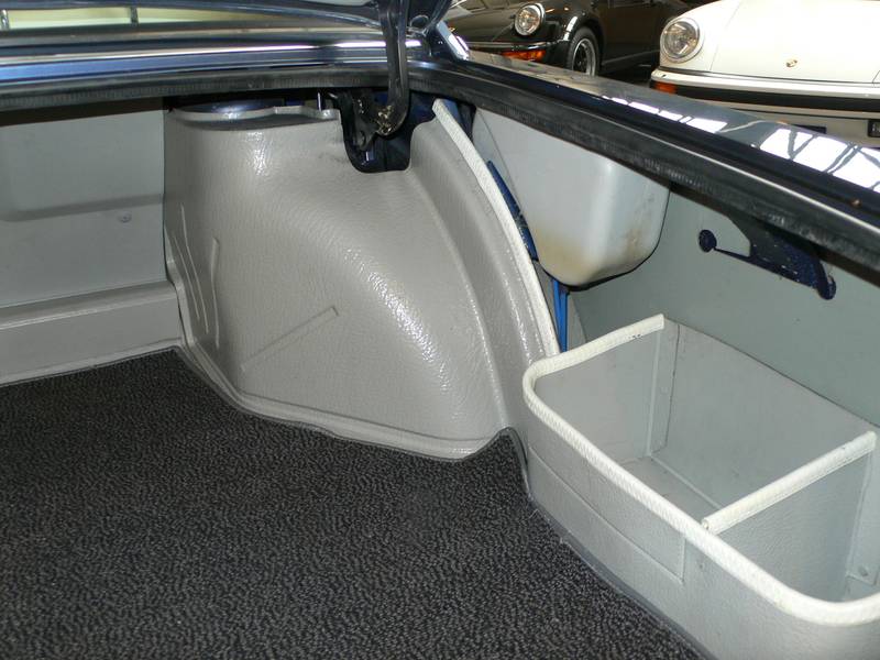

Both examples Chris posted appear to have the tire chock holder on the small part of the bag which puts the tire chock on the outside face of the trunk...

Although it is difficult to tell for sure...especially on the green car.
You can see a screw or fastener to hold a snap on the one in the green car.
@Christoph what is your take on this? Wedge holder to the rear of the car or to the front? Fastened with screws, snaps, or not at all? Did BMW change practices during production? Am I beating a dead horse here? ;)

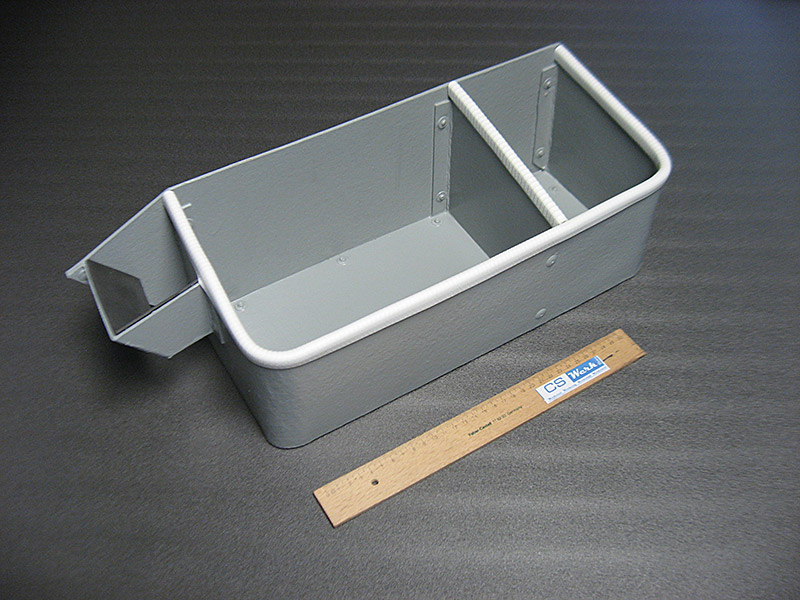

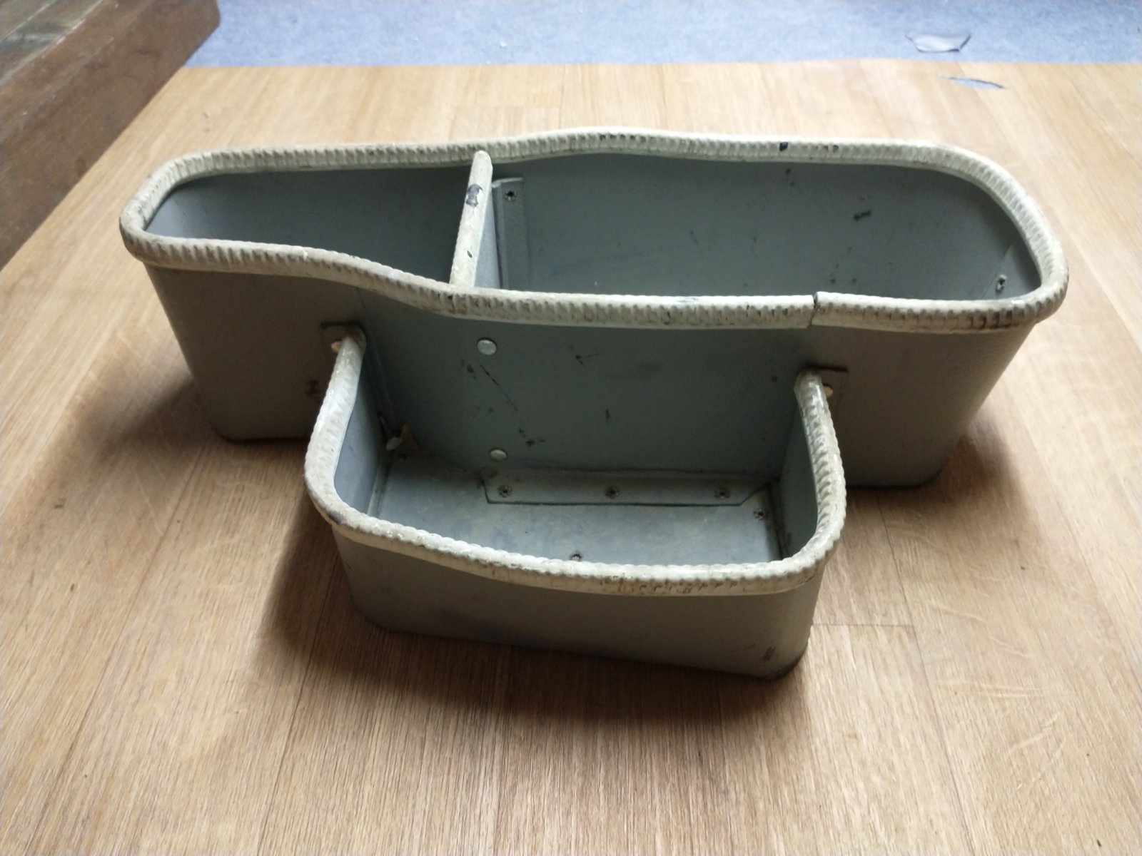

I just noticed that the one I got from CS Werk is different than the one pictured in that Bavaria on BaT. Mine has the wheel chock holder on the big part of the bag and the one on BaT has the chock holder on the small side of the bag. The one pictured on CS Werk's web site is the same as the one I received from them.

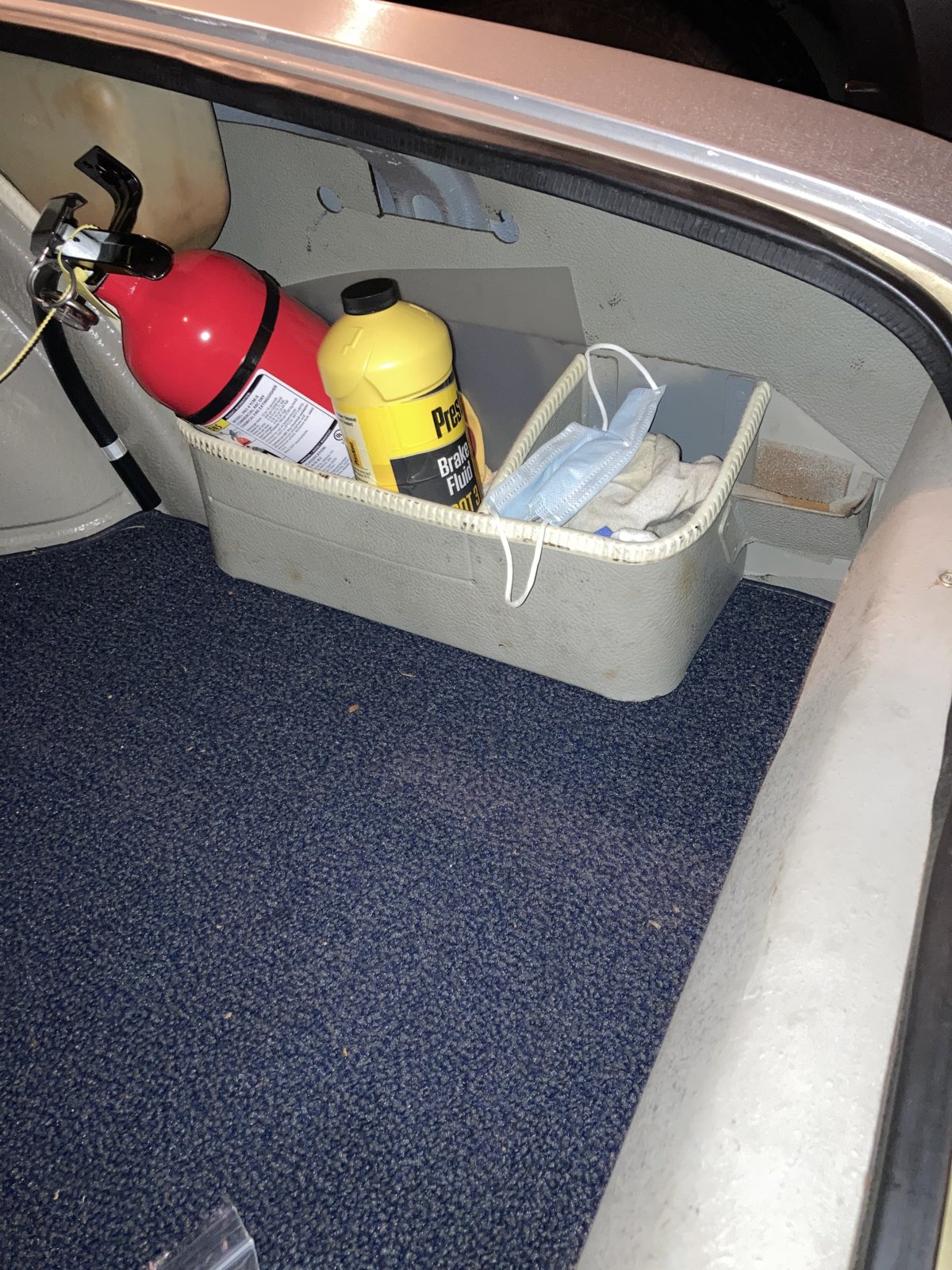

@bavbob and @HB Chris (and anyone else with one in an E3), can you post a picture of yours and where it sits against the right vertical trunk panel? Thanks!

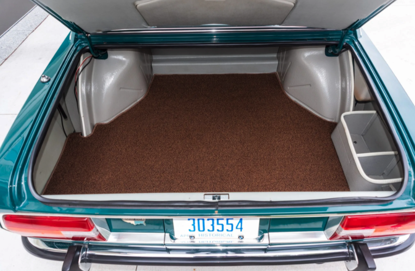

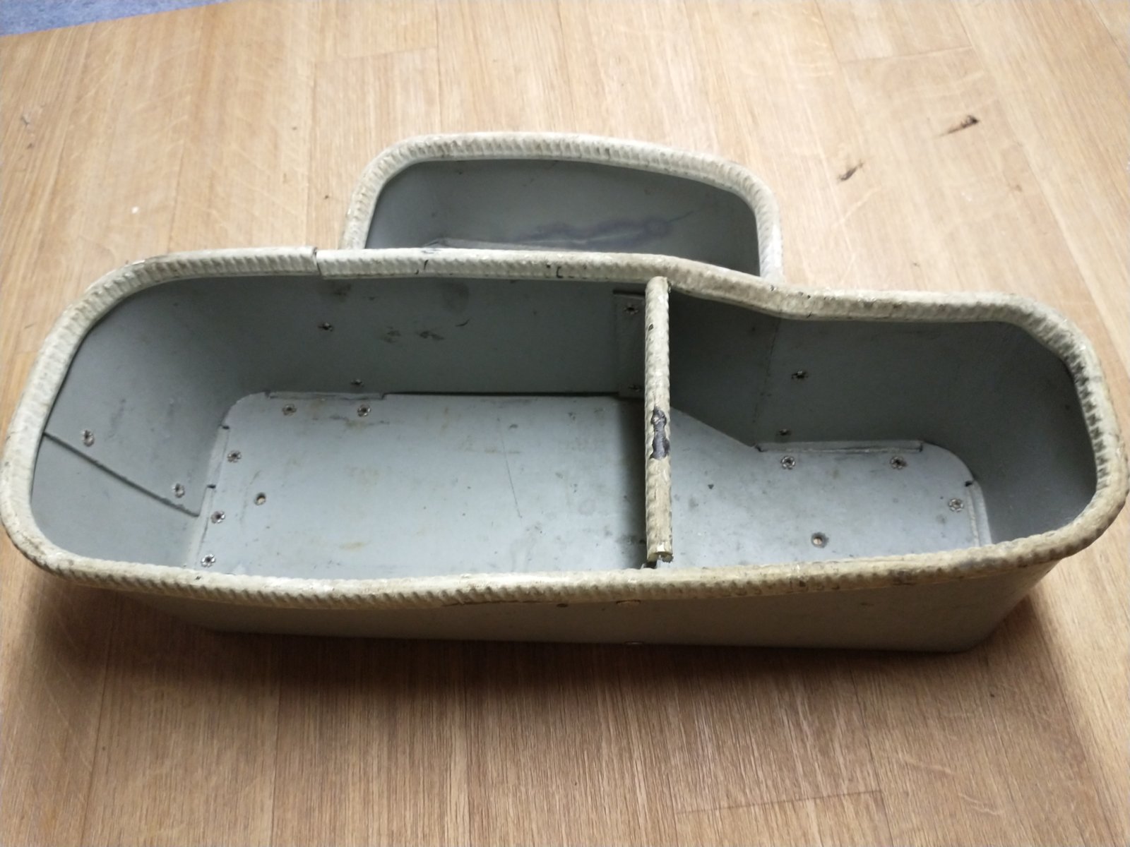

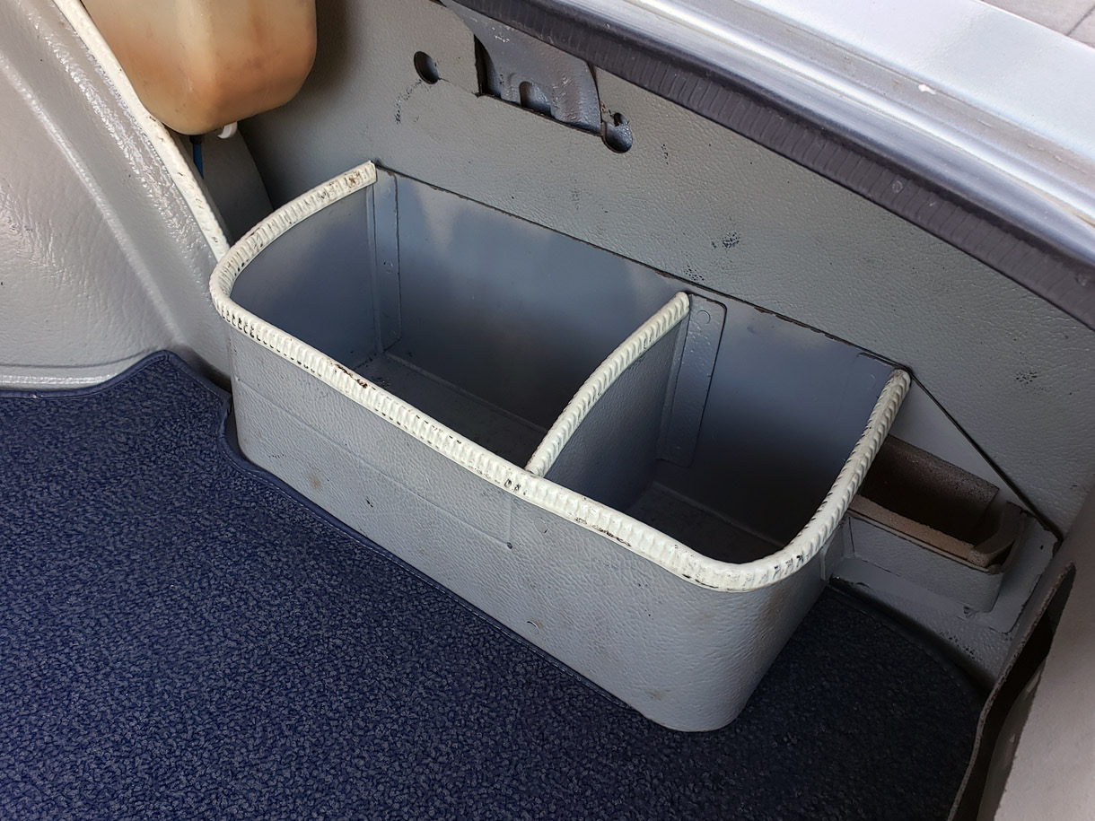

There seem to be two different versions of the bag, see below. Pictures courtesy of the sellers. The early one has the chock on the front, the late one on the rear and rotated by 90 degrees. The change probably came with the introduction of the petrol tank overflow (series 3, 73/late summer). As your E3 is a 1971 car the bag Mr. Bier sent you should be correct.
Red car: holder on front, no overflow.
Blue car: no sign of holder on front, overflow.
Silver car: holder on rear, overflow.

My pictures of US cars (I've also found one @HB Chris posted) suggest the position of the chock was changed when the overflow tank appeared. Thus, or probably, for ECE cars the early version was retained while the US cars were already fitted with the late version of the bag.

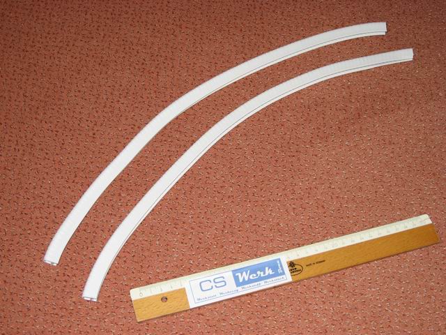

These are for the wheel wells but same stuff and should be enough - you could ask him for a custom cut length to suit
