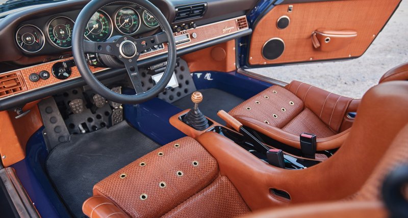

If I were you… $10K into your interior would add way more value and appeal to your car.
Imagine something custom like cognac! :) Photo for color-only.

i love the cognac color.
I could not agree more! Could I redo my interior for $10,000 though? My engine compartment also needs significant cosmetic work
the short answer is MAYBE. if you redo the entire interior (seats, door panels, armrests in leather, you are talking 4 to 6 hides (600 / hide +/- 100 bucks) ... plus the disassembly labor and the fabrication. also depends if you are doing custom work or just a redo. as always, there are people who are really good and in high demand (with e9 experience) and their cost could be 15k. bottom line is you want to see the quality of their work

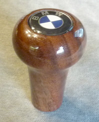

take a look at the shift knob in the picture above. looks like one made by Elihu (customwoodshiftknobs.com) his work is really good. he makes all kinds of shapes / sizes. he is a member of the e30 m3 special interest group.

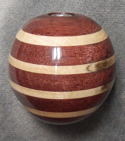

that one is 48mm - purpleheart + maple. he has done some in macassar ebony / maple, bubinga / marblewood, katalox / maple, bubinga / maple. these were made for Porsche cars.

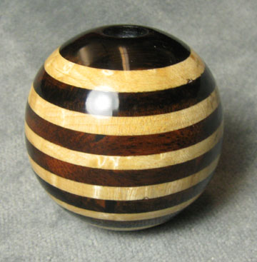

this is the ebony / maple and its 52mm.

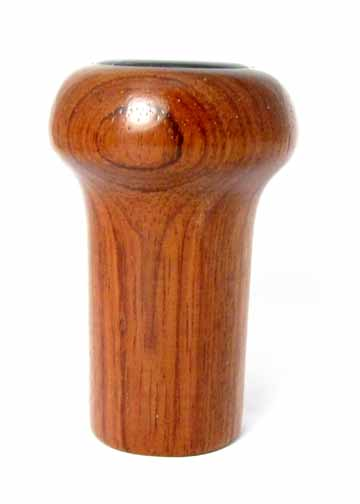

he makes mushroom shapes for 2002 / e9 / e3. different woods and various shapes. this one is bubinga - 46mm wide x 72 mm high. he makes them with / without inserts.
this one is walnut
