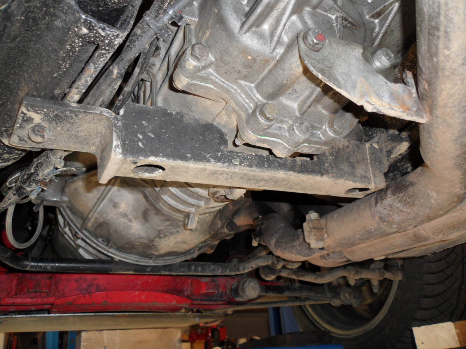

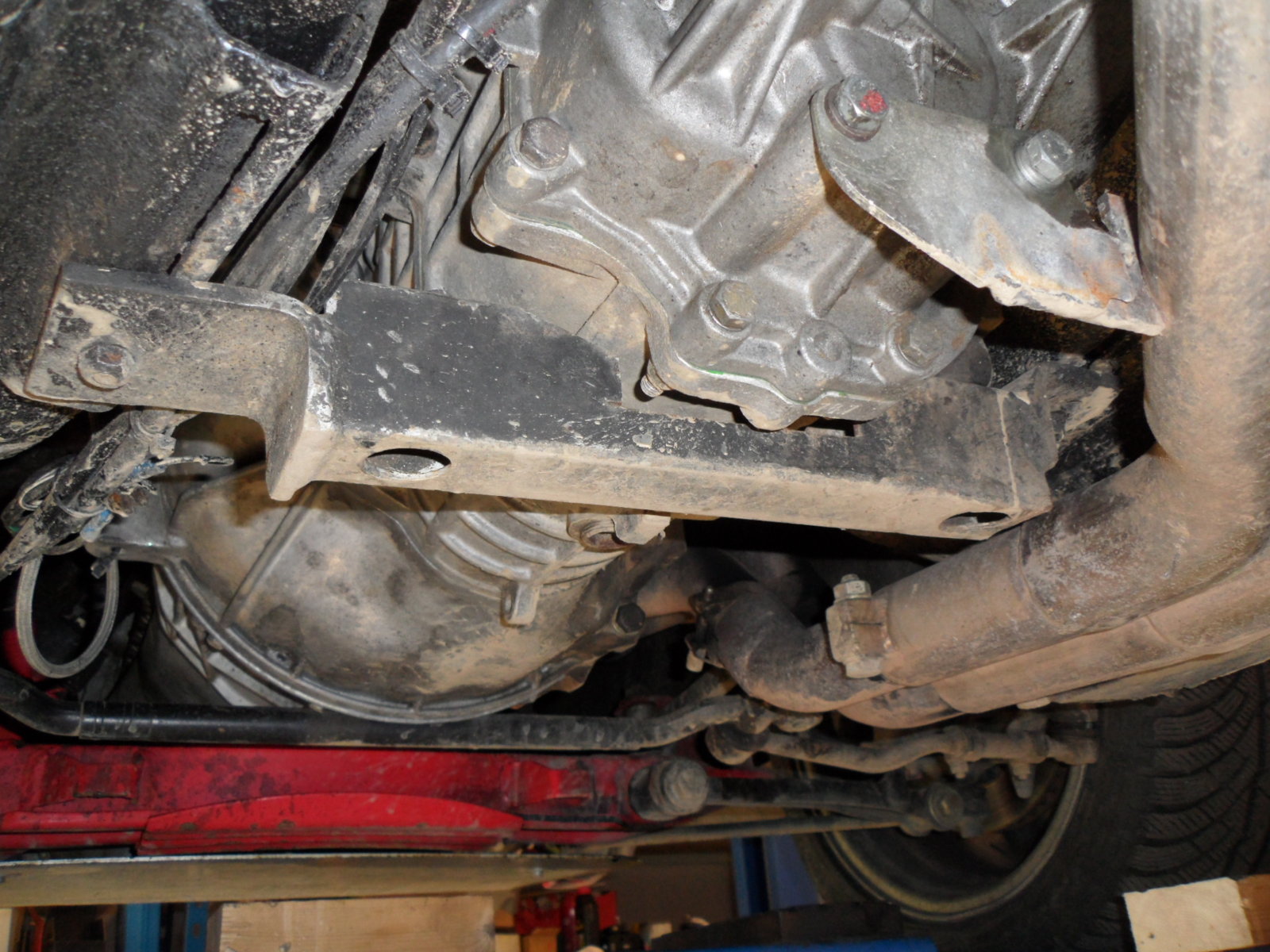

I did my conversion before this stuff became available, but I am going to switch over mainly because I am concerned about how close the bolts that hold the tranny mount to the car are to the wide part of the slot they ride in that allows them to be installed and held in place. If I were having the clunking problem discussed above, I would look at the position of these bolts relative to the wide parts of the slots in the car frame. If one of them is aligned with the opening, it could allow the tranny to move. I remember being unhappy about how close the bolts needed to be to these openings when I did my install.
same observation here Ohmess. My plan was to weld a extra flat piece on both sides of the bridge so we could place another 2 extra bolts in it.... for some reason we didn't do it so far .... and i must say it stayed firm all over those years rally .

You should be very careful of the propshaft alignment. Usually the 5 speed being longer touches the tunnel so people tend to lower the gearbox to get clearance leaving the prop out of alignment. Best way to do it is to remove the bolts from prop to gearbox flange and check the clearance between the three prongs of the gearbox flange and rubber coupling are within 1mm of each other. A friend once fitted a 5 speed without doing this and on hard acceleration the prop came through the floor and smashed his radio.....!!
Wolfram, as promised, a pic of my bridge. It's a easy DIY welded part , but as mentioned , it better should have wider side pads to accept 2 T bolts each side. The ones now are scary close to the opening in the chassis rails.

Thanx for pic.
I Will try with the crossmember from a E24. If it does'nt work I make my own
