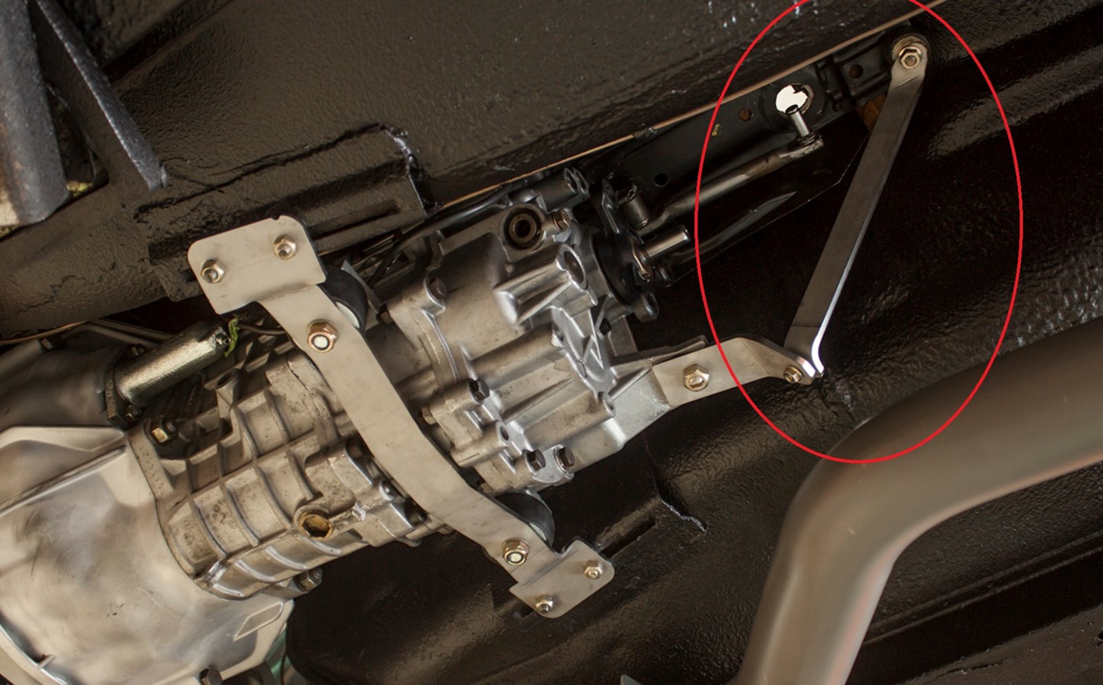

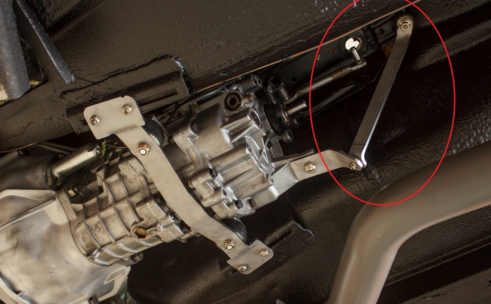

.... interesting solution from CK, but what is the separate brace for ?
I can't see any purpose :rolleyes:
It braces the shift platform (vs. bolting it to the tunnel). I am using Autosolutions brace and mount.

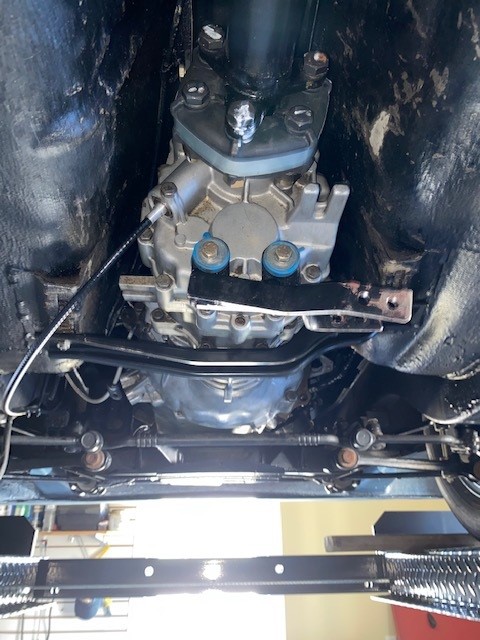

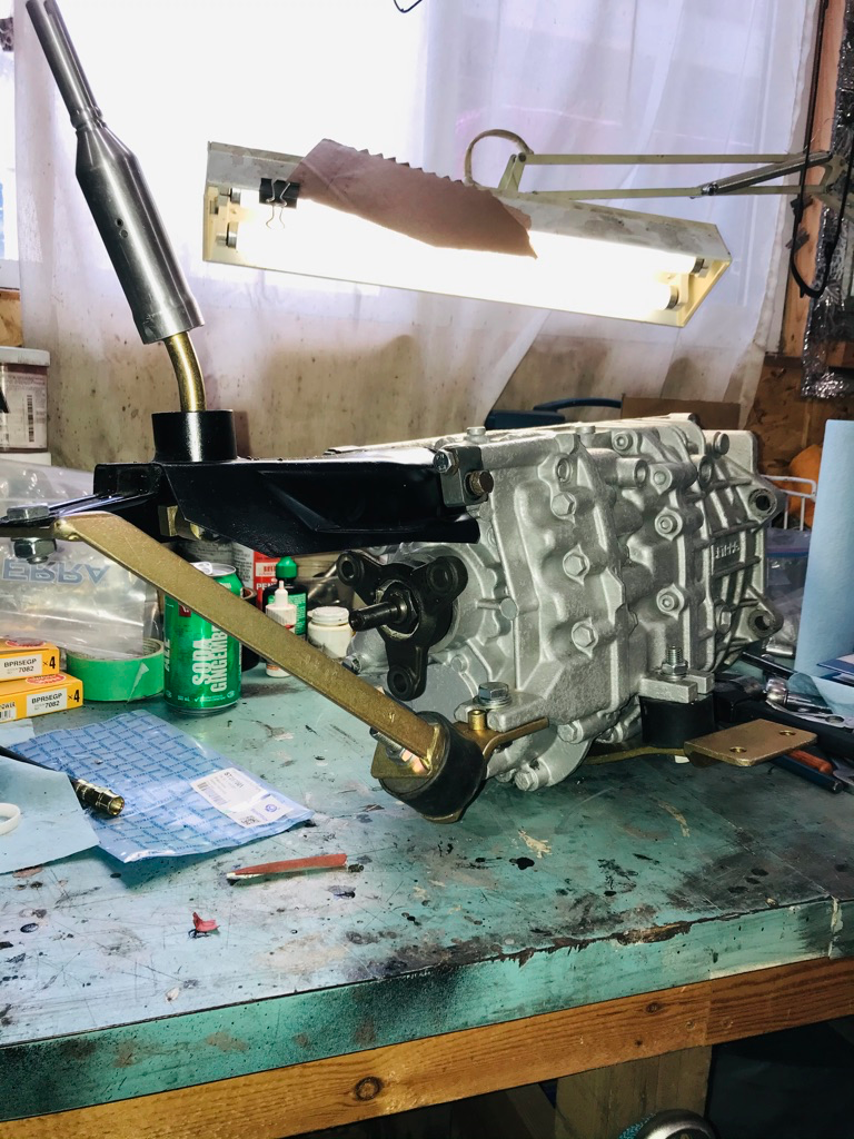

for those on a budget-
A used sway bar rubber, a bolt, 2 washers and a nylock is what we use.
My recent conversion went straight forward with no issues except the O ring leak on the speedo gear.
