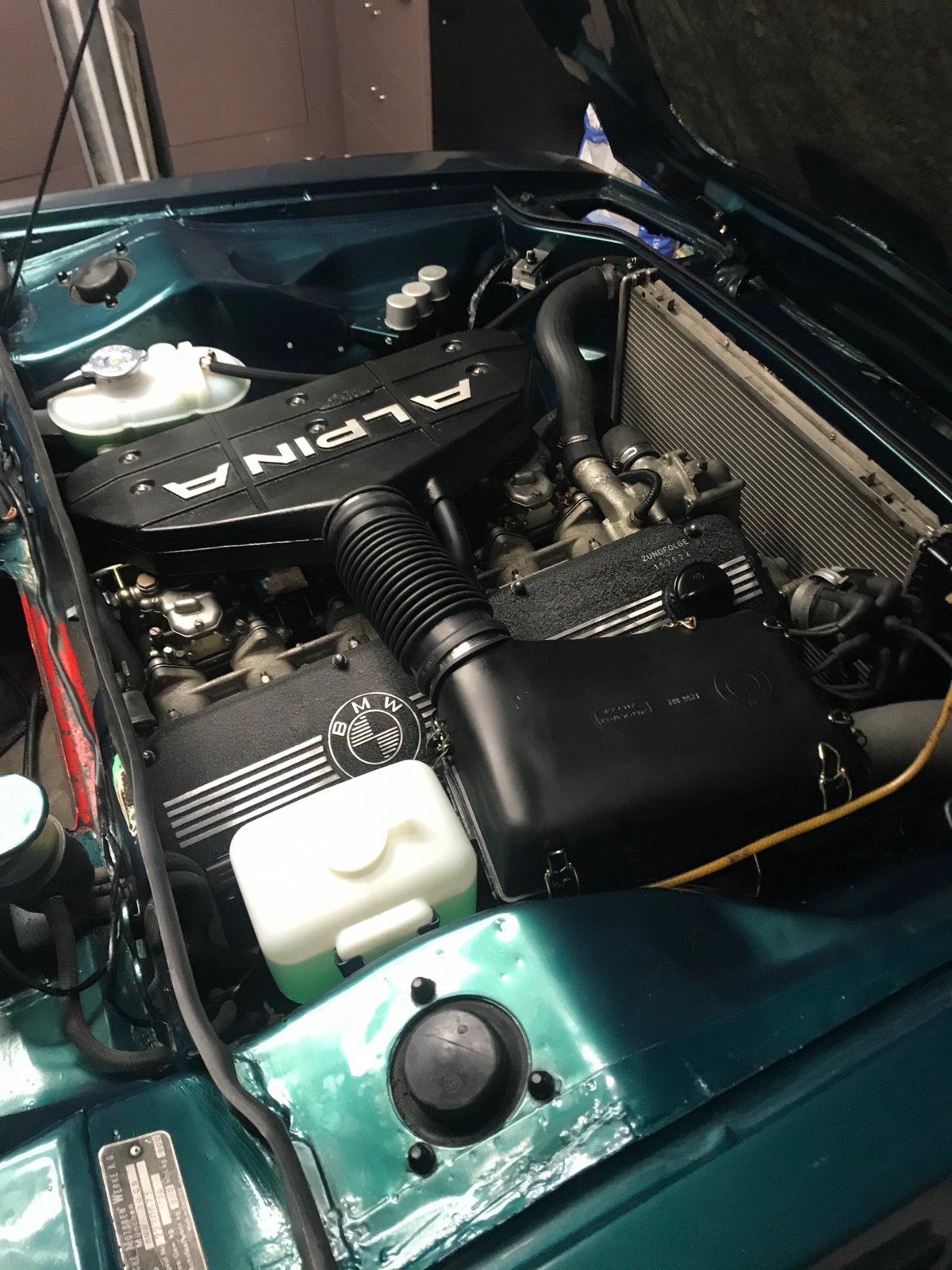

Thanks to many on this site I am making progress on my Alpina b2s tribute.
The car is a RHD CS, which was my first car, purchased down here in Australia for $8000, with some help from my parents, in 1988!!
Plan is to get everything working and serviced on the car, prior to a bare metal respray etc etc.

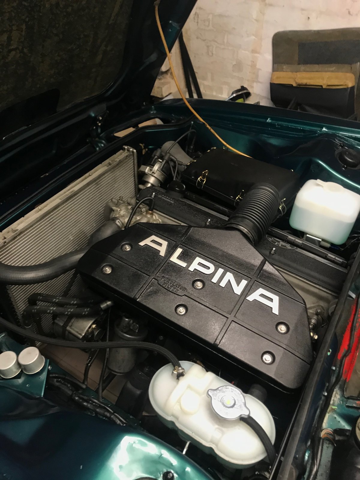

Have posted pics of engine bay here, have just installed a repro Alipina airbox and elbows and a csi airbox , both sourced from forum members, while also cleaning up all the wiring throughout the whole car.
Engine is m30b35. Long stroke crankshaft for a 3.3li, bored to 93.4, 10:1 custom forged pistons ( we get 98 gas down here), schrick cam, headers, mechanical advance distributor, thermofan, oil cooler.
Brake booster removed, with big bore master cylinder to compensate, manual steering, manual windows, 3.64 lsd, 5 speed od gear box, staggered 16 inch Alpinas.
Has a scheel interior, and gauge cluster, and bonnet pins, with black headliner on the way (original needs replacing anyway).
I will post some more pics once I move on to the body.
Will have alloy boot, bonnet, door skins, plexi rear windows, early alpina chin spoiler.

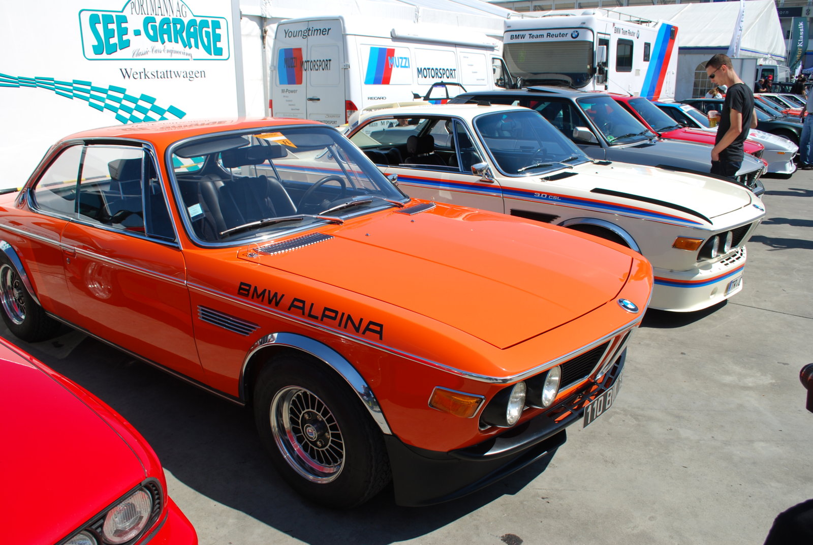

Goal is to optically mimic the alpina b2s, that was based on the early csl carb cars.
I will leave it badged as a CS, but reserve right to use any original e9 color (as opposed to being limited to carb csl colors)!

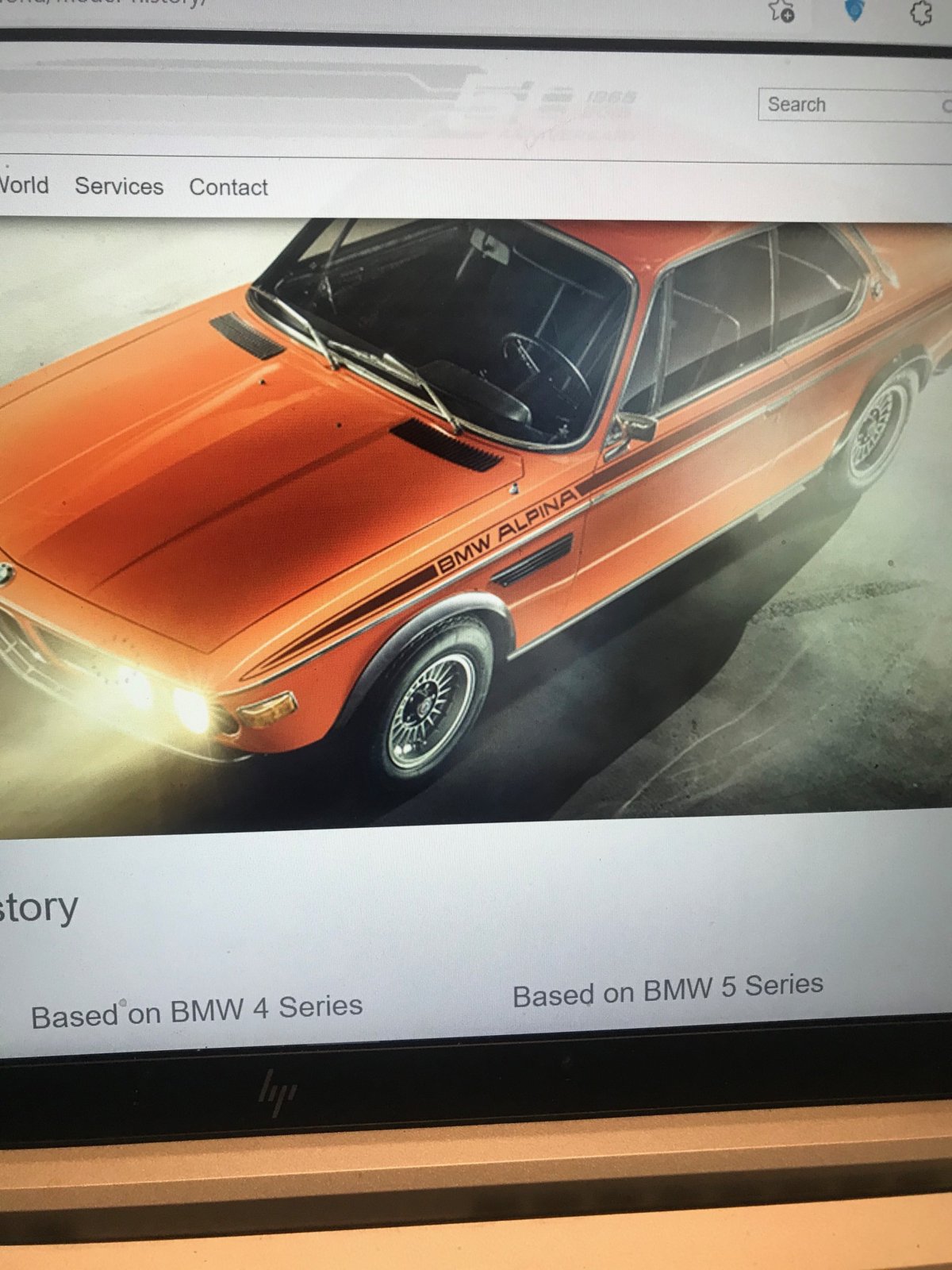

I am debating whether to put the ALPINA large stickers on the side of the car as I don't love them, may go with something like the picture attached, which is now on Alpinas website, despite the fact that I see no evidence , that that design was originally used on the car.

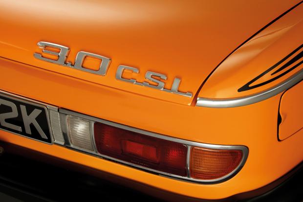

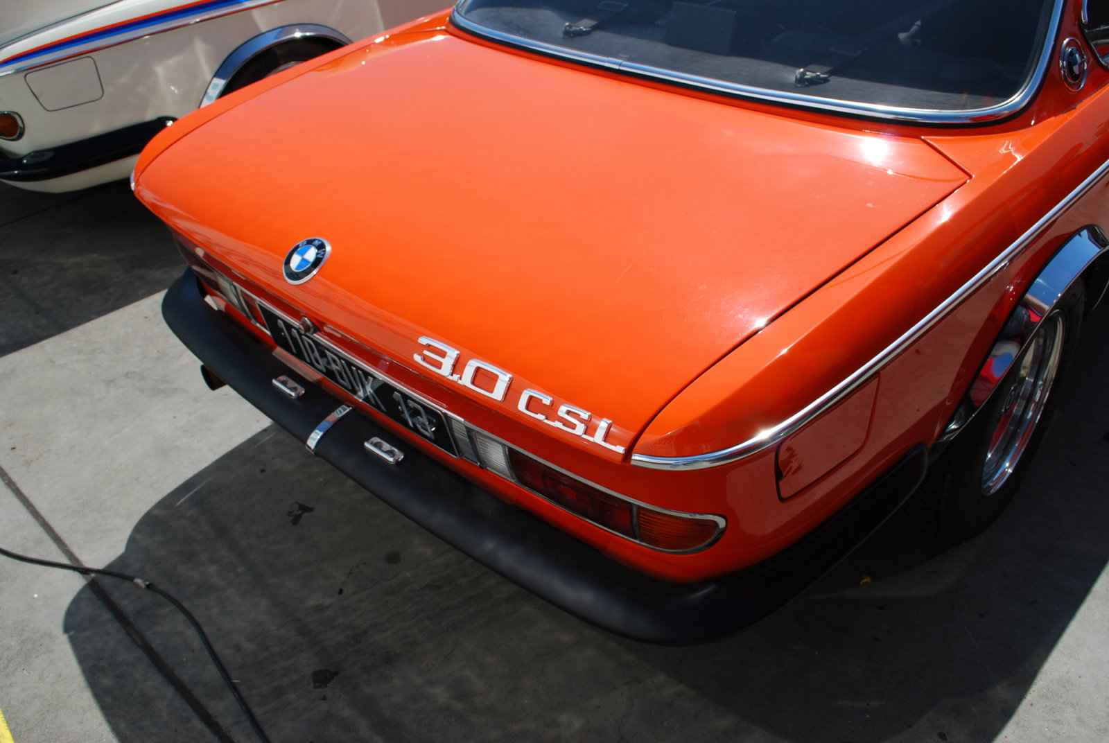

FWIW - The carb CSL was badged a 3.0CS. Same for the B2S, early ones anyway.
When you stick a CSL badge on an original carb CSL trunk lid, the L gets wedged up against the edge of the lid.
Compared to an injected CSL trunk, where
the holes were drilled for the actual CSL badge:

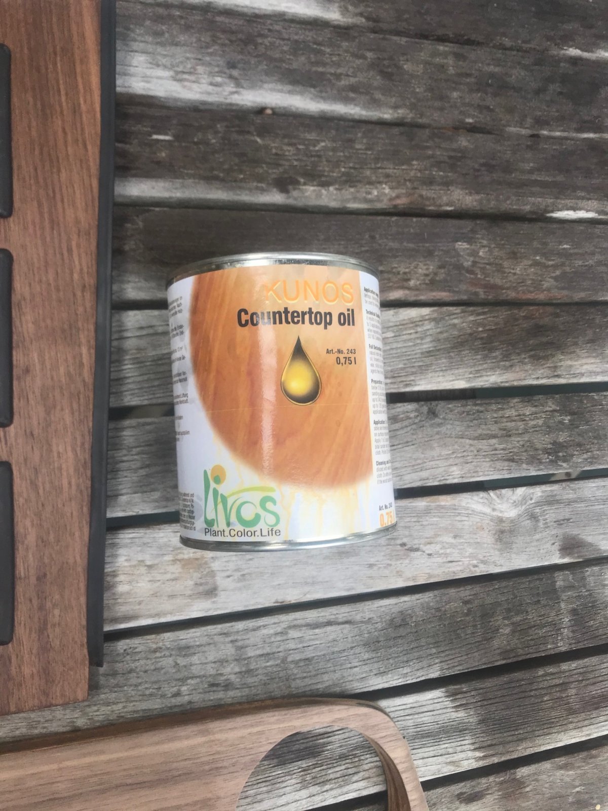

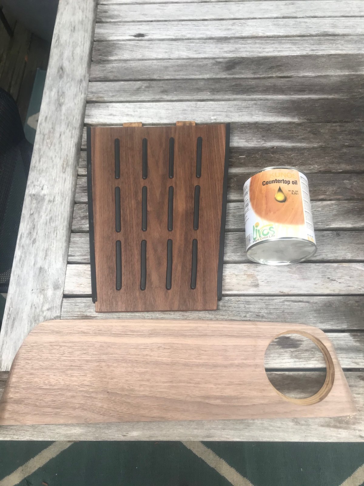

So , getting going on the re veneer of the wood trim.
Have gone with an american walnut, along with this "livos" countertop oil.
No stain, 4 coats provides a light sheen. Is heat and water resistant etc.
Used West System epoxy resin to secure the veneer, annd lots of patience / steaming, on the bendy bits!!
