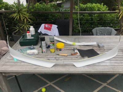

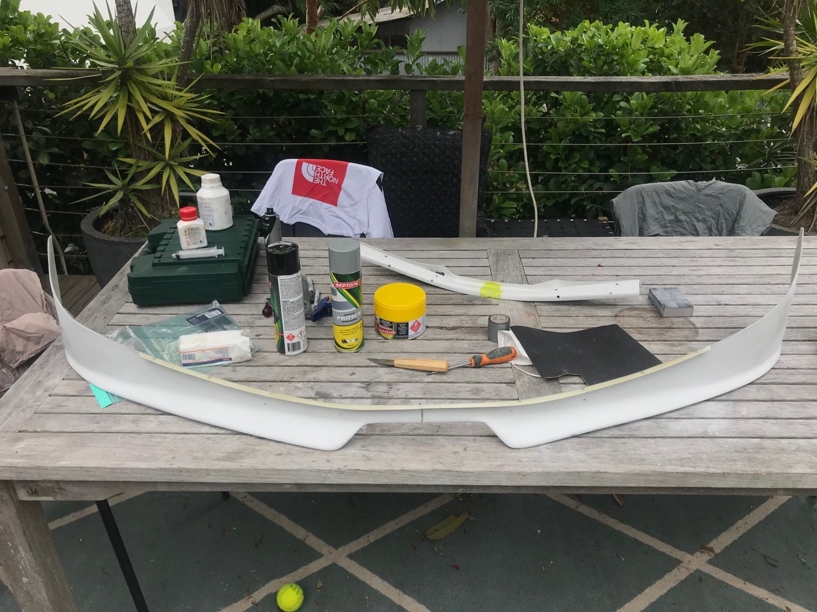

Finishing the early alpina chin spoiler today.. will take some pics when mounted..
Shipped from germany in 2 pieces, with a brace to glue it back together!

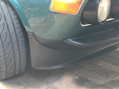

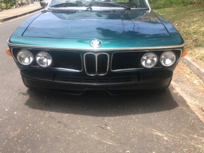

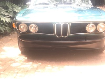

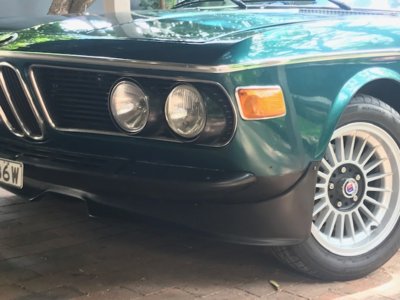

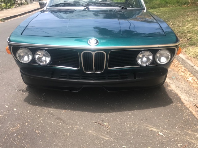

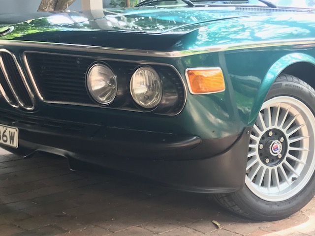

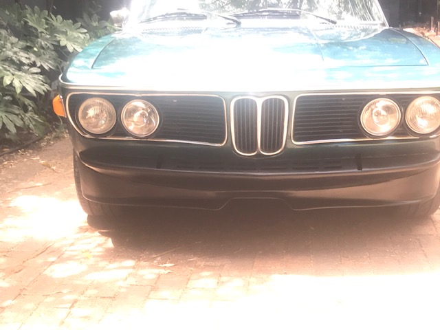

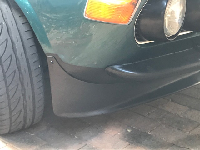

spoiler mounted.. note, one side with rubber sleeve, other side without.. not sure is the rubber sealing looks better or not, any thoughts?
Overall, v pleased..

He will ship it to you split. brace to re attach works well , I used 2 stainless rods, which i encased in an expoxy bath, using bluetac to create the walls, so it could dry.
I mounted the two sides separately first, as it turns out, I needed about a 3mm gap in between the 2 pieces, to make it fit better.
Needed about a day of patient work, sanded the lip that attaches to the valance underneath, to match (some variation there), and sanded one side of the spoiler, toward the top corner , to get it to sit better etc etc.
So definitely some fine tuning needed, but all hand sanding, nothing major.
Heavy construction, thick glass all around, hard to avoid minor gaps around the valance, as it goes up around the corners, but this it not unlike original, or csl spoiler.
I have used a thin rubber, to fill those gaps, but may still remove it, as gaps are vv minor.

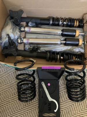

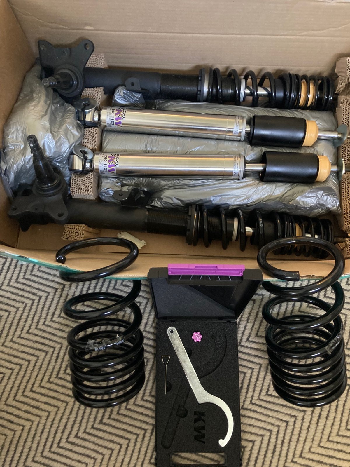

KW coilovers arrived from RAAB Motorsports in Germany..
Spoken about by others on the site.
Use the original rubber upper strut bearings - no camber adjustment, but am pairing with carl nelson fixed camber plates, so a middle ground between the hard core, integrated adjustable camber plate coilovers, that basically bolt straight to the strut mount.
Rears are not height adjustable, but like the look of the rear stance it provides regardless.
I will purchase a standard height rear upper rubber shock mount (28mm i think), and a high one (38mm), if i want to mess with rear ride height.

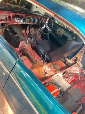

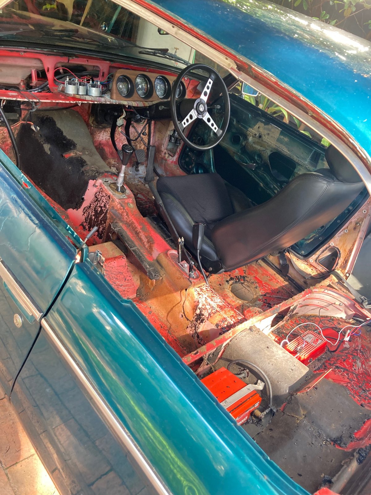

Interior now basically stripped out - some of the sound proofing left to do.
I can only do that one hour at a time.... is a horrible job!
Car heading to mechanics to remove running gear next week, onto a rolling jig, then off to the body/paint mob...
Will keep you up with pics of bodywork.
Cheers,
Mike

Nice one!
Great to see another set of Raab KW Coilovers out there, I also have a set for my own B2 project!

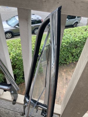

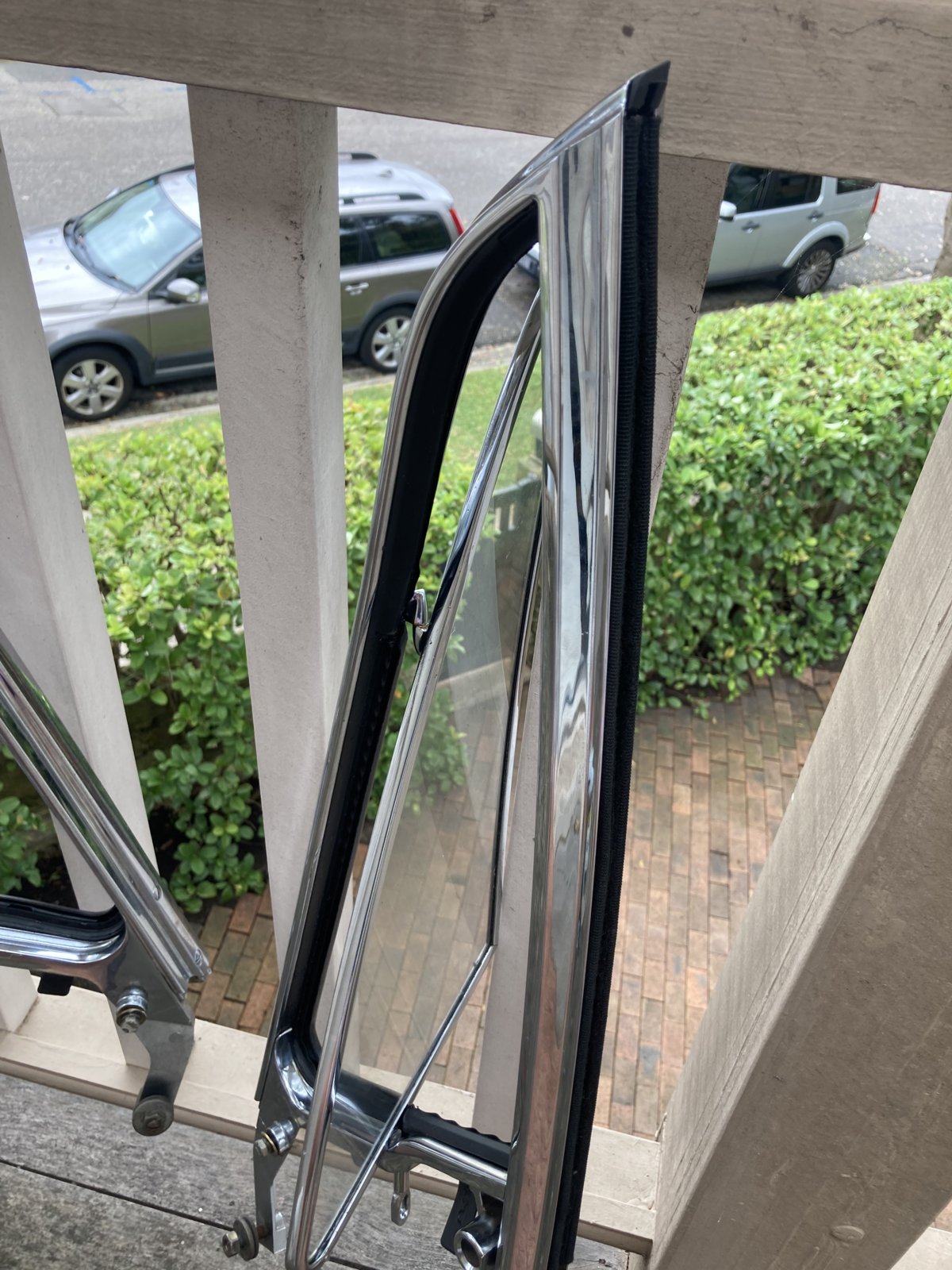

Front window quarter? Fix up.
New rubber, new channels, new platic cap thingy at top of channel. Clean and polish. Getting rubber back in was fiddly but all in all, pretty simple. Even for me. Its just time. Like slow cooking, very rewarding.
