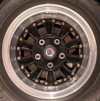

The wheels on the car in the early brochure were the Alpina 3 piece found on the B2S.
The interior had early scheel fiberglass seats and a prototype momo alpina steering wheel. It has more dish and spoke holes than the 380 alpina that landed in the later carb CSL’s. It also doesn’t have the droopy hub as seen further below:
These are the alpina wheels:

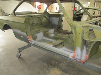

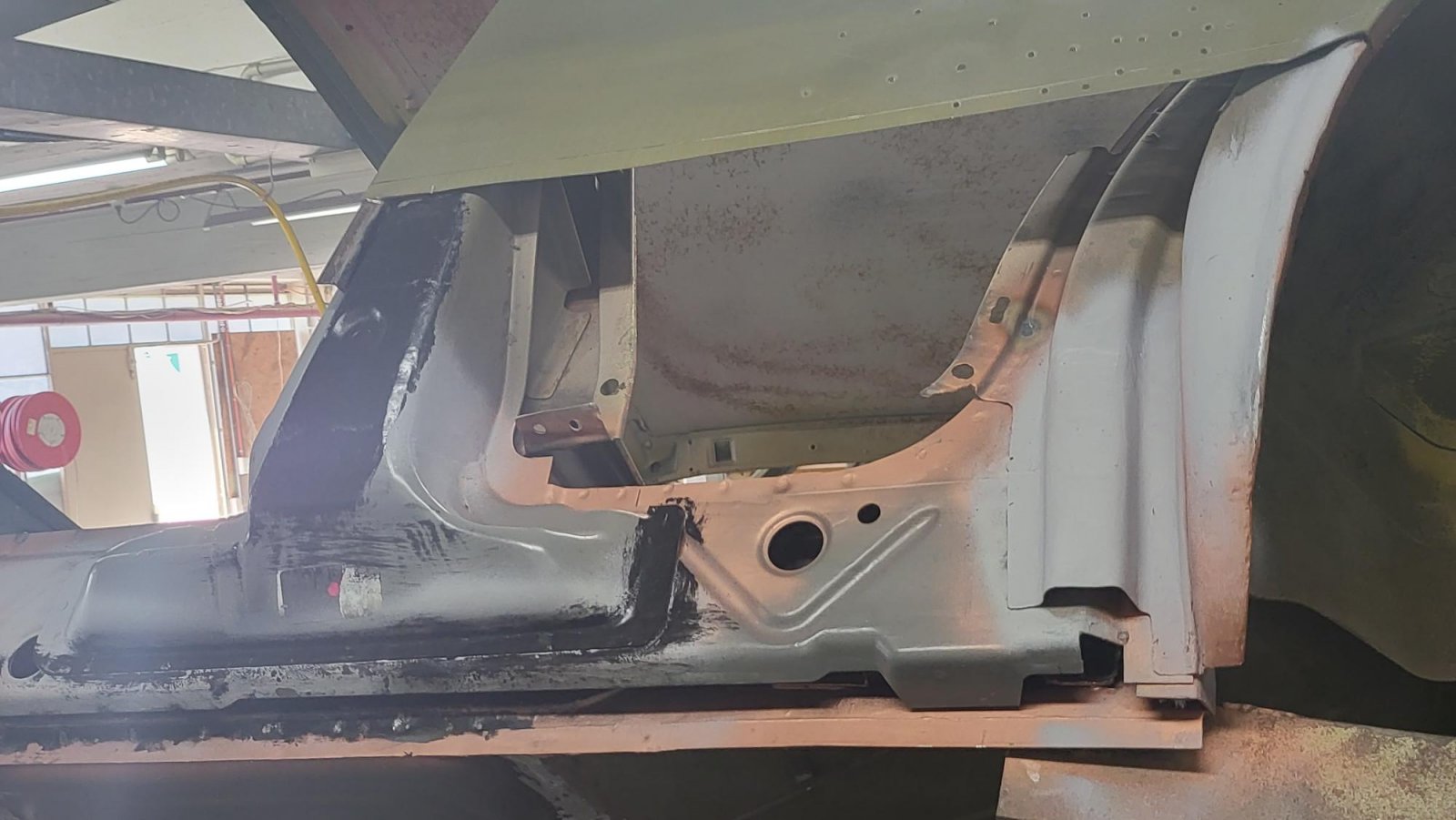

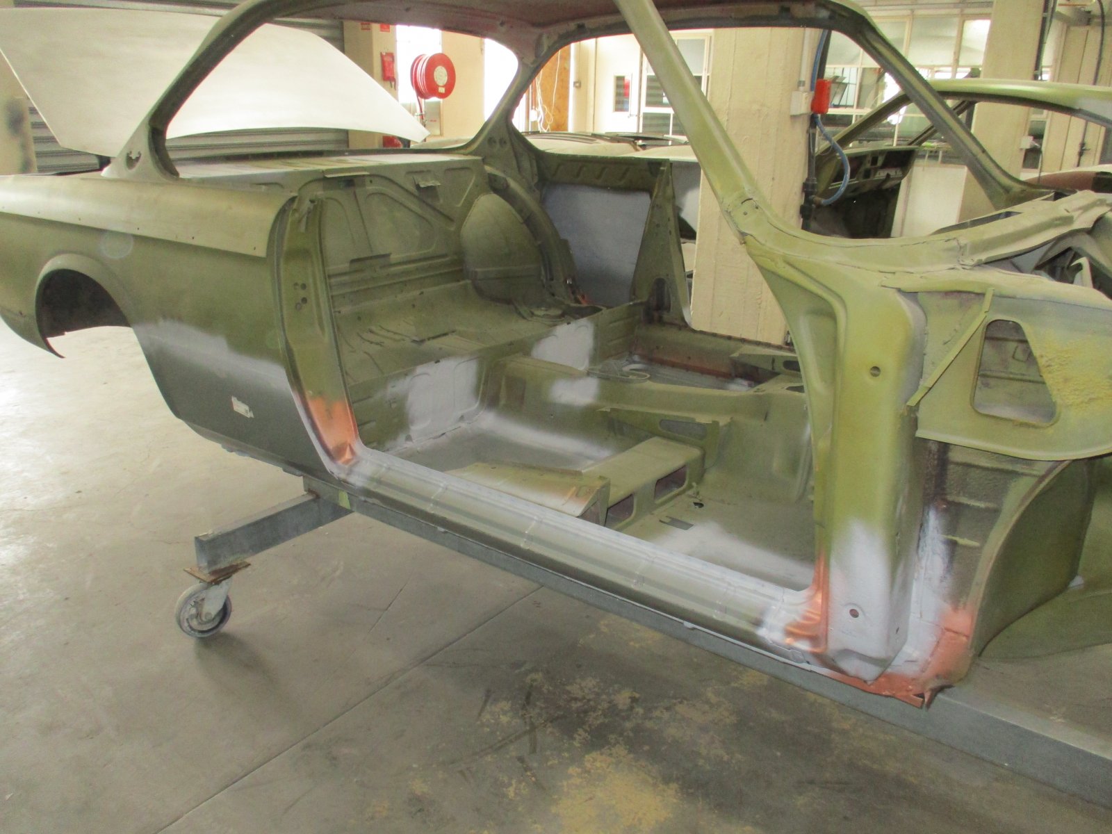

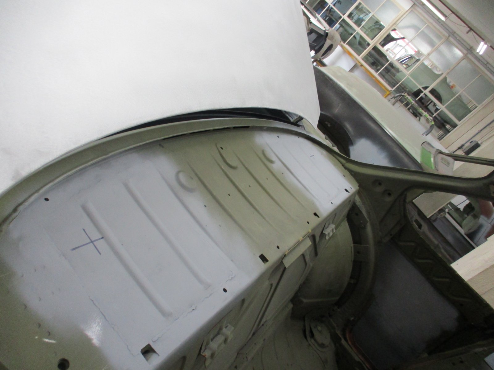

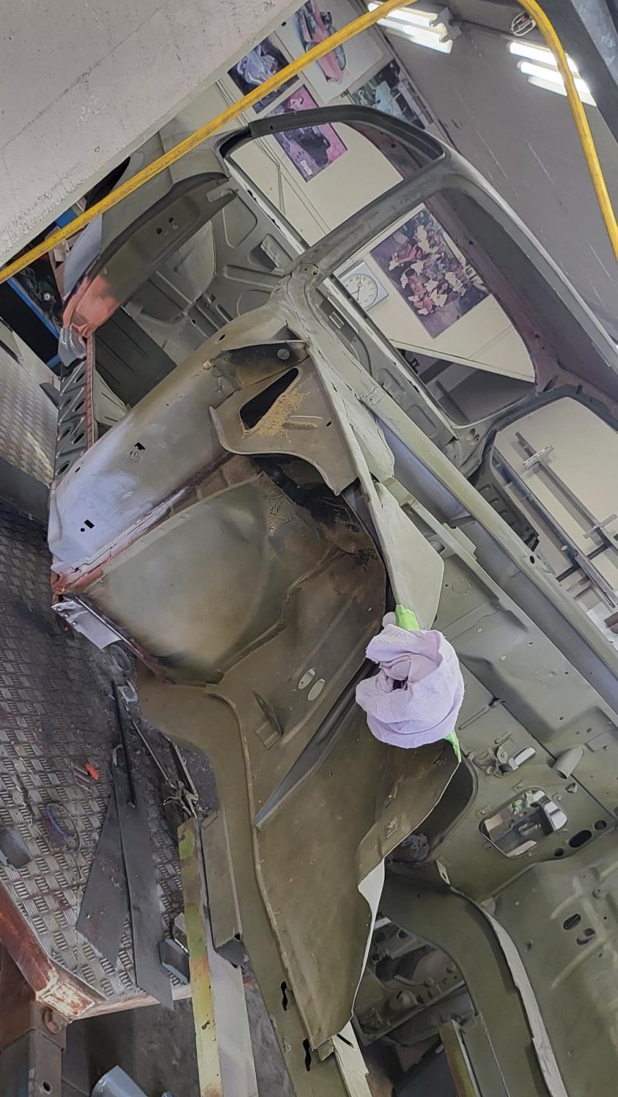

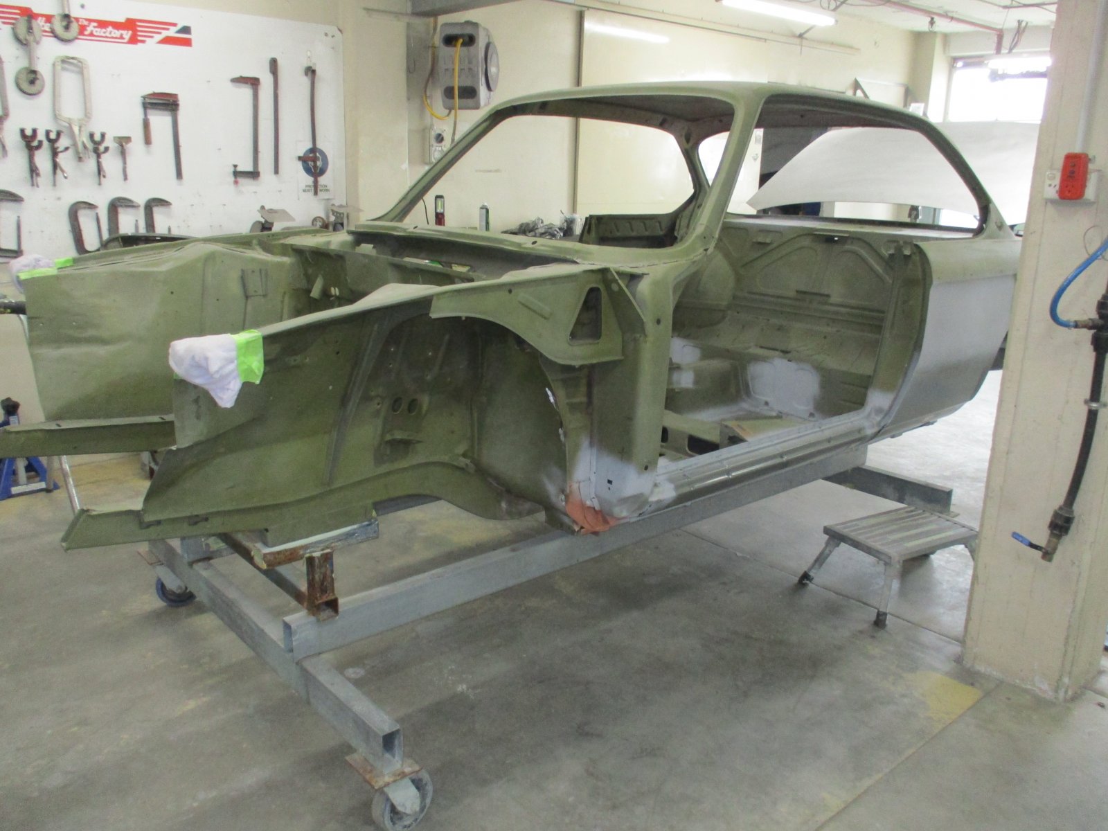

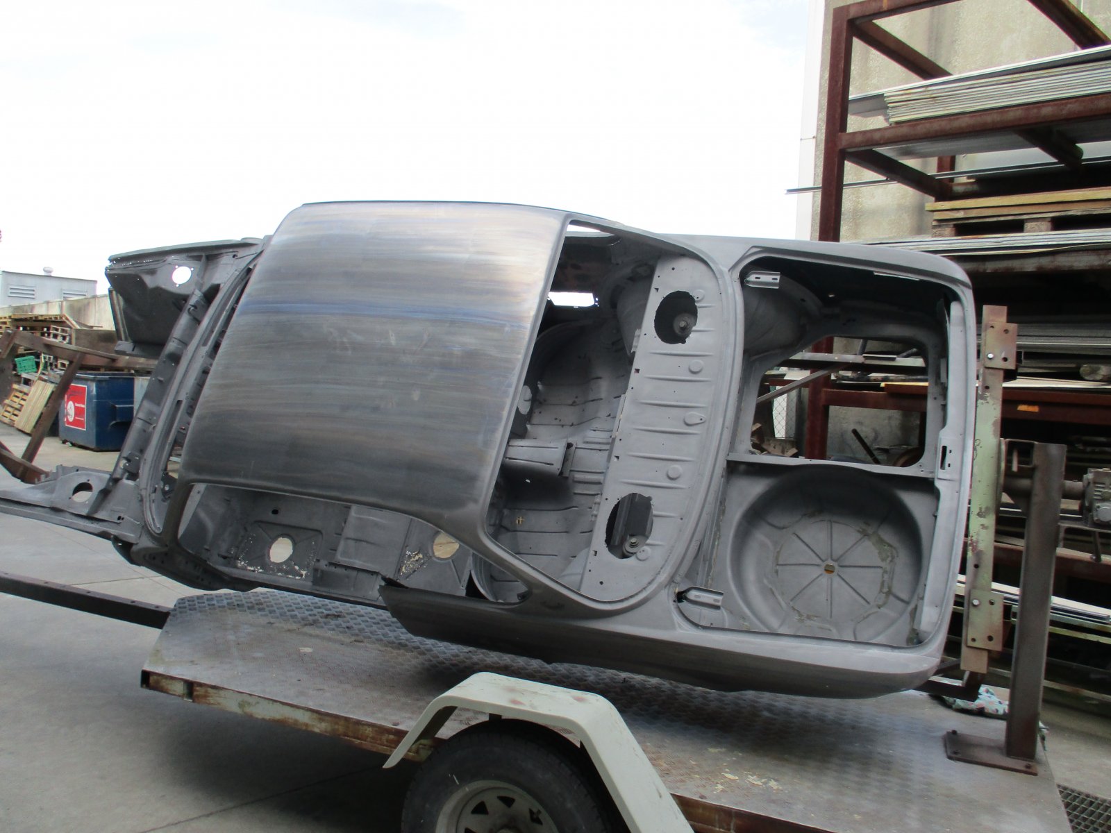

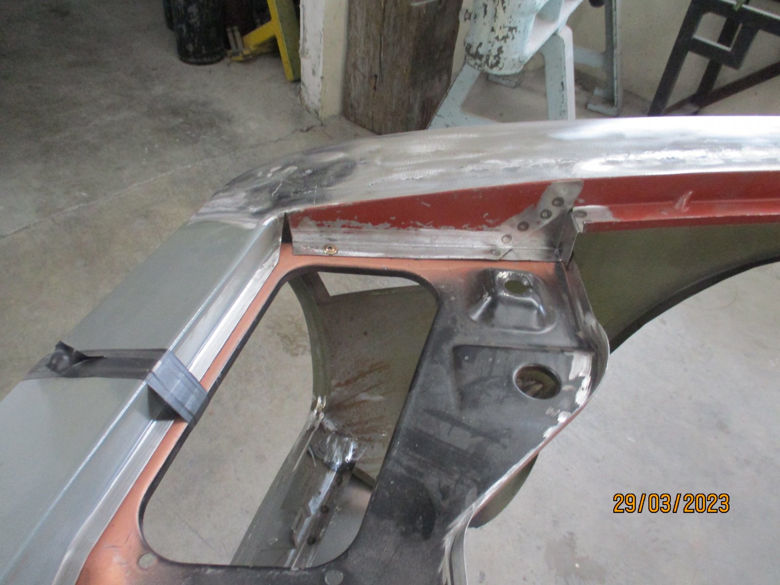

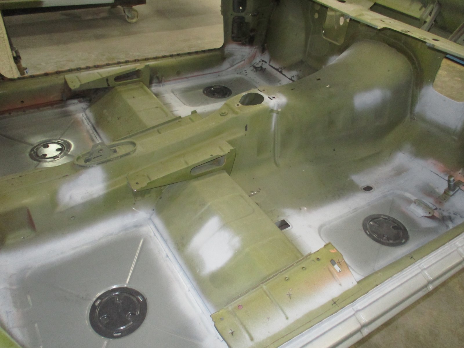

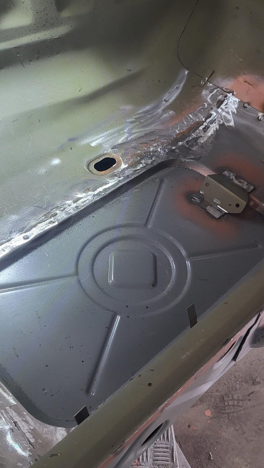

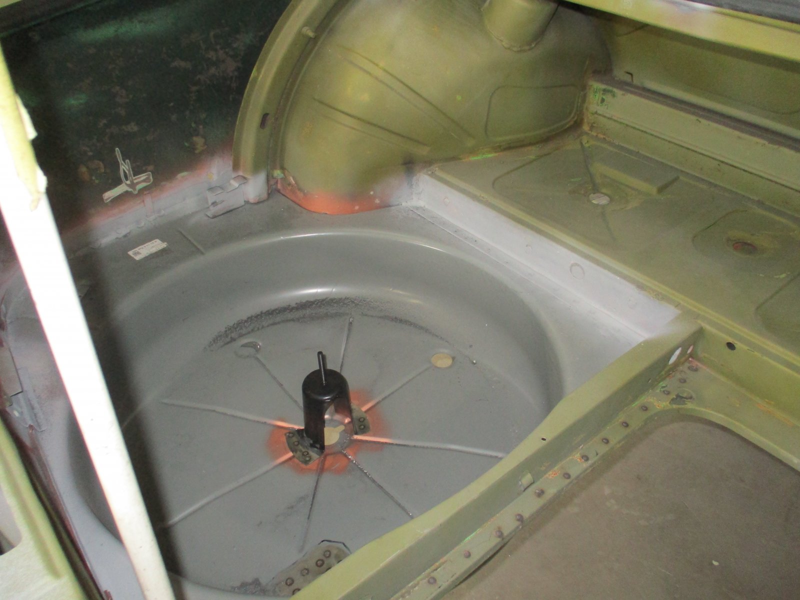

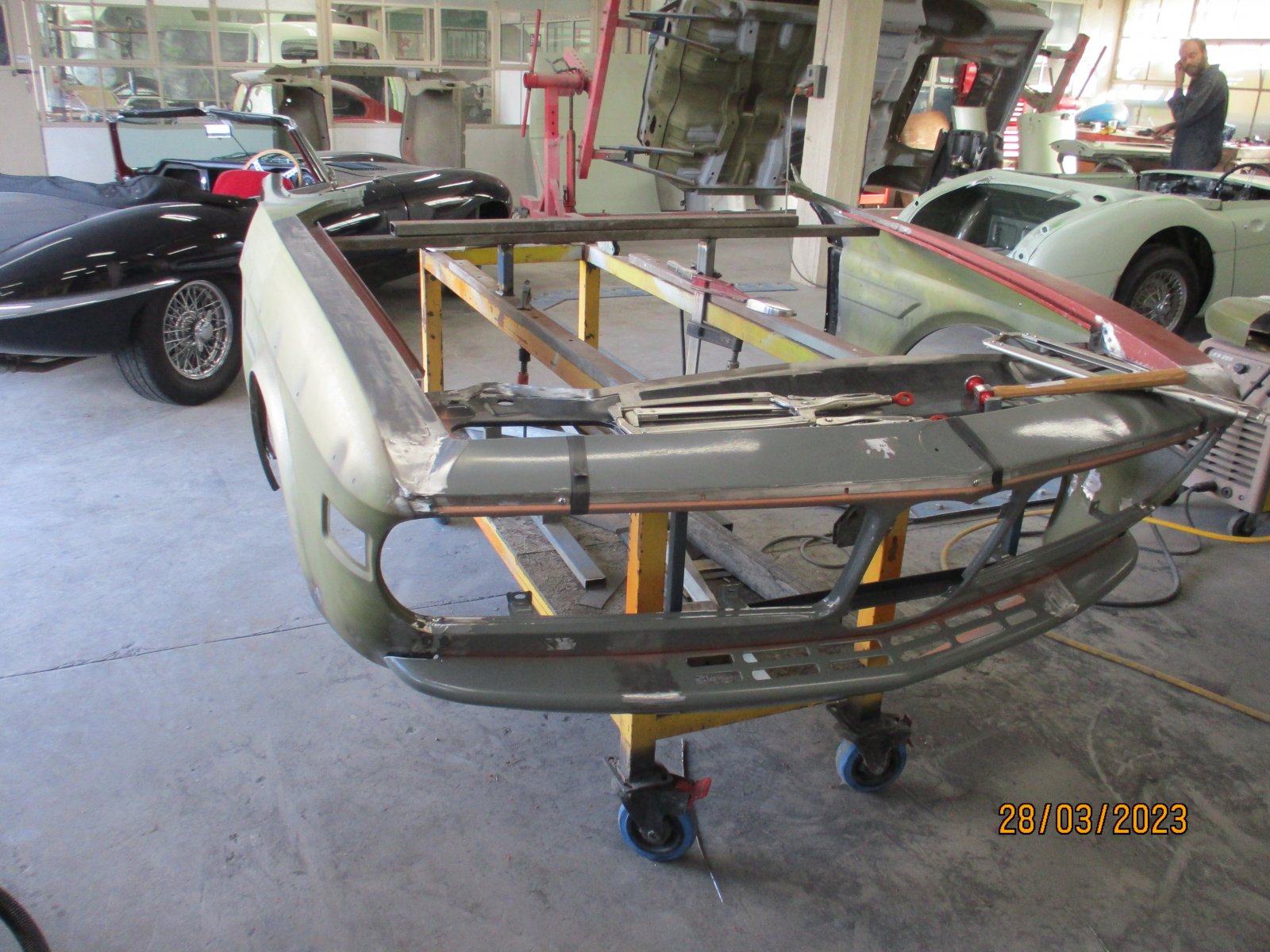

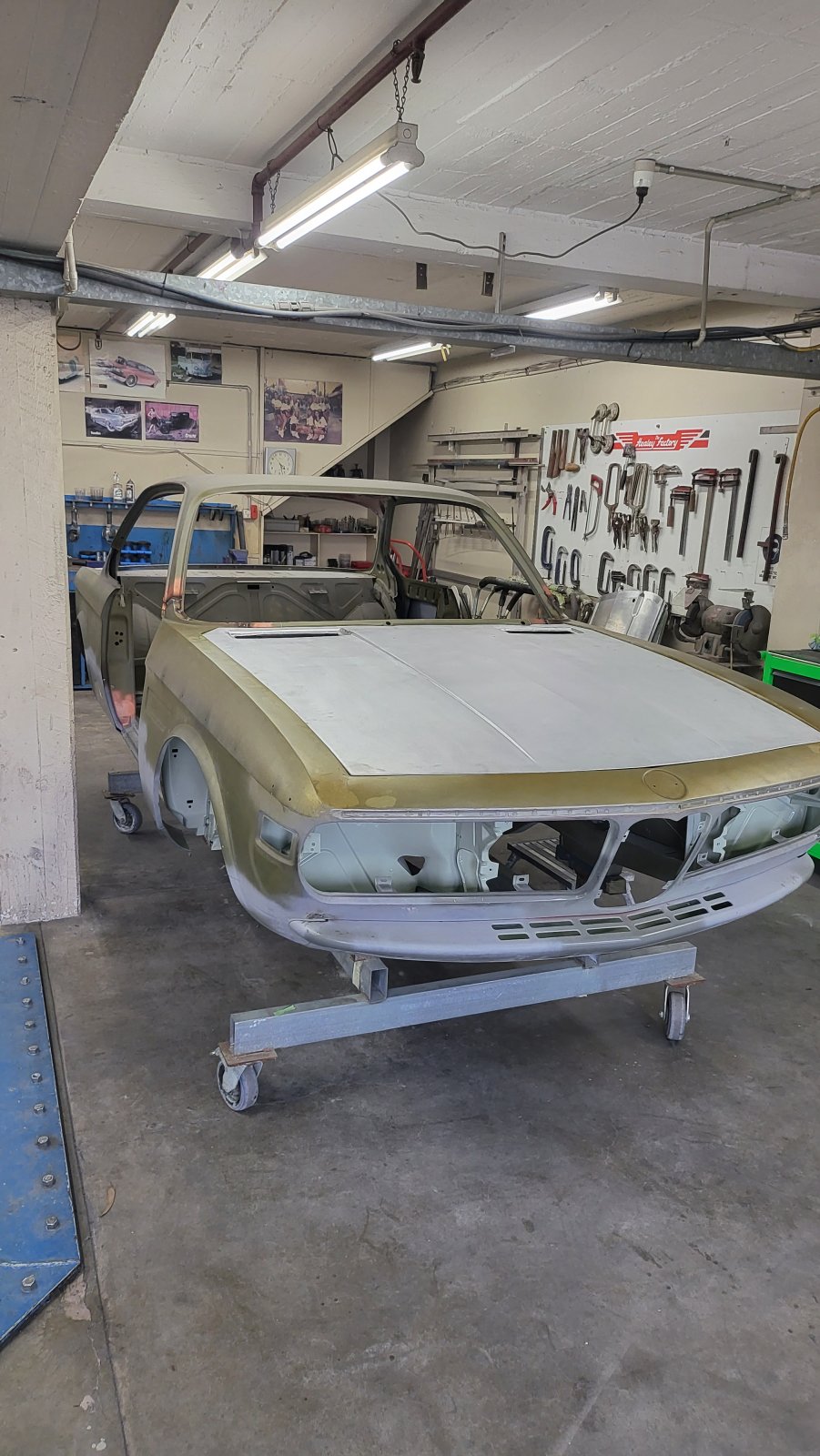

Front clip removed (with front gaureds still attached,outr sills and lower rear qtr panels removed, body sand blasted, gremlins exposed...
nose, guards, intermediate sills out, will get a full rebuild.

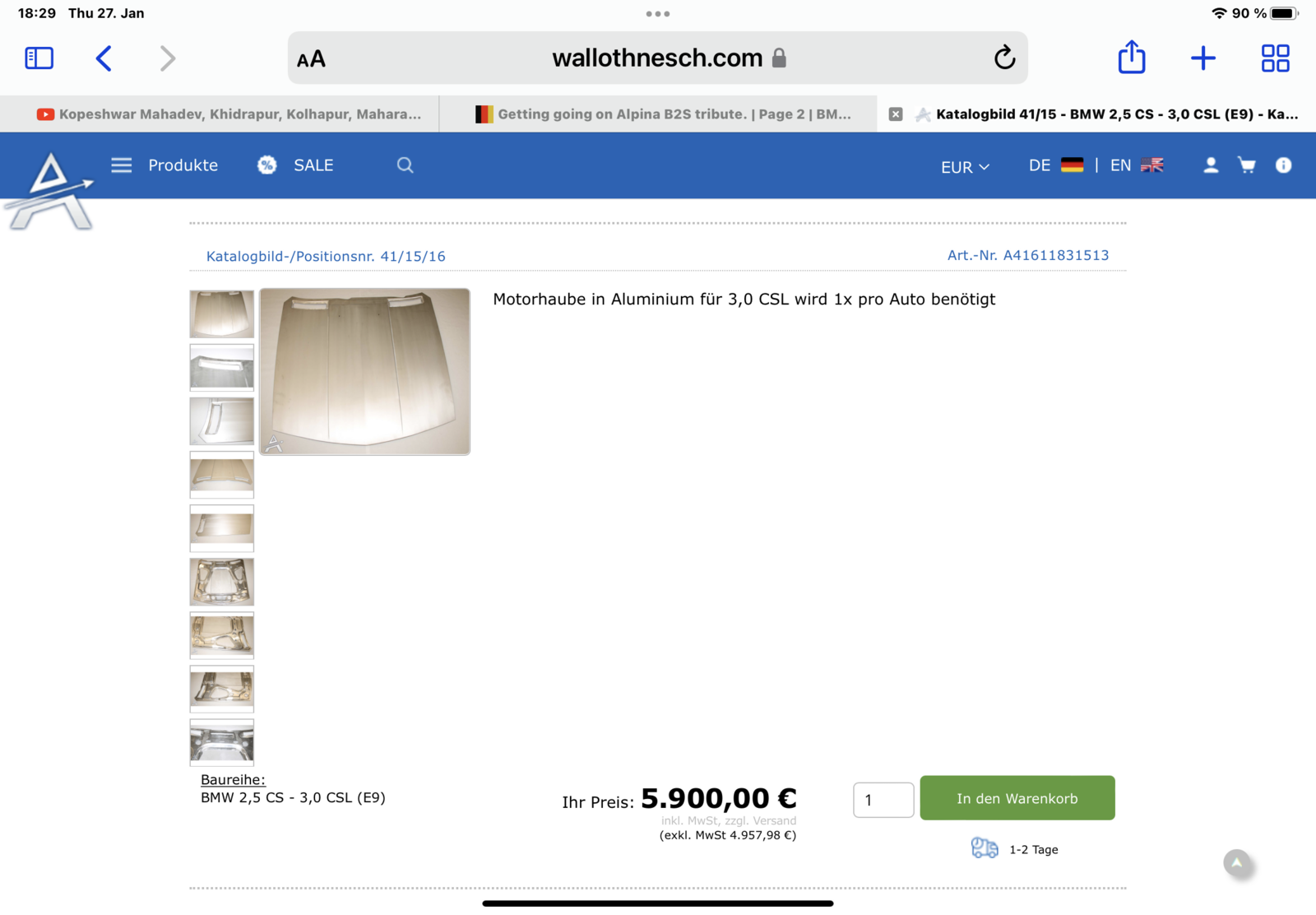

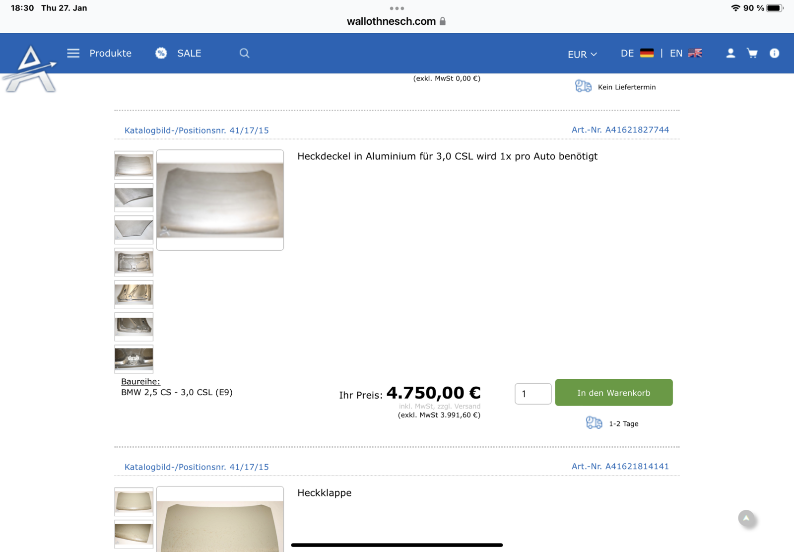

all repair panels, new / repro alloy boot and bonnet all purchased from Walloth.
here we go!!!

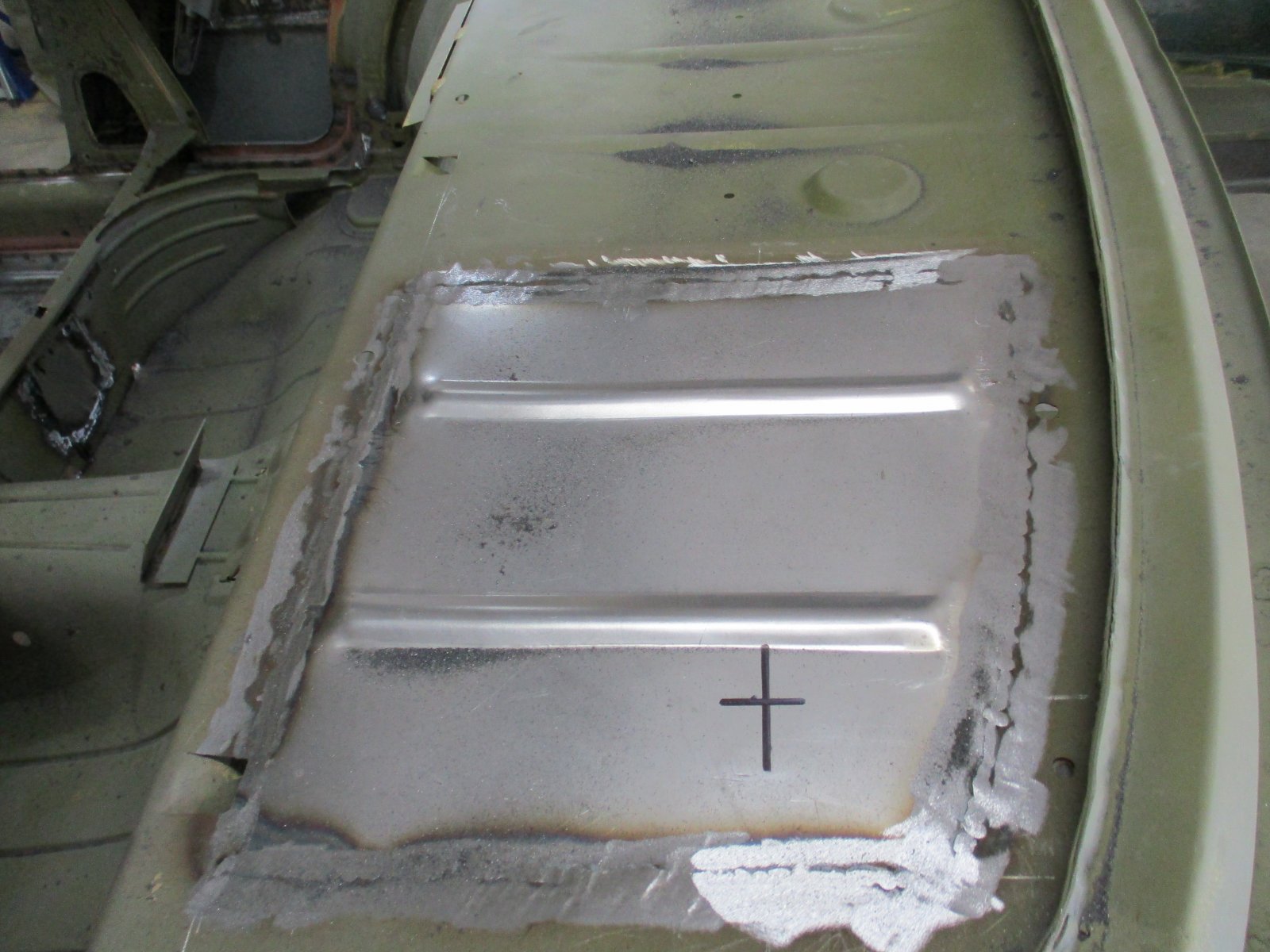

will also attach pics of some guard channel repair panels I am about to purchase.
Will give you feedback, once my panel guy gets them and takes a close look.

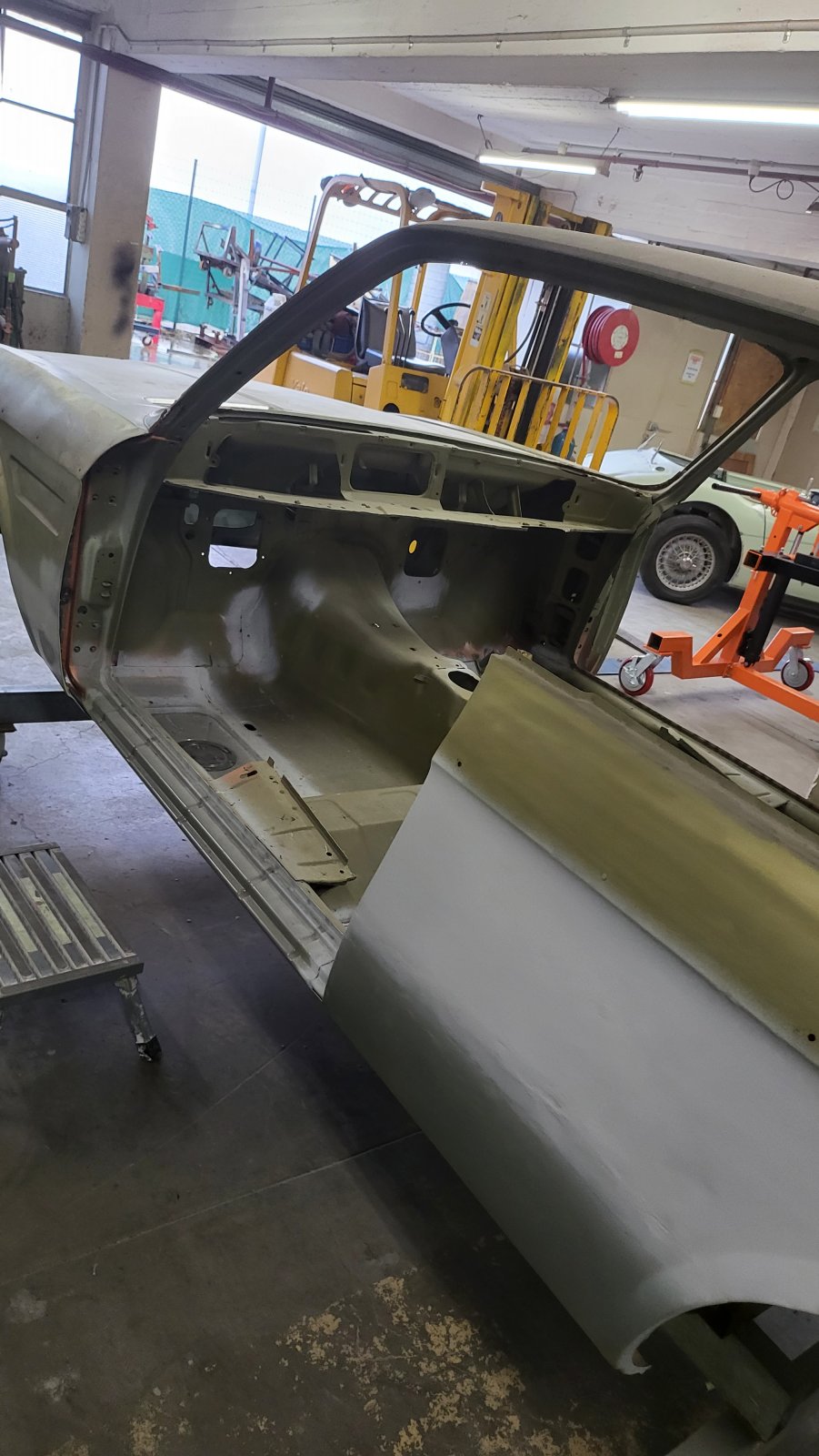

Moving along quite quickly.
This is the 5th E9 these guys have done now so have used the Walloth repair panels a few times.

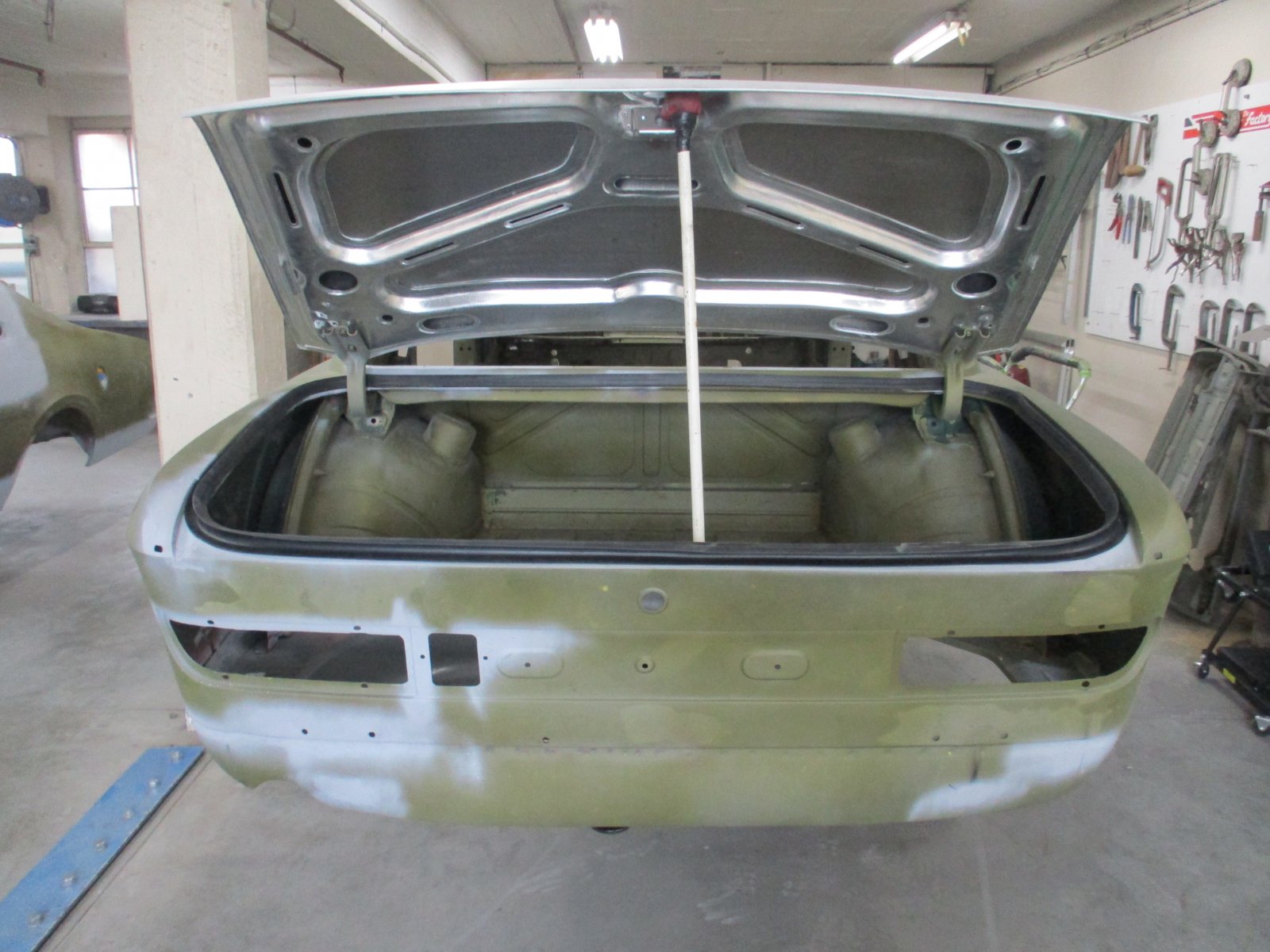

New / Repro Alloy trunk purchased from Walloth (made in Poland) has a very good fit out of the box (will need some fettling I am sure).
Now onto the doors and front...

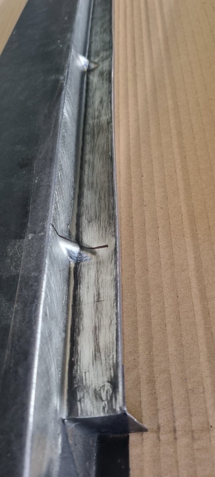

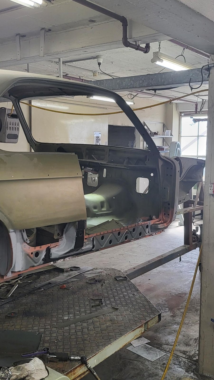

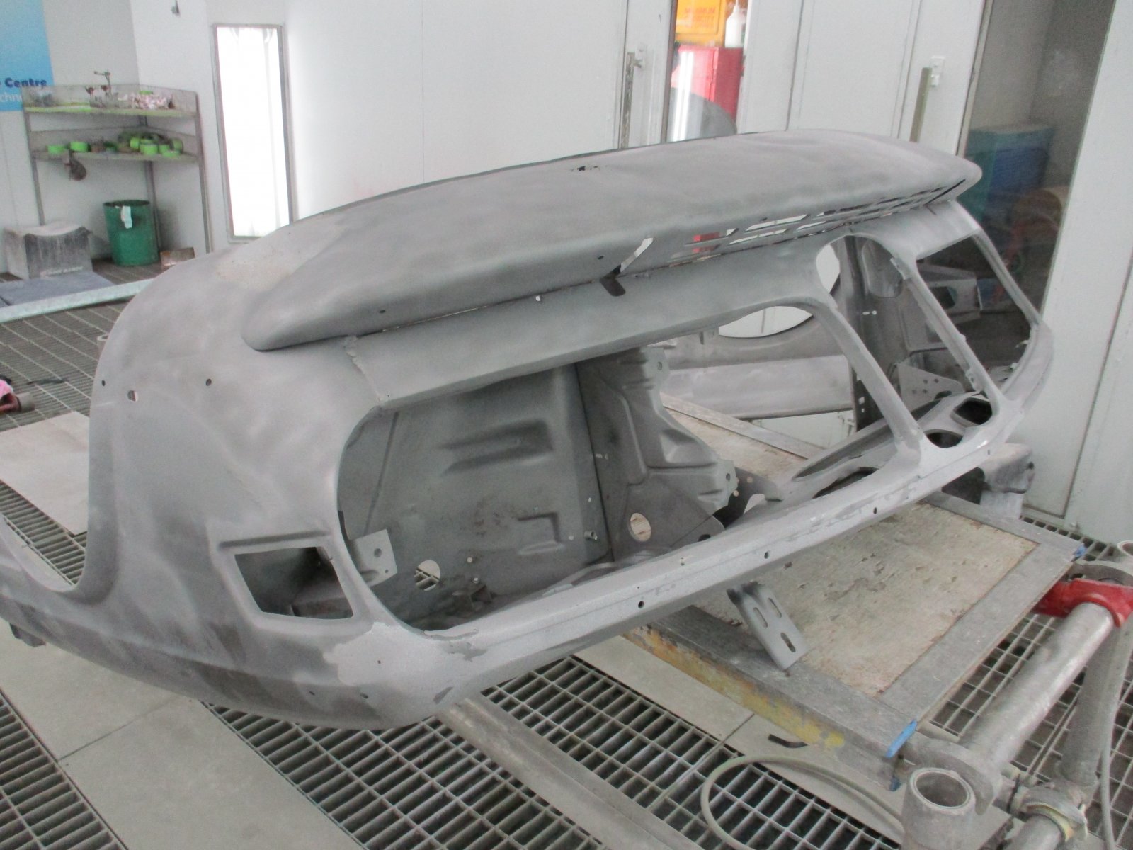

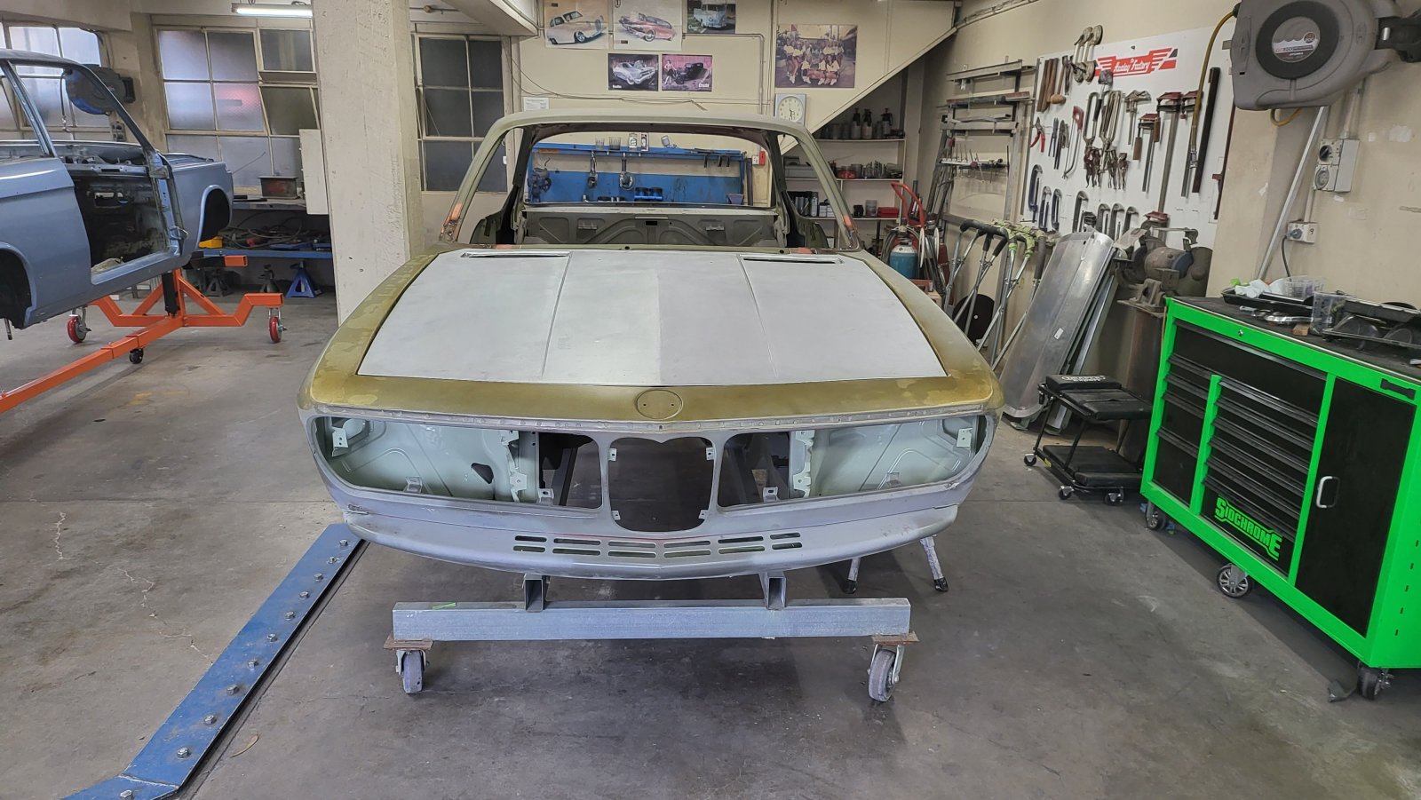

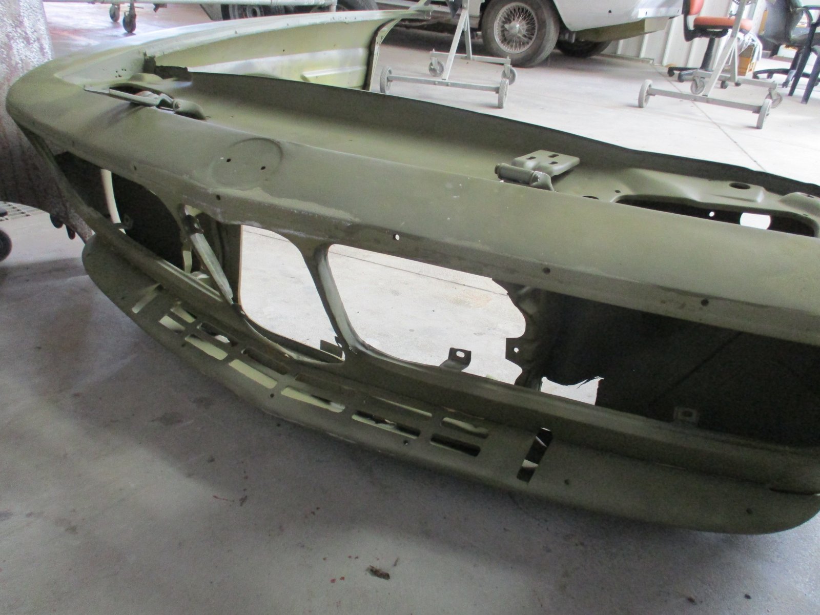

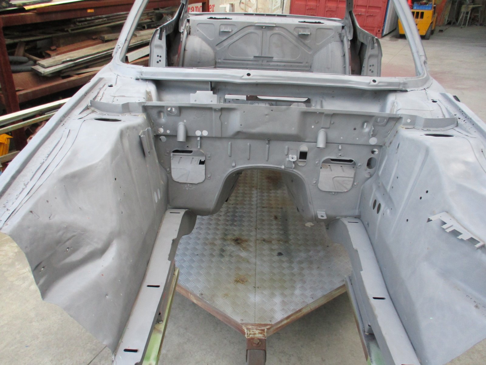

Gettting there. Chassis expoxy primed in front, in areas that would be sealed in, followed by underside of entire nose clip expoxy primed, prior to being reinstalled. This should future proof the channels / cubby holes sitting underneath the front fenders.

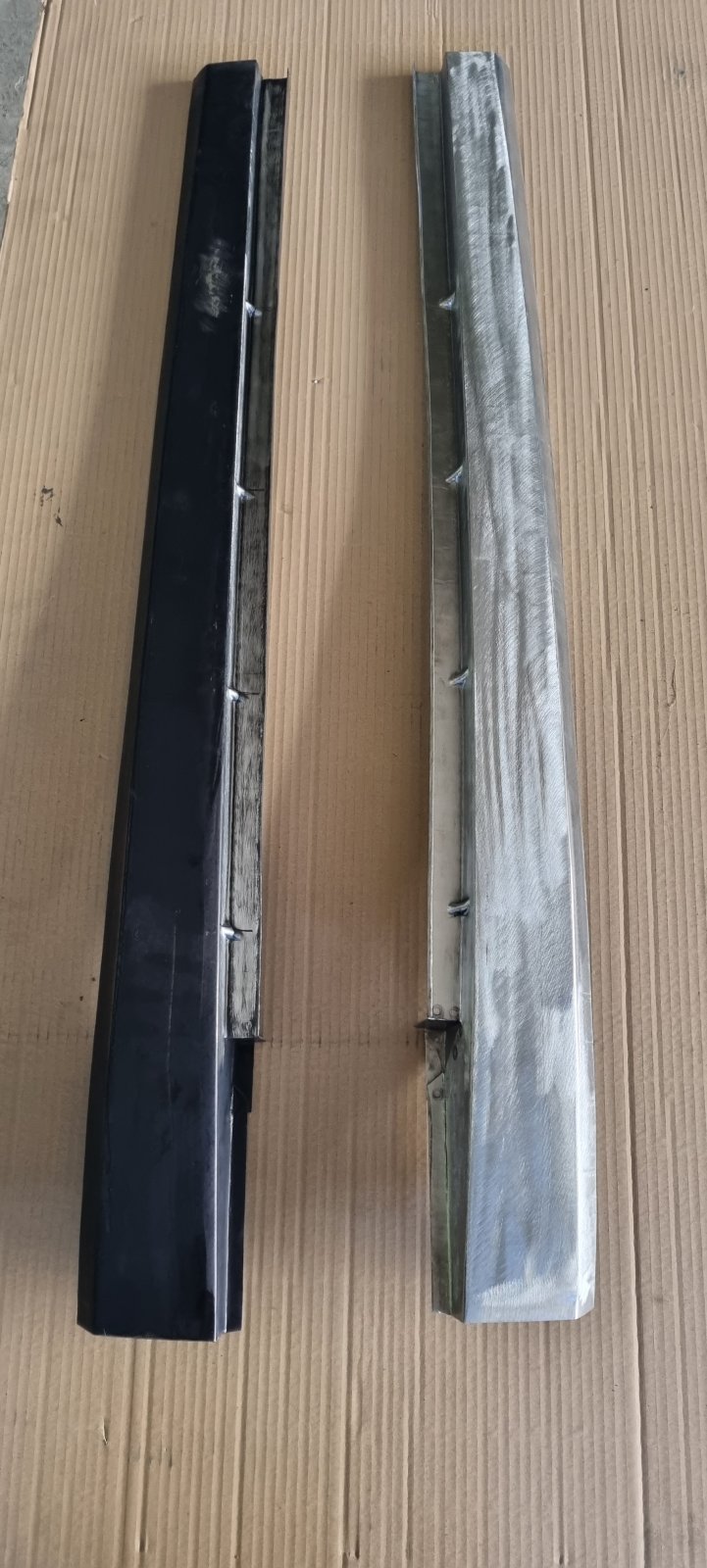

Waiting to fit doors prior to fixing the lower front fenders (repaired) to the sills.
Try adding the door seals at the same time. I’ve heard the new ones are a major pain. This way your door gaps will be correct.
