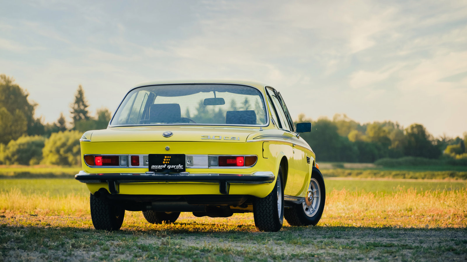

No piping under door cards, after market rear muffler with welded mount, missing seal under passenger door, as Don mentioned the thermostat cover has a bolt and nut arrangement, must have snapped the studs. And the underside was never body color.

Yeah yeah. I spotted the missing welts, roundels on the vent window knobs, 1970 seats, black wipers, missing rivets on the Karman tag, touch up paint on the doors, wrong bolts in the upper door hinge, missing white caps in the doors/rear wells, wrong bolts on the HL panels. Yes we could go on, but why? As I said to a friend this morning "This stuff is all trivial. Let's give the new owner something to tinker with!"
This is just a standard and very attractive CSI. I see no reason to pick it apart, other than getting clarification on the VIN plate, and getting pics of the firewall VIN. Circle back when it is at $200K then complain about the fit and finish. :)

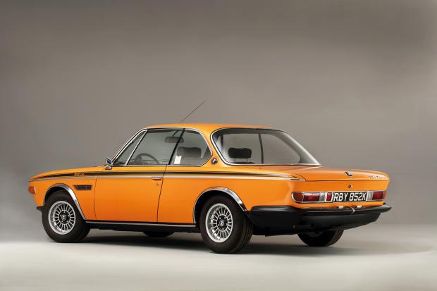

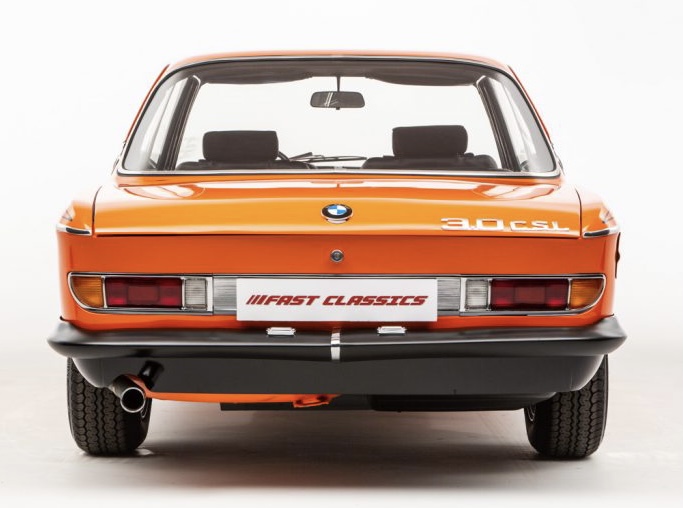

I think this is a valid restoration preference for those wild 70's car. Take a look at the two CSL's below. One has an orange well, and the other is black. I think the bright wheel well looks particularly strange when the rear valance is painted black.
I think the black valance looks horrible, but, because I deal with salvage and rebuilds everyday I immediately think of an aftermarket or new panel that hasn't been painted yet.

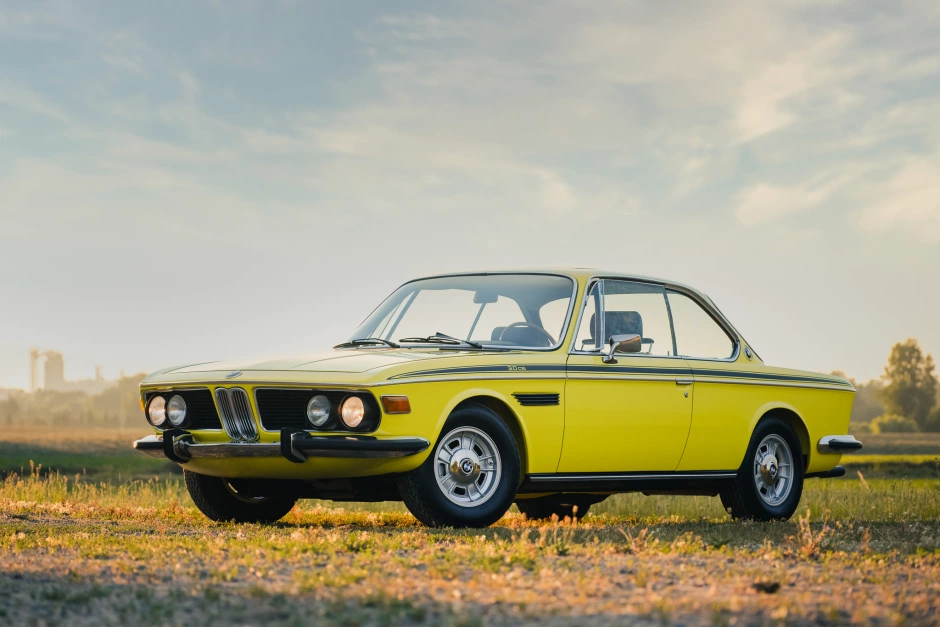

This is funny. Your discussion made me all curious. First impression: overall nice car. Second impression: first 43 pictures are useless.
Pic 113 - Leather looks very soft and far thinner than works material. May crinkle in a minute.
Pic 114 - Leather is folded at the sides of the front backrest. Common for reupholsteries, original supplier managed to do it without.
Pic 144 - Stamped "60". Original colour was Polaris Metallic, if this is the original Karmann plate. I'd expect it to be rivited to the car. Not to mention the door brake.
Pic 151 - The coolant reservoir changed from black painted metal to beige plastic in autumn 1973. May be correct depending on production month.
Pic 155 - Later valve cover. Oil cap should be at the front. This one came with the L-Jetronic in mid-1975.
What is hidden in the boot? Still no pics yet.
Still: can be a nice car. But 100000 is a lot of money, regardless of currency, especially for an E9 without rust protection but with numerous small imperfections.
It’s a legit CSL thing. “Chrome arches” also look horrible. Not because they *look horrible, but because you associate them with some other non-bmw thing that is horrible. Altezza lights looked great on the Toyota Altezza!
