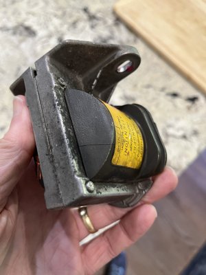

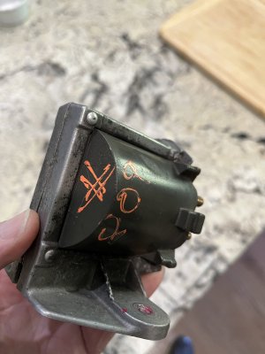

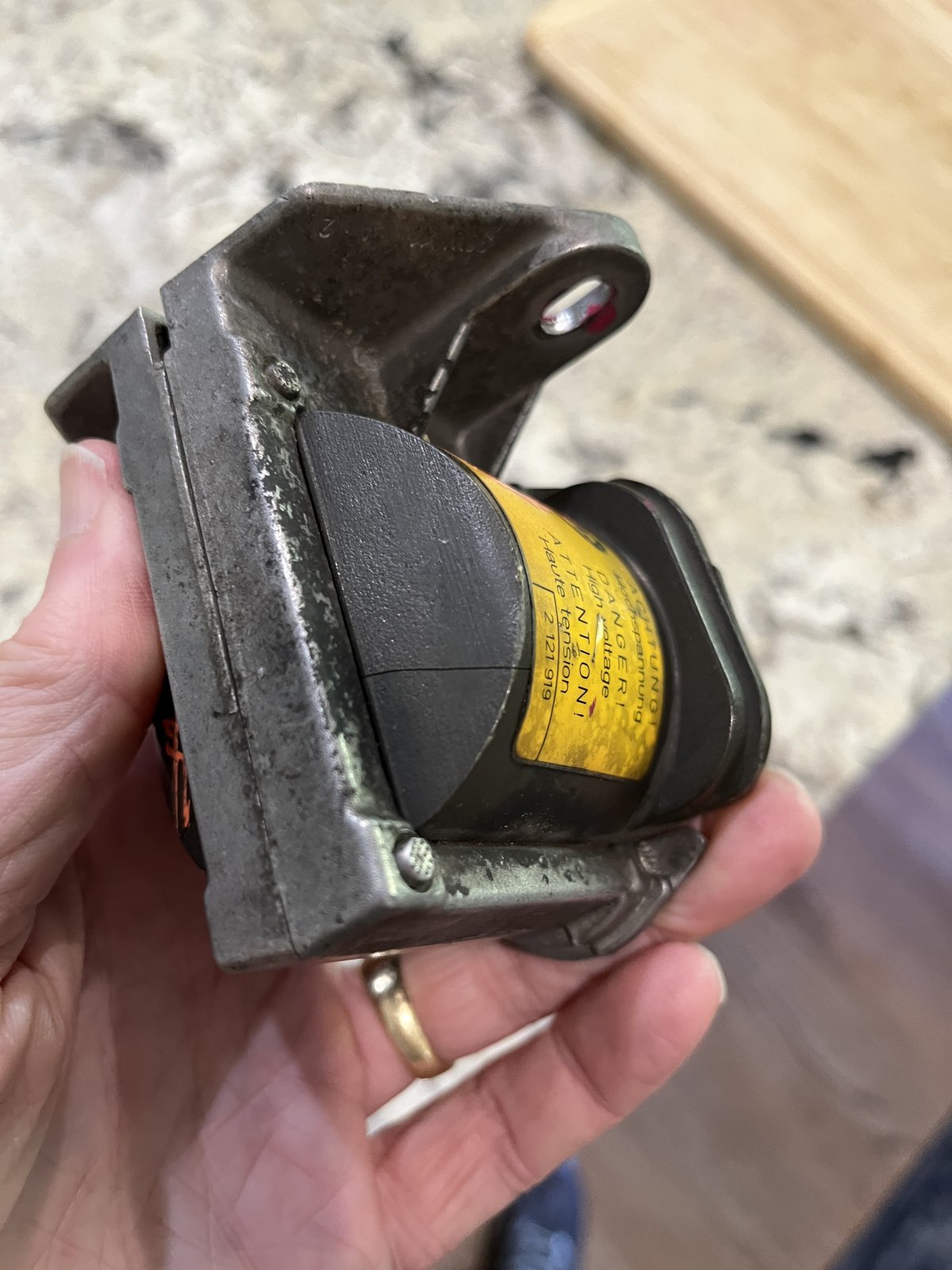

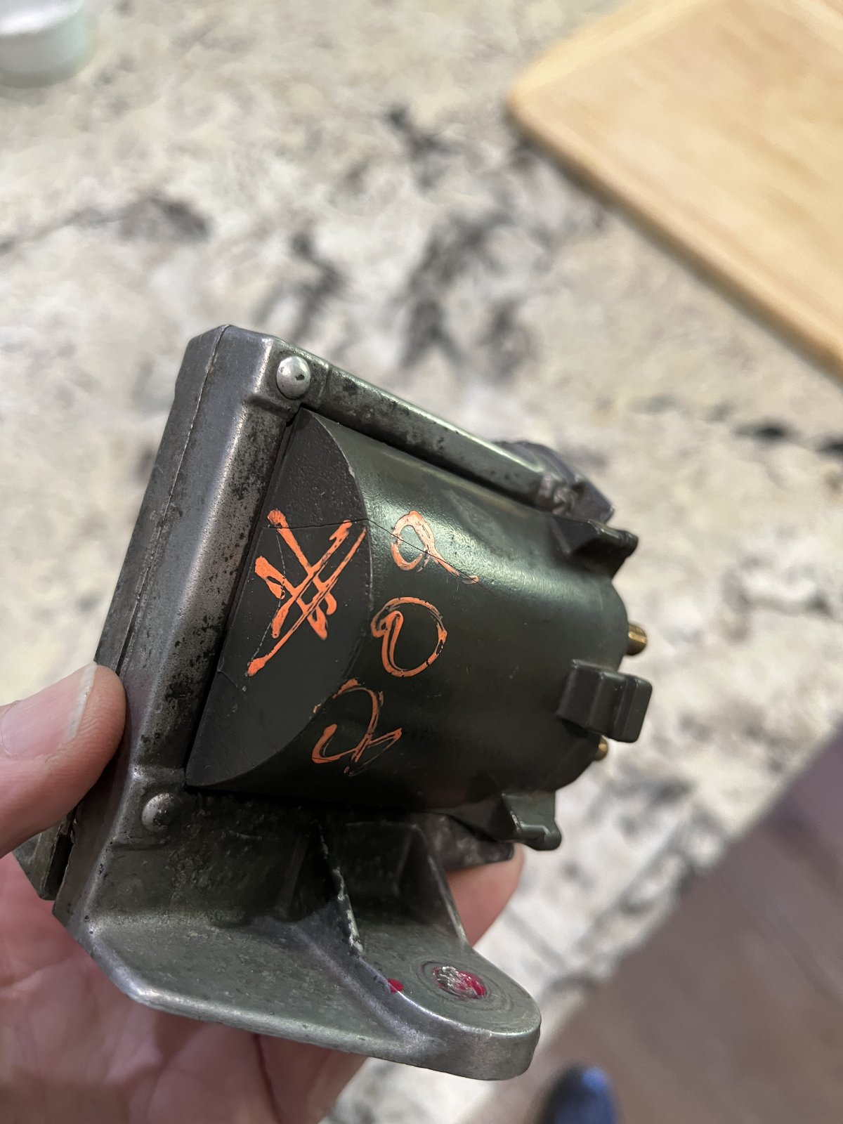

well guys, thanks to Steve's suggestion, we might have identified the problem. I checked my coil and the connections seemed secure. After removing it, though, I noticed two small hairline cracks (attached) in the bottom that run up each side almost symetrically. Chris' theory is that my coil might be arching from these cracks against the radiator support that's located close by. How did this happen? I think the movie studio had my car in accessory mode for prolonged periods waiting for shots and maybe the coil cracked from the pressure created by that situation and not delivering spark to the motor as it is supposed to do. This is my car's first and last movie, by the way. They say they take such great care but this situation and the rock quarry dust I had to remove from some many places is not worth what they pay you.
I'm going to install a new coil next per Chris/Don's suggestion and it likely won't be this same unit as you can only get them used now...

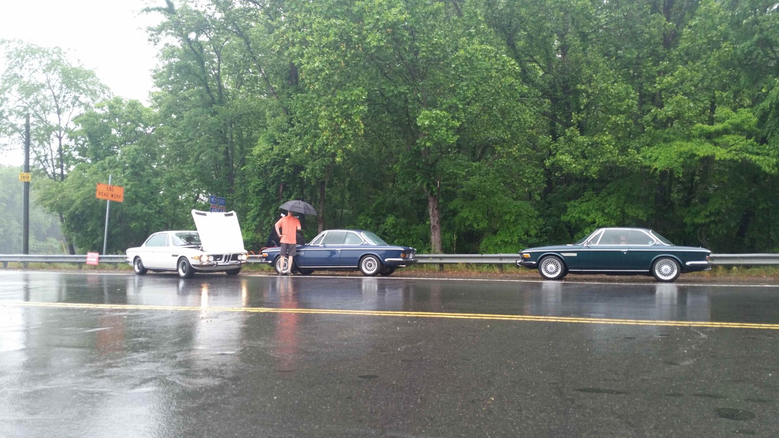

Wayne - Let's return, shall we, to the 2017 Vintage. I recall driving in the pouring rain when Tom signaled me that he needed to pull over. His drivers' side wiper blade had departed his vehicle at speed and he was left without a wiper in the pouring rain. We pulled over, switched the passenger side wiper to the drivers' side, and safety wired it on so he could make it home.
Now, if I remember the sequence correctly, during the stop to repair Tom's car, you had a hard time restarting your car. I remember giving you a jump, which for some reason got you going again.
You then had trouble restarting later at the pump when we stopped for gas.
After we got home, Tom determined the problem was electrical, and, I think he did a wiring repair in your trunk. Not sure if this was fuel pump related; memory is a little hazy here. Anyway, I toss this out there following up on Arde's comment.
