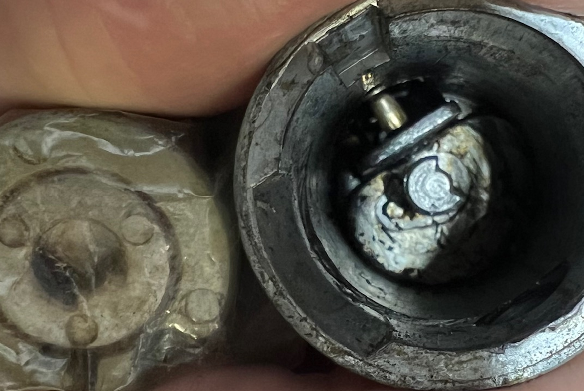

Here you go.
Below you can see the little lug that protrudes from the key tumbler.
It was previously broken and I thought this was the issue so had it replaced.
The lug engages the nylon bush on the shaft, see below.
Here is a pic of how they engage.
Something still isn't right though. I notice that when it's all put together and I rotate the key it doesn't engage the steering lock. This tells me perhaps there is something broken inside the key tumbler too?
What am I missing here?
Perhaps the issue is with the electrical switch that goes in the back of the barrel?

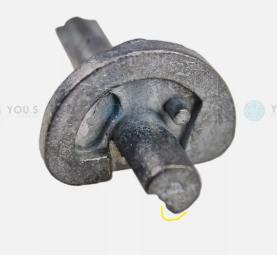

Your intermediate shaft shows enough wear that even a new lock cyl might not be able to transfer enough rotational travel to the electrical switch to activate the last "crank" position. I'd be very pleasantly surprised if that e36 (?) part would work - ask seller? Could just be the ebay picture but a nice sharp corner is what the original would have. Other picture shows one with some wear but still working.

I did solve it, 3 E9s ago :)
@sfdon helped me out. You need to replace the barrel components - think we used an e24 - and then also the electrical switch that mounts to the back of the key barrel. The interface between the two sections gets worn down. You will be able to rotate the key but nothing happens at the 'crank' position as the two mating surfaces slip.
