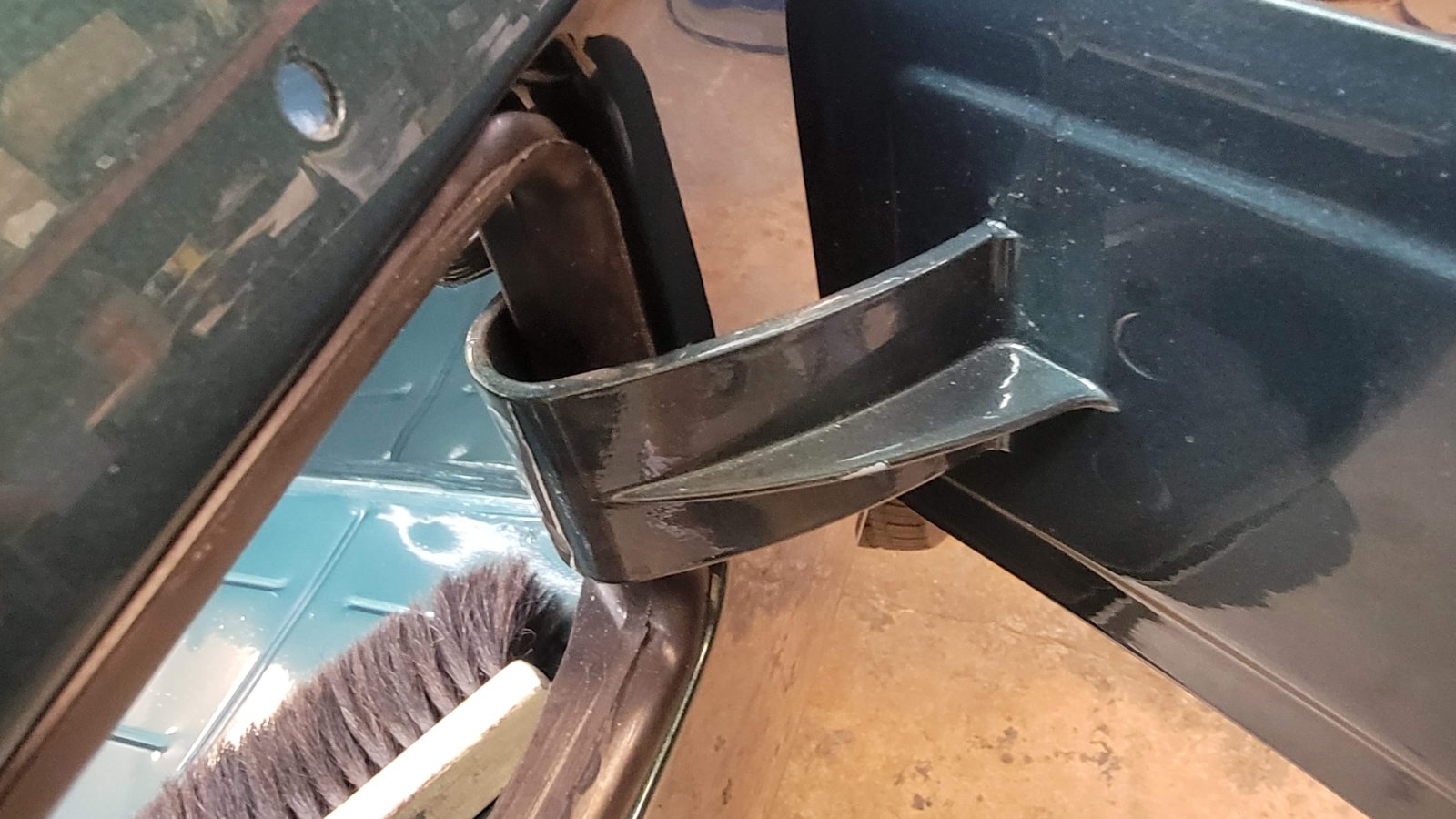

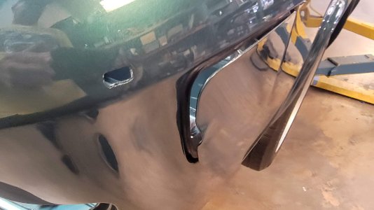

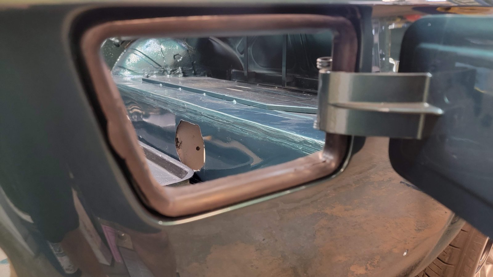

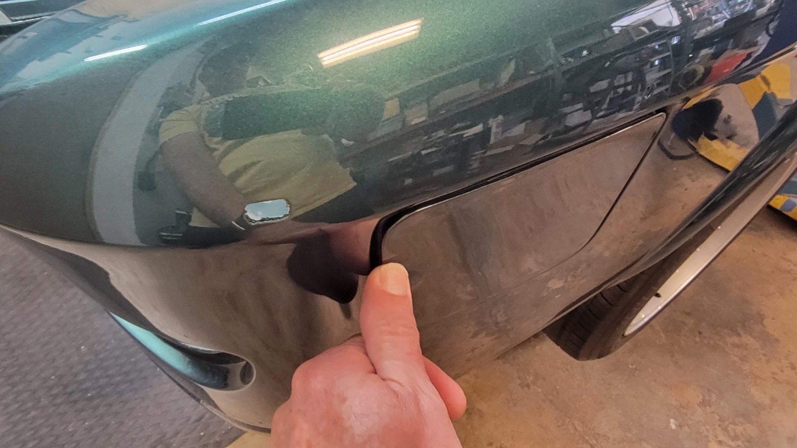

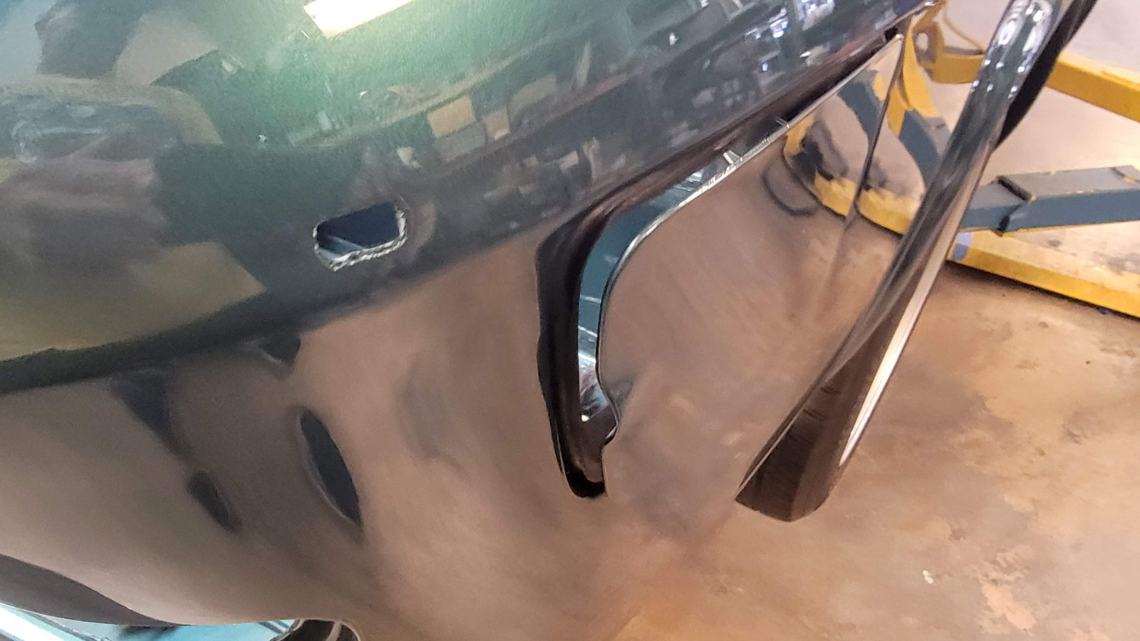

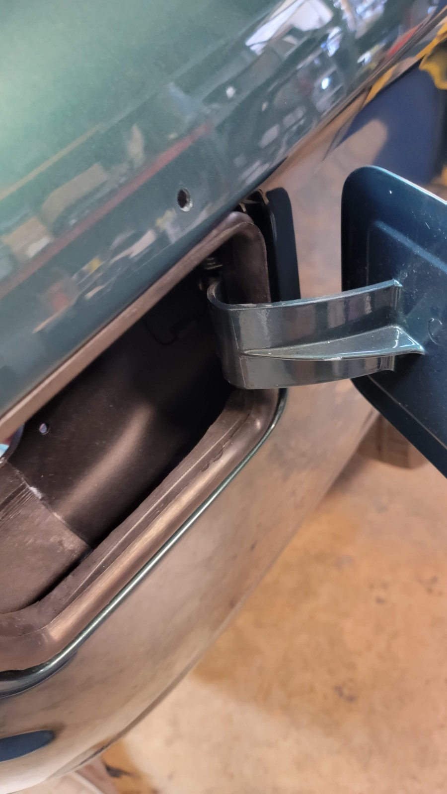

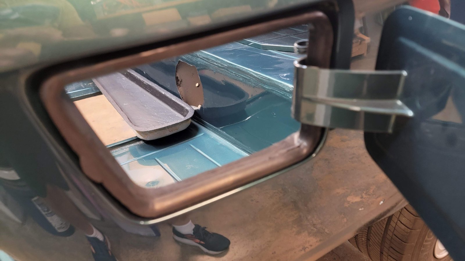

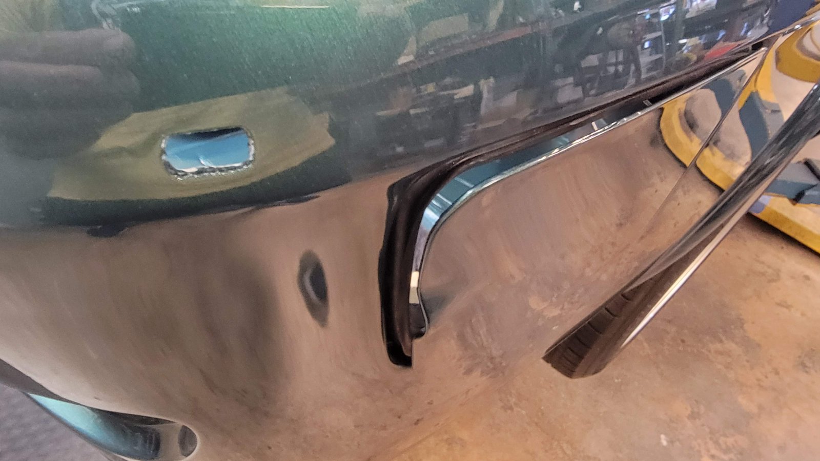

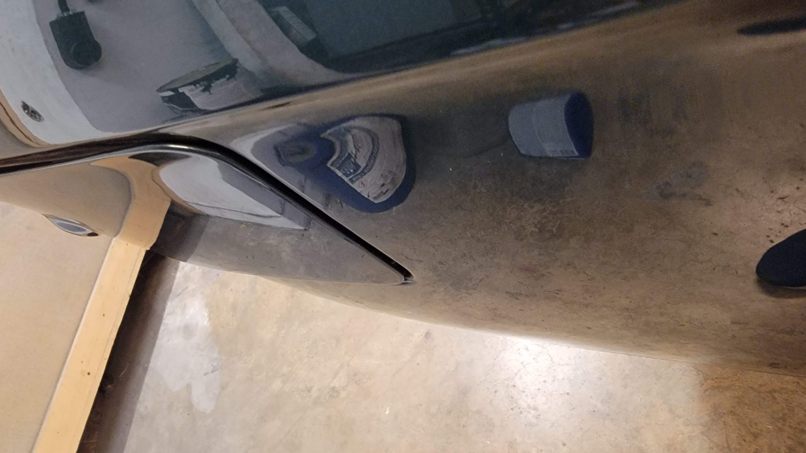

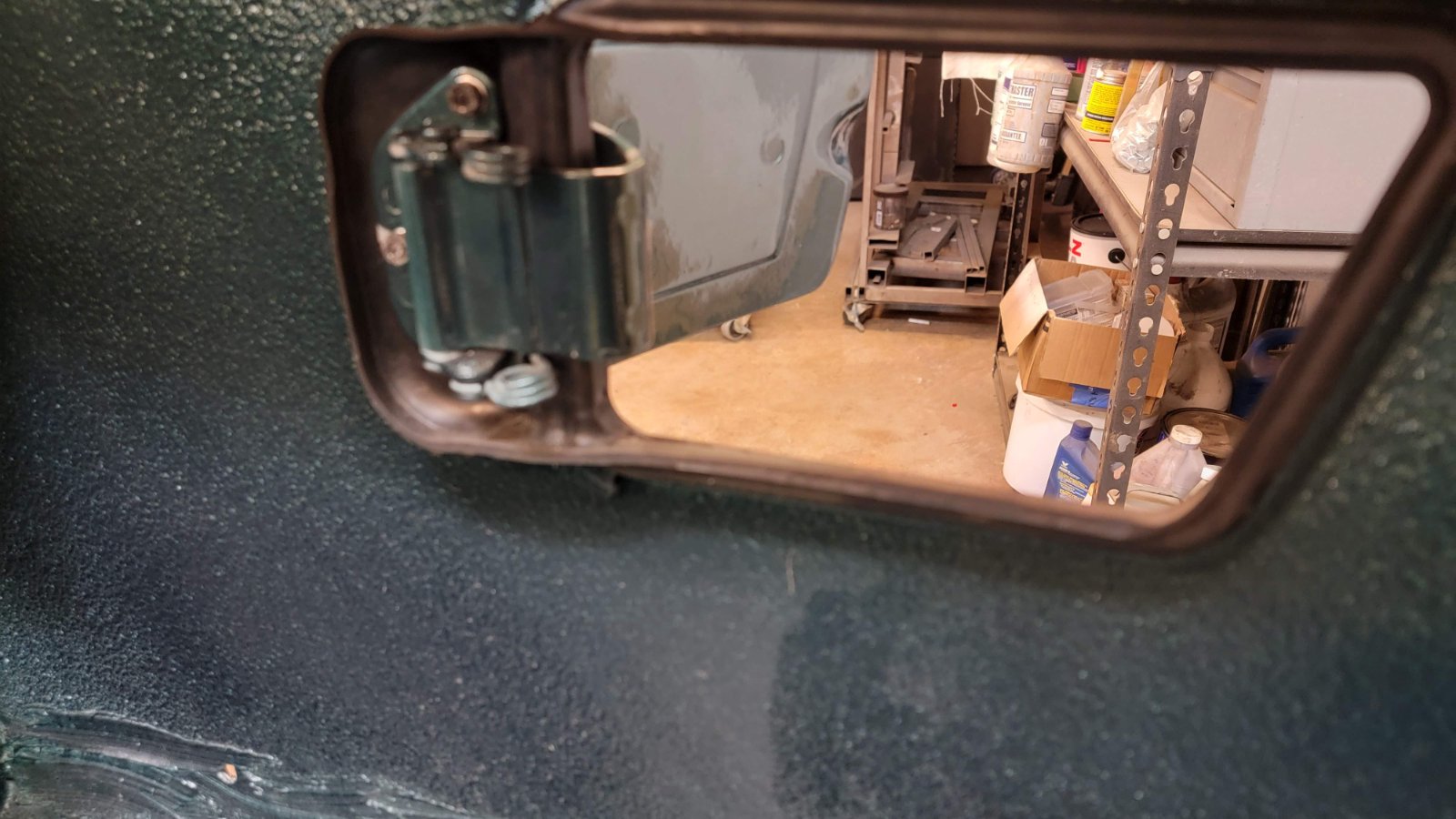

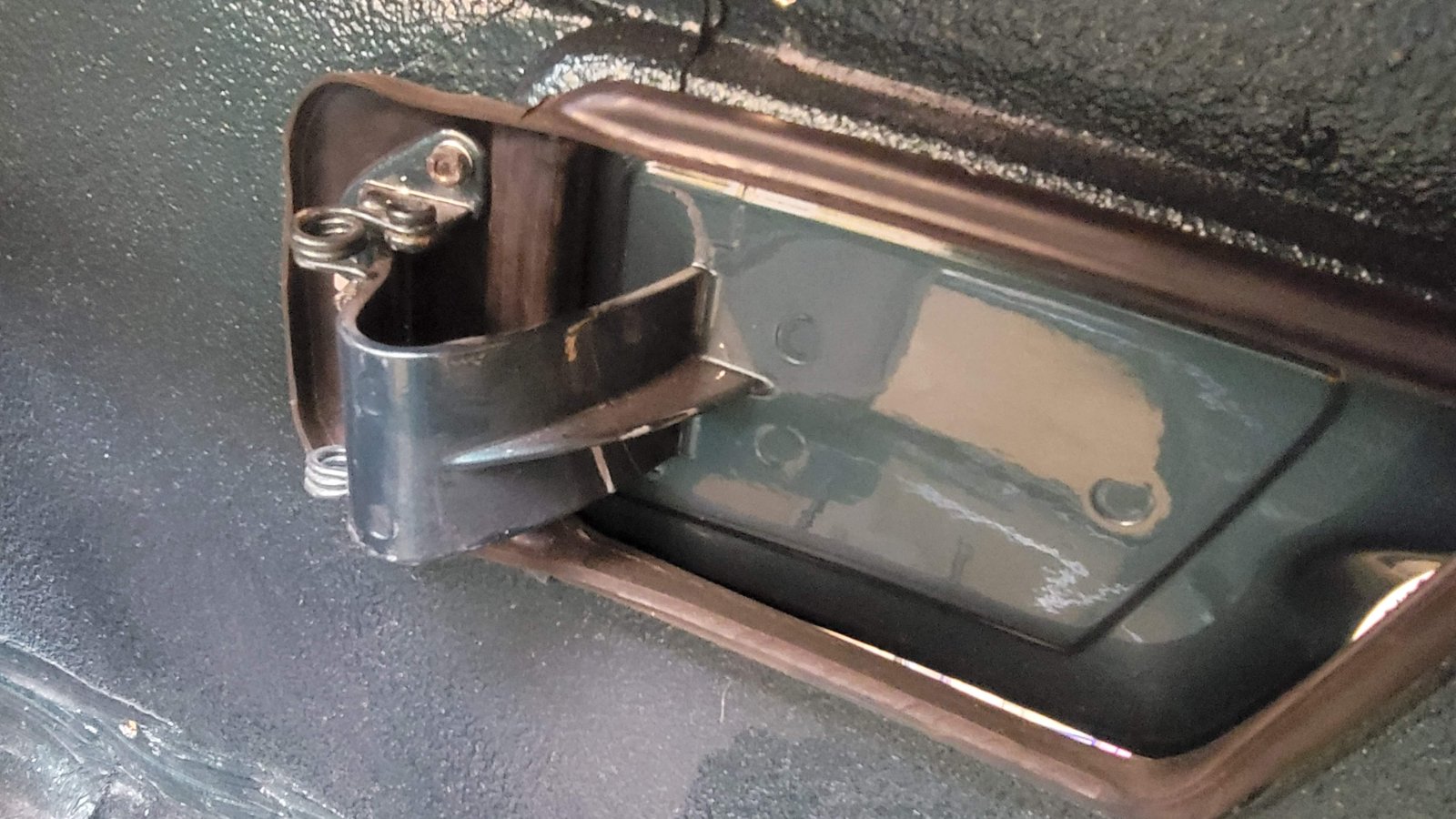

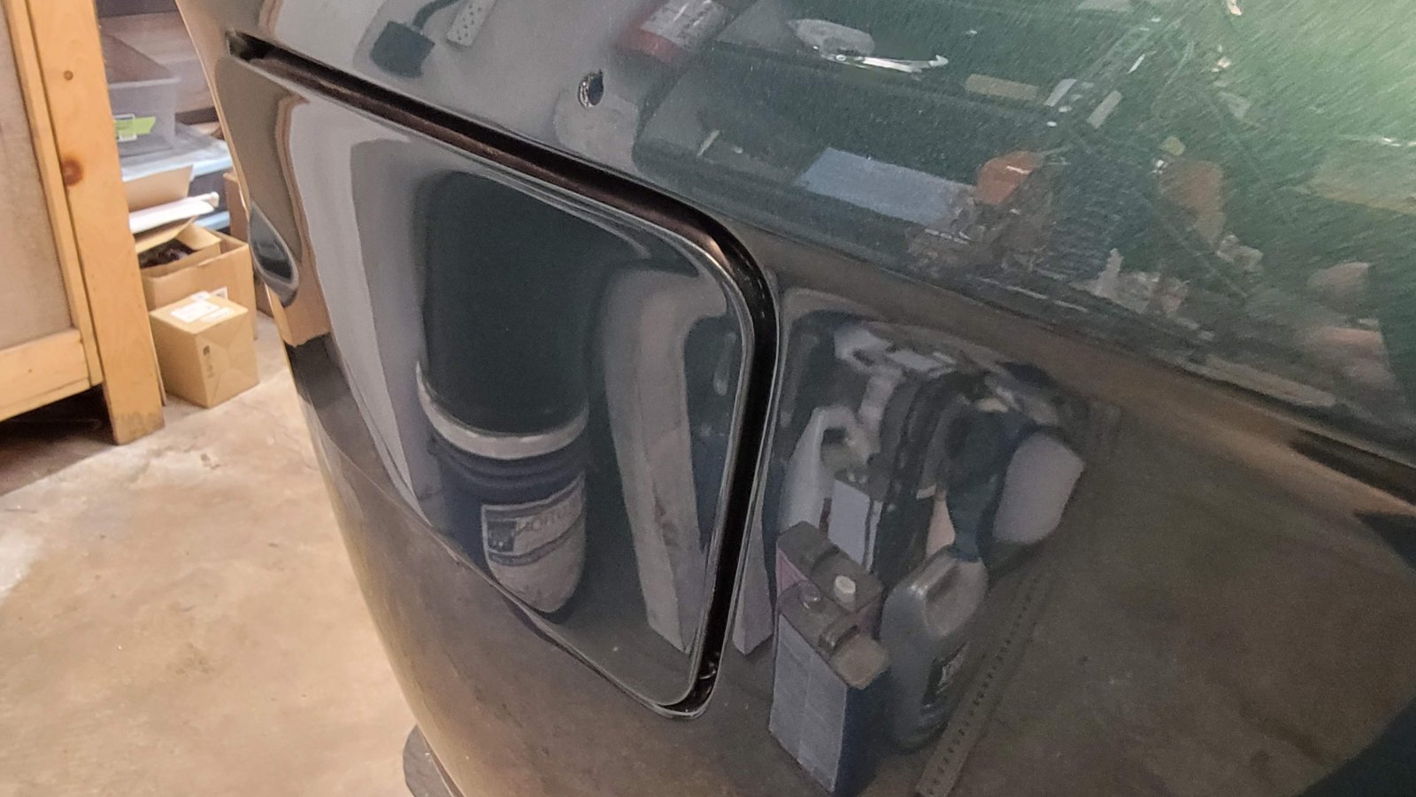

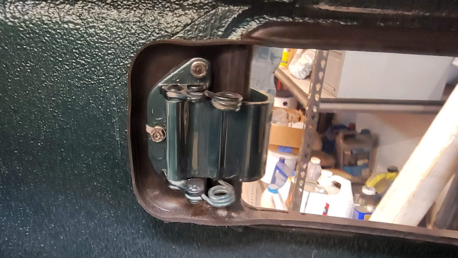

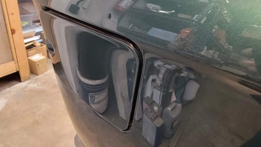

I hope this doesn't hijack the thread but I'm interested in tips for adjusting the fuel door. Hold your noses if you are offended this is an EV conversion but the only thing that changes is the boot has been cut to just be a gasket now, and the door bolts are easy to access.
Brand new boot/gasket. Appears same thickness and maybe even softer/more pliable than the original. But the door won't close unless forced/held. Thoughts?

I like HB Chris' solution: cut back the edges of the gasket. I re-used my old gasket which has been squashed by the door for probably my coupe's entire 56 year life, yet the door still sticks out a little. At least with an e-car, you're not worried about gas fumes leaking out past the gasket!

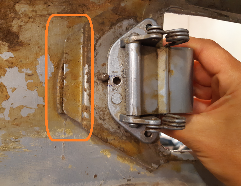

@jefflit , one reason why the lid sticks out, may be if it was forced open too far. This may happen e.g. if you walk into the lid while in the open position.
That plate holding the 3 threads is only spotwelded on the forward vertical edge of the fuelopening in the fender. If you force the fuelflap open to far, that plate will bend the edge of the fender along the vertical line of the spotweld, changing the angle of that plate.
The new 'closed' position of your fuel door is now a few degrees more 'open', depending on how far the plate was bent outward.
It will snap before it will bend.
Ah, I see i was unclear (probably)
The alu cast hinge part indeed will break when bent.

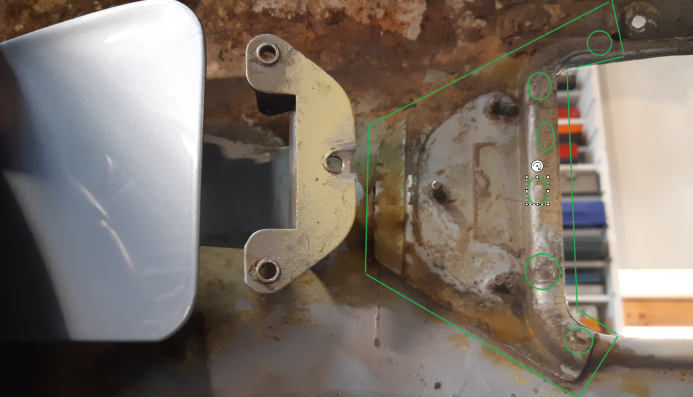

But i was trying to point out that the reinforcement spotwelded and glued to the quarterpanel gets bent. It's this part, encircled in green in the pic below, looing at the quarter panel form the inside. I've also located the spotwelds with green circles, which show that they are roughly along a vertical line:
in this pic you can see that the front side of the reinforcement has a tab under which a foam type glue seems to hide (in my car). This makes sense, as a full spot weld would be visible on the outer surface; glue isn't. (encircled red in the pic below:)
pic from the inside, minus the rubber boot:

I think that when you have a touching condition of the fuel door to the painted outside, that something is wrong.
E9's didn't leave the factory in that condition ; hence there must a reason why yours is doing that + it seems to me a solution awaiting to be discovered
Possibilities:
the reinforcement on the inside of the quarter panel (rear fender) with the 3 thread studs is bent a tad into the trunk area. Bend it back and check?

Thanks for the suggestions. I'll take a look at the bracket with the studs and a look at the gasket. I suspect the latter. All that said, it is amazing how predictably parts fit on new cars compared to our old ones. Panel alignment windows, gaskets, etc. are all so much more precise now.
