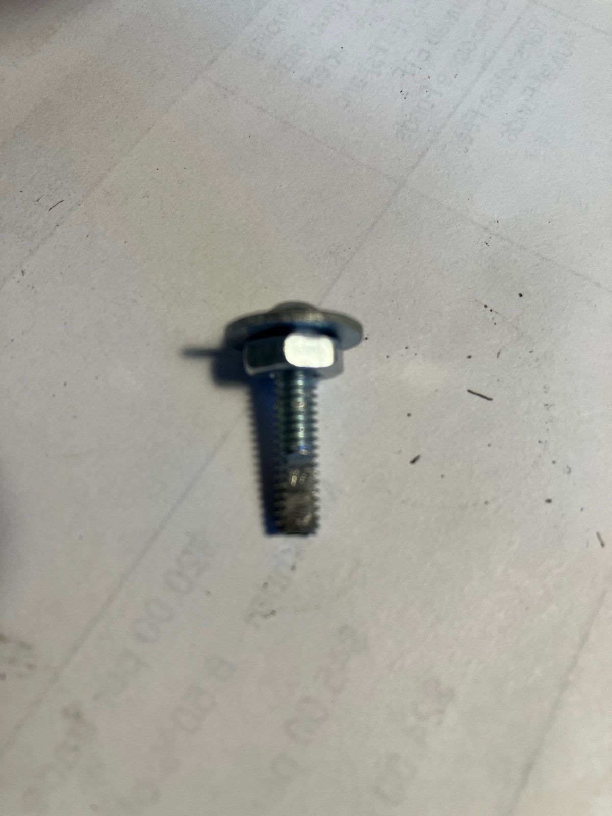

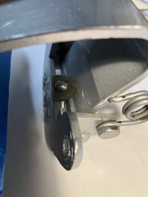

1) Getting the door into position. The spring on the hinge is bi-stable: it either wants to be closed or open. And, it won't fit into where it needs to go in either of those two positions. Almost fully open is where you want it to be and I achieved that by wedging a screw-washer-nut into the hinge to hold it open, but not fully open. See the first two pictures below. Note that the washer needed to be filed flat on one side so that it did not protrude below the hinge's mounting surface. I used a #8 screw, and had to grind it flat to fit into the gap below the hinge.

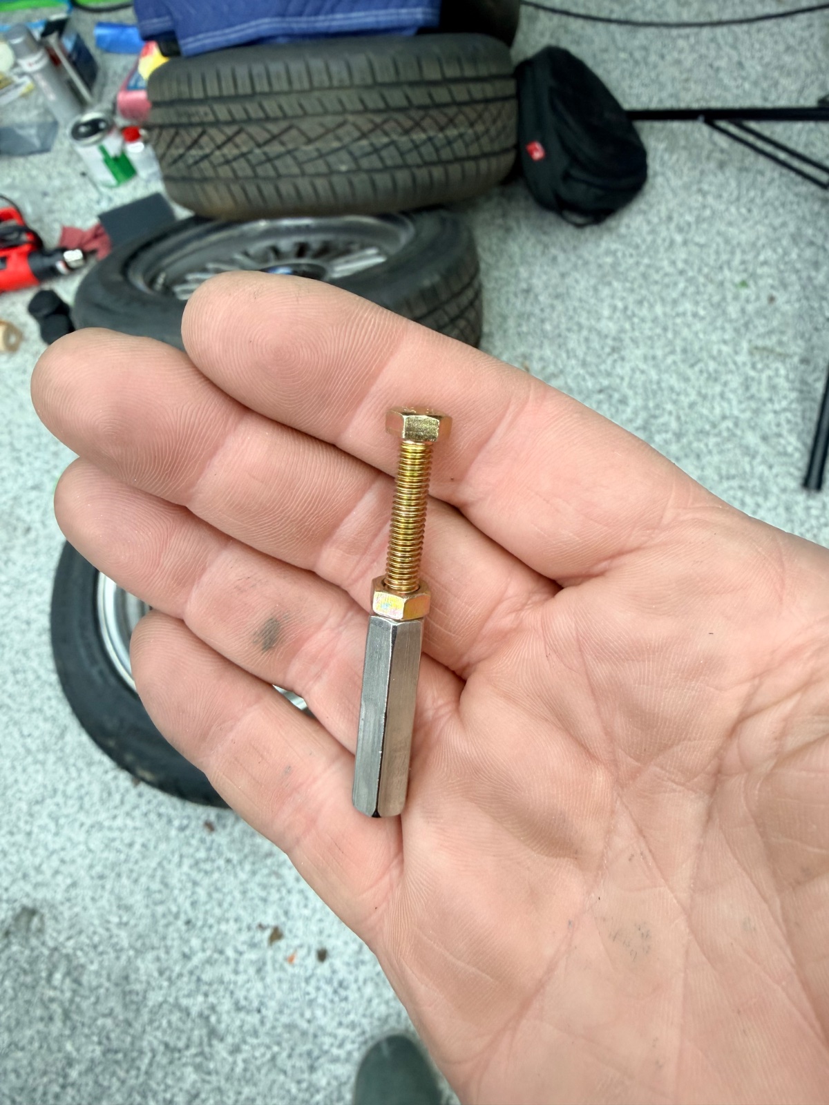

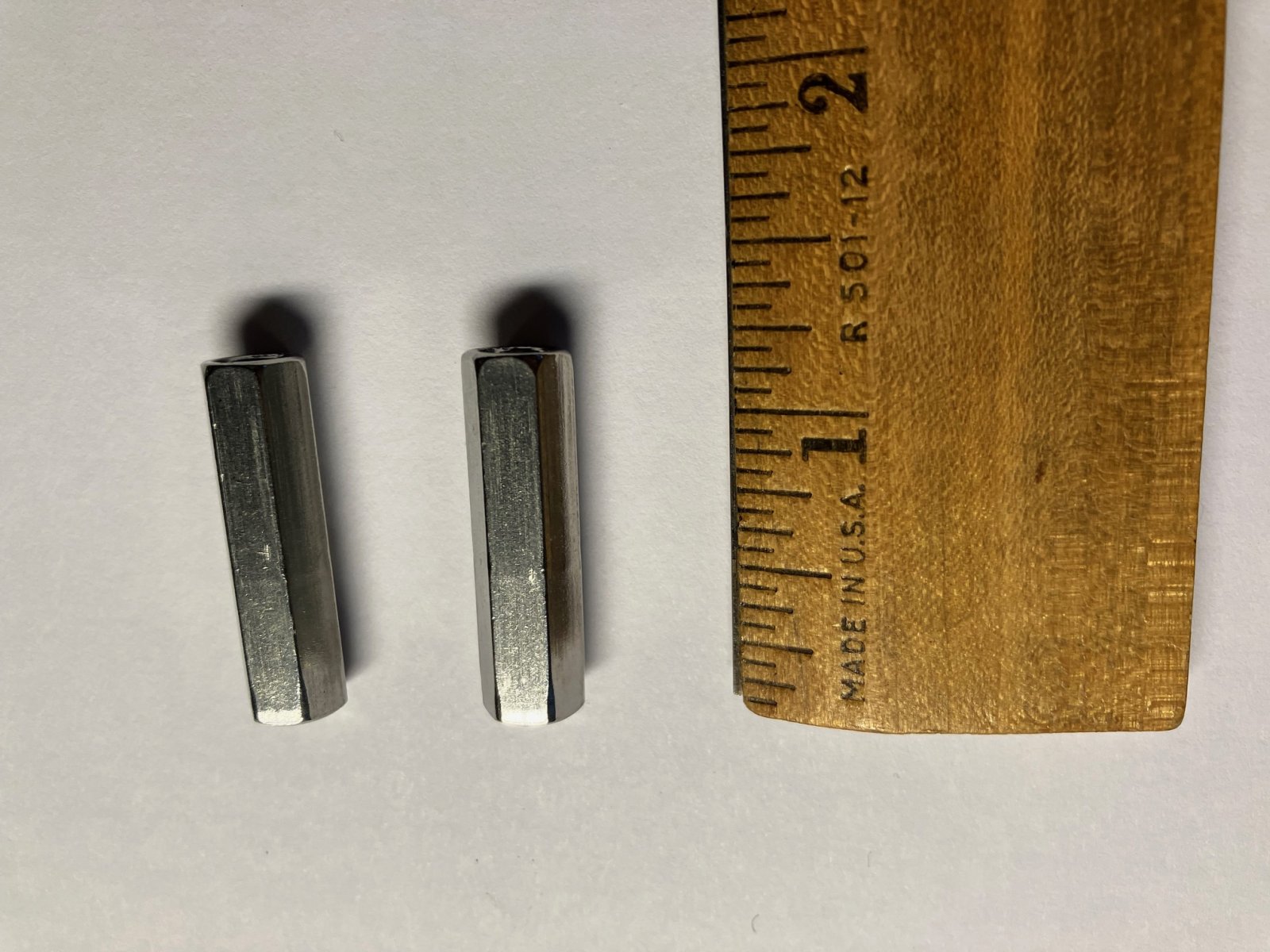

2) The second challenge is getting the securing nuts started once the door is in place. The studs on the body have to be short to allow the door to be squeezed into place, which doesn't leave much stud protruding to start the nuts. Because the hinge won't be parallel to the mounting surface, the most forward stud will be the first one to start. Someone above suggested sticking the little 5mm nut to your finger with grease to maneuver it into place. Instead, I used 30mm long, 5mm threaded connectors - sort of "extra long nuts". These are available on Amazon ( https://www.amazon.com/dp/B0FFMGL354?ref=ppx_yo2ov_dt_b_fed_asin_title&th=1 ) for ~$1 apiece, next day delivery. You can easily grip these with your fingers to twirl them started. Once started, a socket (5/16" worked for me) on an extension will drive them into place. See the first photo below.

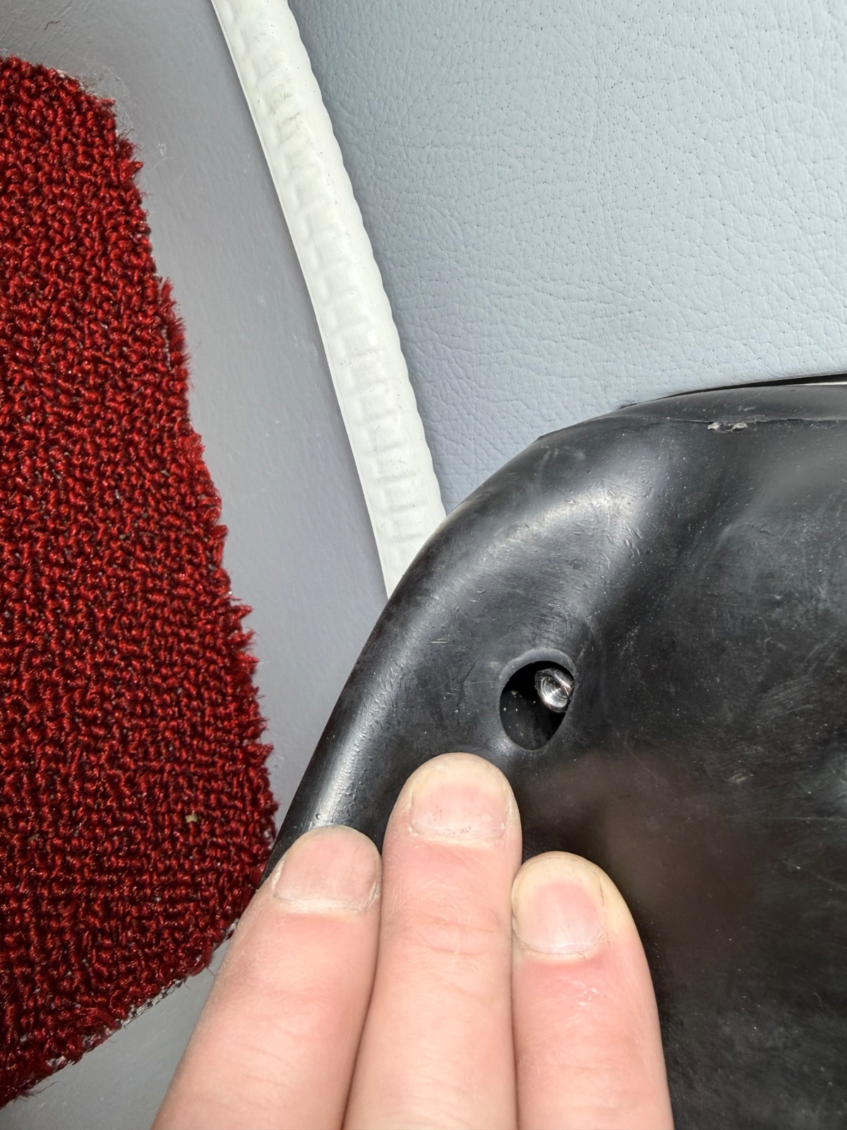

Note that the boot that goes around the filler and hinge has two holes punched in it that provide access for tightening the three nuts. Why two holes for three, separate nuts? Beats me! The two factory holes are positioned above the two rear nuts, but you're on your own to tighten the front nut. I fixed that by punching a third hole in my boot to allow my socket on an extension to go in. See the last photo.

2. I did use a small screw to hold the hinge in an “almost fully open” position. Once I had it close to that front most screw I stuck a small pry bar into the black plug hole to pry it slightly further open and lift it over that front screw
3. ABSOLUTELY use the longer nuts linked above. I can’t imaging trying to do this with the tiny nuts originally on there. Nice side benefit is not only did you make this job easier, but you then make it easier for anyone else after you. Win win.
4. Although I tightened that long nut down with a socket wrench, I got it mounted and did the first few turns with the screw/nut holder shown in the picture below. I found this easier to manipulate than a socket holding the long nut. Twist a few times then unscrew this screw/nut holder and use the socket to complete the tightening
