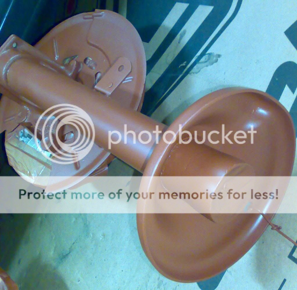

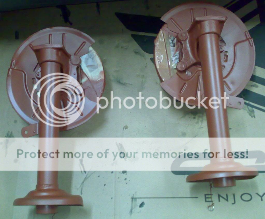

today start painting
anti-rust from rust-oleum:
two times in preparation for final paint, i will not go for original dark green colour, but black matt, in order to simplify things...

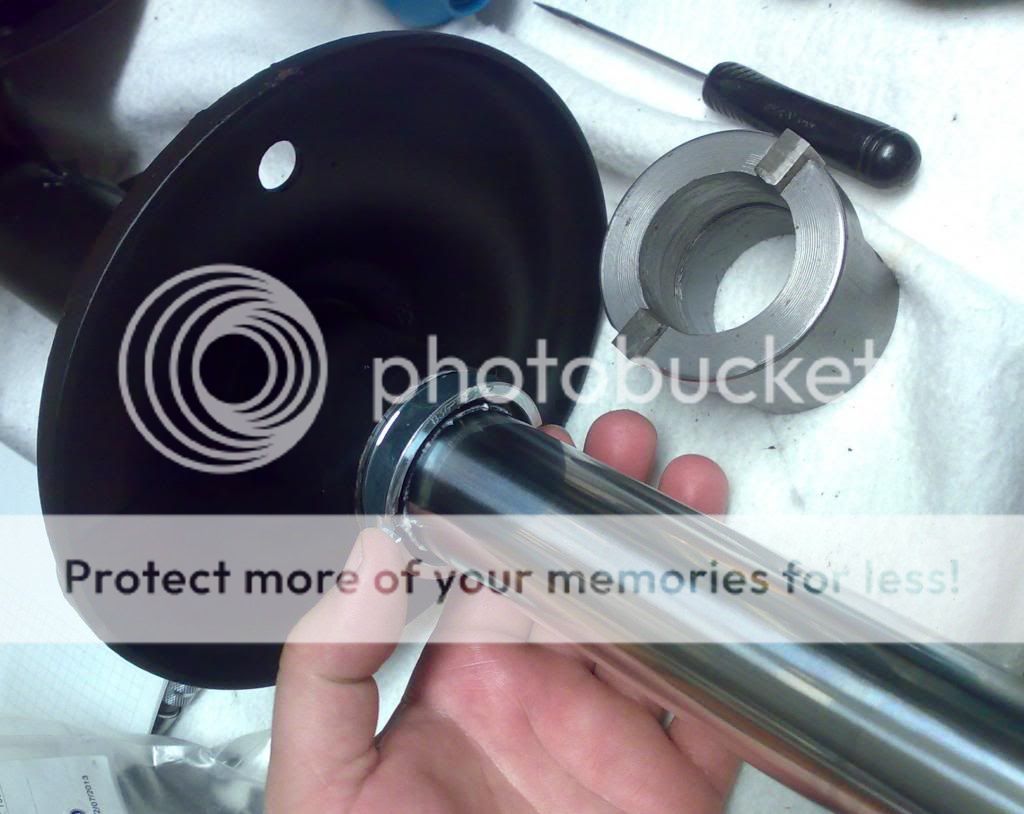

the assembly of the two front struts has been completed,
once the strut towers are painted, regreased and ready, i placed one in a solid and firm support
overview of the required parts and tools:
start removing the blue cover from the shock
pour 40c.c. of engine oil into the strut cylinder
insert the shock
place the tool for doing the nut, torque must reach 130N.m
insert the blue cover again
sequence of needed pieces
torque 80N.m
