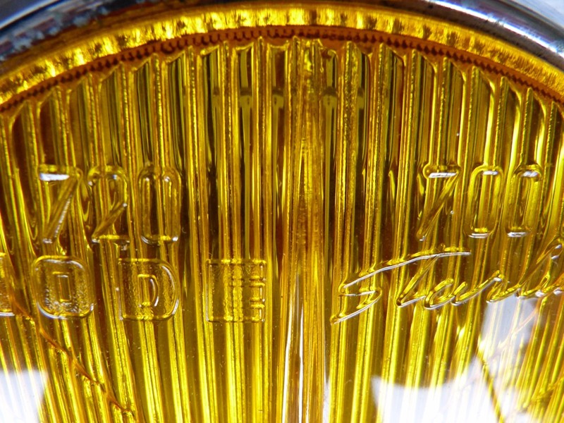

Gratuitous Marchal porn, the high beams are yellow bulbs as are the driving lights (obviously). Easy on the eyes at night.
ulOCypnDk7cQsyQbJhhNpIcl3nSOXlUBU2Exc_8CAaG6RVLCkZmoFUlynWHhGMqEJ1Na44J3Ynz-iJW-4H2d51iwT7vFk4XPSujiu6T-75bhlHkU0OIYwPNQC6_qv8ZwqIH6ZUSmMlcoku0f9BPbo8vwY4-duXp_8hcwFEjUhfFtZEKqY866RRk17YkJviJU3st0X7zR05xhbNEbHvMwqZ9Ian2jF2rP9KUs4j1PIQudrKivGvUr9Dg9CJMJggzQhA0G2-9kQnve60Aj-Oacfd_nF_Dqlw_RYLKB5HDIFDB8dfyjkOF1Rdj6MKnk8YCAiYUDRbCerhuYwTOvLE0Fpkl5LLGoF929v2hNaJqBqwlihg8o-3oBKqFdxXwmzoDNw8fyXQ_xhlIOYh_f9QulNT920NZjNNaq5u497d_bkyPIz9Xxzskp_BvjXXkg1Q2hMb7iFbtID6LDc4SRVrTwjEaITaXA_qdHOuvXm2mVUXxOh0pb0v9XtjGPQ5g1pdaWy0CLvJPj58RrdL7xetEGvbFWb6OUO_GYz8ipVtTXQJ5p0ny-Y8vK7KJGVXngChPi6Lmk08XM1sTVJZ3Xzqhqzkd6dCKVXjlLNgMyGvs=w868-h651-no
Looking for a set of Marchal 700/720s like these in clear glass. May buy these anyway and change it up a bit.
