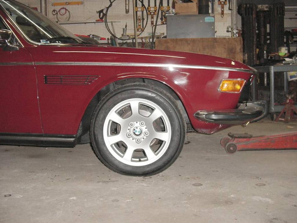

I just put BBS RS 16's on my car, and it still looks about 2" to tall in the front. It has brand new Bilstein struts and spacers have been removed. I know that Carl sells a lowering kit. How much will it lower the car and how does it affect the ride/steering quality? Also, how much does installation usually cost?
Thank You For Any Input,
Pat

The photos a little dark around the wheel arch, but I'd 2nd the comment that it looks great as is. Looks just like mine, in fact. :grin:

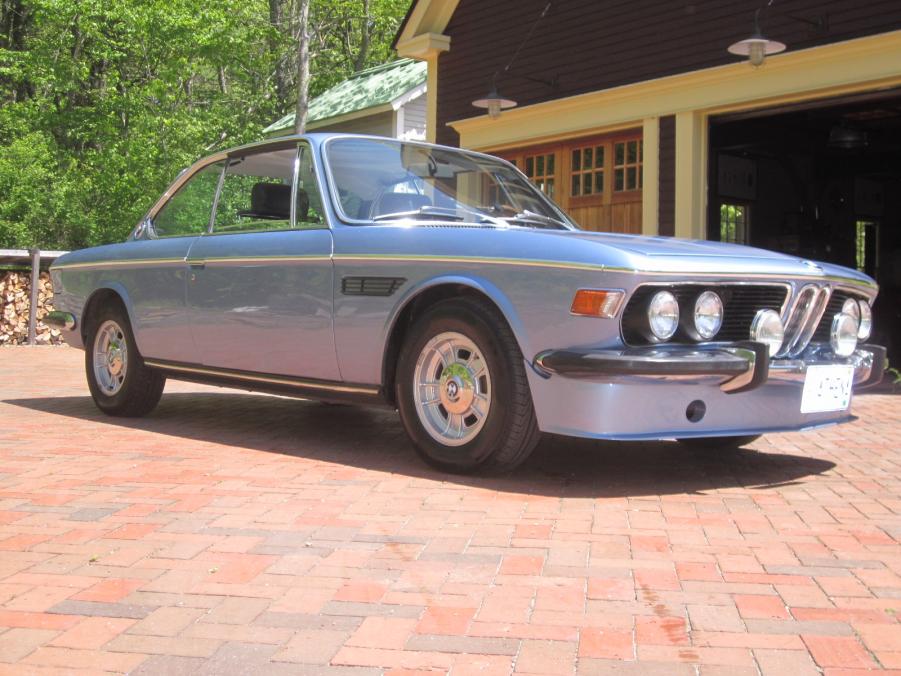

I lowered the front with CN springs left the rear stock. Reveal from the tire to the fender lips are the same

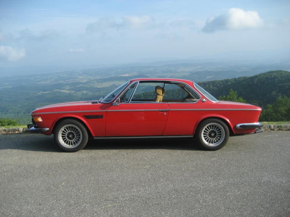

I had a spare set of springs, so I cut a coil off the front and rears, paired with HDs. The fronts were perfect. The rears were too low, so I put the original springs back in the rear and went down a spacer size. The pic that was shot on the Blue Ridge Parkway on the way to The Vintage in 2010 (which is the one on the back cover of my book), with the trunk full of crap, so the car looks just a skosh tail-heavy. With the trunk empty it's about right.

I think the rear ride height shouldn't be higher than that with the current lowering up front. A basic difference between front and rear end of the rocker panel height is about 0.5" (higher at the rear end)

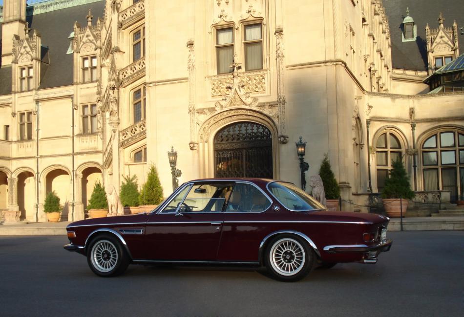

Here's another to look, mine is a 1972 I have Bilstiens 16" Alpinas with Miller & Norburn springs.

another nice set up... I prefer the rear end tucked (low or no rake) like this one and Stan's
