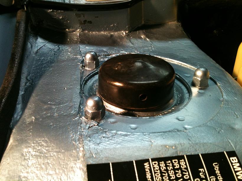

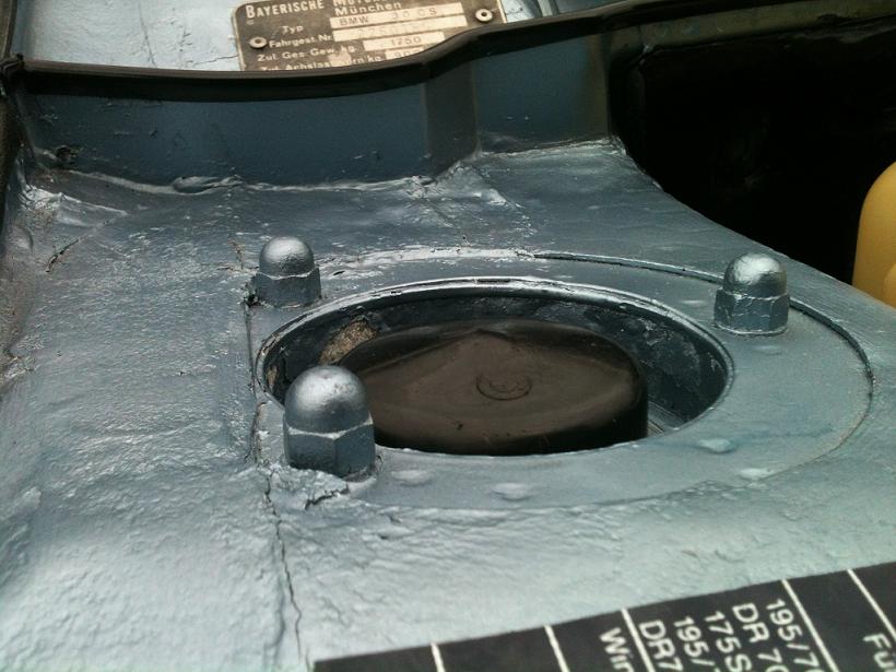

You can see them from above around the strut bearing, they are 5/8" thick aluminum.
Here is what Chris is describing (before and after the spacers are removed):
I see said the blind man
OK that really helps. I was hoping I had a picture somewhere on my phone to reference but it should be easy enough to tell. I suppose once the spacer is off I will either have to install Andi's strut brace or cut off the excess length on those bolts. I realize I'm risking starting another thread so I'll continue this train of thought on new thread should I need to remove them. Thanks as always for the replies.
