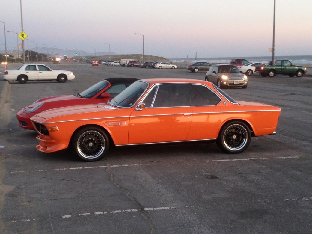

I did a coil over in the front and used an 8" Hypercoil for the rear. Made my own spring pad.
BBS RS
front 005 - 16 x 7 with 1" wider lip = 16 x 8 ... 215/40/16
rear 007 - 16 x 8 with 2" wider lip = 16 x 10 ... 225/45/16
enjoy

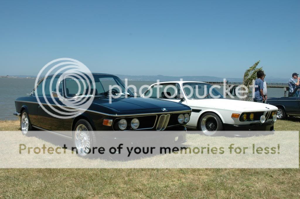

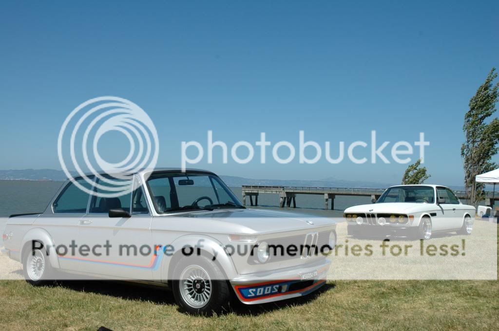

Sean Casey has a nice 02 turbo
Very clean Black Beauty

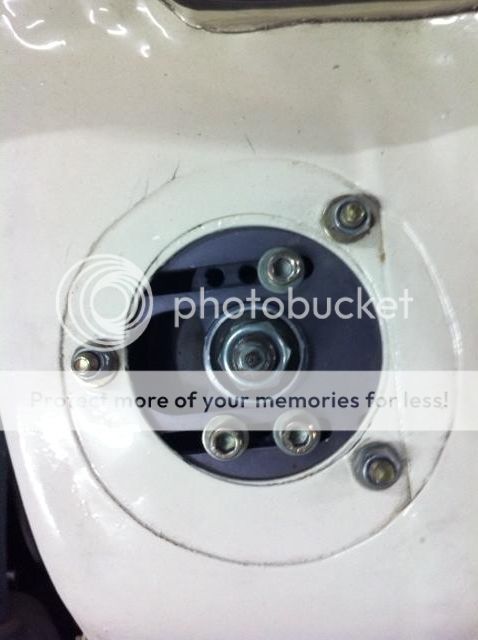

I went with http://www.ground-control-store.com/products/description.php/II=665/CA=281
for my Camber plates.

To lower my car, I went with a ground control coil over but I cheaped out and did not shorten the strut or weld on a spring perch-I used the stock spring perch. I measured the strut diameter, called ground control and they shipped me parts that just slid over my strut.
I then reassembled the car using their camber plates and dropped the car onto the bump stops using my lift, then raised it up 2.5" which is what ground control told me I needed for minimum travel. Measuring it all back, I needed a 6" spring, and we calculated a front spring rate that matched the rears being cut 1.5 coils.

Barry, two big thumbs up on your coupes stance, it makes the black coupe almost look like it's four-wheel drive. Also thumbs up for the photo shoot location, there is nothing as impressive as that in my area.
The BIG QUESTION is how does your coupe ride :?: and handle :?: now ? How much ground clearance does your front cross-member have now ? You should probably consider installing a front skid pan if you haven't already done so. I worked as a heavy man in body shops for over 20 years and I can tell you what happens when a cross-member hooks a manhole cover isn't pretty. ~ John Buchtenkirch

Thanks guys I'm glad you approve.
rb1971
I have seen those fine SF street, some are Brutal.
Lucy is perfect just the way she sits, I would cry if her chin ever got scraped.
Mine i would just rip it off - toss it then get another.
John
It handles just like any Coupe.
It's not the height, any harshness come from the spring rate of the springs... 440 front 600 rear.
skid pan... i have thought of it just haven't done it. You have to keep a very sharp eye on what's out on the roads.
