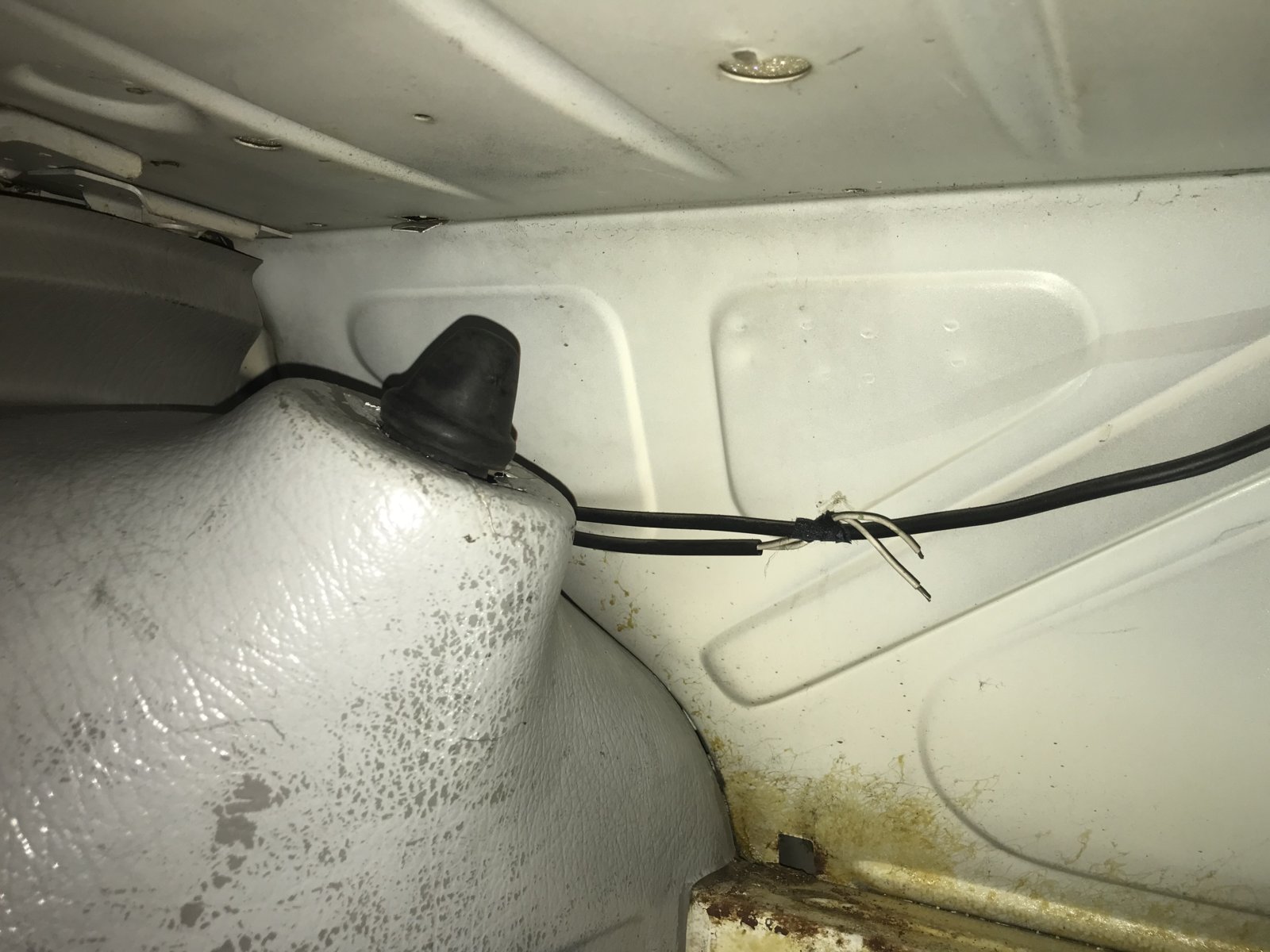

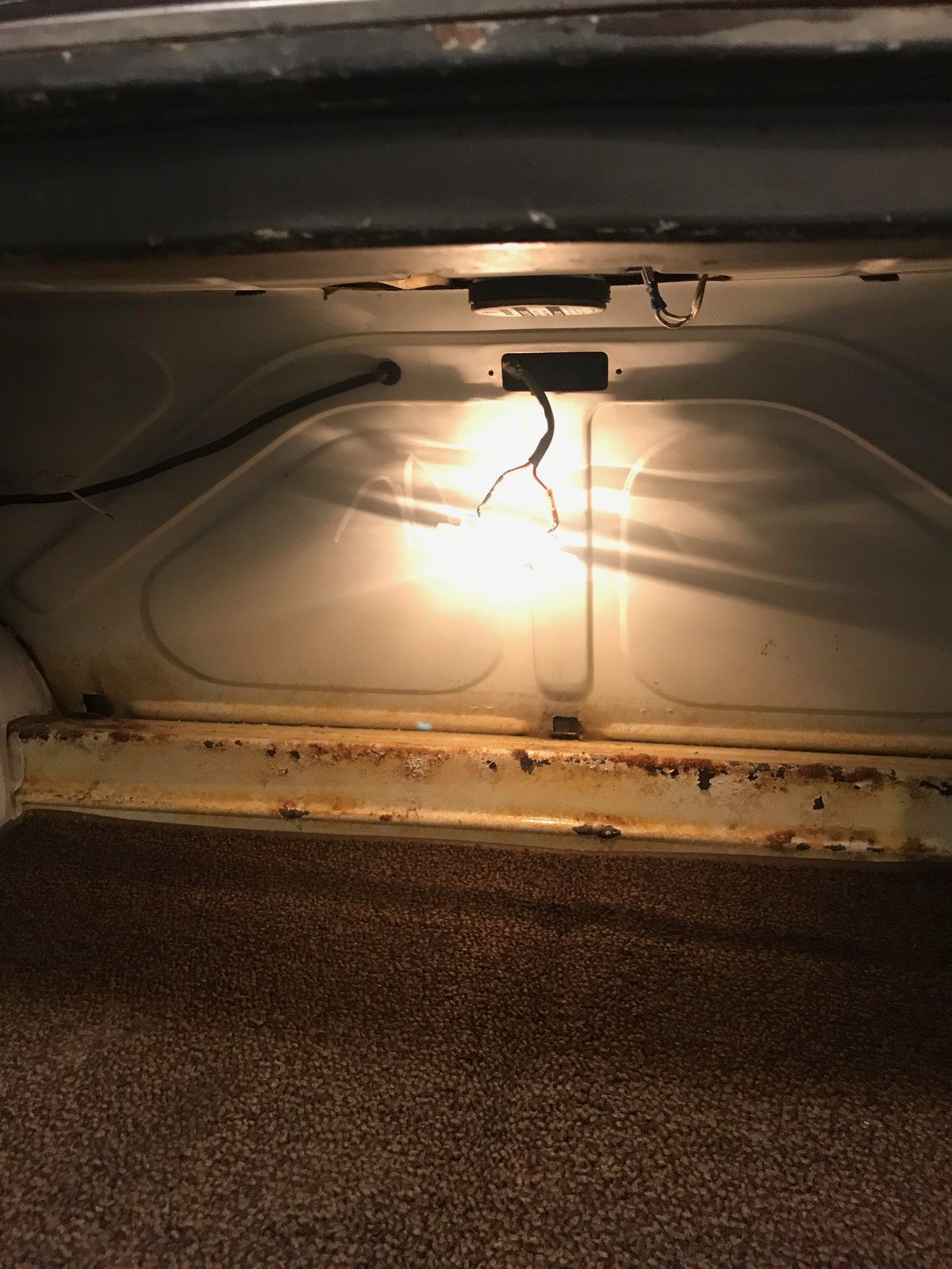

One strange thing is that, out of this options: main lights of the car, warning switch, and clock, interior light and trunk light, two things are not working...... The clock and the trunk light, I asume the clock isn´t probable working for two reasons, the fuse inside or the age.... but the trunk light and also the engine light are nor working...

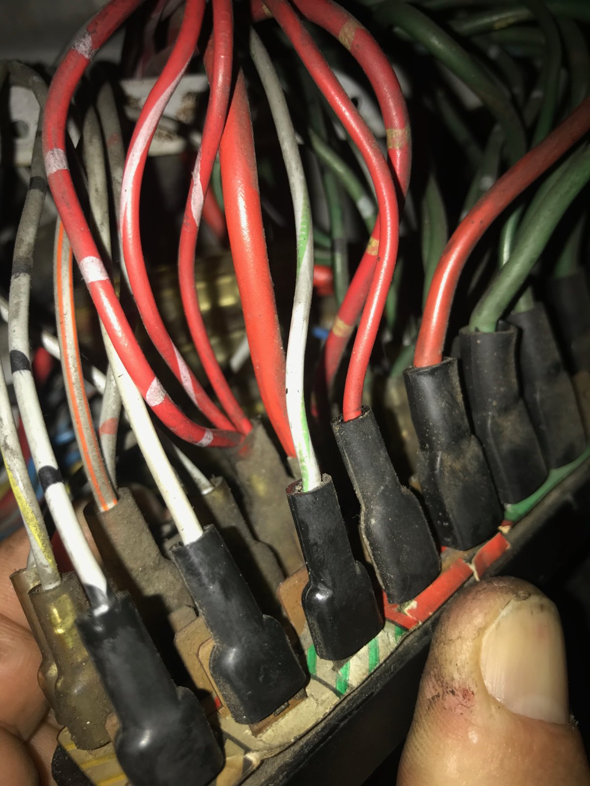

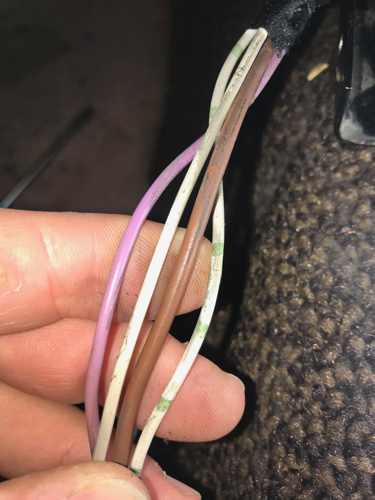

I believe this two white wires (full white and white green) are coming from the radio speakers at the front because under de heater ventilation I did found (I believe) the other end...
So that lives me with only two lights that are not working, the trunk and the engine lights, it could be the switch? but these switcxhes look very simple and difficult to fail.... it looks like just a ground conector...
i think you are right that the white wires are for speakers. Notice how the ends are also dipped in solder, it makes it easy to lock them in a wire clamp.

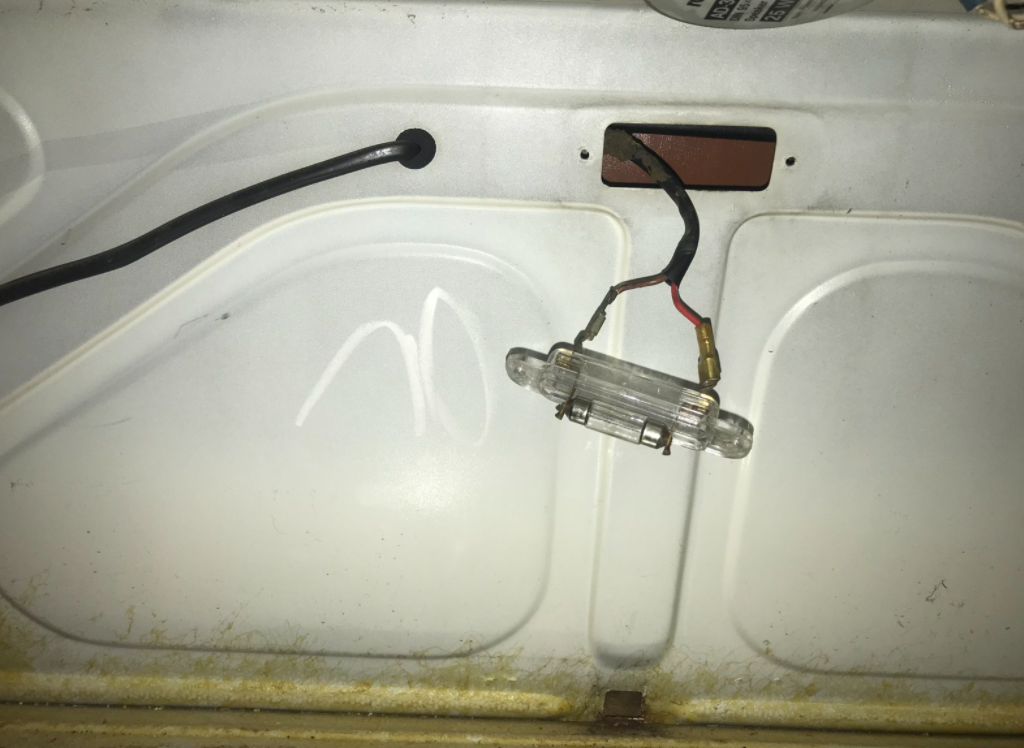

The trunk light should function as you expect (if circuit fuse is still OK); try bypassing the switch to see if it then works.

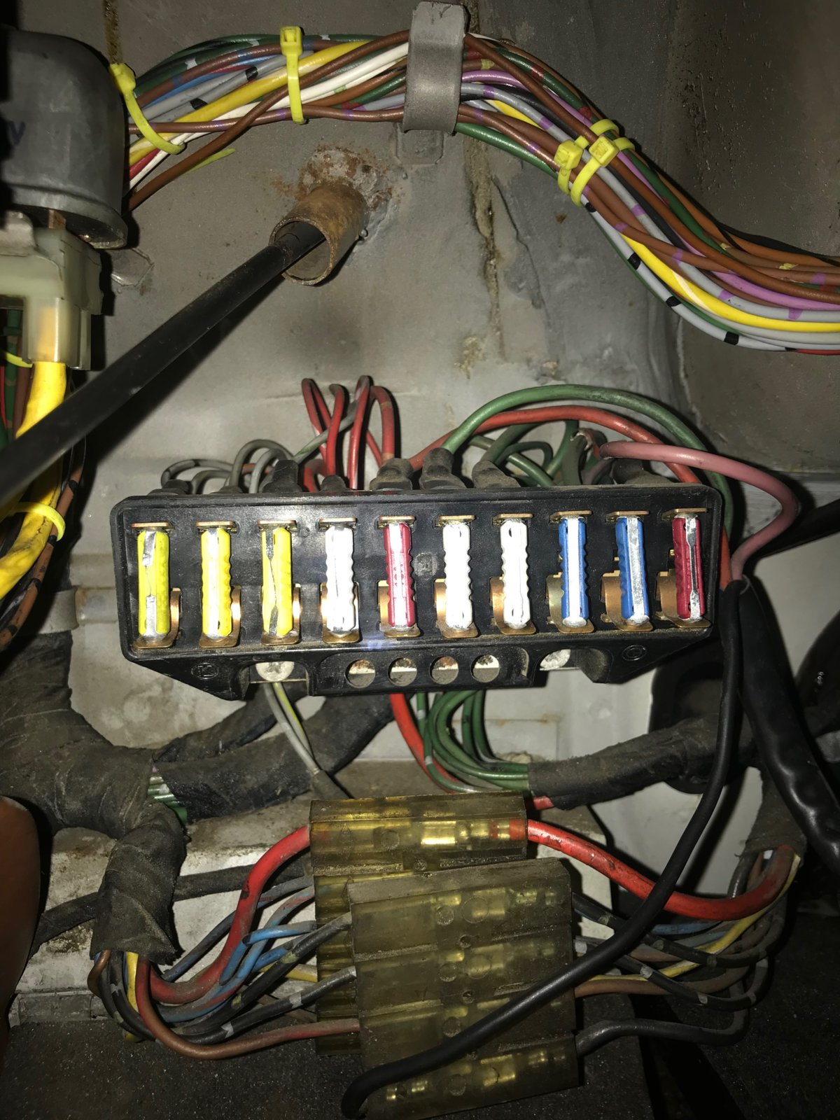

Hello Arde, thanks for helping...
If fuse 4 is removed the dies completely, no lights, no ignition or lights in instrument panel, no click of load shedding relay.
But my question now is..... If this has been change, who the hell change this and why...? :mad:
And most important, how should I proceed now?.

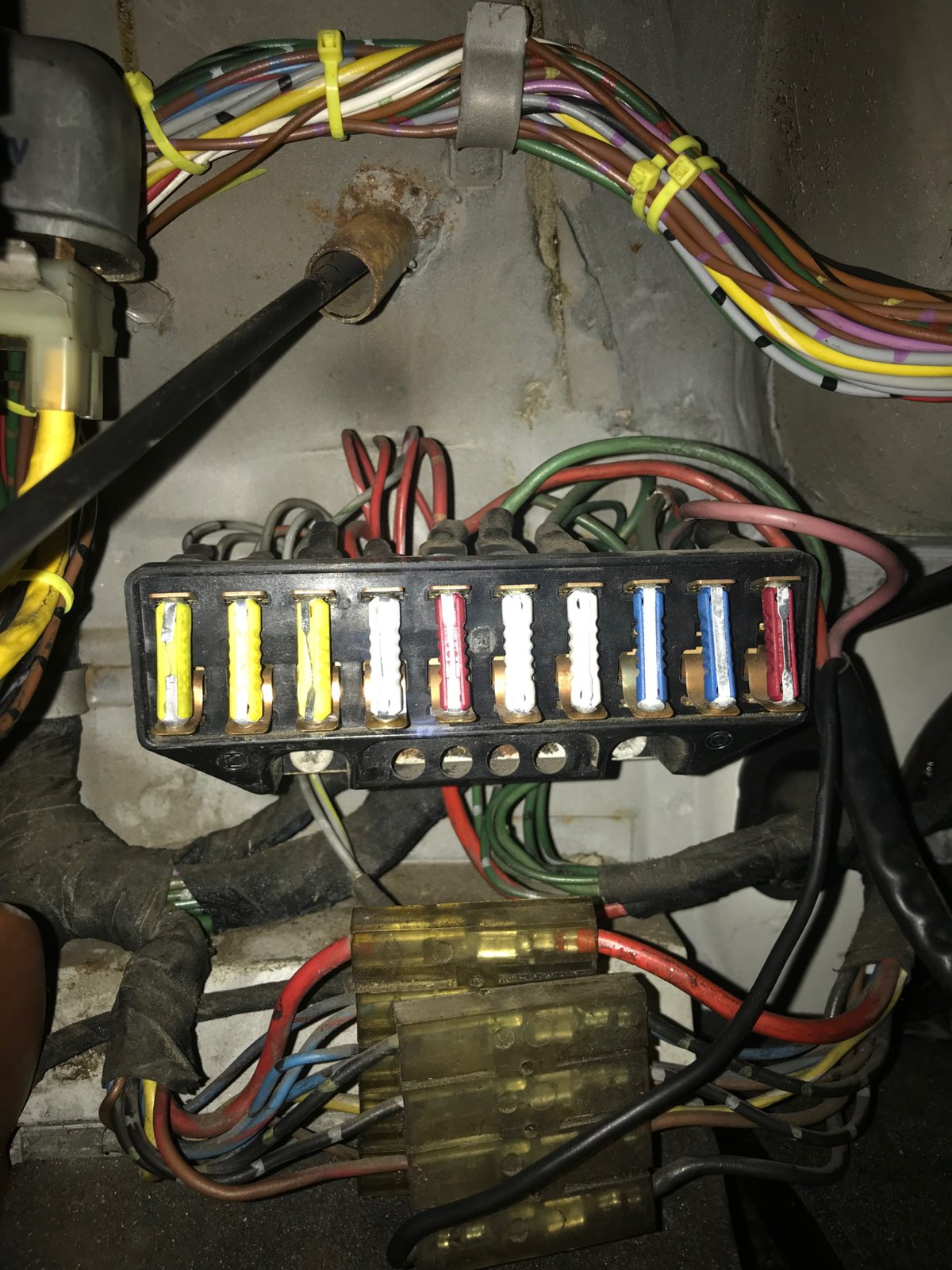

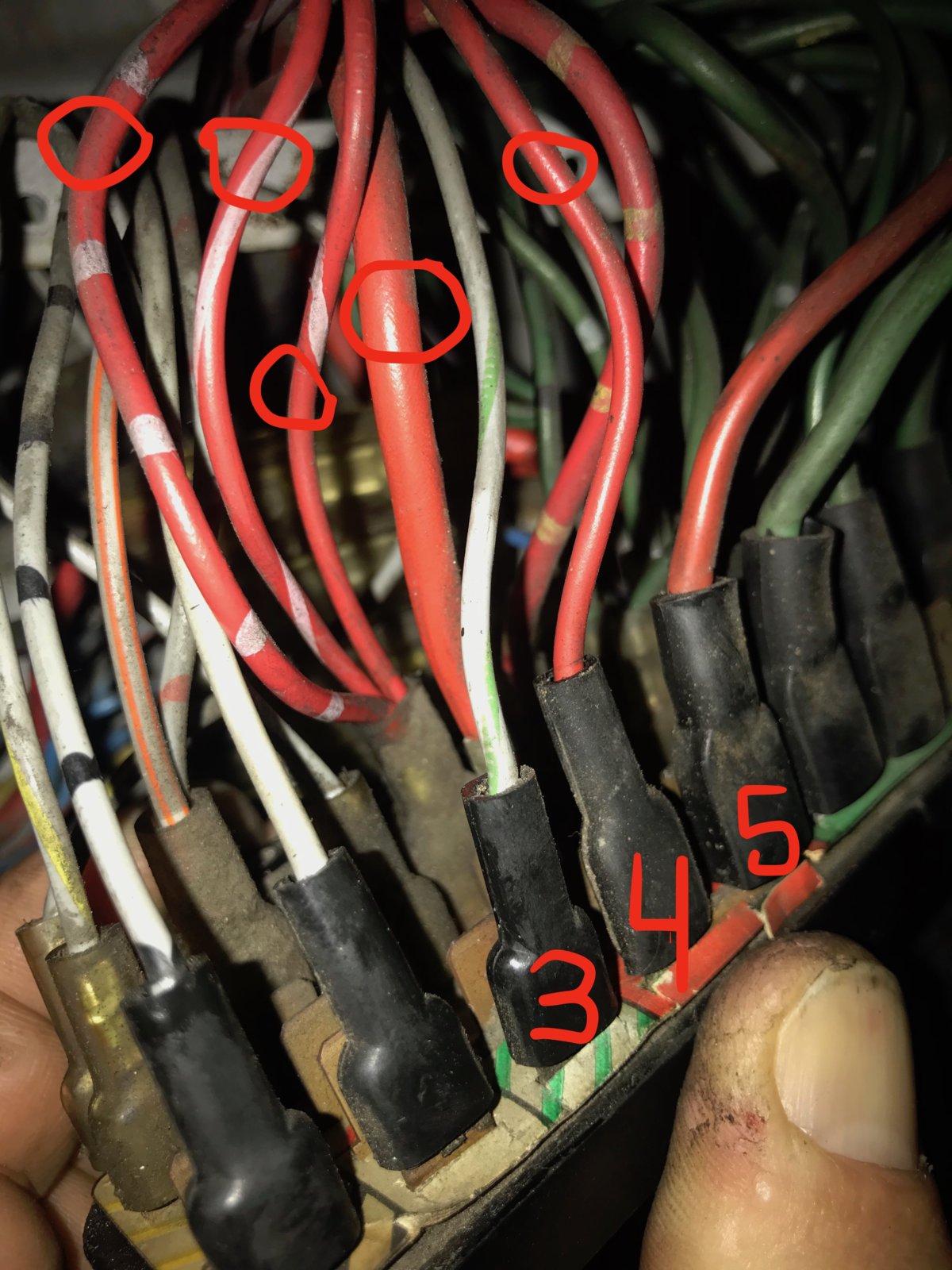

This a picture of the fuse box...

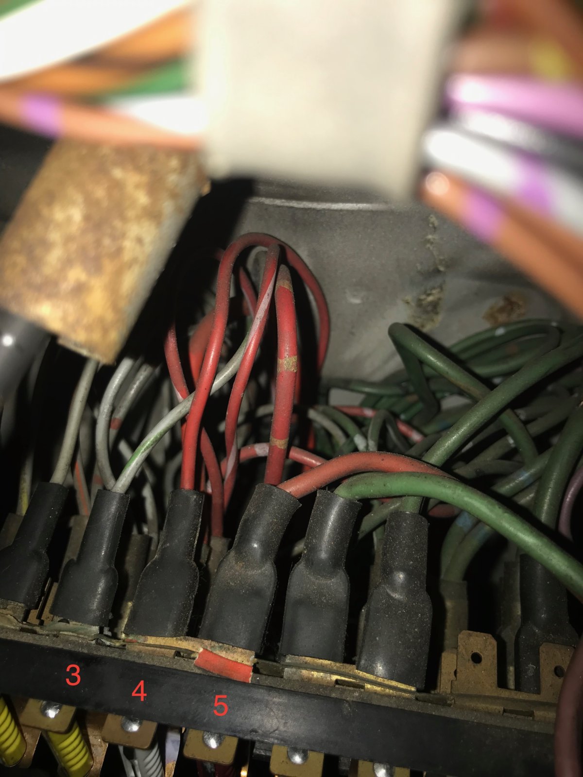

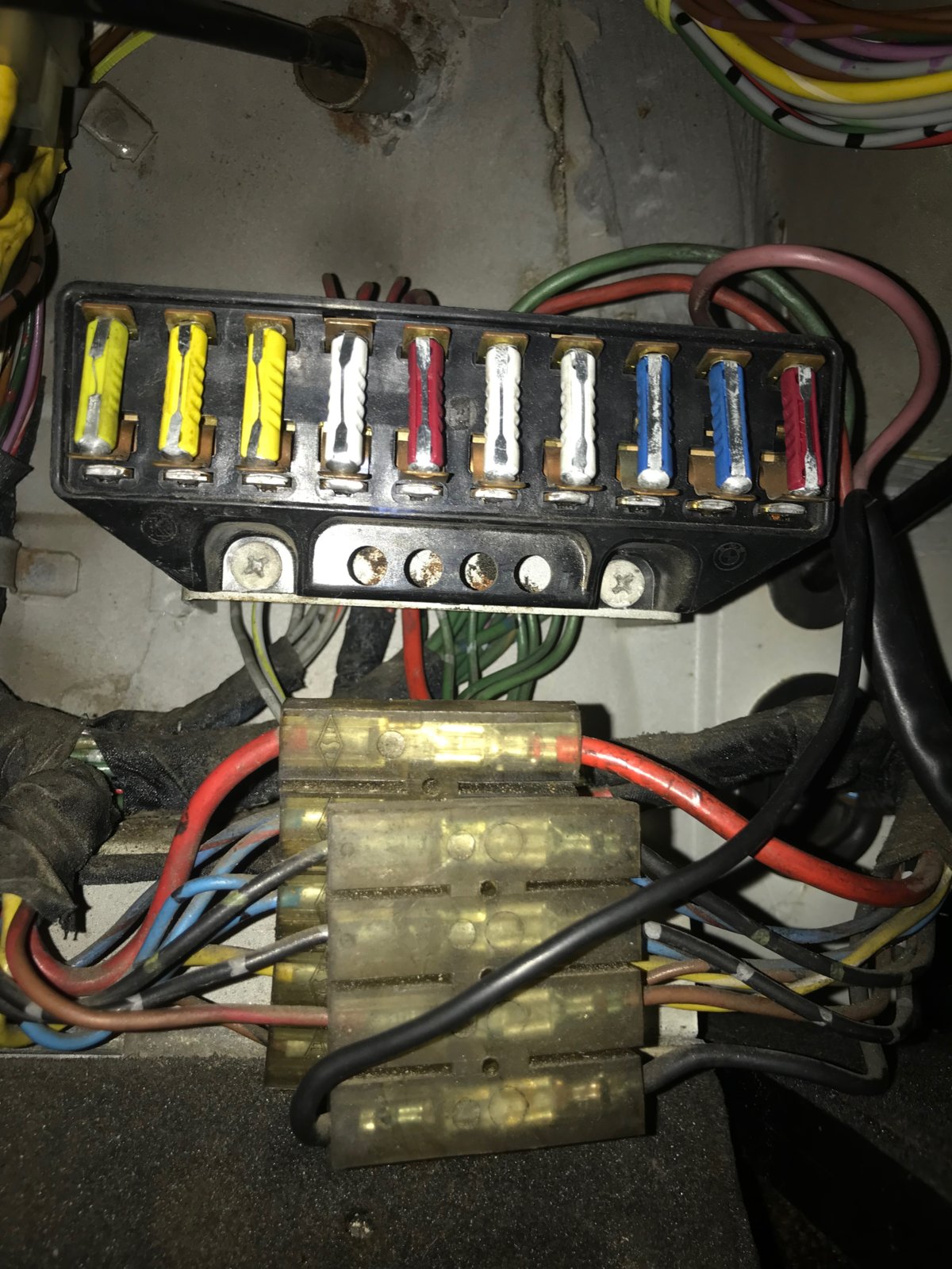

View attachment 138098View attachment 138099View attachment 138100 View attachment 138102

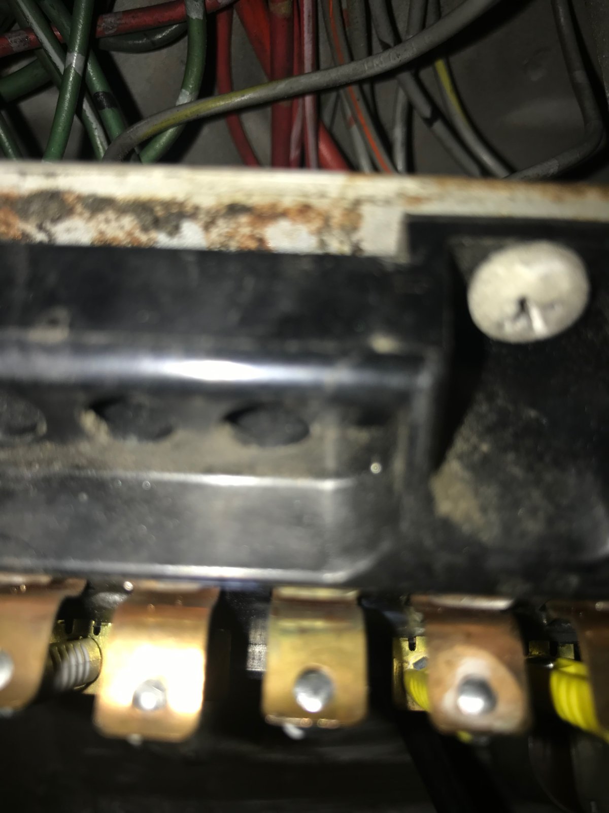

i asked you a question and i think it was not responded, is it a CS or a CSA ? AKA automatic ?

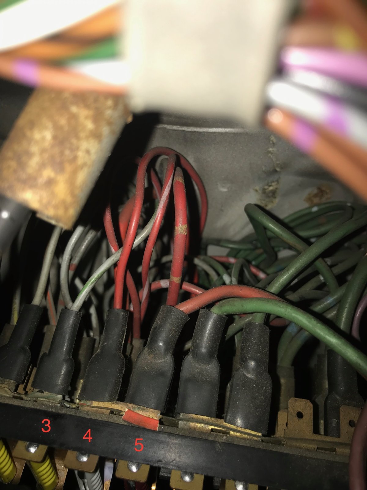

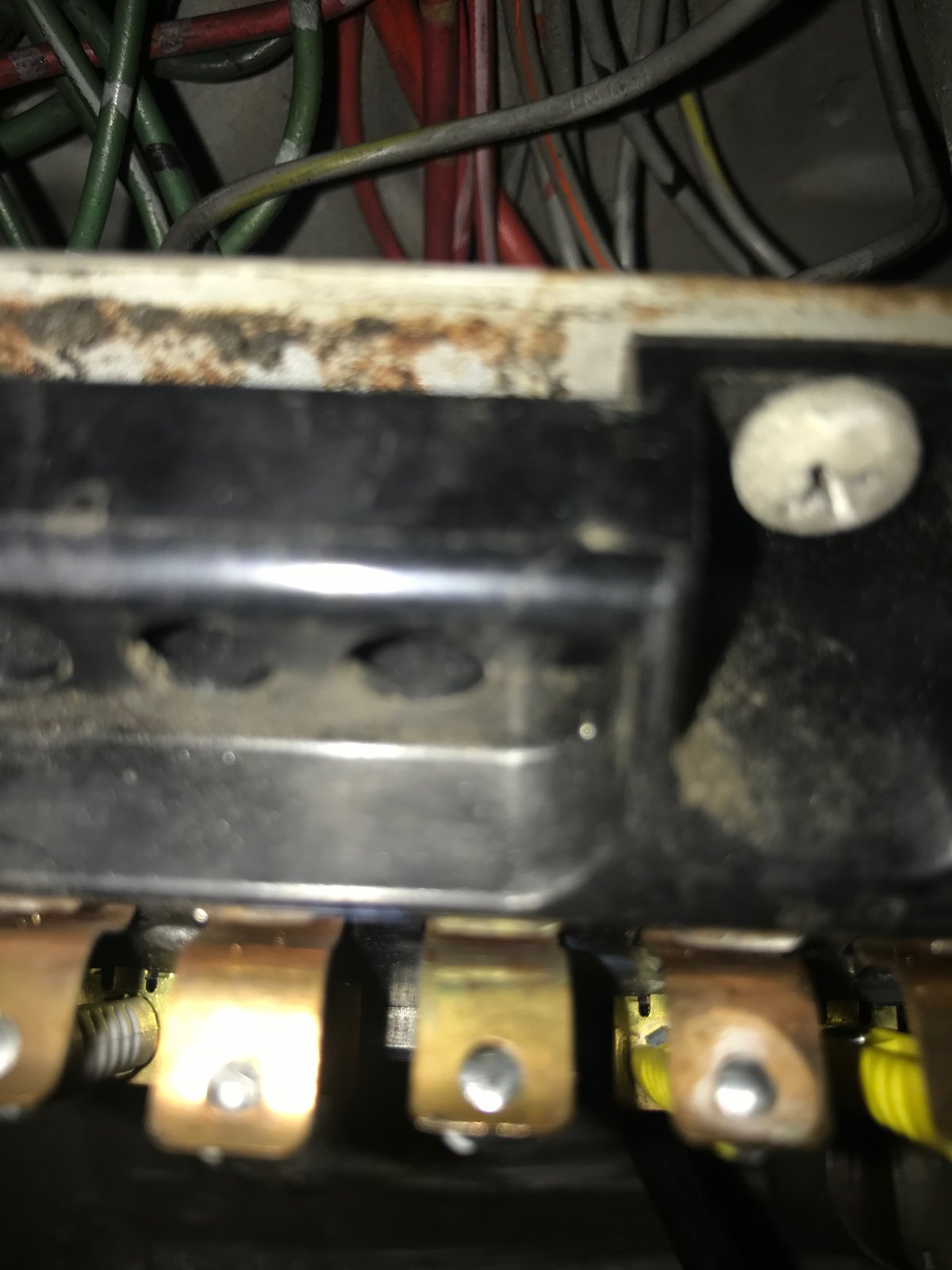

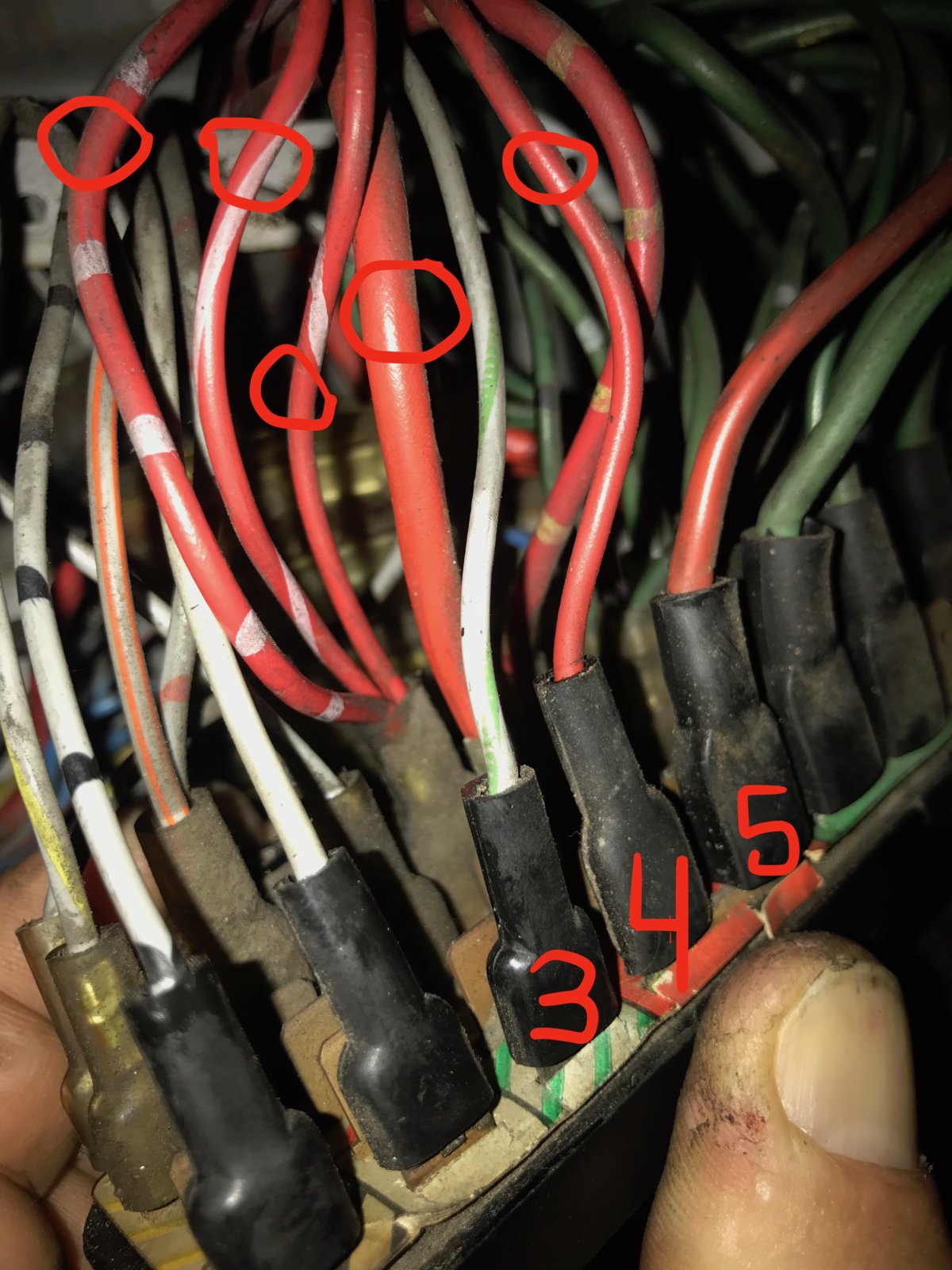

from your pictures it seems that number 4 is crowded,
you might want to remove the 2 front screws and look at what is connected behind

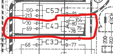

in principle, i would be cautious, the diagram that you showed us is different from the one i have in the blue books, and it has more things hanging on that fuse #4
Have you disconnected the trunk light wires and tested? Then disconnect the interior light and test, and so on. My E3 had burnt wires clustered together and it ended up being the trunk light switch. Eliminate one at a time.

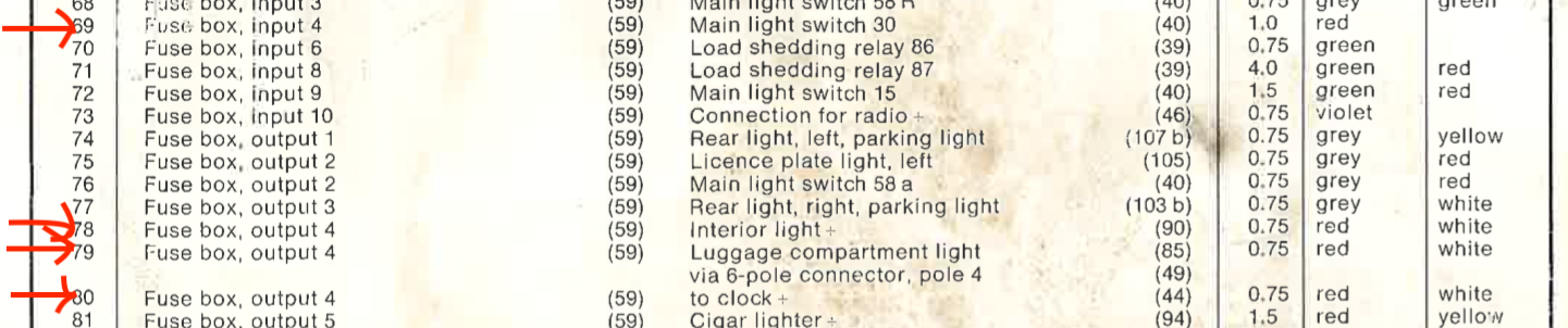

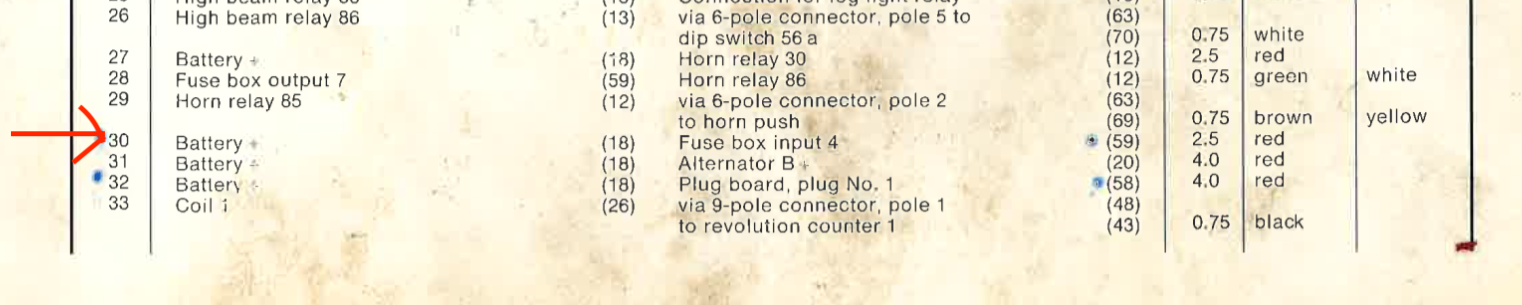

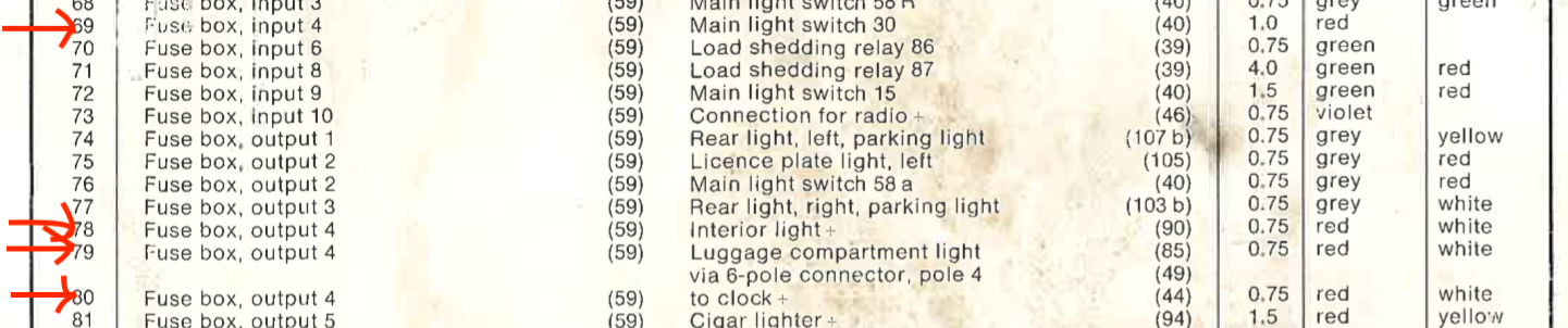

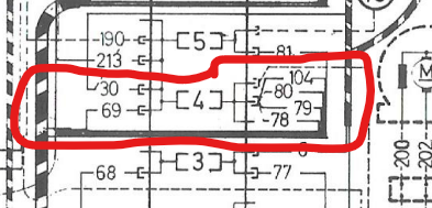

Ok, here is what I´ve found... to fuse 4 comes:
INPUT Top side: One Red wire (probably 1.0 cross-section)
INPUT Middle side: One Red wire (probably 2,5 cross-section)
OUTPUT Bottom side: Three Red/White wires, maybe one thicker than the other two (0,75, 075,(0,75?) )

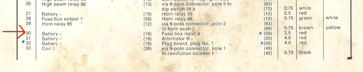

According to the Owners Handbook:
69 - INPUT Top side: One Red wire = Main light switch 30
30 - Back Middle side: One Red wire = Battery +
78, 79, 80 - OUTPUT Bottom side: Three Red/White wires = Interior Light, Luggage compartment Light and Clock
All wires seems to be correct and in the right places....
The deeper that I get the more non sense that everything gets...... o_O
I am feeling a bit lost to be honest...

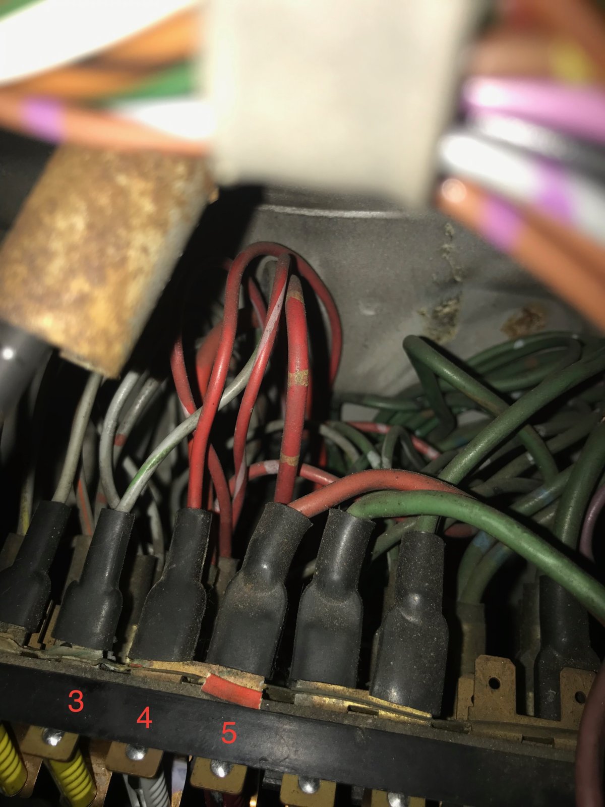

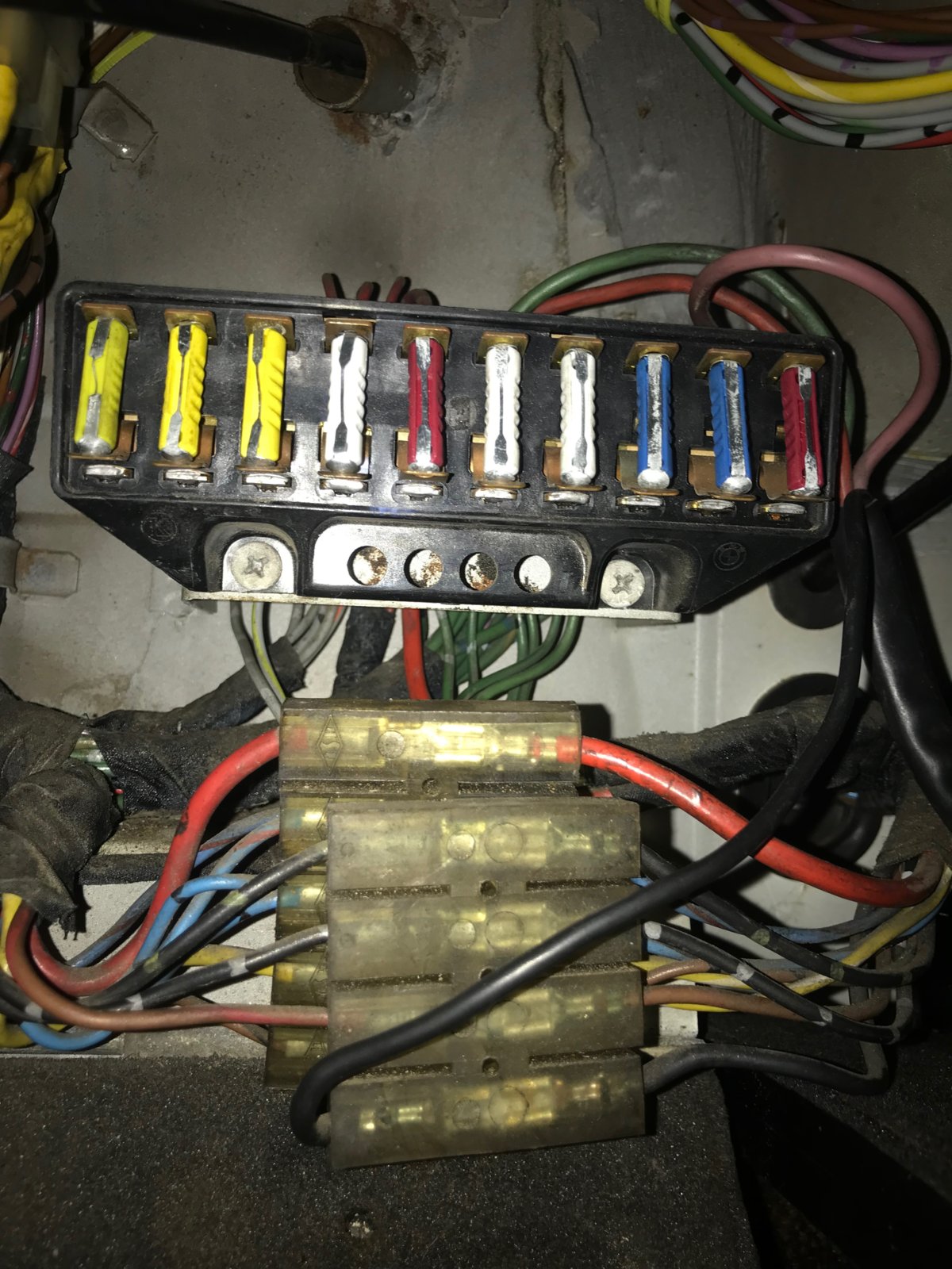

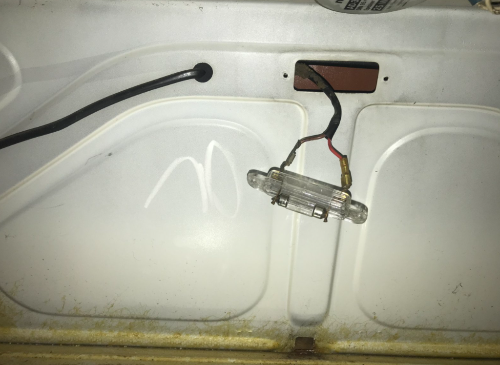

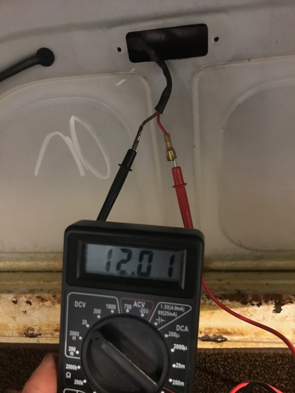

The trunk light is disconnected but I do not know how to bypass the switch...
Yesterday I tried with the engine light by disconnecting the switch and touching with the brash conector directly to the body but nothing happend... Is this the way to bypass it?

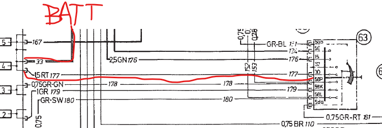

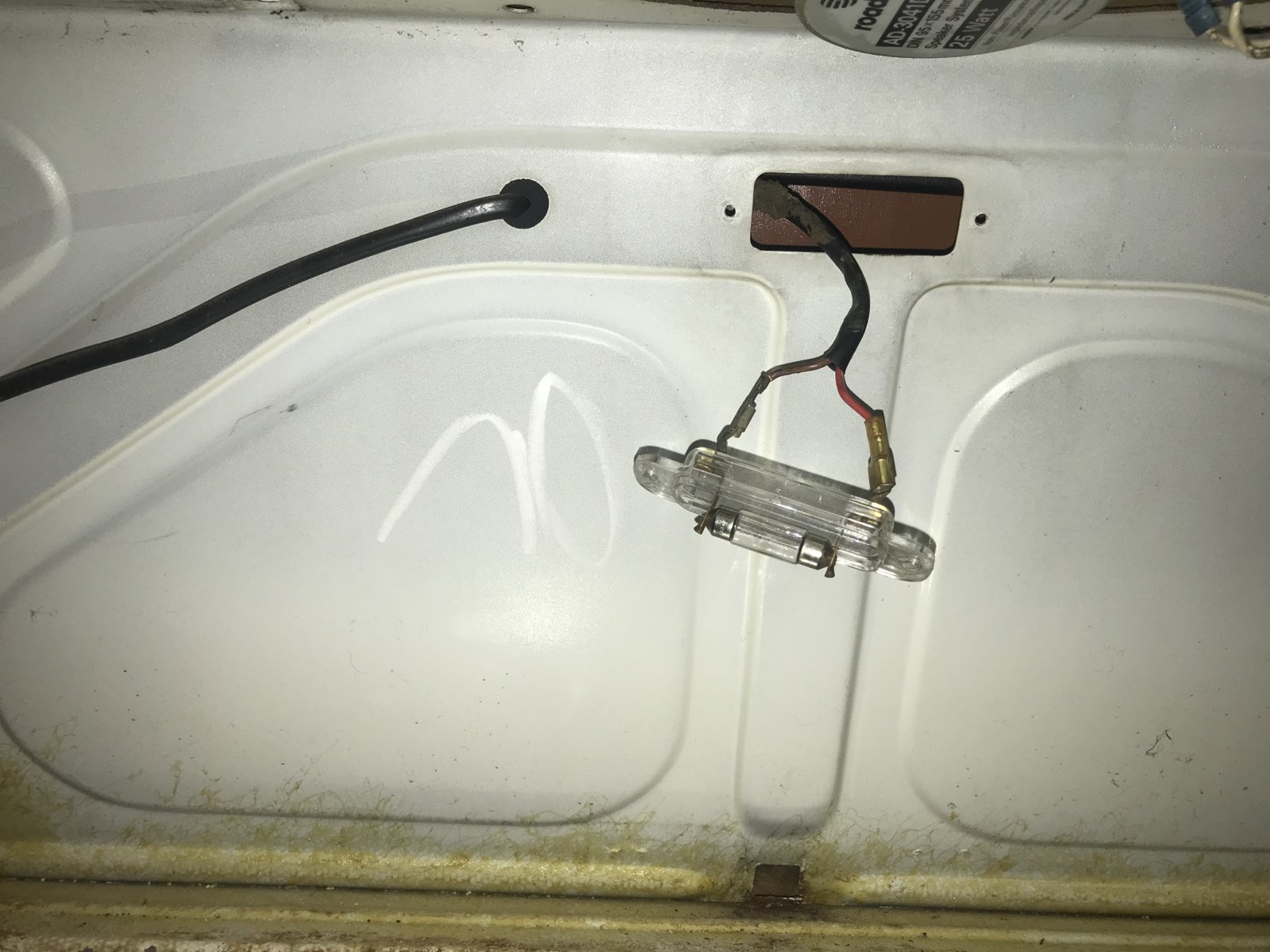

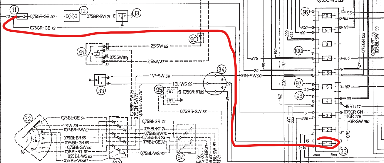

the light will receive a white/red cable that brings +12v
the switch simply touches ground
here the schematics:
correct:
but main light switch is INPUT, and is directly connected by INPUT to 33 that comes from BATT
correct:
Correct, in my fuse box the main light goes to input, top part of the back of fuse 4...
BTW, luggage light works, bulb was dead, but engine light does not work, but does not care because as you said, engine light is for fuse 1, I will check in the future... But main thing is that all lights from fuse 4 works.. Now I don´t know what else to look for...

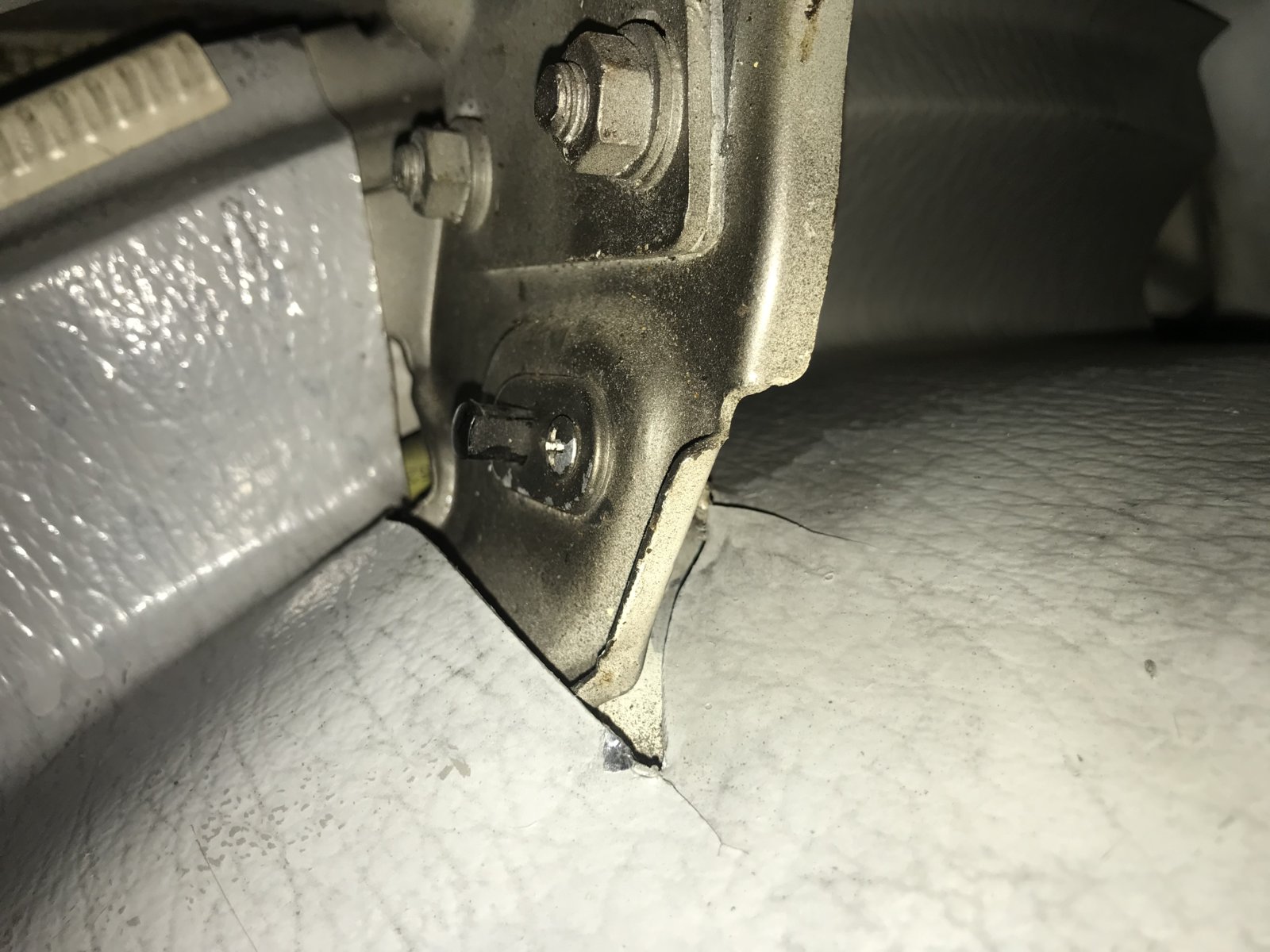

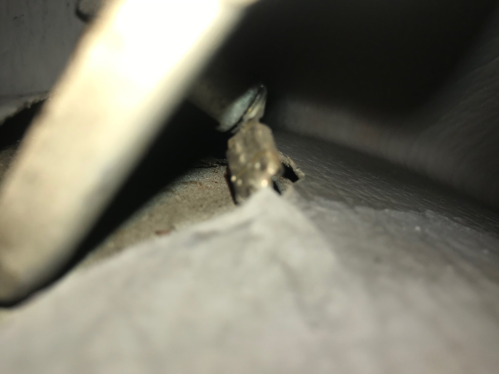

just curious as saw this picture...naked sheet metal...
in my car this is covered by a panel upholstered in elephant skin; was the 2800 a different thing ?
not a all, is because this piece was the only one without elephant skin fake leather, this piece was a plastic hard board with the elephant skin printed (colour and texture) and I have not had the time to reproduce it yet, the rest of the trunk is finished, following your instructions, of course...

I put the bulb from the engine light compartment in the lugagge compartment and light works...
