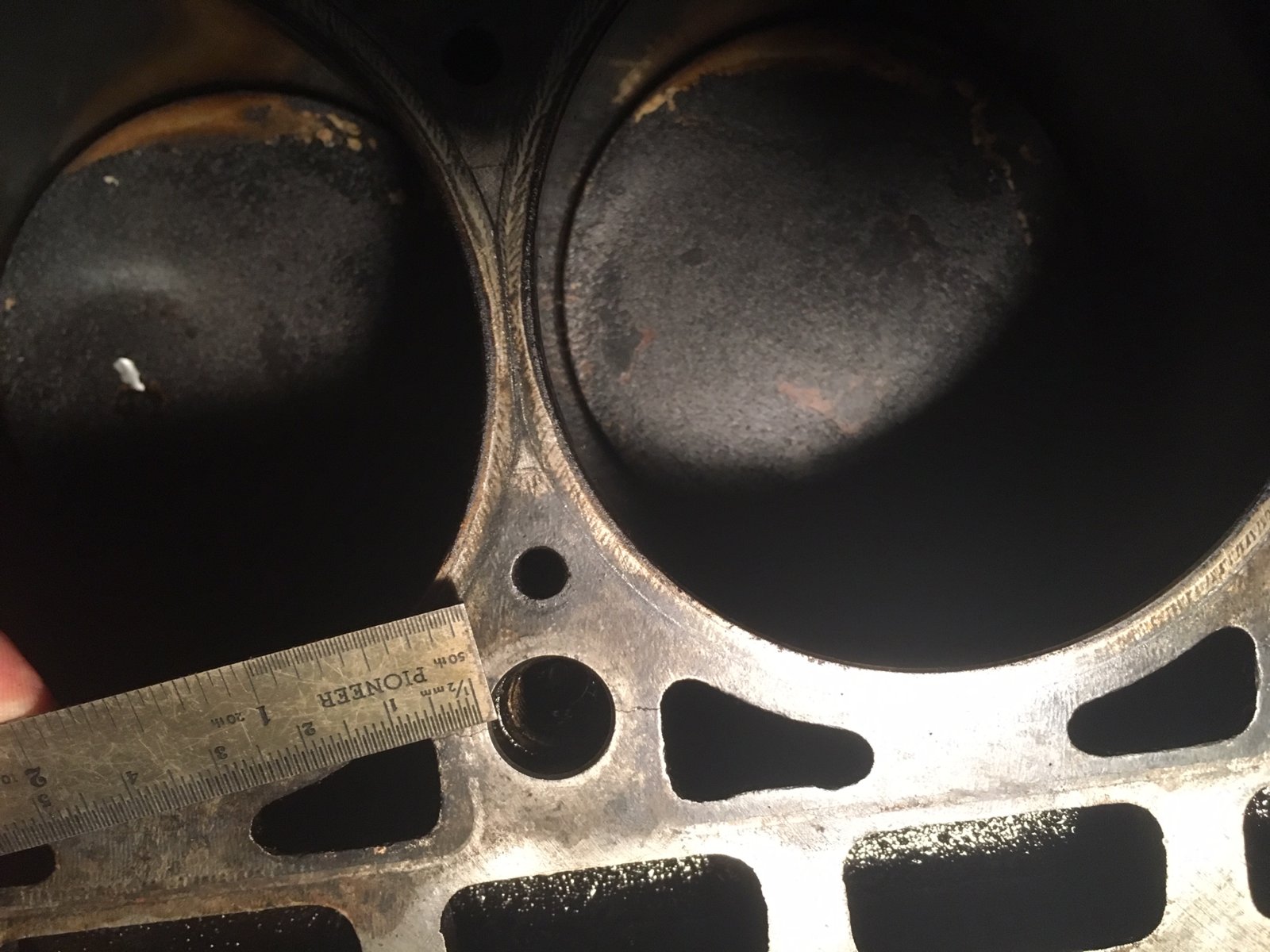

That’s an m90 block bored out with custom high compression pistons fitted for a b35 head. And more..... cam, rods....

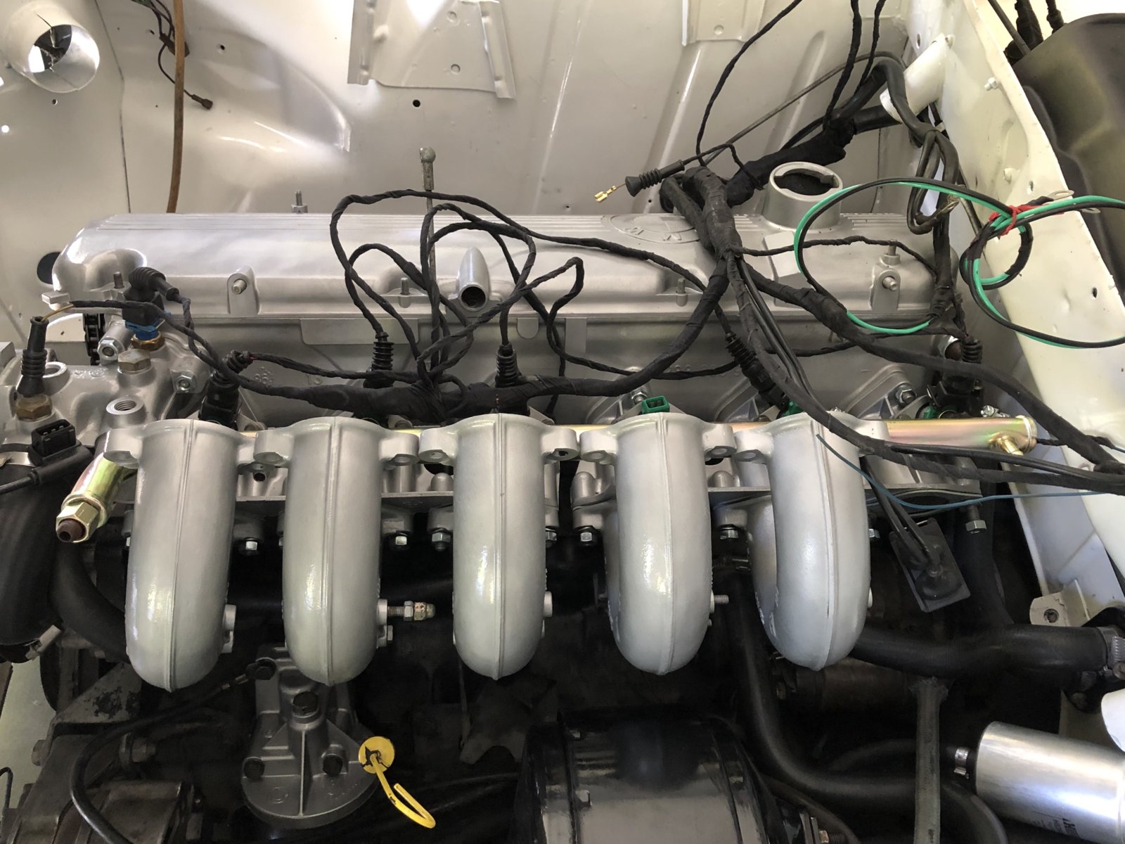

1. I have a dead spot in my ECU / Harness that needs to be found. The problem is that when I push it to around 4-5 grand it cut/backfires, not good.
2. With COVID-19 I haven’t driven it in months and when I did take it out last weekend it ran fine , but when I got home I left it on the driveway for 10 minutes and it would not restart. Checked everything, turned out to be the pulse sensor on the balancer. But still cuts ou t:-(

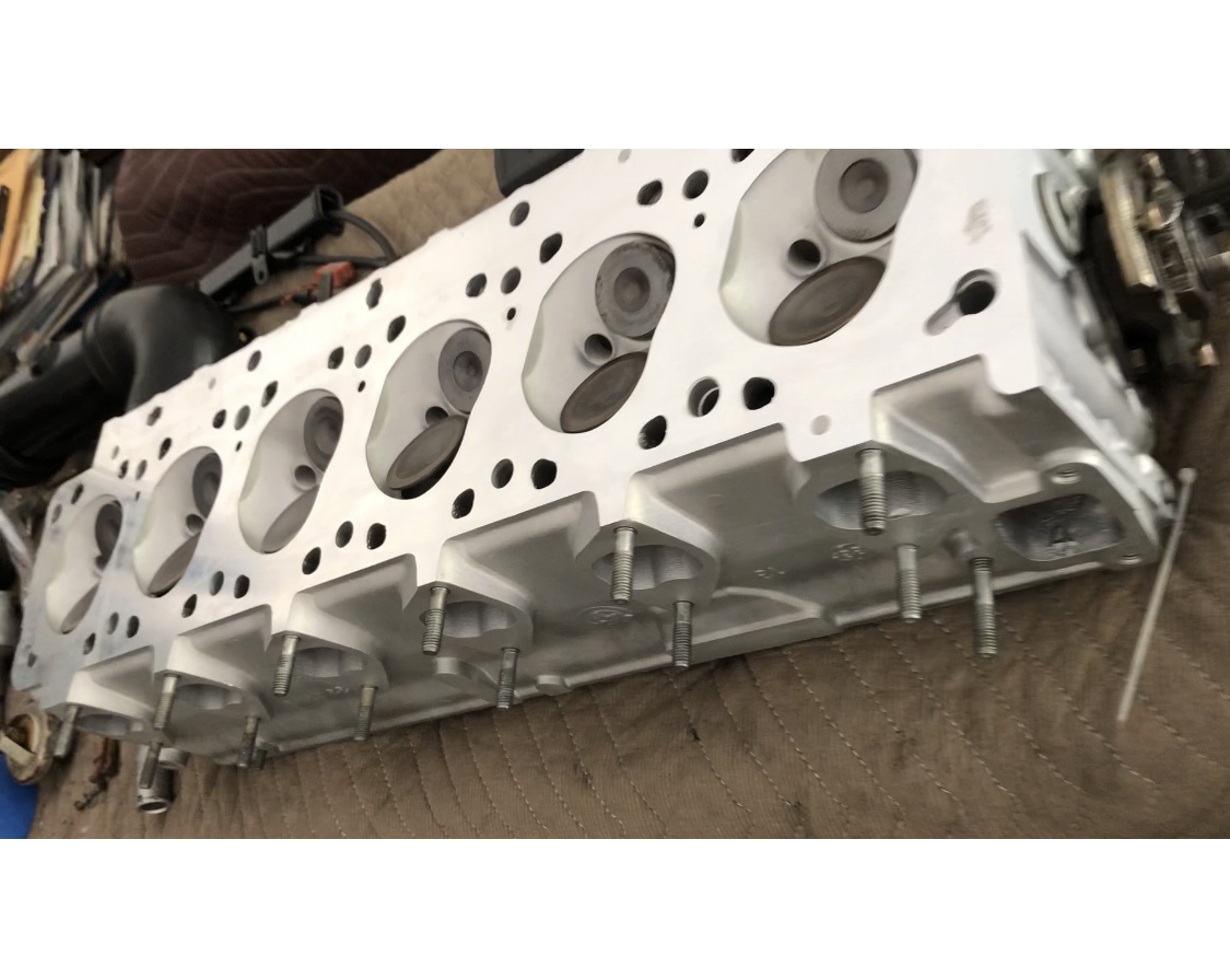

I delivered my spare head to my Machine shop this week. Ordered a cam, dual springs .

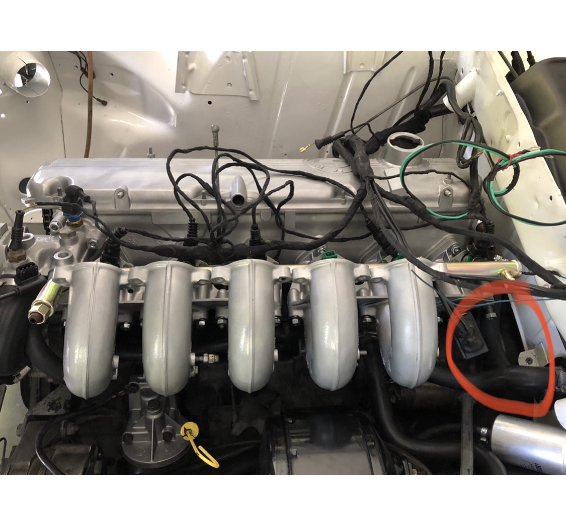

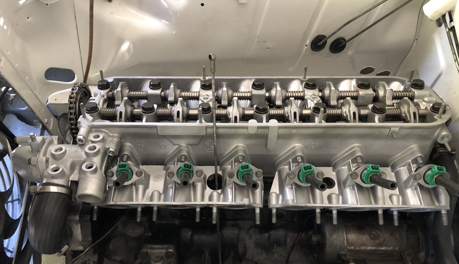

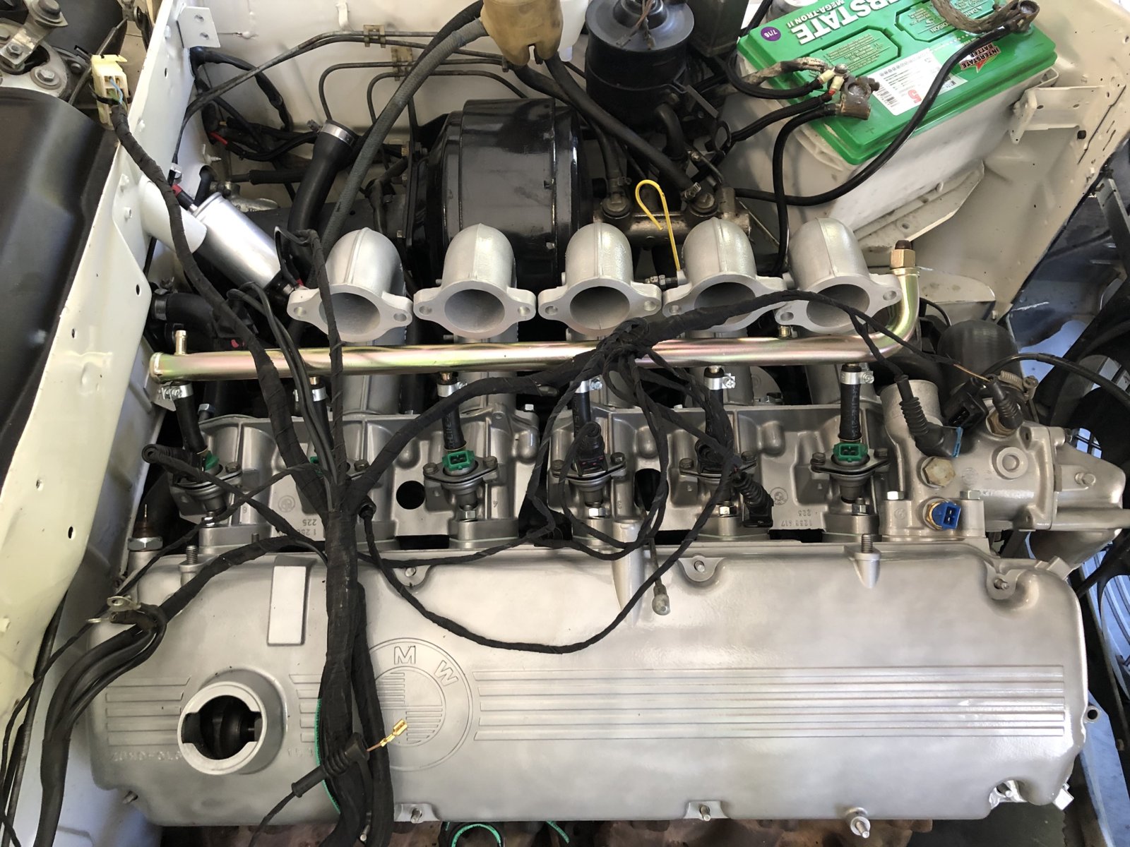

Update

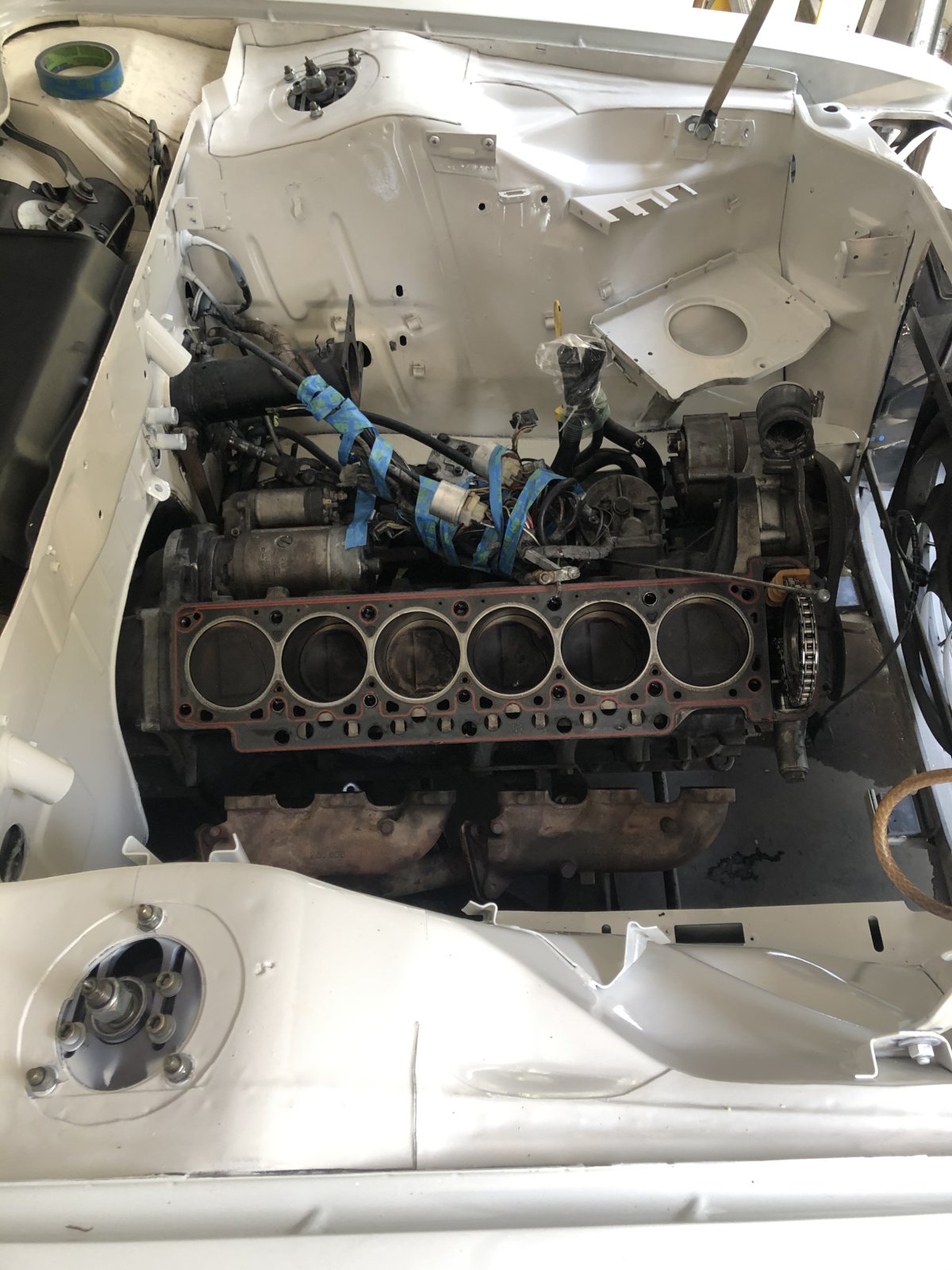

Finally got my head back , parts took more time that I like. Head gasket & other gaskets showed up also.
There was this deep rabbit hole I feel into, you know ... while your in there.

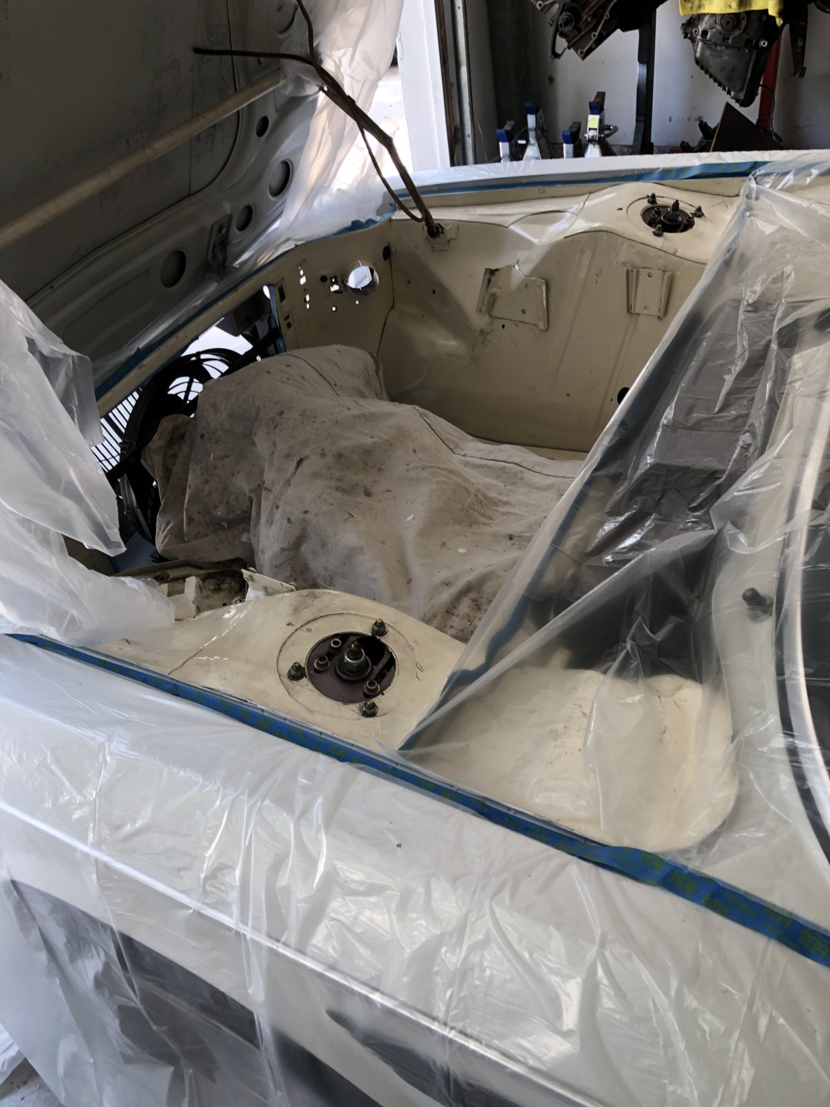

I had painted my engine bay some years ago but it didn’t come out the right color so I stripped everything out and repainted. This time it matched up great.
Old paint
New paint

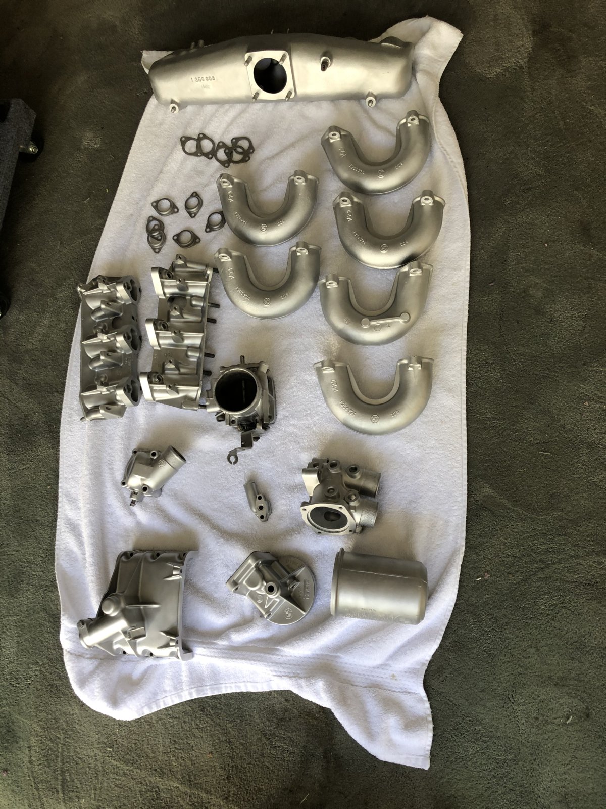

Engine bits cleaned up nicely
More to come soon
In the beginning I wanted to do and learn as much as I could about MS by myself , I had no idea how the harness was going to be so different from the standard old bmw harness. there are things in the harness I had no idea about. So here I am ... helplessly waiting.
