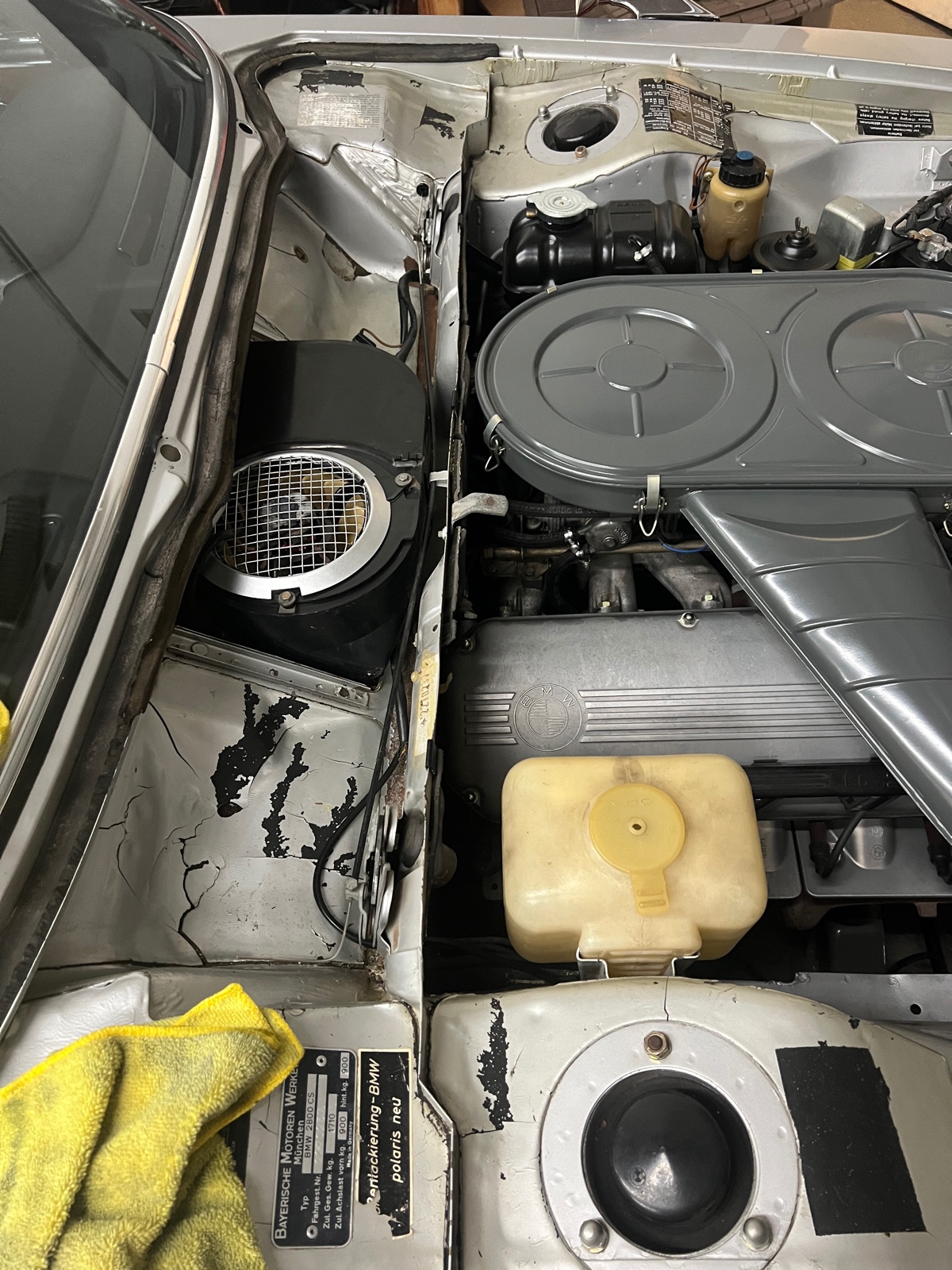

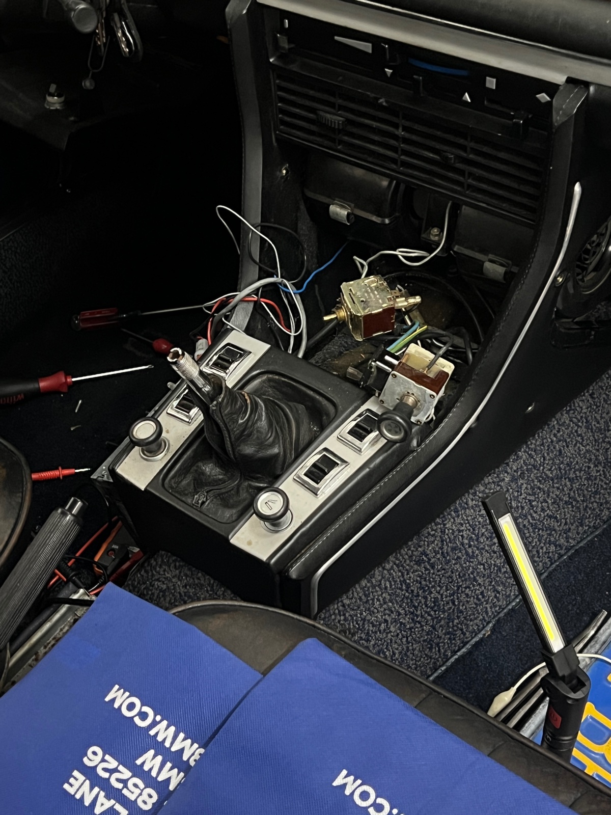

First thing I did was put the heater blower in. This is the same one that was in the car when I got it. I pressure washed out the detritus and sanitized it, then lubricated it and let it sit for almost 3 years. I cleaned it up again and installed that without the grille just to test it. It worked! No noise. Neat. Let's turn on the AC and see what happens there. I switched it on, heard the changeover relay click but that was it. Great. I spent some time researching this. I had power at the fuse and with the wiring diagram, it was clear that I couldn't determine much without getting involved in something I was not excited to delve into.

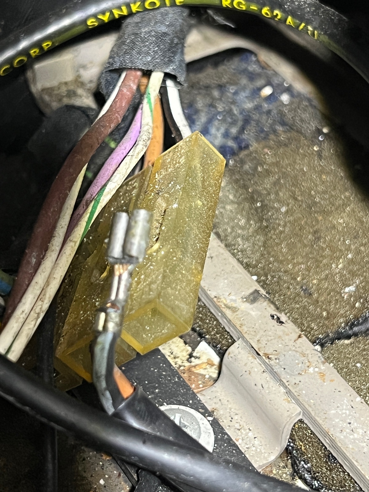

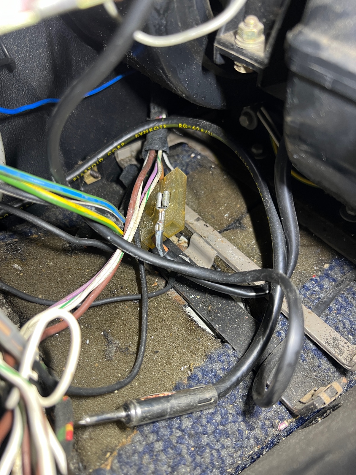

One of the leads was missing off of the back of the temperature switch, but that wasn't the issue. I had to dig deeper. On the fan switch side, I had power going into the resistor, but no power coming back to it. Hmm what's this?
This black/grey wire was wrapped in electrical tape and was just sitting outside the connector block. What a weird way of keeping the AC blower from working. Wonder why this was done. Awful lot of work for something that could have been done a lot easier. I decided now I need to reconnect this and be ready for anything. I did just that. I hooked it back up and turned the blower on. It just worked. Now I'm wondering how long it works for. What is going to happen? What are the chances that there was nothing wrong and this was done for another reason? The theory I had was that this was used to turn on the auxiliary fan but they didn't want the AC blower coming on. Seems nuts, but I think this was done then it was later changed to a dedicated switch. The rodents ate most of the wiring on that. Must be nice.
Now that all of this works, I installed the heater blower for real. Have to do the wiper transmission and motor first, but I have no idea where it ended up. It was in the same place for over two years but I moved it to where I thought it would be safer. Then I couldn't find it. It would be hilarious if it wasn't so sad.

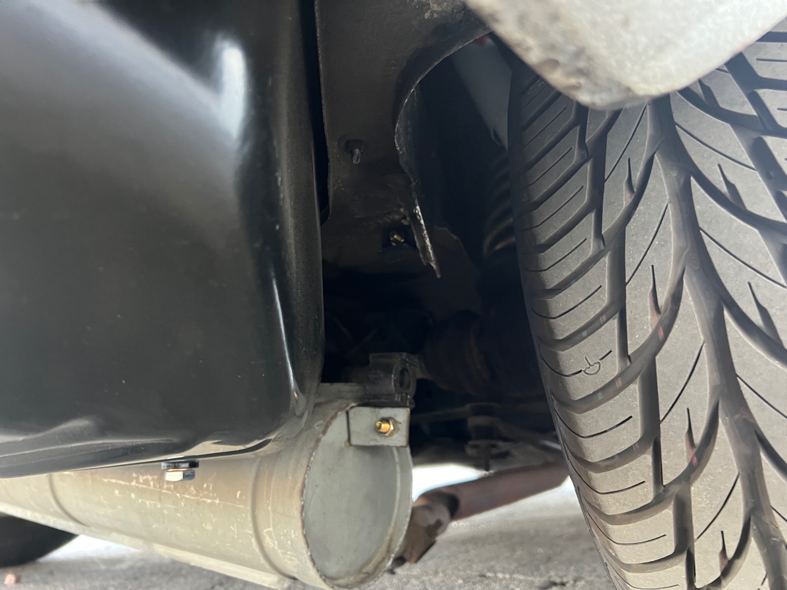

Very impressed with the quality of these new Walloth and Nesch muffler hangers. I found the pair of genuine ones that were previously on the car and installed those. sfdon clued me in to the error of purchasing these so I'll buy some more from a different source. Anyway, back to work.

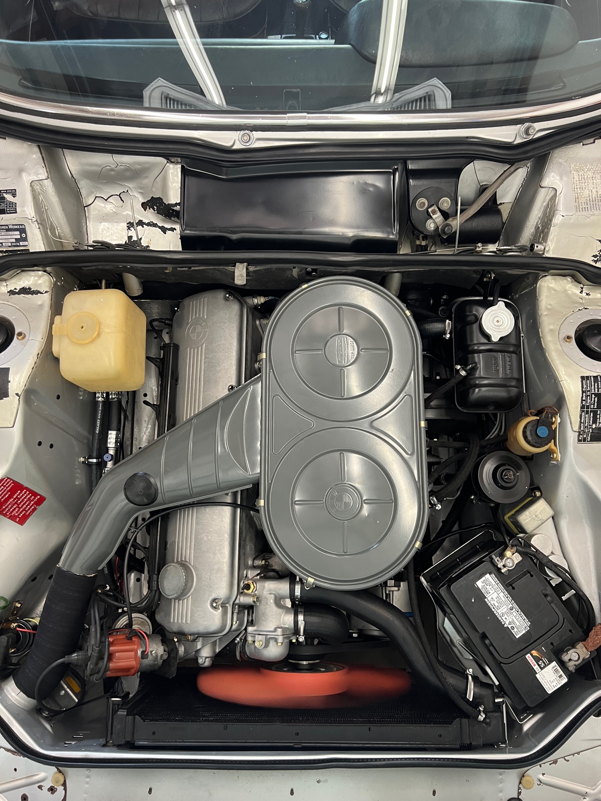

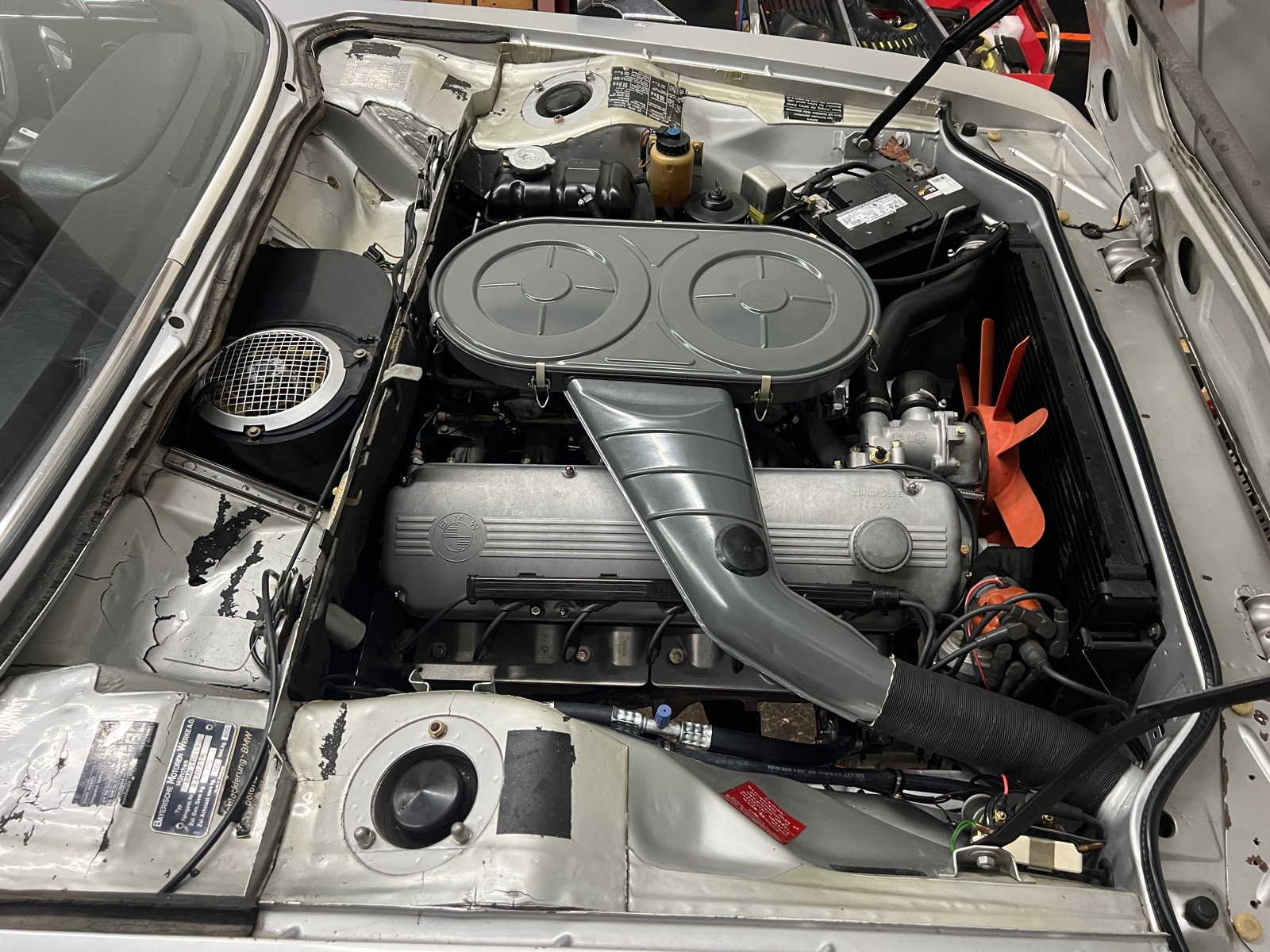

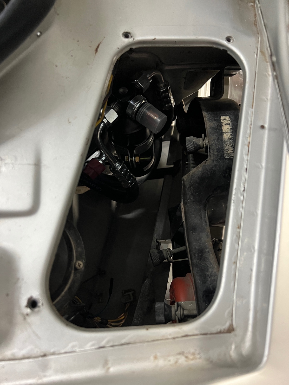

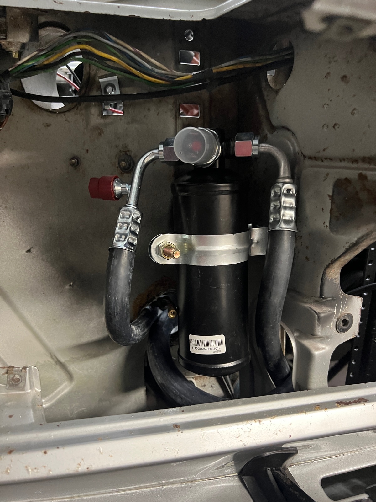

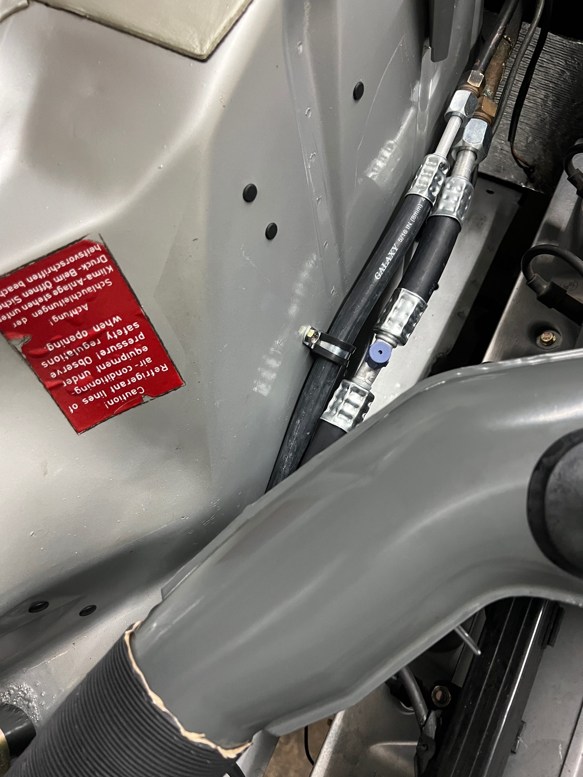

The first thing I did on the project was remove the radiator again. I'm so good at it, I need to stay on top of my game. I had several pieces of my design in stock already, from the condenser, a Spal 16" fan and various fittings. My first plan was to install the drier in the stock location. One problem with this is that I don't have the original bracket. Or maybe I do. Somewhere. I made a trip to pick up a slough of parts with the car and after all of this time, I still haven't inventoried them so I really don't know all that's actually there. Good chance the bracket is there somewhere. Or not.

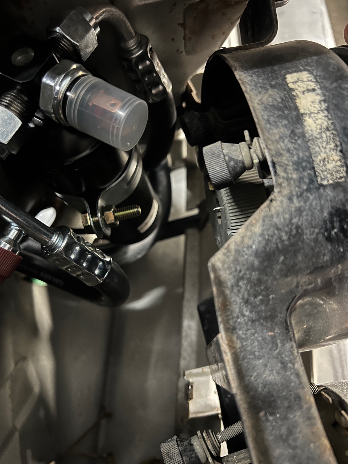

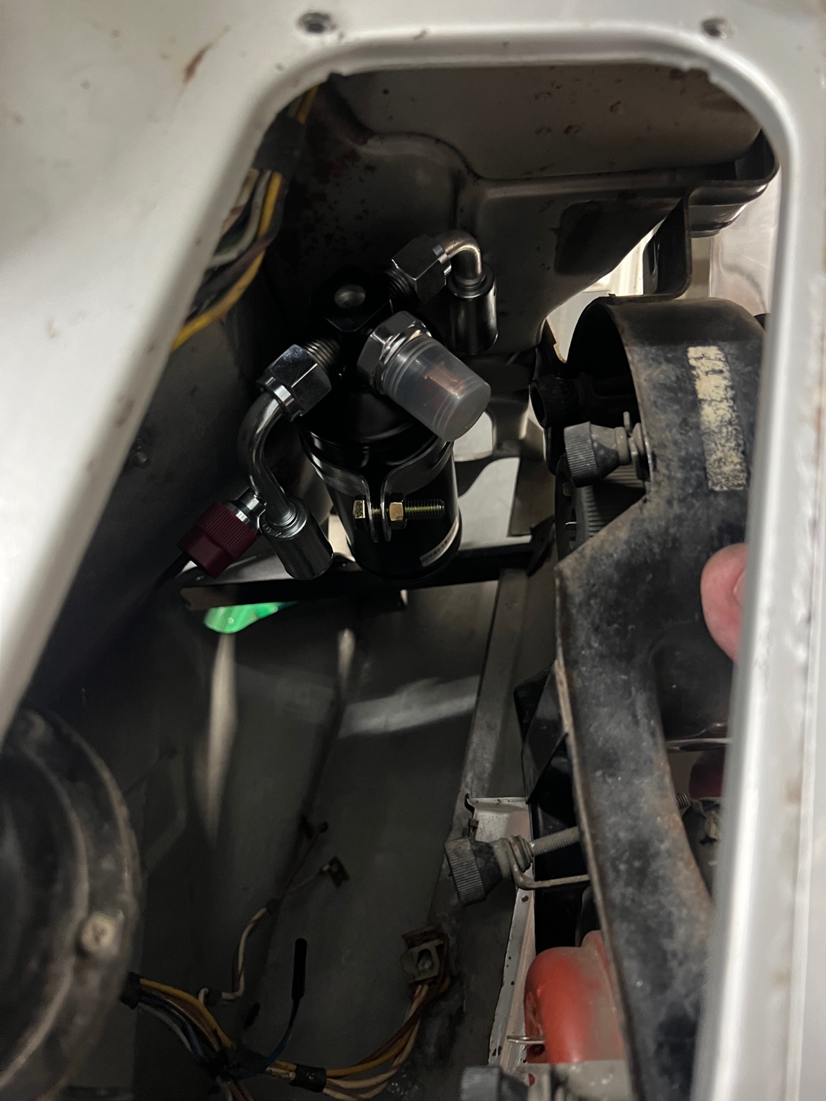

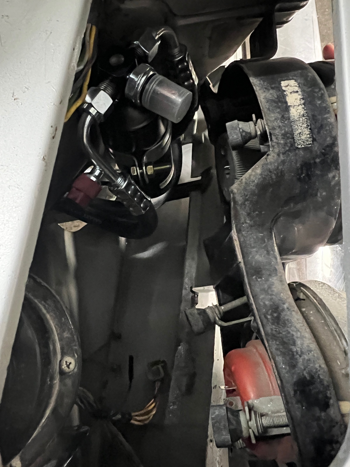

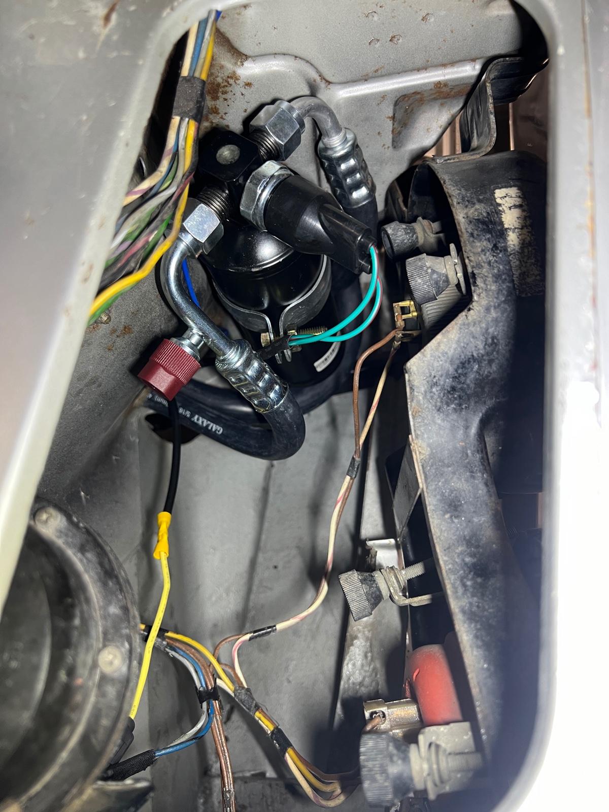

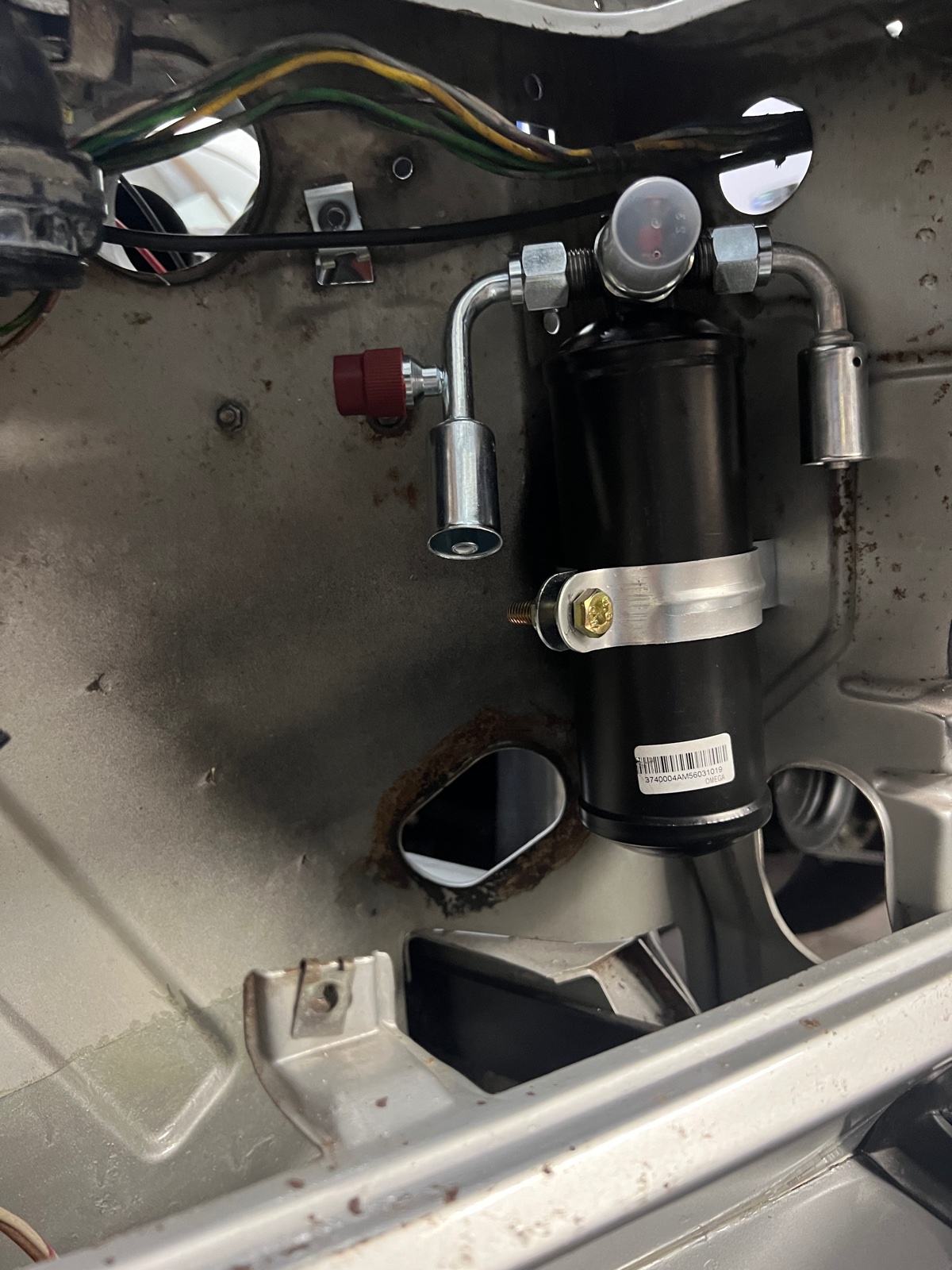

Anyway, I bought a selection of receiver/drier brackets. I bought the short drier and soon discovered that my "plan" was a failure as the short drier doesn't fit in the standard brackets. I exchanged the drier for the tall one and then discovered that this is a terrible idea.
Wow, that's so dumb! Of course, it would almost be okay if the bracket held the drier closer to the inner fender, not out in no mans land like it does, but it's just so...busy.
New plan! Let's look behind the headlight.
I used an existing fastener for the original condenser bracket.

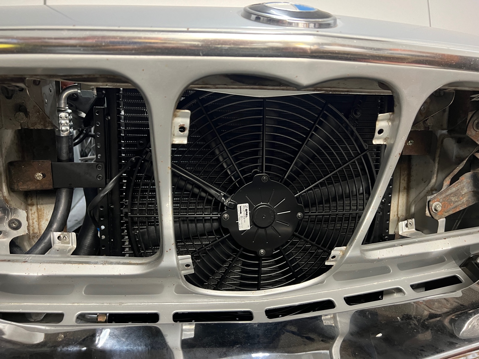

For the condenser, I used a 15x20, which is the same size I put in E28s. I made brackets which I riveted to the condenser which matched up to the existing brackets in the car. I attached the fan using a Spal mounting kit. I actually used scraps left over from previous jobs for the straps and it worked out perfectly.
The inline fuse holder held a ceramic fuse but it didn't hold it well and the fan did not work consistently. I had to replace it with a blade fuse holder and then it was rock solid. I do wish I could have gotten a high side charge port fitting with the charge port on the side, but clocking the fittings as I did gives plenty of room for connecting the hose..

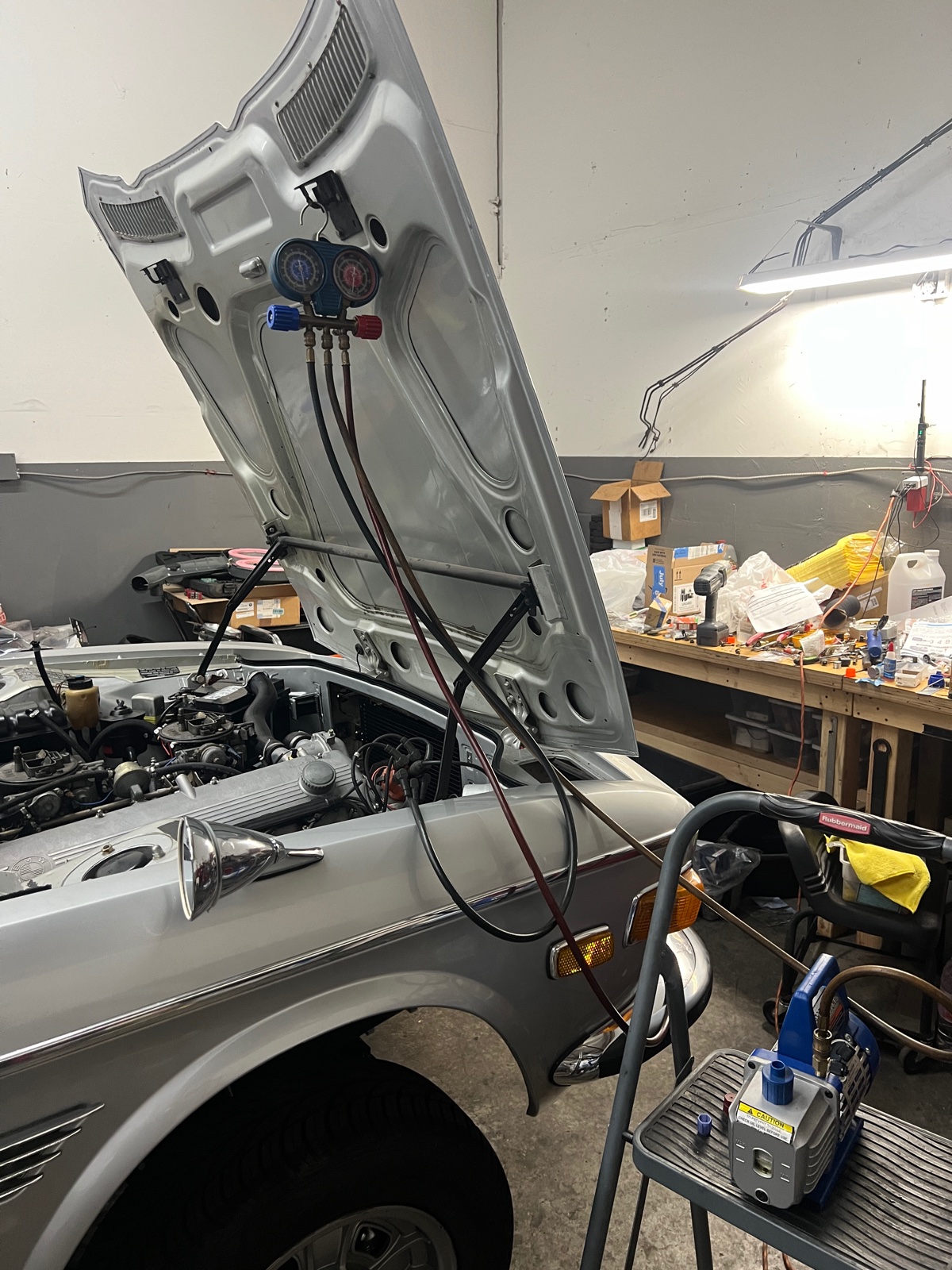

Now that I'm satisfied the electrical portion of the installation is doing it's thing, let's suck it down. I let it suck for an hour, closed the gauges and let it sit overnight.
I like to keep my workbench just so. Well-organized. Can find anything I need in two seconds. Honest.
Well, we passed the test. It held overnight, so let's charge it.

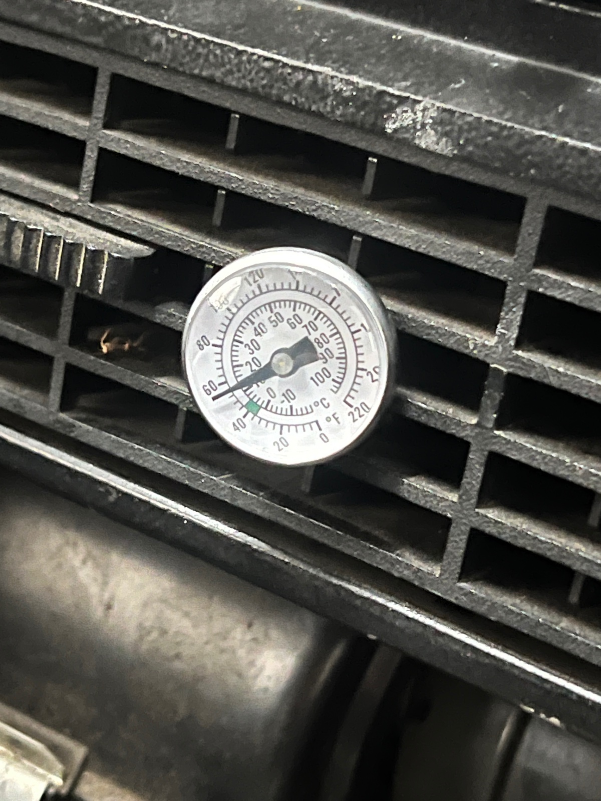

I'd say that works. 117º F outside, about 95º F in the shop with the car idling.
Now we have AC, yay. I tidied up and added a few plugs where the existing holes in the inner fender are, like for the drier and pulse-dampener.

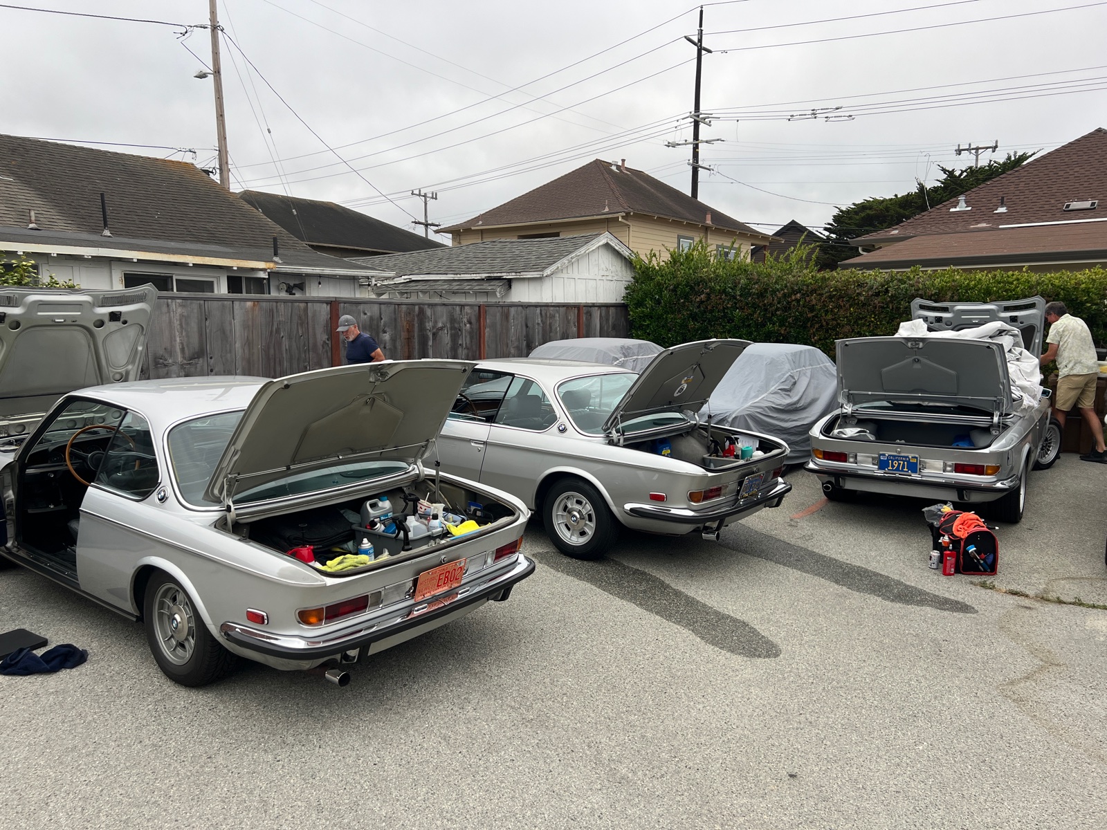

Back to August 12th. Car is all packed to leave. Lots of stuff in the car. Fingers crossed.
Hit the road around 9:30pm. Things are going okay. I'm quite comfortable with my air conditioning. I am simply amazed at how quiet all of the seals are.

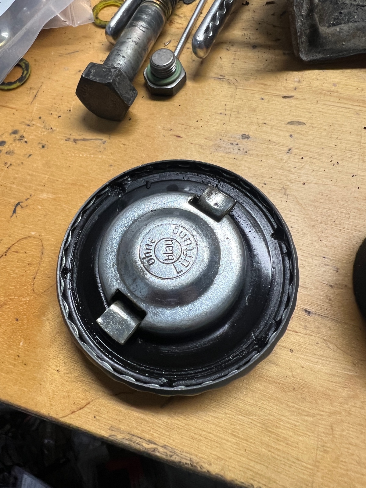

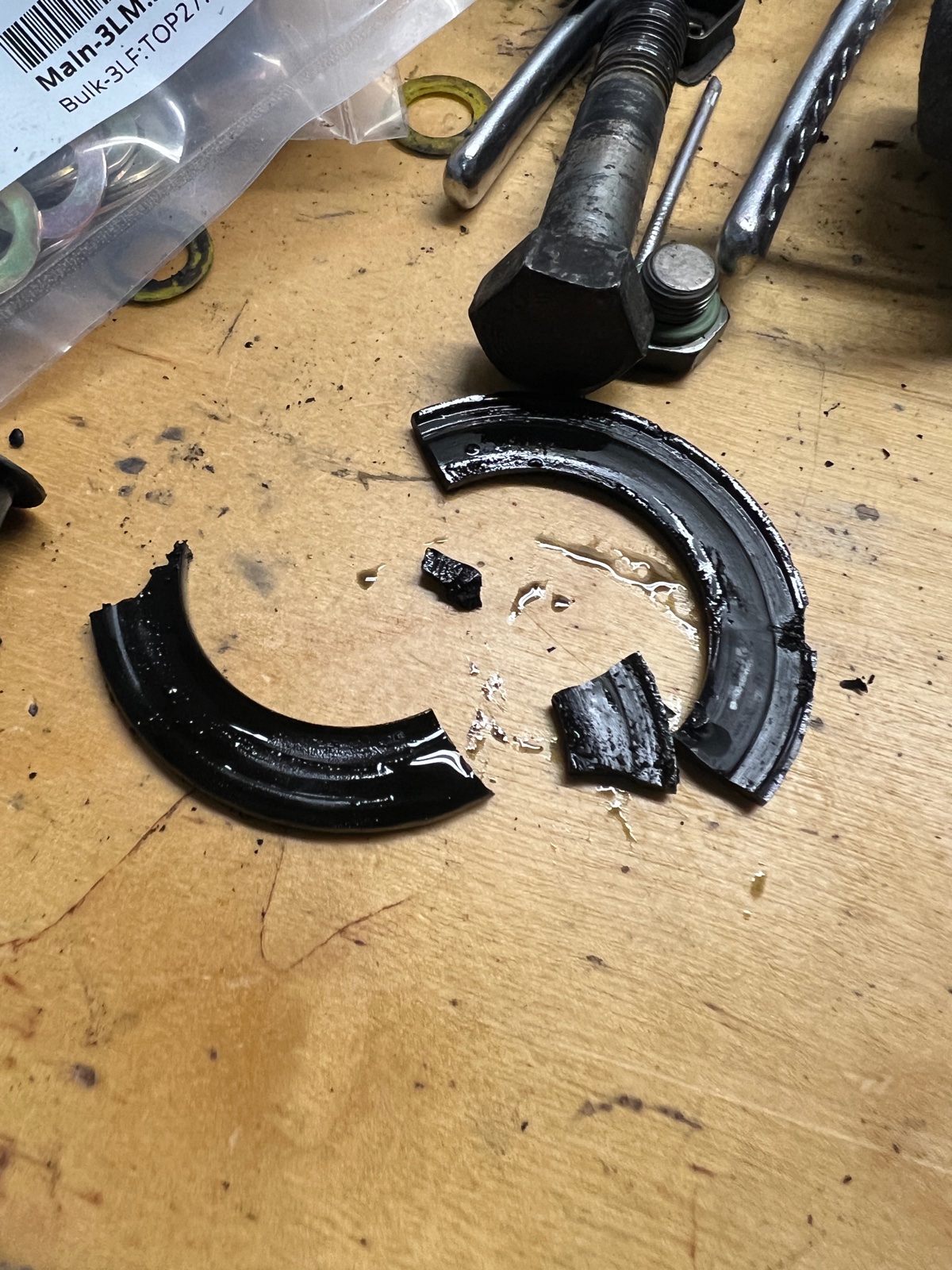

As well as the trip to Monterey and back went, there was one rather frustrating issue. Oil consumption. I smartly brought a case of oil with me (6 quarts - I'm not insane) and I'd have to add a quart at every fuel stop. I also had quite a bit of oil leakage out of the oil cap. I wasn't sure how much of the oil was going out the tailpipe and how much was leaking but I decided I needed to look at the seal on the oil cap. I swore I had replaced it, so I was thinking that there was a tab issue or a valve cover issue. So let me just pop that seal out and have a look.
Well, this doesn't seem to be coming out. Hmm. It was at this point I realized I didn't replace this. About 20 min later, I had this.
I keep new oil caps in stock. I hate this because I remove the seal and end up with a real muffin stump problem (Seinfeld: Season 8, Episode 21). I get stuck with a new cap I can't use because new seal but can't throw away because its a new cap. So, I pulled the seal out, put it in the old cap and put it back on the engine after a thorough cleaning and adding a quart of oil.
Of course, now the question is whether or not this fixed anything.

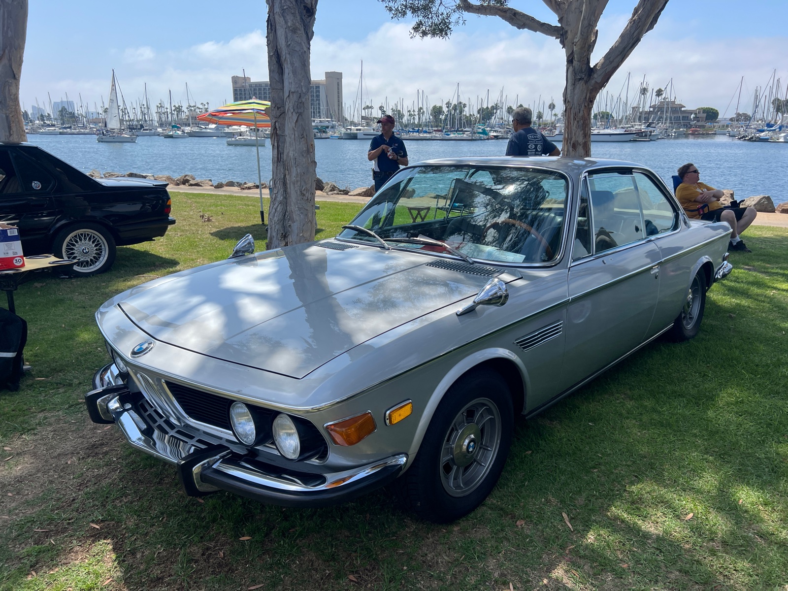

Anyway, the show was quite well-attended and as part of registering you're given a people's choice ballot and of course, the classes were confusing and the majority of those were weighted towards newer BMWs, and to their credit that appears to be the majority of what showed up. You could vote for any car for any class as long as it fit the criteria. I photographed every car there (a fun new thing I tried when I realized I didn't have to change film and have it developed), but here's a few we'd be interested in:
The owner of this car was very excited to get a YOM blue plate on it. He had two early E24 steering wheels for sale (which is what the paper on the windshield advertises).
@HB Chris 2800 looking beautiful next to a "71" 2002 "shitbox edition" in what the owner called "Taiga." Lots of room on the left side for the car that never showed up.
Gorgeous Ceylon CSi in the parking lot.
And of course, my 2800 CS:
