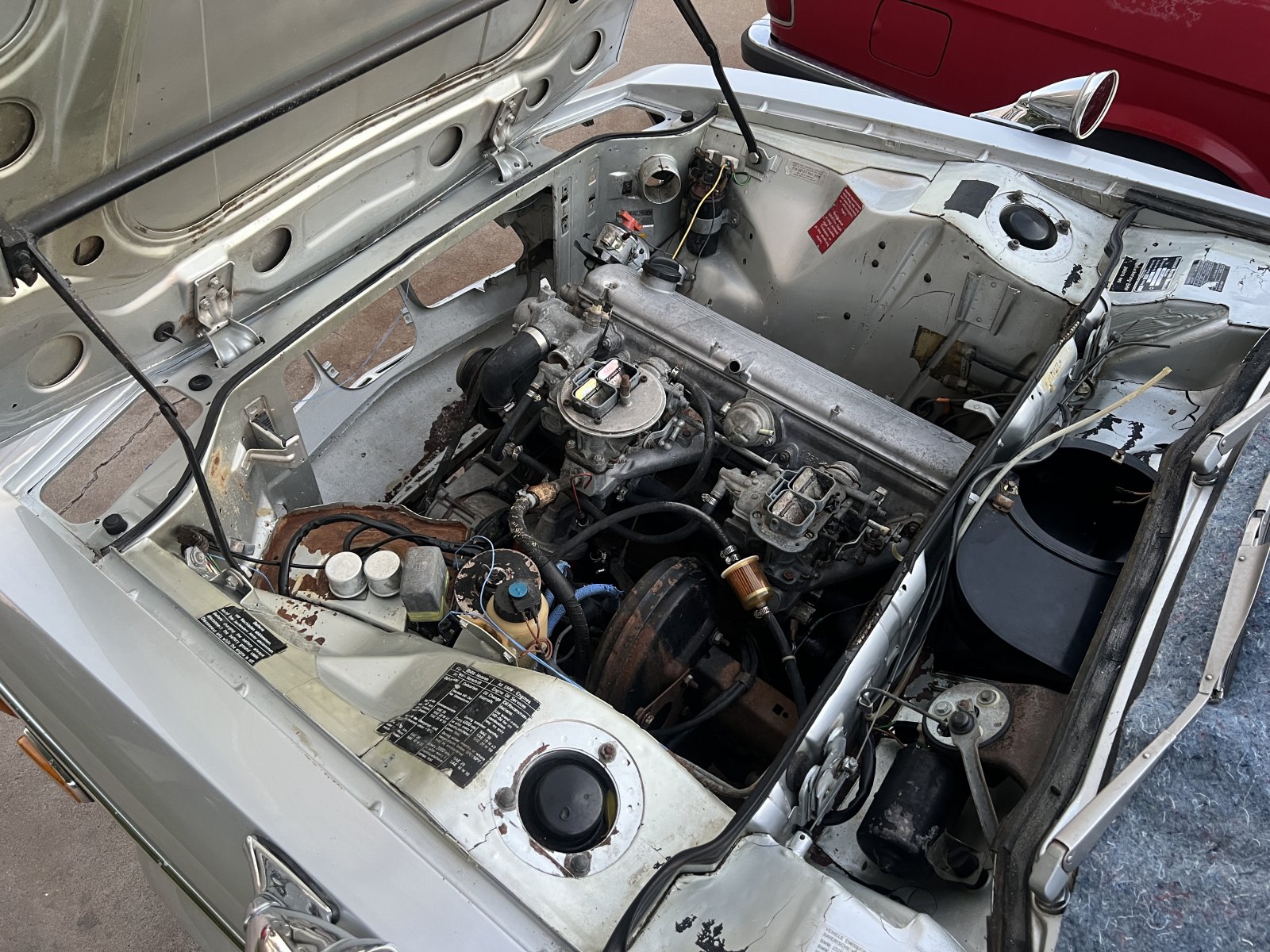

After pulling the fuel tank, I’ve kept up the progress. The tank is at the radiator shop so hopefully it turns out ok. I haven’t yet ordered a sender as I was debating asking for a used one but I should just order a new one.

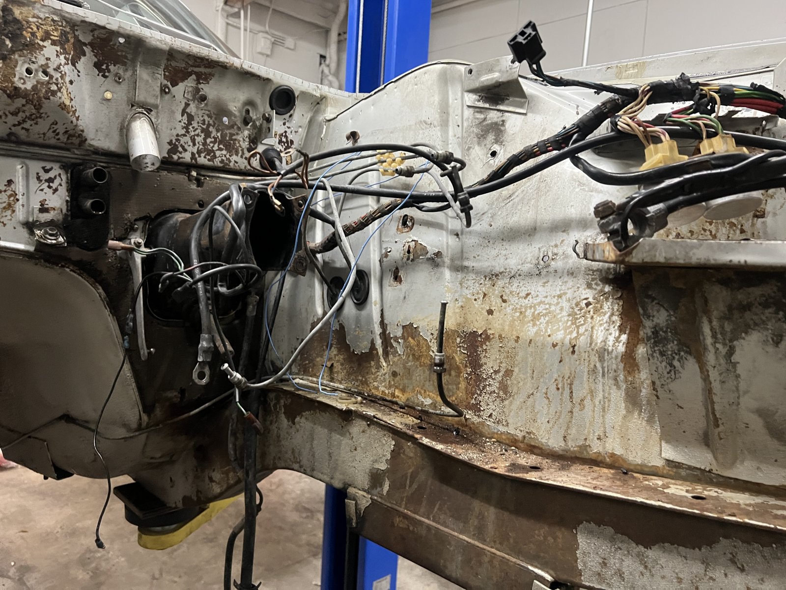

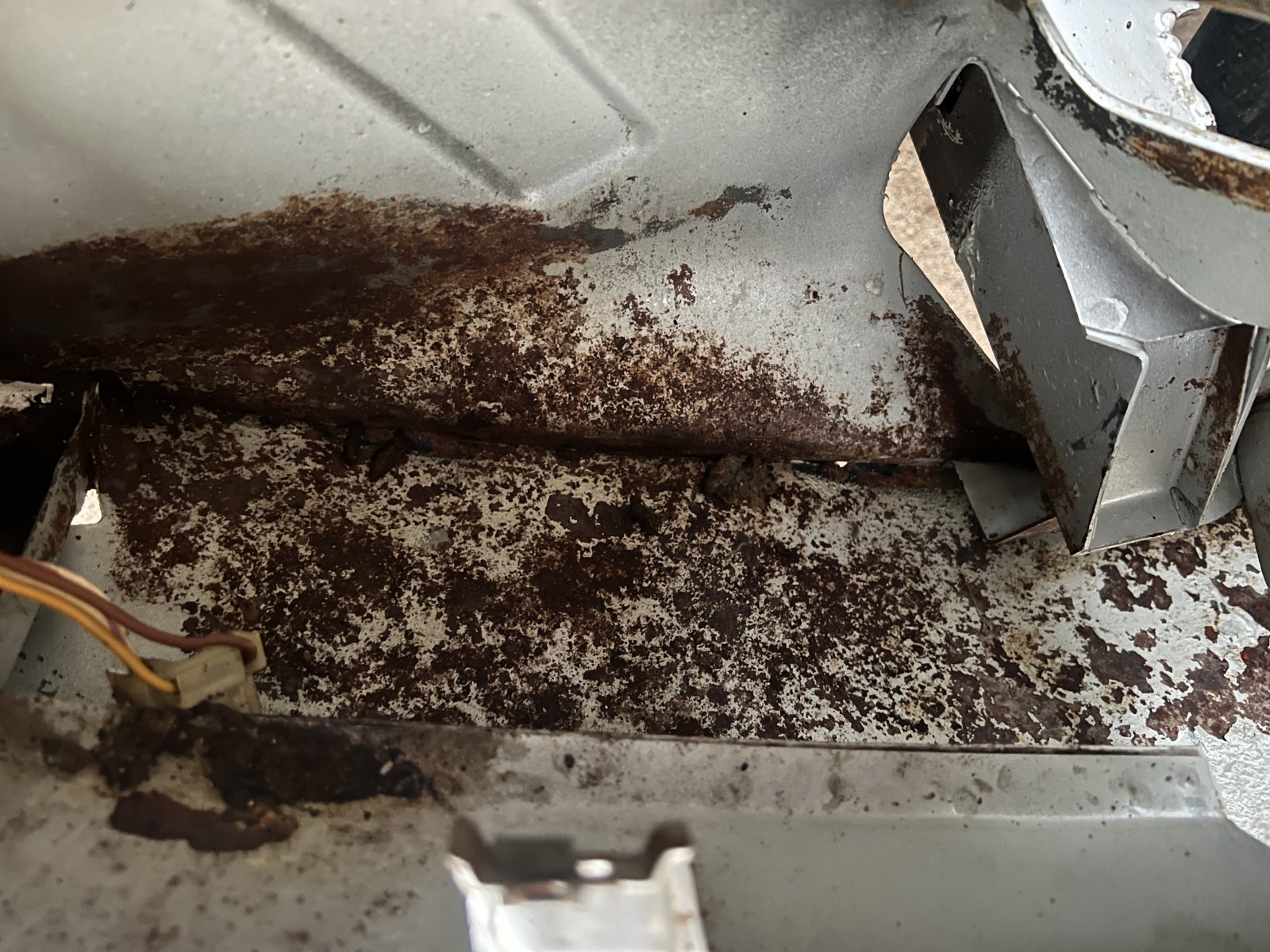

I moved back under the hood to the excitement of cleaning. I had previously tried to remove the cover over the heater but found one of the screws for the rear of the cover had the Philips head stripped out enough to prevent using a screwdriver. I used a small vise-grip pliers and was successful. Not sure what I expected but eww. BB6E06B2-5FF6-4AE1-8B7E-B3D6FCF344A0.jpeg
Naturally, this was concerning but I was hopeful that there wouldn’t be any rodents inside the heater box, given the design, but to find out, I had to remove the fan. First, though, I had to vacuum up all this stuff.

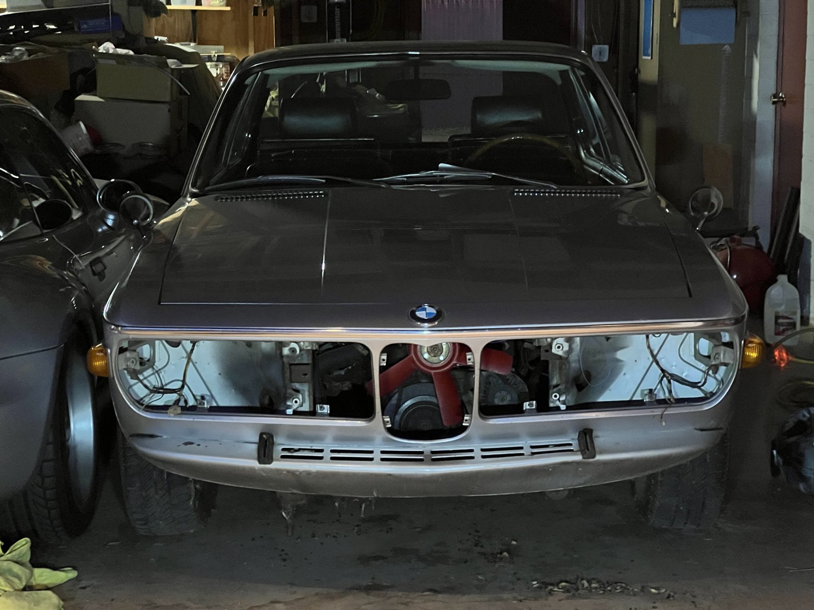

So instead, I decided to remove the “trim panel” under the nose. That went without too much issue and I think it could possibly be saved but I don’t know if that’s worth it. I guess I didn’t take a photo of that. Only have so much room for rodent crap on my phone!

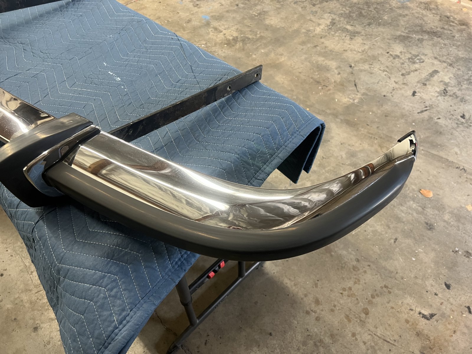

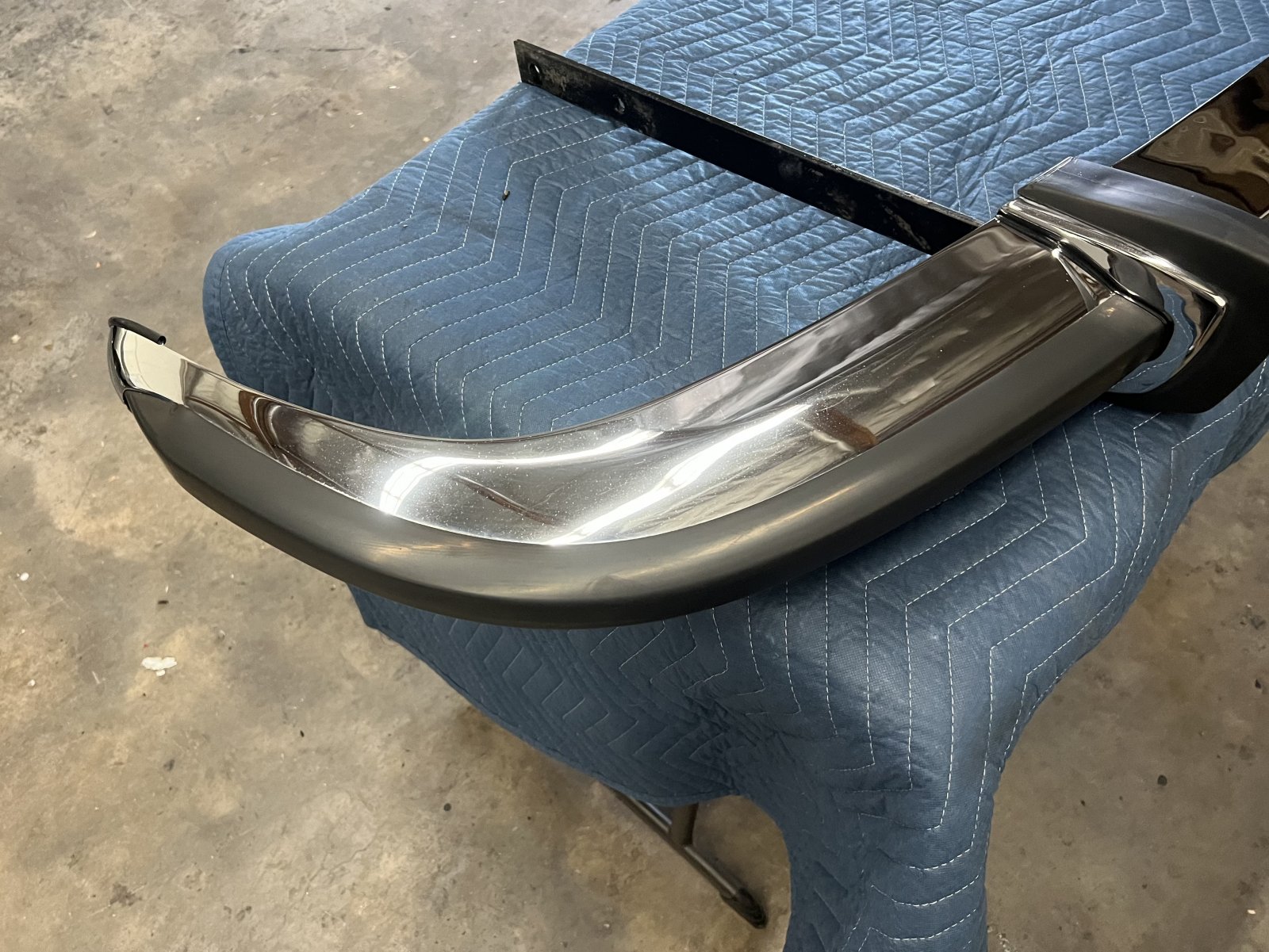

After I removed that I decided to take the front bumper off. It went pretty smoothly and it doesn’t look like it’s ever been off the car from the look of the brackets or the fasteners.
Removing the bumper was mostly to help clean up the nose better and also to give me a chance to do something that will keep me motivated (not that I’m not motivated).

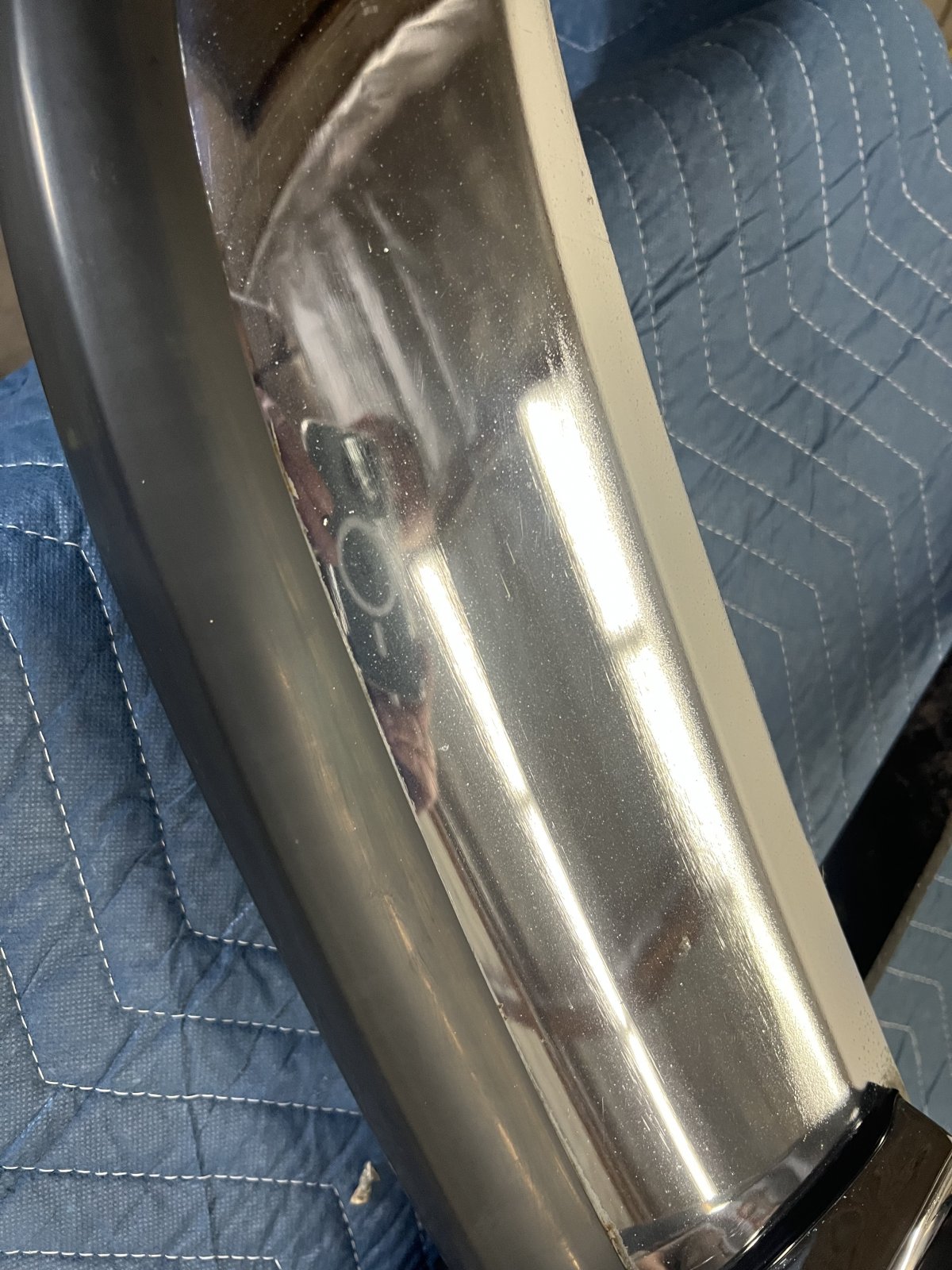

To me, it looks like most all of the brightwork on the car is in really nice condition but the chrome has these freckles on it. Not deep pits or corrosion by any means so I thought I’d start cleaning it up with the front bumper and to get a good idea of how it would go, I started with the bottom.
After a bit of time, this was the result:
I did the whole bottom and then moved to the top:
It cleaned up pretty nicely and while it doesn’t look brand new, it fits the car. I put it aside in my “reception area” so it’s safe and out of the way while I work on the rest of the car once it’s here at the shop.

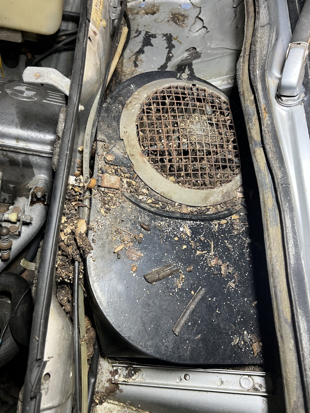

Back at my house, I finally had the shop vac and vacuumed up more stuff at the base of the nose. I carefully removed the headlight covers to assist with this plus they and their hardware need to be cleaned up anyway. I also removed the heater blower motor and vacuumed the small amount of junk that likely fell out of the fan during removal.

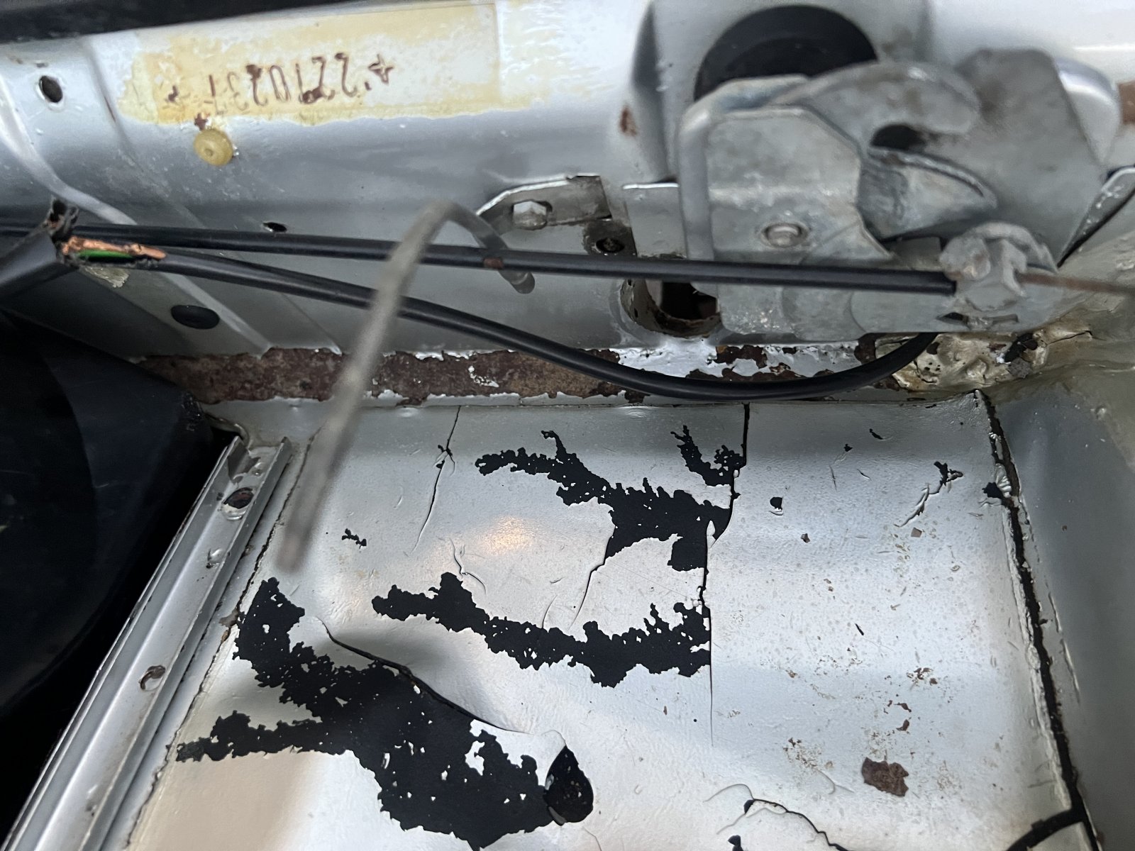

The flap was closed and I felt like I won the lottery on that one. I used an endoscope to look around the partition in the box. I don’t want to open the flap until I clean and sanitize this part of the box.
Also note that a couple of wires were chewed up (green and brown). They go through the small grommet above the valve cover. The other pair of wires (also green and brown) go to the washer pump I believe. Shouldn’t be hard to fix.
I then set my sights on the hood insulation. There are areas that had been chewed upon. Fortunately it wasn’t original, but also had a couple extra pieces added. It was quite a bit of work, but I worked at it methodically and while my fingers are quite sore this evening, I was quite satisfied with the outcome.
That’s where it’s at now. Will probably spend more time cleaning under the hood tomorrow and then tow it to the shop so I can get to work on more mechanical stuff.

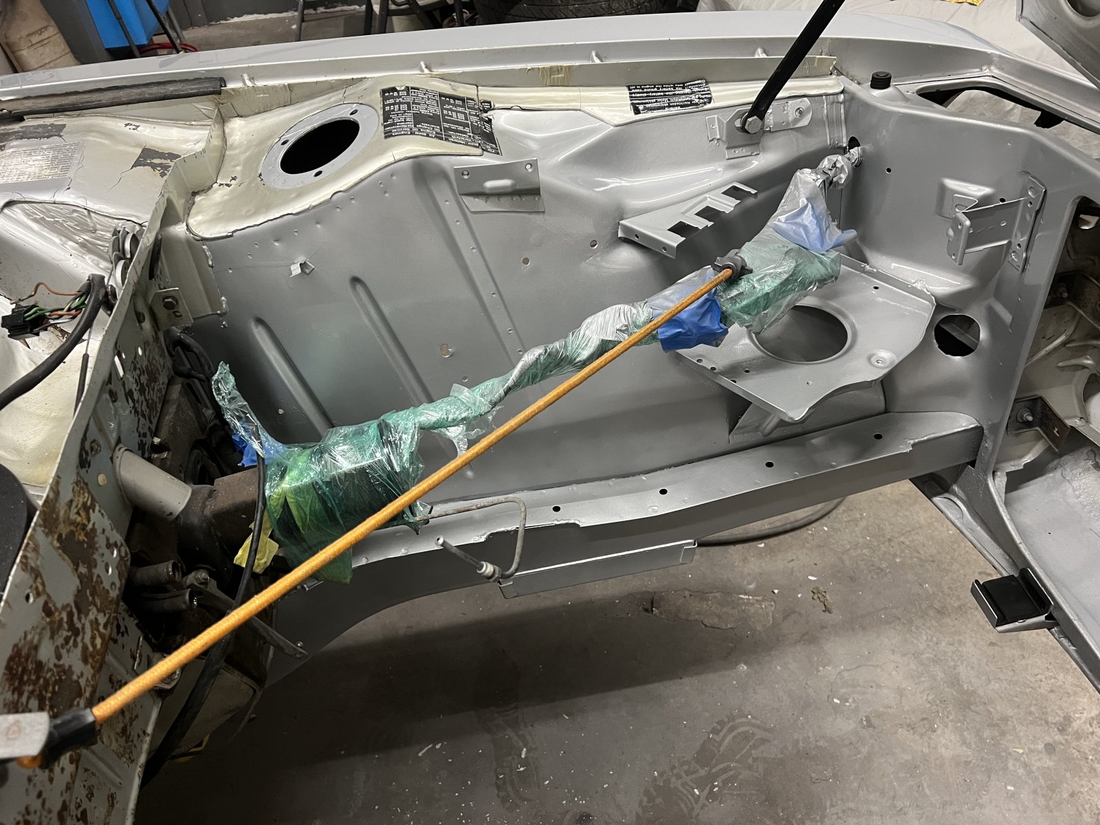

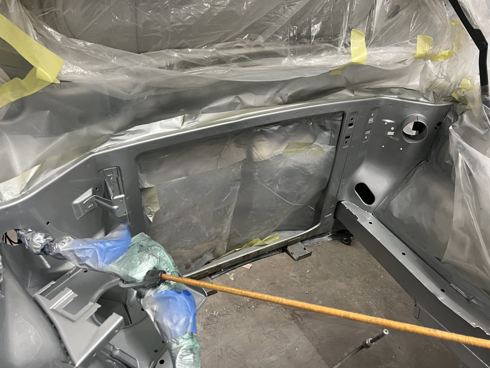

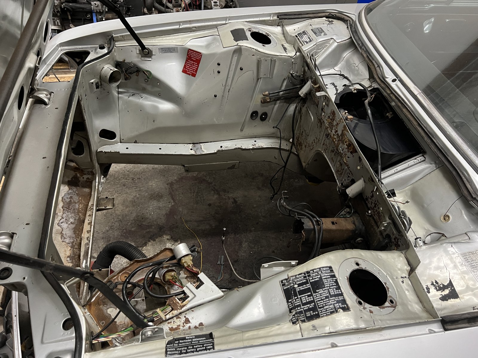

Yes, another update but this one is free of feces. We had a “warm,” sunny day today so I used the opportunity to do something that I think needed to be done but at the same time is a bit risky. With so much rodent activity and the results of said activity, I’m unaware of really any other way to rid the vehicle of the after effects than using the pressure washer.
To prepare for this, I put a bunch of effort into isolating the rest of the car from the affected areas. I covered all of the surviving labels with painters tape, I covered the aluminum belt line trim with tape and also as much of the exterior paint as possible with both tape and plastic sheeting. I’m very careful with the nozzle but one mistake and it’s too late, so best to do my best to avoid it.
I think it’s much improved and things dried out much more quickly than I anticipated so I could breathe a sigh of relief. At least I think that’s what it was. Either way, I think if you look back to previous photos of inside the nose, you’ll agree.

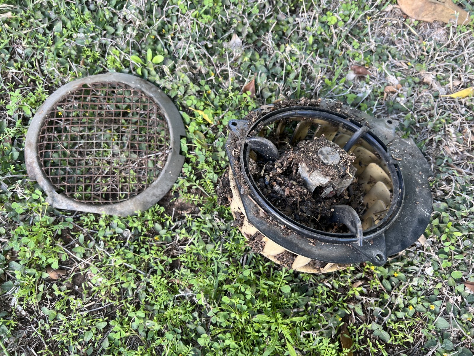

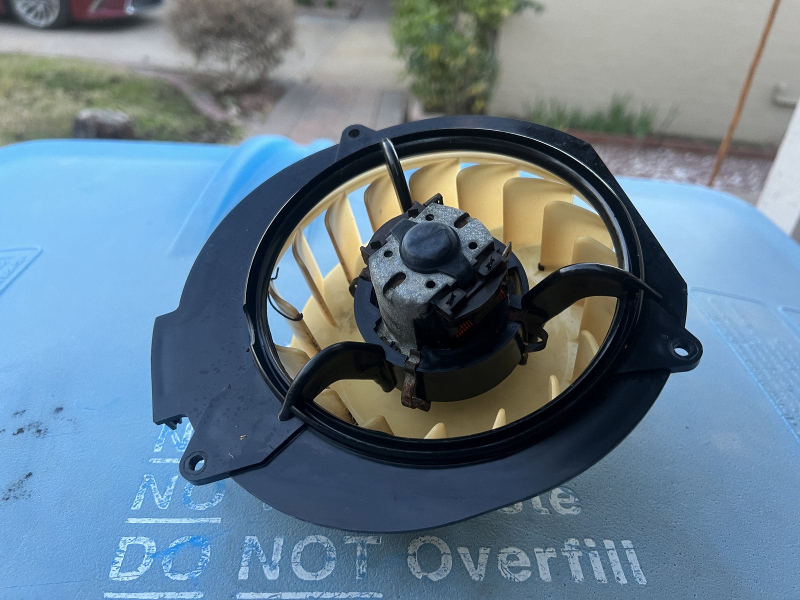

I didn’t have much hope for the heater blower but I had to rid it of all of the detritus it accumulated (and thankfully didn’t transmit throughout the car). Once I emptied it out, I decided to hit it with the pressure washer as well, then cleaned the motor itself out with brake cleaner and electronics cleaner and then hosed it down with Deox-It. I think it cleaned up pretty nicely and it spins smoothly which was a real surprise. Going to let it sit a while longer before testing it but I’m still surprised how it turned out, especially given the “before” photo.

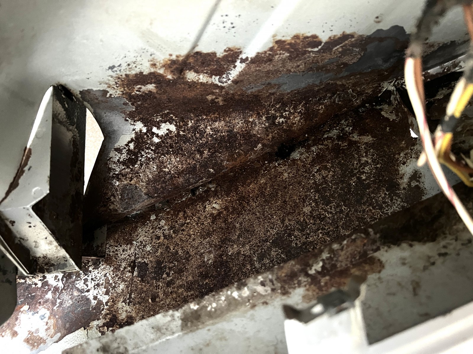

For the front noose I might suggest Rust911... It is non toxic and once sprayed it will eat all the rust without rubbing or sanding.
One example of usage:
I would avoid any sanding of that car and acids are too risky to be used. So Rust911 could be a nice option to consider is some places.
Later on to cover (isolate) the bare metal after treatment and you can pait it being sure there is no rust even in between the point welds as long as the solution was reacting for some time.
Nice job on the clean up. The acids from rodent excrement look like they didn’t do too much damage! Bumper tuned out really nice dude!. I hope that blower motor works, it was really worth a shot with the power washer.
Thank you and thanks for the suggestions. I feared the worst with the effects of the acids and the amount of time it had accumulated so while it’s not attractive, I feel much better about it. I have a large quantity of evaporust I was considering using say soaked in a rag to keep it on the surface but I’ll investigate the Rust911. Great call on the blower motor. I had looked it up and had only seen the whole assembly for considerably more. Thank you.

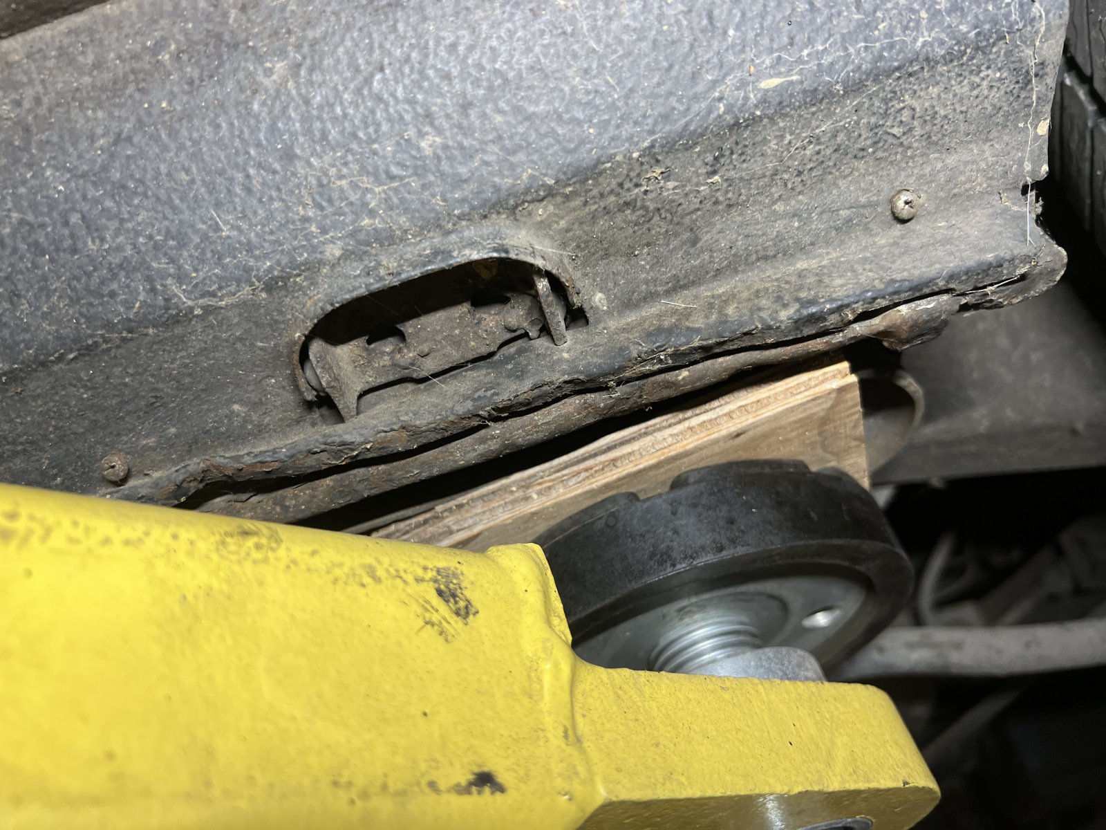

I was able to get the car towed over to the shop from my house and got it on the lift. Pretty exciting.
This was exciting because this will help make more progress on the car but I also haven’t been underneath it. I naturally looked under it just kneeling down, but I didn’t get the opportunity to inspect the body so I didn’t know if there was something lurking. Here’s a handful of photos under the car:
I have to say I was pretty pleased. Amazed I ended up with this car. Excited to keep moving.

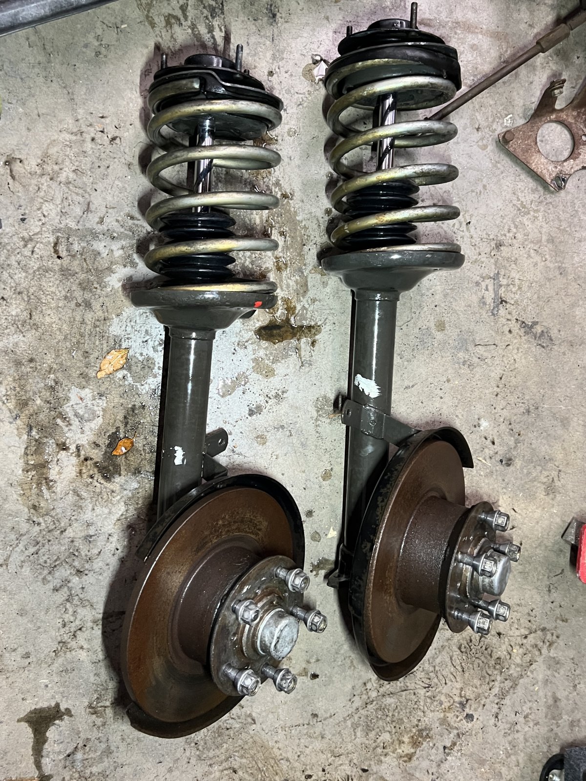

I decided to call it there as it was getting “late” but had enough time to pull the wheels off and check things out. I was surprised to see all of the ball joint boots were in great shape and there wasn’t any play in the steering linkage. The bushings need replacement so that will happen.

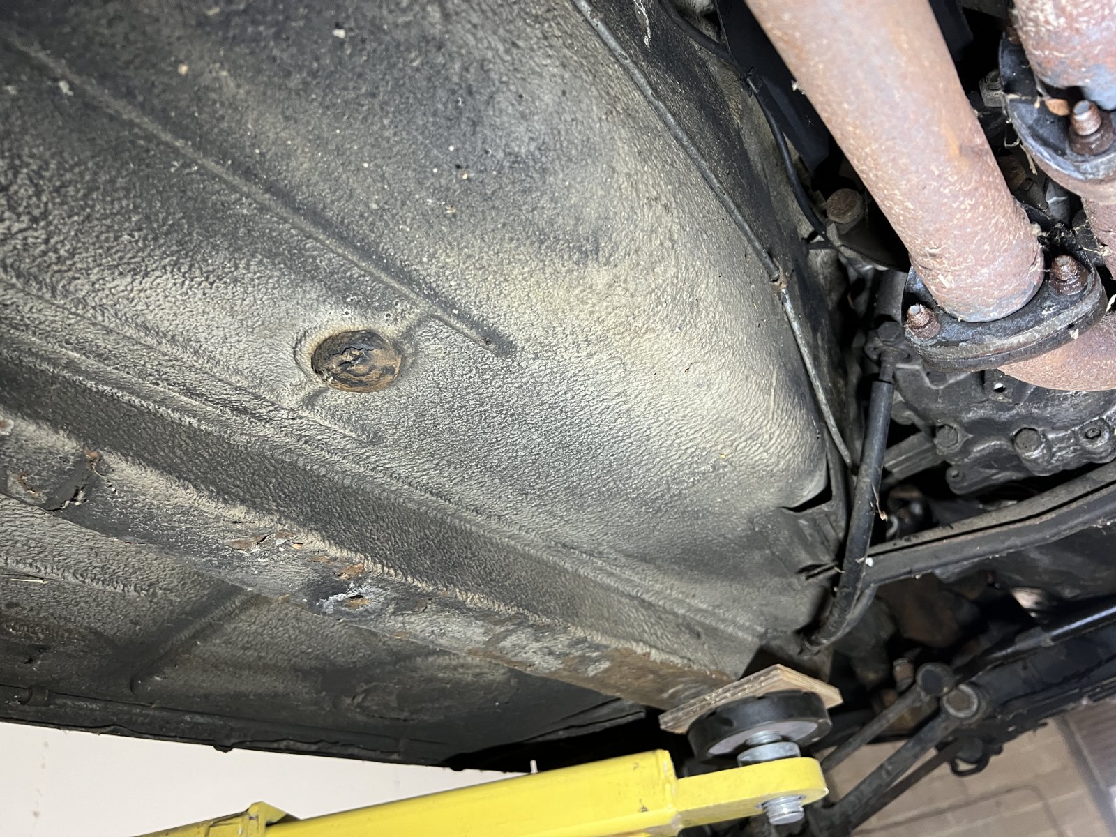

I was surprised at how light the stock wheels are. I pulled the drums off in the back and yep, they’re drum brakes. Wheel cylinders aren’t leaking but they might not have any fluid. The brake hoses are braided stainless but I’m sure they’re well past their service life, so I’ll replace them.

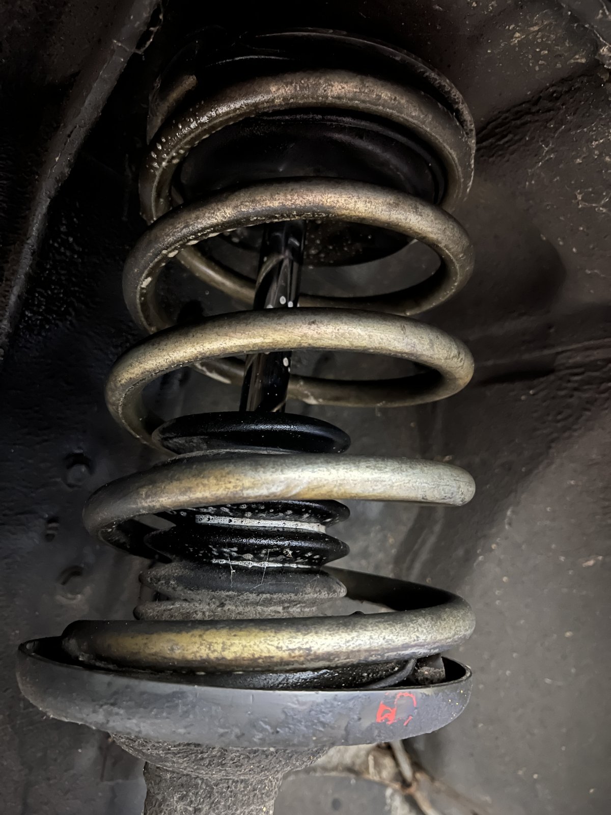

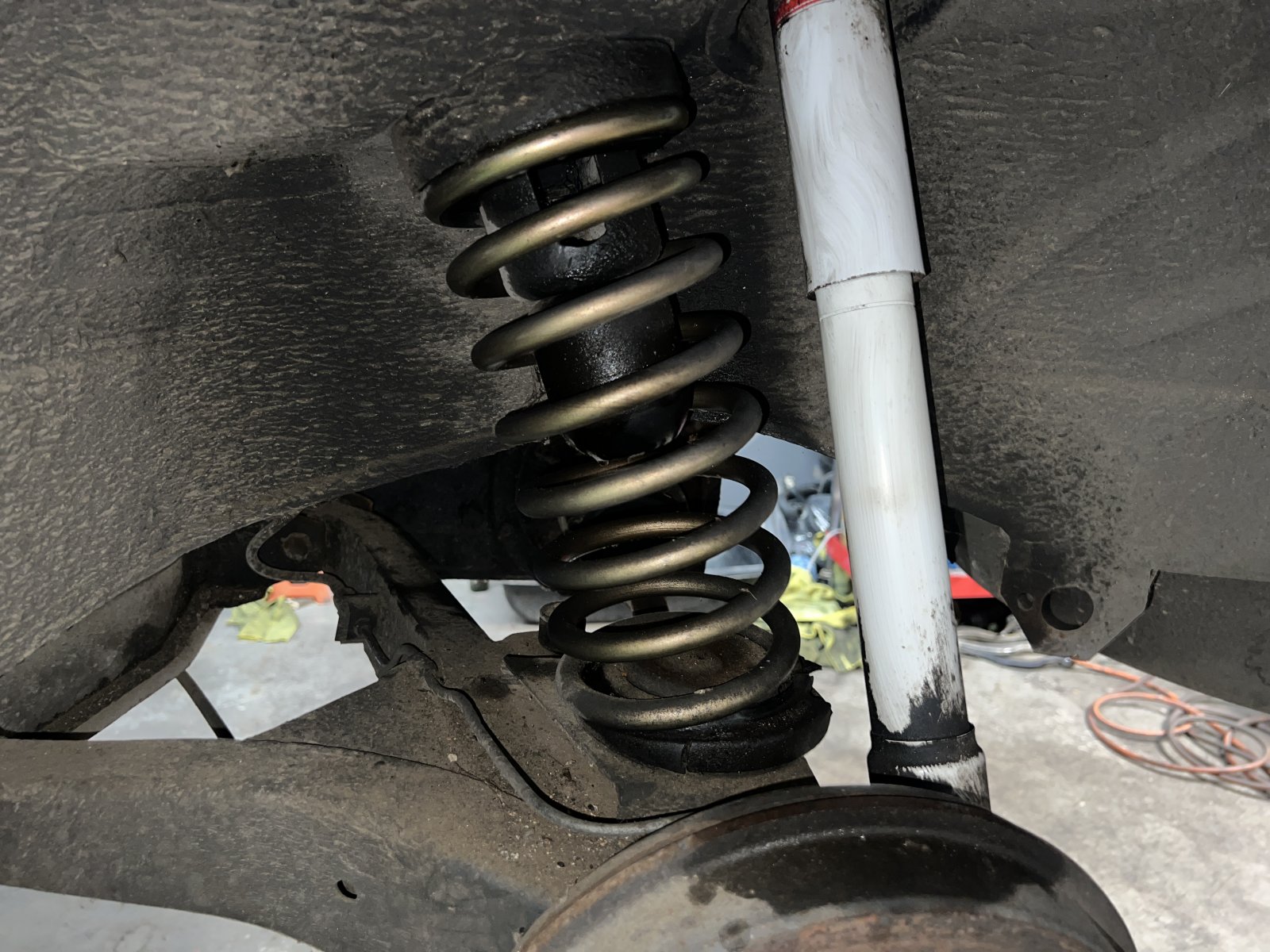

One thing I happened to catch was a metallic sheen off of the rear springs and that made me curious. I sprayed some degreaser on a rag and found that the springs appear to be plated, both front and rear. It doesn’t appear to be paint. The front springs are also loose with the suspension at full droop, so I have no idea what’s going on. Any chance anyone recognizes them?

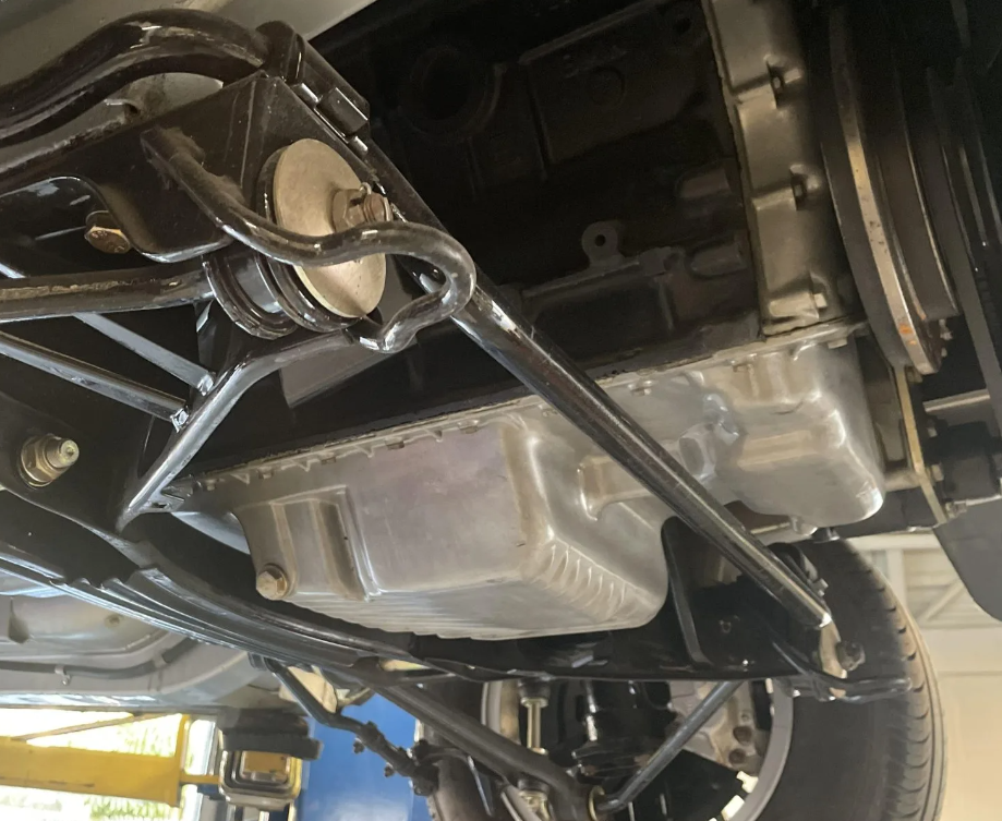

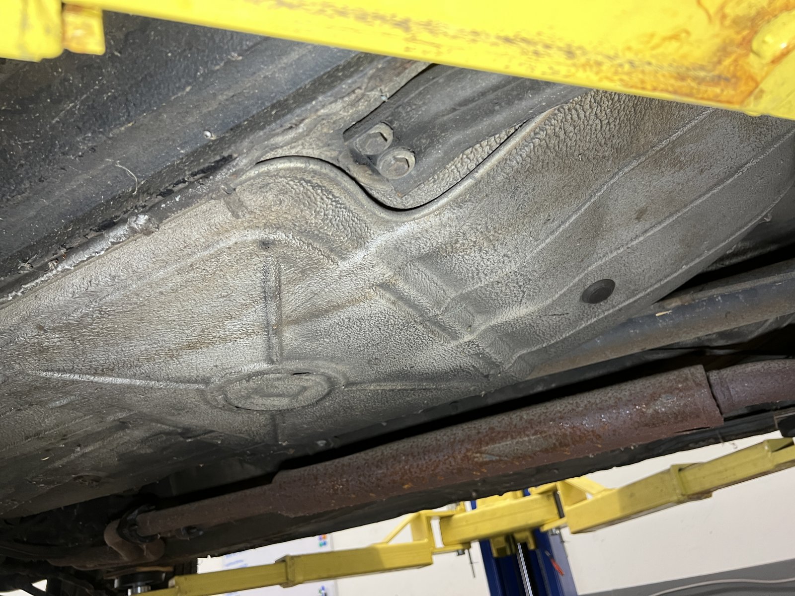

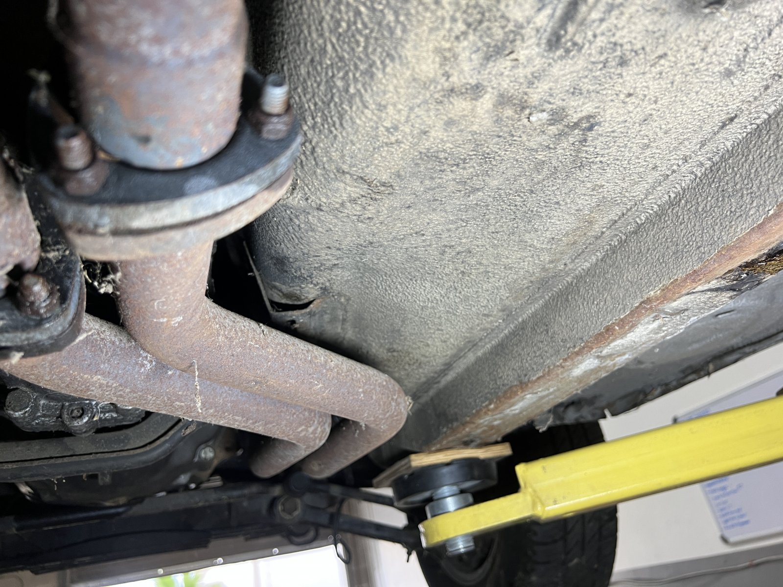

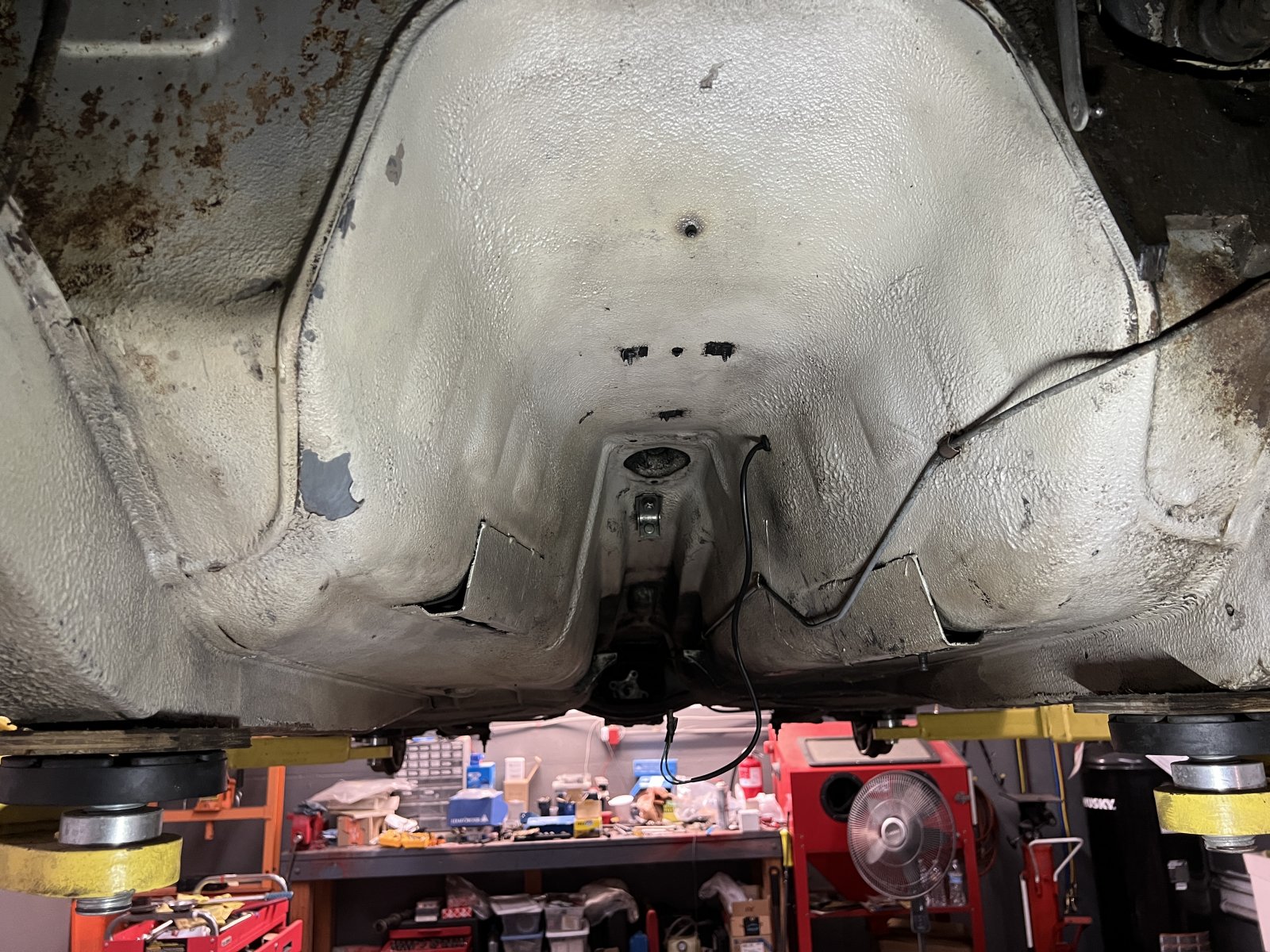

Thanks for pictures. They are extremely valuable for us - having ugly, rusty or - for many cases - improperly repaired E9 ... There is always "not enough" such a pictures! WE are hungry for more!
There is a topic about the colors on the coils. Maybe you can add your part to it?

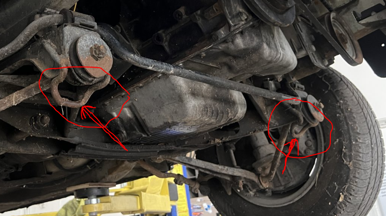

One thing is bothering me looking on the pictures - the two hitch ears:
This also looks to be bent but maybe it is an original shape ... I have no idea.
There is still a mystery for me that BMW was adding a squares after the front wheels. There are even in my E30 but for sure they are not for towing the car. Might it be used on assembly line or paint shop during car manufacturing or transportation? Does anybody know?
I can only dream about such a perfect underbody of BMW. Your car is really amazing and this is just about to clean and secure it.

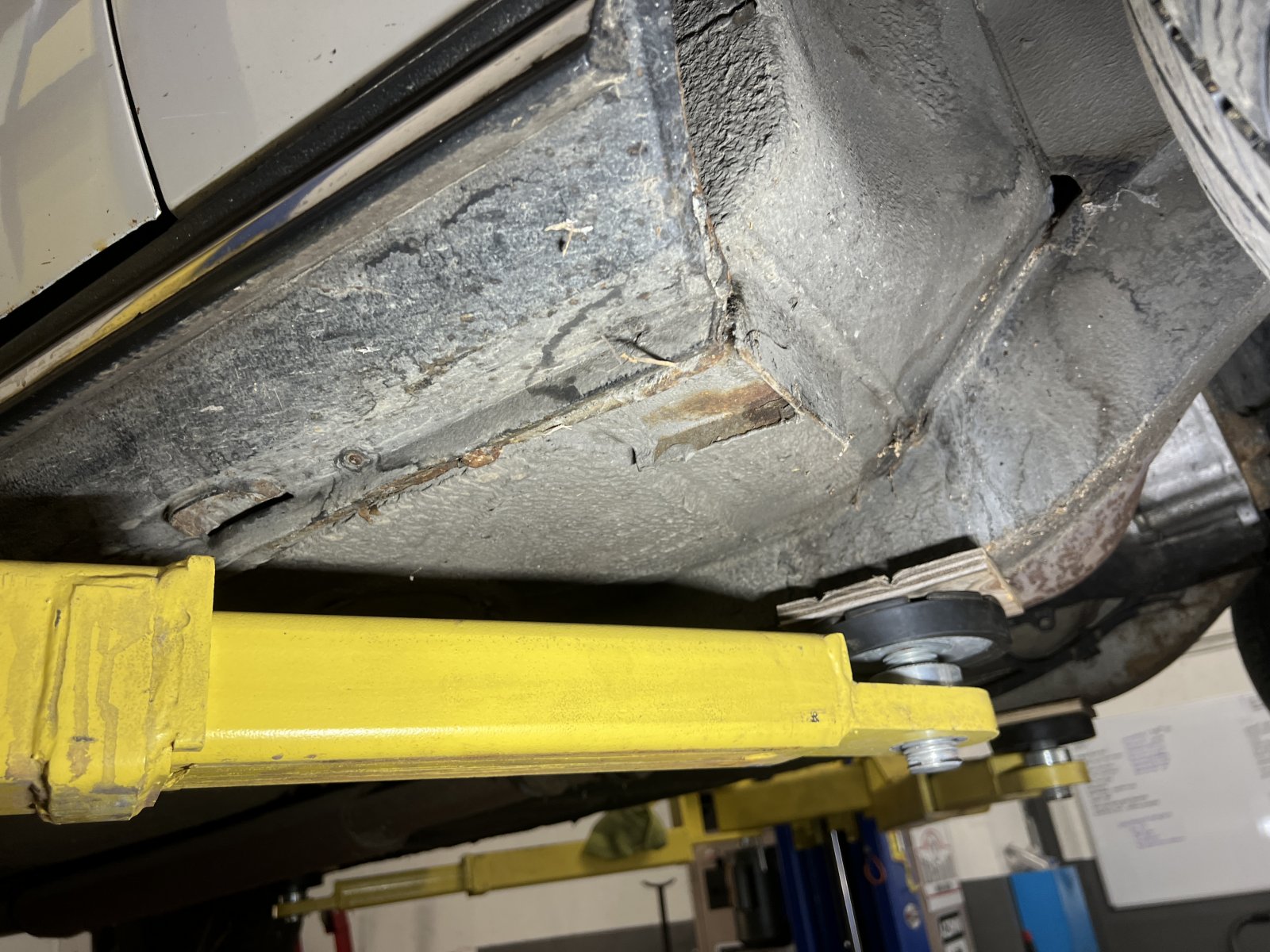

Are you going to remove the sill covers? Most of E9ers are interested what's behind. First look on the cover's opening looks very good.
Do you have a plan for the renewal of the underbody? Are you going to treat it with frozen carbon dioxide to remove all dirt, grease and surface rust without using a water or chemistry which could come into the profiles?
Excellent condition! Thanks for sharing the pictures!

Thanks! I’ll be taking a lot more photos. Can’t have too many.
The tow hooks are a mystery. They both look cleanly bent backward even on both sides. Wonder why they’re like that. It does appear that one piece by the driver floor is bent. It’s not severe so it could probably be bent back easily. The squares (at least on the later cars) were used to move the car down the assembly line. Big source of rust problems on E12s, 28s, 24s, etc. They shouldn’t be used for lifting the car.
As for cleaning the underside, I’m still working on an idea for that. I would love to find someone locally that can do what Dr. Detail does in Costa Mesa, CA. One thing I’ve learned is that the dry-ice cleaning is bad for the schutz as the pressure necessary to actually clean it can damage it. Of course, once I figure it out, I’ll share.

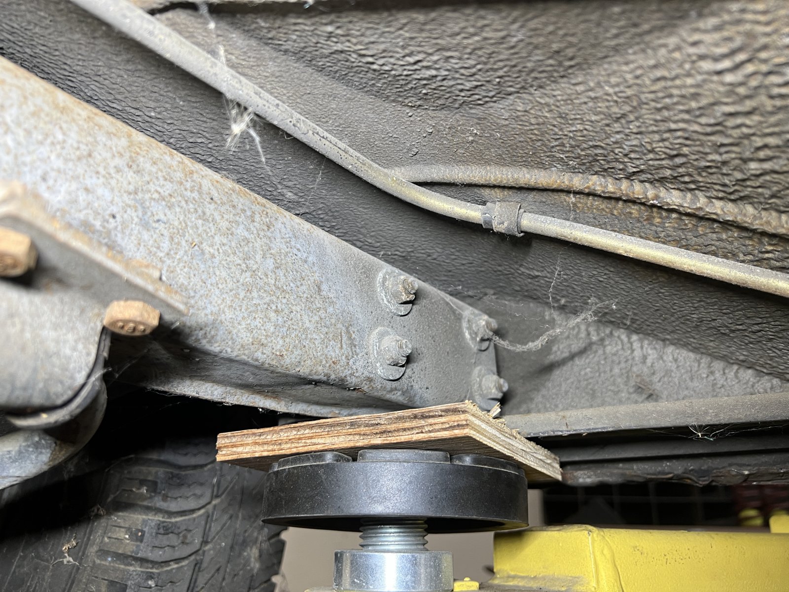

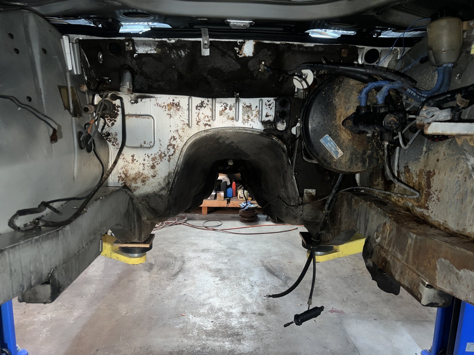

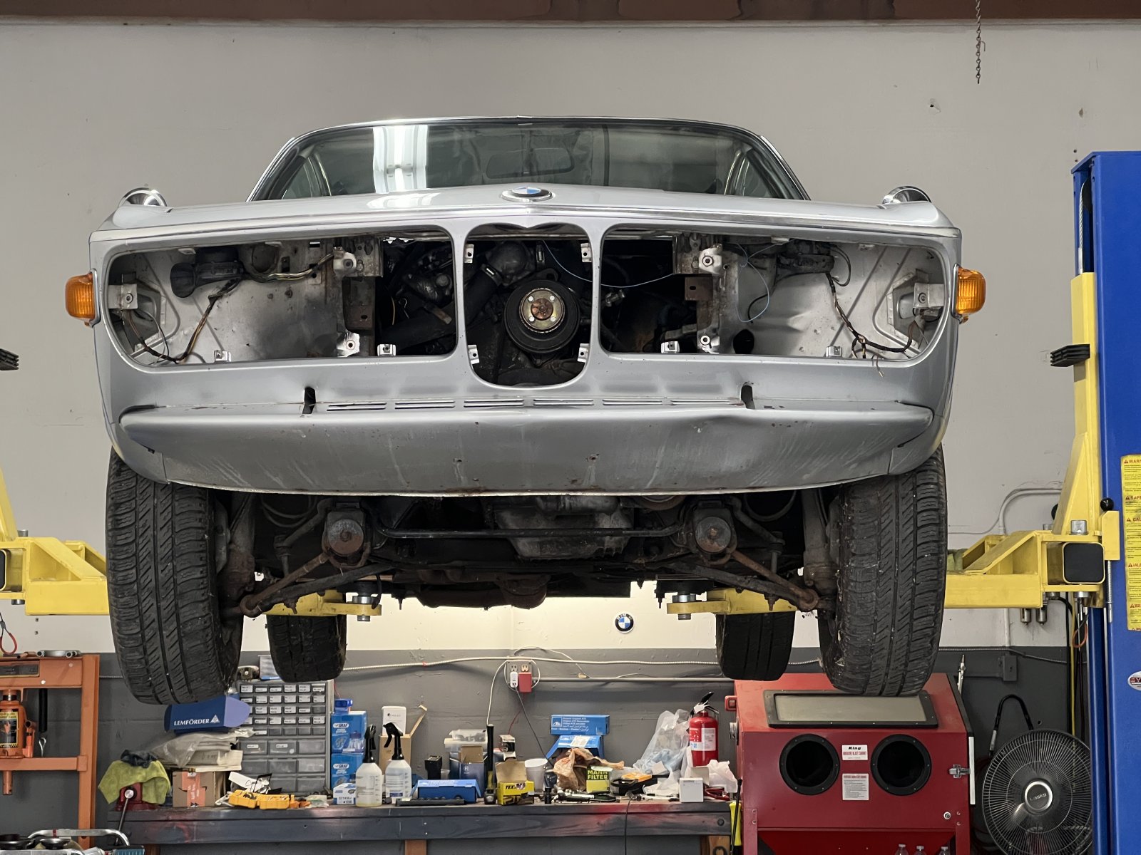

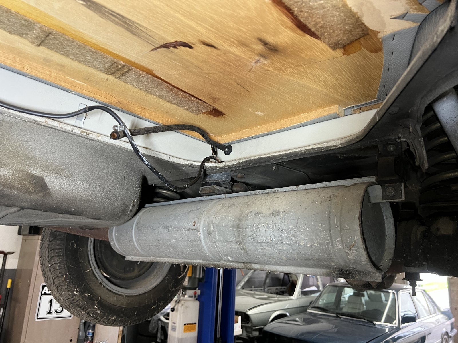

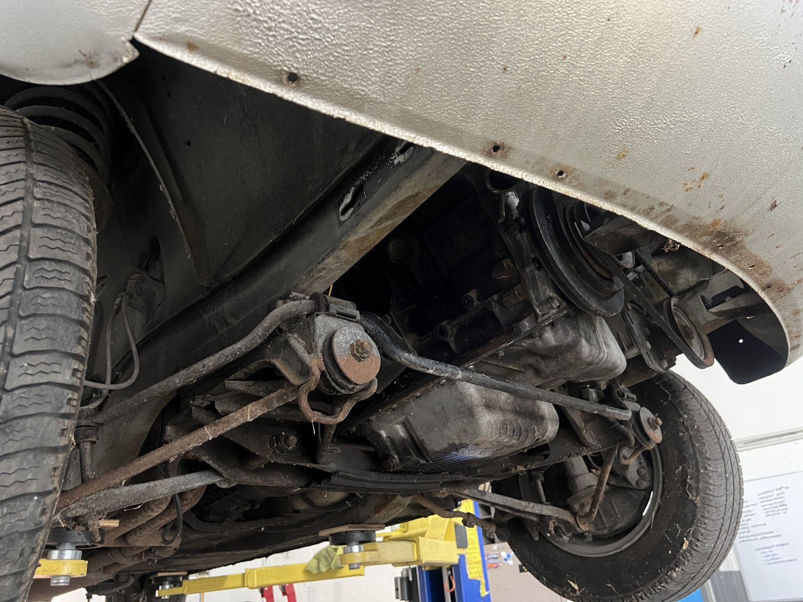

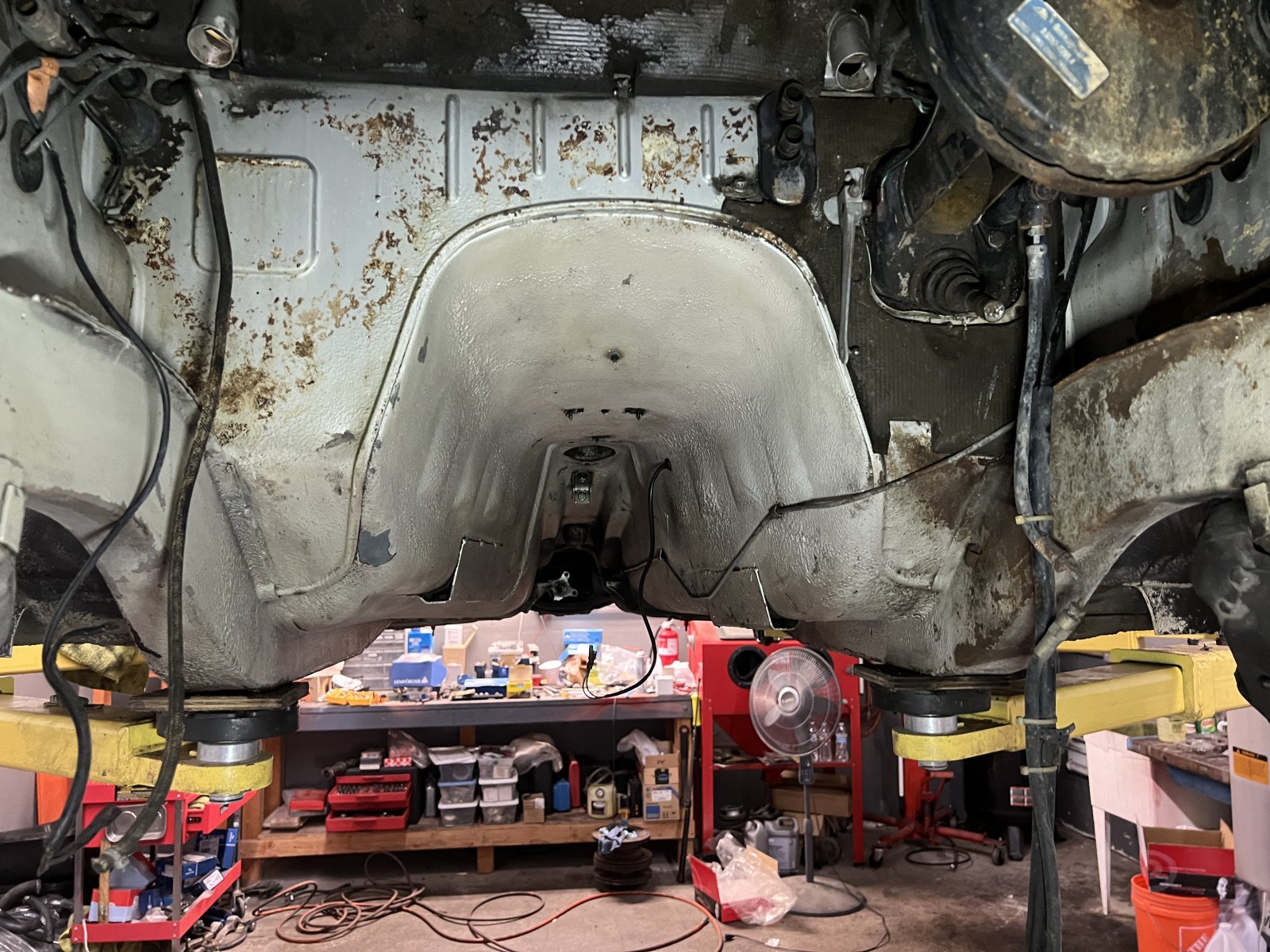

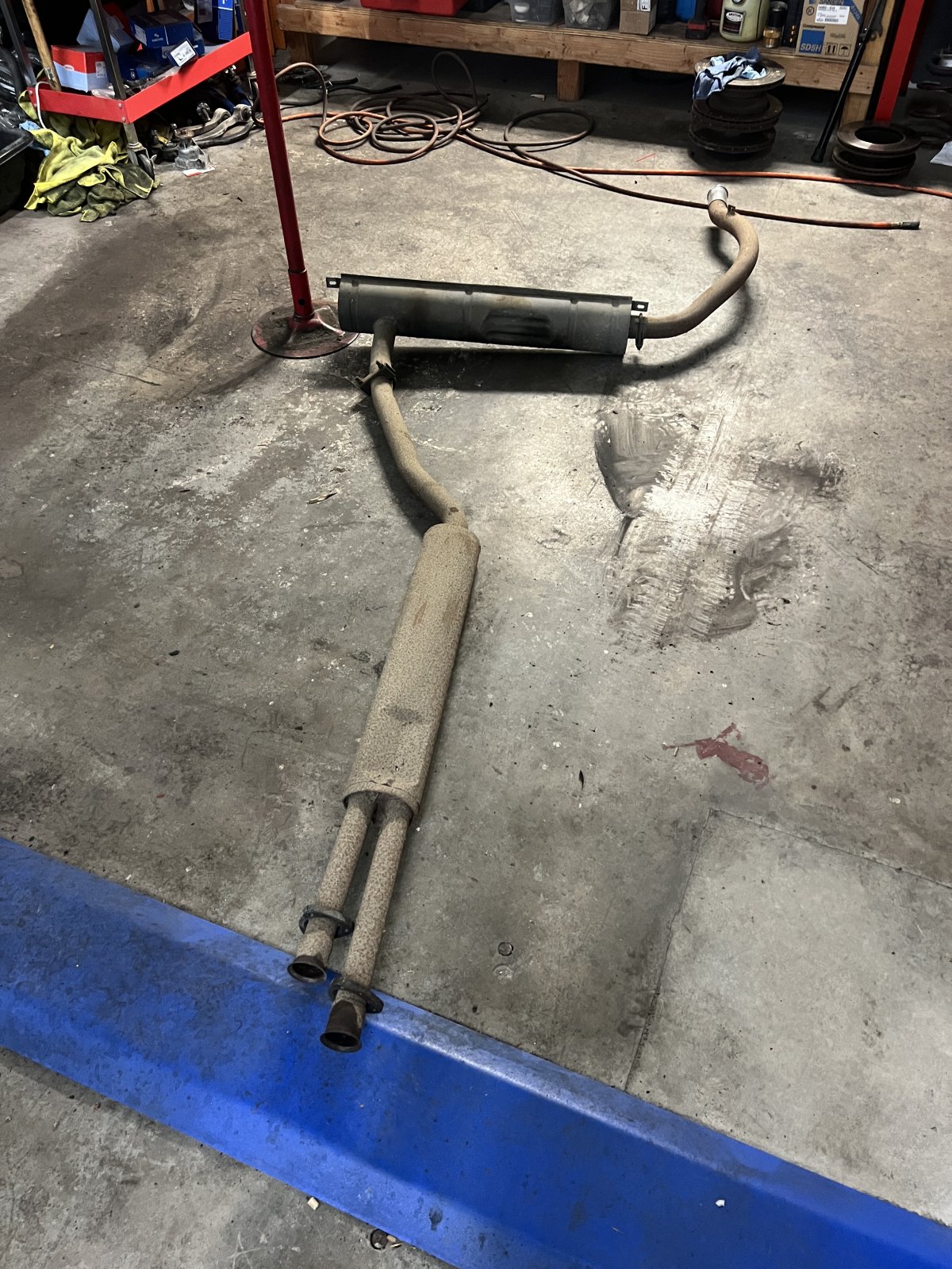

Thursday, I removed the exhaust and driveshaft, as I shared before. Friday, I spent more time under the car getting things prepared. I drained the oil, It smelled pretty foul, and some clumps of who knows what came out so I am glad I am not wasting any time on this engine.
I also put some effort in to seeing if the front caliper pistons were seized as the car was somewhat difficult to roll and I noticed some resistance on the front rotors. All 8 of them moved without too much issue and the fluid I removed from the calipers during the process really wasn’t that bad, so the brakes might even be functional.
I brought the vacuum over today and vacuumed up all the cobwebs, leaves, etc. I sucked out the ATF from the power steering canister, removed it from the firewall, unhooked the heater hoses, removed the brake booster hose and the huge amount of wiring that is connected to the engine. The only real concern I had was the steering u-joint but I did get the splines moving freely. Lift the car, remove the slave cylinder, speedo cable and the rear shifter mount.

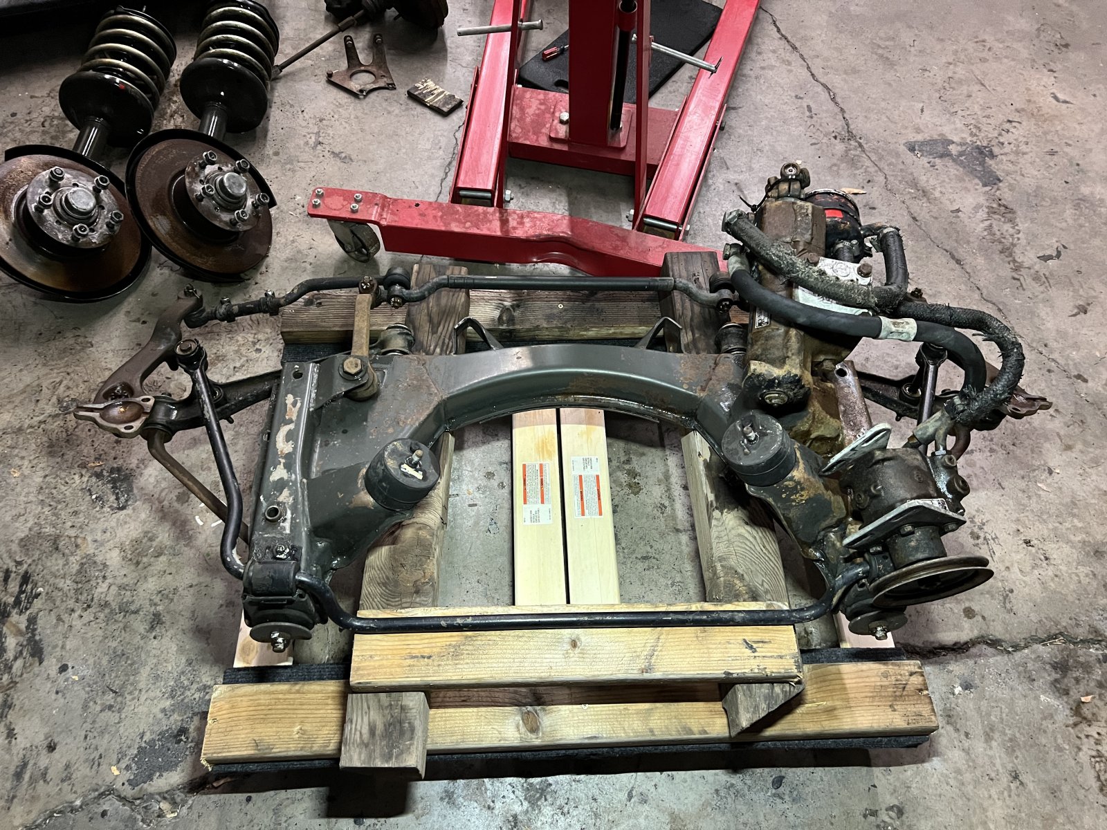

I had a couple ideas for lowering the subframe out of the car but ended up copying what OCCoupe did when he put his car together in 2016. It worked well. Being able to make fine adjustments to get the steering shaft separated from the joint and also allow the distributor to clear the frame rail was helpful. Of course on install of the replacement engine, the distributor won’t be installed.
So here’s some photos of how that went.
So that’s where we are at now. Of course now that I’ve made the car immobile and have taken up my lift, I have to figure out the plan from here. I’m leaning towards cleaning everything up and just getting it running with the replacement engine and it doing anything crazy. At least right now.

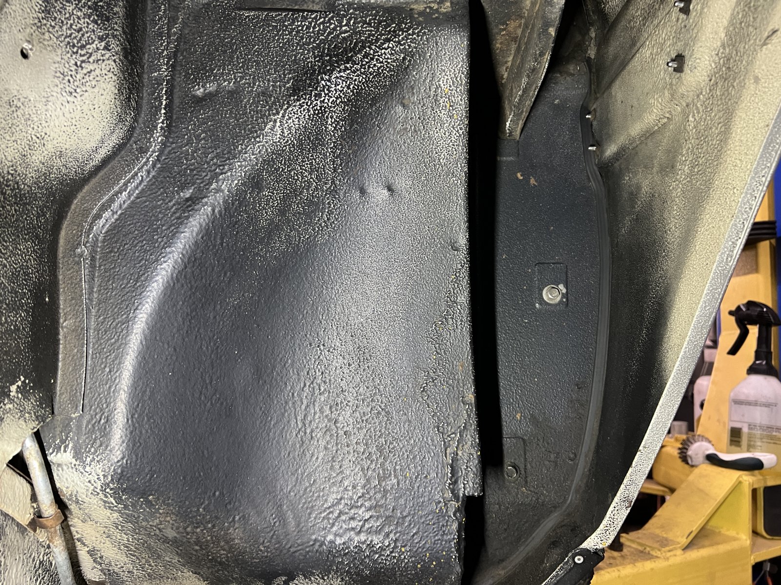

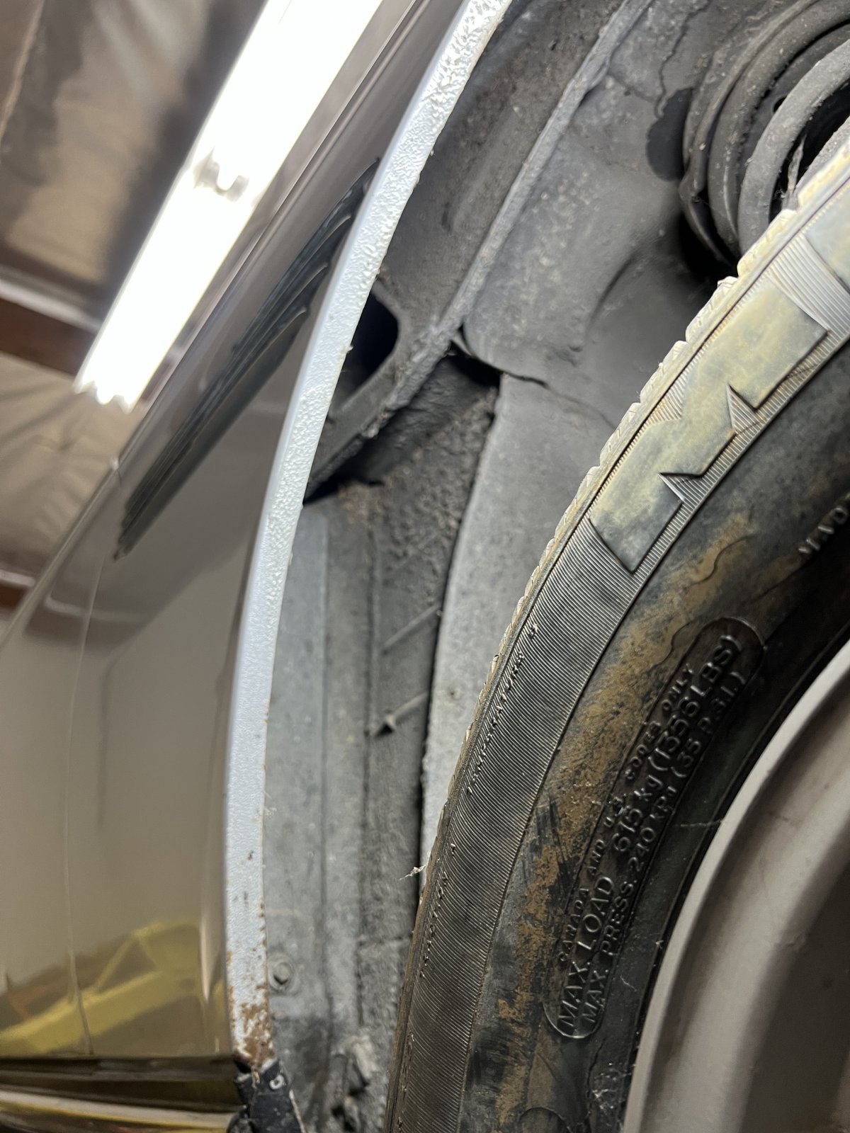

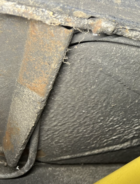

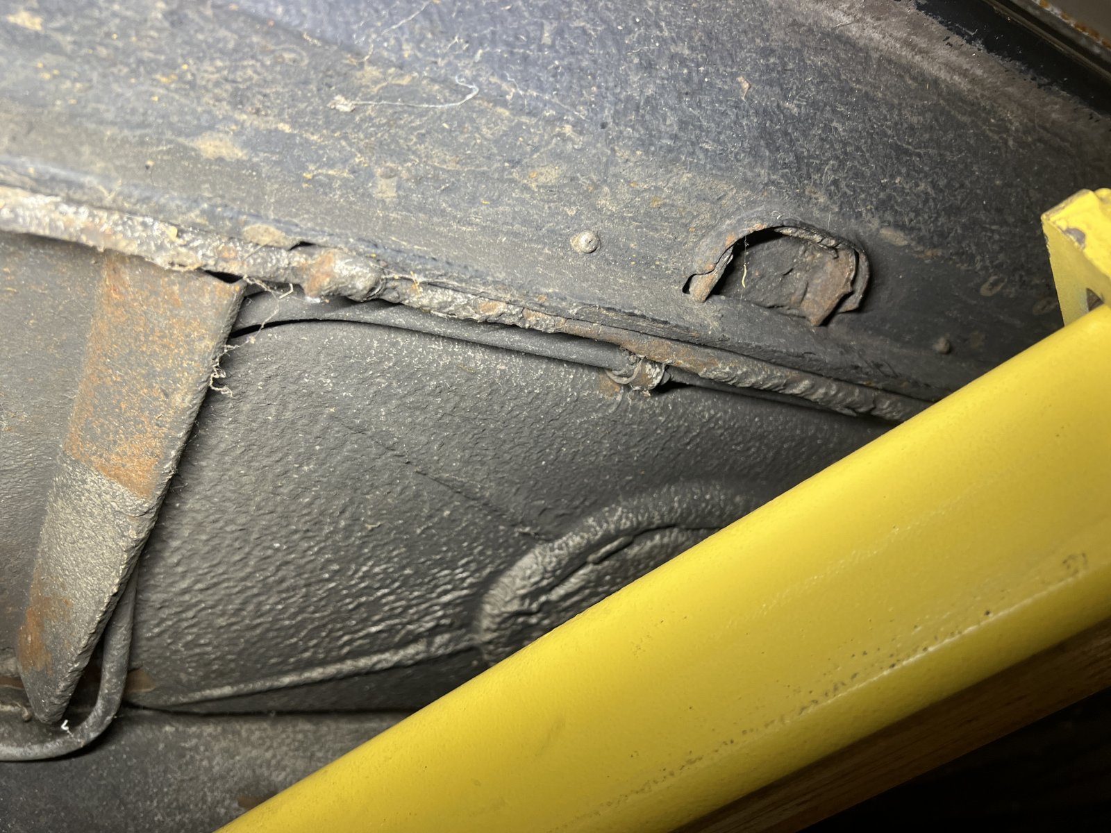

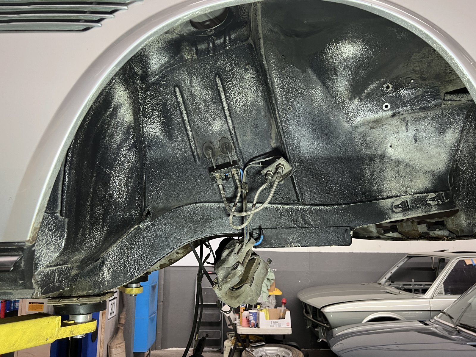

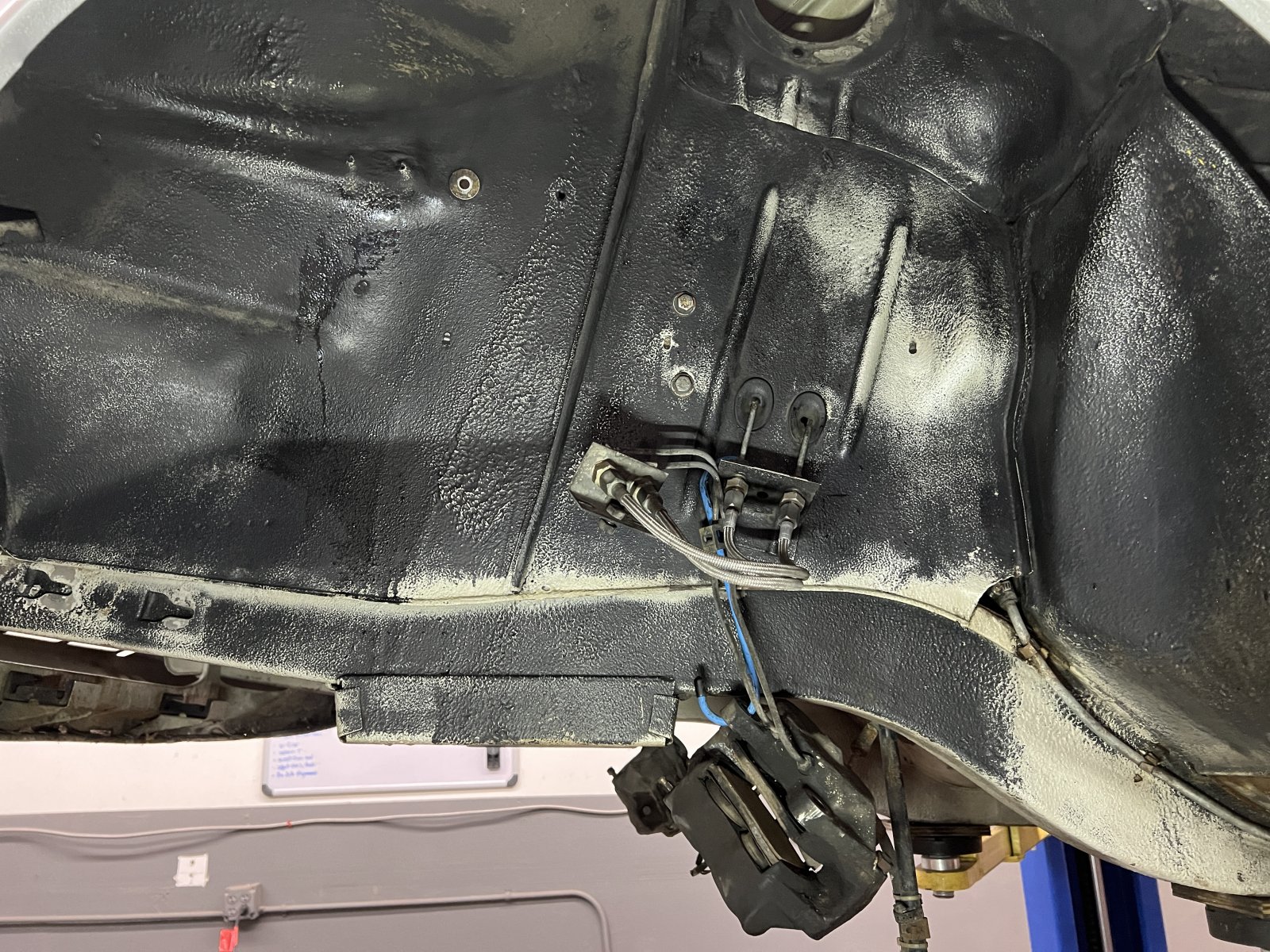

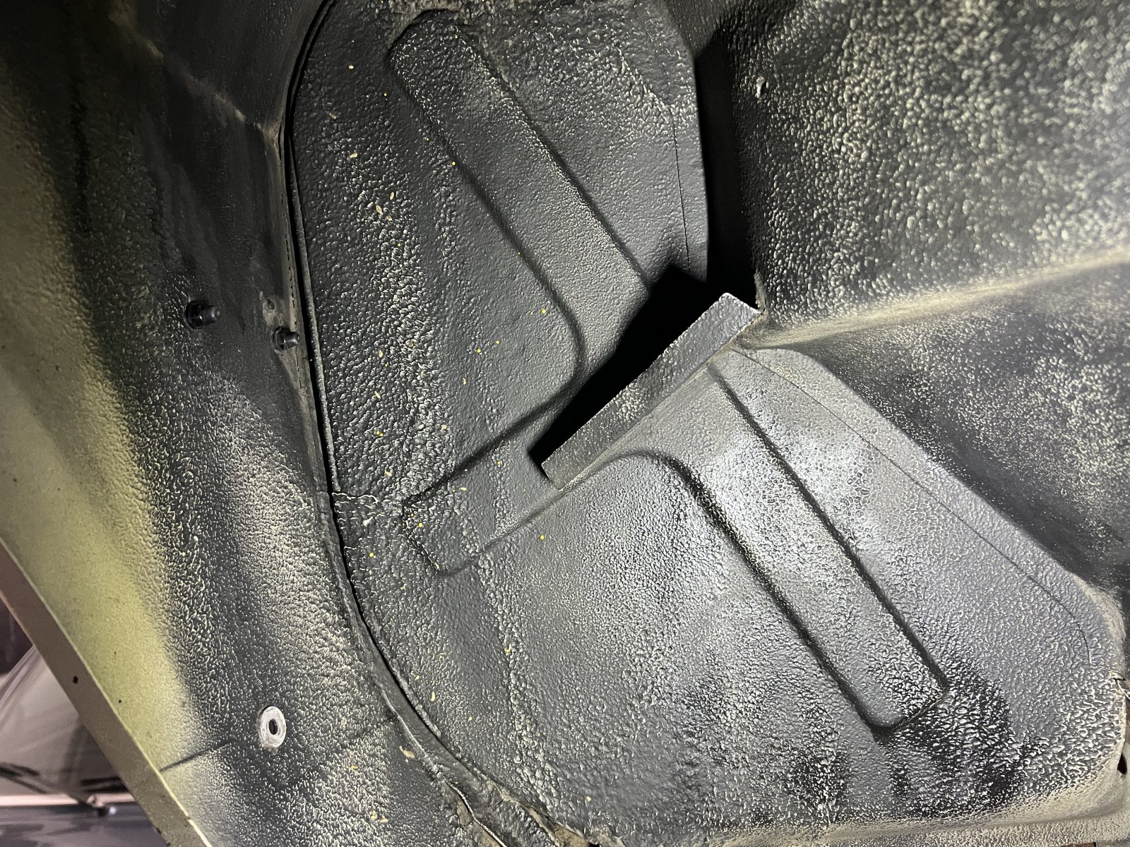

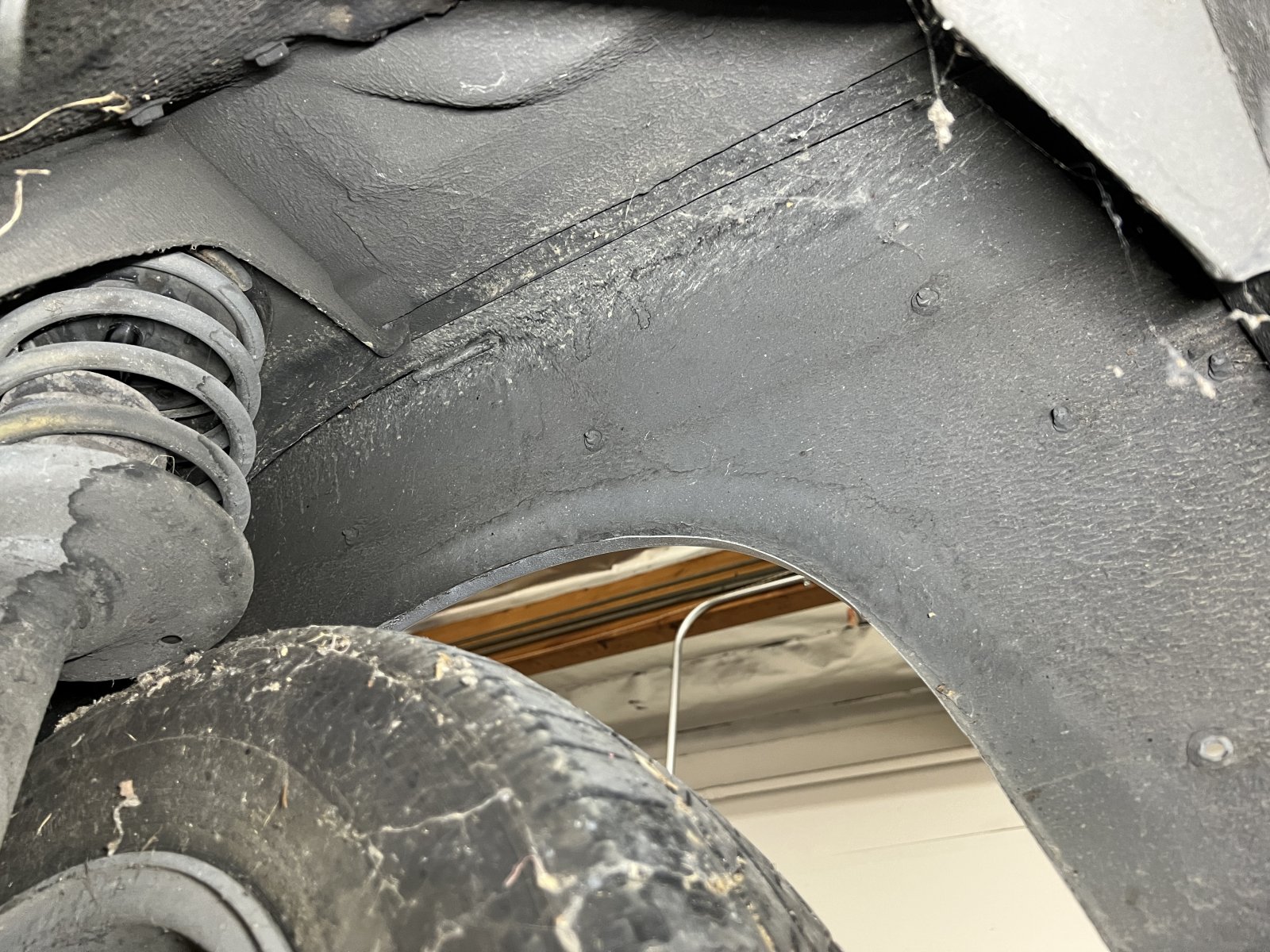

Looks as though the PO used some sort of rust inhibitor spray in the wheel wells. They are usually the color of the body.

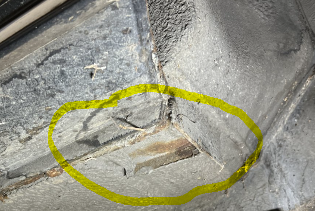

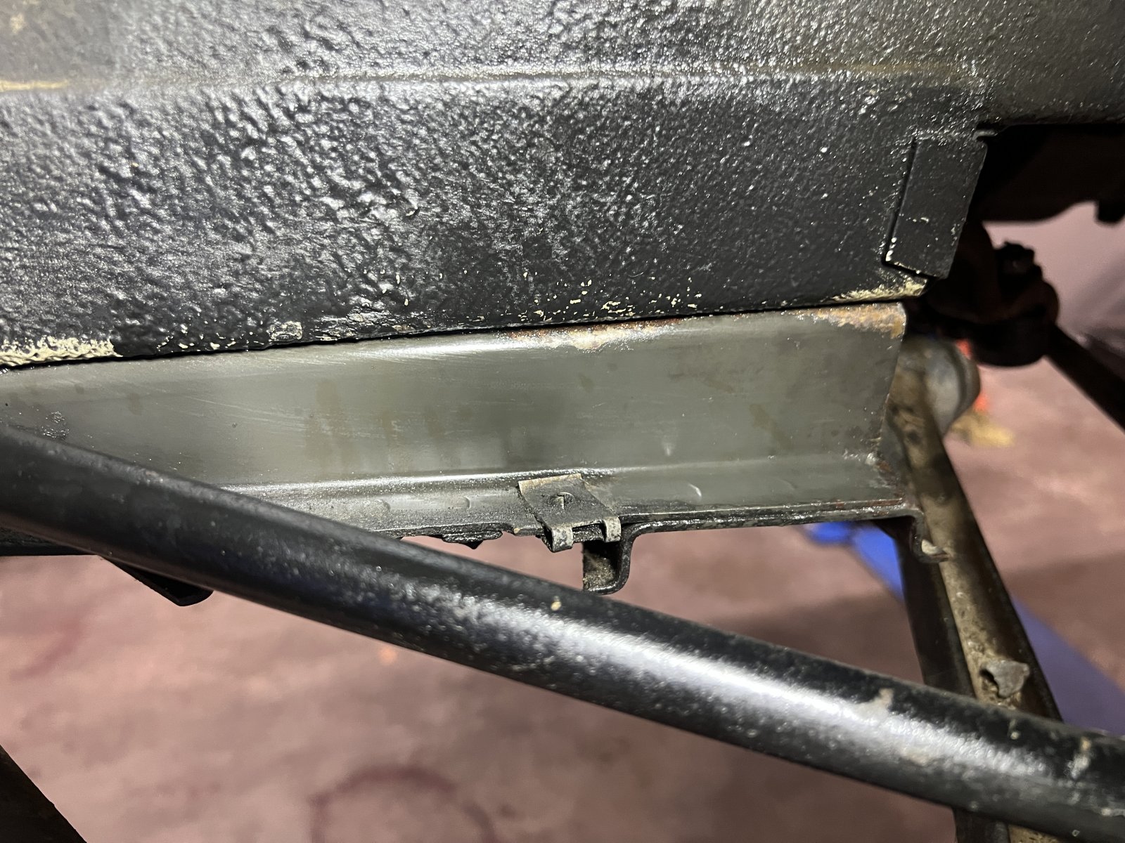

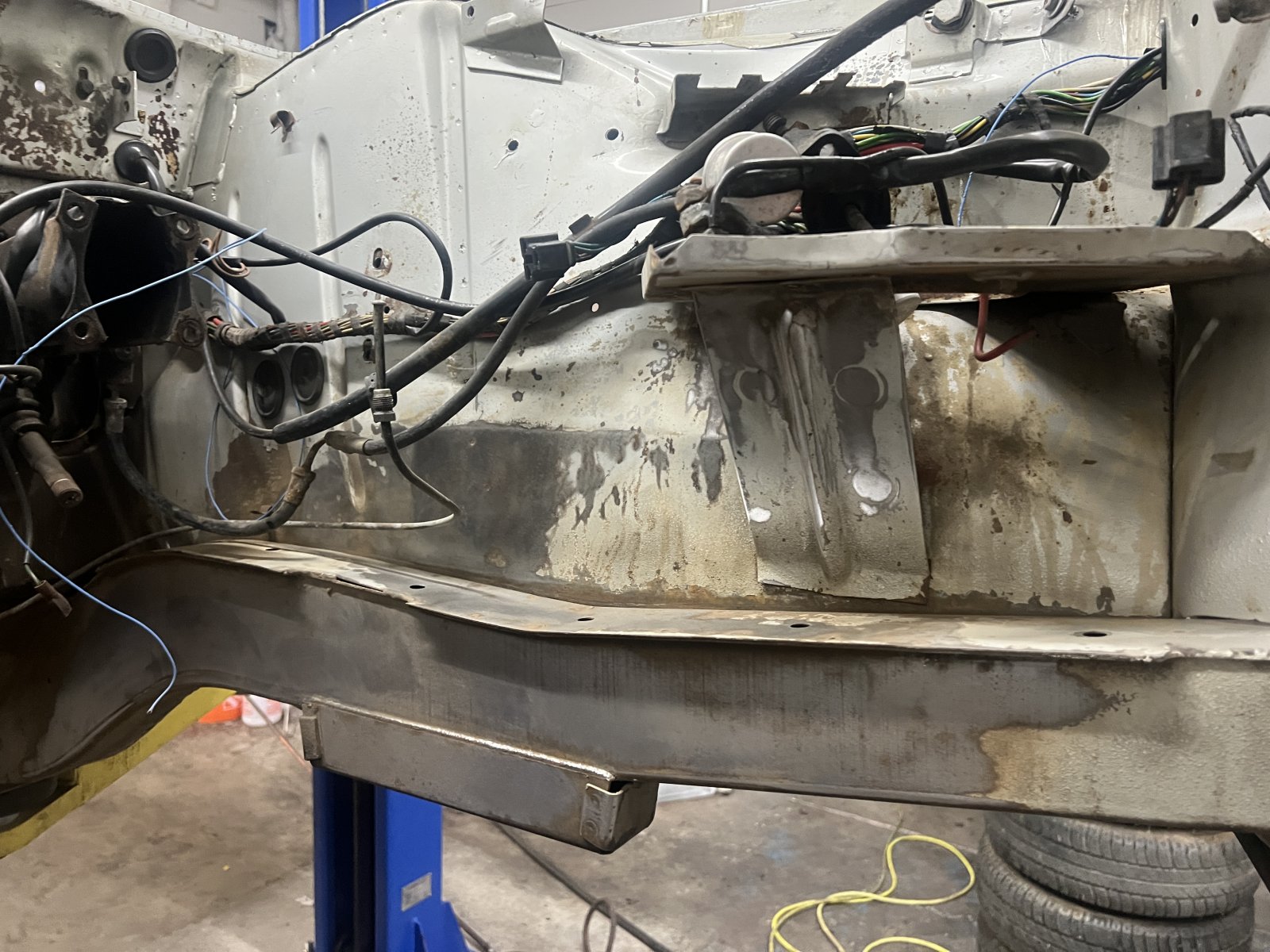

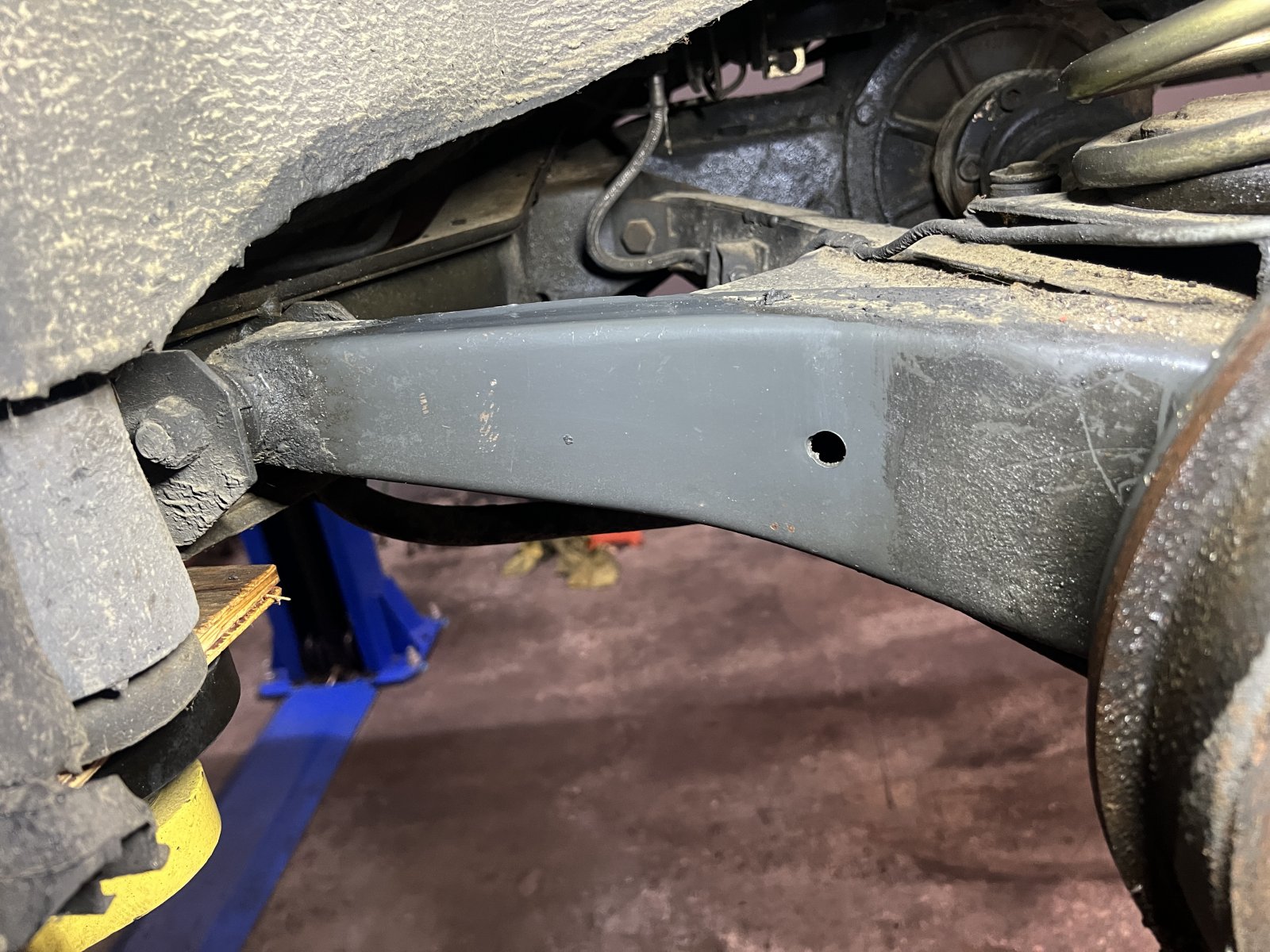

First, I discovered that I was originally incorrect about the subframe color. I was confident it was black. While I was cleaning off the rear springs to attempt to identify them I decided to try a bit of the trailing arm that looked like it might clean up well.
Wow this is exciting. I wasn’t upset to think the car had black but I was disappointed to not have the grey. I was amazed at how nicely it cleaned up. Then I thought that is weird the front is black but the back is grey. Turns out, again totally wrong.
I cleaned off this part of the subframe and questioned the black paint there but was so happy to see the grey, I didn’t think anything more of it.
I know that the knowledge base says the wheel wells are body color. There was such an accumulation of grease and dirt, I wasn’t surprised by how dark they looked. I was looking forward to the transformation back to the bright, clean-looking wheel wells. Then I saw this run of black on the bottom right frame rail.
I tried cleaning it off but soon realized it’s paint. I was a little disappointed to see that but as I continued to clean (I would put money on this car not having ever really been cleaned underneath), I uncovered lots and lots of black paint. It’s not undercoating, it’s paint and the more I scrubbed to remove dirt, in many areas it is wearing thin. This puzzled me. Also, I notice that under the black paint is not a silver but more a light dusting of silver over the beige schutz. It was obvious that no one had removed the front bumper before I did and the paint is black behind the bracket and inside the recesses for the carriage bolts.
The left side has more things attached and I think makes an even better case that the black paint was applied before anything was attached to the car on that side.
So while I think there’s disagreement that this is original, I’ve seen enough evidence along with the context that this is a car with original paint, not wrecked and no real evidence of regular undercarriage cleaning that I’m going to maintain what’s left of the black paint. I still have some cleaning to do in crevices but it has come up surprisingly well given the accumulation of crud.

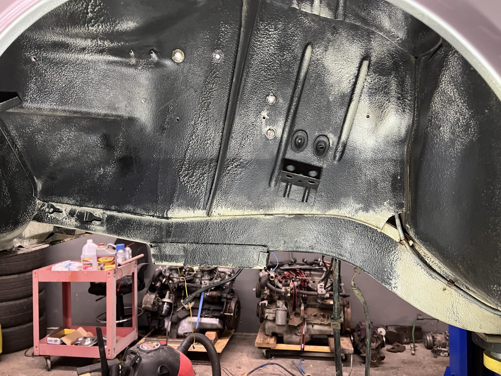

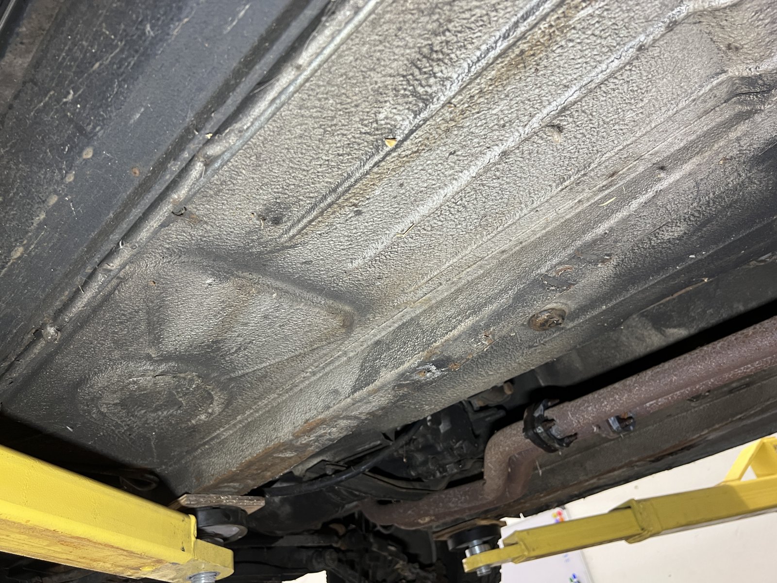

Meanwhile, I also worked on the transmission tunnel and was very pleased with how it came up.
I’ll eventually work my way further back but I was curious how this would clean up and was not disappointed. The floor is going similarly.

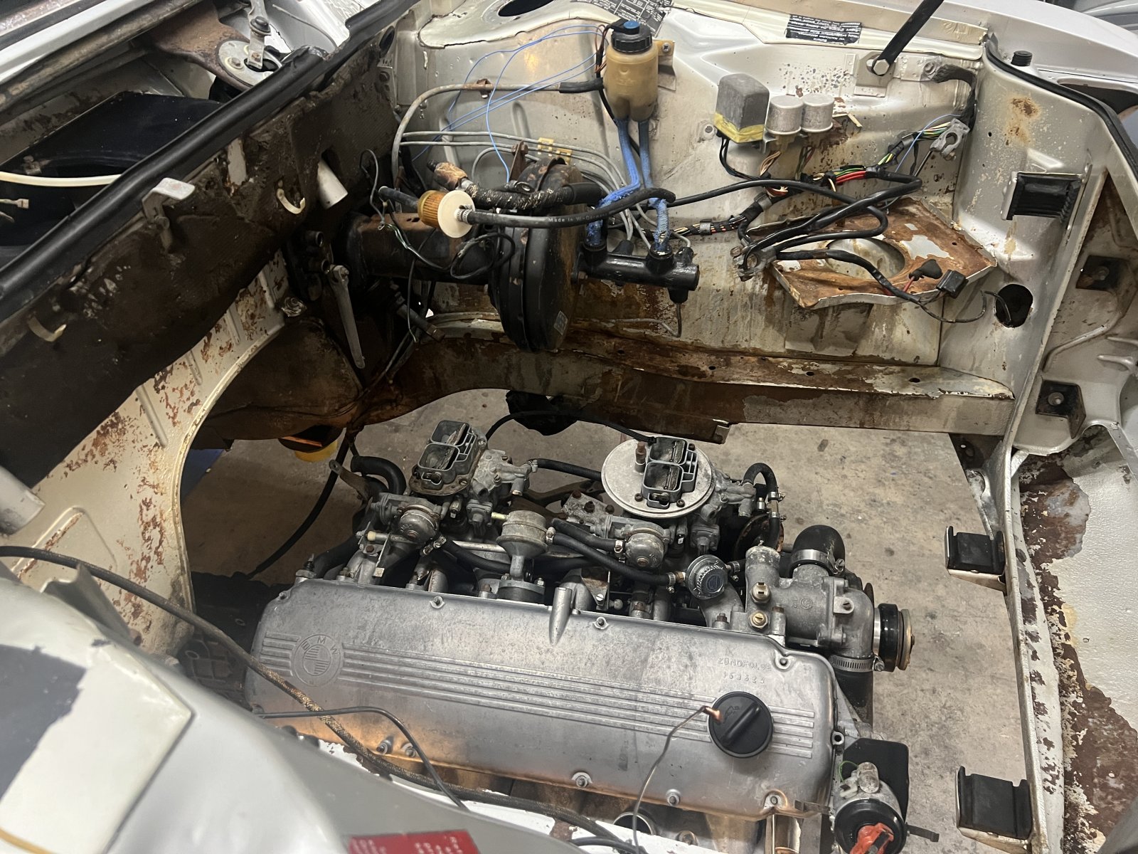

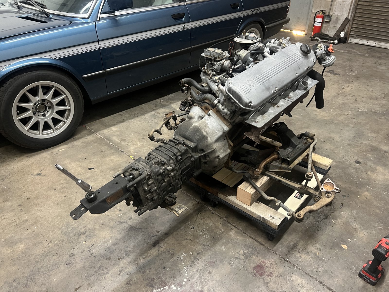

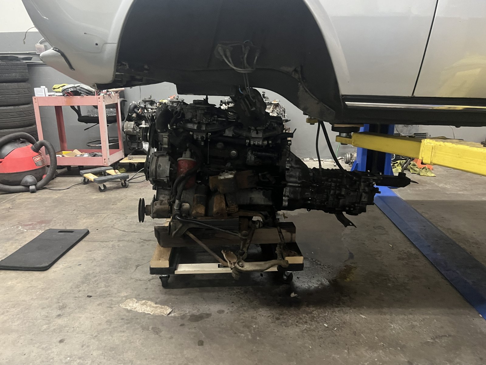

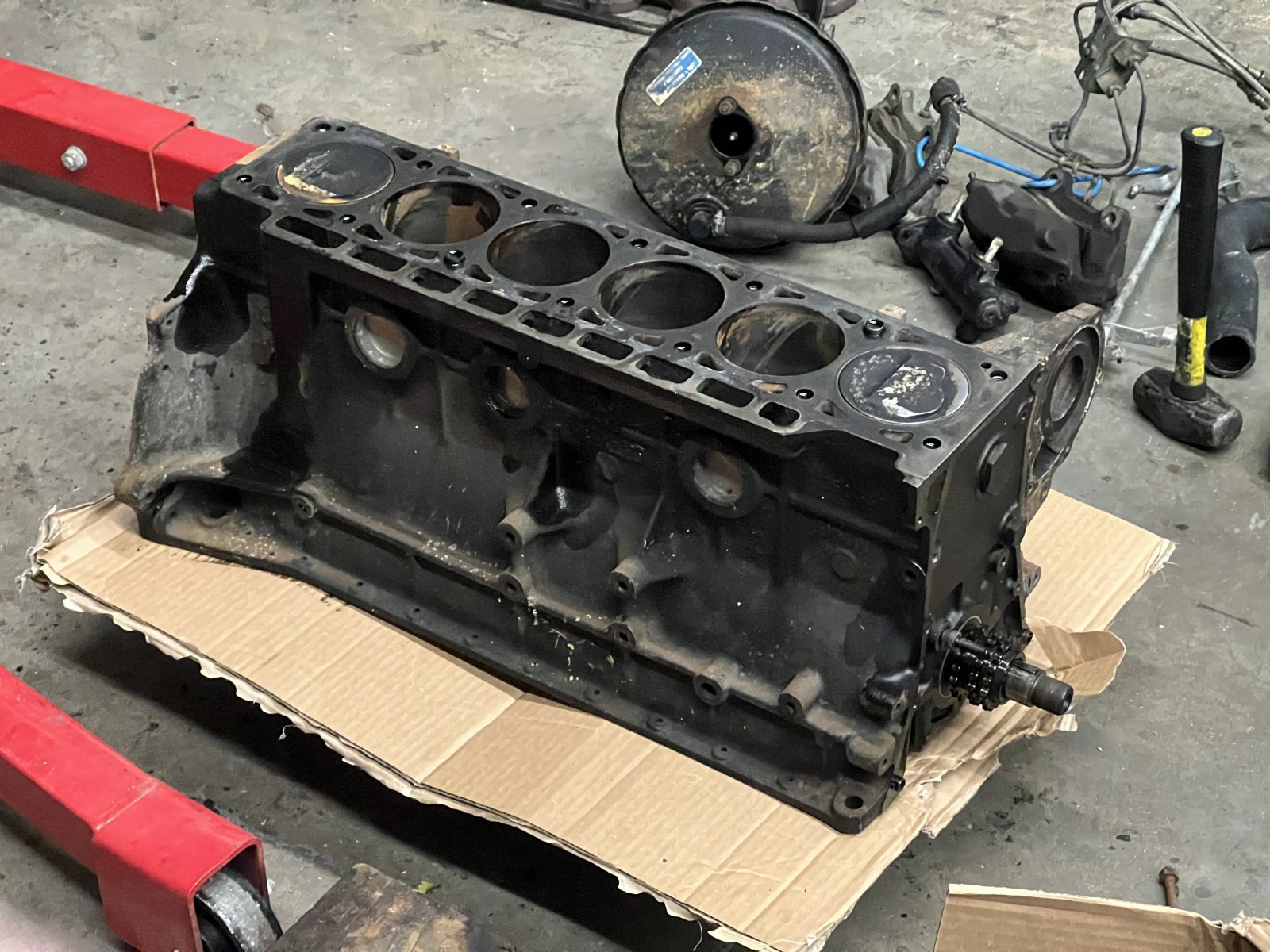

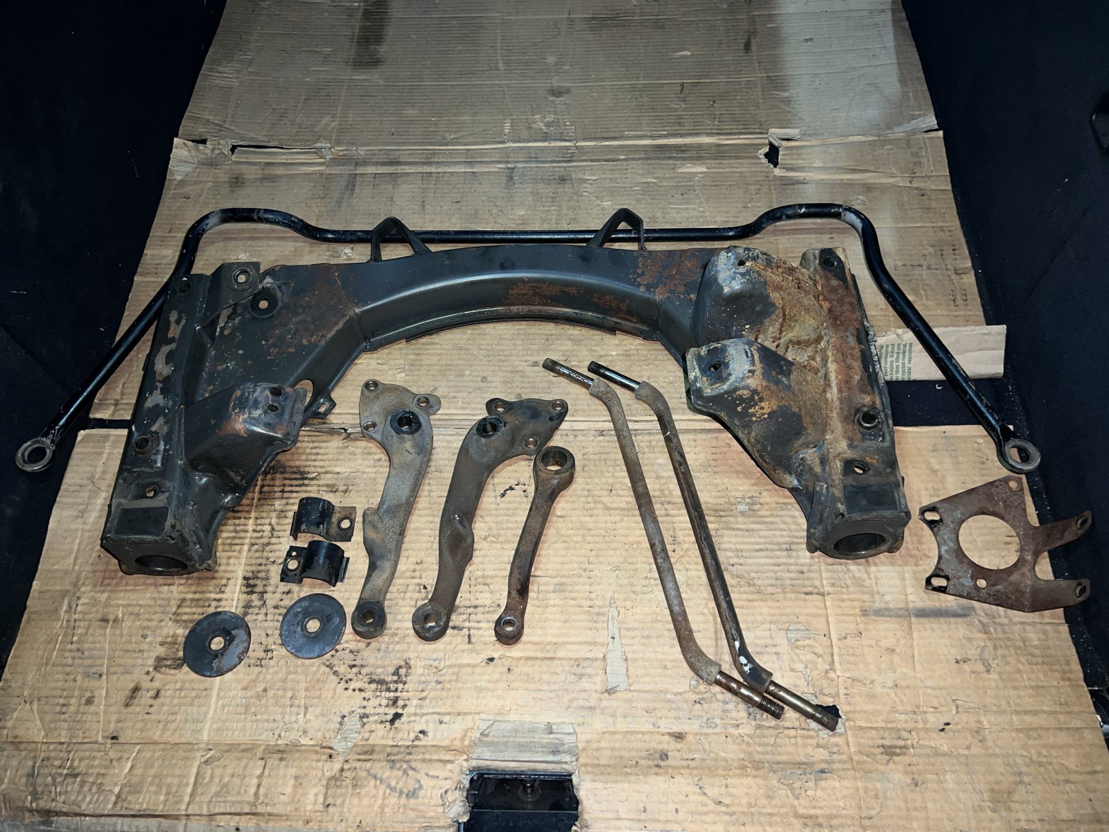

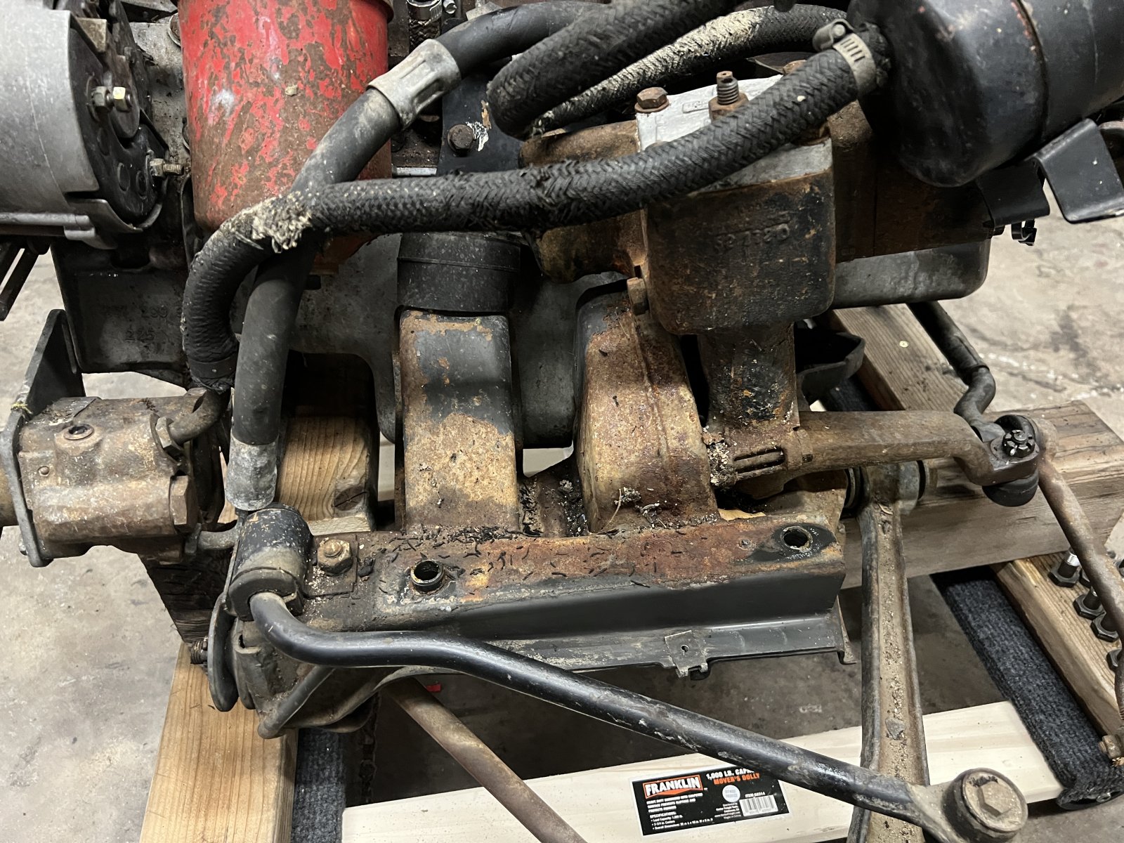

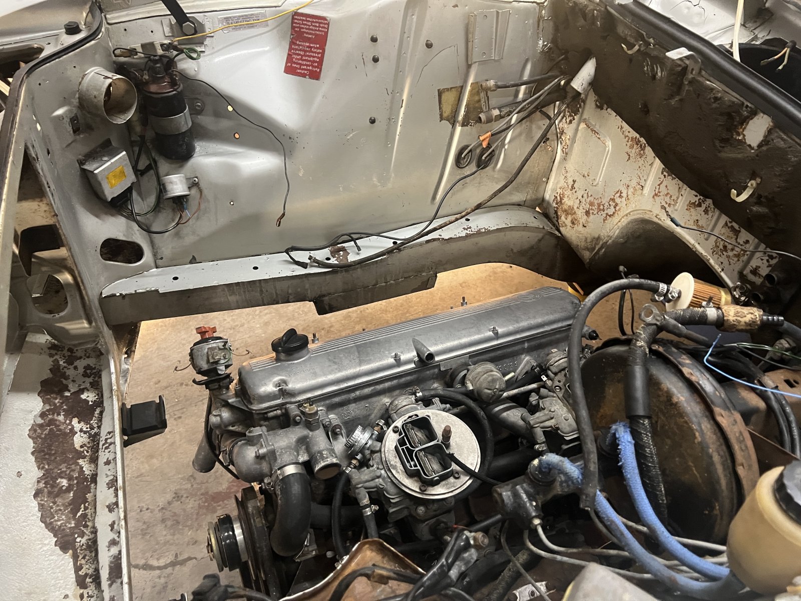

Initial plan for the engine was to simply pull the old one off the subframe, give it a good clean and put the replacement on and put it back in the car. That has changed since I really need to attend to the left inner fender and the paint that’s been removed from years of fluids and battery acid. On top of that, I have to address the issues in the nose at the same time. I have formulated a plan for that and am working on getting things together for it.
The left side of the subframe has a similar fate, including the steering box, power steering pump, etc so that seems to have expanded the scope yet again. I don’t have much choice but to refinish the subframe, and that then means I’ll be replacing all of the still serviceable control arms and steering linkage because it’s all ugly as well.

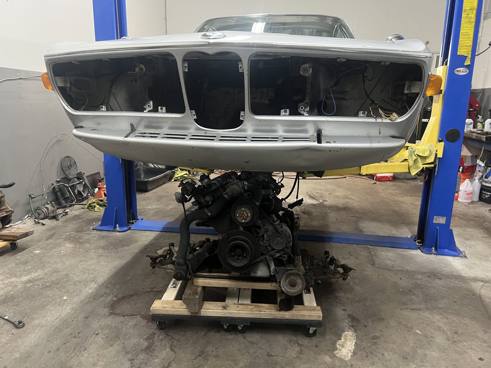

Since dropping the subframe, it’s been sitting in front of the car with the motor on it while I make a huge mess cleaning the front of the body up. This evening, I finally pulled the motor off of the subframe. I don’t really have anywhere to put it just yet, so it’s resting on the ground but still supported by the hoist. This allowed me to finally clean up the subframe, the struts and the transmission. There was a bit of trial and error on getting a thorough job since it was dark out, but the parts came up pretty well.
I guess I’ll be disassembling the subframe tomorrow and see about getting it and the related parts refinished. I hate to do the strut tubes since they’re in such nice shape and original to boot. I might wait with those. I think the subframe itself is more of a concern, along with the steering arms and tension struts (it looks like they all get the same color).

I wish anyone's E9 to have such a nice wheels wells! Amazing. For most E9 even additional body protection chemistry haven't had helped.
What kind of chemistry and method you have used for cleaning the underside? Which is the most efficient as typically it has to be time consuming.
Despite a lack of updates to the thread, I have been busy.

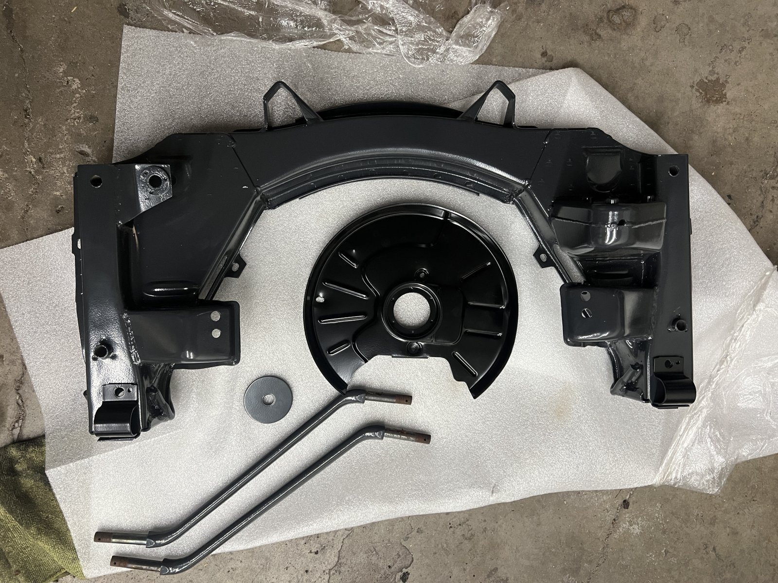

I took the subframe apart and took it and the related parts to be powder-coated.
Because the shop has a minimum charge per color I added a bunch more black parts to the mix.

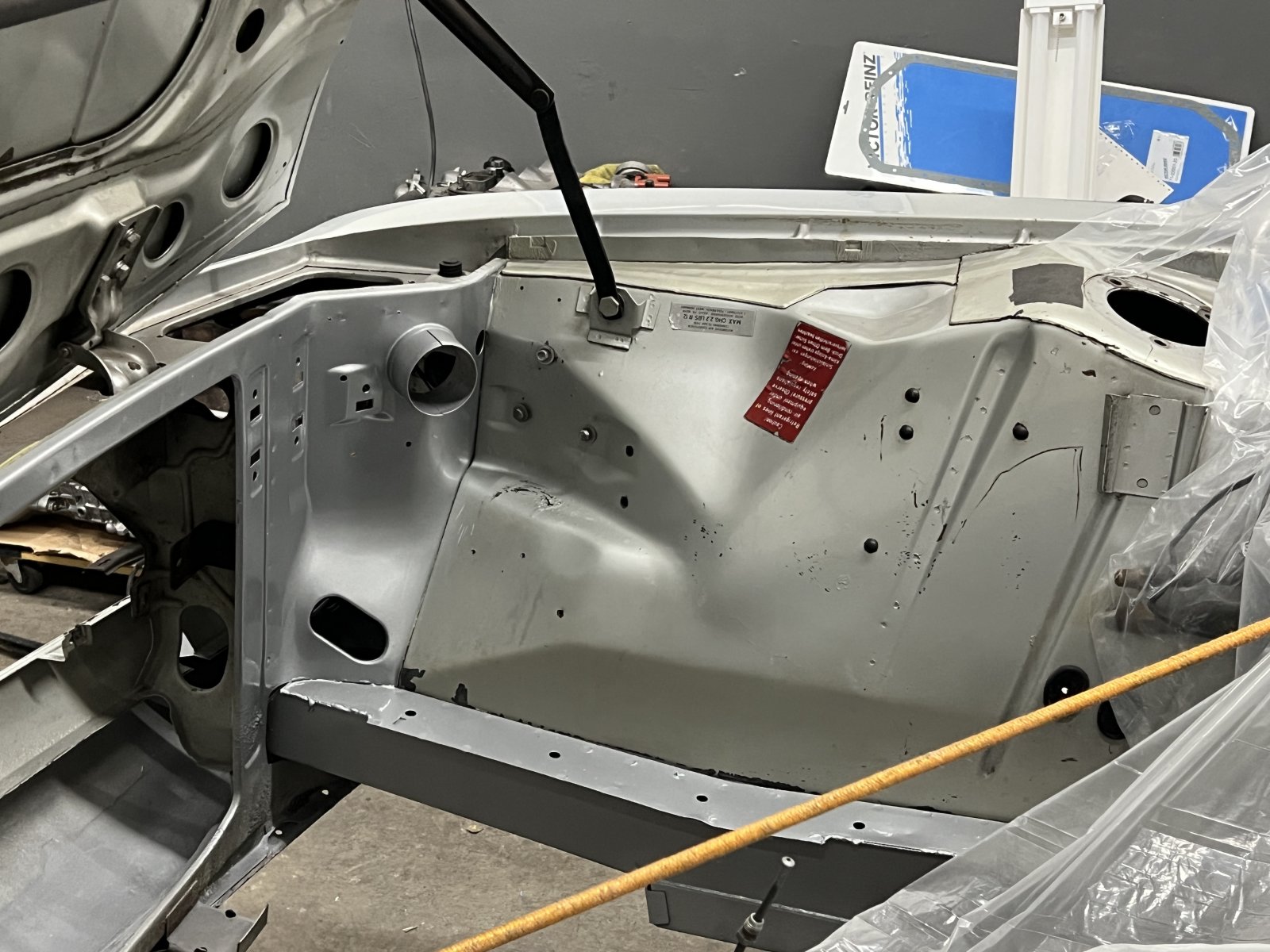

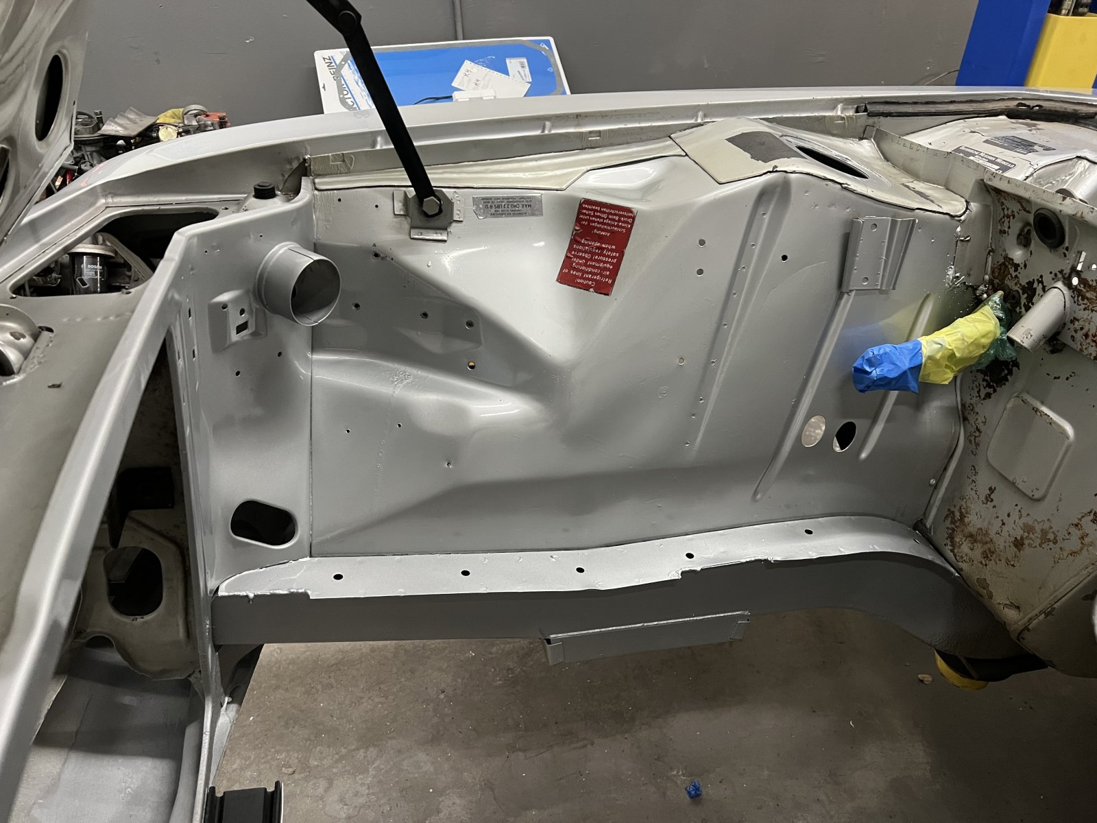

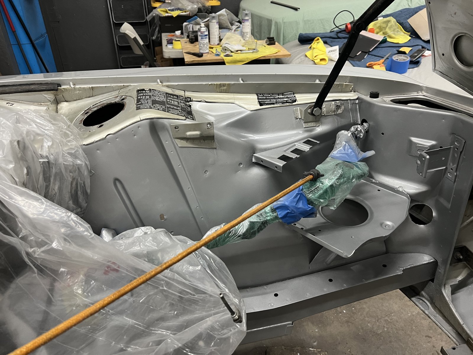

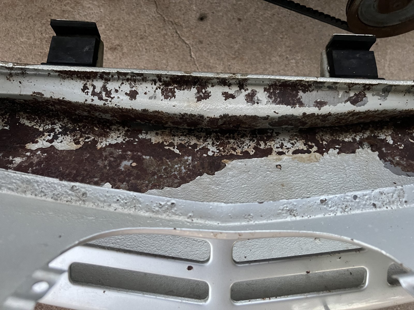

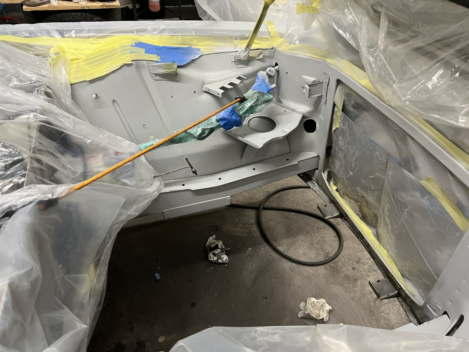

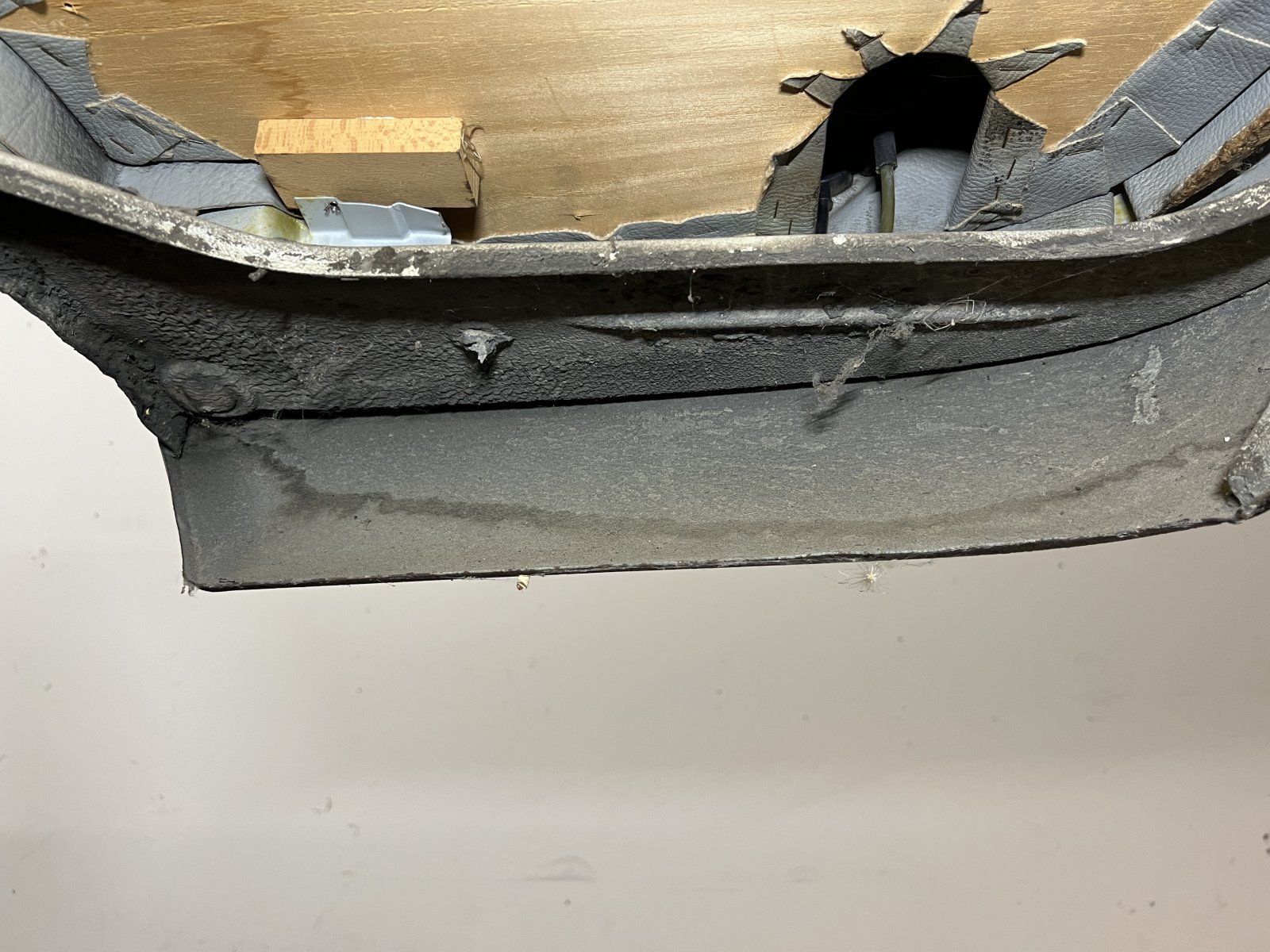

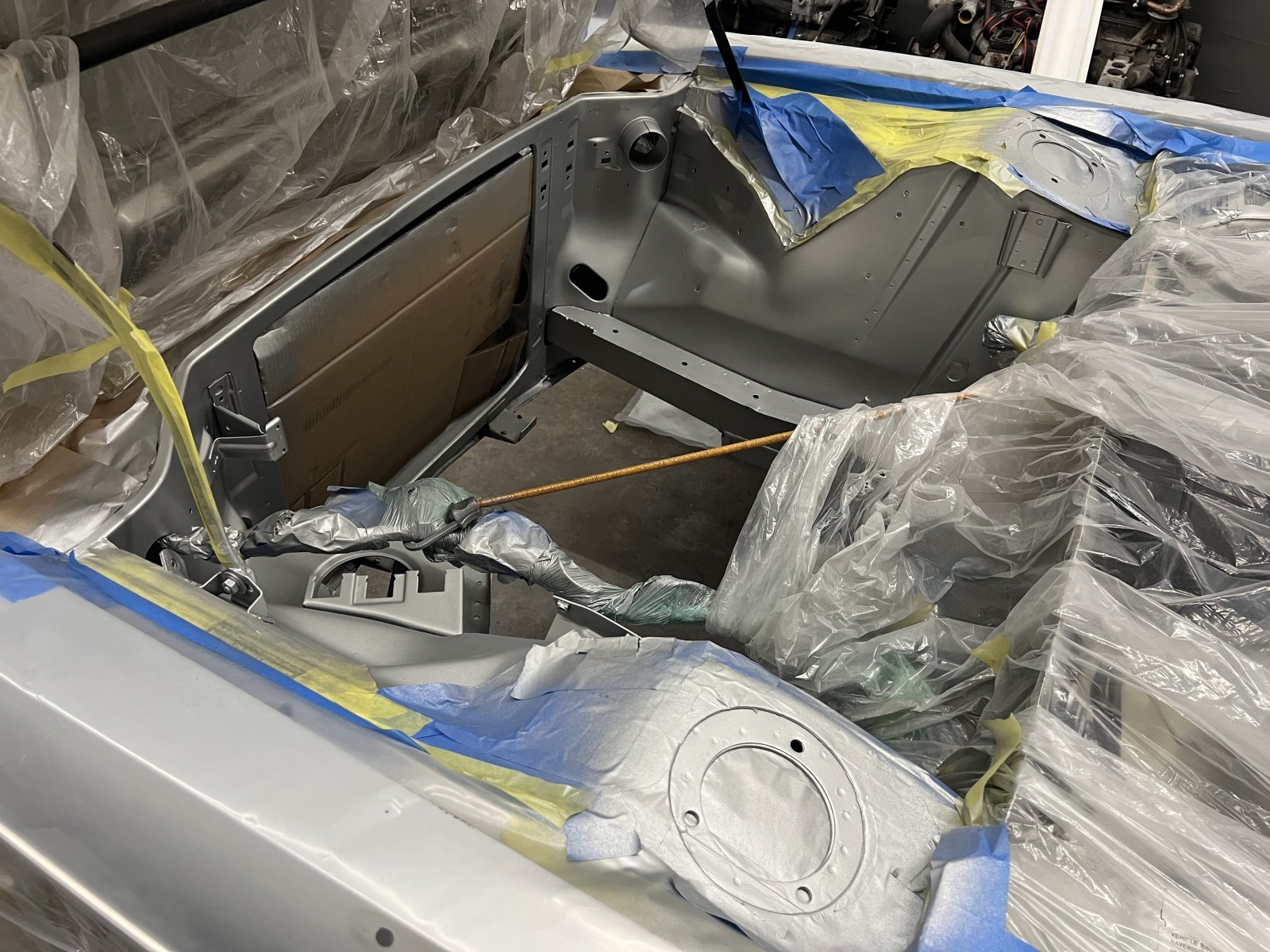

While they worked on that, I started cleaning up under the hood. Scope creep. So much for just throwing a motor in and hopefully having a running car.

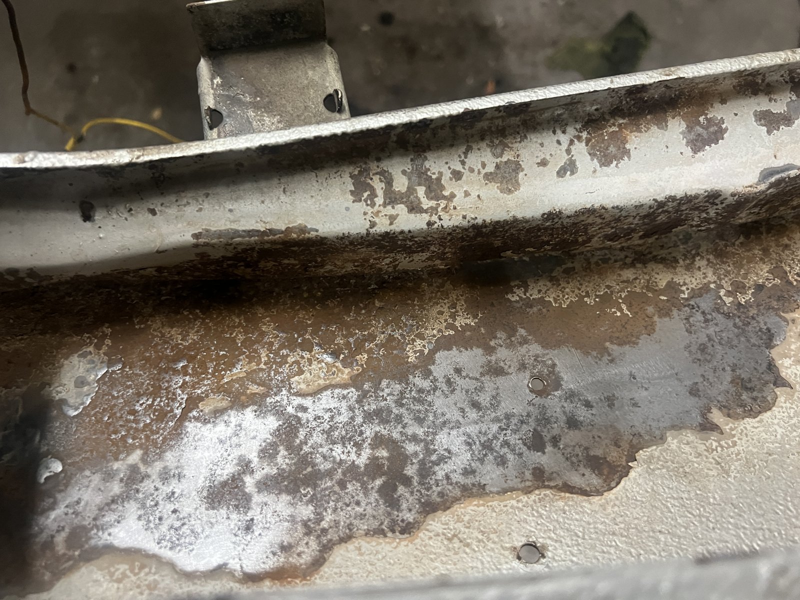

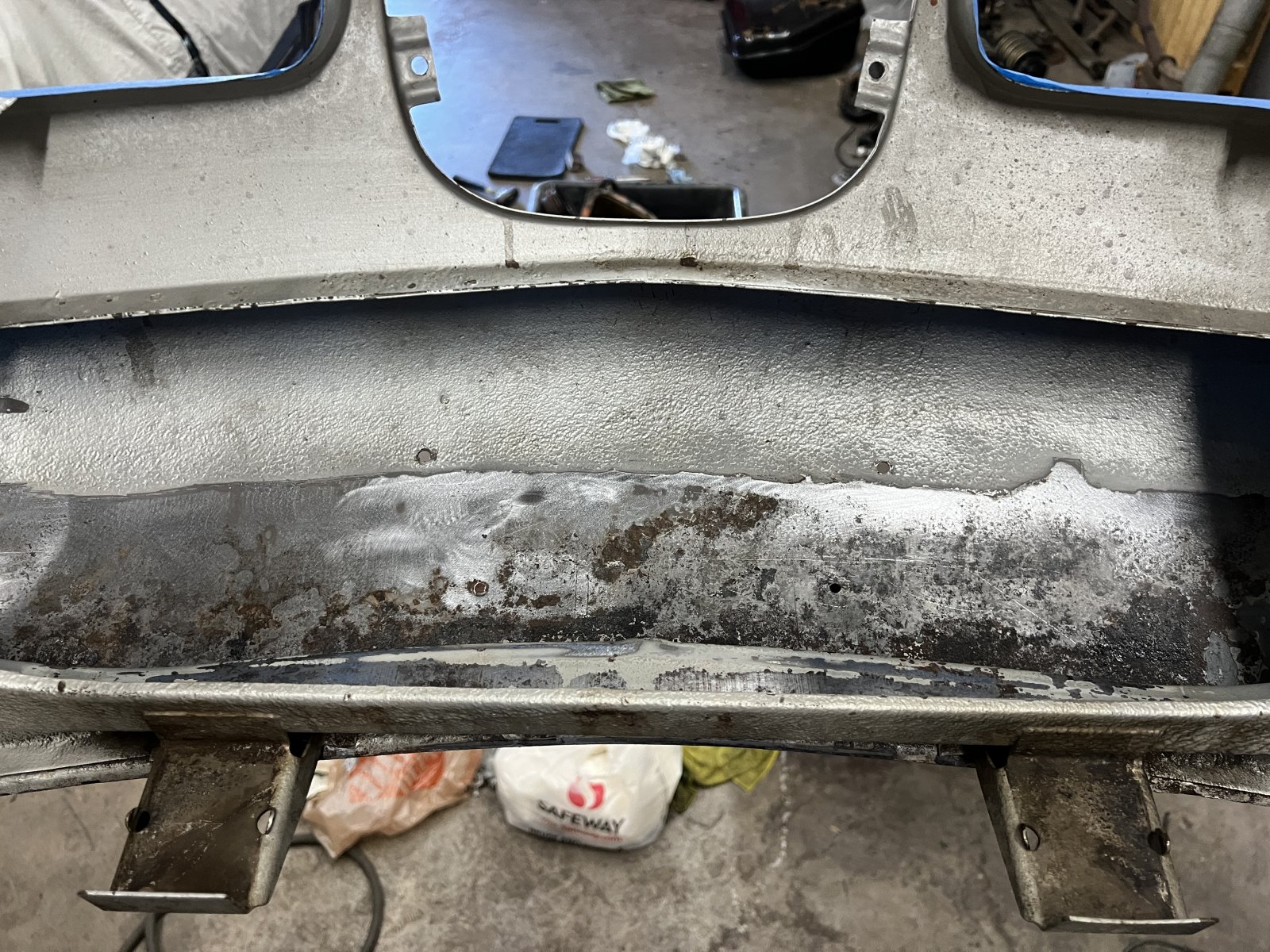

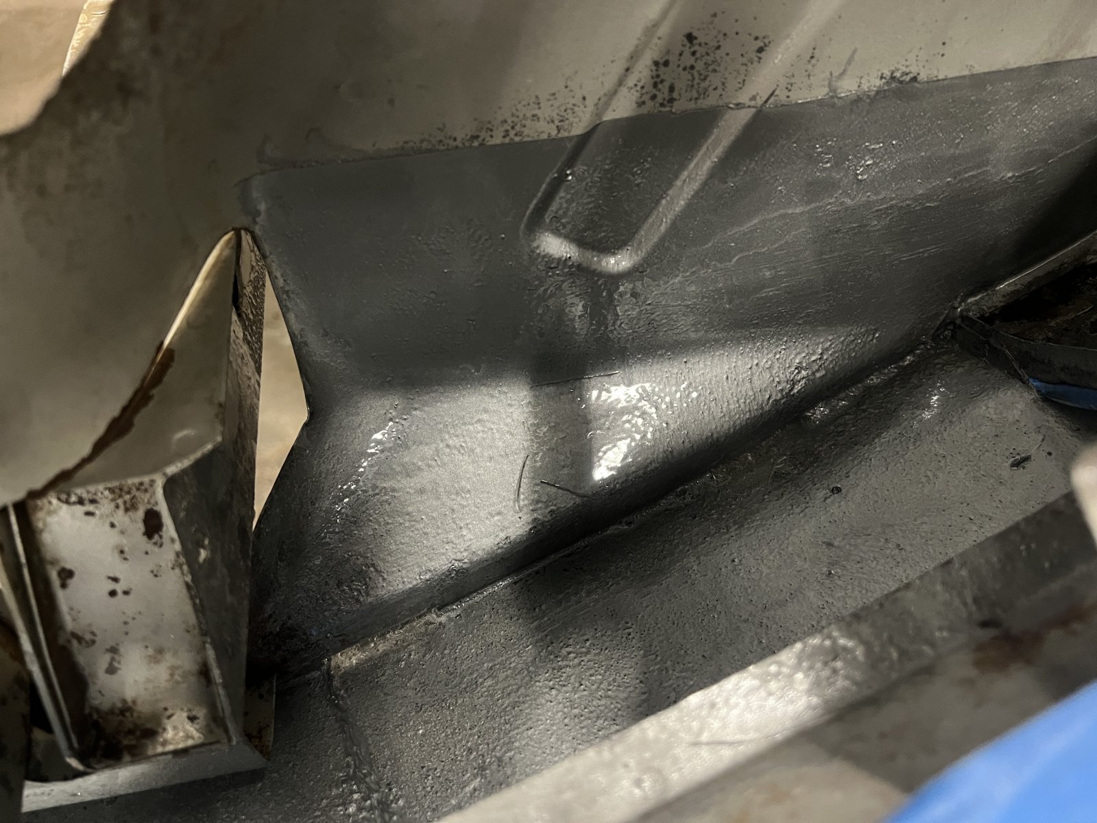

I also focused on cleaning up the inside of the nose.
I did a considerable amount of sanding and also used some evaporust, which isn’t as easy as you’d think it would be.

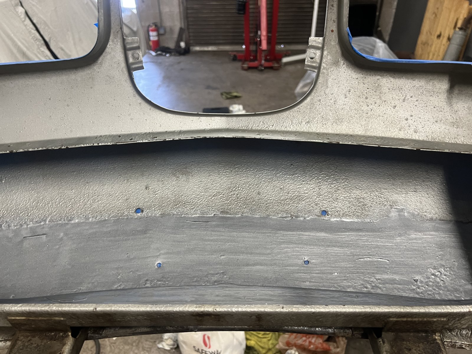

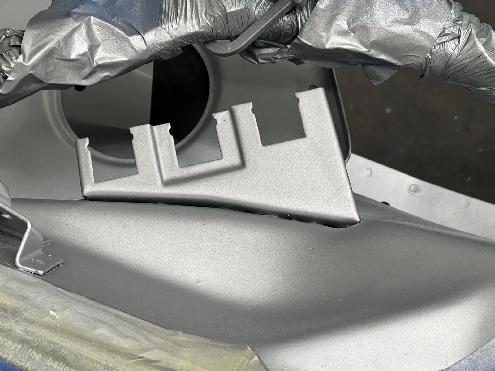

I ended up using silver POR-15 in the nose. I bought a kit which contained their degreaser as well as their metal prep product so as to ensure this would actually work, even on the clean metal. Access is so tough in some of the crevices, I decided this was really the best path forward. It turned out pretty well.

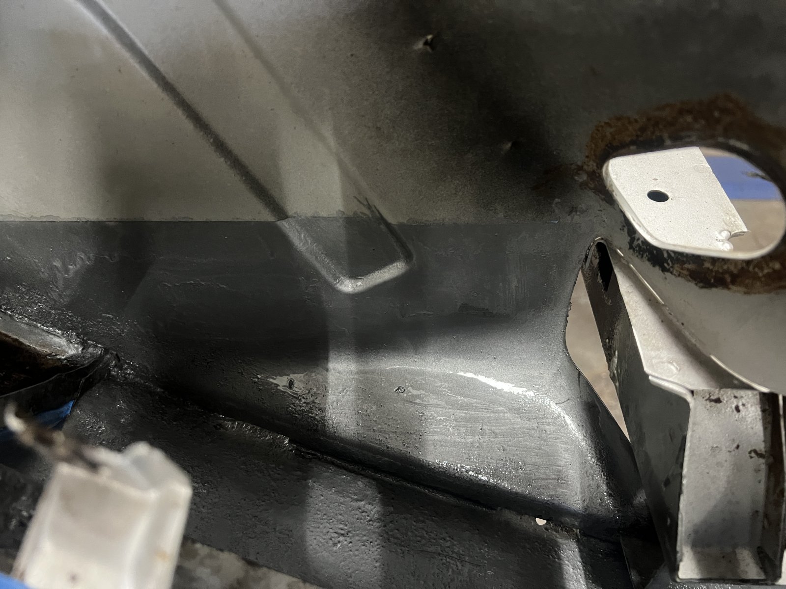

I continued to sand the engine compartment (120 where the rust is, then 220, then 320) then epoxy primed it. I decided that I had to paint the core support just because of the area around the battery. I could have blended in front of the radiator but decided I may as well paint the whole thing but leave the right inner fender. I had paint mixed up.

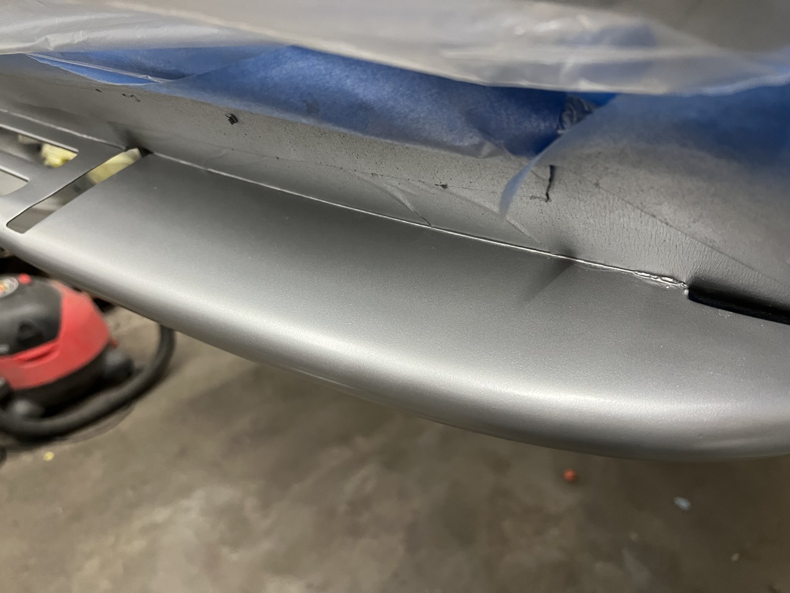

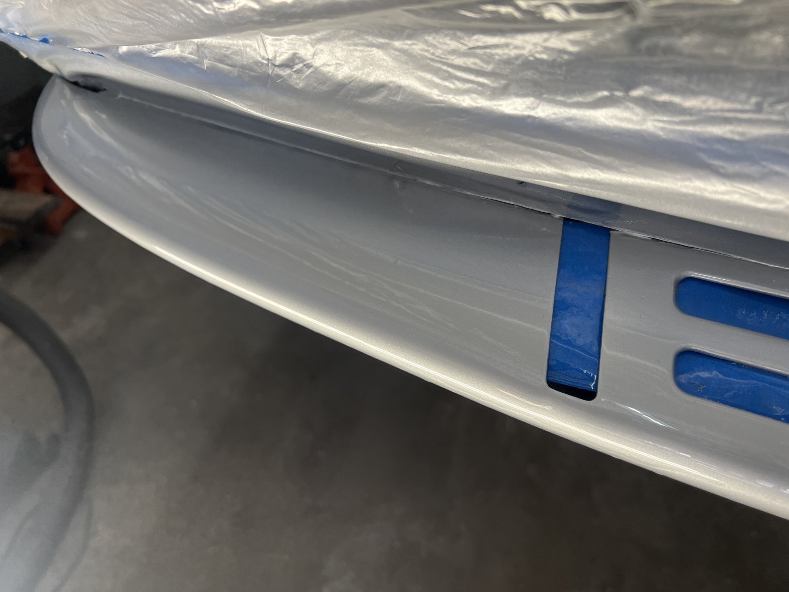

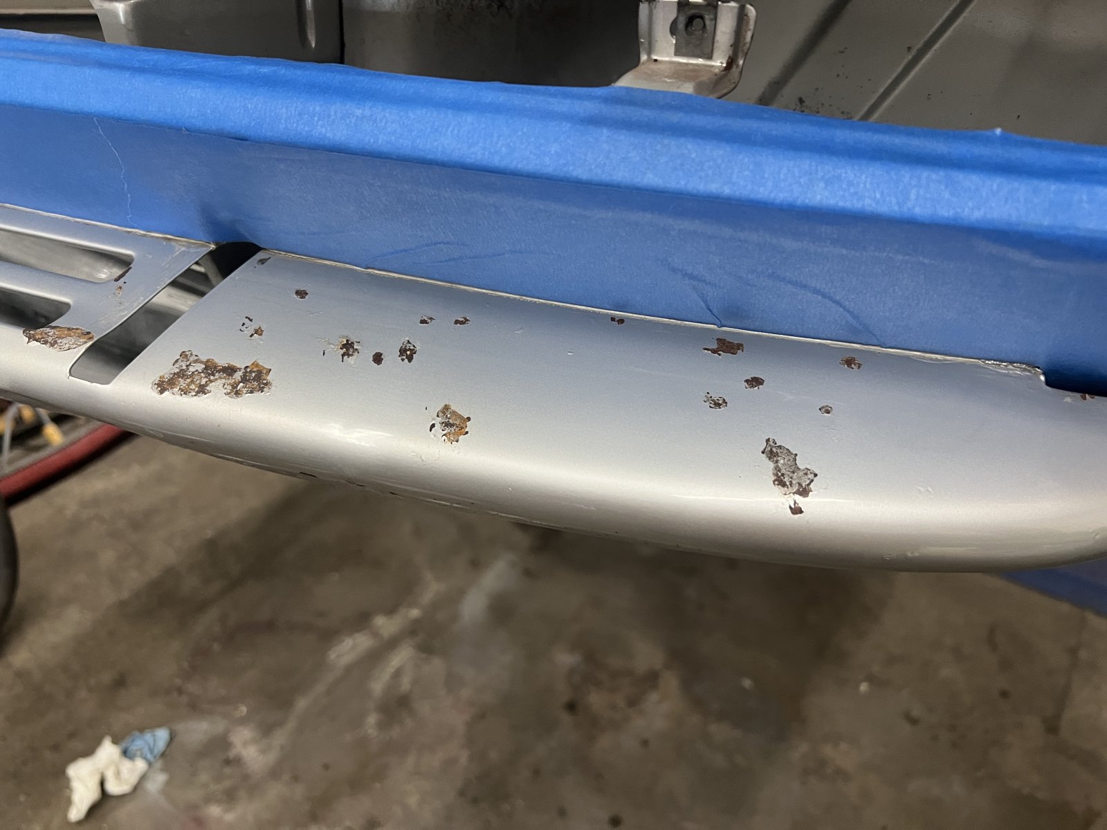

I also had to do something about the top of the valance where there was some bubbling paint likely from urine or something. I first soaked some rags in evaporust and wasn’t thrilled with that.
120, 220, 320 on the DA and then epoxy primed.

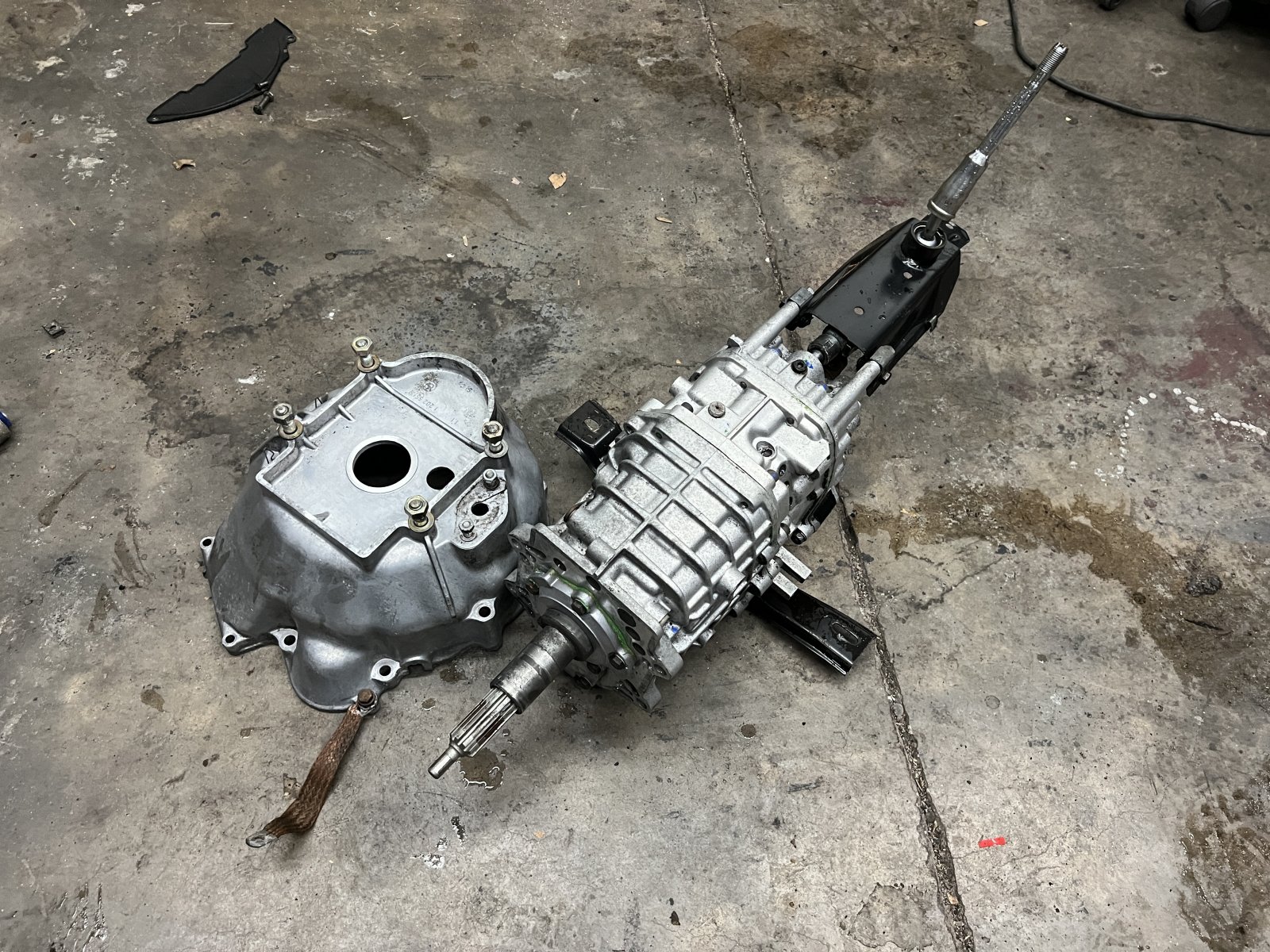

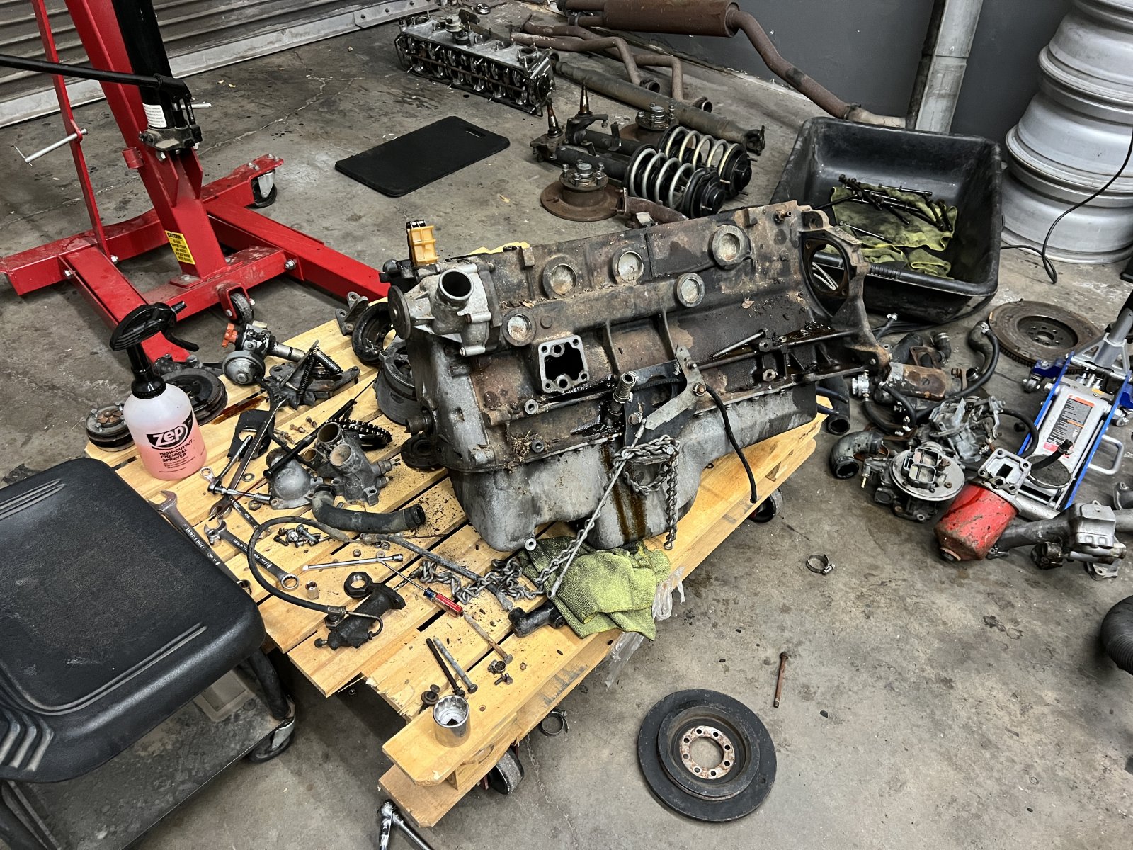

While the primer cured, I decided to pull a few things off the engine I removed from the car.
I took a few more bolts off and then I had this.

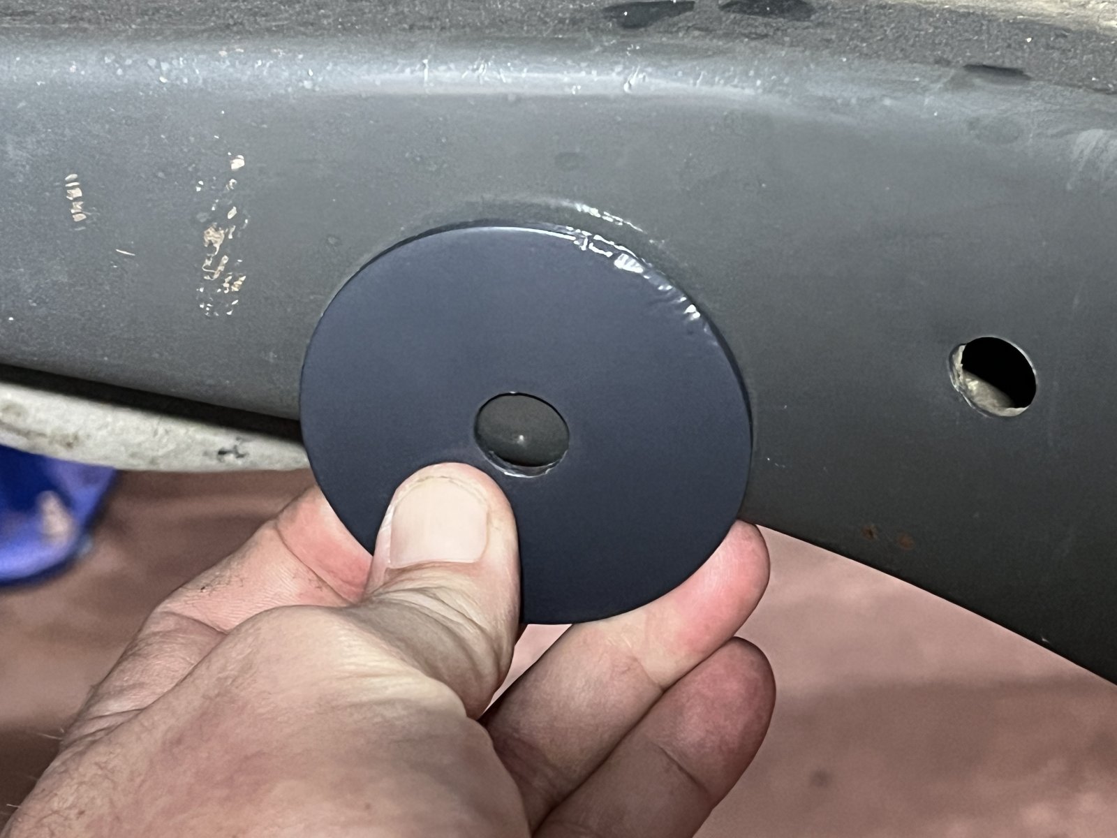

I picked up the powder-coating. There were a couple mistakes in masking the shop had to fix on the steering knuckles so I left those parts behind. Then I realized I had selected the wrong grey, so this was excellent discovery. Made me really feel great about my progress.
Here’s a shot of the tension strut washer against the original trailing arm.

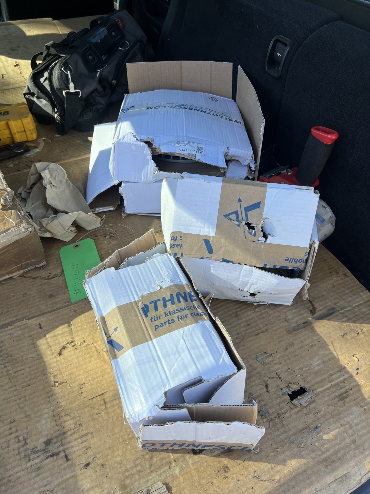

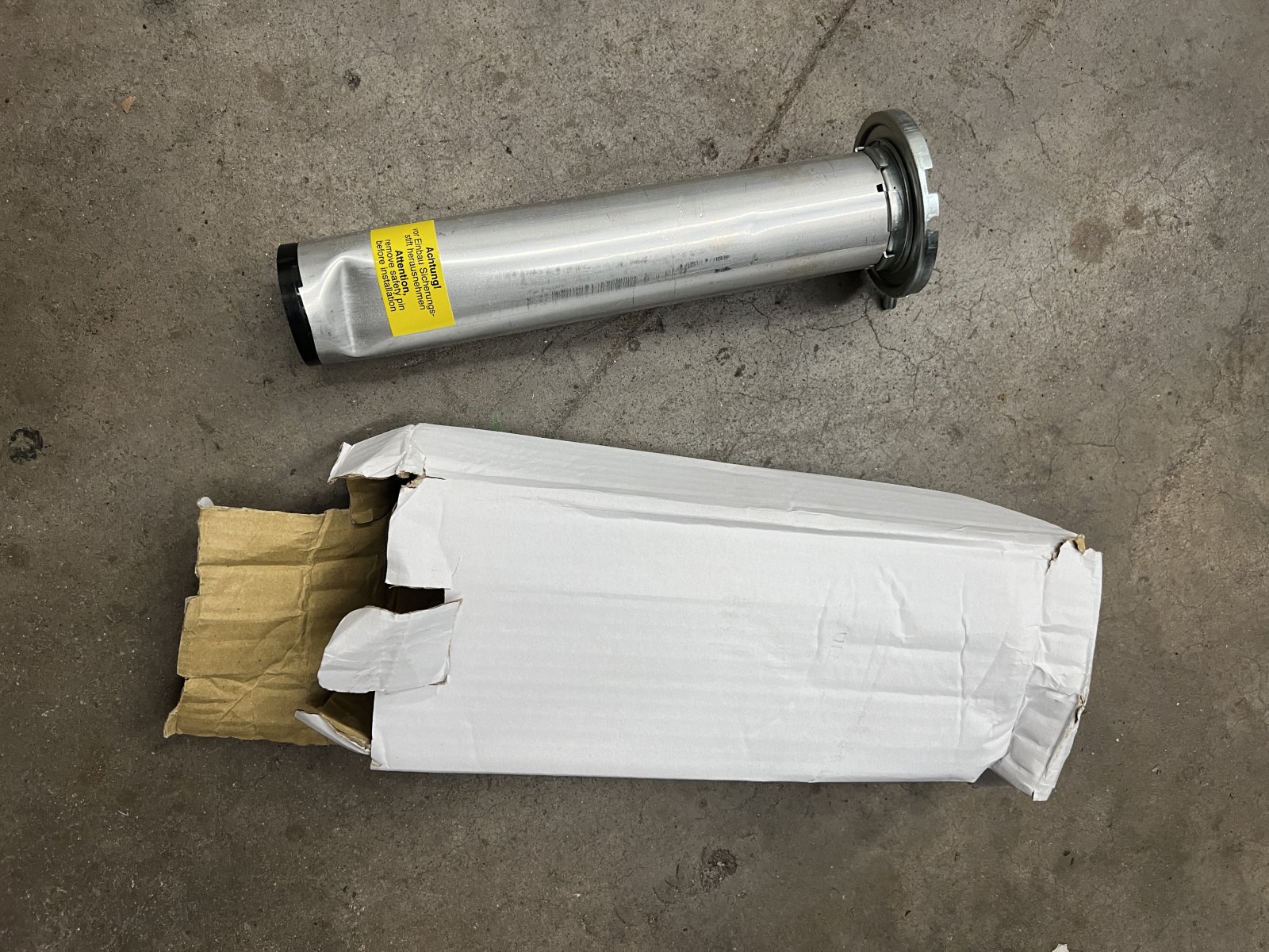

Hey but great news, two boxes from Walloth and Nesch showed up. One of the boxes from the original order and the other order placed over a week later. It didn’t go to China. The other box from the first order is a few days away still.
Oh.
I opened the boxes at the shop and everything was accounted for despite the hole but it wasn’t without casualties.
I’m not sure I’d have put this box adjacent to brake drums and then give that package to UPS.
After trying to decide what to do about the incorrect grey, I fell on my sword and said hey I screwed up and requested the wrong color. I’ll pay again to redo them. So I took them back to the shop and they can fix their mistake with the steering knuckles on my dime.

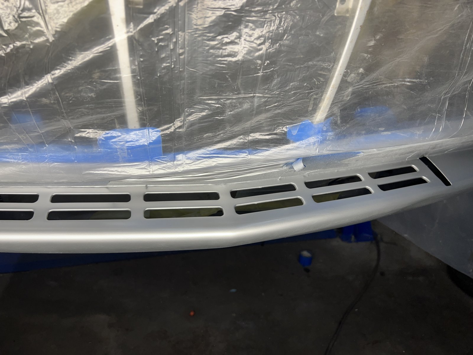

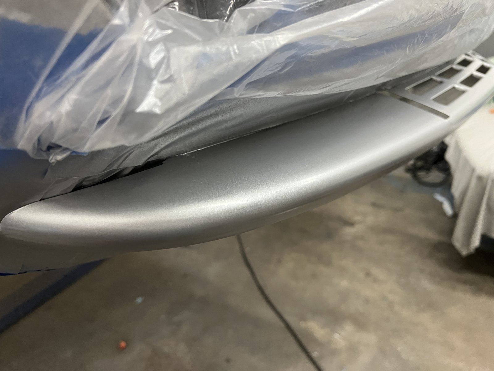

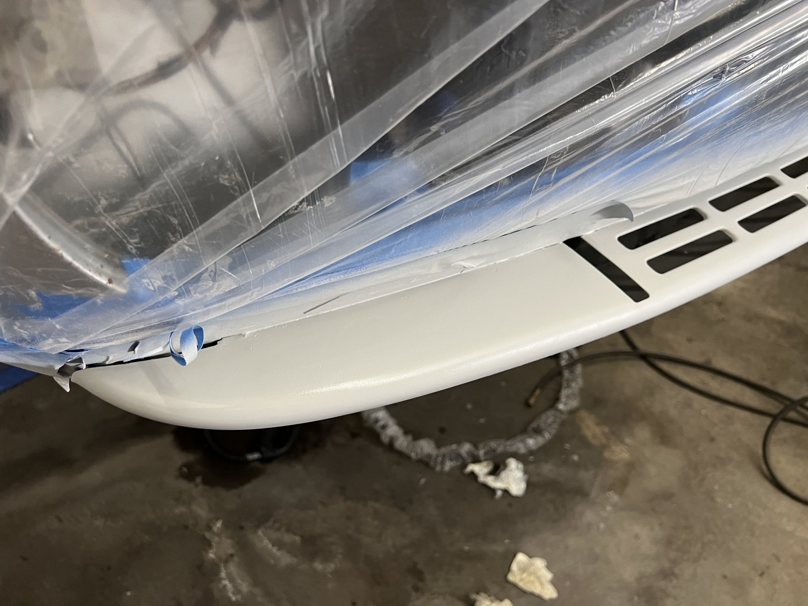

I sanded the epoxy primer 320, 400, 600 and finally shot the color on the valance.
I let it sit overnight due to the temps and cleared it the next day.
It came out pretty well so I am happy with that. More great news, my second box from the first Walloth and Nesch order showed up! Nice.
Oh.
In the box were new front calipers, new front rotors and one control arm. Somewhere between Germany, China, Alaska, Kentucky, then here, one fell out of the box.
Fortunately I wasted no time documenting this stuff and sent everything to Walloth and Nesch both times and have two replacement shipments on the way.

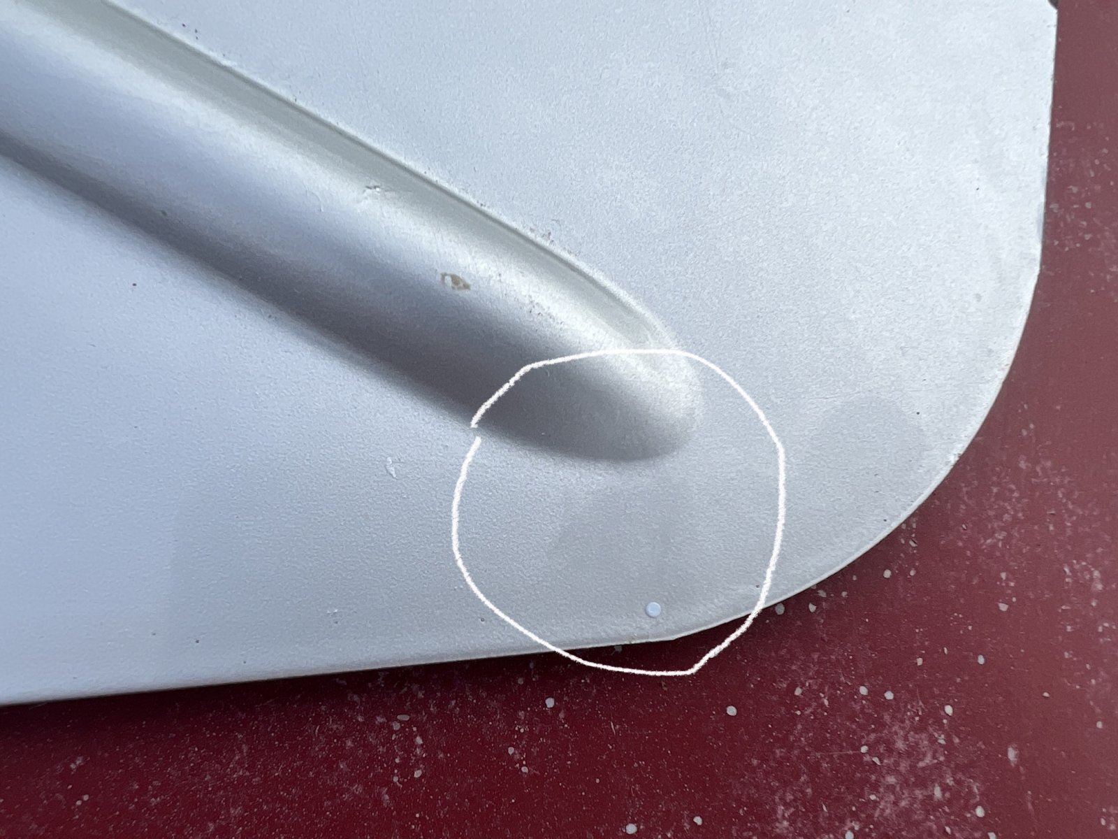

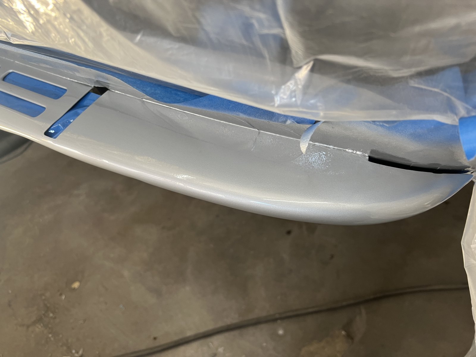

Next, I shot the color under the hood. I felt it was a bit dark. But I let that sit for a couple hours then shot the clear anyway as I felt the base was dark then it lightened up on the valance with the clear.
Sigh. So while the application looks pretty okay, it now looks like I took my original paint car and made it look like it’s been in an accident (salvage titles increase values on BaT). It might not have been so bad if I had painted the right inner fender but I left it alone because I didn’t expect it would be so far off and also I didn’t want to have to work around the AC stickers, plus it was already in pretty decent shape considering. Not a restoration, I keep saying.
I spent some time disappointed with the outcome and with how this relatively simple project has exploded and I’m going to have to get this car off the lift because I have paying customers that need my attention and obviously very little is going my way.

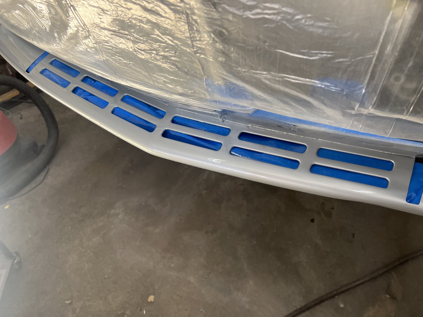

I decided that I can’t live with the paint the way it is as it upsets me. The valance is okay but under the hood just can’t hack it. So I set out to go with a different source. I talked to a PPG dealer and he looked at the headlamp cover and said they don’t offer a metallic that is small enough. He had just gotten in some of their latest extra fine metallic for the concept line and it was much larger than the original. Basically metallic size is key to Polaris looking right. I appreciated his honesty in saying he couldn’t match it. I went to another store near my shop that does offer Glasurit and Spies but they only mix Naison or ChromaBase on site. He couldn’t do it either. On top of that he couldn’t put the paint in an aerosol can.

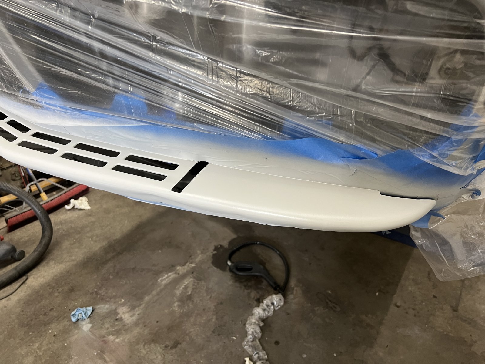

This morning I collected my new paint and I could already tell there was going to be an improvement.
Obviously metallic size is key. There’s a smudge of the new base on the cover over the original nearly 53-year-old paint. I had a discussion with the guy there about my project and he told me that the problem with some of the lower end brands like Limco (I only had two options for aerosol at the previous store, Limco or Matrix which doesn’t match BMW or Porsche metallics at all) is they only have 4 metallic sizes and a limited amount of toners. This Debeer line is much more prolific. I felt more positive leaving the shop.
I sanded down the previous paint job. 400 grit in some areas and then 600 on the whole thing.
After just shooting the base I was pretty excited.
I also decided to do the right inner fender as well and found a spot to blend where I wouldn’t encroach on the AC decals. I also cut the masking out over the strut towers and sanded and primed that area before base coat. I took a break and gave it a couple hours before clearing.
After some carne asada tacos, here’s the result:
I feel a lot better about how that came out. Now it’s onto something else. Keep going back and forth and how much cosmetic stuff I want to do on the engine.
