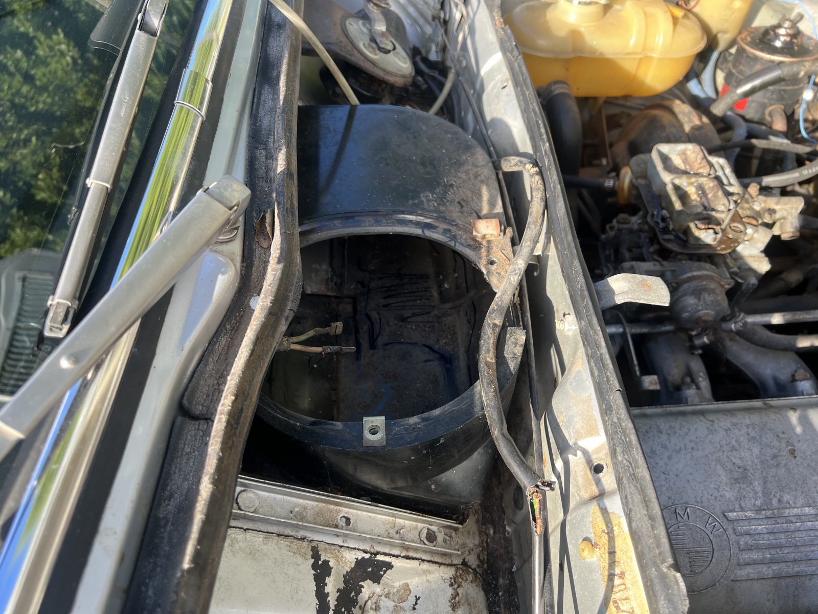

I moved back under the hood to the excitement of cleaning. I had previously tried to remove the cover over the heater but found one of the screws for the rear of the cover had the Philips head stripped out enough to prevent using a screwdriver. I used a small vise-grip pliers and was successful. Not sure what I expected but eww. BB6E06B2-5FF6-4AE1-8B7E-B3D6FCF344A0.jpeg
Naturally, this was concerning but I was hopeful that there wouldn’t be any rodents inside the heater box, given the design, but to find out, I had to remove the fan. First, though, I had to vacuum up all this stuff.

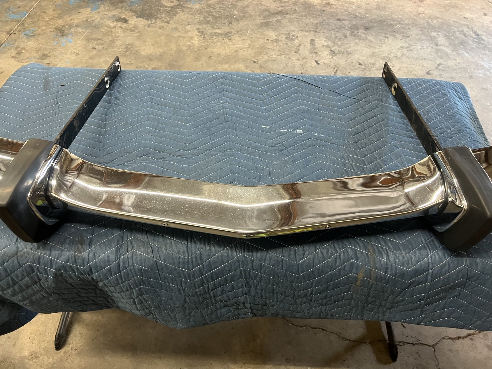

After I removed that I decided to take the front bumper off. It went pretty smoothly and it doesn’t look like it’s ever been off the car from the look of the brackets or the fasteners.
Removing the bumper was mostly to help clean up the nose better and also to give me a chance to do something that will keep me motivated (not that I’m not motivated).

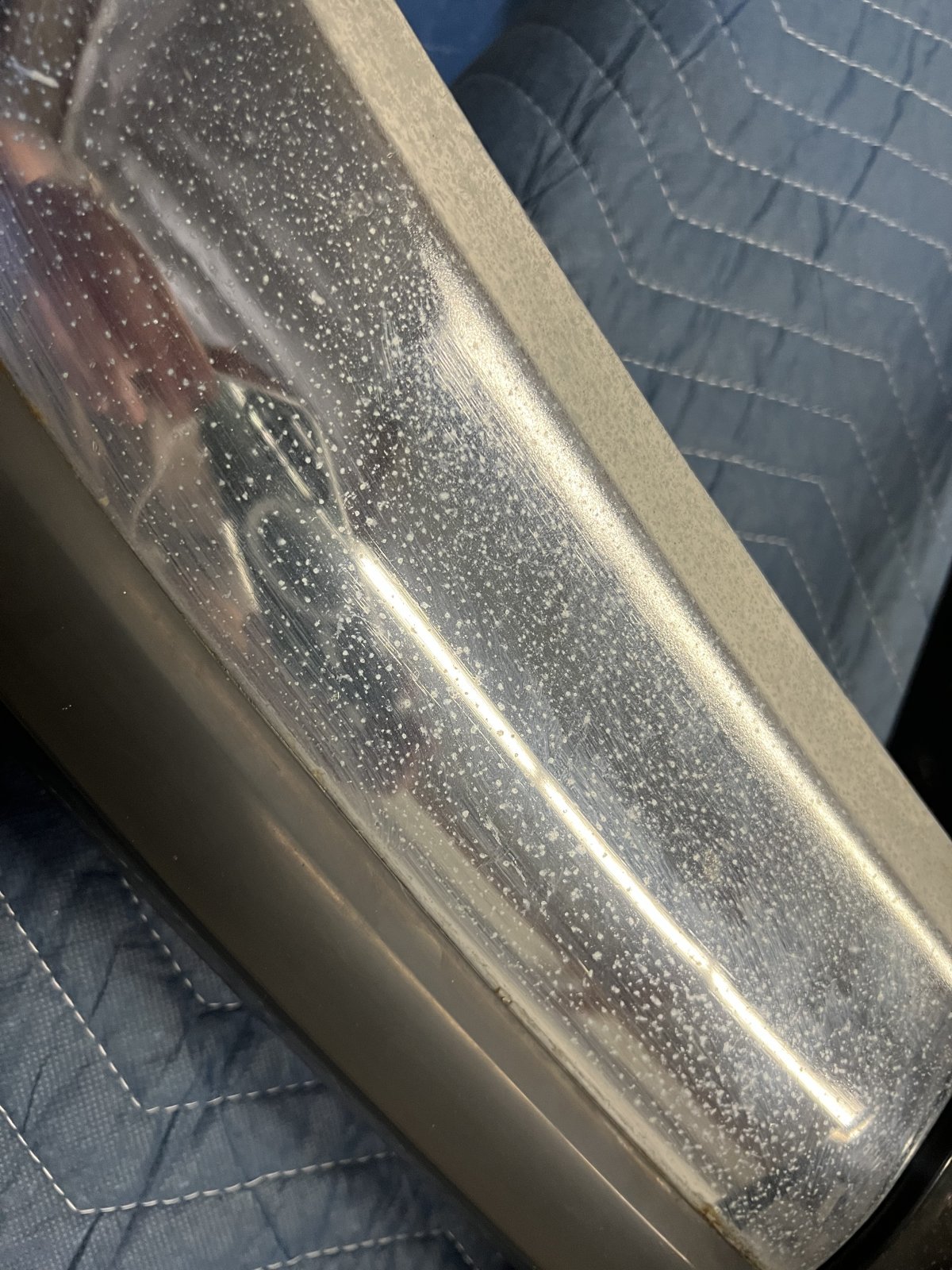

To me, it looks like most all of the brightwork on the car is in really nice condition but the chrome has these freckles on it. Not deep pits or corrosion by any means so I thought I’d start cleaning it up with the front bumper and to get a good idea of how it would go, I started with the bottom.
After a bit of time, this was the result:
I did the whole bottom and then moved to the top:
It cleaned up pretty nicely and while it doesn’t look brand new, it fits the car. I put it aside in my “reception area” so it’s safe and out of the way while I work on the rest of the car once it’s here at the shop.
Back at my house, I finally had the shop vac and vacuumed up more stuff at the base of the nose. I carefully removed the headlight covers to assist with this plus they and their hardware need to be cleaned up anyway. I also removed the heater blower motor and vacuumed the small amount of junk that likely fell out of the fan during removal.
The flap was closed and I felt like I won the lottery on that one. I used an endoscope to look around the partition in the box. I don’t want to open the flap until I clean and sanitize this part of the box.
Also note that a couple of wires were chewed up (green and brown). They go through the small grommet above the valve cover. The other pair of wires (also green and brown) go to the washer pump I believe. Shouldn’t be hard to fix.

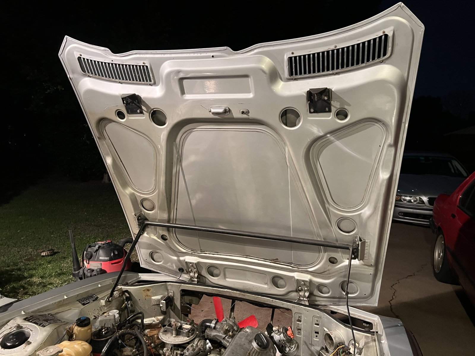

I then set my sights on the hood insulation. There are areas that had been chewed upon. Fortunately it wasn’t original, but also had a couple extra pieces added. It was quite a bit of work, but I worked at it methodically and while my fingers are quite sore this evening, I was quite satisfied with the outcome.
That’s where it’s at now. Will probably spend more time cleaning under the hood tomorrow and then tow it to the shop so I can get to work on more mechanical stuff.

Yes, another update but this one is free of feces. We had a “warm,” sunny day today so I used the opportunity to do something that I think needed to be done but at the same time is a bit risky. With so much rodent activity and the results of said activity, I’m unaware of really any other way to rid the vehicle of the after effects than using the pressure washer.
To prepare for this, I put a bunch of effort into isolating the rest of the car from the affected areas. I covered all of the surviving labels with painters tape, I covered the aluminum belt line trim with tape and also as much of the exterior paint as possible with both tape and plastic sheeting. I’m very careful with the nozzle but one mistake and it’s too late, so best to do my best to avoid it.
I think it’s much improved and things dried out much more quickly than I anticipated so I could breathe a sigh of relief. At least I think that’s what it was. Either way, I think if you look back to previous photos of inside the nose, you’ll agree.

I also decided to do the right inner fender as well and found a spot to blend where I wouldn’t encroach on the AC decals. I also cut the masking out over the strut towers and sanded and primed that area before base coat. I took a break and gave it a couple hours before clearing.
After some carne asada tacos, here’s the result:
I feel a lot better about how that came out. Now it’s onto something else. Keep going back and forth and how much cosmetic stuff I want to do on the engine.
