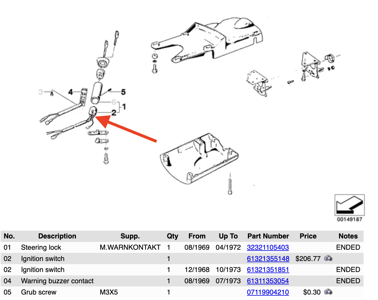

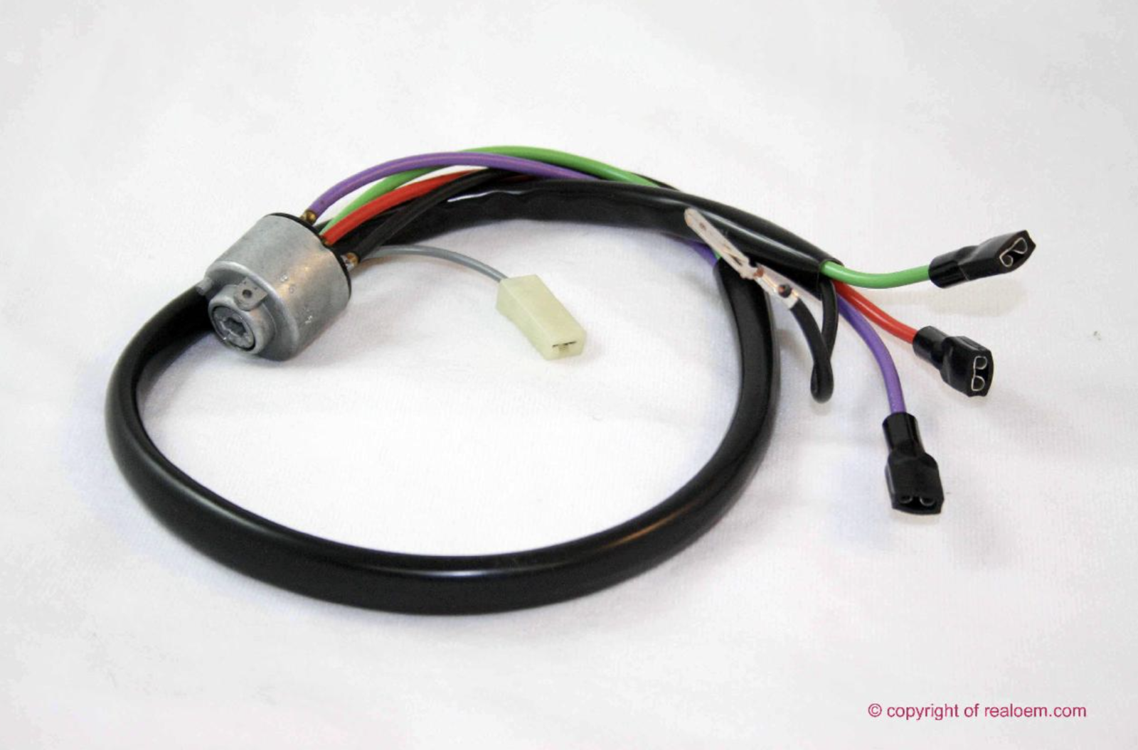

yes. Basically, I have to turn key several times before car will turn over. It makes no noise on first effort, second effort, then turns over normally on 3rd or 4th effort.
It is probably one of two things. (both have been mentioned here)
1. The "pawl" that connects the two parts of the ignition switch may be broken or breaking. It can usually be fixed by replacing the electrical part of the switch which is accessed by removing the bottom cover of the steering wheel.
2. The starter is on its last legs and needs to be replaced.
To test which one it is, use a multimeter to see if 12V is reaching the the trigger wire either to or at the starter when the key is turned to the start position. If not, it is the electrical part of the key switch. If so, it is the starter.

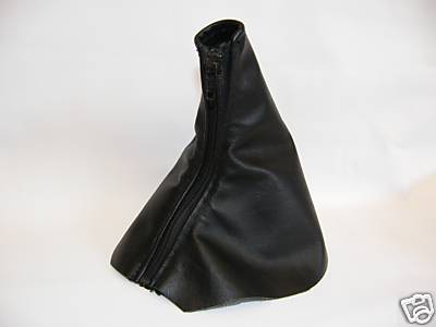

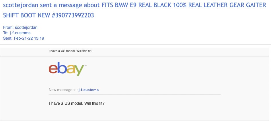

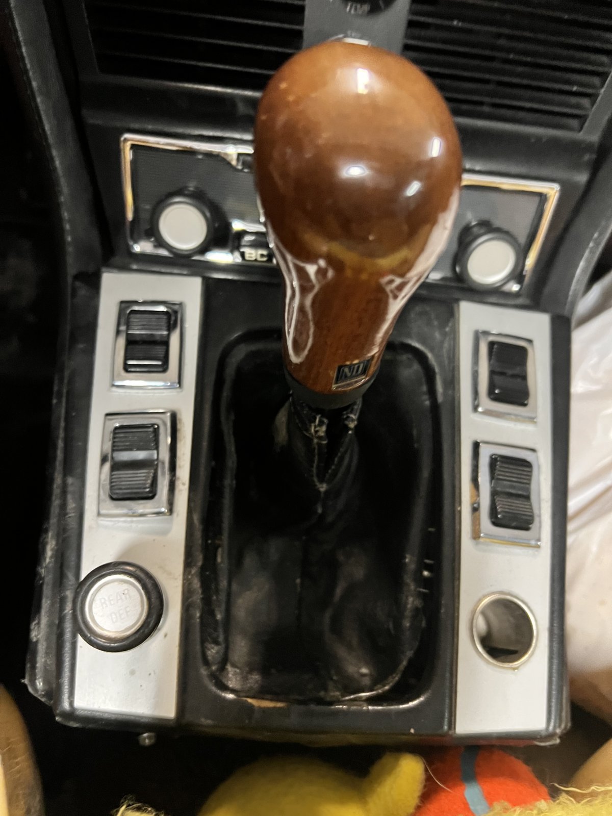

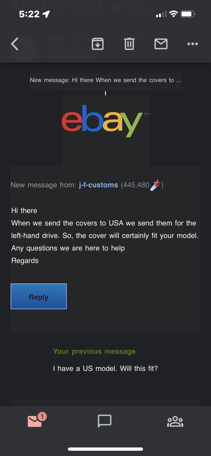

Wait, mine is the entire platform, not just the boot!
Also form the UK it would be for RHD :).
Arde:
I installed in LHD 2800CS with no issues. I suspect right and left are the same. If Scott is looking for the entire platform, I agree with you. Then CS Werk might be the way to go.
Thx, Dan
Arde:
Thx, Dan
Oh, you missed my smiley, of course they are the same. Leather is axially symmetrical I think.
It's a reasonable assumption. The shift lever is angled differently for LHD and RHD so I bias could be incorporated into the boot. ( Serious face here. )
Trying to get my ignition issue solved and my mechanic asked me to post the following question:
Can you ask if there is a wire running straight to the starter or does it go into a relay
The 2800CS ZF trans had a LHD and RHD version of the shifter but the Getrag uses the same for both LHD and RHD according to the parts book. The shift platform is the same as well.

I got the new shift boot, and it seems perfectly symmetrical to me
