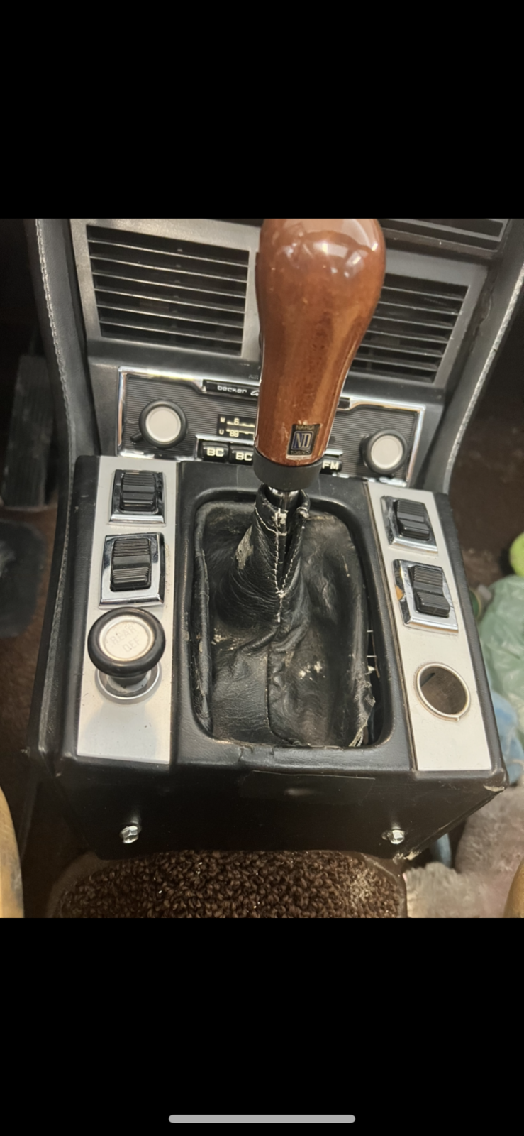

  • New boot for shifter - I can't believe what a mess has been made of this. Looks like they drilled holes- i covered one with tape, and not sure there is much I can/should do about the other 2 screws, but would love to figure out how to get the leather boot to attach properly... I think this just take attentiuon.

4 - Have a beautiful boot for shifter made by DQ available, it is for non A/C so you would have to cut it a bit one side.
link?

An good upholsterer should be able to make a new shift boot using yours as a pattern.
