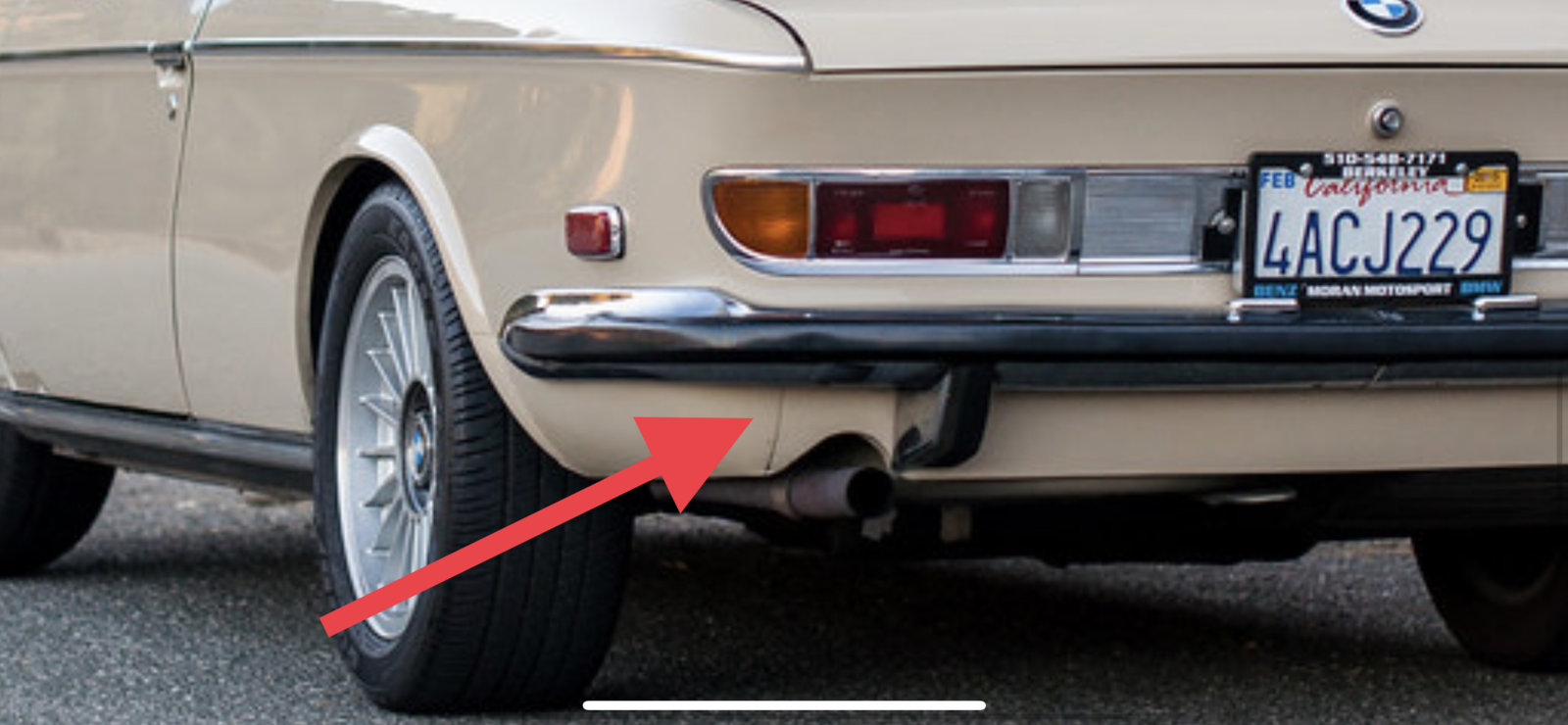

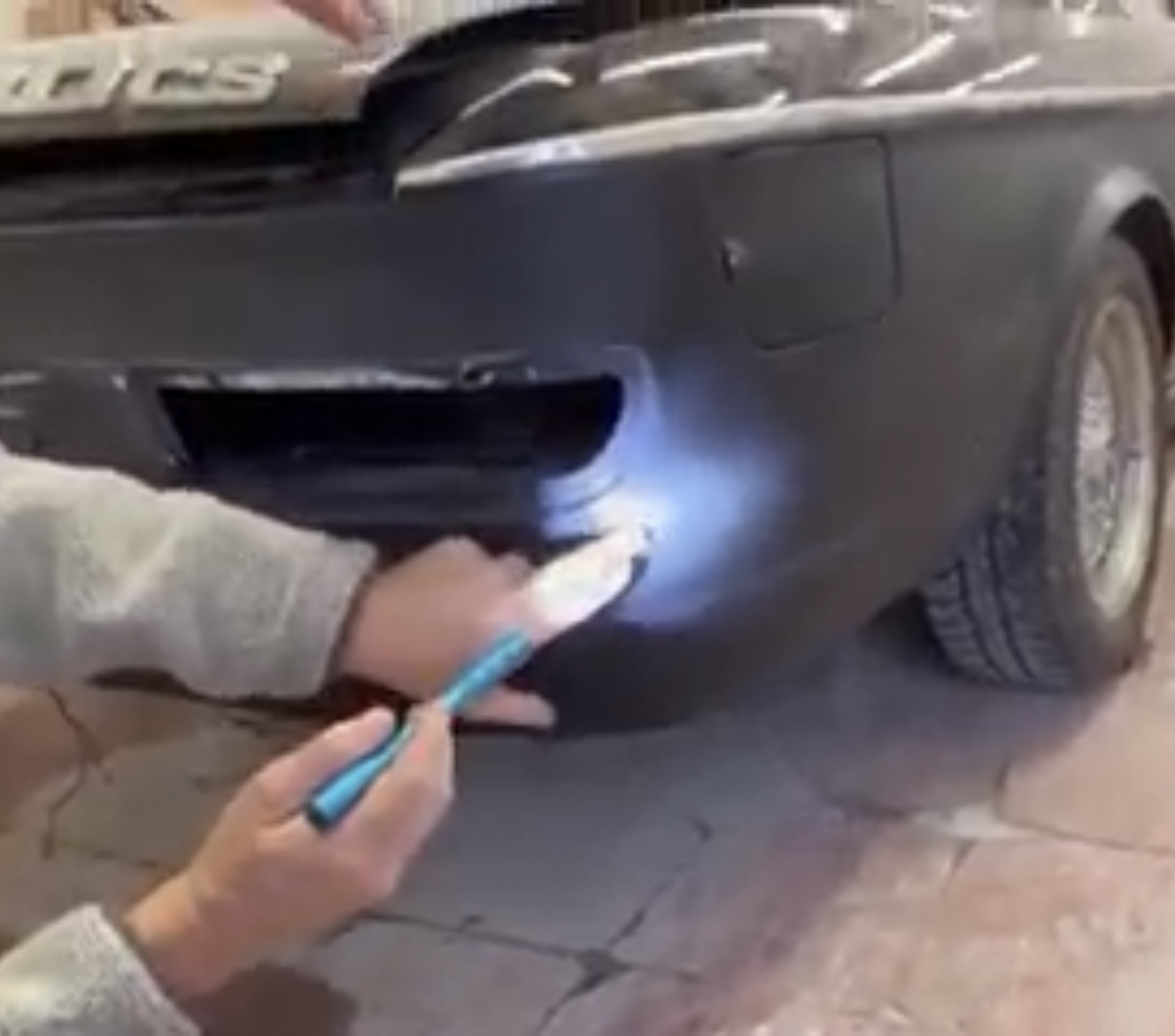

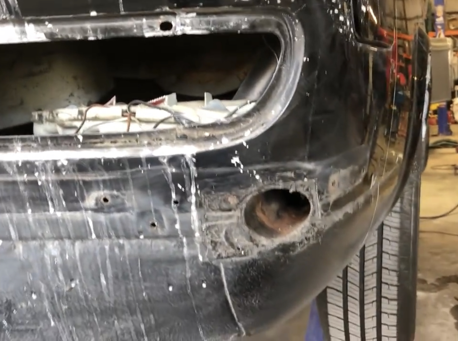

FWIW, the cracks mentioned in the rear bumper section are where the 1974 bumper shocks go. When he grinds that area out he will find plates that cover your old holes, as seen from one of your first restoration videos posted.
2018:
2021:
FYI - The vertical “crack” below that hole that he is pointing to immediately after this is a factory seam. It is where the tail panel is spot welded to the rear fender, with visible folds on the backside. There is supposed to be a seem there, as seen in the 2018 pic above as well as the Sahara below. Yours was filled during the restoration, as seen in the latest video.
