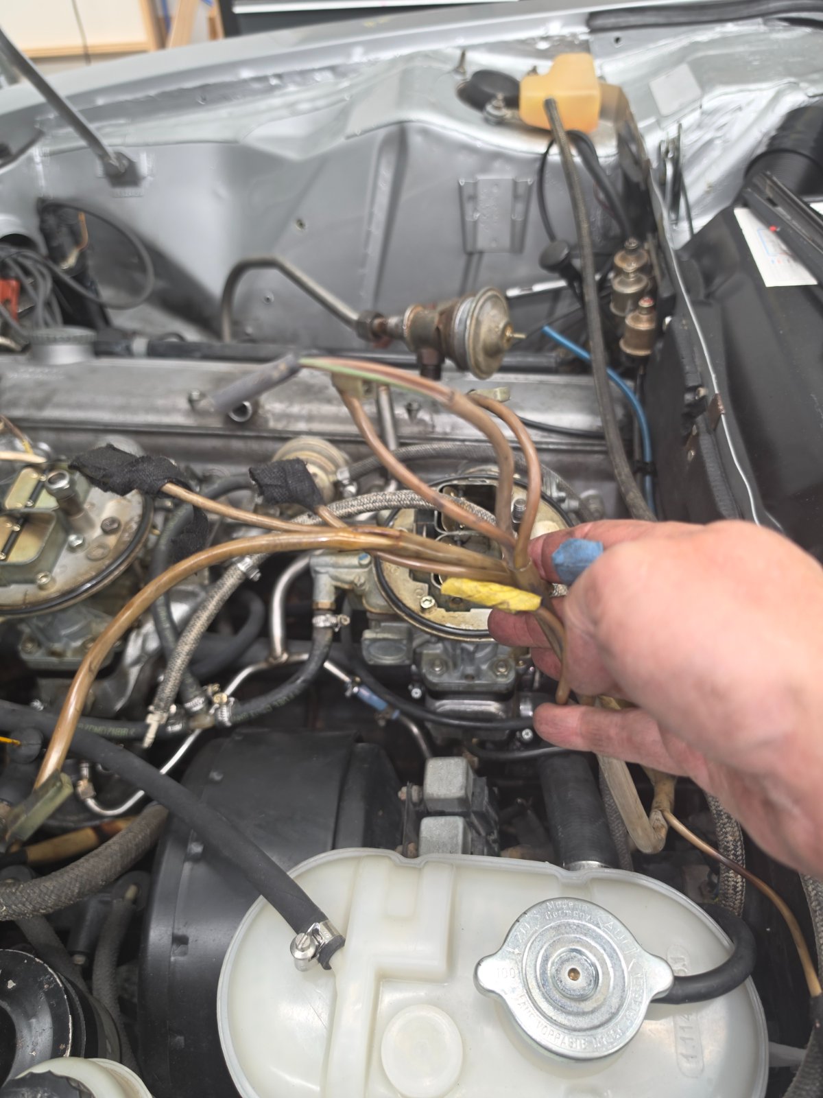

My car was just delivered and so far, I'm pleasantly surprised. Can someone please tell me what these wires are from? Would photo # 3 suggest I have a relatively new OE Radiator?
David
74's had a torch in the glove box. Those wires might be for that. Any current in them ?

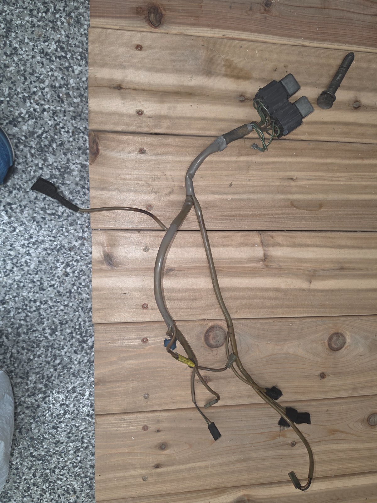

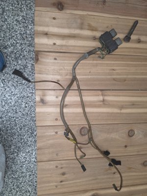

I have all these loose wires. Most of them are not attached to anything except for some relays mounted to the top of the brake booster and to the bottom of one of the carbs. Any ideas? Does anyone make a color wiring diagram?
David
Looks like you have Webers now. These were for the water chokes on a Zenith carb, there was a relay on top booster too, all can be removed.
Why would someone go to the trouble to tape off all the ends instead of simply removing the wiring harness?
Probably so they could go back if they wanted. I woudl just put shrink wrap onthe connectors and tuck them away as invisibly as possible. Putting them back would be a huge amount of work if you ever needed or anted to do that.

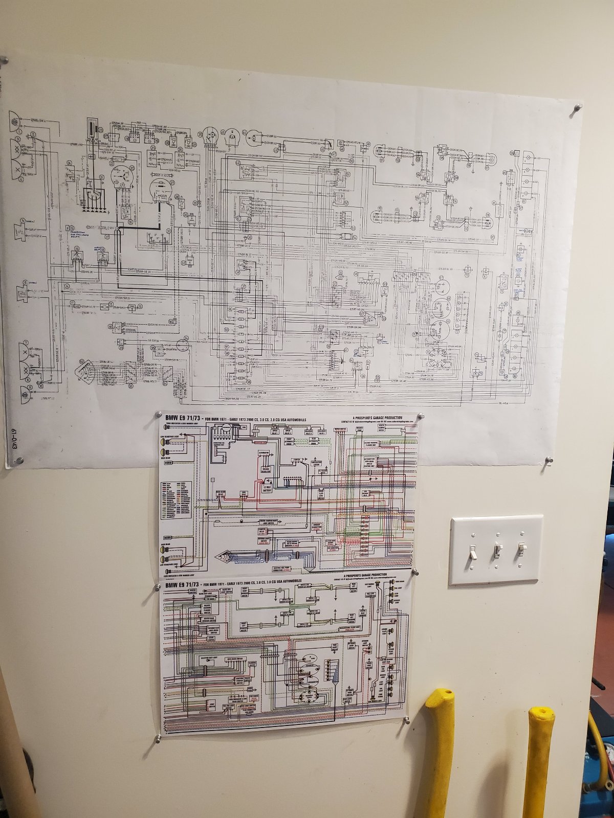

Thanks nicely done. I may need another diagram on the wall.
they didn't want to undo the harness to get to where the wires started. i removed some green / white wires that went to speed relays for carbs a few weeks ago on my car and it hadn't had carbs in 20+ years. those wires went all the way to the fusebox.
I know that many have said that Prospero’s diagrams have some slight inaccuracies, but I do find them VERY helpful for a quick and dirty oversight trying to trace wires from point a to point b. I tucked one under my trunk carpet so I have it in case I have an electrical problem out on the road…
