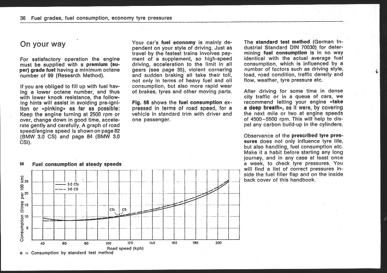

BTW, what kind of gas mileage should I expect to get on under highway and city. On first tank of gas, I got about 13.7 mpg. I drove it fairly hard, mostly city driving, so about what I would expect.
Again, much thanks for all he help. You guys clearly know your stuff.

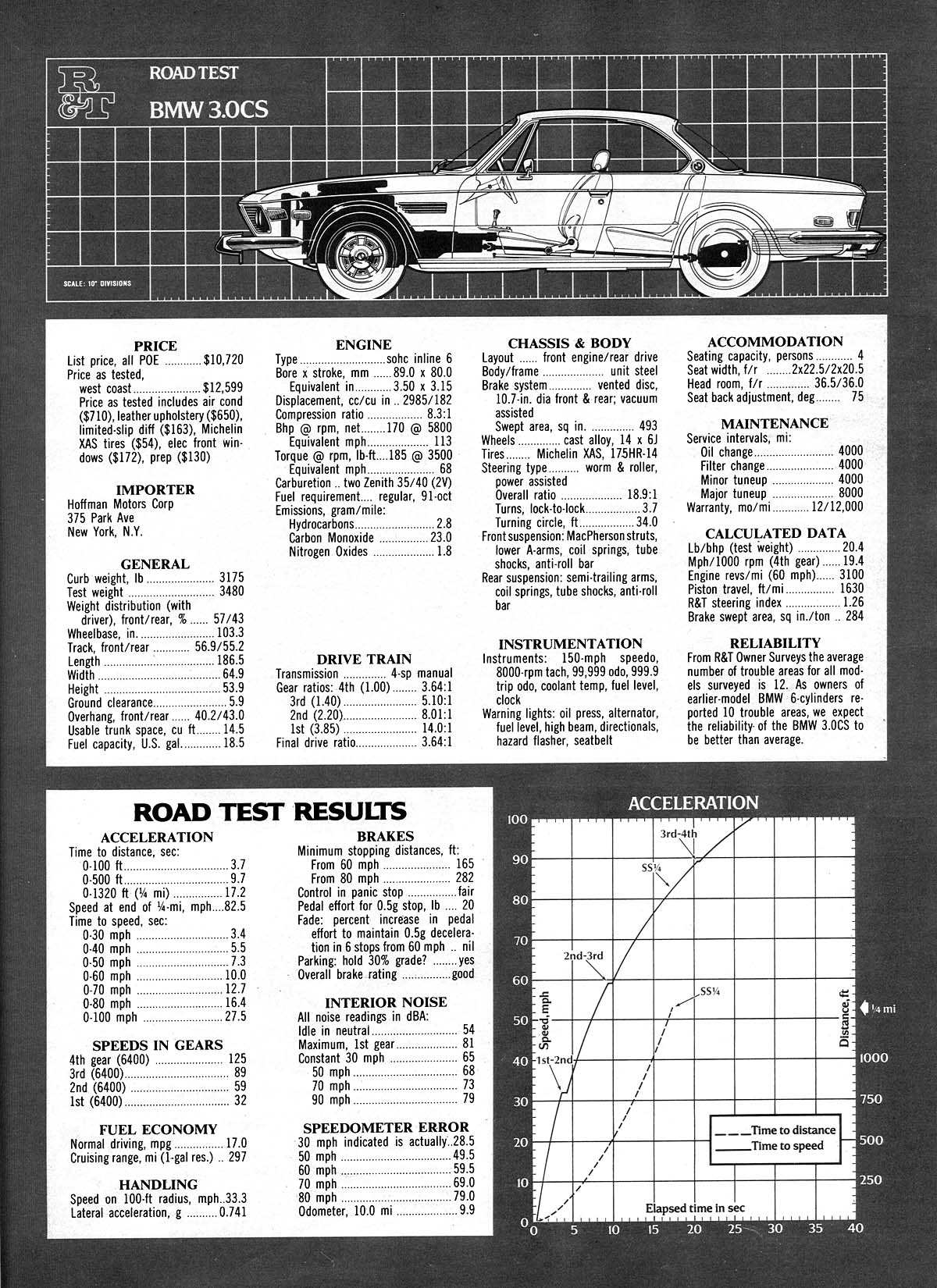

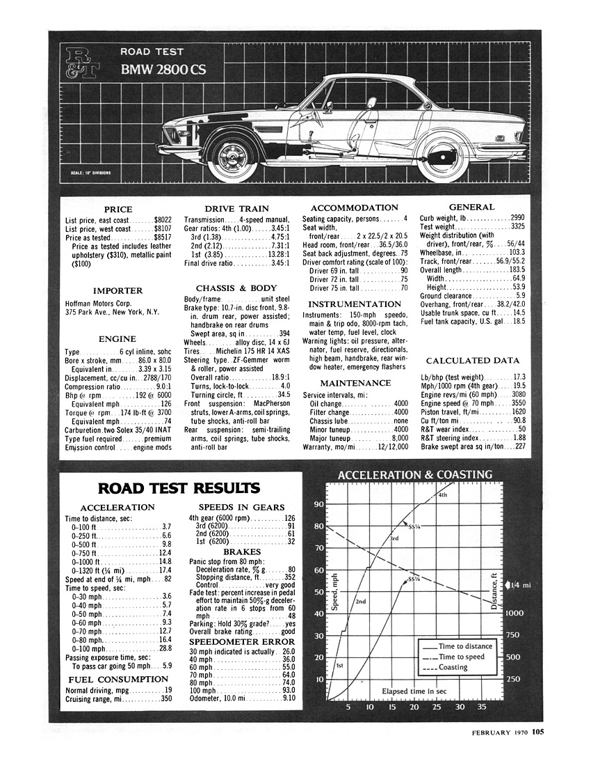

I live in mountain dessert climate . . .
For obvious reasons, mountainous terrain might yield lower economy figures as compared to those of us who hover near flat sea level. Coupling that with what you describe as "fairly hard" driving, does not make for high fuel economy numbers.
Given the ages of our cars, states of tune and modification, and different driving styles, fuel economy comparisons can be very misleading. Even if you had two comparably equipped vehicles, those of us who feel compelled to drag two sets of tools, golf clubs and groceries whenever and where ever we drive, are probably going to get different results.
Interestingly enough,R&T reported "19 mpg" for the 2800 and "17mpg" average for the 3.0 E9s. (see below).

Also, I find it interesting per the Road and Track figures that the 2800 cs has more hp than the 3.0, and the 3.0cs is supposedly 10 sec 0-60, when I have read elsewhere that it will do it in about 8 sec. No big deal, but those numbers are pretty fair off, and I think I ran 0-60 in about 9 sec yesterday, and wasn't pushing it.

Regarding R&T's test figures, who really knows under what conditions they conducted the tests or, for that matter, exactly how they conducted the tests? Same is true for many of the other contemporary magazine tests.
Suffice it to say, we are not privy to exactly how each car was treated/tested, each vehicle's mileage/condition when tested, or who might have ridden the clutch prior to any test run. Also consider that the engines had different advertised compression 9:1 vs. 8.3:1. One used premium leaded while the other evidently drank regular. While the 2800 produced more hp, the 3 liter produced more torque at lower revs, suggesting it might be better behaved at low speed takeoffs. The rear axle ratios were different and the gross vehicle weights were different. The 2800 is listed as having a 17:1 lb/hp ratio vs. 20:1 lb/hp ratio for the 3 liter.
These test figures are far from clinical measurements, and at best, they are broad guidelines to be discussed over Cardinal beer. As the saying goes, your mileage may vary.
