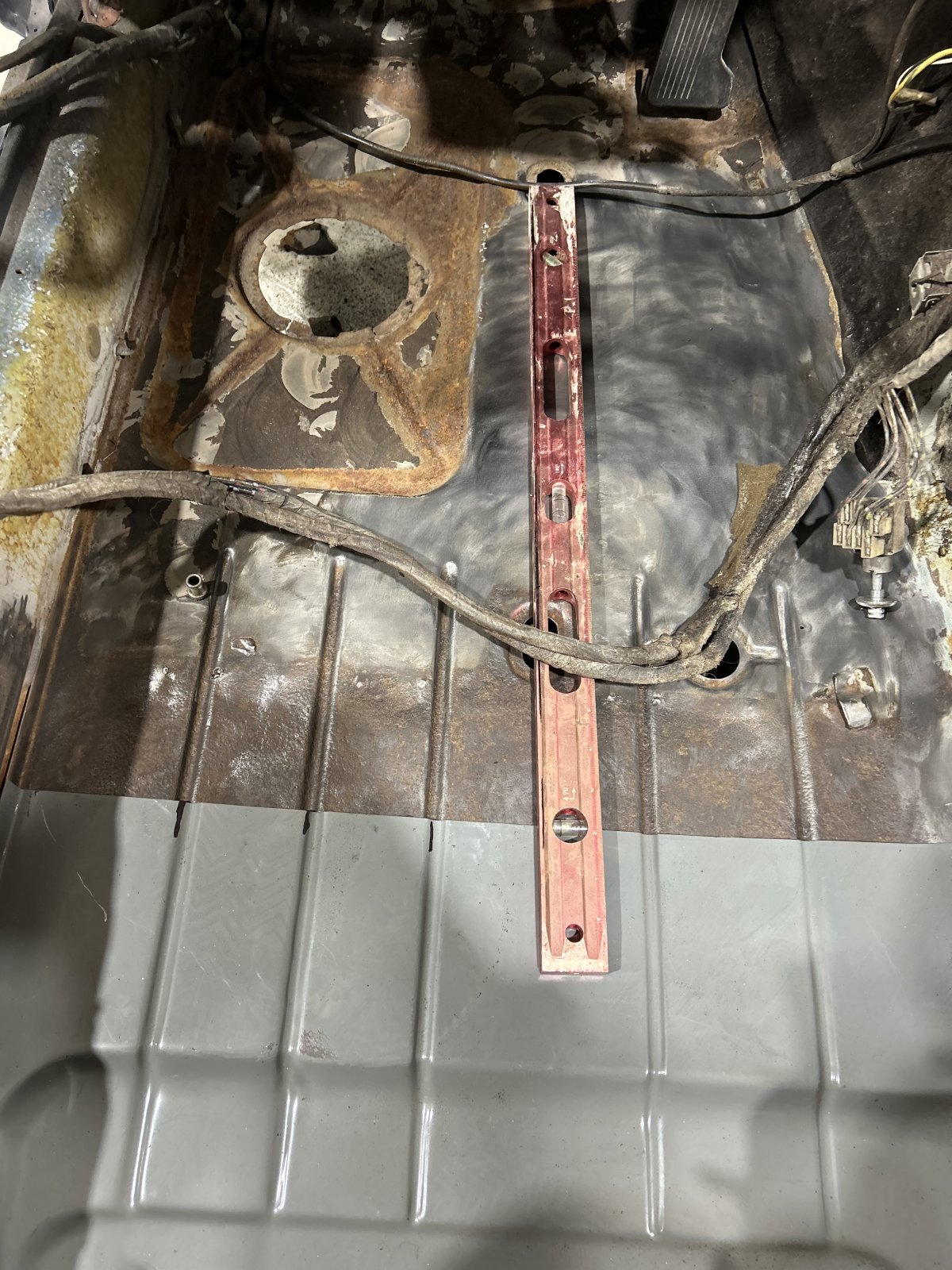

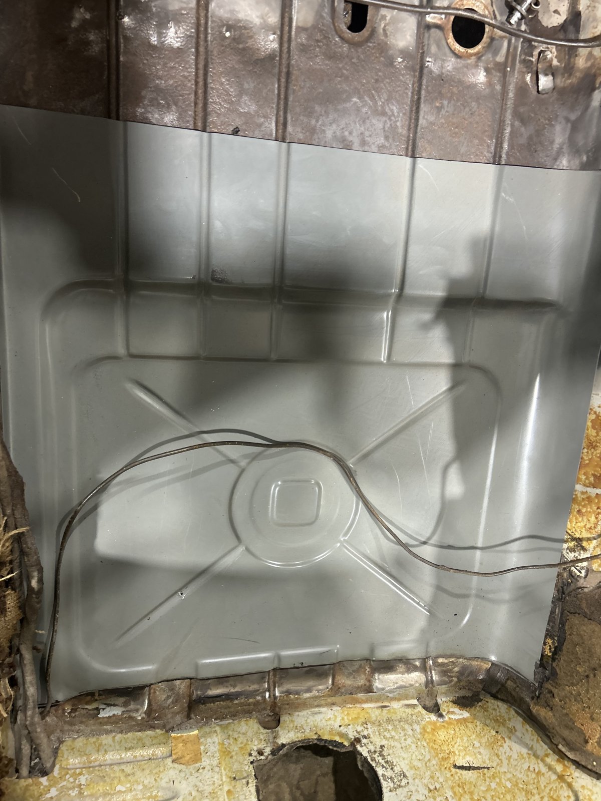

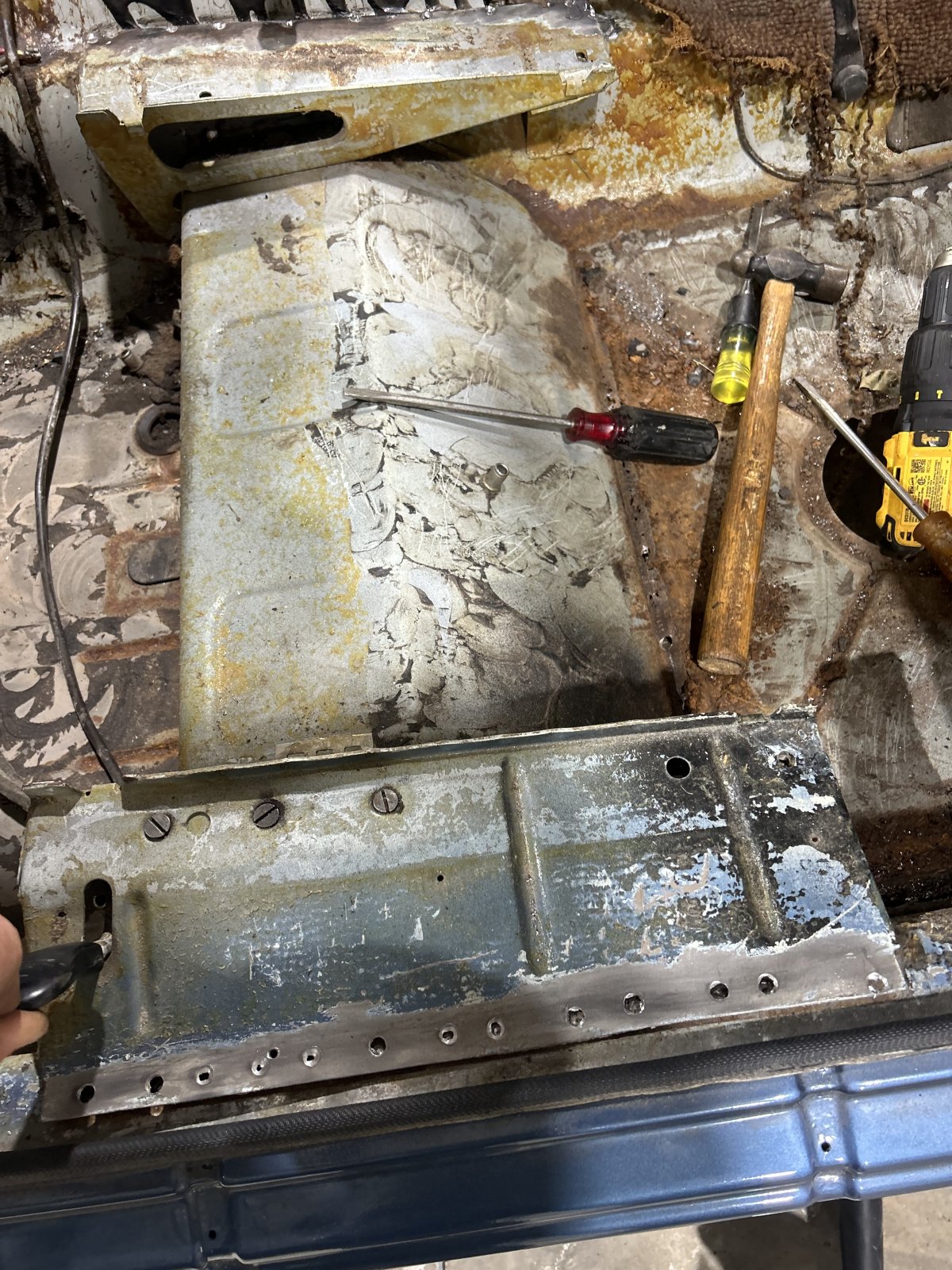

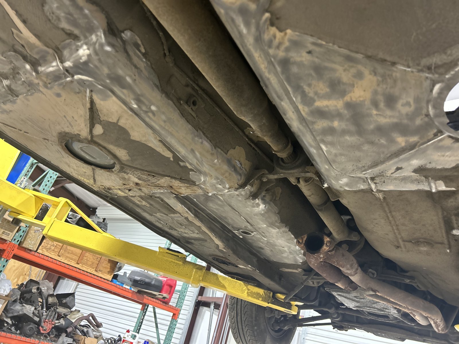

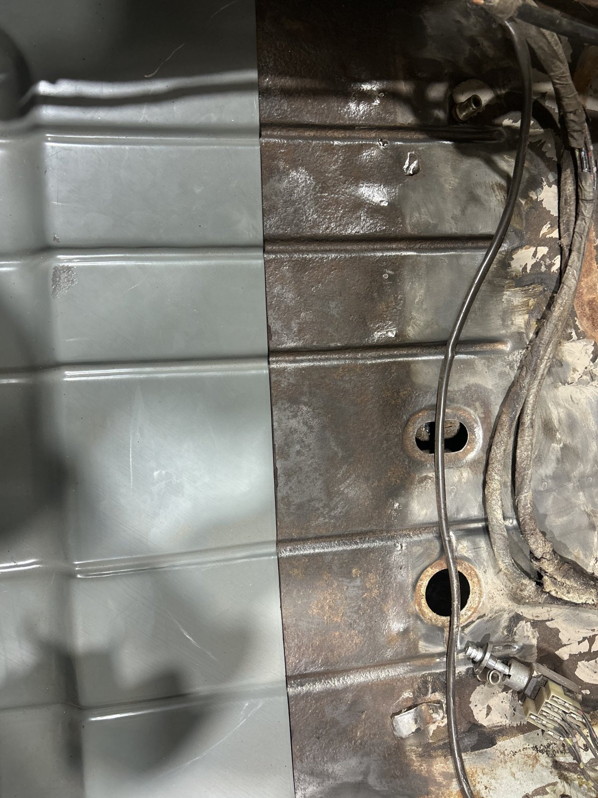

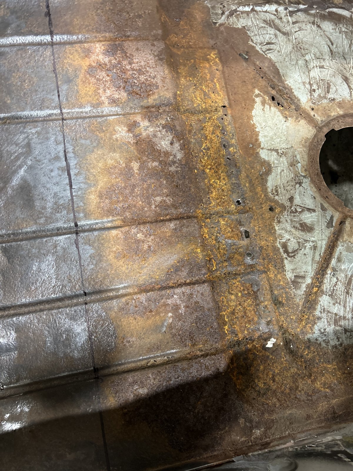

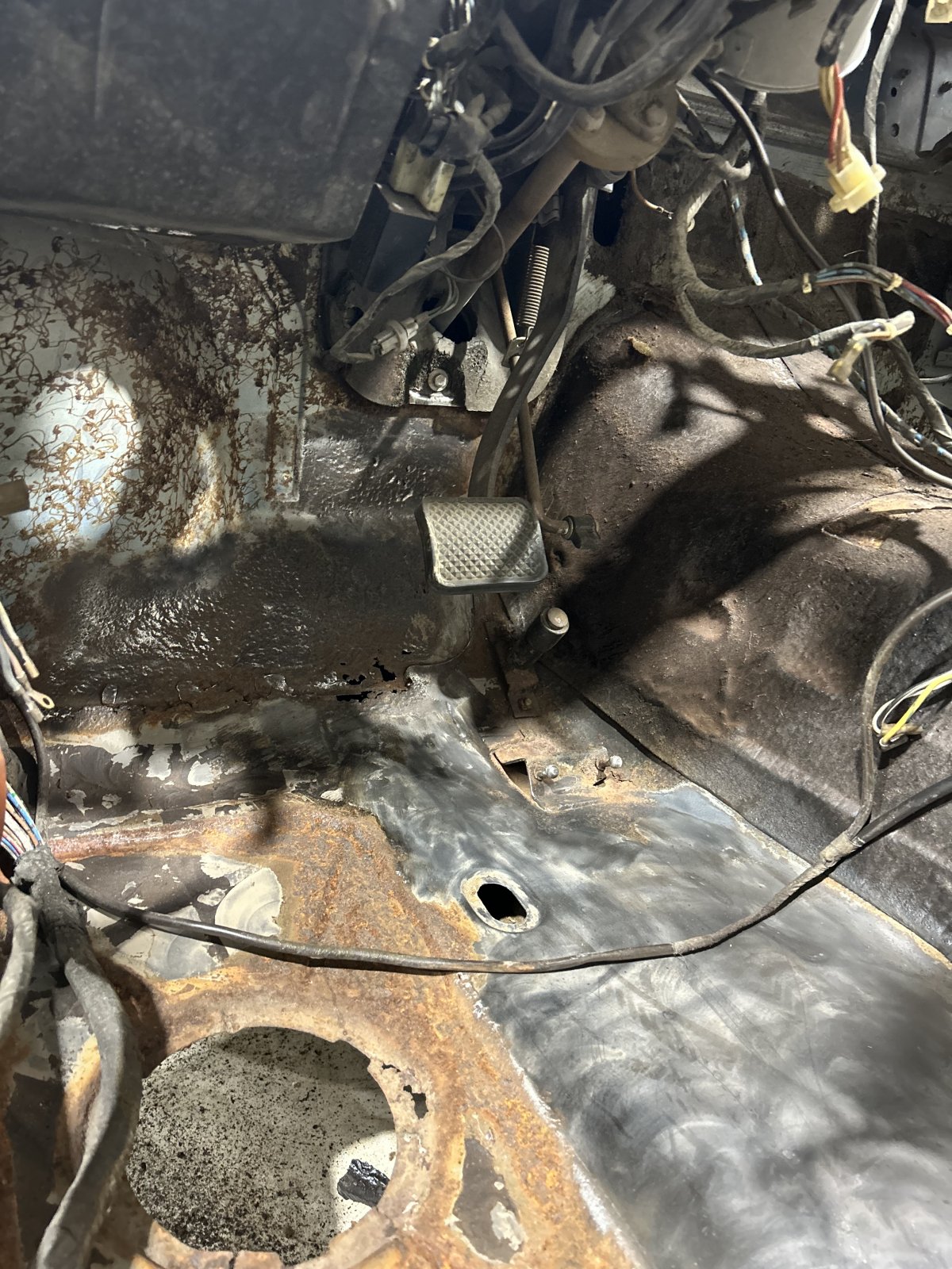

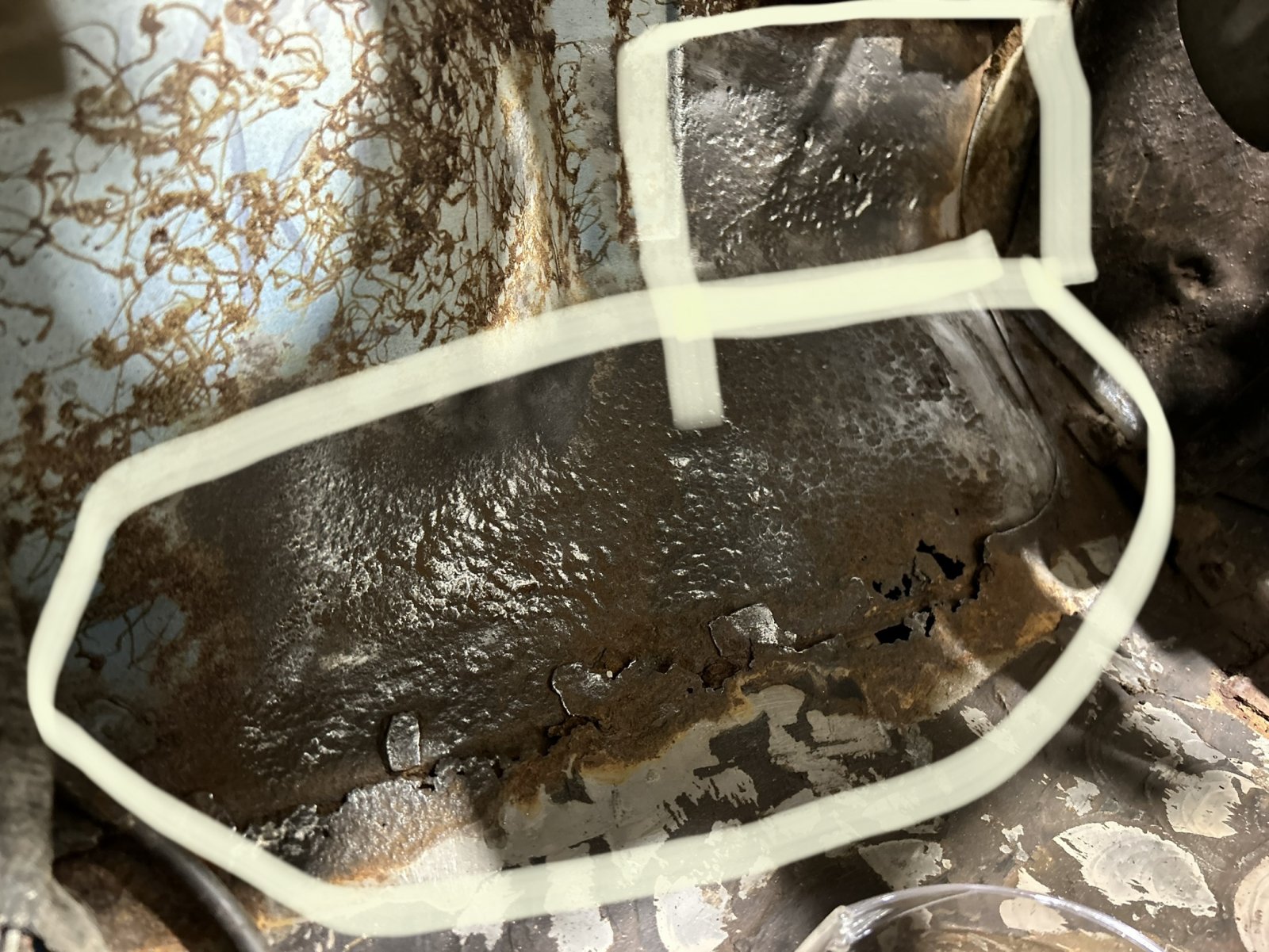

Updating this as more of a restoration/motivation thread. I’ve decided to take on more of this myself than originally planned. Mainly to keep costs down but I don’t want to suffer on the quality. I do not work nearly as fast as most of yall, so updates will come as soon as I have questions or make notable progress. The last week or so I’ve been getting ready to repair the drivers floor.
Removed the seat bracket.
Mocked up the rear pan.

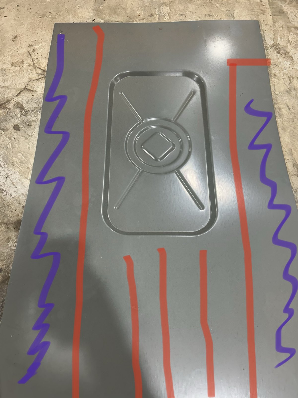

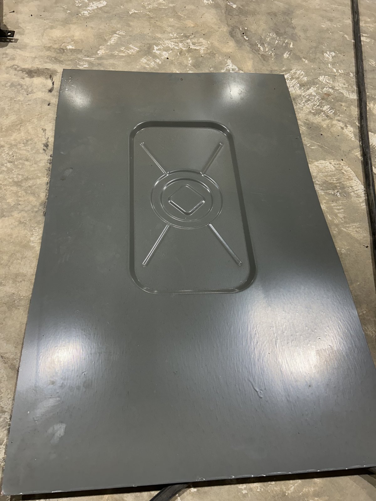

Coming up with a plan for the front pan. Walloths floor pan lack of quality is making things more difficult especially for a novice like me.

indeed the floor pans from Walloth are missing some details.
Here's some suggestion what i did to get them as accurate as I'd liked them to be:
I've used a bead roller for the beads, and shrinking dies to get the curve up front. The oval and rectangular openings can also be straight cut into the plate. Pressing in the depressions is for the die-hards ( as it needs a custom pressing die) .
I think the pressing die (tool) I made to press the rectangular depression, is still with a forum member in the US somewhere. I agreed to send it to him, if he would send it on to the next forum member in need - interested?
I think I might not need to cut out my original. But if I decide to replace, I will definitely take you up on that offer.

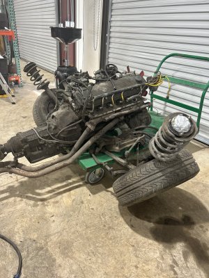

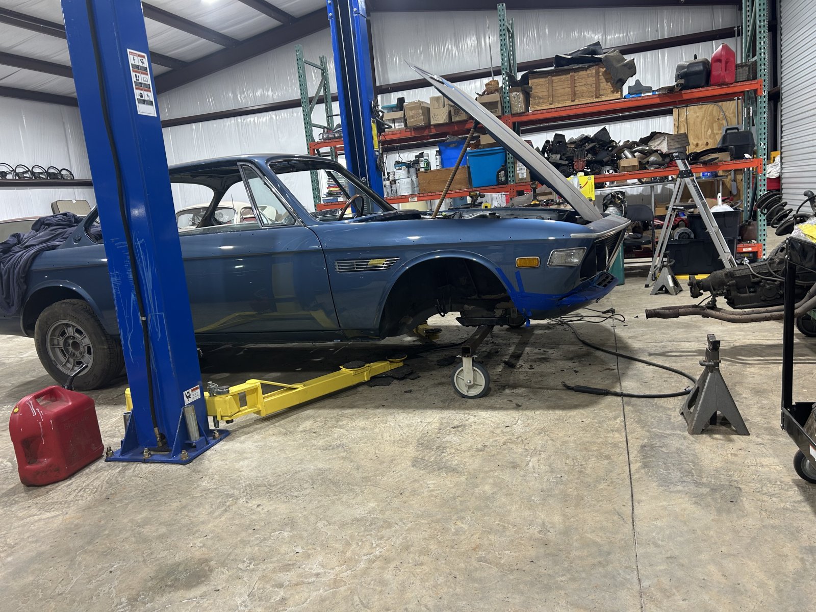

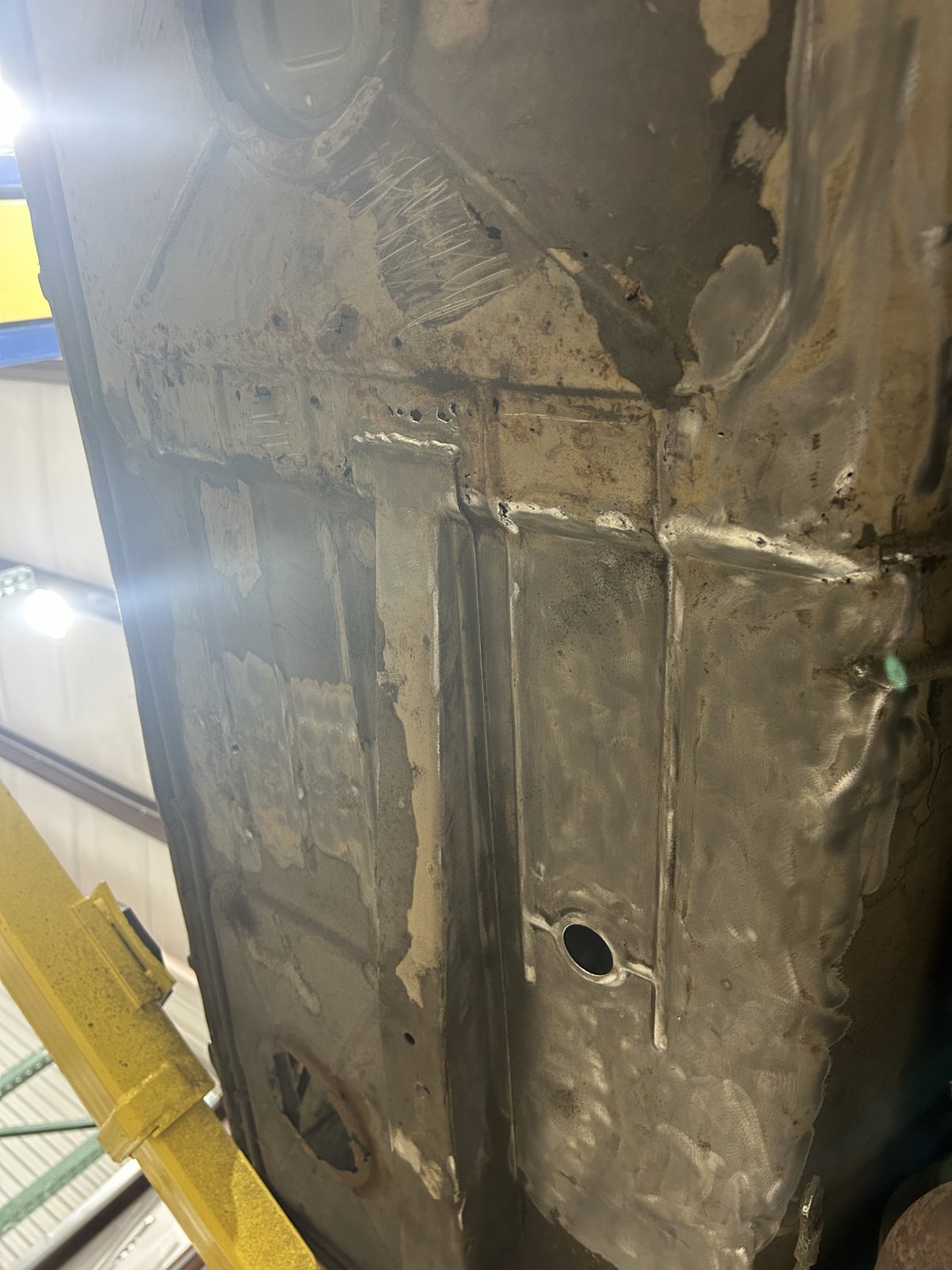

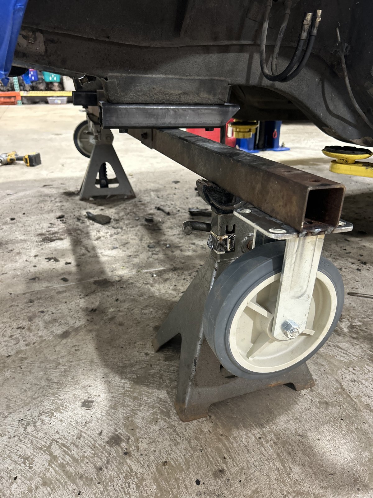

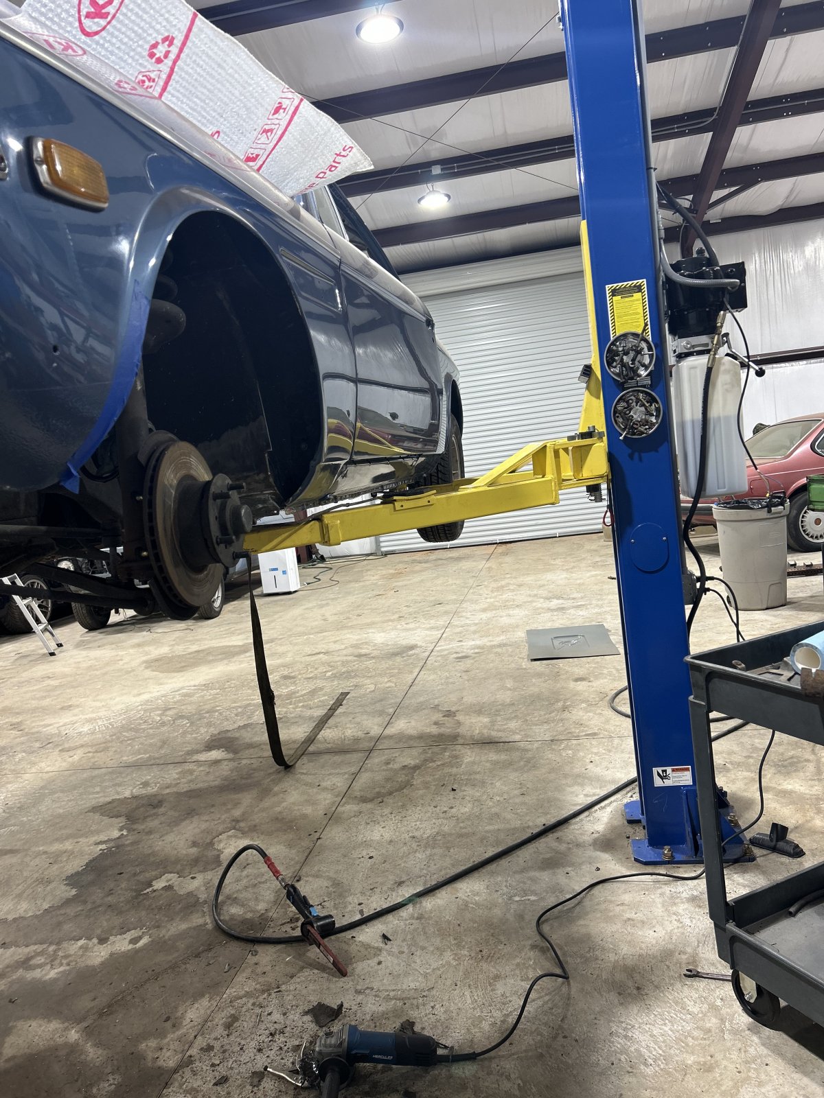

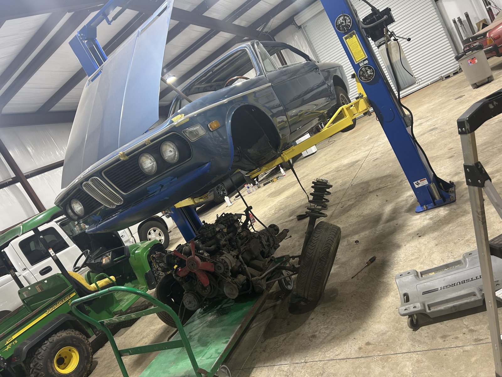

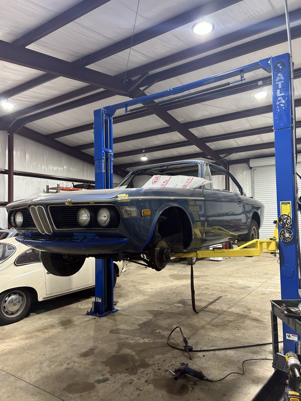

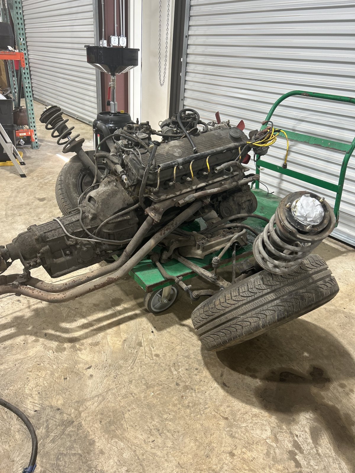

Small update. Dropped the entire front subframe with the engine and transmission.

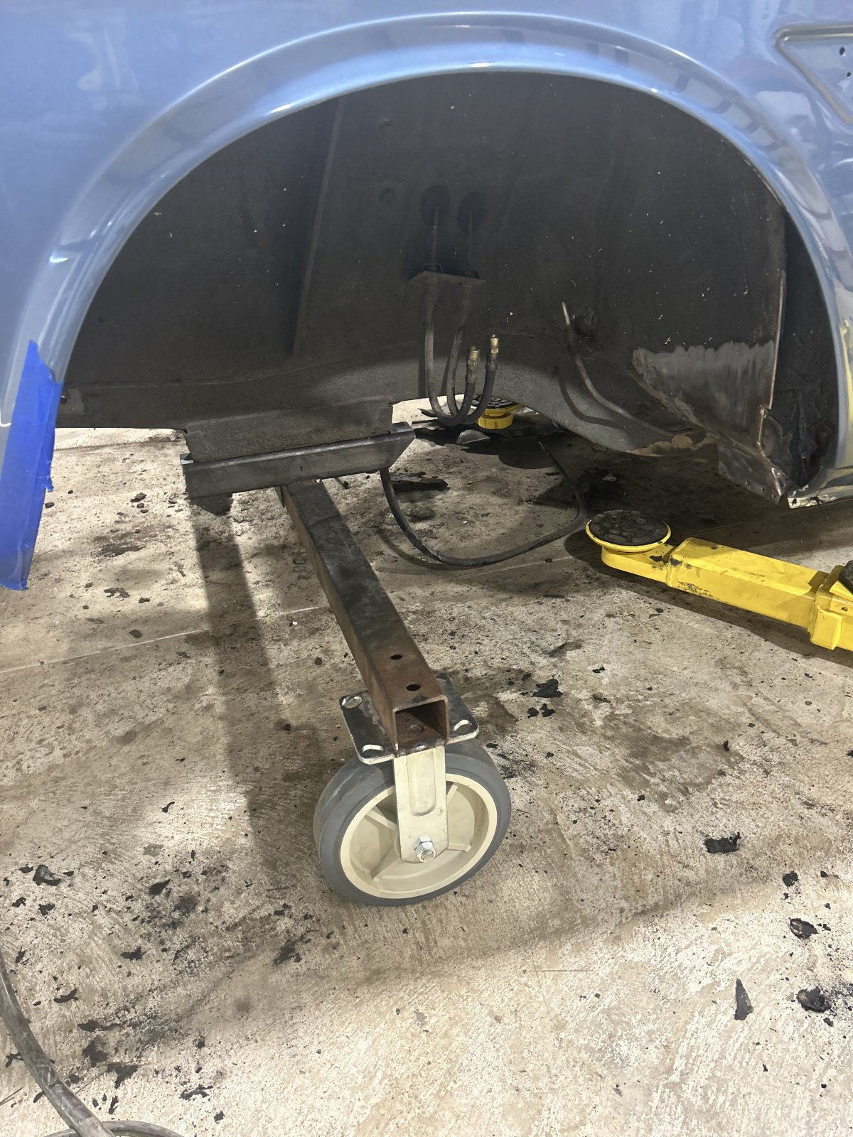

Made the front part of the chassis cart/dolly.

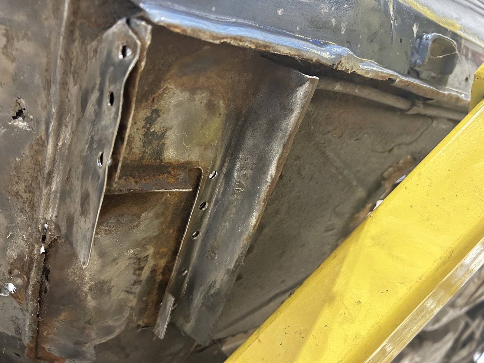

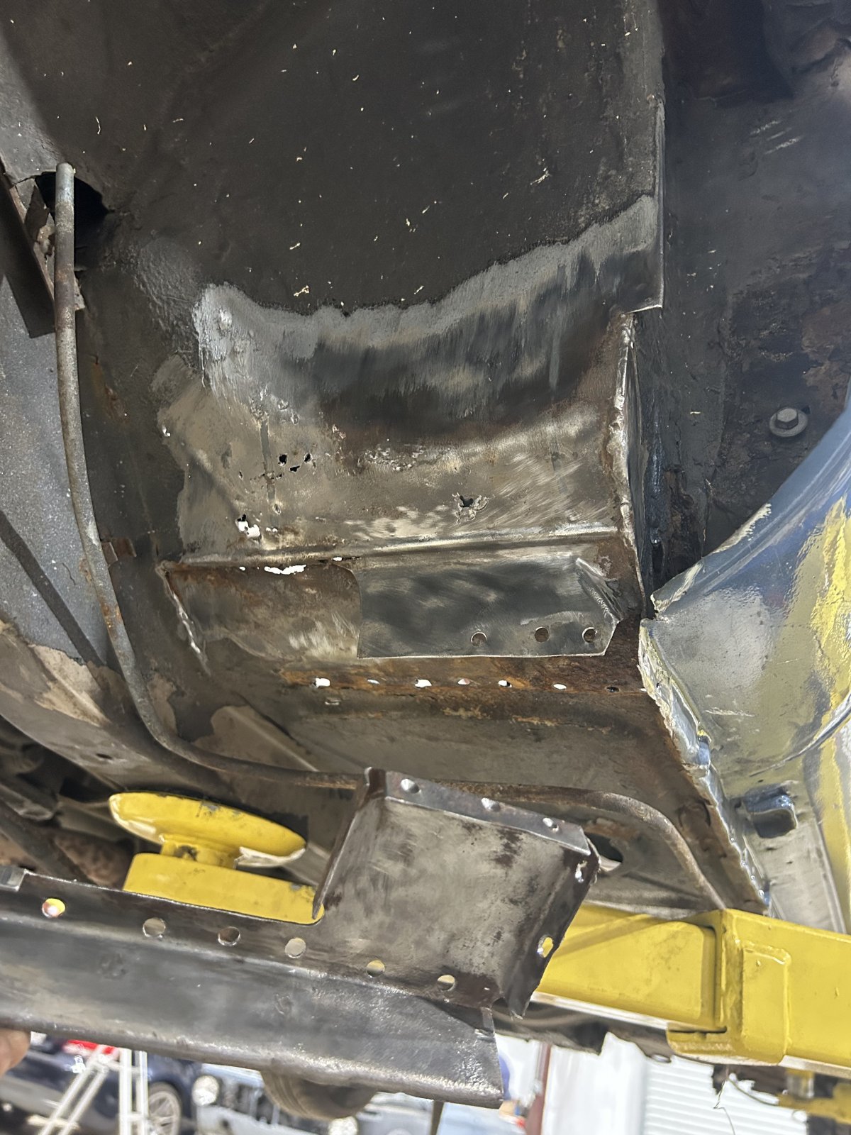

Found some more rust that appears to be partially repaired around the left rear subframe mount. but more exploring is required once rear end is dropped.
