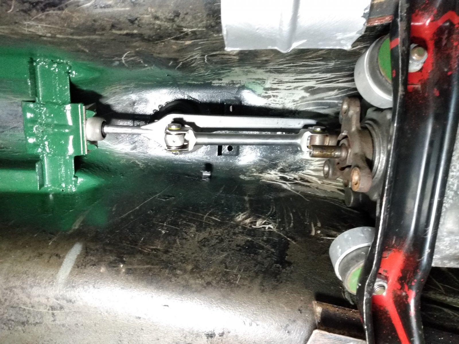

Chris thanks for the reminder on the throttle stop. I tore the car completely apart in a frenzy (I never learn) and am trying not to make more work during re-assembly than it already is. It's a slow project so hopefully slow and steady...
Maybe this weekend I'll get to install the rebuilt axles and then take a closer look at the linkage.

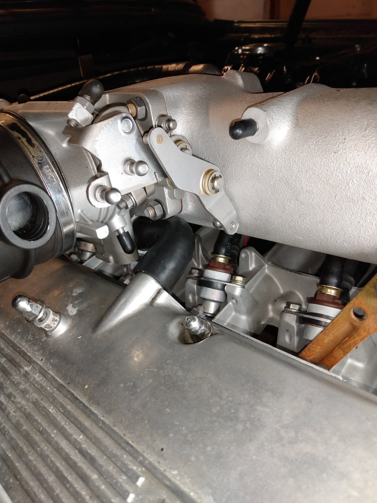

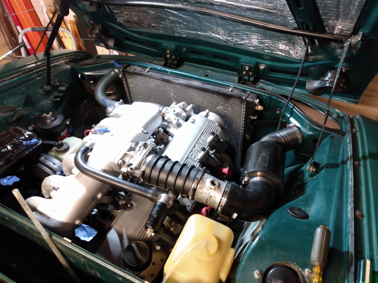

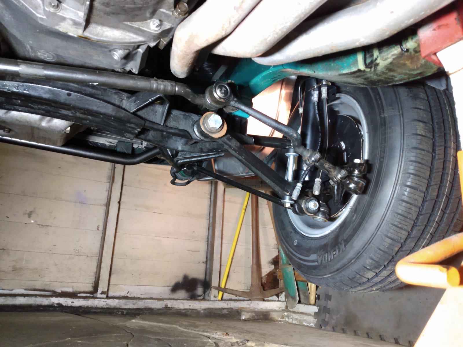

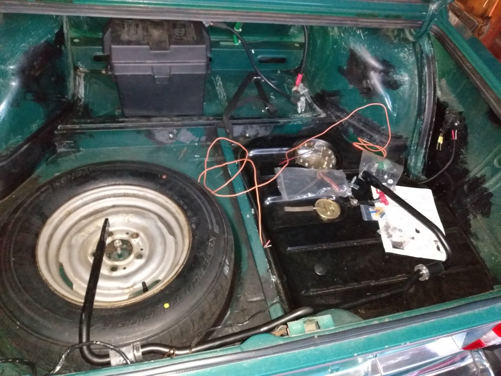

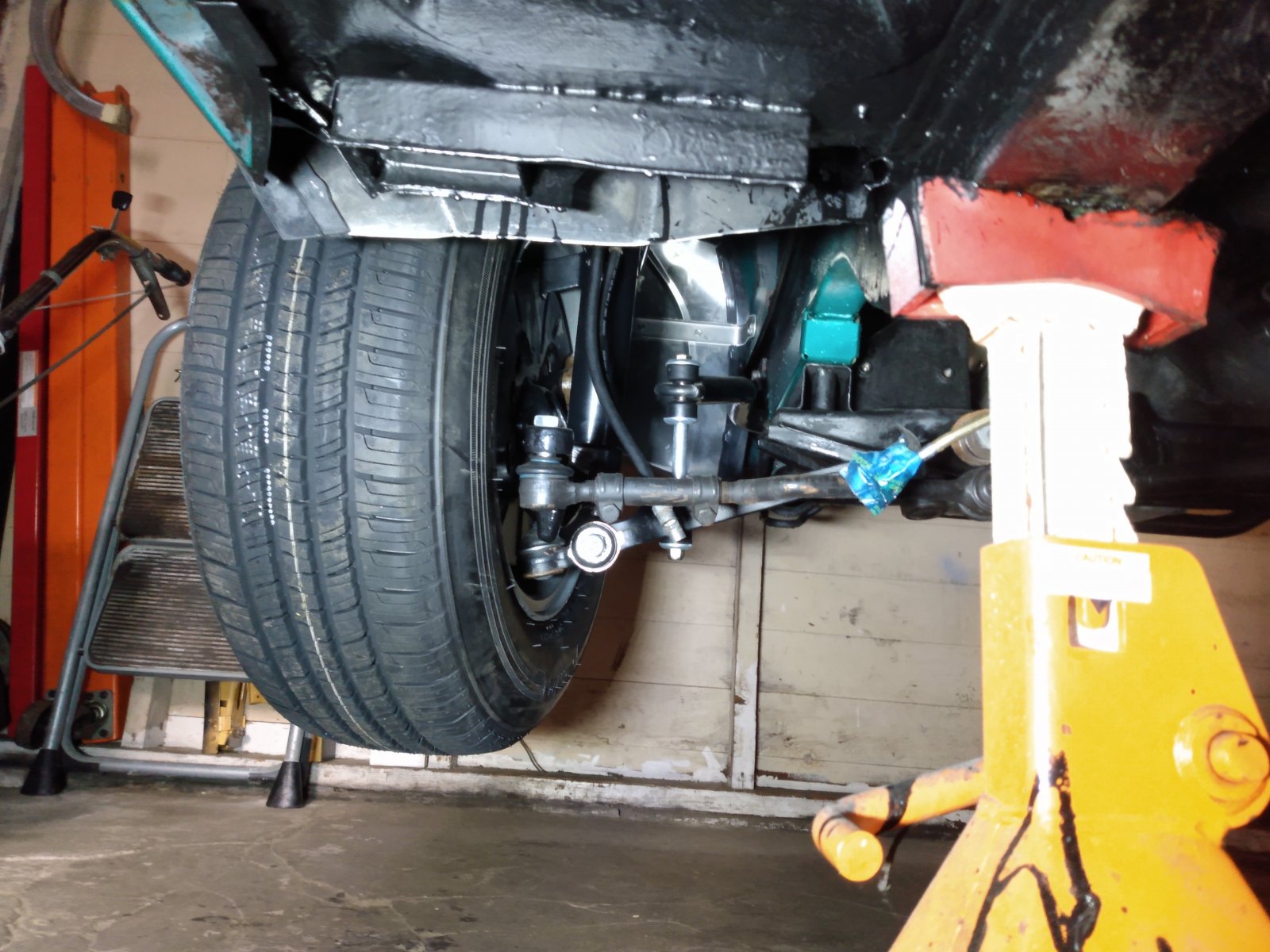

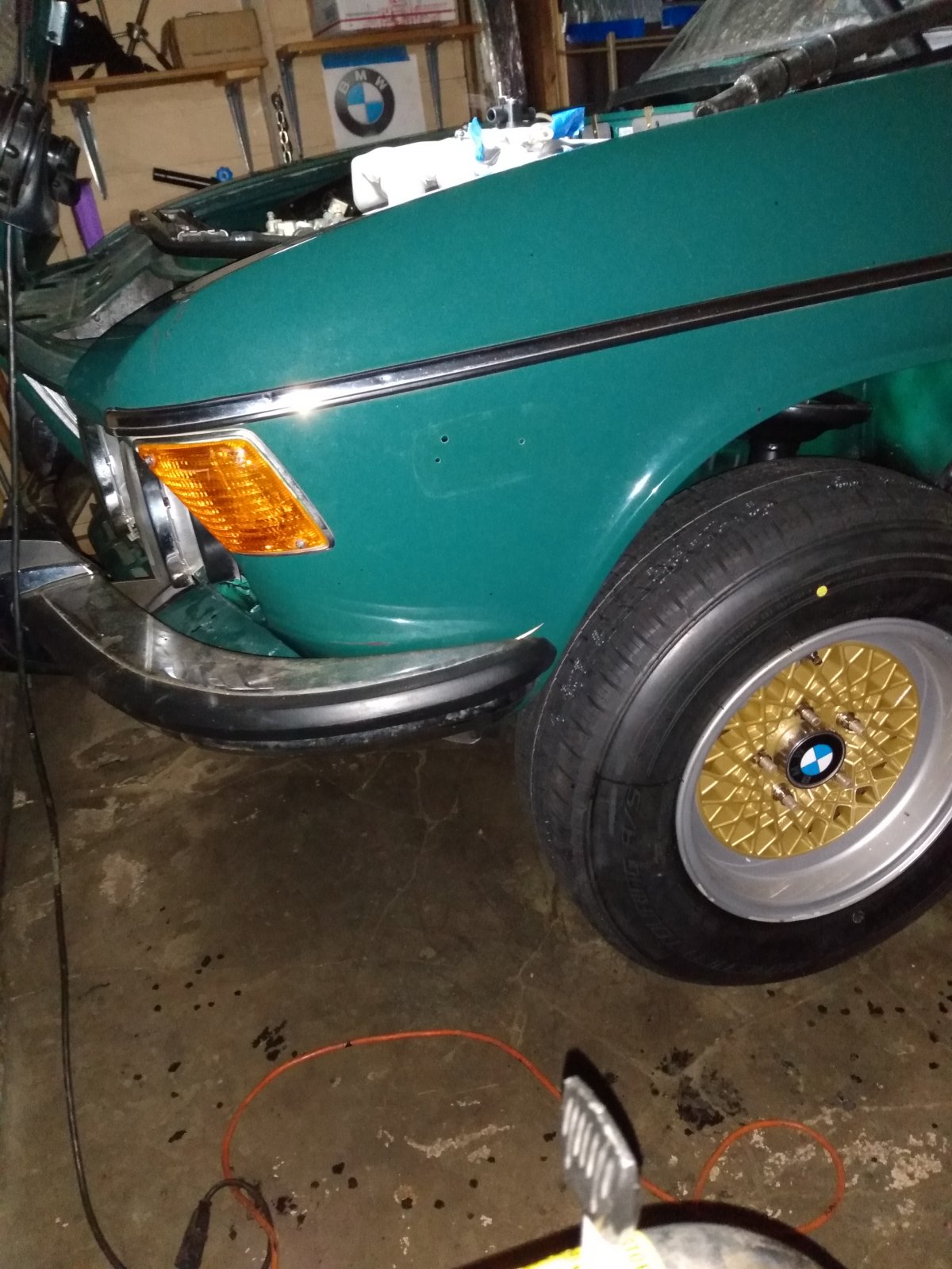

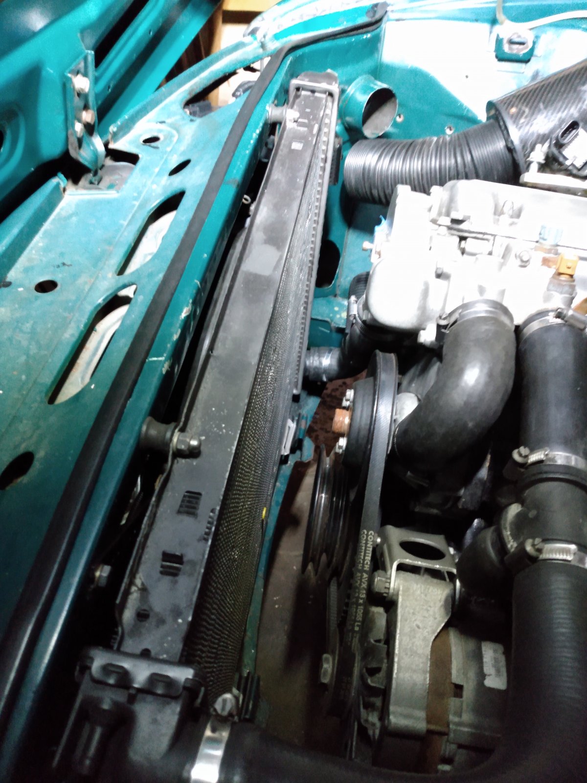

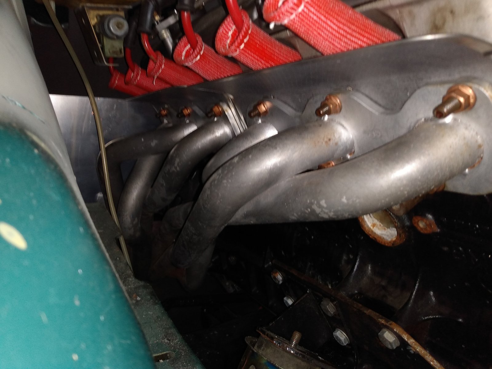

I'm making slow progress but it's better than no progress. I've decided to have my steering box and PS pump serviced by Jay Stratton and am working on solving the custom driveshaft issue. I may also be going into the heater box but I'm not sure how involved I want to get. Beyond that it's been re-assembly and figuring out how to make non-stock things work including battery in the trunk, Megasquirt with Djet intake and so on.

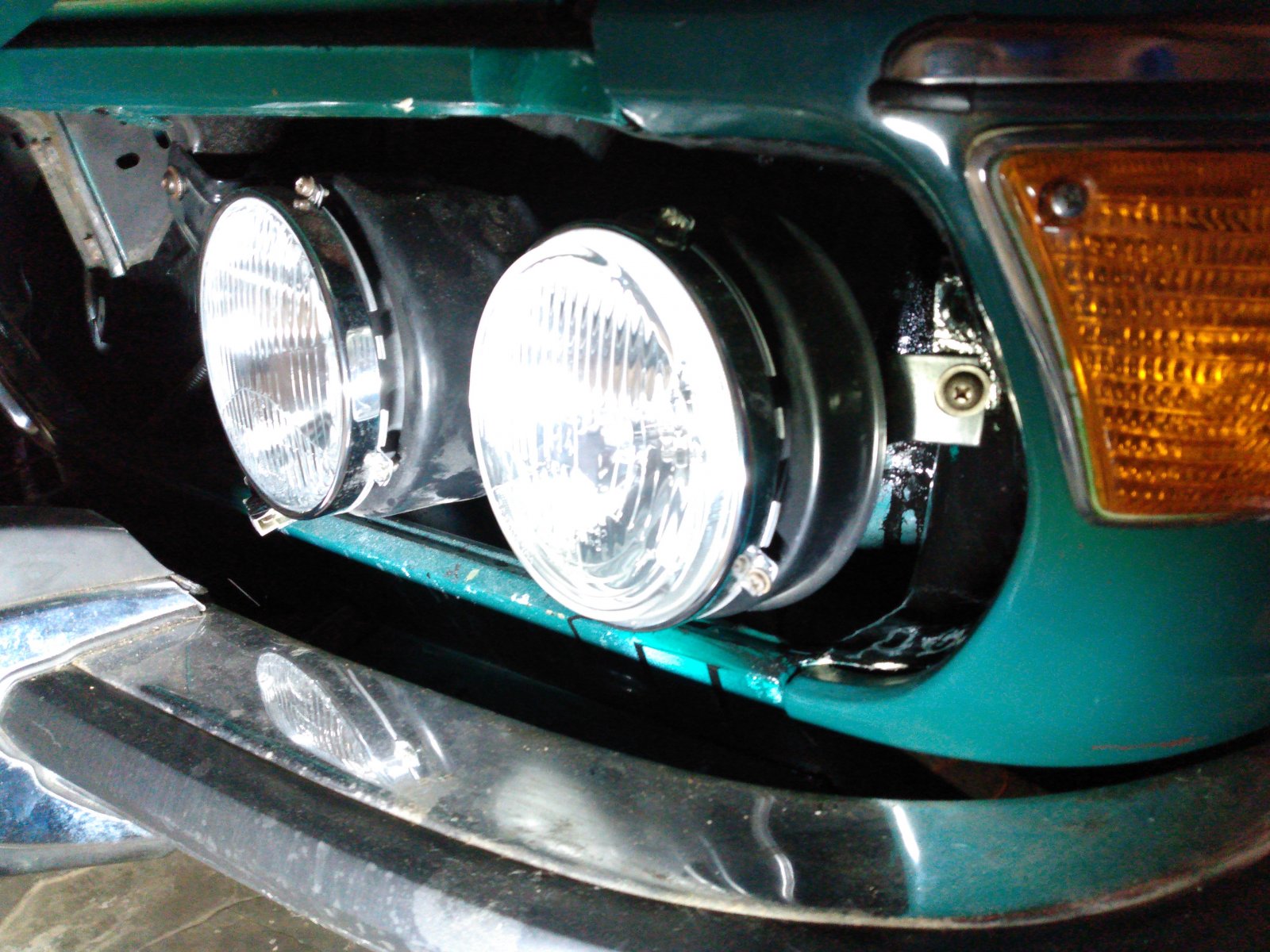

I decided to use the smaller Euro turn signals and delete the front side reflectors. Went with E code H4/H1 lights. I'm using an E28 radiator. I'm not too happy with the IE rebuilt brake booster in that the paint is failing and surface rust is coming through. It looks like they didn't do a good prep job but it is holding vacuum so I'm not in a hurry to do anything with it. Here are some pics.

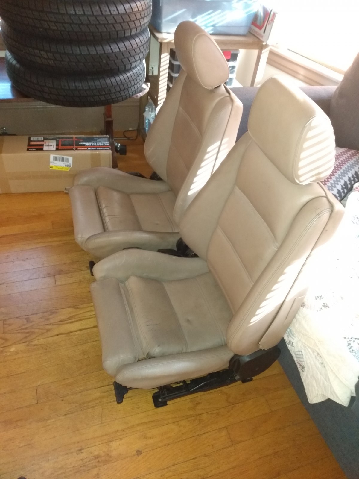

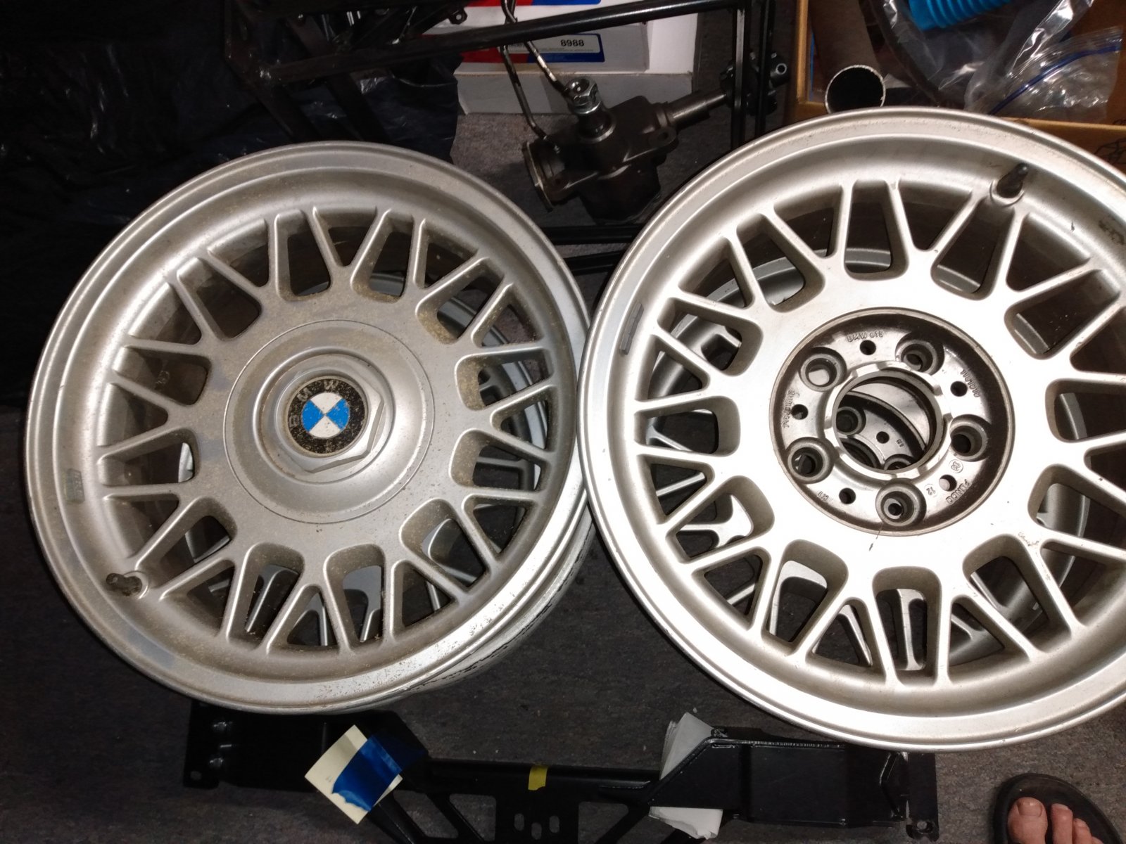

2 more options down the road. I have some 16 x 7.5" style 8s if I want a more performance oriented tire at a reasonable price. I also have these E30 seats I refurbished and could dye to match the interior if I'm so inclined. Talk about mission creep. I'm a master

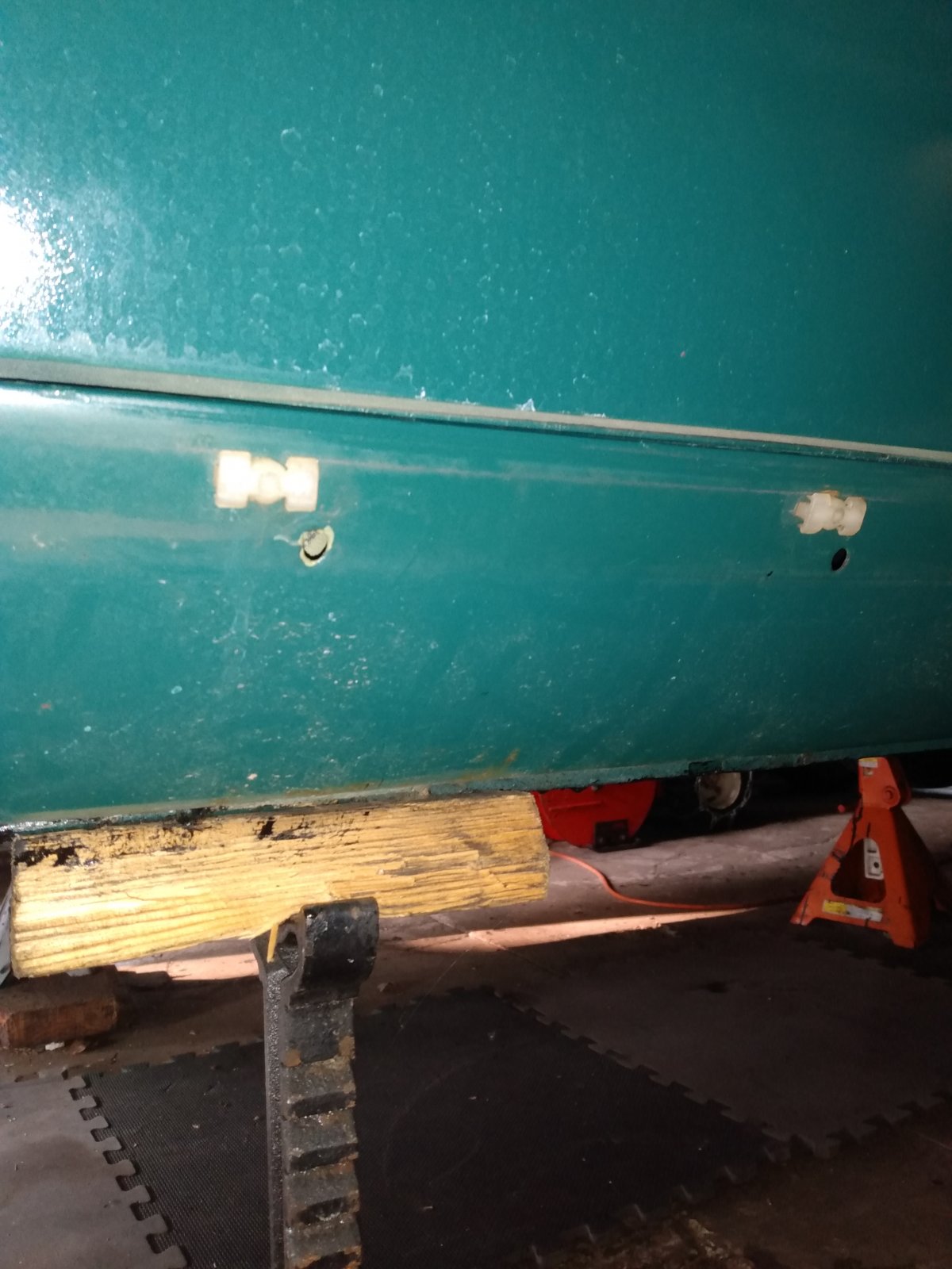

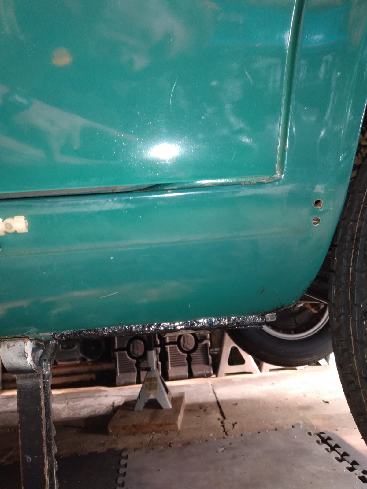

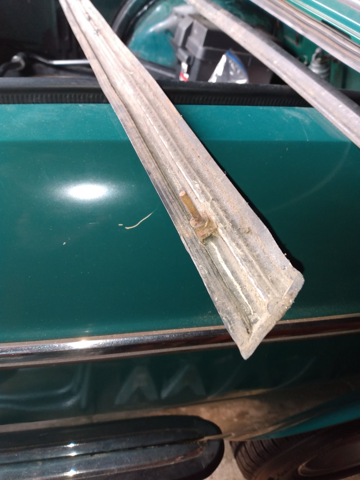

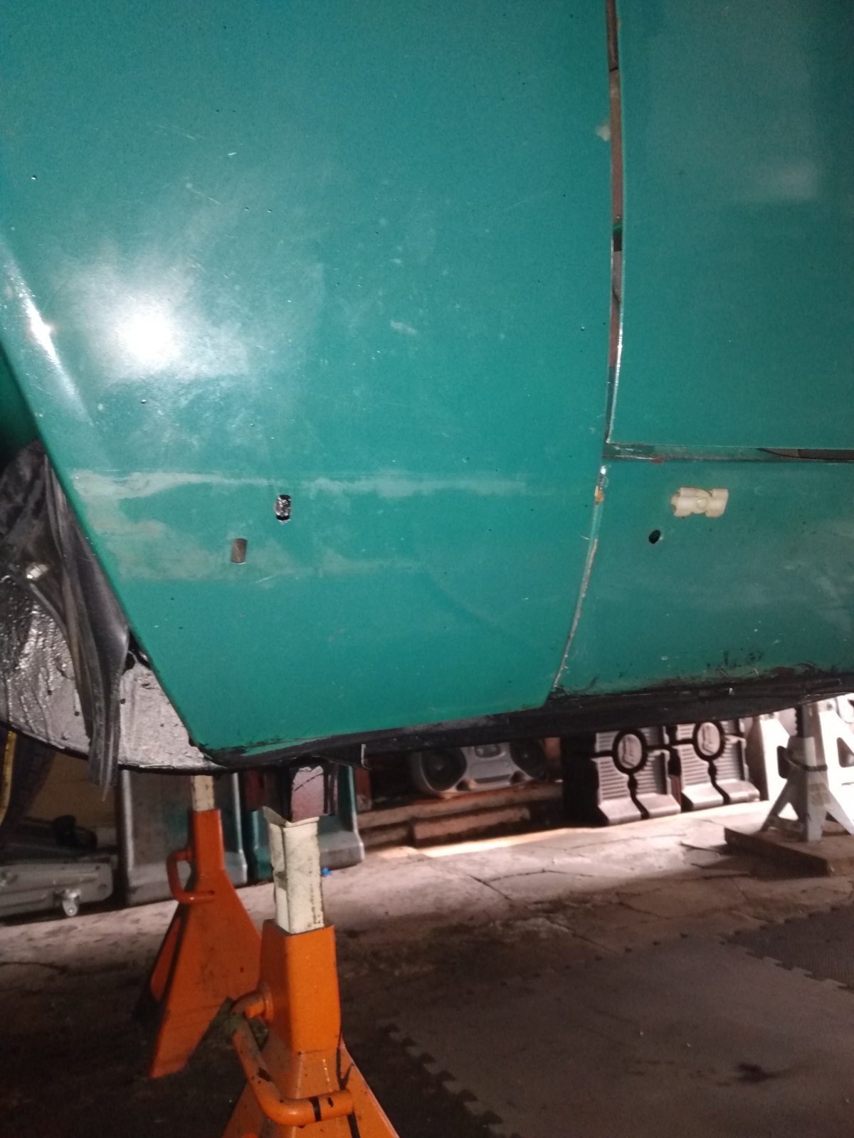

A more pressing issue is that I removed the rocker panel trim strips years ago and was somehow able to do it with the plastic retaining clips remaining intact on the car. Now I want to reinstall the trim and see that in addition to the holes for the plastic clips there are similarly sized holes a bit lower and offset from the clip holes. Do all E3s have the lower holes and what was their purpose? Here are some pics to illustrate.
The lower holes are intended for the wider trim style i think. Like the ones on my -69 2800 or on 3.0S/SI
Thanks for the info. Is it considered OK to just leave the unused holes open or should they be plugged somehow? I wonder what BMW recommended. FWIW my rockers received a heavy coating of Ziebart rust prevention tar many years ago.
I would probably just let the holes be. If there is no rust/bare metal around them I se no reason to do anything.
My 2800 has the lower row of holes only. I know replacement rockers have double set of holes.
Have the rocker panels been replaced on yours?
The rockers appear to be original and I think I will follow your suggestion of leaving them alone. It seems that being open all these years has not caused any harm as they are not rusted.

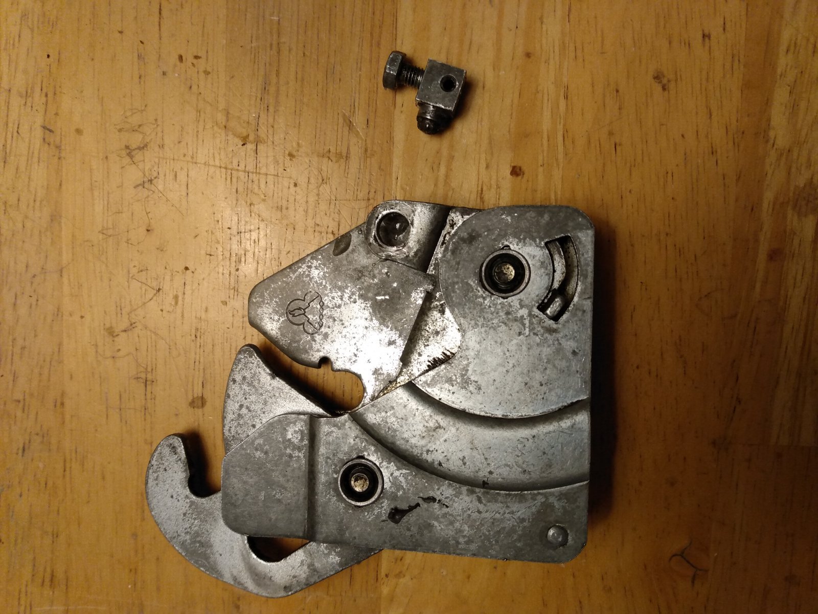

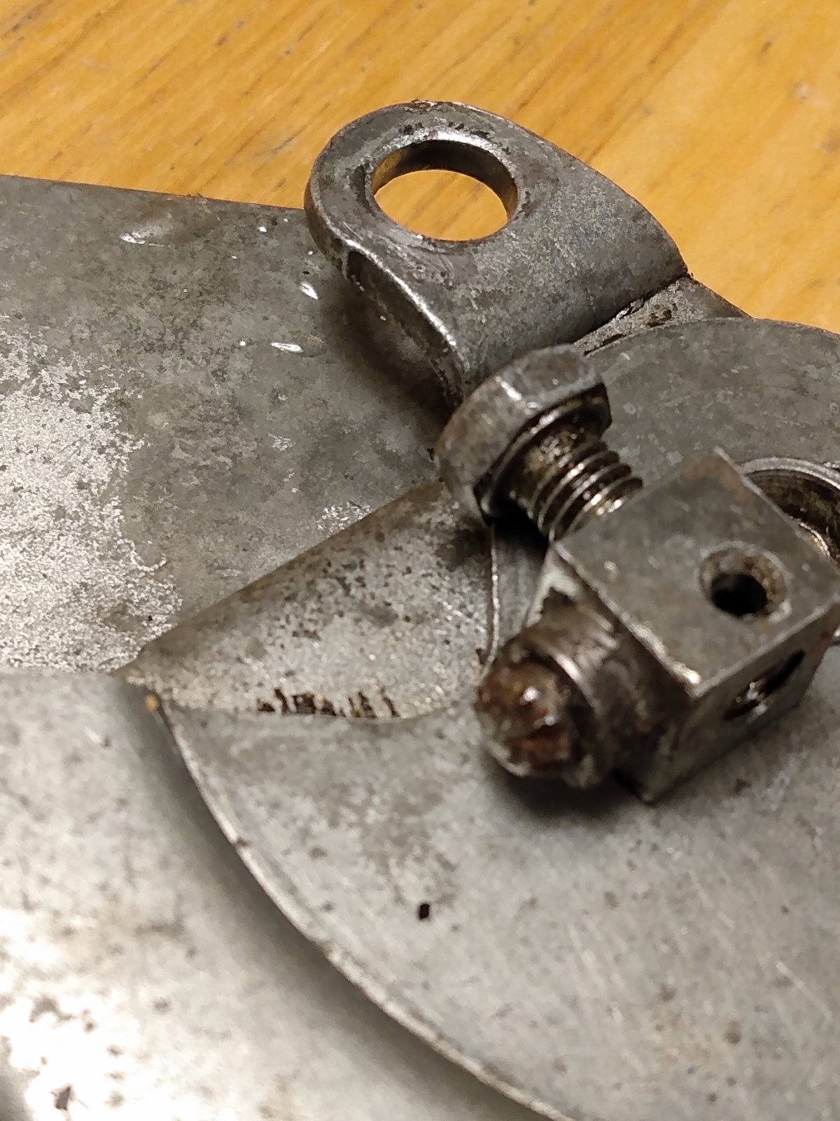

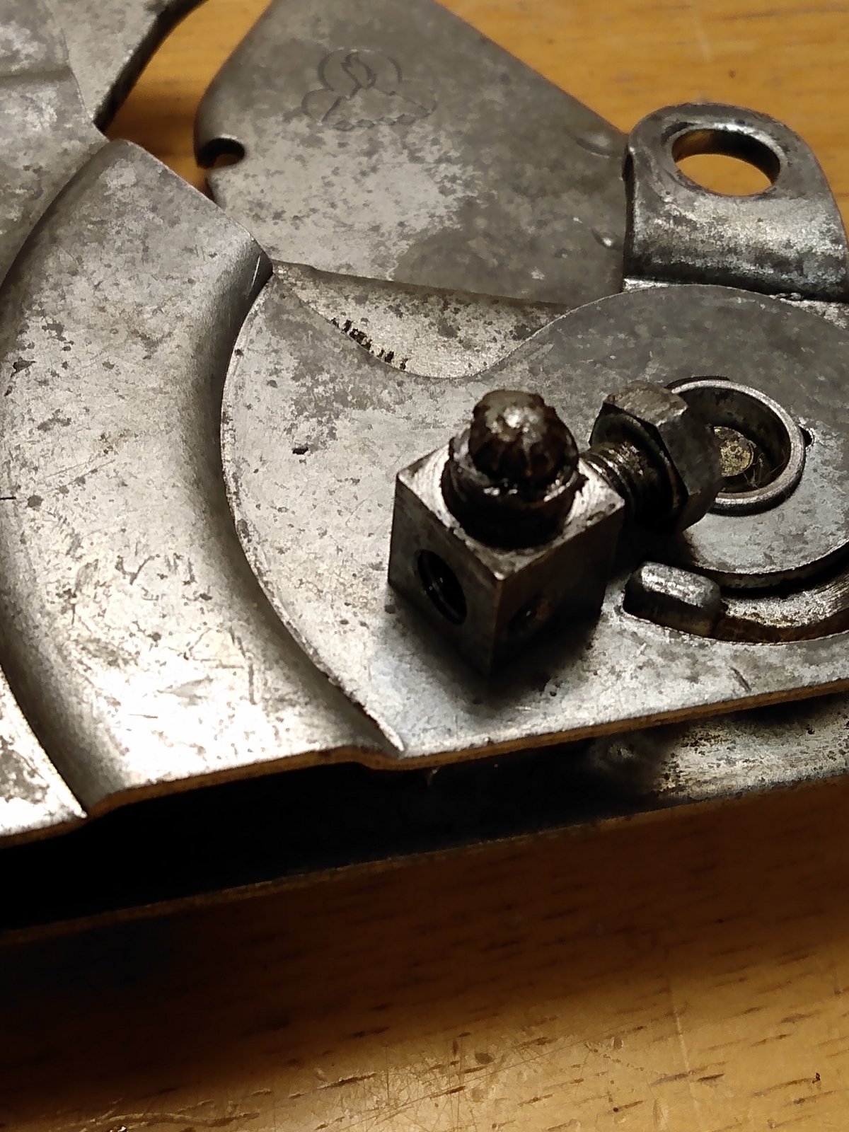

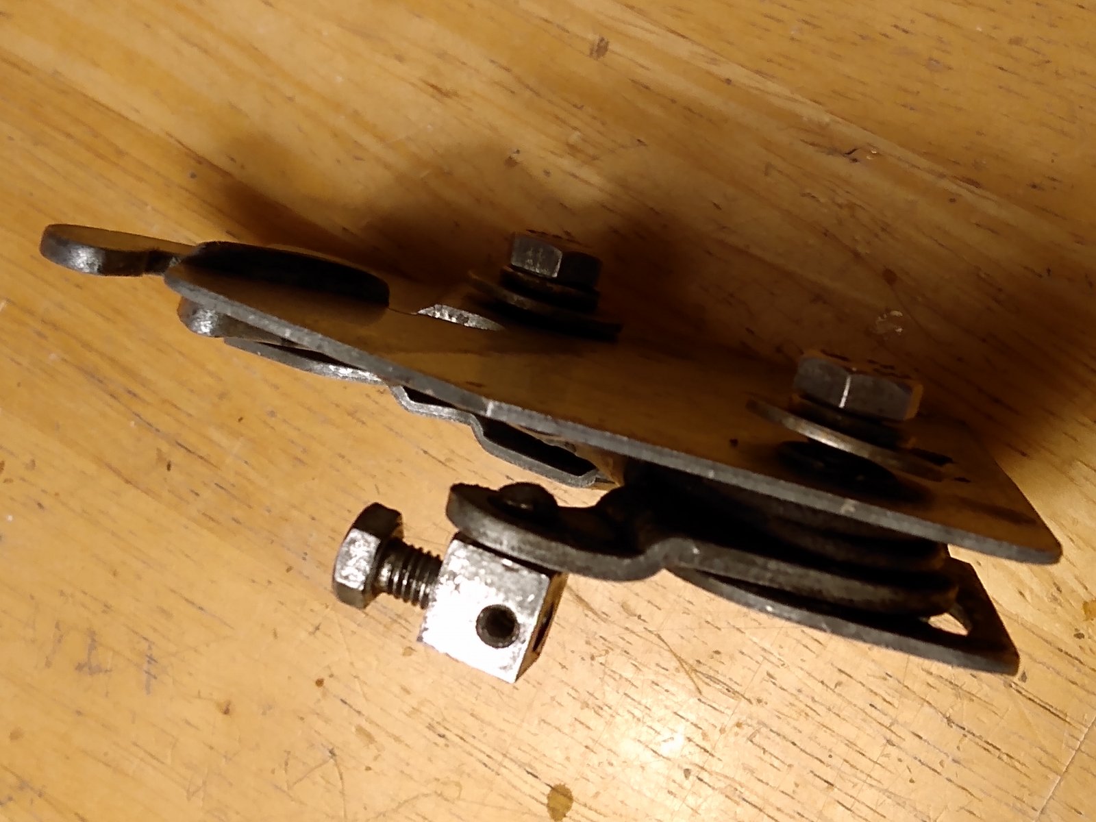

I'm hoping for some suggestions on dealing with a broken hood latch. The part that secures the cable broke off and I'm not sure what repair options I might have. Worse case scenario I look for another one but if there is a feasible repair option I'd prefer that. Here's the issue.
Couple thoughts..Looks like it's a rivet type fit with a mushroomed end to hold it in place so it can still swivel...can you use a punch to flare the head again to hold from falling through? Second, maybe a small drill and tap for a tiny machine screw/washer to hold it in place? Mine are boxed up with all my parts, so I can't look at them in person..
Stephen thanks for the suggestions but I don't see how I can get a punch at it because that side is obscured by other parts of the assembly. There is also very little metal in that spot to work with so I'm not yet sure how to attack it.
Oh, I guess I was thinking it would have to be disassembled to access the backside area? It's hard for me to tell in pics..I hope you can figure something out.
I'll try to dig mine out and see what it looks like. Maybe you can send it to me and I'd be happy to find a solution. Sound fun...:-)
Stephen thanks for your reply. Mine is now in the hands of a talented friend who said he might machine a new piece that will attach with a clip of some sort. He is busy with real work though so it may take a while to see what he comes up with.
Sounds good...yeah, I enjoy machining new parts here and there for my projects...I'm trying to get ready for prime/paint...then I can do the mechanical stuff that I actually enjoy..:-)
