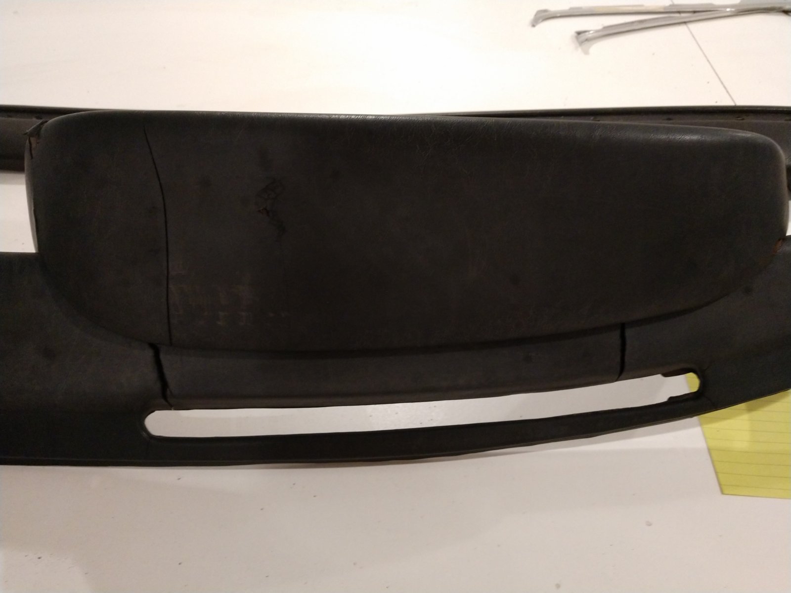

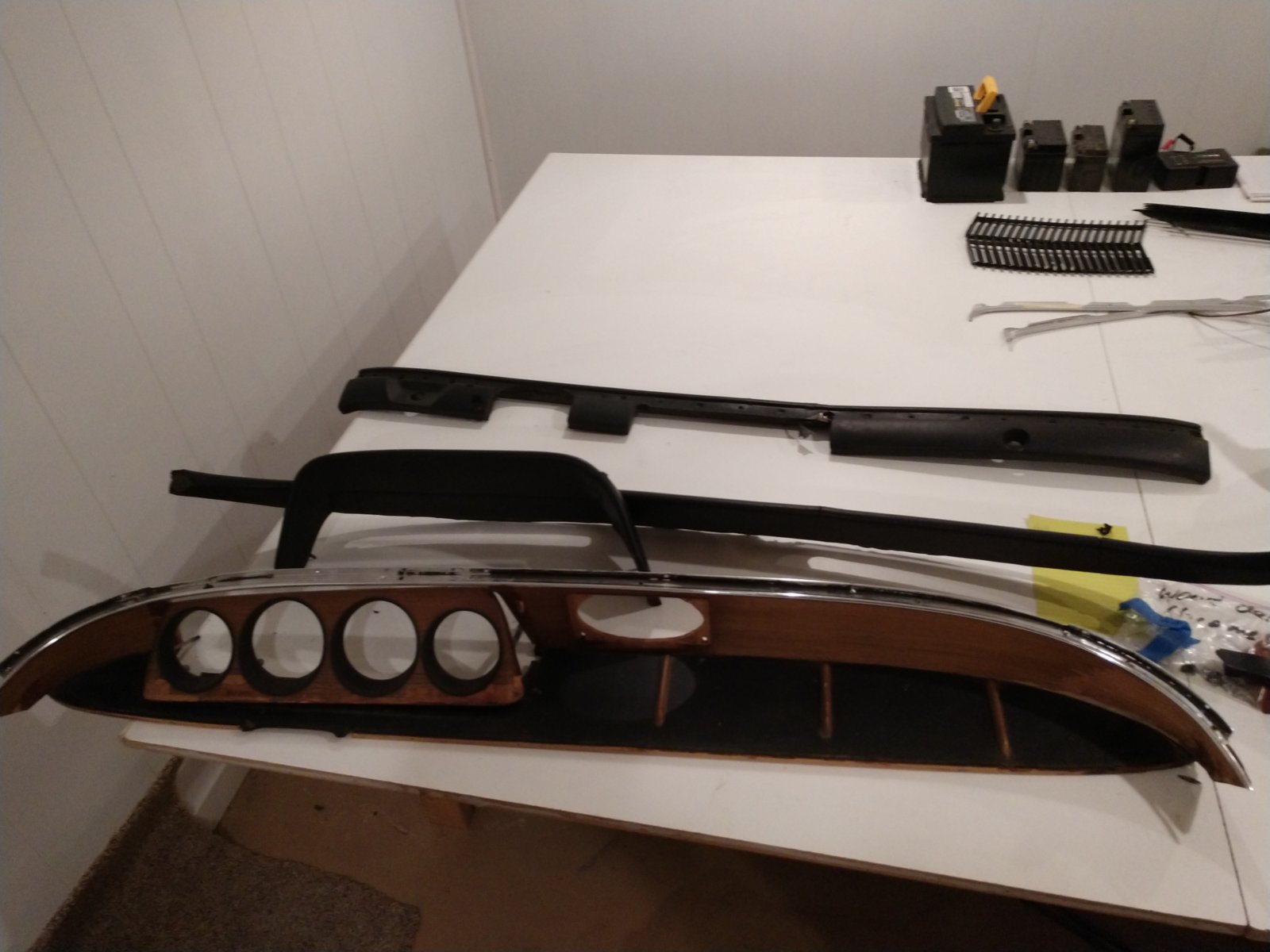

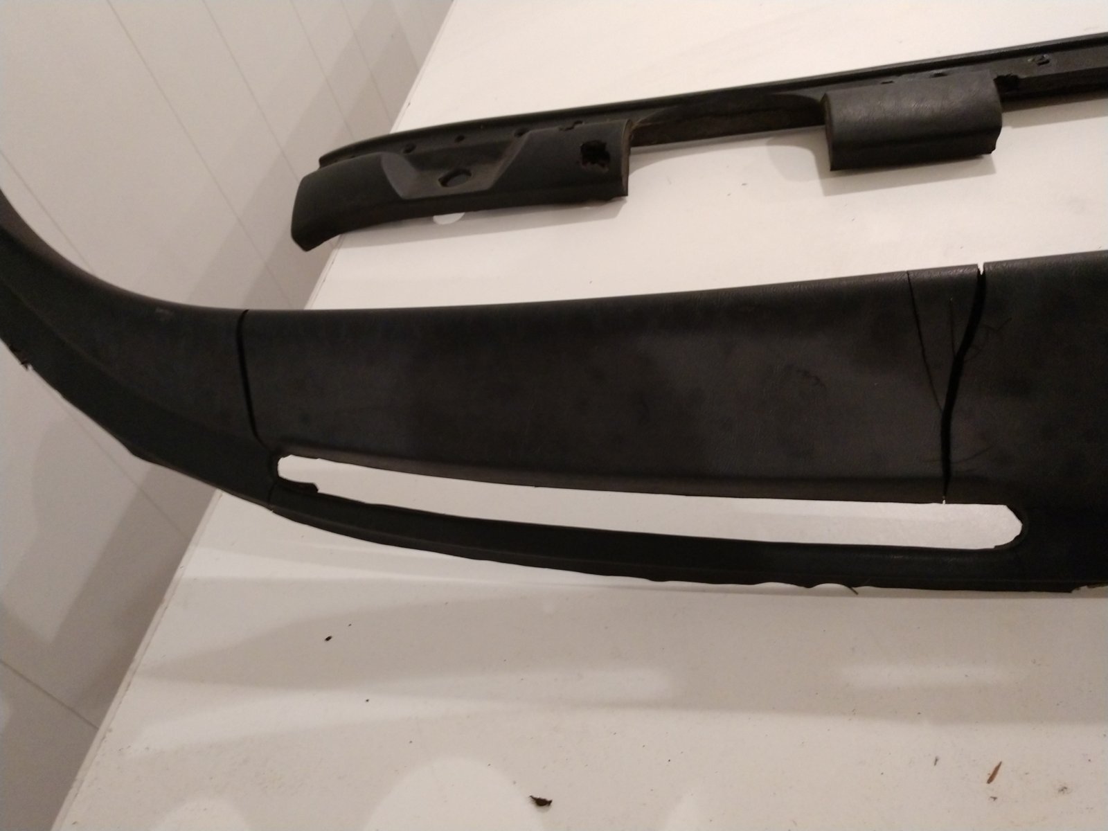

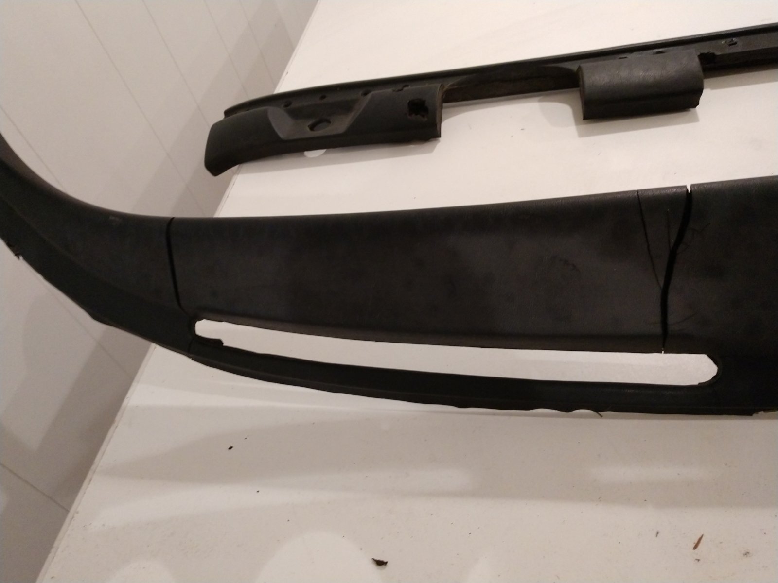

Almost ready to wrap the dash in New vinyl! Need to buy a heat gun first.
Dash top vinyl turned out ok too! I started with the top then slowly wrapped my way underneath, the bottom corners are stretched and look a little rough but it's mostly hidden by wood. A little patience goes a long way here, and dry fitting before glue to know where the tough spots are helps. Don't be scared, try it yourself!

Thanks! These are legitimate concerns of mine as well. I did not remove material to compensate. The two pieces bolted together without a problem, but I have not fitted it in the car yet. The overall width is not changed because the outside edges do not get covered (even the original vinyl does not wrap). So, I don't believe the growth happens in critical areas, but is a hope at this stage of build. I went with a thinner vinyl and would recommend it.

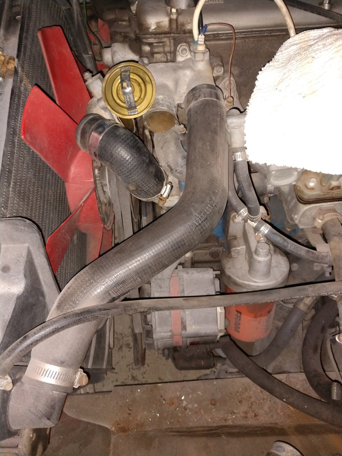

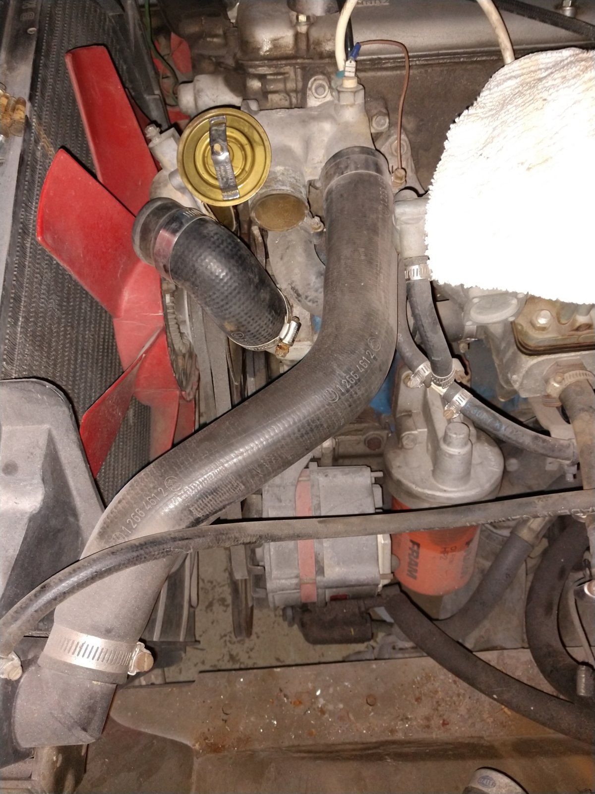

Of course the motor didn't work, replacement Bosch was pretty easy. I used a roll of metal ductwork tape to suspend the fan while tapping the motor shaft.
Heater core was rebuilt. Ordered all new hoses, thermostat ect from tii. Not sure I'd recommend them if your expecting good service.
