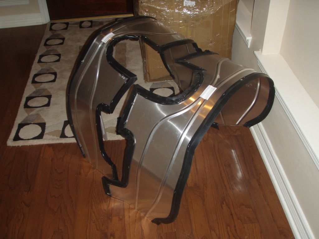

Installed mine!
They came in the USPS via DHL with no issues!
I think my wife didn't complain about them staying in the entry for a couple of days because they looked like art :lol:

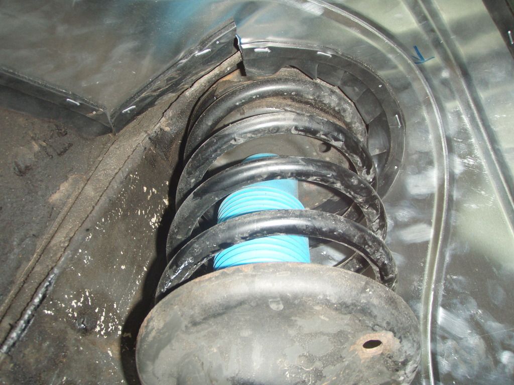

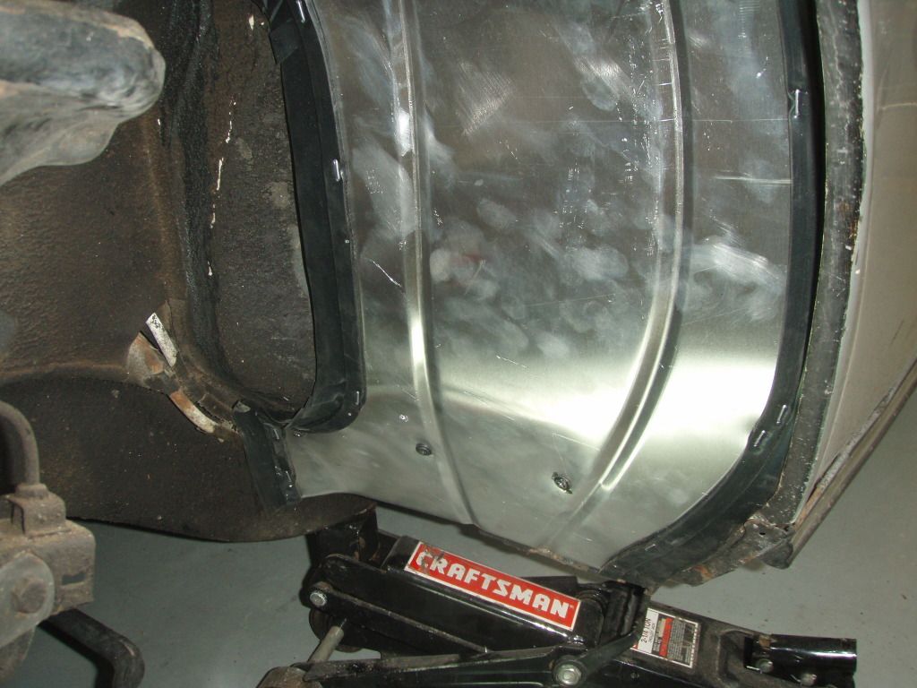

Turns out the instructions said (yes, I actually read them!) the lower part number is on the passenger side. Well, the sticker was either reversed or the folks at Lokari thought this was an English car. Once I studied the photos at the beginning of the thread, I figured it out. They literally jumped into position. A dead blow rubber hammer is a lot of help too!

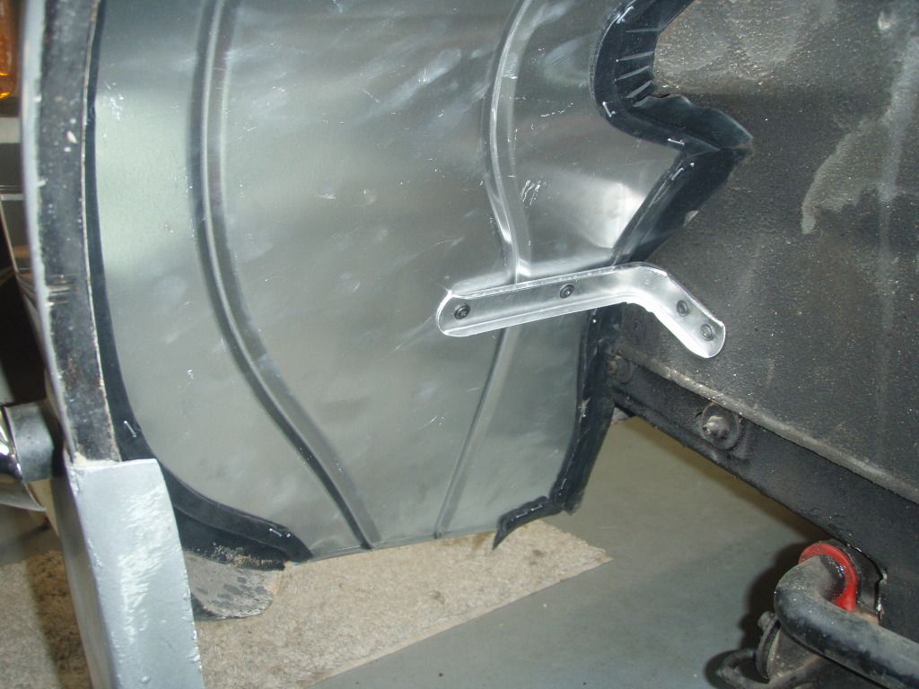

Front (thanks jcat, I never would have figured out where to put this bracket)
Rear
No brainer installation once you figure it out. Not many screws either, almost fits via friction

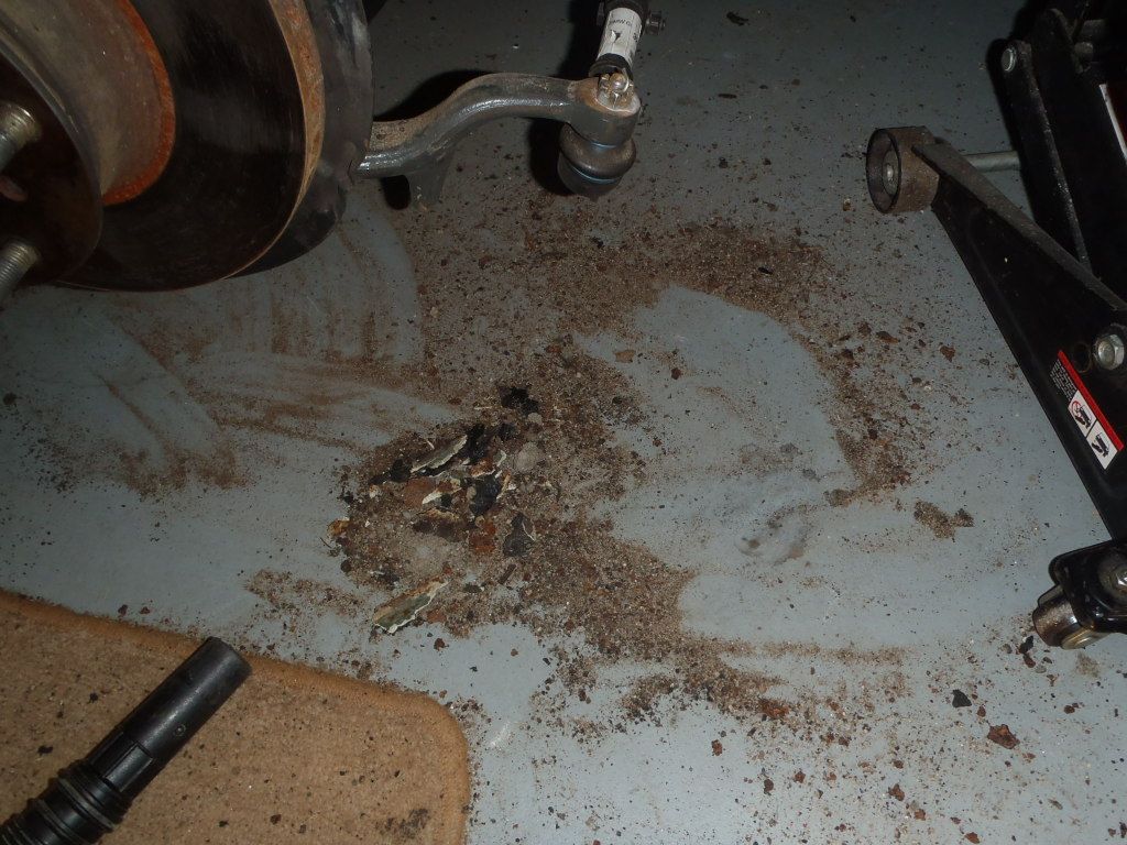

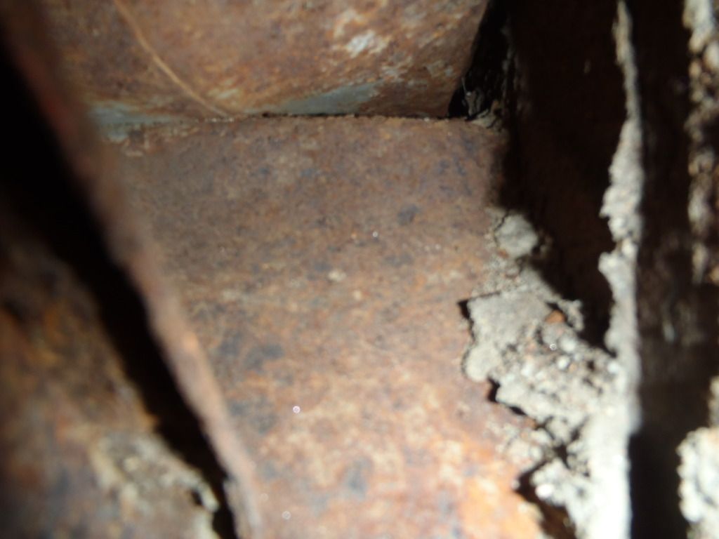

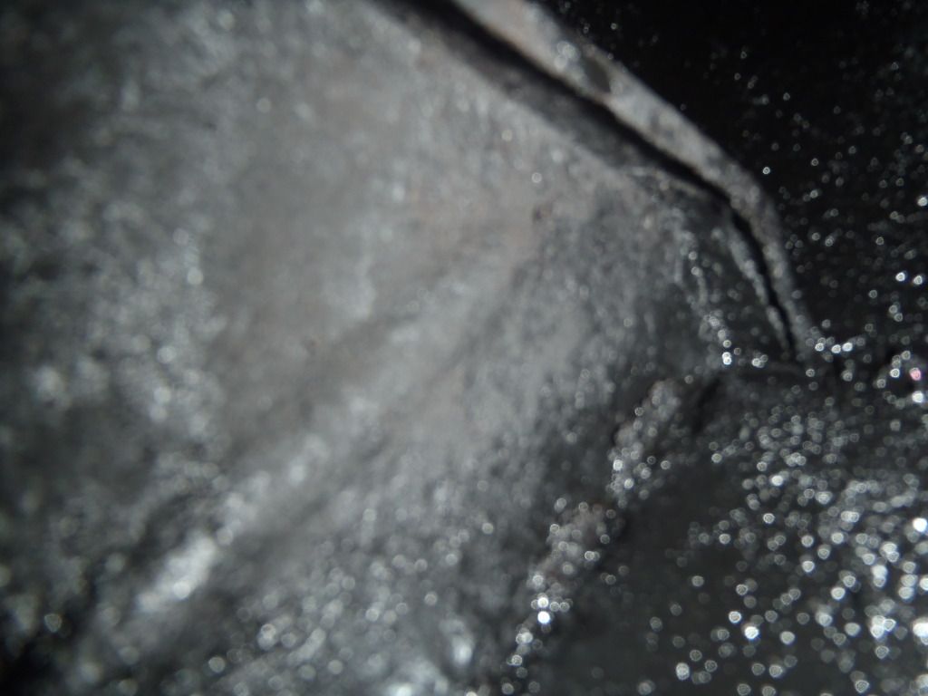

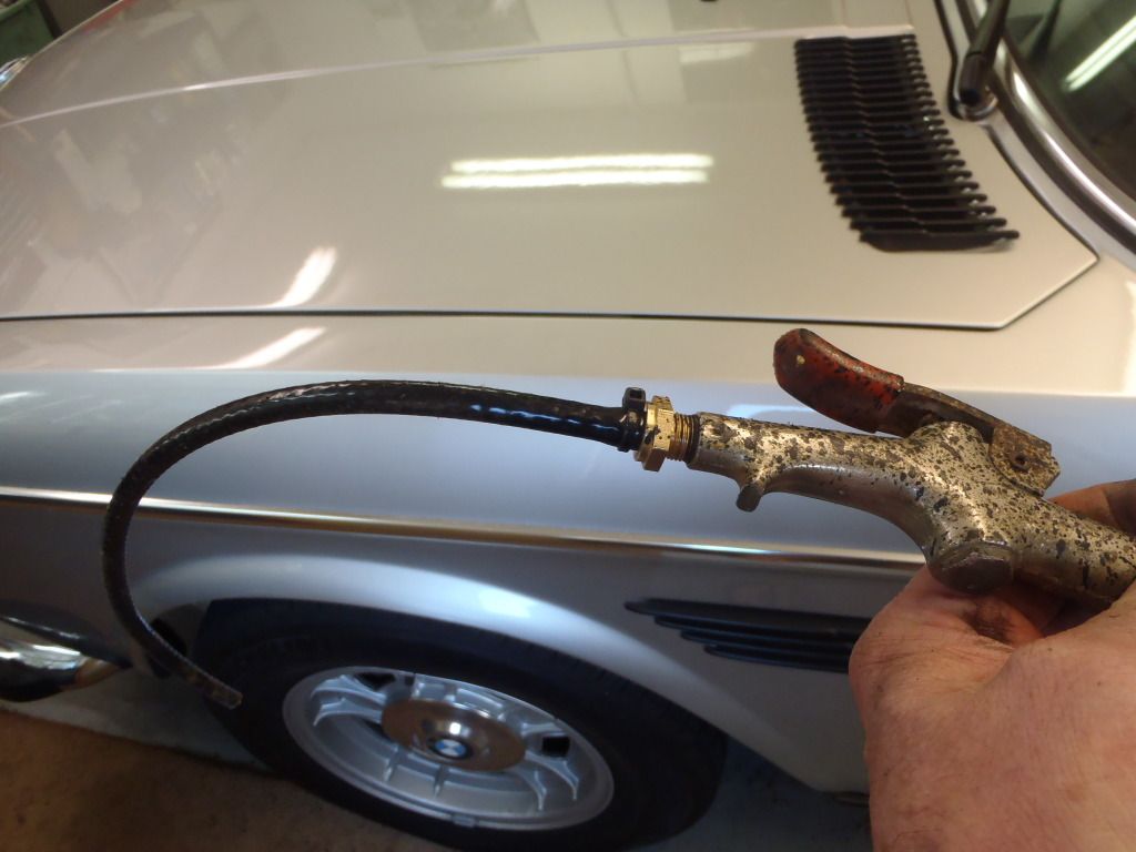

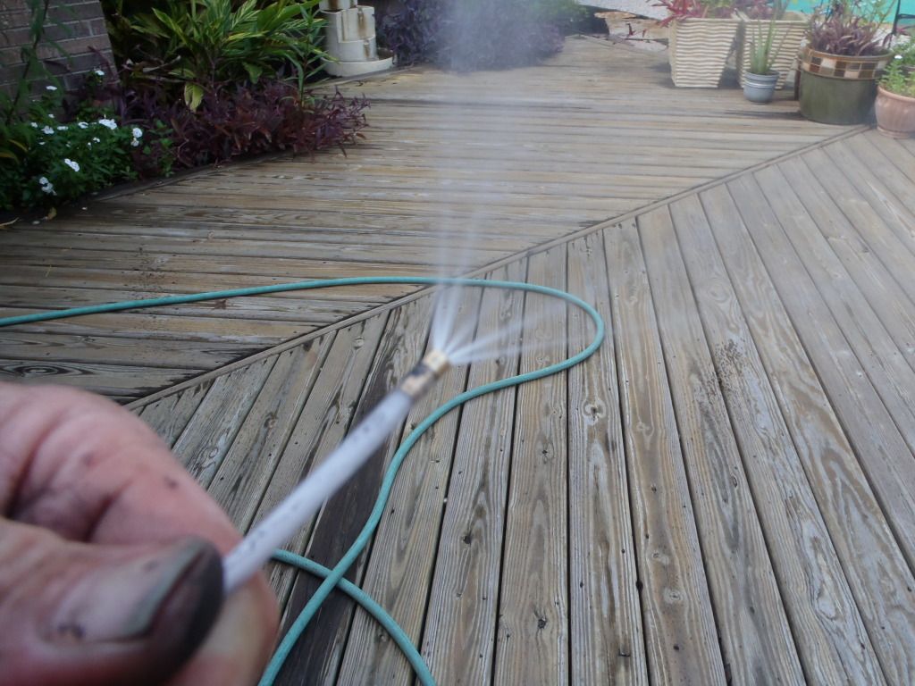

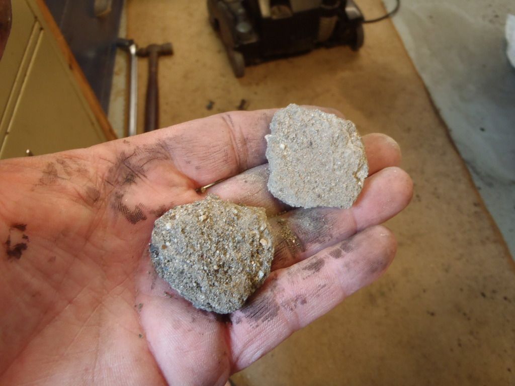

I forgot to show some additional info WRT what I did before I installed these liners. I cleaned out the upper fenders, the "hell hole" at the upper rear of the fender well. I was able to clean it out with high pressure air plus some judicious scraping.
Cool air nozzle I made so I could get into all the small spaces
Stuff I found in the hole
Results from the scraping/blowing (don't forget your safety glasses!)
