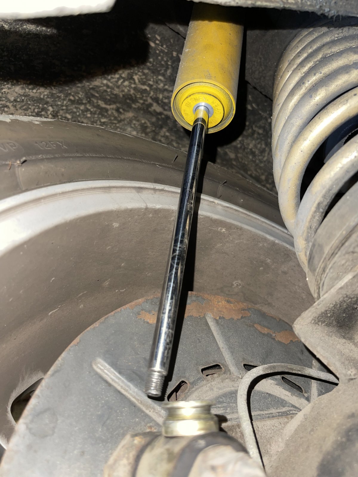

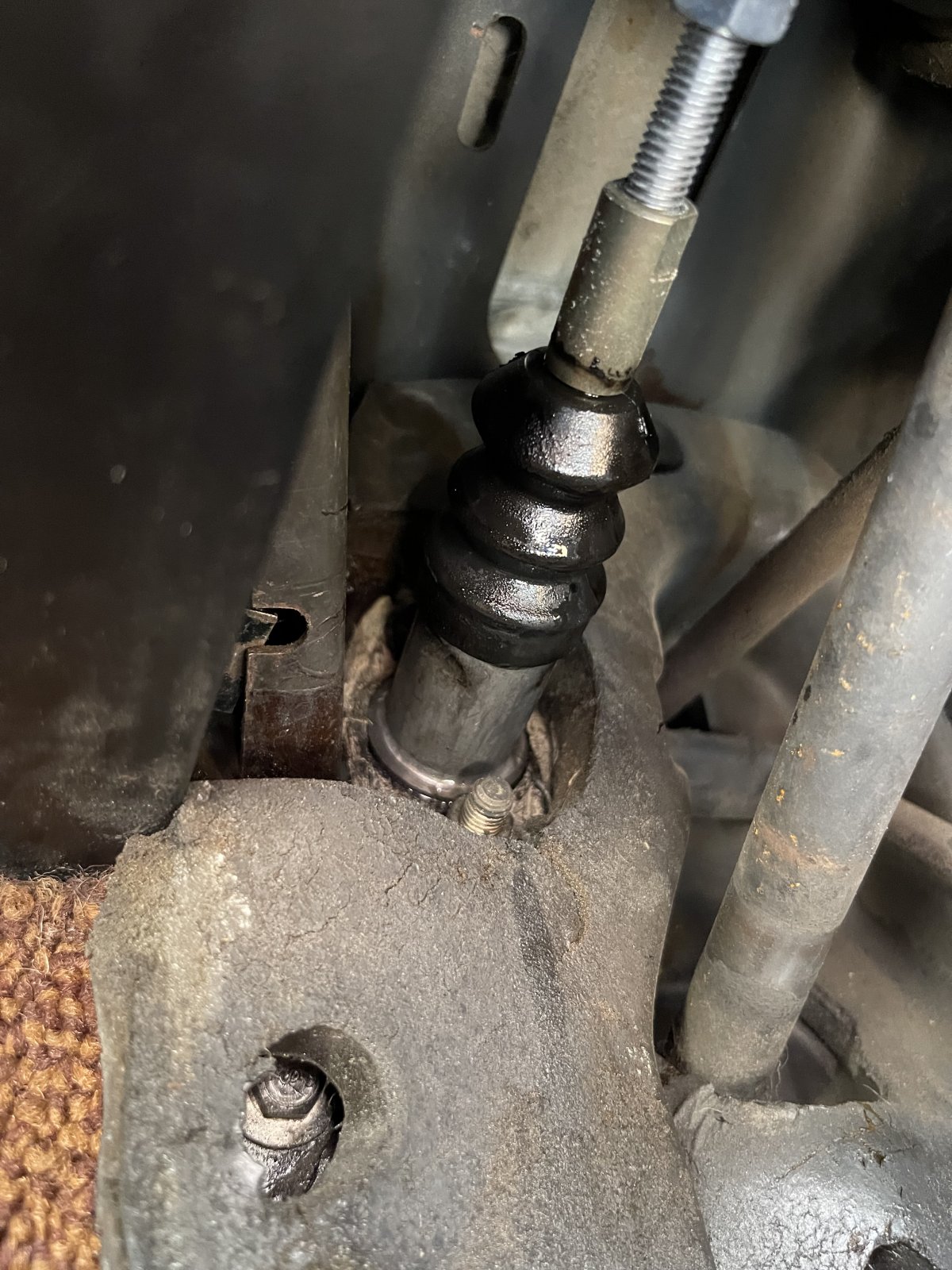

I had an eventful weekend. Many years ago, somebody repainted the car, and they filled in the holes for the “2800” emblem. Thankfully, they were still visible when you open the trunk which was used as a template. Driving home I heard some severe clunking, and when I got to my house, I realize that the rear strut unscrewed itself from the base. A very old Bilstein but with excellent rebound. I took everything apart, cleaned the threads, applied red Loctite and screwed the strut back into place as a temporary fix while I order new rear struts. I was about to take it on a test drive, I depressed the clutch pedal and realize there was no more clutch engagement. I check the brake fluid reservoir and it is bone dry. I fill it back up, hop inside the car, depress the clutch and notice brake fluid squirting out of the clutch master cylinder on my shoe. A new one will arrive early this week and I hope to get it installed before the weekend. I also got new tires installed on the E39 M5. All in all, it was a good weekend.
Is the booster full of fluid? How does the fluid get from the master to inside the car?
Had this happen to me. Fluid gets past the seal and follows along the pedal linkage and drips onto floor. Sometimes not obvious as to where the disappearing fluid from the reservoir is going until a large puddle forms under the carpet.
Master is still available but it is the later e12, e23, e24 design so the metal pipe will need to be bent or replaced with brake hose and a plastic elbow/nipple.

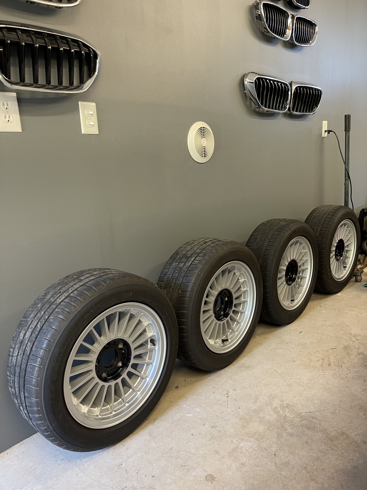

Fantastic car. My E9 at one time had similar wheels. Owner gave them to me and at one point I considered putting new tires on them and putting them back on my car, but decided instead to go with Alpina wheels. I ended up selling them for $2500 I think on e-bay. They look cool on your car and with your color paint make your E-9 very unique and will get you a ton of attention and conversation at cars and coffee events Here is a picture of what my car looked like with them.

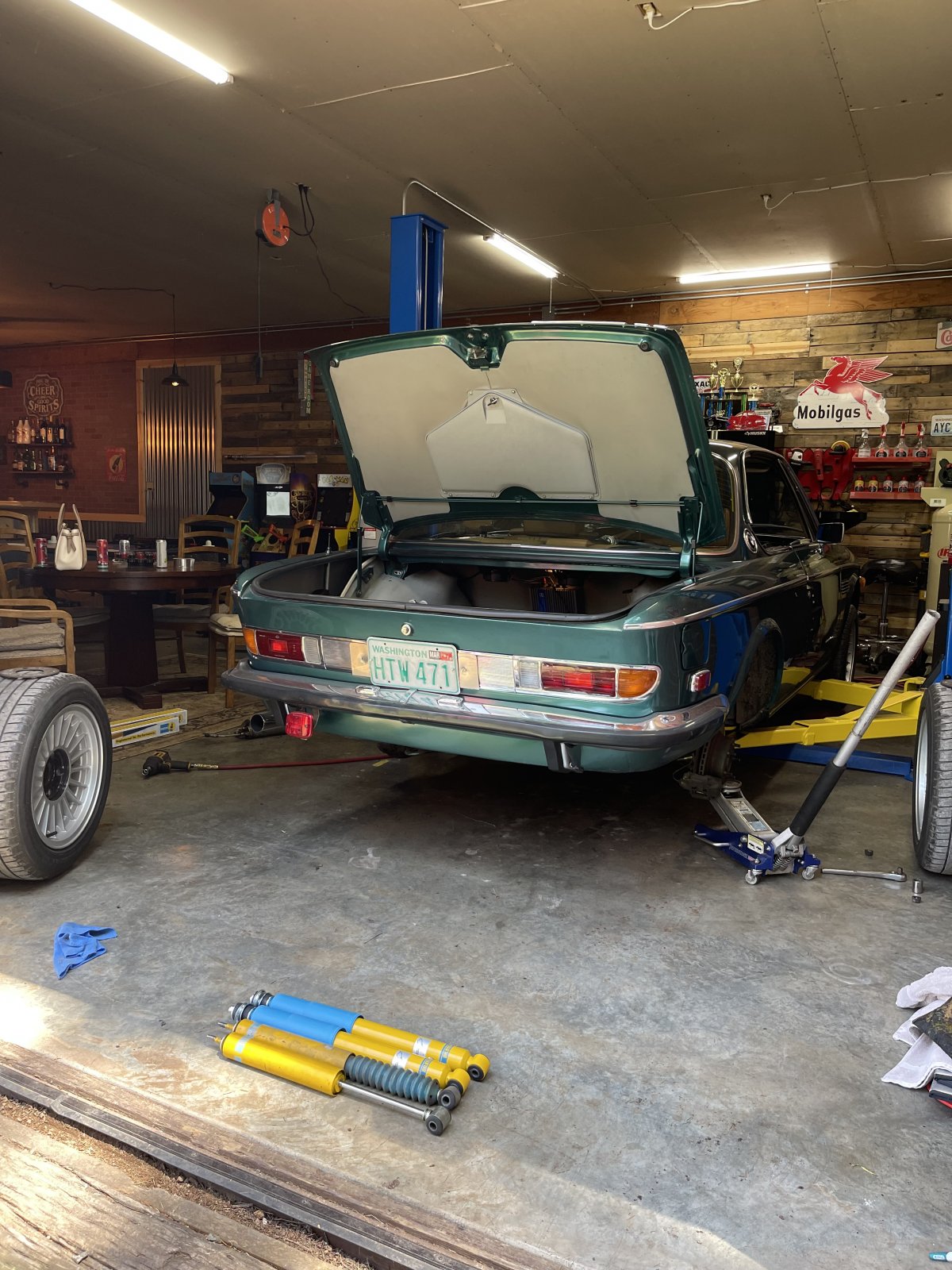

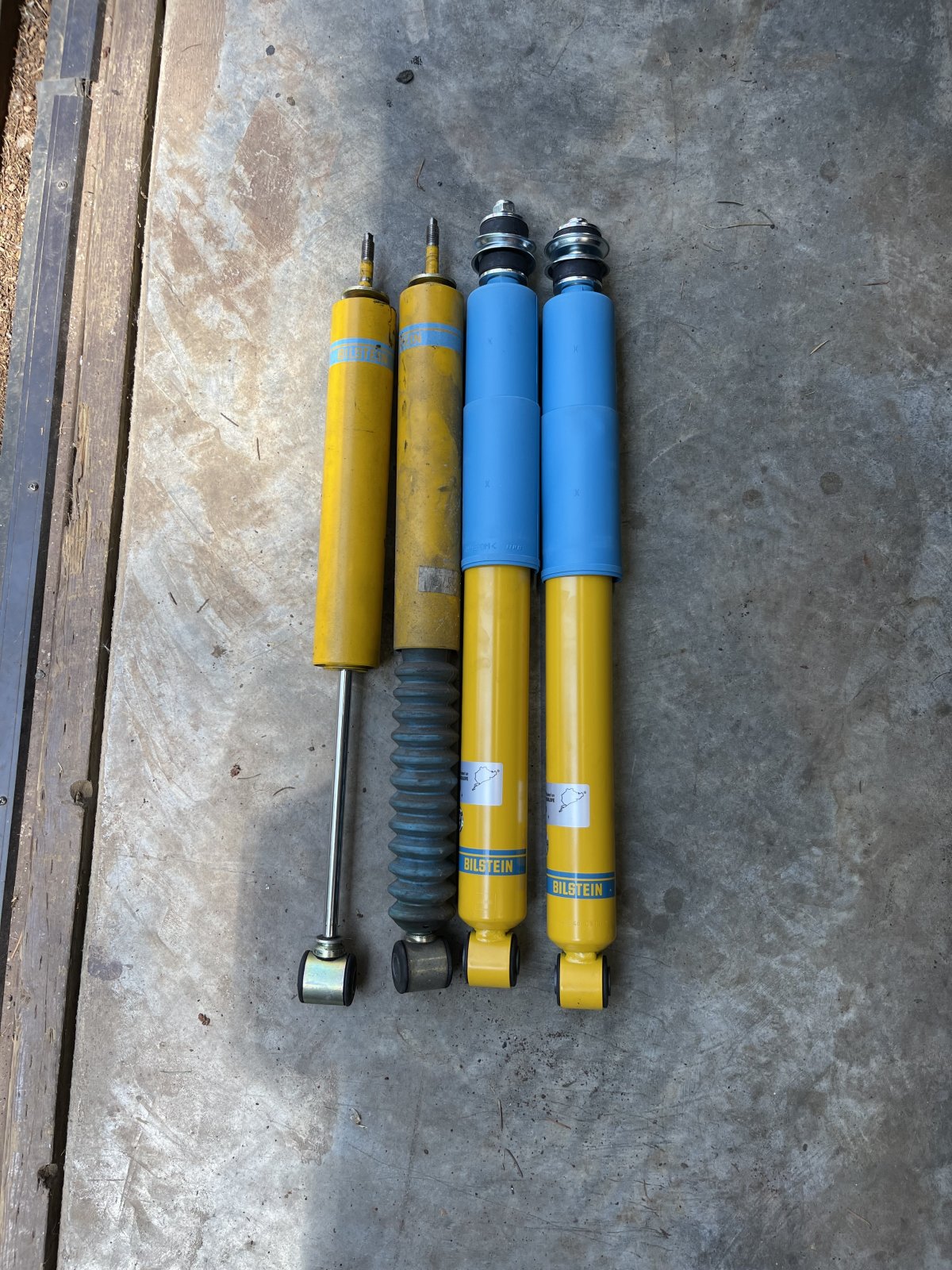

Yesterday I got around to installing new Bilstein HD shocks in the rear to get rid of the old style (and tired) Bilsteins. Ride quality has drastically improved. Next will be the fronts when I have time and now I’m thinking about different lowering springs as I feel the springs (not sure the brand) are a bit tired as the rear sits a bit lower than the front. I also need to take a look at the odometer/trip as they’ve both stopped working. New gears were installed about 200 miles ago.

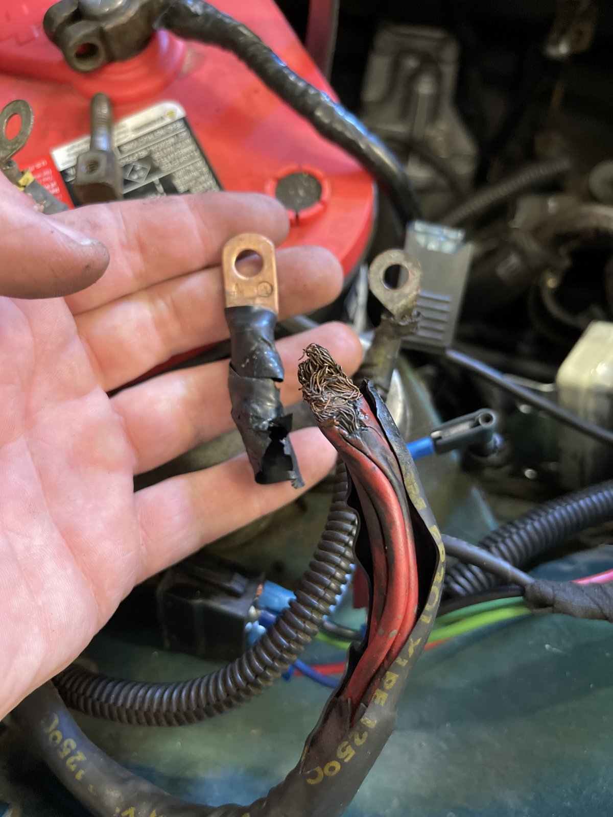

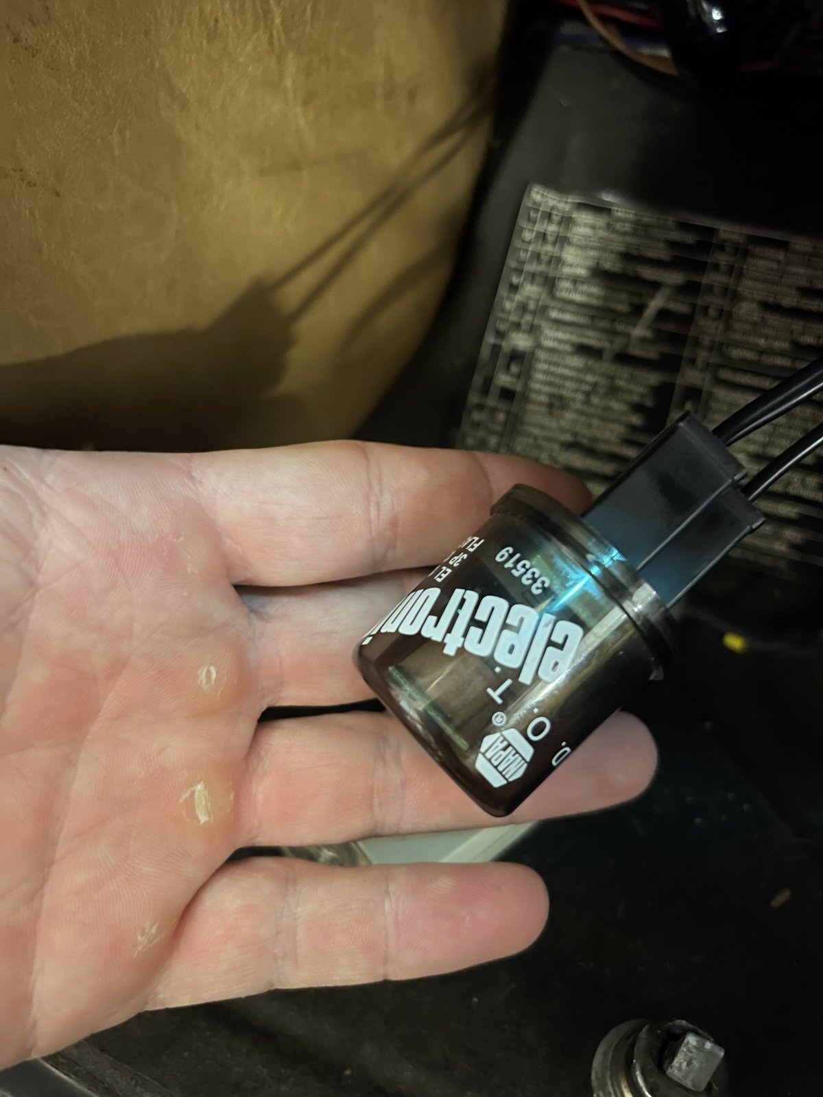

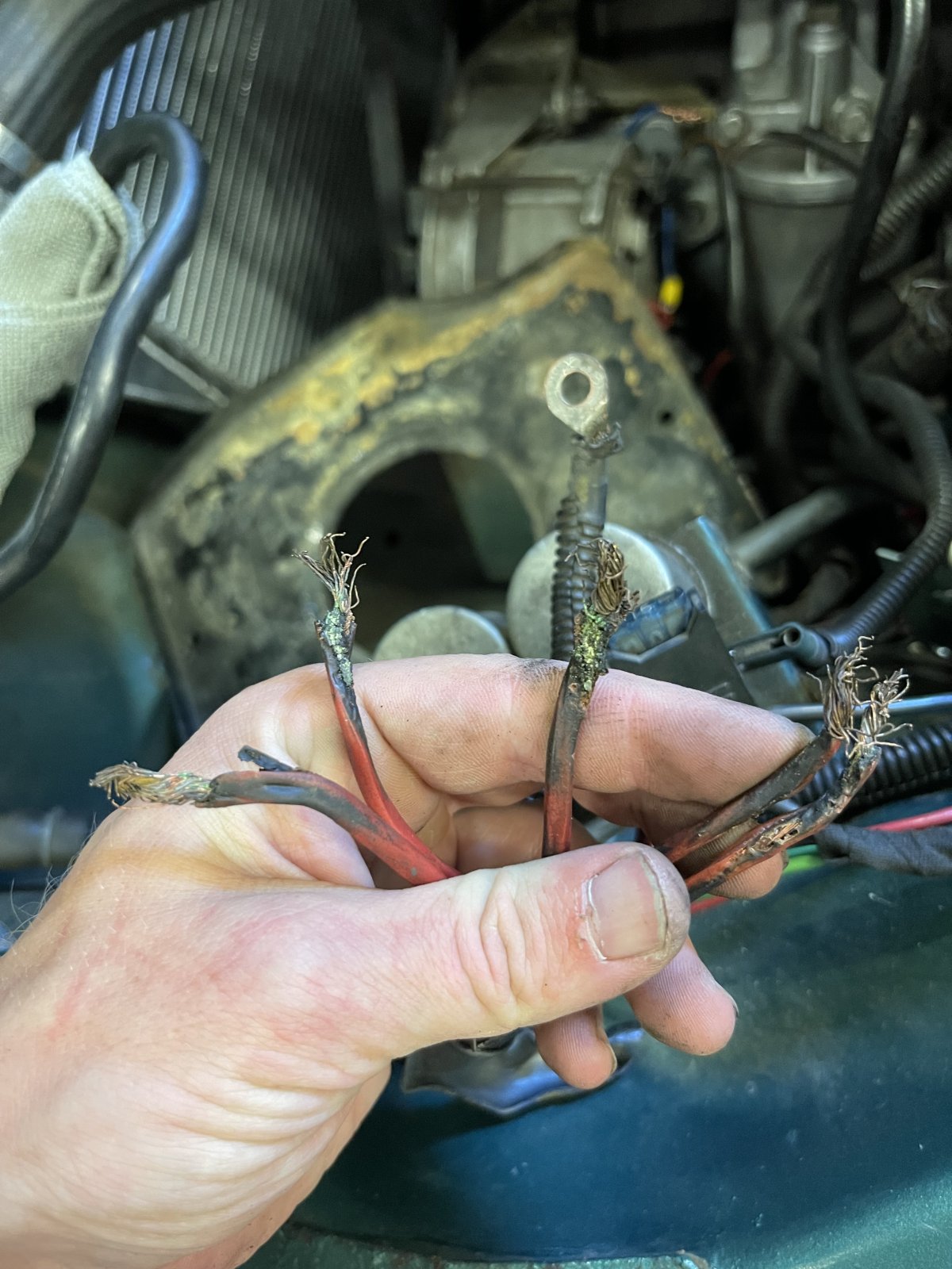

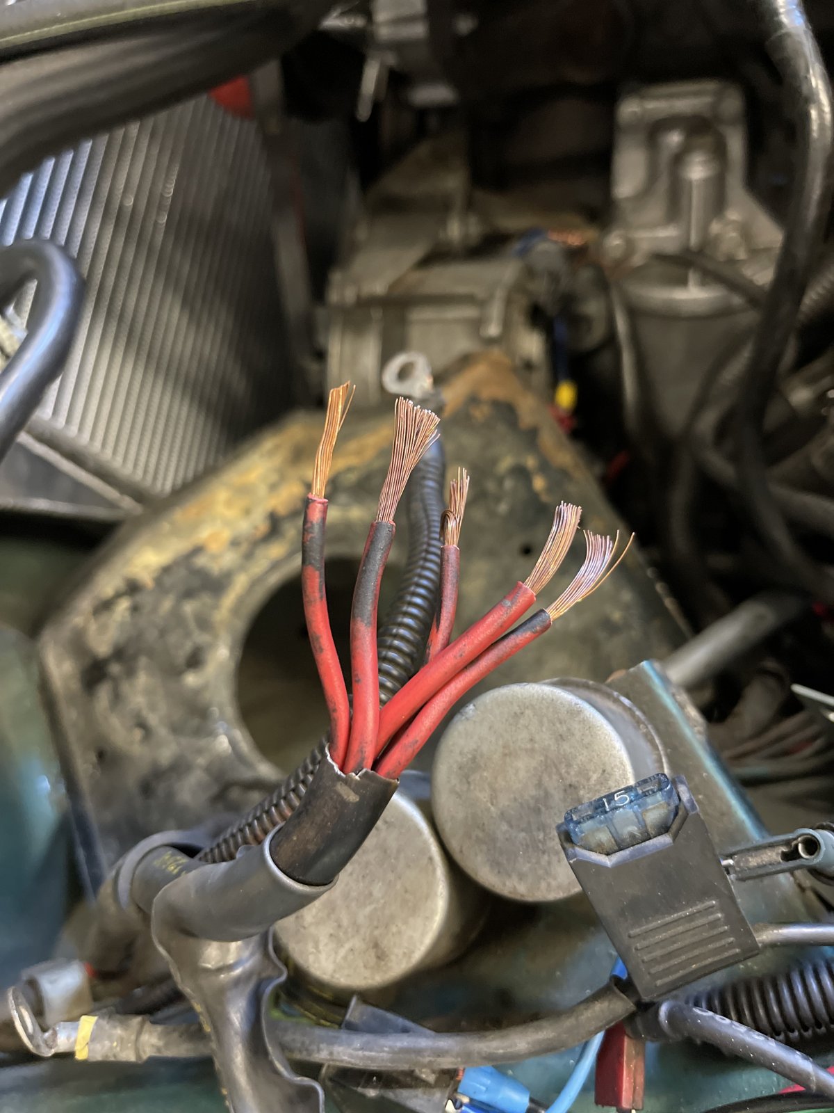

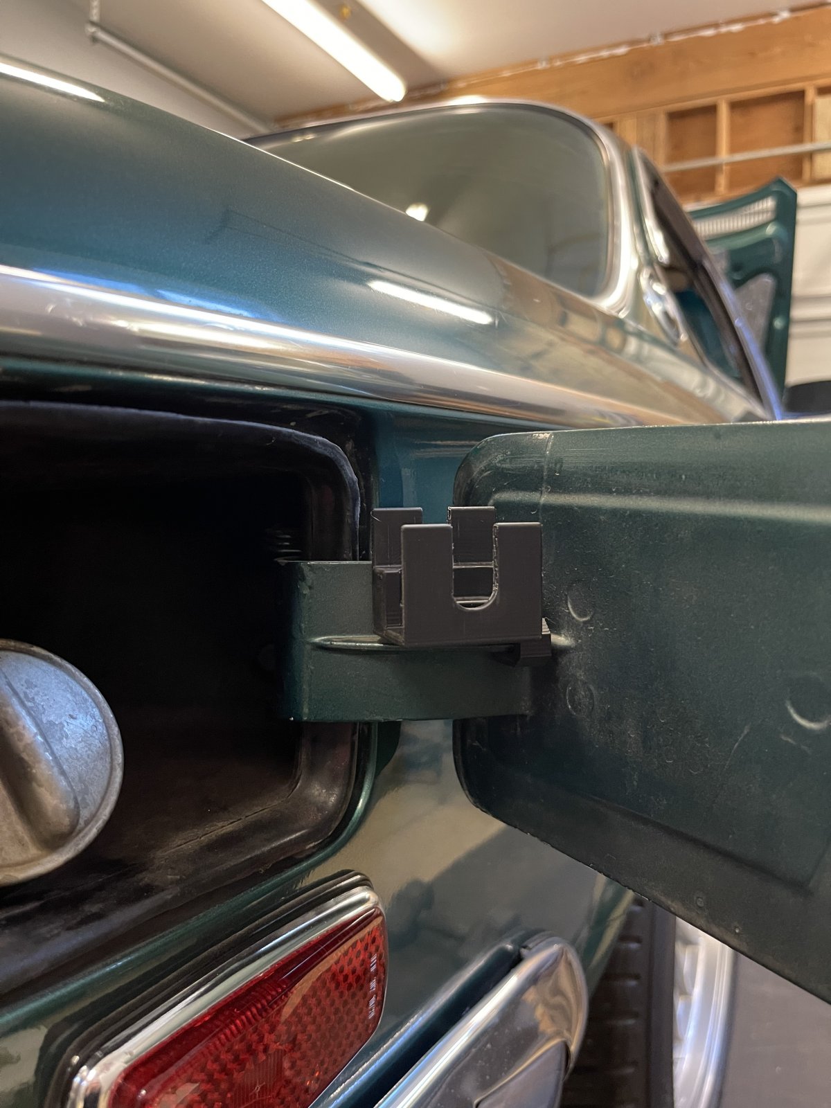

My sister is getting married and wanted to use the e9 as the getaway car. I’ve been tinkering with it, installing new to me CN rear springs (thank you @Stan ), cleaning the car and wheels which I coated with a quick “ceramic” spray. I couldn’t find my actual ceramic coating in the garage. Next time. I ran into a weird electrical issue including no start/no power and long story short, a lot of positive wires were all twisted to one connector and they had very little contact. It wiggled loose after all these years causing the dash to dim, RPM bounce all over, odd misfiring and more. I mended it with a temporary fix by stripping as far down as I could until I got to soft rubber/wiring then fitting eye/ring terminals. My goal is to trace and replace all of those red wires this winter. I also fixed my turn signal issue with using the NAPA EL-13 electronic flasher. The hazard relay is in good shape as I’ve gone though fixing that in the past. The electronic flasher was a legit 5 minute fix. It’s nice having functional turn signals again. I installed a new gas cap holder from @x_atlas0 and it works tremendously. Lastly, I had my garage door tracks raised so I can fully open the door with my other cars on the lift. Photo dump time.
