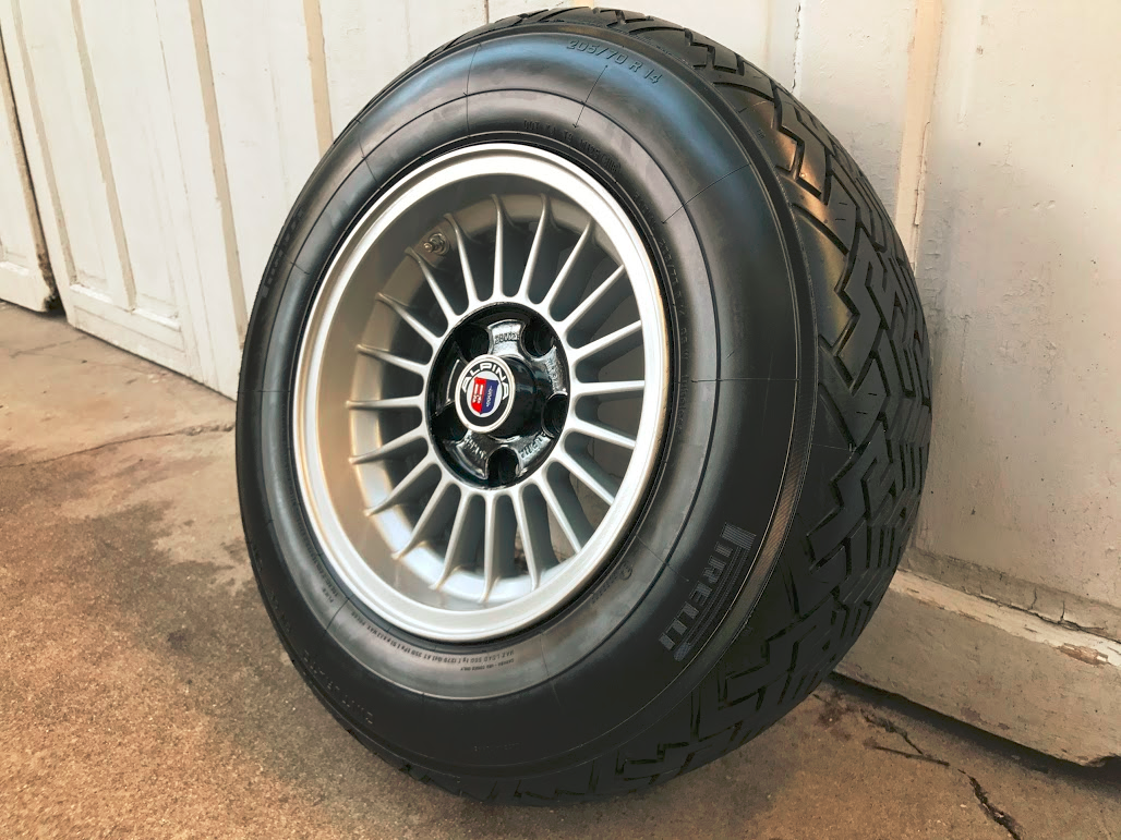

on the tundra coupe, the stock wheels just look so right! if you really want them to look great, buy some Pirelli CN 36 tires for them in 205/70-14 size ... a tiny bit bigger but they are perfect on a coupe. okay this pic is a period correct Alpina 14" ... but you will get the picture.
When my BF Goodrich time out or wear out, I want to downsize to these!

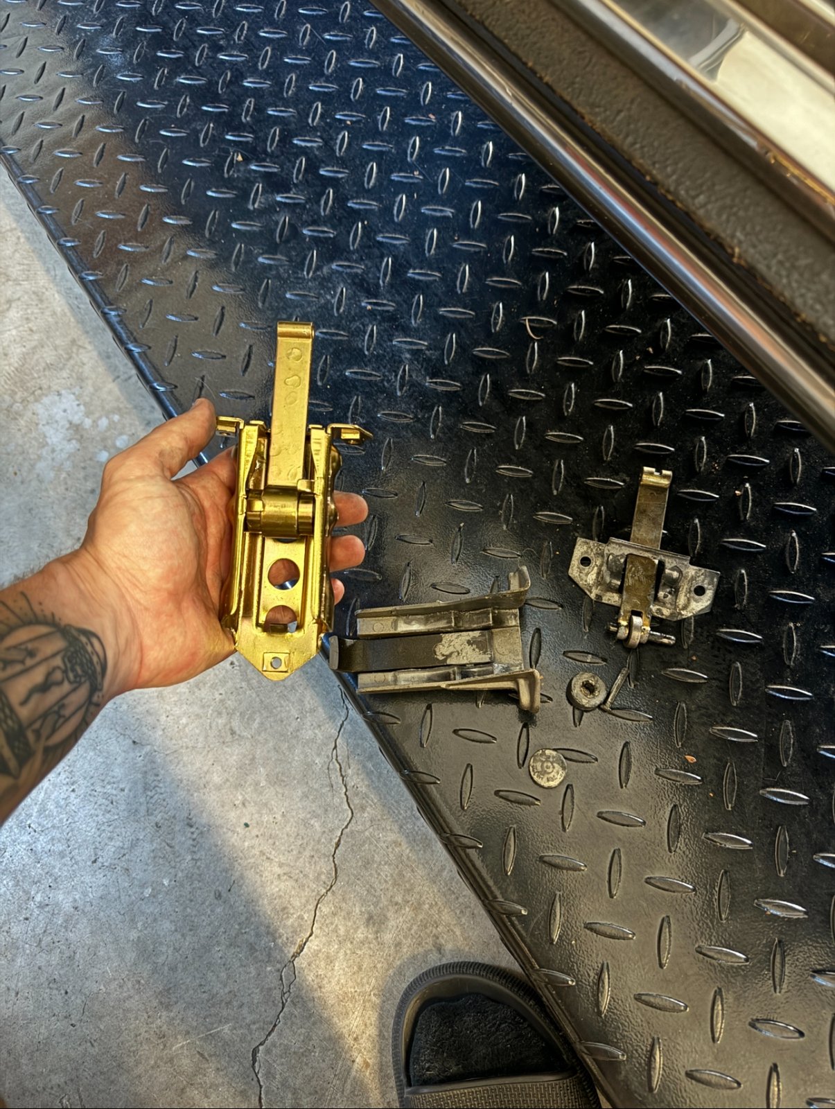

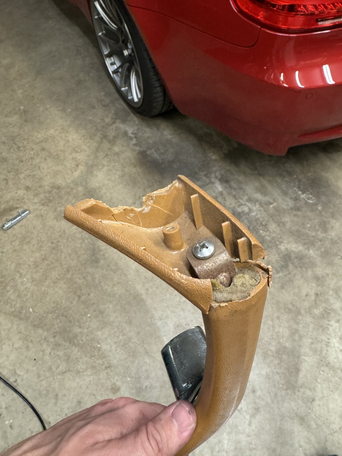

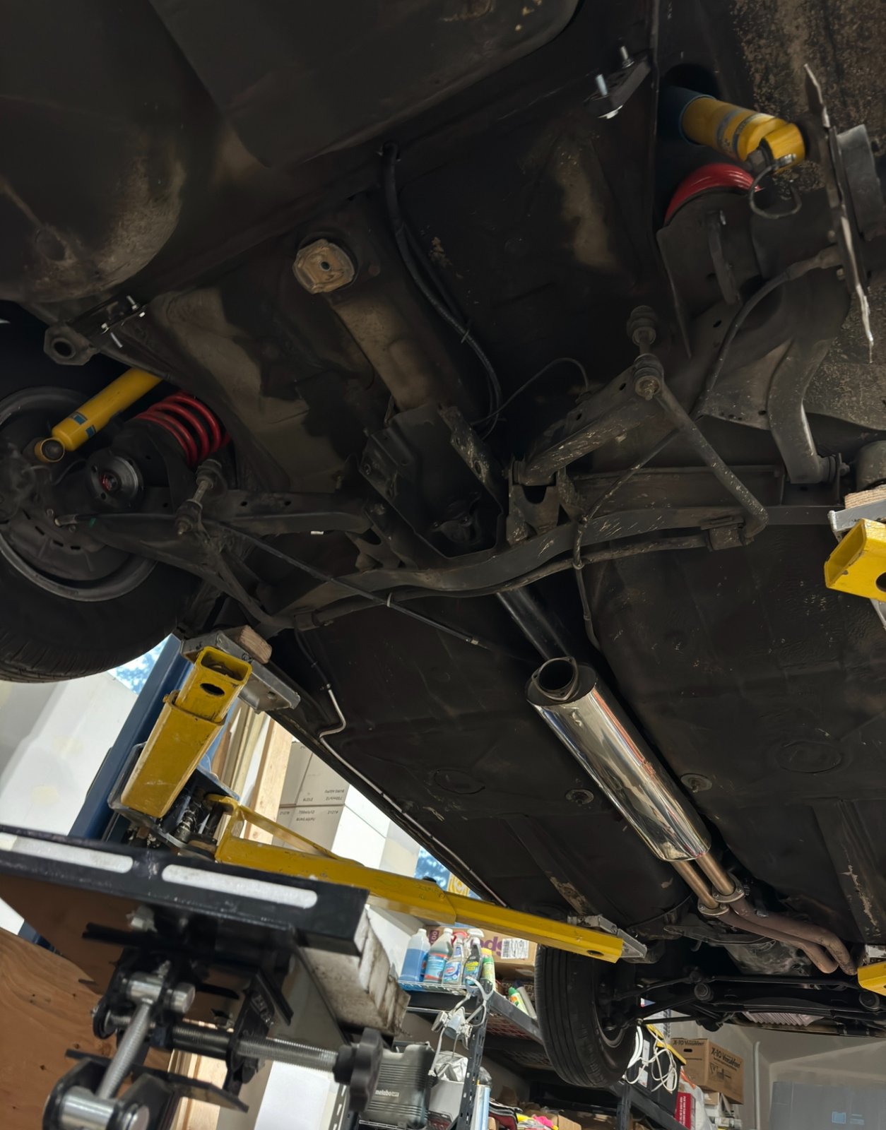

I recently replaced the driver side door brake with the MB part. During the removal of the door panel, the top door handle cover turned out to be extremely brittle and fell apart as I unscrewed it from the panel. All four front window switches are functional now and work in a consistent manner. Lastly, I had a muffler shop adjust the Fritz Bits exhaust as I’ve had fitment issues for the last two years with it. It now sounds great!

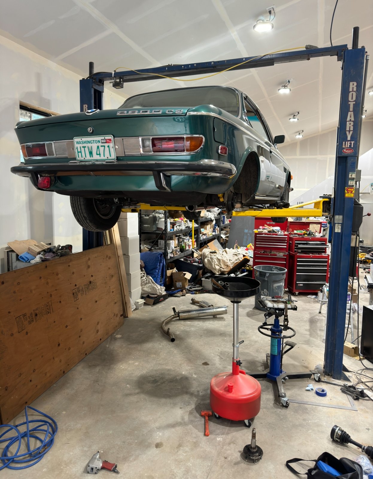

Currently in the process of replacing all wheel bearings, front/rear brake pads, parking brake pads, passenger side cv joint refresh, differential mount and differential rebuild (IE has a nice kit for this). I am looking to locate the doc for diff rebuild to keep me in line for the process & numbers.

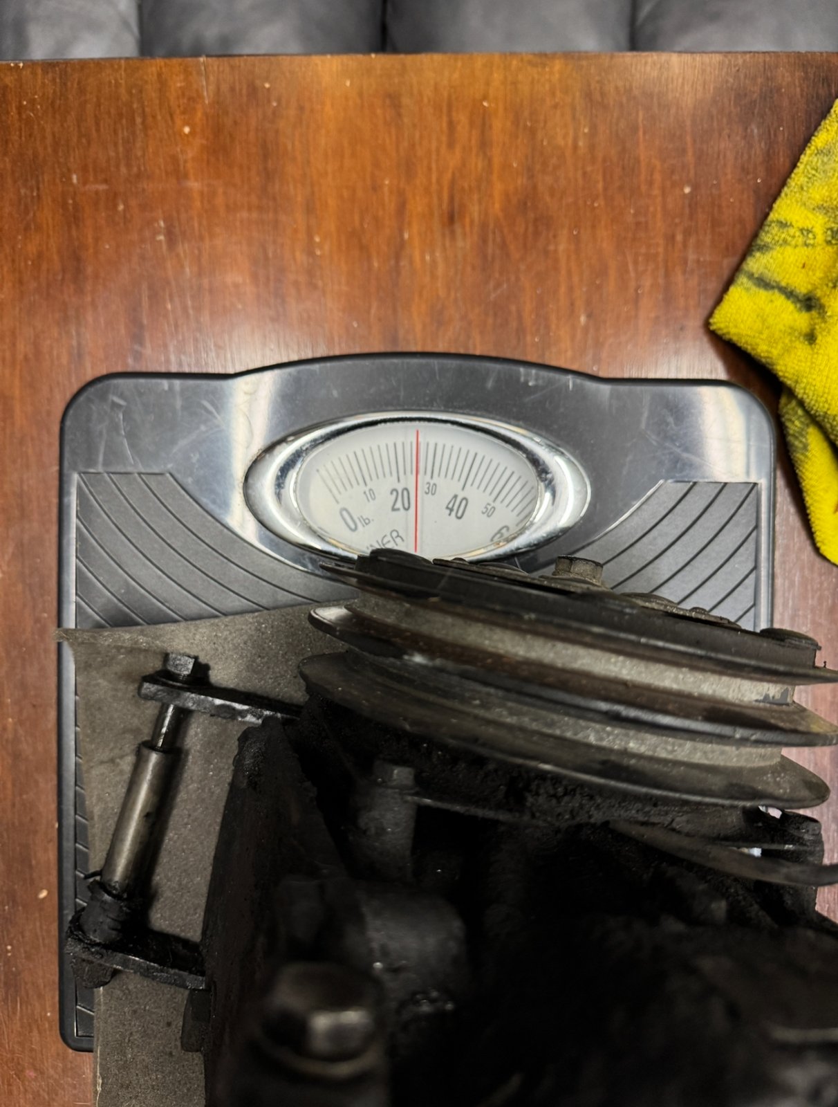

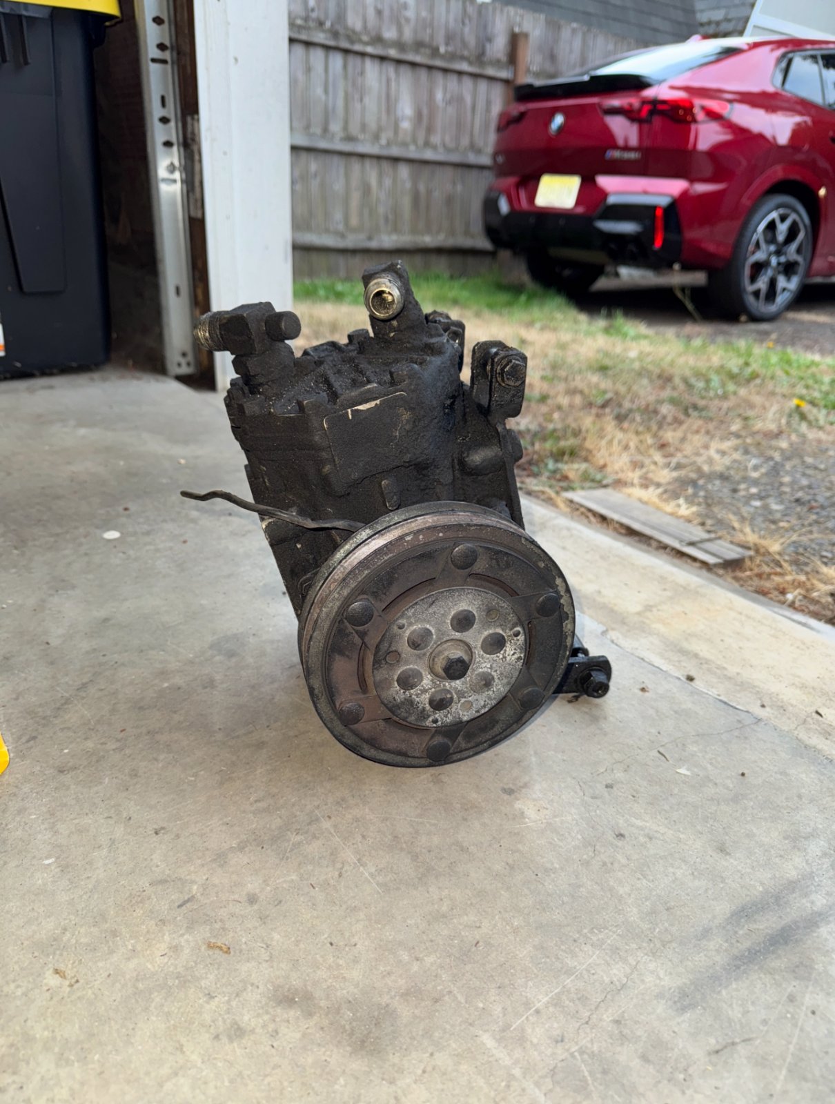

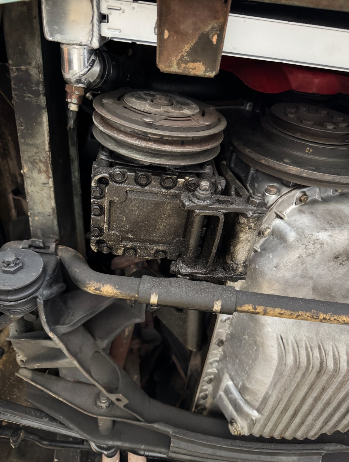

Tonight I removed the AC compressor as the lines were removed quite sometime ago. If rarely need AC, but if I do I tend to drive the M3 instead. I didn’t realize how heavy the compressor is. I plan on deep cleaning it and tucking it away should I ever want to make AC functional in the vehicle. Decades of gunk all over it. Thankfully my VCG and oil pan gasket is still pretty dry from a few years ago.
The compressor weighs approximately 25lbs. View attachment 189861
I wouldn't bother even cleaning that thing up. It is very inefficient, and if you want to put a/c in your car a modern Sanden compressor is the way to go. It weighs half what that thing does and places far less drag on the engine. Also, you can remove the vibration dampener under the hood that is only necessary with the stock compressor - see part number 1 here:
