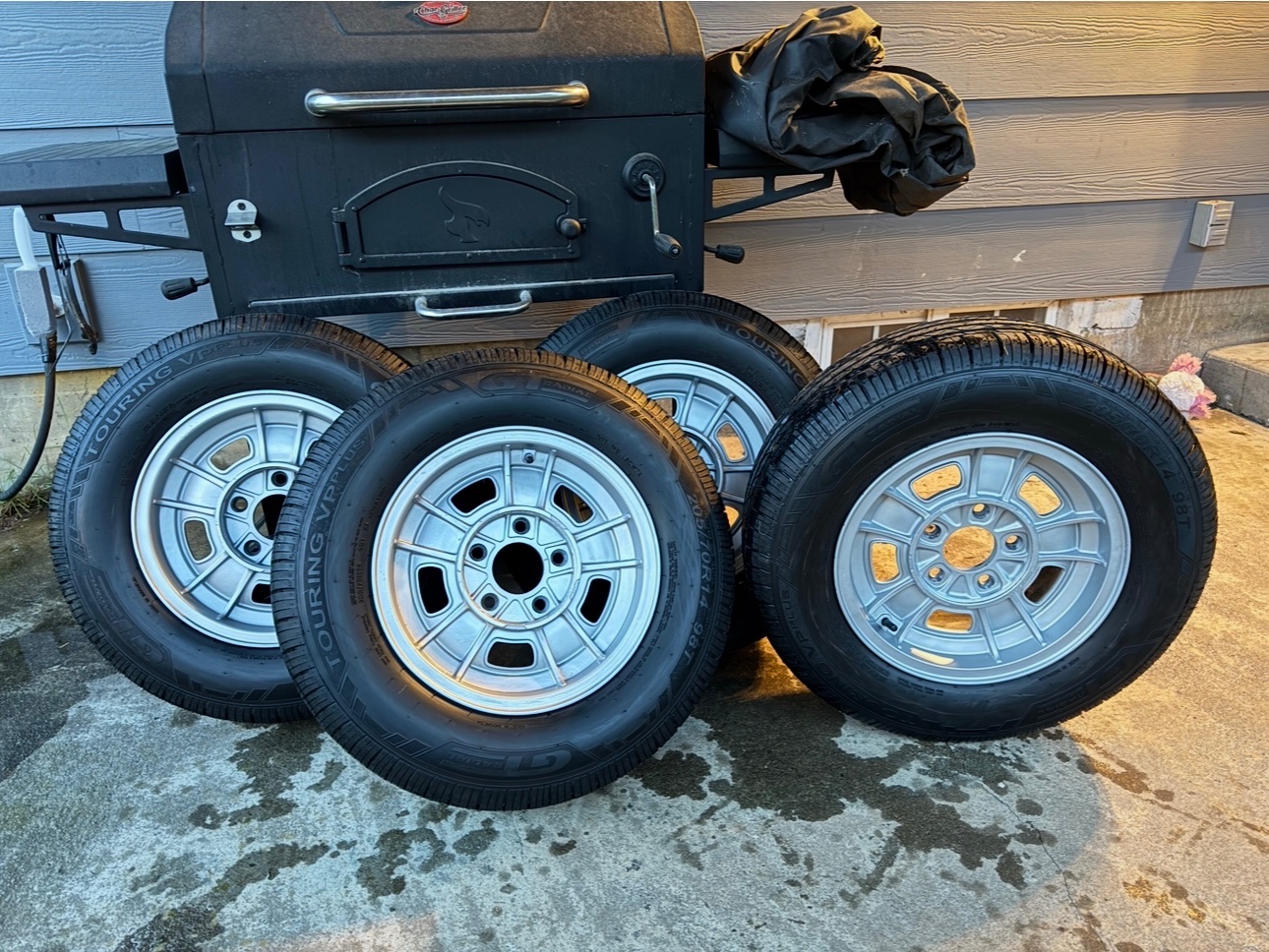

As for the second part, I was referencing the wheels that originally came on the car which came from an E32 with fresh tires. I wasn't the biggest fan of how they looked, so I drove them for a while and sourced Alpina replica wheels. Since then, I purchased a set of factory E9 wheels from @Dick Steinkamp and I've been using those for quite some time now. I love the original 5-spoke wheels as well!

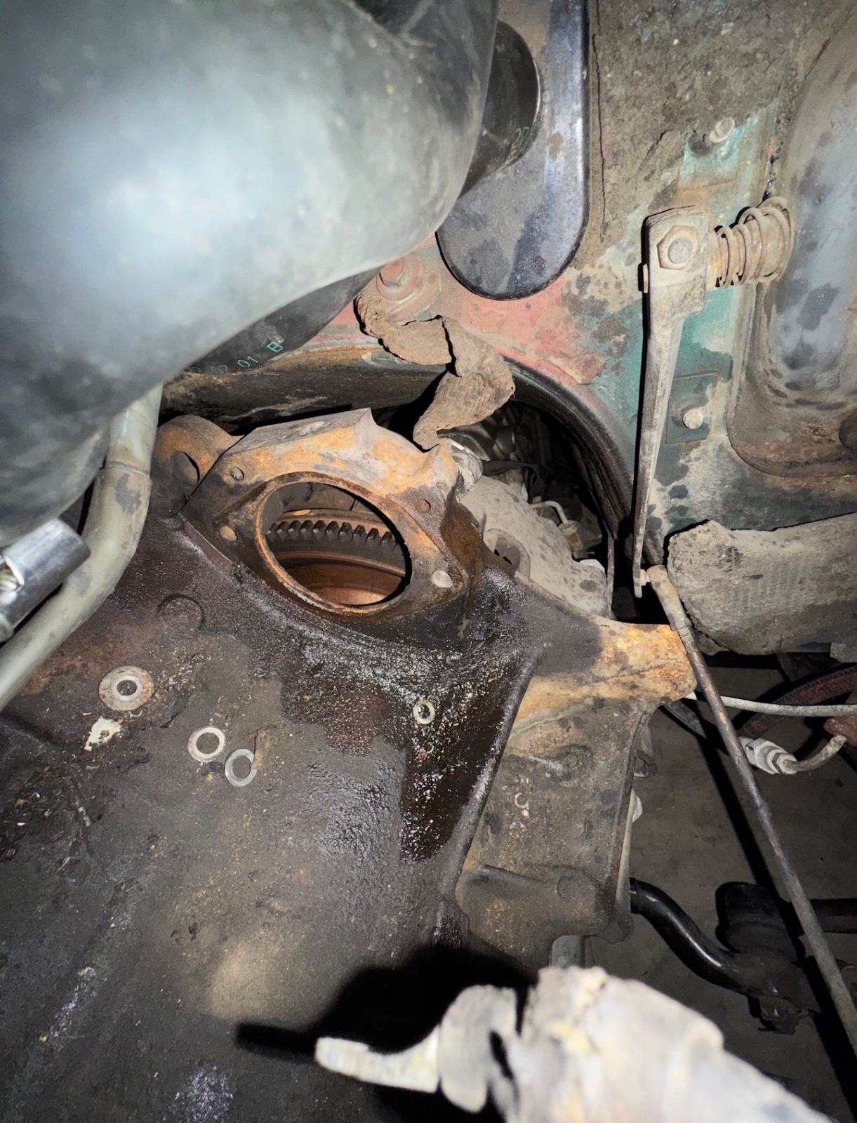

I’d be curious to know what you found/discovered upon the opening of the diff. Mine’s next.
Everything was surprisingly clean with no marring or areas of concern. The fluid on the other hand was terrible and was showing its age.
Ok thanks. Did flush the bilge colored oil outta my diff and added new .
Appreciate the feedback as I’m diving into mine soon. Were gaskets easy to obtain?

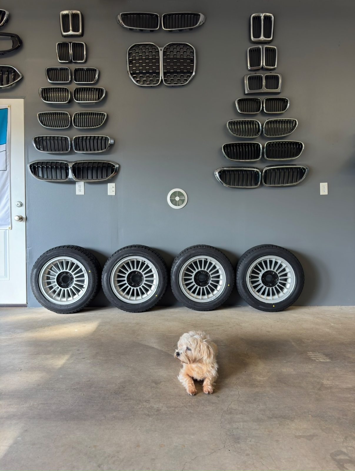

After running the factory wheels for the past couple of years, I decided to put new tires on the other wheels I had. I also got around to finishing the front struts & spring replacement. I cleaned both sets of wheels prior to installation and storage for the other set.

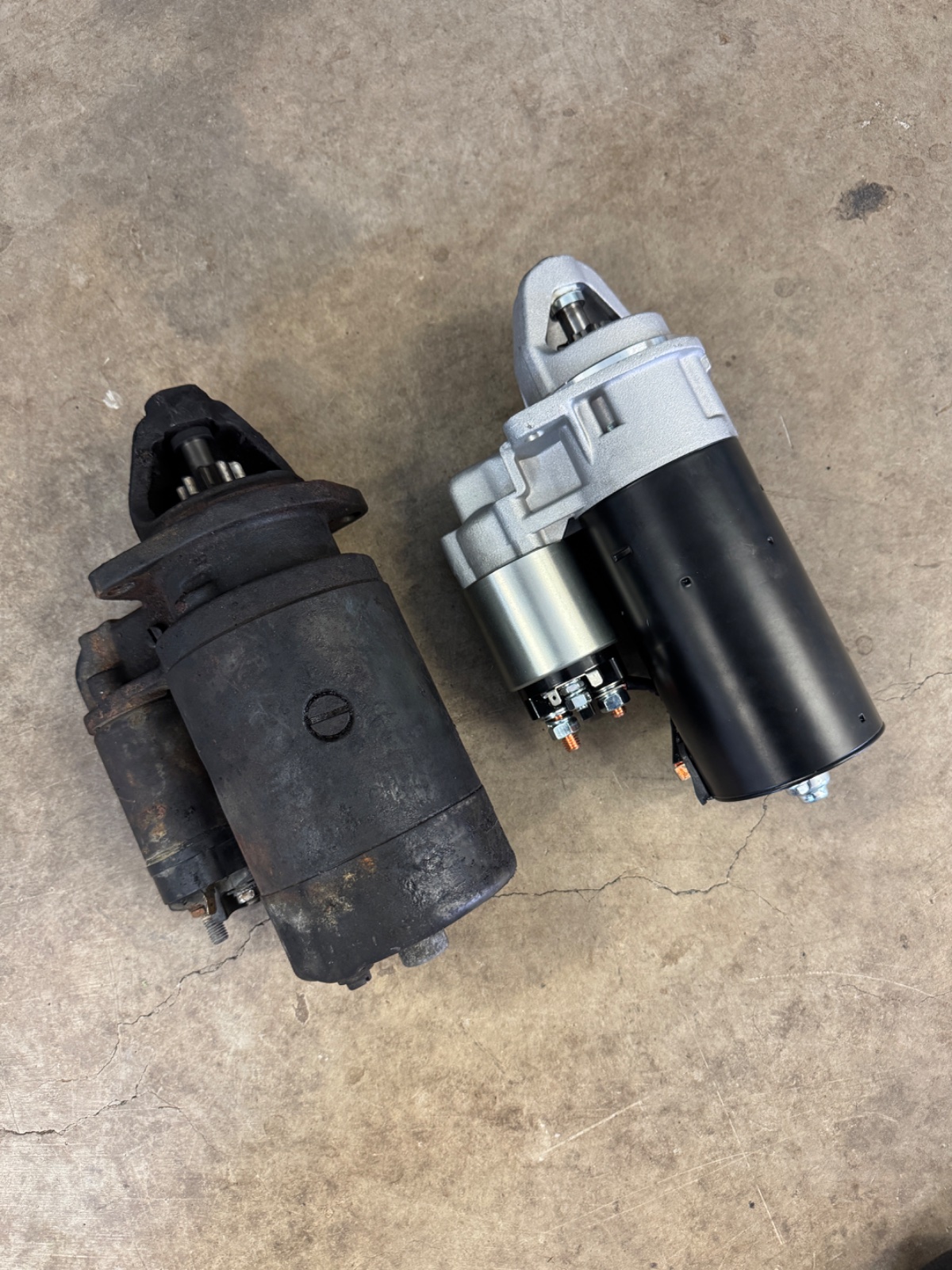

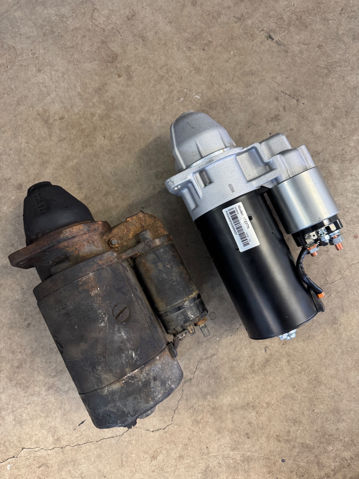

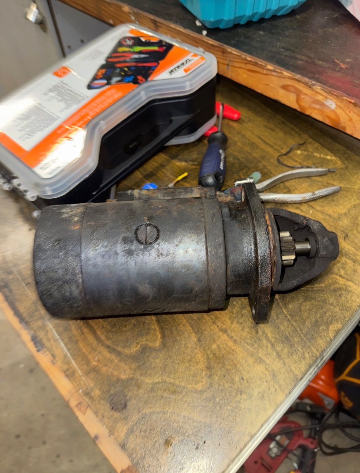

I’ve had inconsistent starting after driving the vehicle as of late. Cold start was great but once it got warm and I went to start the vehicle, it wasn’t always starting on the first go around. I did some testing and found the starter was faulty. Pulled the starter in 15-20 minutes. Just waiting for the new one to arrive. I also have new brake lines & clutch line waiting to install.
For what it’s worth, I installed the WAI Global 17237N from Rock Auto. Great size, power, reduced weight. Incredible start time now. A new starter (not reman) was long over due and only $165 shipped.
