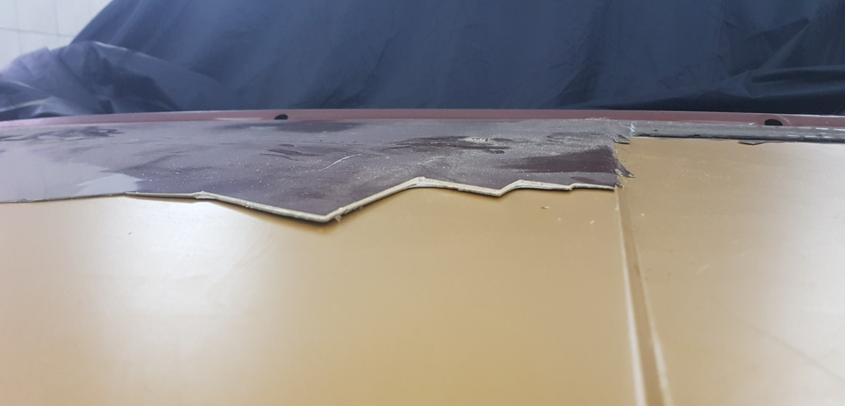

OMG it's sooo cold, it cracked my paint!

To be clear, this is no one's fault, especially the paint shop, Bennyz Rod Shop. They did an amazing job given my very limited budget. This was not a bare metal restoration, but a relatively cheap paint job that turned out amazing. I don't think it was the repair shop's fault either, but would have been nice if they stored the car inside as I asked. I was more concerned about rain/snow/rust, but it never occurred to me that it would get so cold to crack the paint. File this under, "shit happens." Sucks but no one's fault.

That really sucks to see. Unfortunately this is one of those components of 50-year-old car and not knowing what’s under the paint. You never know how many times something was done quickly to sell. Hopefully the filler isn’t in a Wile E. Coyote shape.
Exactly! Benny warned me of this, as did many of you. No regrets, other than not making sure the shop stored it inside.

Benny didn't do a bare metal restore. This was only a $7500 paint job if memory serves me, that ended up being much more than that but never intended to be a "proper" restoration. I agree that no shop should be required to store inside necessarily, and I do drive it in the cold, but not -15 degrees. I think this is just one of those things....

The way I view this there are two ways to go at this. One is to point fingers at everyone and one is to just say shit happens. Frankly, I could’ve gone either way. I figured the second wave was easier.
Looks like insurance will cover it under their comprehensive coverage. Apparently there is coverage for things like extreme weather.
They do make Wile E. Coyote stickers for that, saw one the other day, made me laugh. Splattered on a door dent, that's Idaho body work I guess, just slap a sticker on it.
Regarding what to do. I like your first response in that, "shit happens." Especially seeing the amount of filler. It's a tough call but maybe this is the sign to have the body and paint properly done this Spring or might as well get on it now with the cold weather, I am the same boat here in CD'A, it's been unusually cold (hence "climate change vs. global warming." The climate does change, imagine that, it's called "Winter."

Sad to see that.
It is so hard to find a good bodyshop once man-hour costs so much and the goal (to make things done) is more important than the way to achieve it.
Unfortunately bond is taking humidity out of the air.
But - what is worse - has different temperature expansion than steel. That is why many professional shops use heating for removing bondo rather than grinding. Clean and easy task for bond-based cars.
The rule of thumb is that bondo should be limited to micrometers range not more.
In the end fuel consumption will drop probably which is a good in a bad.

Just talked to the mechanic shop. They admitted it should have been left inside, but had issues with their door or something. They seem like they are going to be cooperative. I think this is what insurance is for, both mechanic shop and my insurance. I started a claim with my insurance and seems like it will be covered under comprehensive coverage due to "weather" issues. Fingers crossed. Any ideas on approx cost to have BennyZ repair?

I think it is a stretch to get cracked dash. In this case, the car was fine on Friday pm, and destroyed on Monday am. Sunday night it was below -15 degrees

when I saw the title 'cold cracked the paint' I was wondering why that would happen until I saw the filler, when I was a kid, all our cars were outside, -30 below, and it never hurt the paint
My initial reaction was the same - growing up in WI we regularly saw temperatures below zero and never had paint damage, even on the crappy old Pontiacs I used to prefer.
