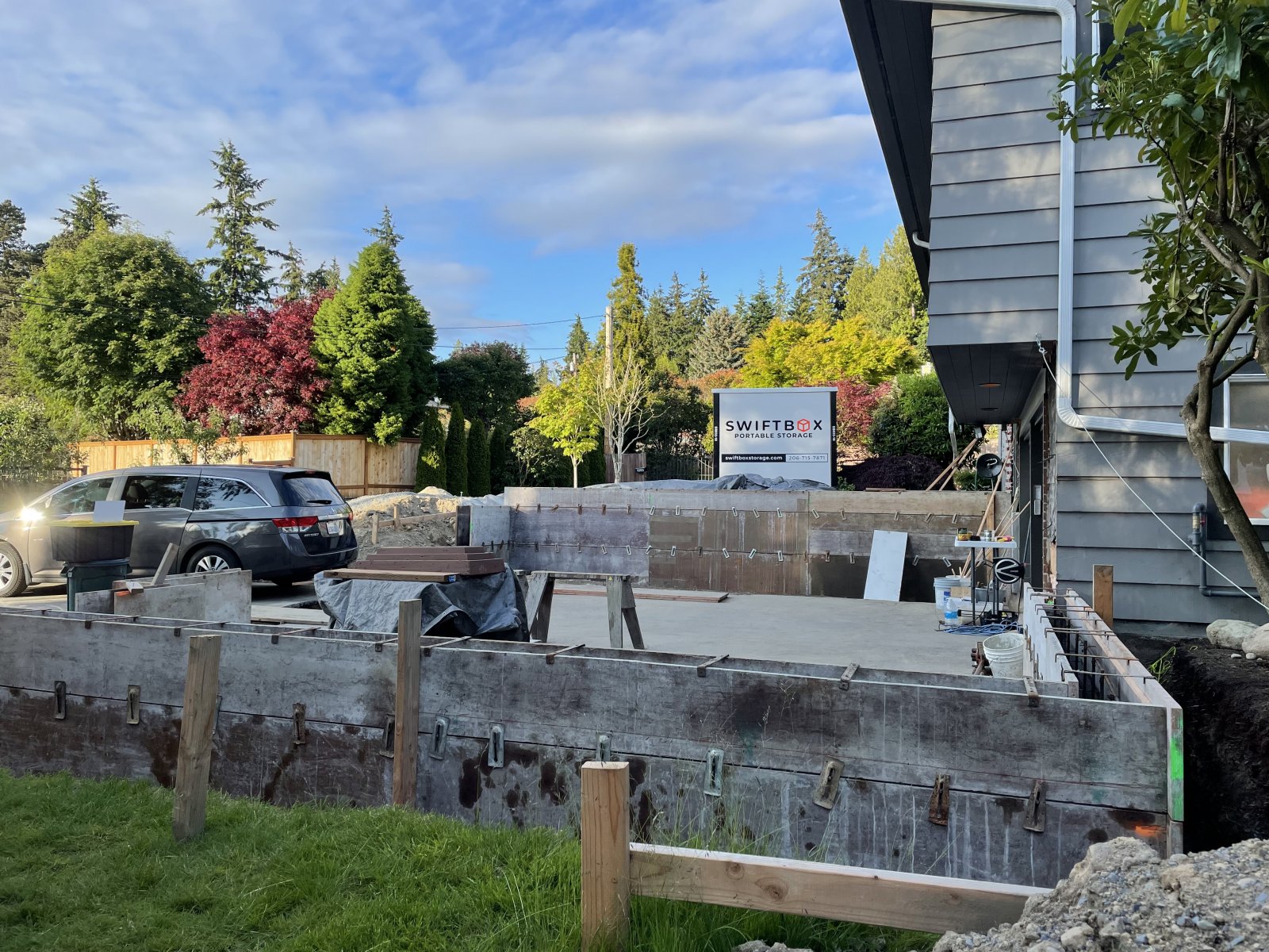

I don't see board formed concrete very often (ever, really) - except when one wants that as a finish. Old school (in a good way). ;)
It’s a little deceiving because the bottom boards are 4’ and 3’, but definitely not steel forms. My framer has had his business since 1981 and started in concrete. He took on the footings and walls.

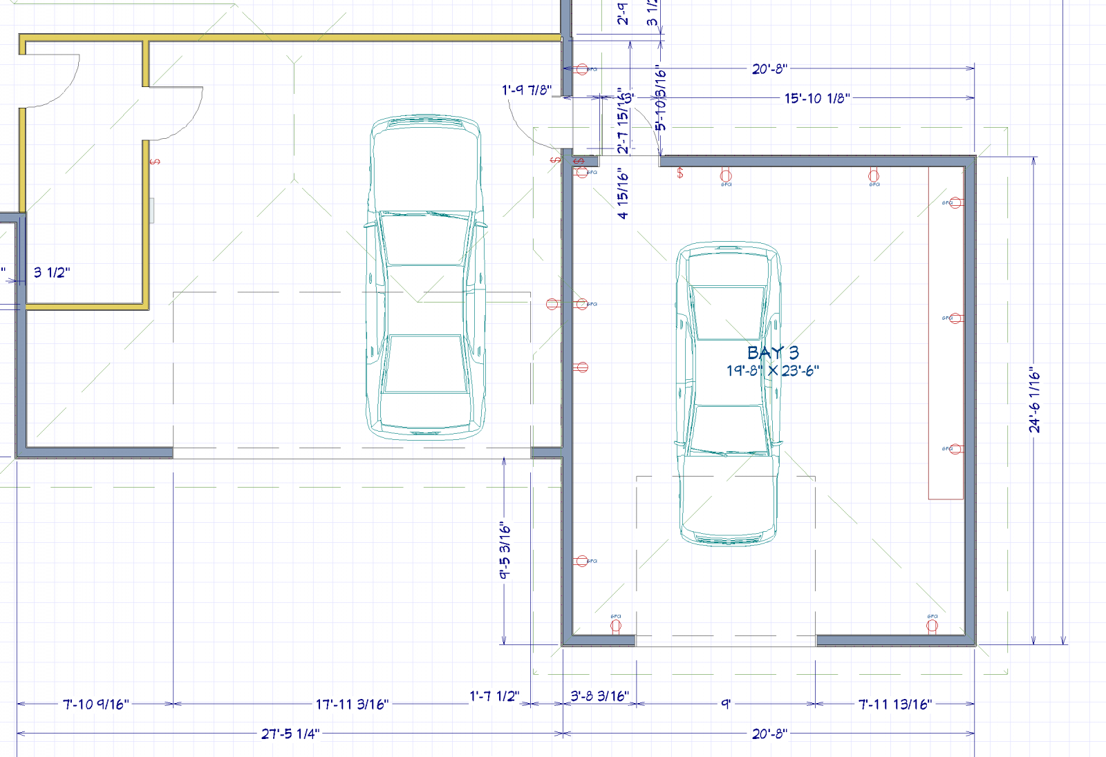

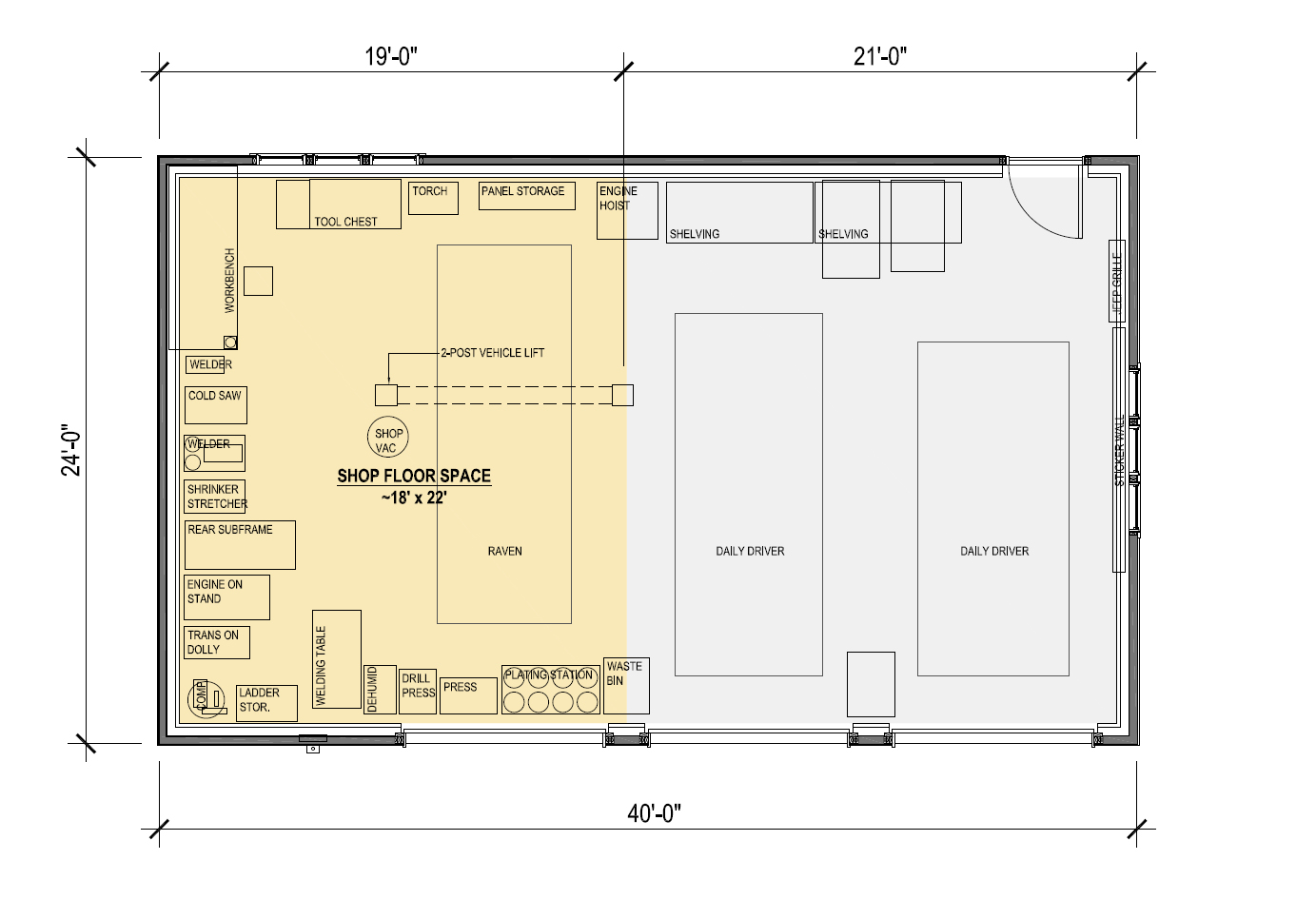

Not at all. I've attached a plan of Raven's Nest. As you'll see, almost half of our 24' x 40' structure is my workspace. The floorspace of the work area is approximately 18' x 22'. The equipment and storage is illustrated as well (including the proposed plating station). I think anyone ( @Markos ) would agree that there's not a lot of floor space to "work" in. More than some but less than others for sure.

Very nice. It looks like we are working with similar spaces. I have a tight two car garage that would be more comfortable if it didn't house the water heater and conditioner and have the laundry room carved out of it. I'm looking to add a third bay that's actually just a big bigger than your allotted working space. The ceiling height will be taller than the rest of our mid 80's single story home. I wanted to make it 30' deep, but we decided it would eat up too much of the back yard space.

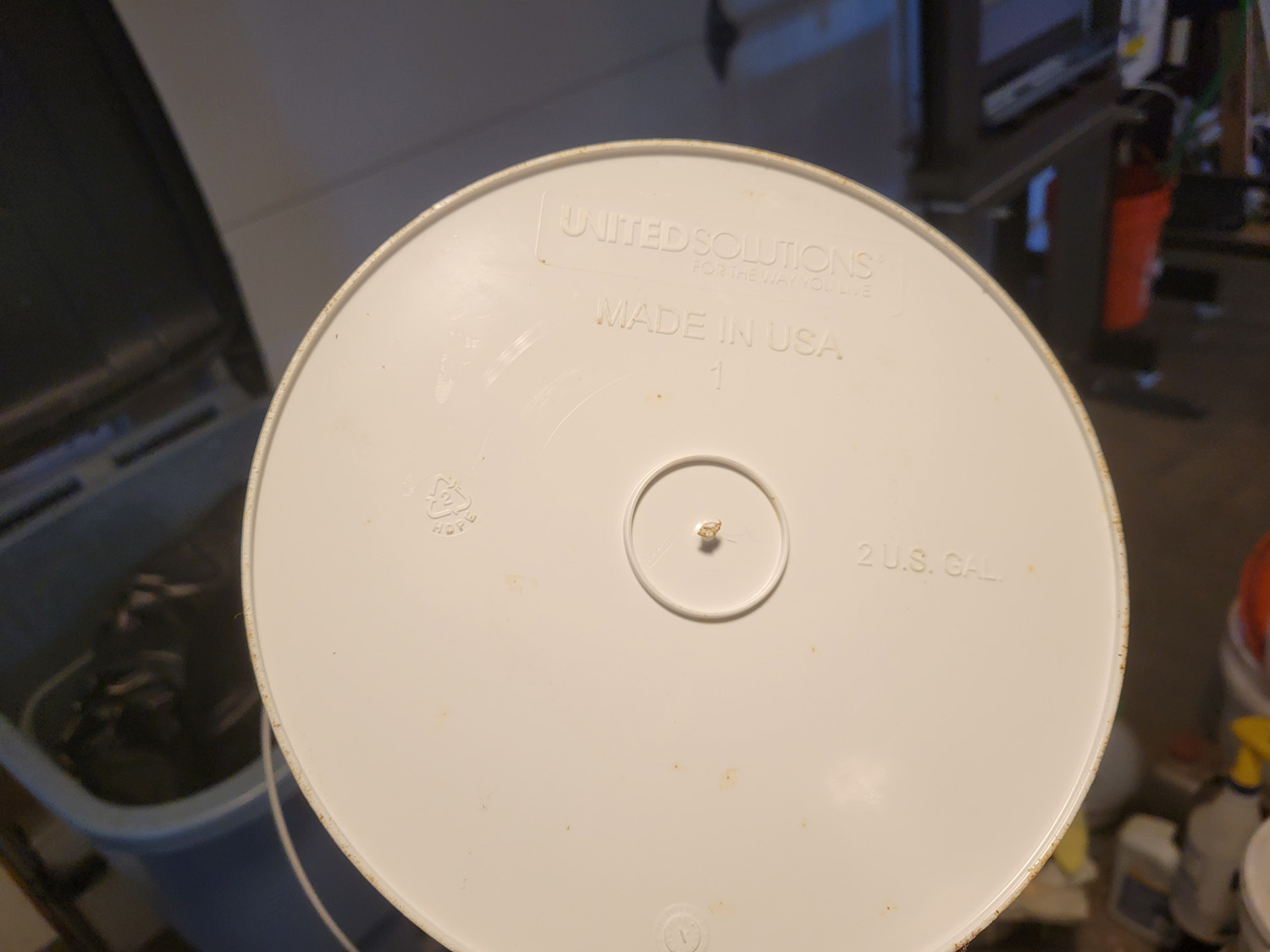

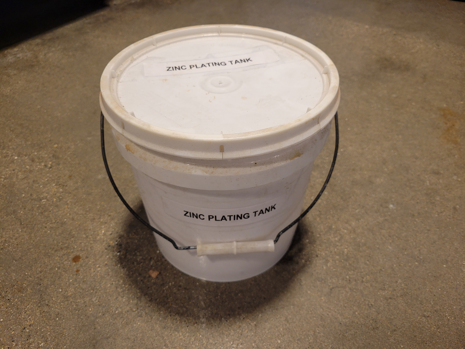

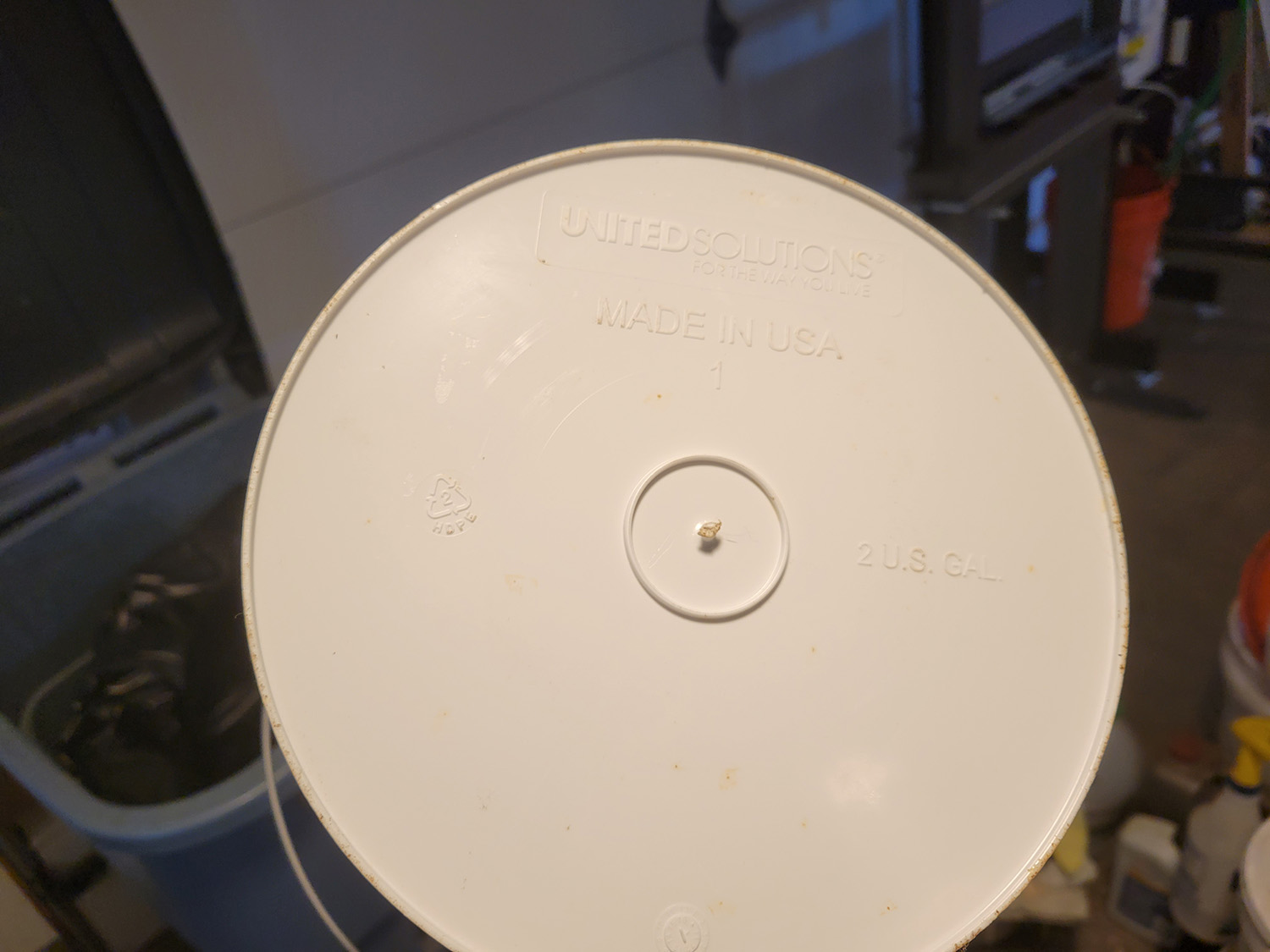

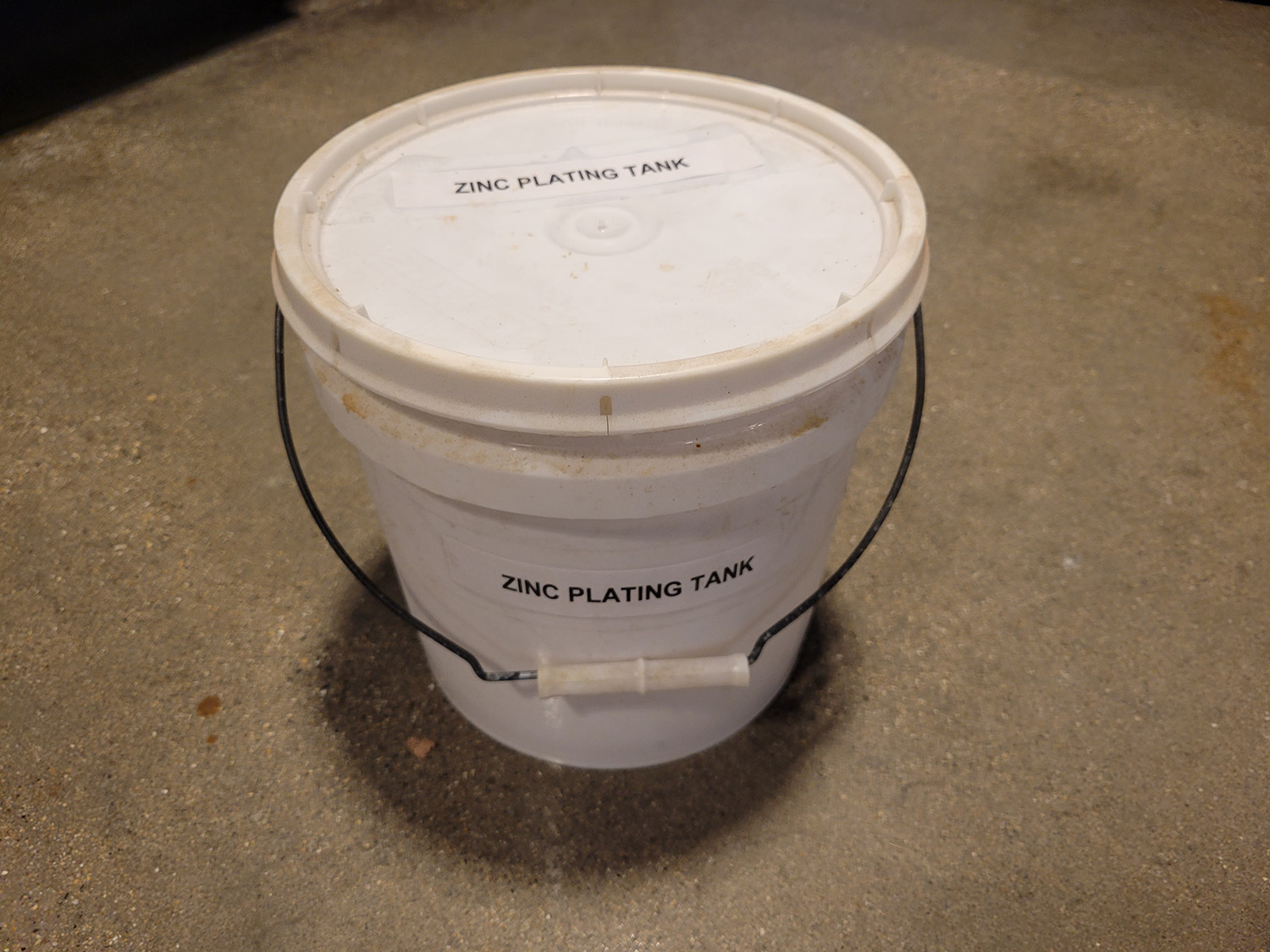

I have been plating my own parts with good results. Most of my system is based on Caswell, but there are a few tweaks. I have a 1.5 gallon system which lives in 2 gallon buckets. But I've had (3) buckets leak. These are nasty chemicals that can cause harm to my garage and/or those who hang out in it (me). All three leaks came from the exact same place - the 'belly button" at the bottom of the buckets. I have buckets from three different sources, and two of the three brands have leaked. I think it is only a matter of time before they all leak. I plan on setting each 2 gallon bucket within a second, larger bucket as a spill prevention technique. But I'd love to find better buckets - ones that would not leak at the belly button. I don't think it is the chemicals reacting with the plastic. Rather, I think the little nub pushes up on the plastic and eventually it cracks.
View attachment 143118View attachment 143119
Does anyone have any recommendations for "a better bucket"?
I had a look at the bottom of my grey pickle bucket and found it was made by Letica in 2018 and is still in great shape. Apparently model number 9548-4, but I can't be sure just what that number is. I did a quick search and Amazon has "premium" singles for an eye-watering price, but a batch of 6 for $16 each. Uline probably carries them, I found a link to a Technical sheet for some Letica buckets, but don't know if they are the same ones. It certainly seems like they do some rigorous testing.
They come in a range of colors. It's hard to say which color would be more durable. I'd go with black or gray myself. I didn't check to see if other sizes are available from Letica.
Interesting, and thank you for the info. I'd mentioned that someone else that is doing a lot of plating suggesting getting buckets from Lowes. When I type in Letica, a link to Lowes does come up. Interestingly, the Letica buckets are out of stock but cost less than the United Solutions buckets that I did buy/do have.

I am really jazzed about @halboyles laundry tub solution. This would make my life easier as I wouldn't have to crawl around on the floor to plate. The tub will automatically act as the emergency catchment system. I really believe that the crux of my leaks is the little plastic "nipple" that is pushed into the floor once the bucket has liquid in it. I feel this is a stress point (much like our rear shock towers) that causes a failure "eventually". Perhaps hanging the buckets in a "countertop" will alleviate that stress completely, and presumably transfer it to the entire rim of the bucket at the top.

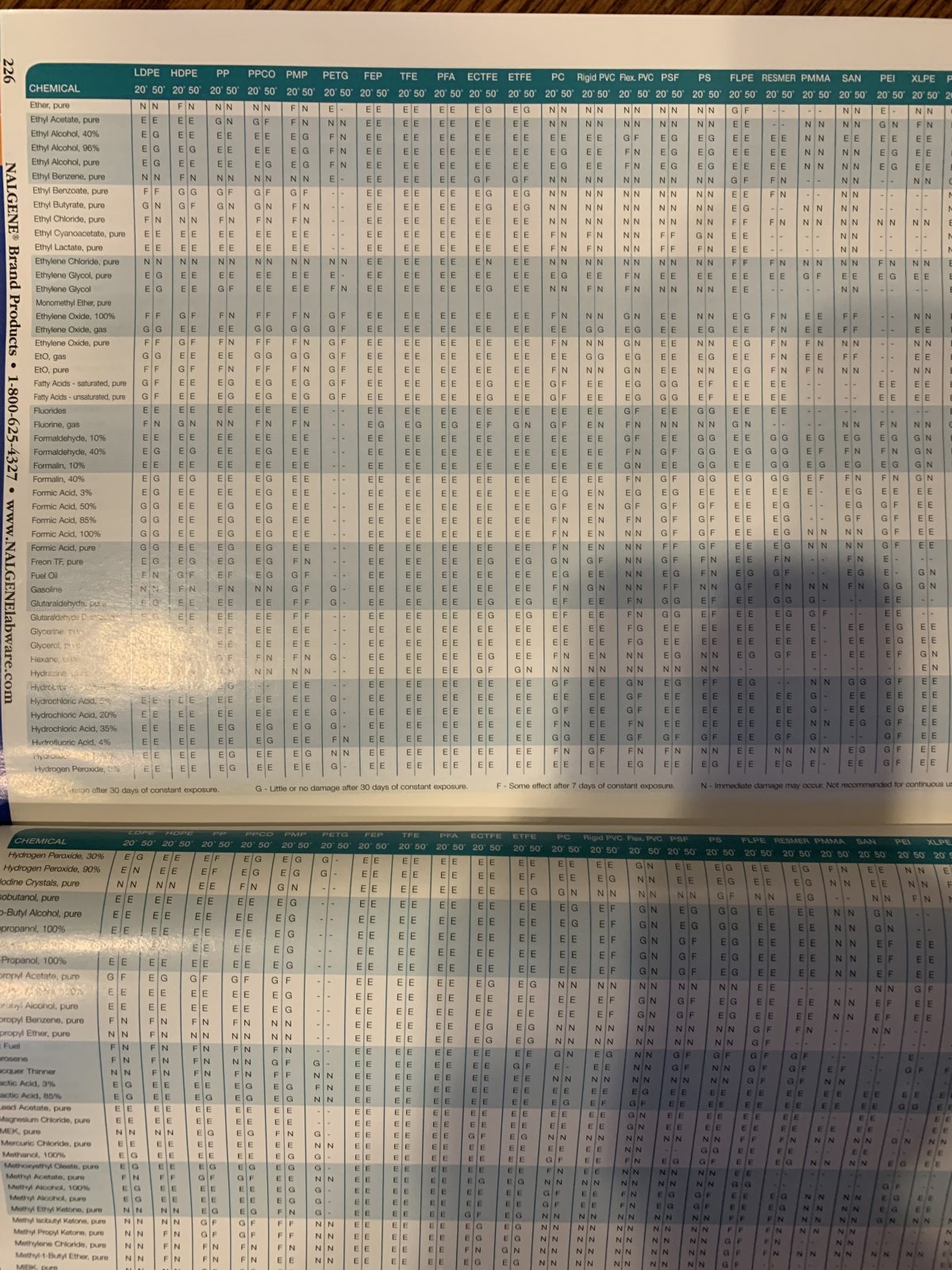

Spoiler alert #2 If you do not get to the end of this long response PLEASE YOU PROTECTIVE WARE. Glasses, Apron and gloves. This is a good chart
ACID DIP:
Hydrochloric Acid approximately 5% solution LDPE, HDPE, PP,PC, PS- Basically all the common plastics
ZINC PLATING BATH:
Zinc chloride 30% to 50% My chart only has 10% all of the above again
YELLOW CHROMATE:
Chromium Trioxide (trivalent chromium) < 17% Not in my table
ACID DIP:
Hydrochloric Acid approximately 5% solution Good with all common plasics except PETG
ZINC PLATING BATH:
Zinc chloride 30% to 50% See above
YELLOW CHROMATE:
Sodium dichromate < 17% My cart does not have this
Nitric acid < 14% LDPE
Sulfuric acid <10% All the common plastics
BLUE CHROMATE (clear finish):
Nitric acid < 40% LDPE is excellent at 20% but drops to good at 50% and drops to Fair at 50% a5 50 degrees celsius
Nitric acid, chromate salts 14% to 17% See above
Sulfuric acid 1% to 2% See above
Ammonium Bifluoride 0.5% to 1.5% Not on my chart
BLACK CHROMATE:
Chromate trioxide < 29% not on my chart
Sulfuric acid < 15% See above
Sodium dichromate < 17% All plastics are fine
Sulfuric acid <10% See above
Nitric acid < 40% see above
Sulfuric acid 1% to 2% see above
Ammonium Bifluoride 0.5% to 1.5% not on my chart
BLACK CHROMATE:
Chromate trioxide < 29% Not on my chart
Here is the chart I used if you want to get more info
ALSO WEAR protective eyewear and the correct gloves. These chemicals are no joke and if you do not have the correct gloves chemicals can burn or soak into your blood stream
My company also sells glove and many glove compatibly charts online
