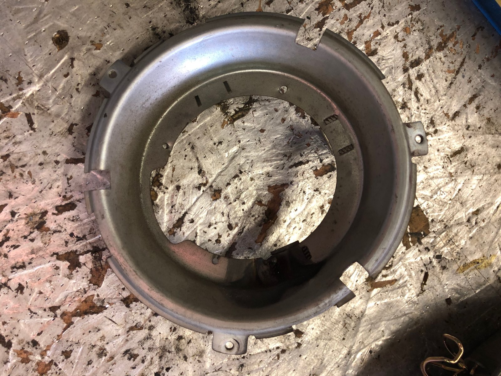

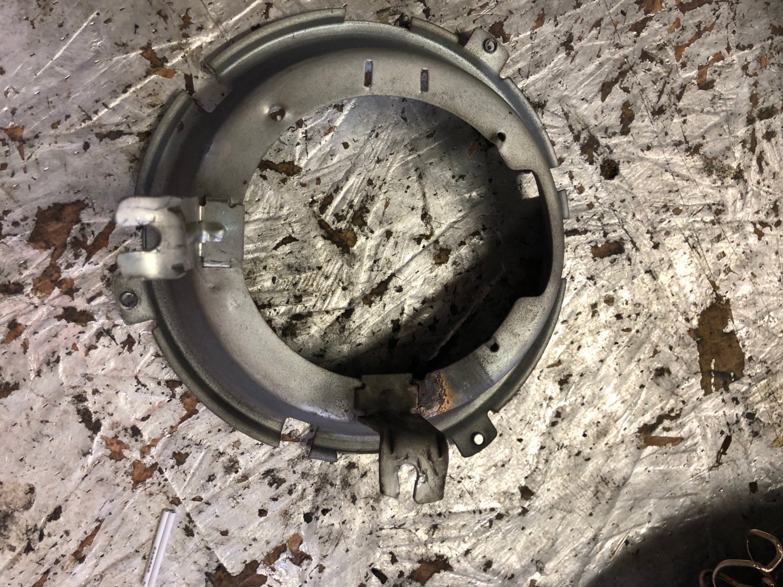

I am looking for one of the head light metal housing as per the picture below..

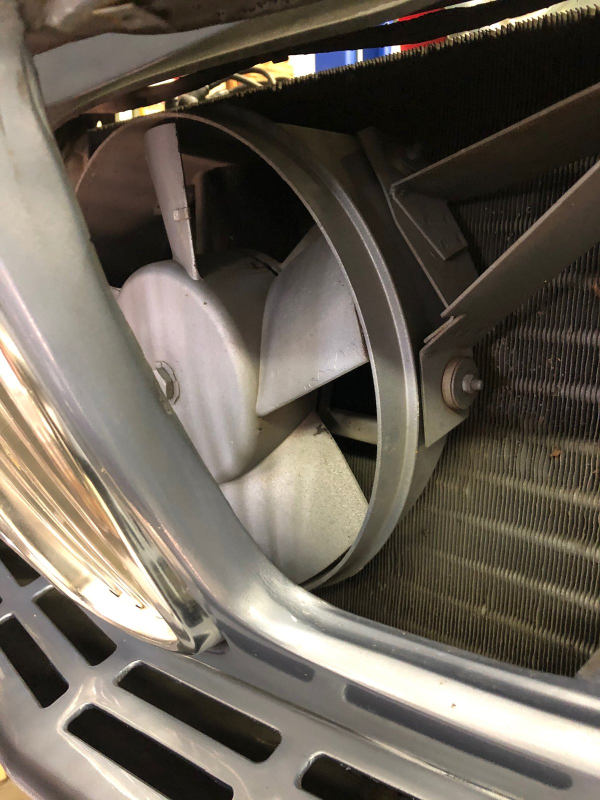

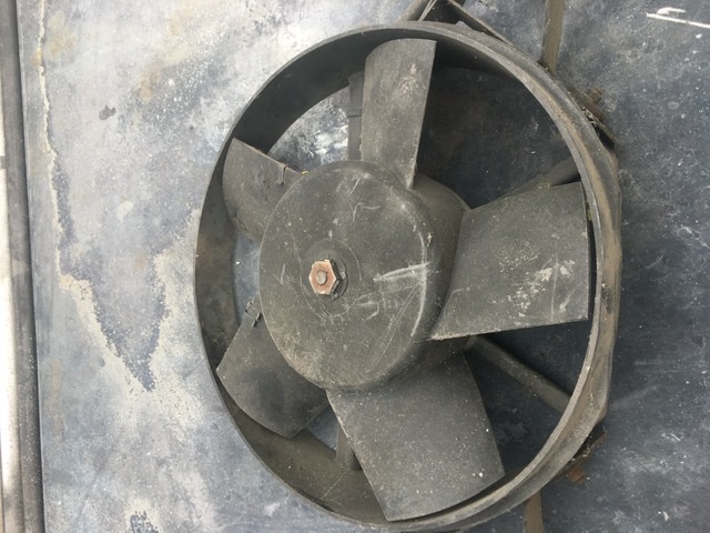

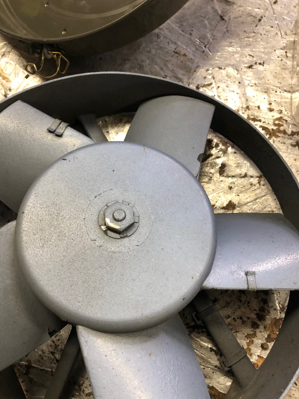

Also looking for An Ac radiator fan.. mine is a little noisy..i could have it rebuilt.. the challenge is getting the plastic fan loose from the motor...took the nut out but can't seem to get the motor loose from the fan...worried about braking the plastic fan.. any tricks?Are this fan motors available new? are plastic fans available new?
all help appreciated...
After developing a leak on the cooling radiator and a leak on one of the ac hoses.. decided to check the cooling fan in front and yes it is probably on it's way out (seems to be making a bit of a trashing sound when rotated...

it is doable, take alook:

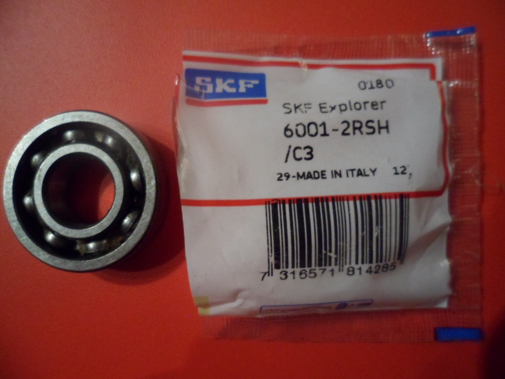

The bearing wears and can be replaced. Did this job a few years ago. Once I identified the correct, original bearing, it was just a case of taking apart, cleaning, inserting new bearing. It then operated effectively and is much quieter.

I am in need of a complete assembly with HL wiper provisions. I have a total of six bu, so if you have what I need I would be happy to trade. The buckets with HL wiper provisions have three holes in the frame between the high and low bucket.

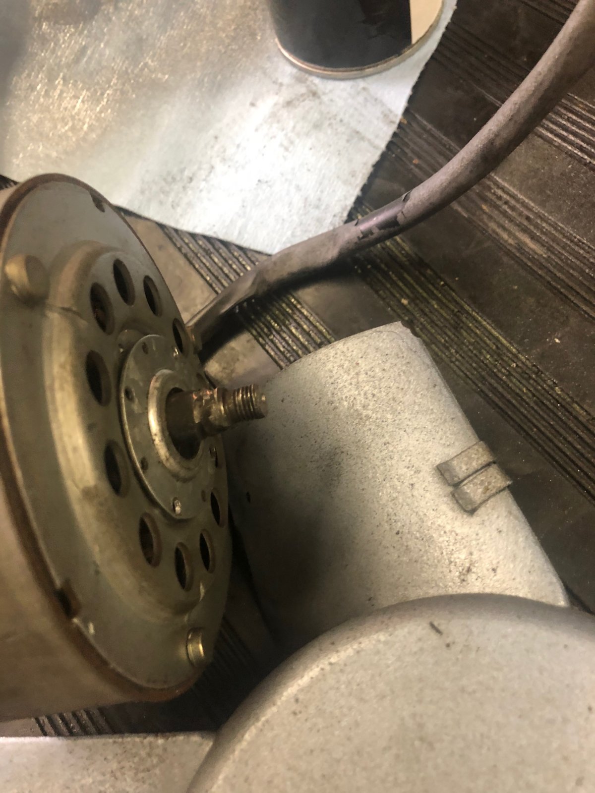

Hi

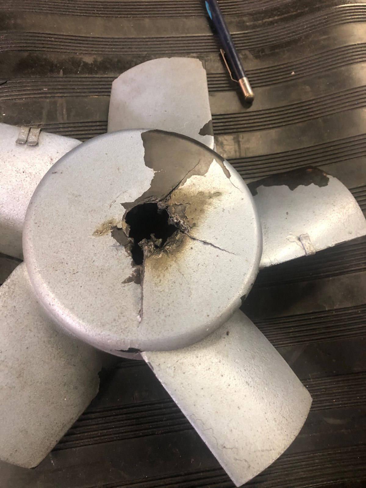

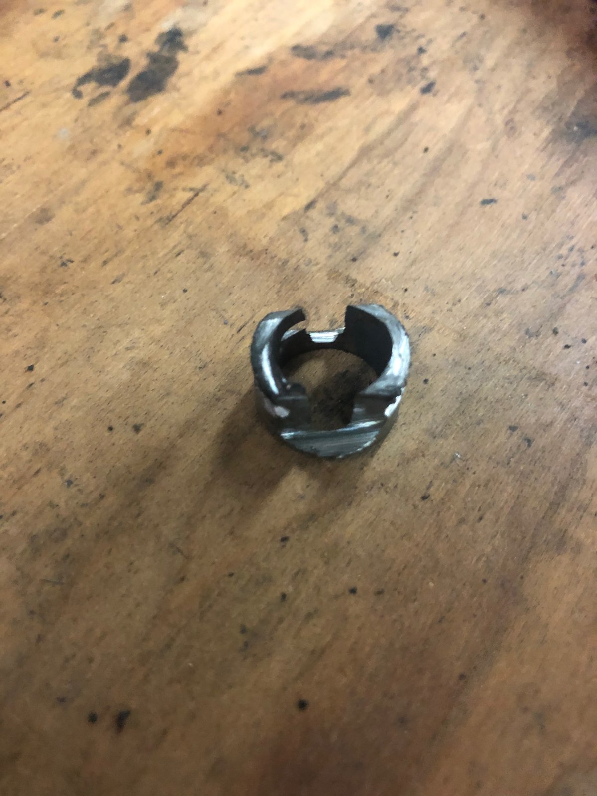

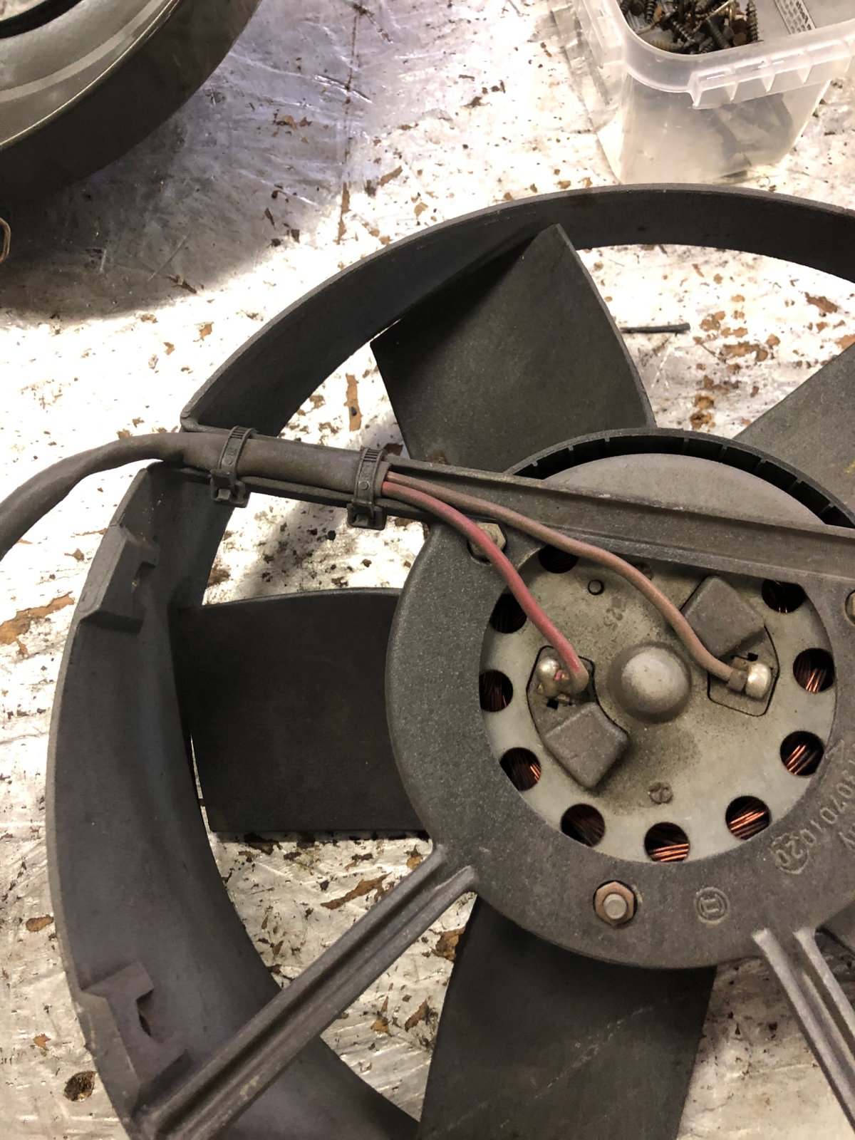

surgery took place but it did not really go as expected. The blower fan was totally stuck to the blower motor.. no matter how much w40 and light pressure from a press..nothing moved..until it all went south..the fan cracked..
So i was able to extract the motor from the fan..then i understood that there would not have been anyway to separate the center bushing of the fan from the shaft motor(rusted on the shaft.. I had to bring and cut slowly to get the metal bushing away from the motor shaft..
The bearing was indeed gone..now i will need a new plastic fan or a are assembly to work with..
so i am once more looking for an evaporator fan for my E9 as pictured(i have all the hardware .. just looking for a good fan or one that i can sacrifice to get the plastic fan...
H E L P..

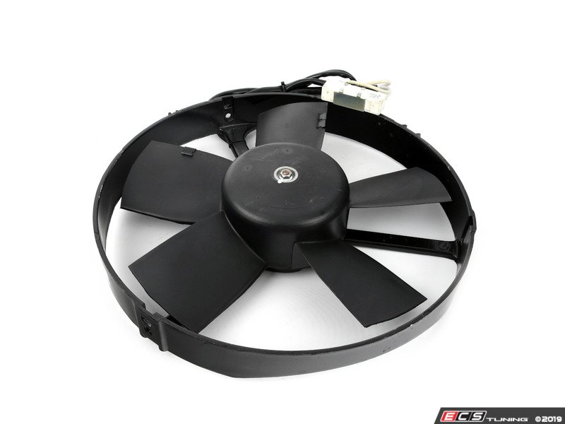

looking for a replacement i found this.. could i just install this new motor and fan on the existing bracket? has anyone experienced doing this?
