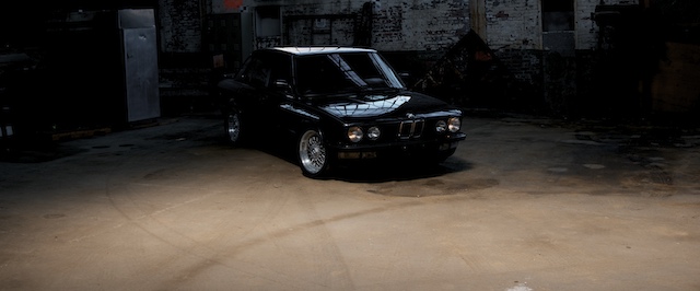

I have the 7" Euro lights on my E28 M5 and they have city lights.
I found some Hella lenses for the coupe and now have city lights in the coupe as well. And yes they are in the outboard lenses and come on with the parking lights. Idea being if you live in a bright city with lots of street lights then you would not need the full head light illumination. Not sure this worked anywhere but it does look cool.
I also have the clear turn lenses which works well on a dark color with chrome. No yellow lenses to be seen.
And yes I'm going to go change my profile pix to show that.
