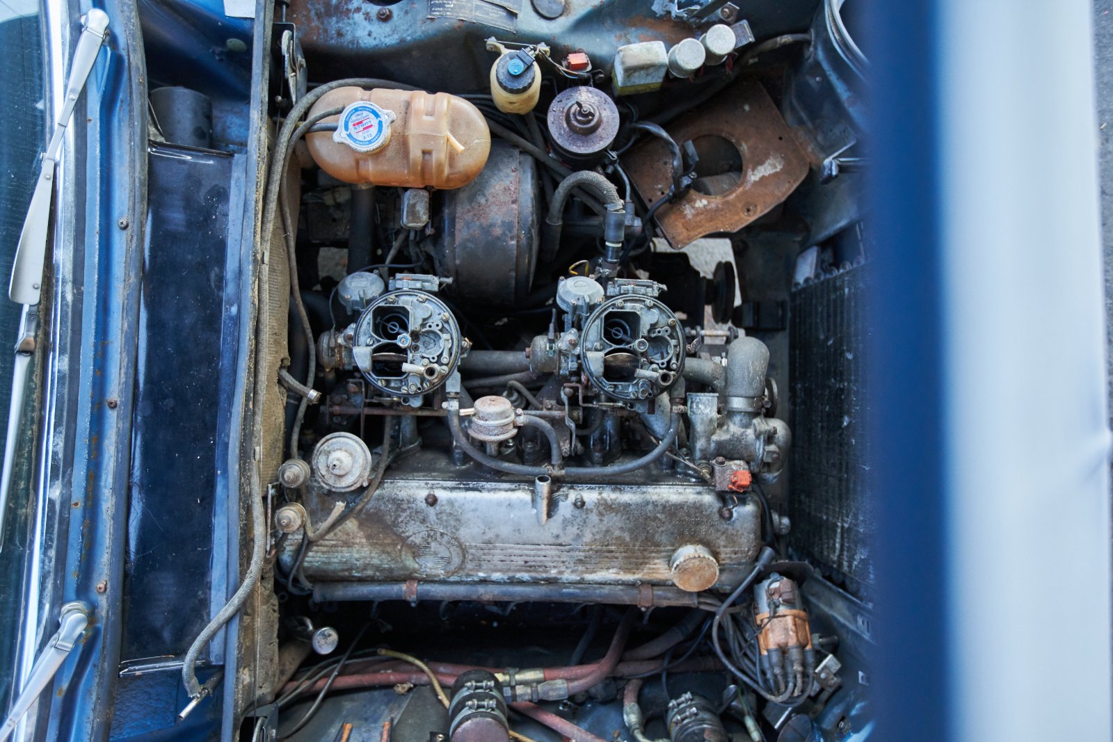

I'm glad we're somewhat anonymous here, because I'm embarrassed about the decisions I've made since buying my Bavaria (vin 3134389, so maybe early 1973). Bought it non-running from a family member of the original owner. All original, save the replacement rad tank. I've posted about this car before, having had a couple mechanics swap out the dead carb'ed engine with an L-Jet engine from a late 70's e23. Long story short, I'm pulling the entire FI system off and will be mounting a pair of Weber 32/36 DGV 5A's. I want to order a stock, mechanical Pierburg but I've heard rumblings about them being built under license by other manufacturers (out of The Netherlands, Italy).
I'm also not a mechanic and have over the years convinced myself I knew more than I did. Nothing beats confronting the truth (Dunning-Kreuger)!
So do I plop for the Pierburg? I also rebuilt the Webers after watching what I think are quality step-by-step vids by Cars, Bikes, and Coffee (YouTube), but I *think* I'll have to replace the emulsion tubes, main jets, and idle jets. I appreciate any help and will post progress pics as things... progress.

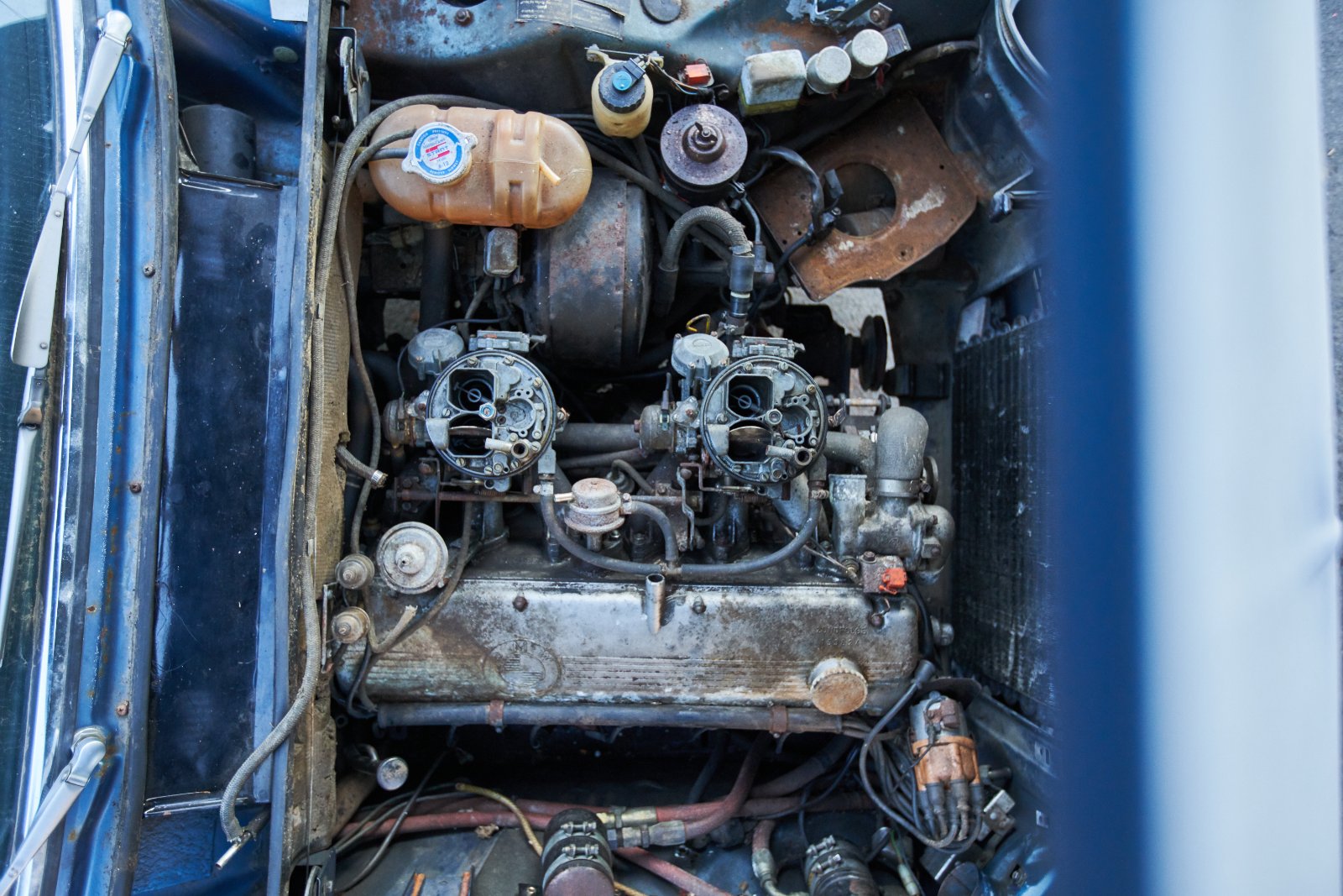

(Original engine pictured)

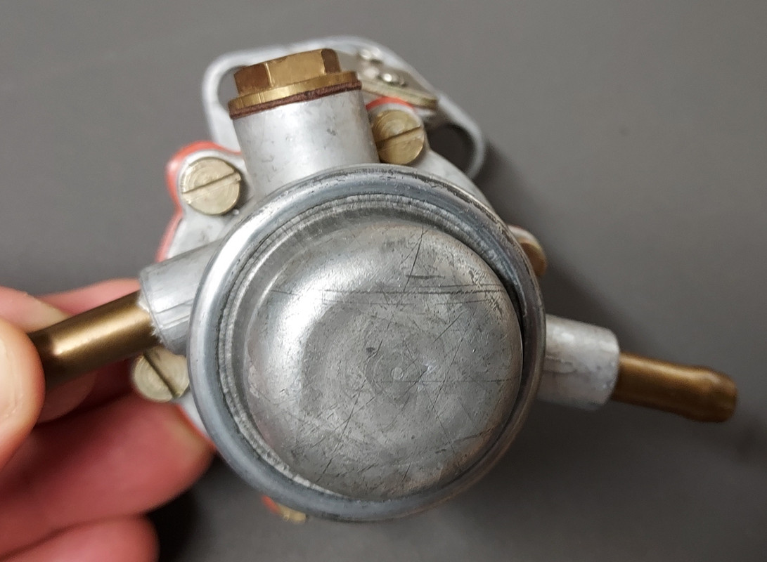

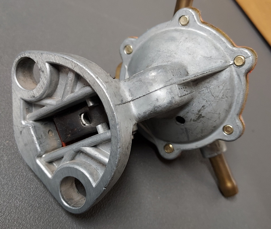

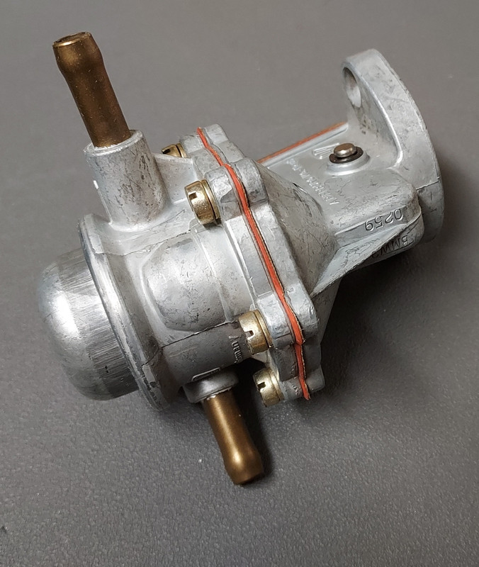

Usual parts suppliers, mostly you will get a faux pierburg made by an Italian company with the brand deleted by milling the logo out from the pump body
Up to three types of these pumps, maybe four
The faux pierburg
Unless you want to stay original, I would put a block off plate where the pump goes and stick in an electric pump with a roll over shut off valve If you stay with a manual pump, make sure you get the appropriate push rod.
Thanks, Rick
The faux pierburg

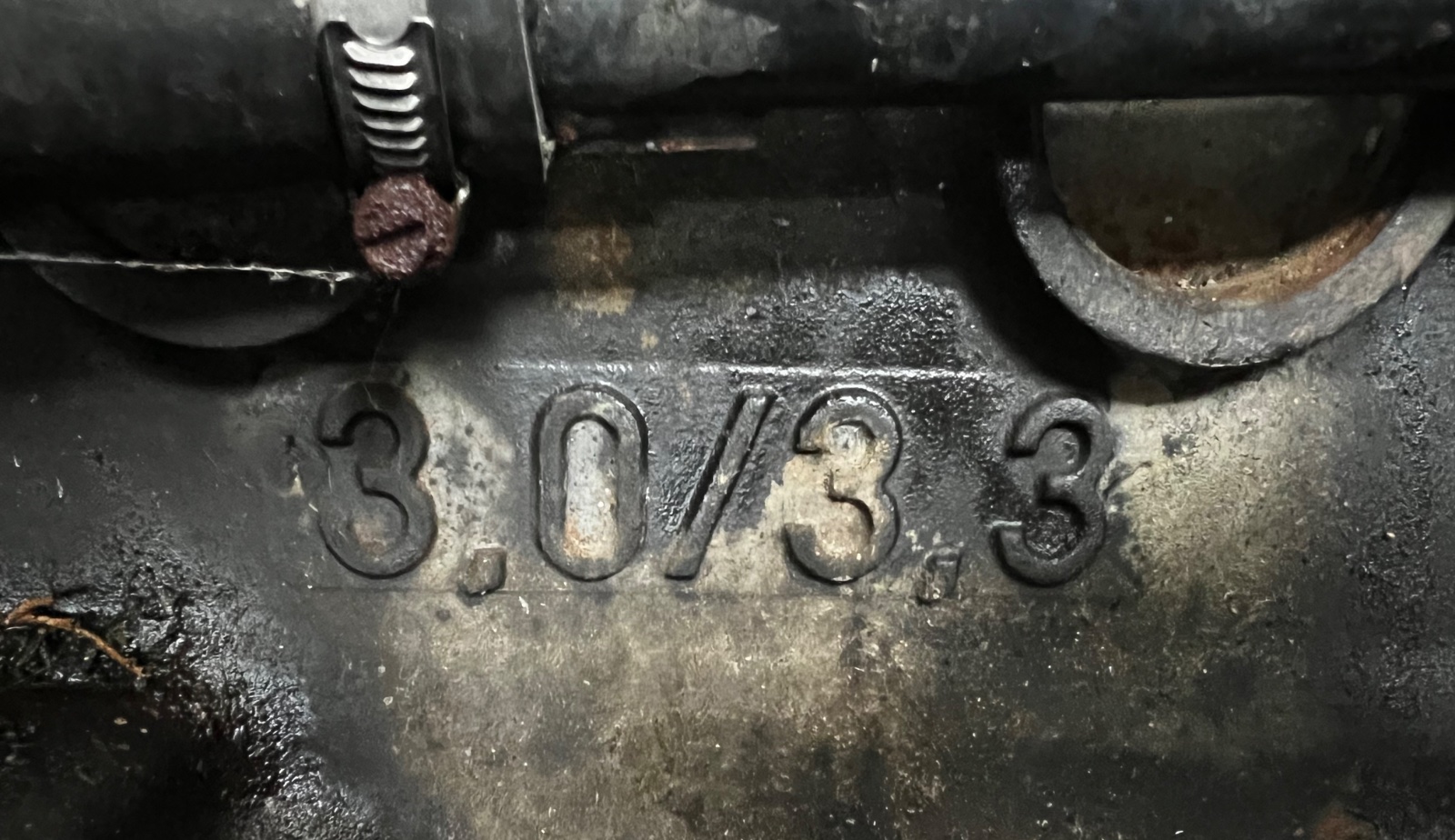

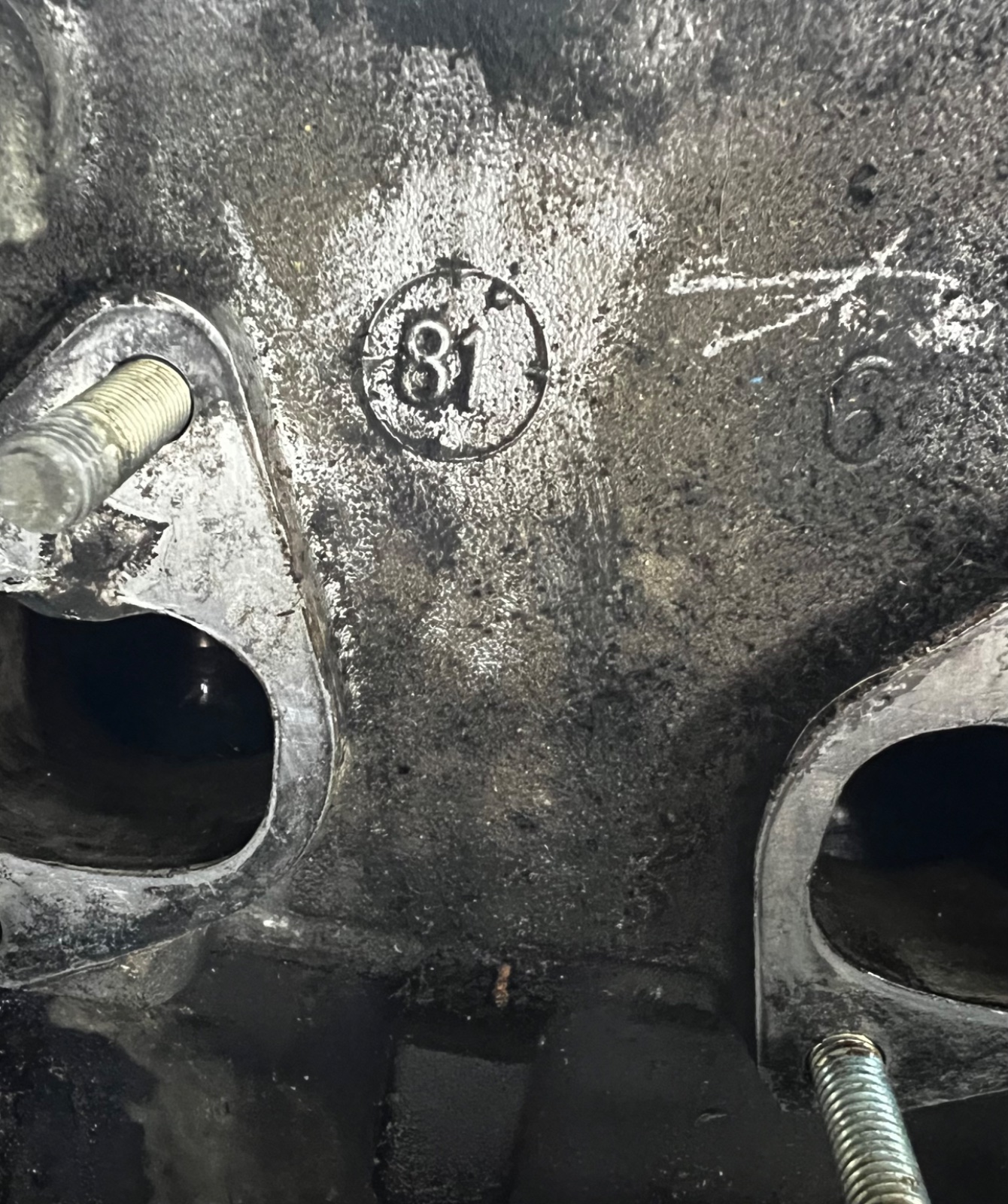

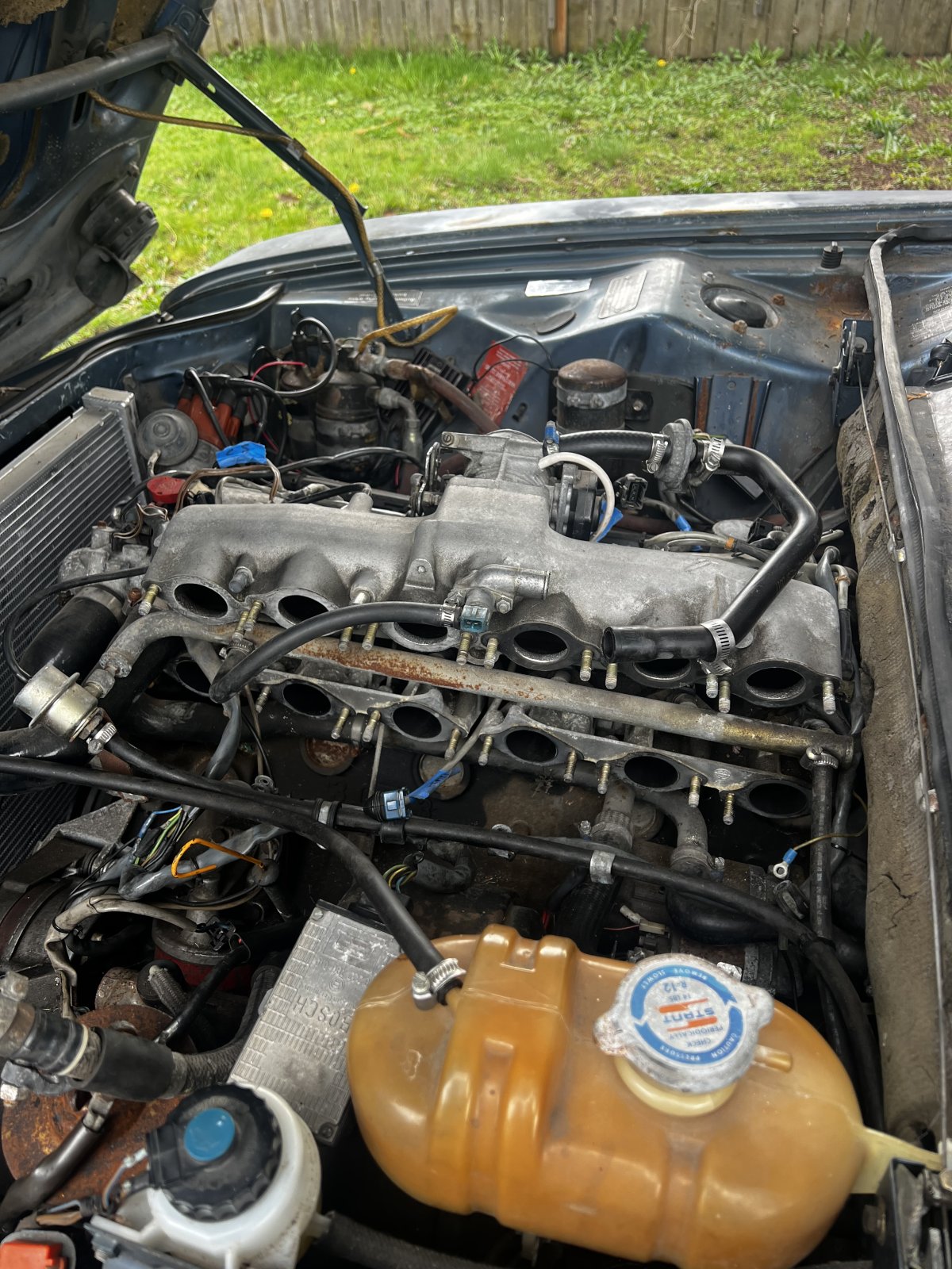

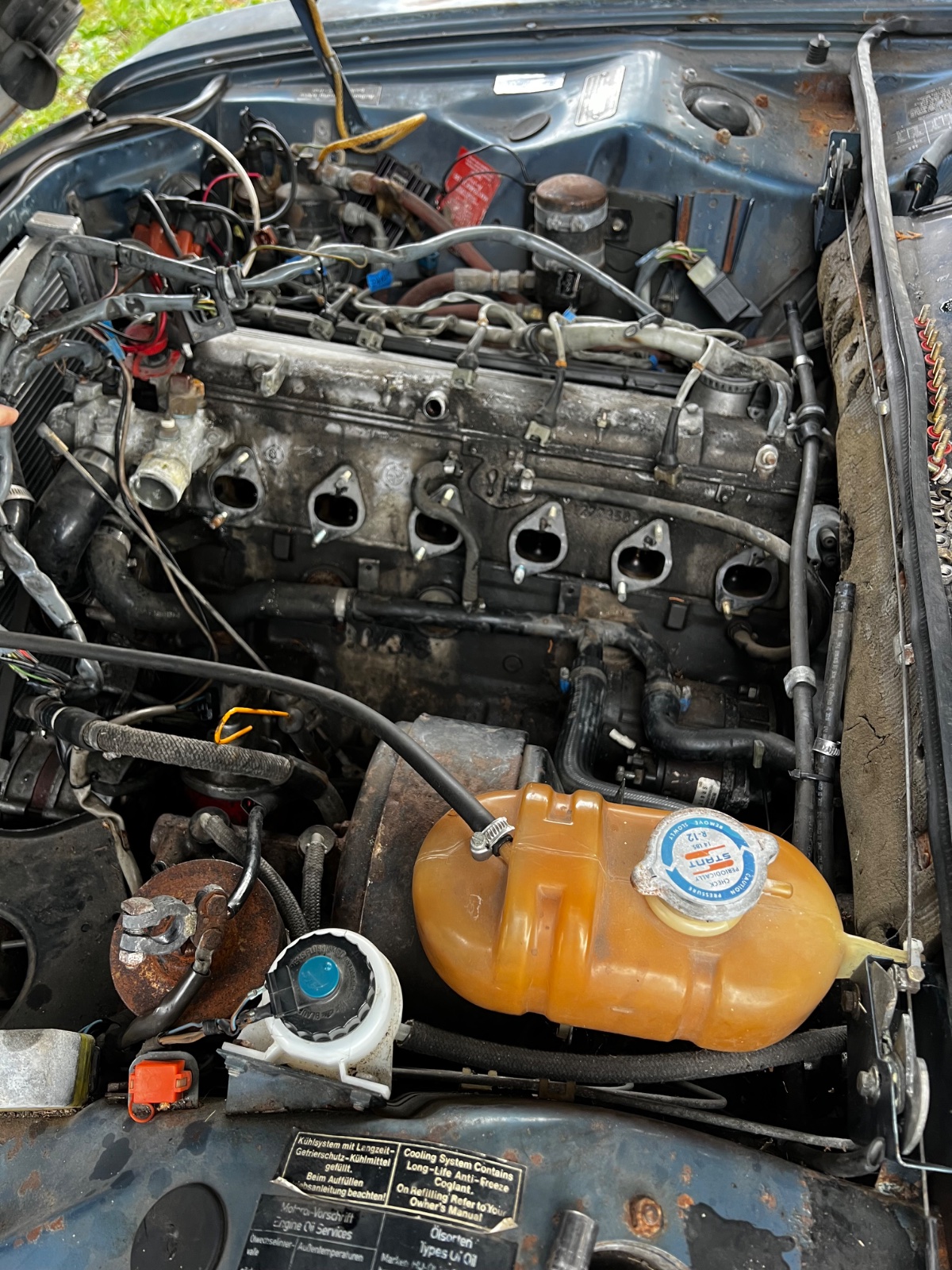

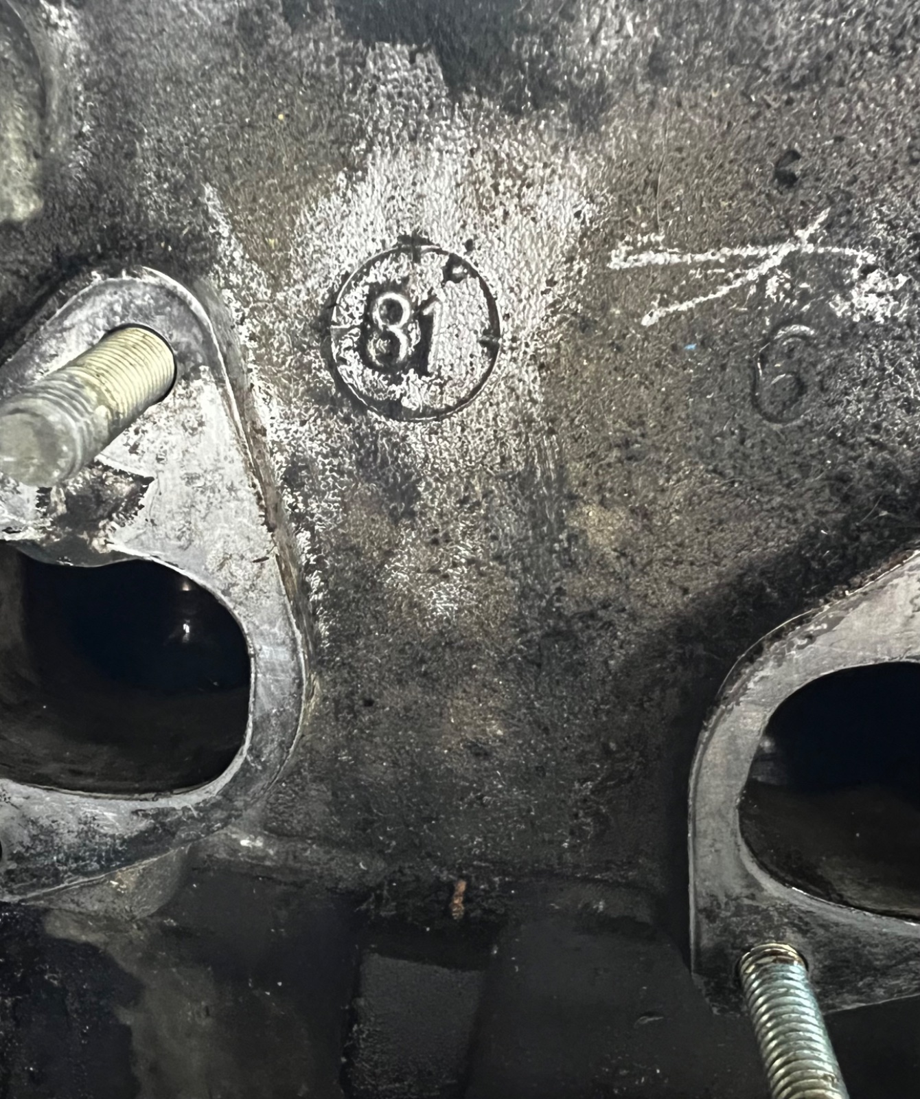

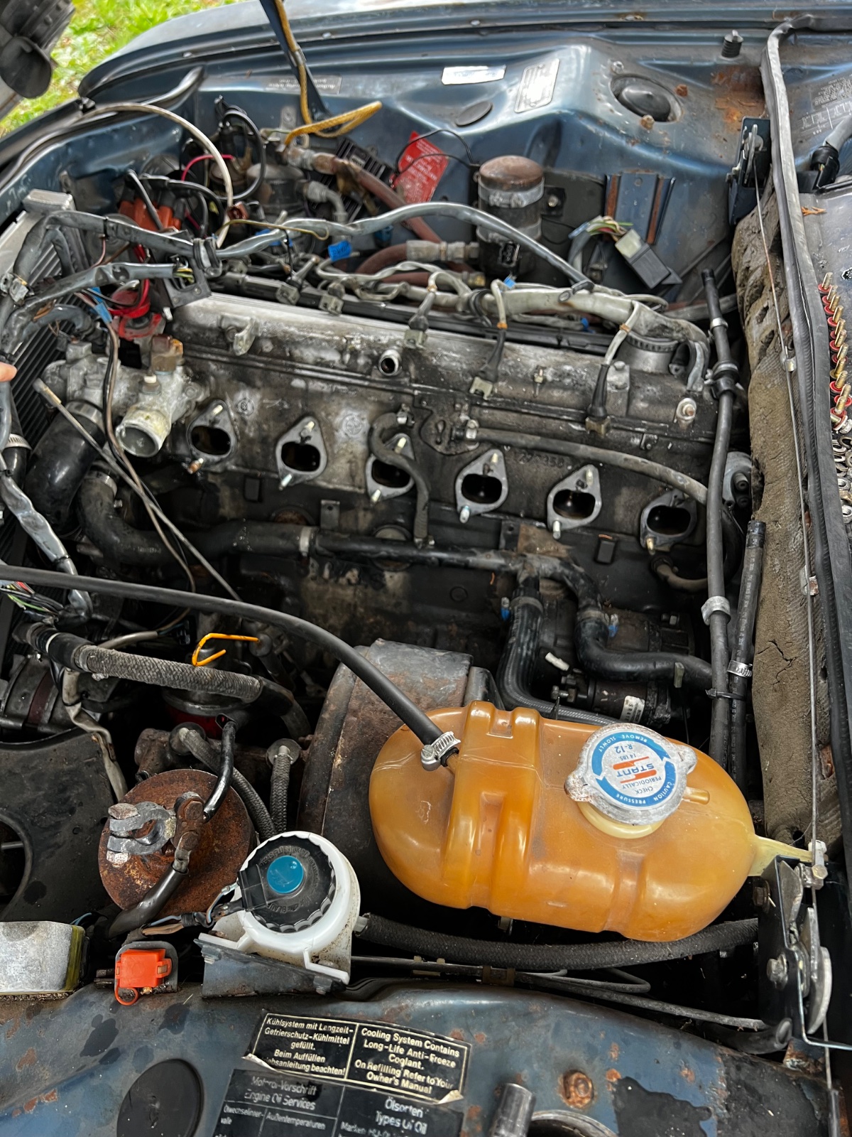

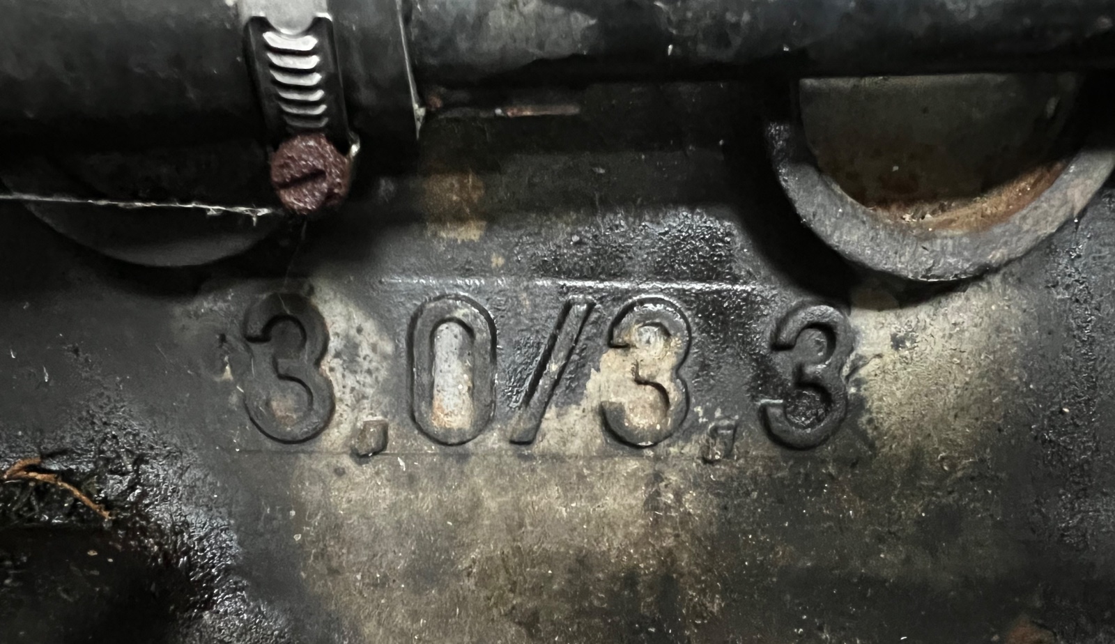

I’m in it now. The head is from an ‘81 engine, but I was told the bottom end and L-Jet were pulled from a late ‘70’s e23.
I think it would be difficult to put a mechanical pump on that FI head.
Yes, I was just about to post exactly this same thing. I suggest an electric pierburg pump, which is what I have been running in my car for several years now: https://e9coupe.com/forum/threads/adding-a-electric-fuel-pump-suggestions.42221/post-369474
