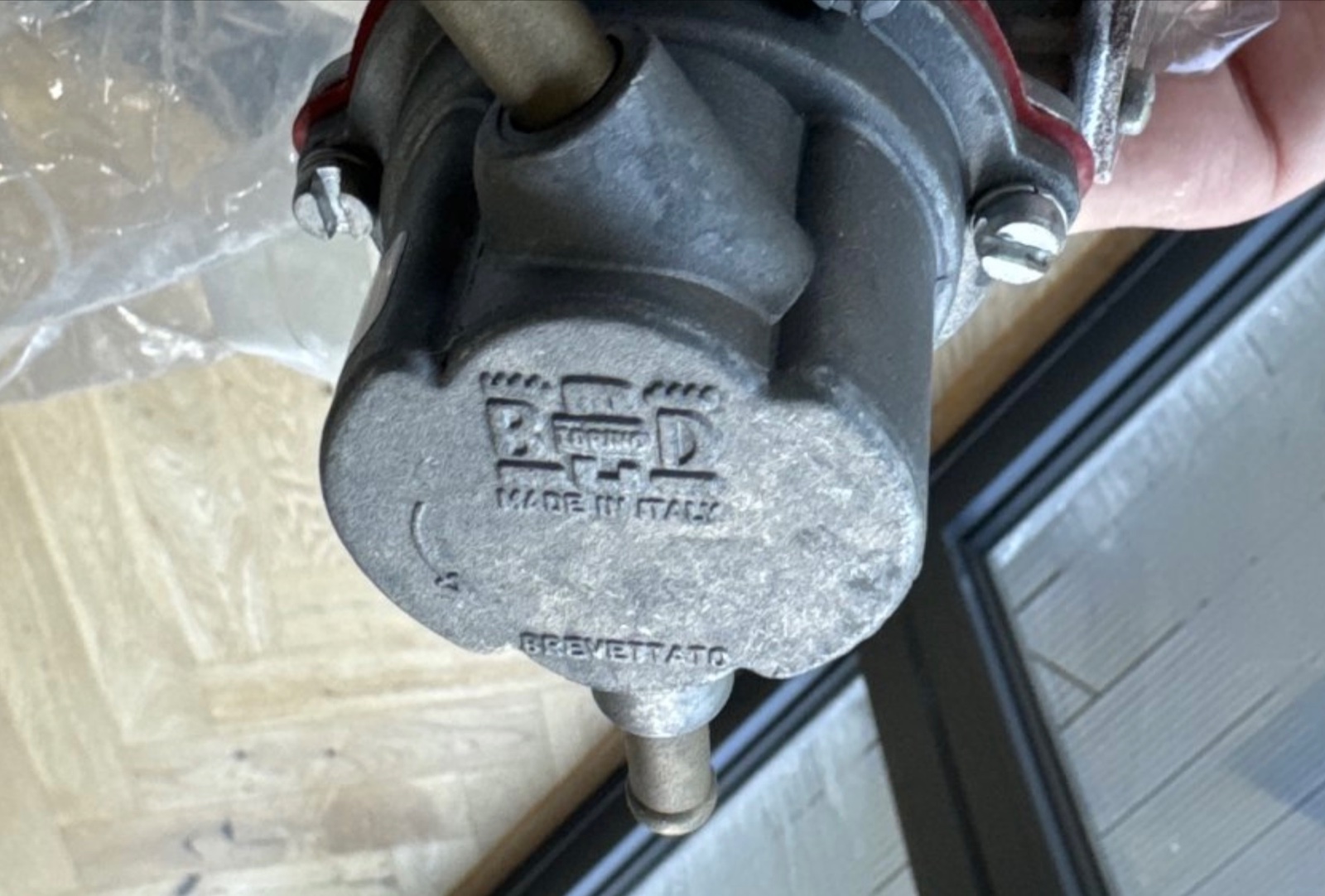

The pump I referenced is the correct low pressure pump for Weber carbs. I've been running this pump for years now. My pump is attached to the rear subframe using rubber isolation mounts, toward the outside near the location where the rear pushrod and subframe bushing attach to the subframe. It is very quiet.Thanks for all the input, everyone. I’ll have to do some thinking. The FI head already has the old pump port blocked off, which is nice but not really a big deal. If I can isolate the sound I wouldn’t mind an electric pump. Just want to make sure it’s able to have the right (low) psi.
