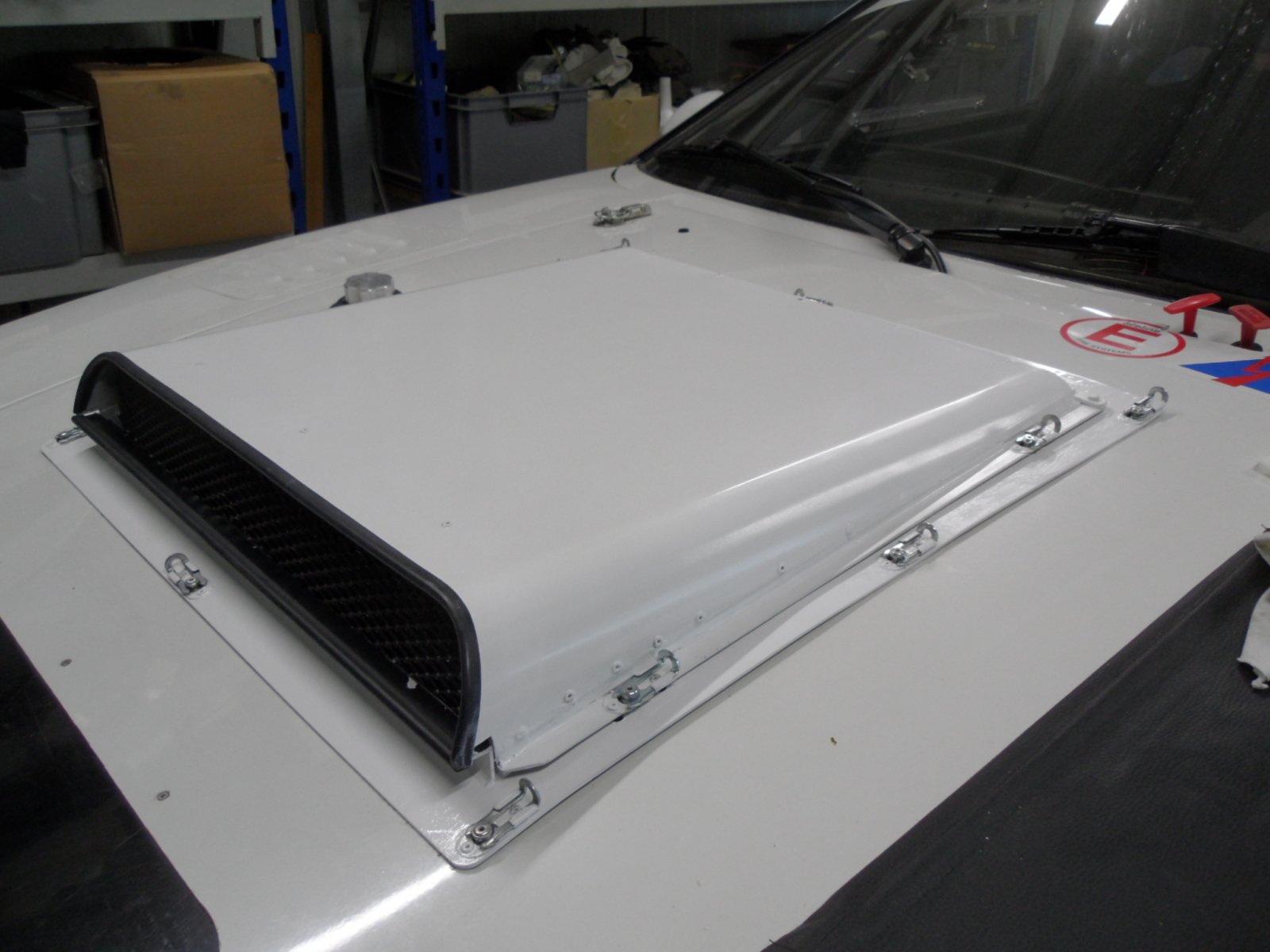

mockup with the nose to measure the needed height for the alu scoops to cover the air filters.

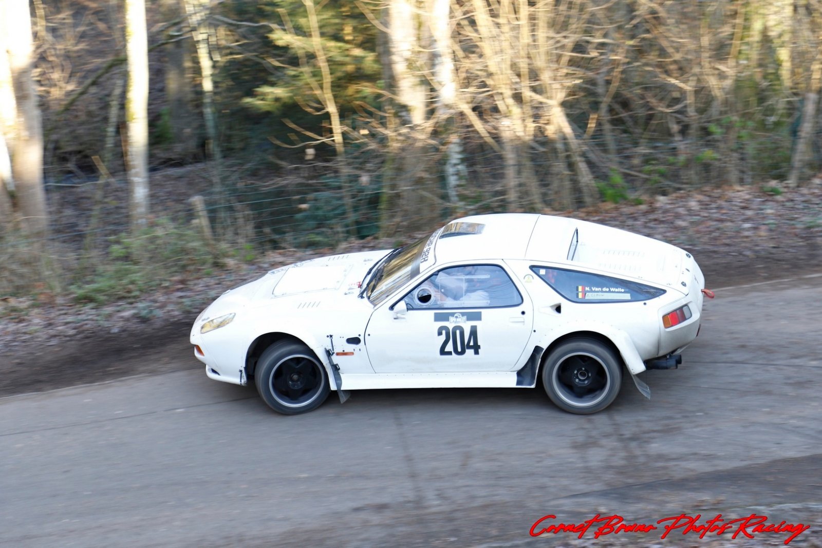

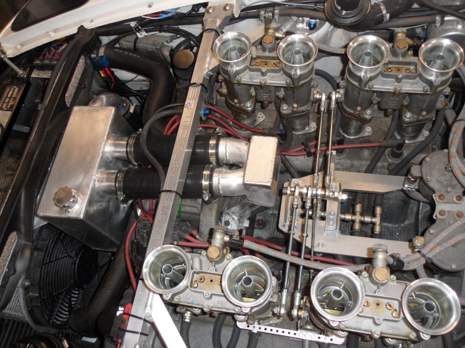

Already participated 2 rallies in the Belgian Rally Championship , without much succes, but fun .... Having problems with fouled plugs i concentraded me to long on the Webers IDA48 jetting .... while we now think the oem ignition is to weak. Changed it to a modern module and seems a lot better... problem is the car isn't street legal , so it's not that evident to test it a 100 miles...... Looking forward for the 2025 season !
it was indeed a weak ignition box that ruined the plugs.... with a "modern" box now it stayed running fine but AFR's not constant good. Played with jets during rally service but no real solution. Thinking further about the emulsion tubes etc... i think i found my big mistake...

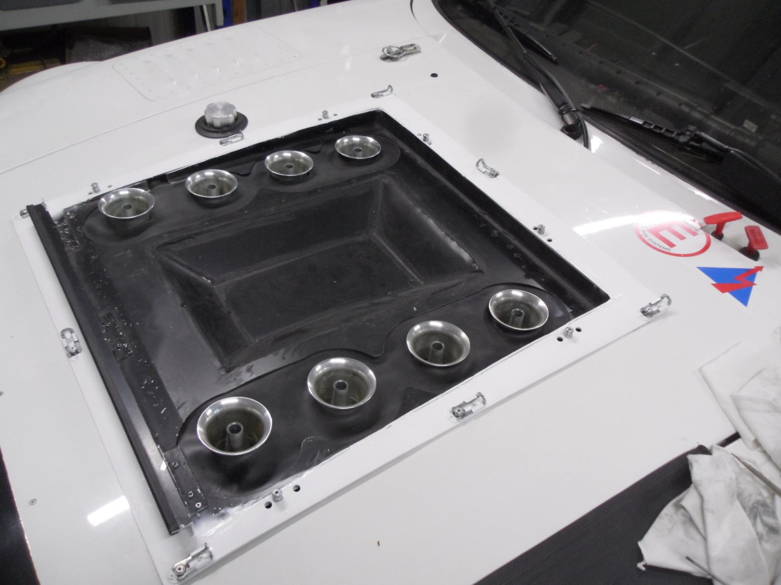

The fuel bowl vents and air correctors are under the hood in the engine bay , not in the "ram" air in the airbox. That can't be good , so i made flanges/tubes bolted on the "vent " well and protruding through the hood rubber into the airbox so they see the same absolute pressure . Hope this give me more constant AFR's now !
How it was :
Barry , not tested yet :rolleyes: next week ....

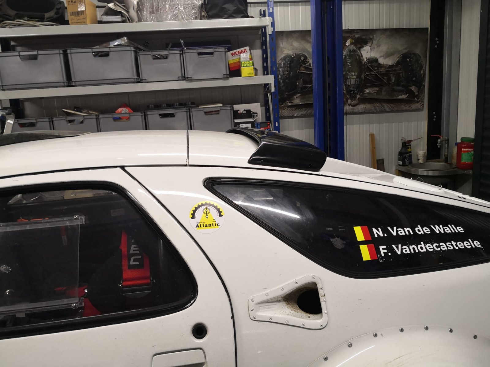

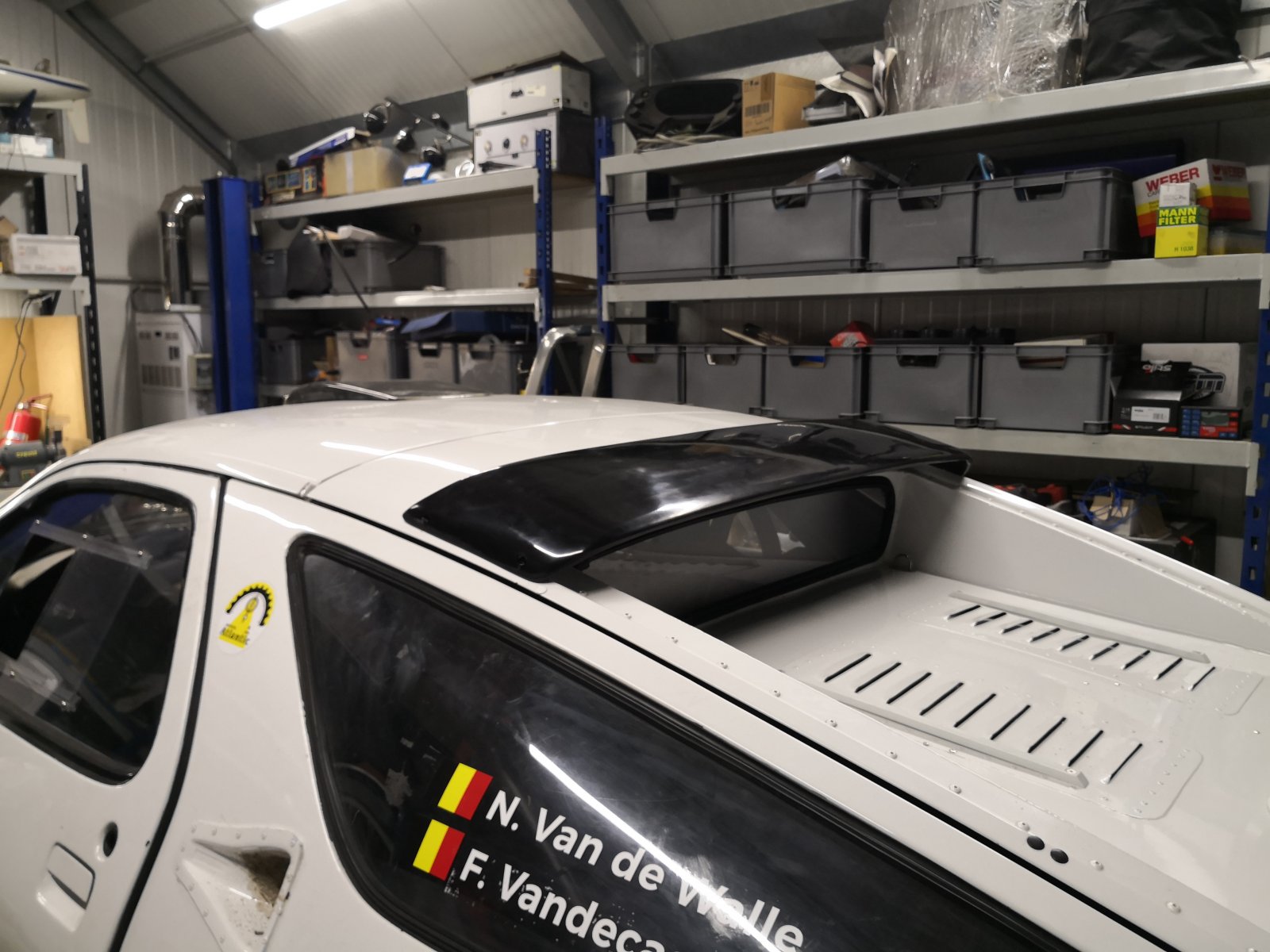

Began mounting a roof spoiler and design supports for rear deck spoiler.... roof done, copy of the '80's Strosek 928 tuner.
almost ready for the next rally at 21 Februari. Will be a great ( long ) test for the carb's jetting now with equal absolute pressure to the bowl vents and air correctors. Can't just do it here random with a non street legal car....
